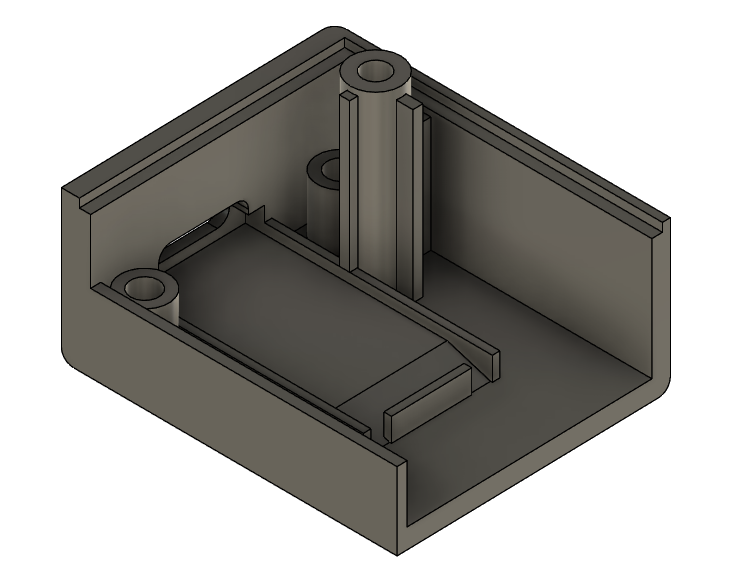

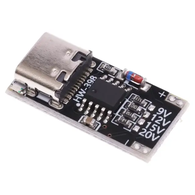

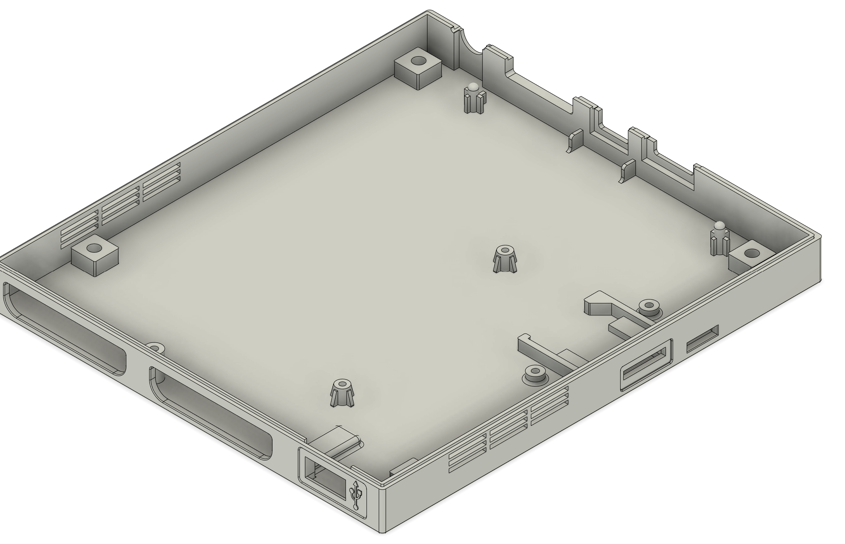

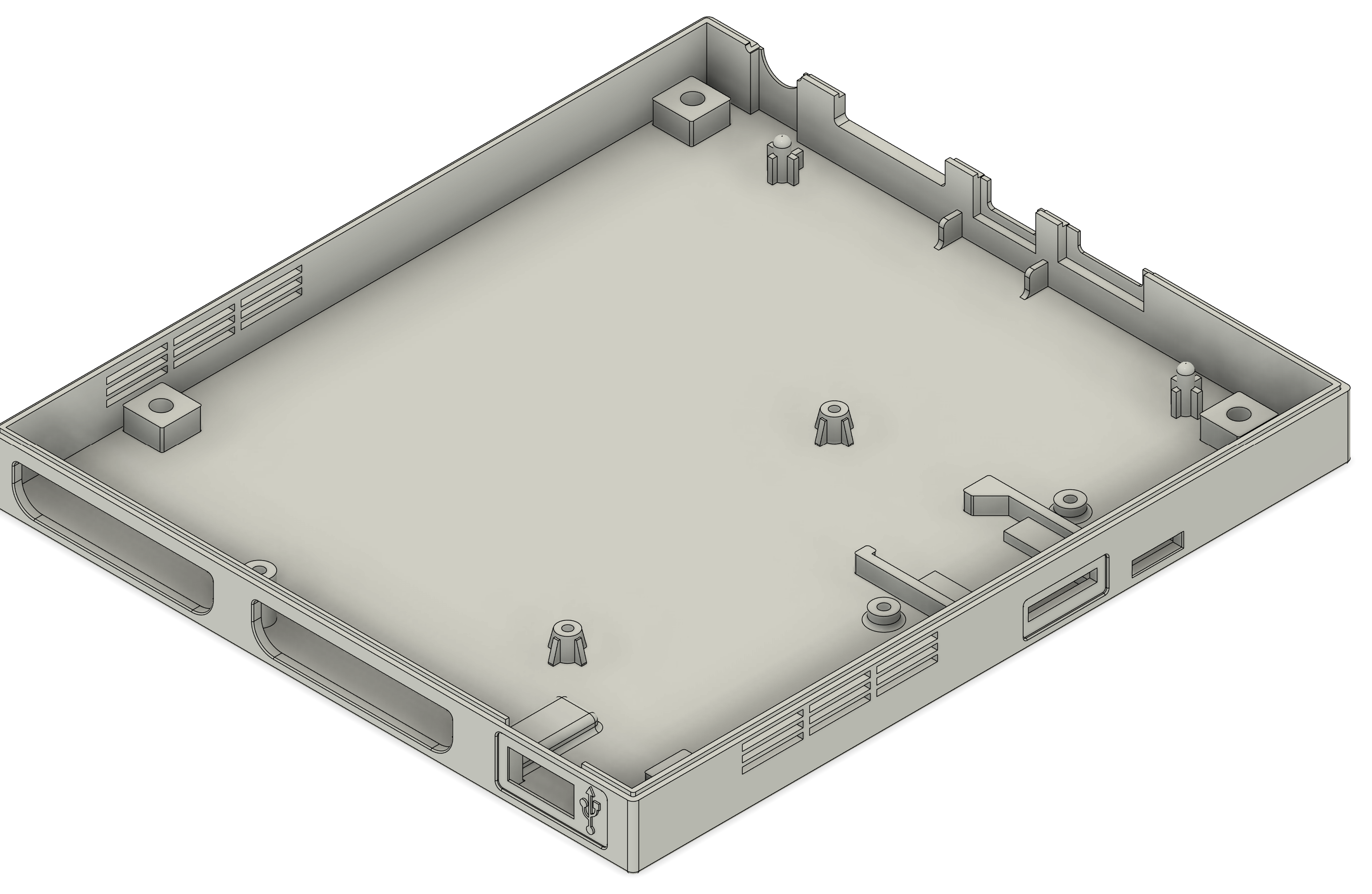

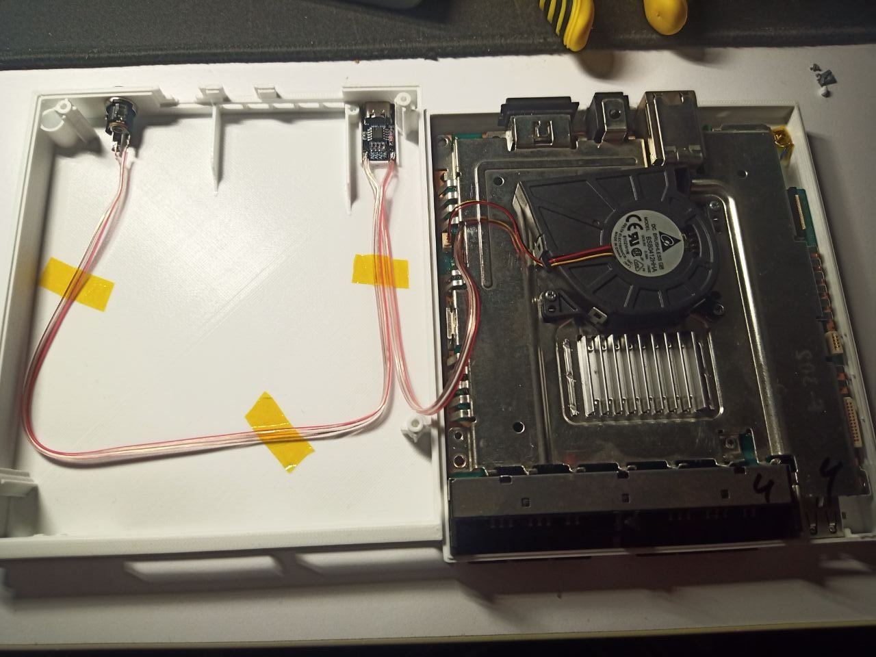

I modified a v1.2 case to accomodate a PD trigger board to use instead of a regular DC jack. @Wesk might want to add this somewere in one of his posts
This is for a HW-398 trigger board.
Make sure your trigger/decoy board is set to 9V
There are no guarantees that powering your console this way will not fry it. PS2 79XXX is rated for 8.5V input so do this at your own risk.
The print for me was a snug fit and I think you can just push the board in without a retainer but you risk displacing it. You need to push the buisiness end into the hole first and then push the rest of the board flat onto the platform.
You will need to use 2 M3x6 screws to mount a retainer. The screw holes are small enough for the screws to self tap. Make sure to not overtighten them else the standoffs will break off.
I am including a test part so you do not need to print the whole half to test fit your board.
CAD files are included so you can modify the design if necessary. The TestPart.step is also included and can be used to modify the other variations of the top shell.

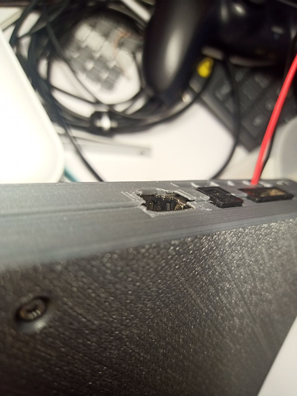

@TheFizz Interesting - I'm facing the exact same issue with the ethernet port, but thought it may be related to my wiring or printing being slightly out of alignment...
I looked at my original shell and it seems that the inner lip above the ethernet port is slightly higher. I might fix it in CAD and reprint but the power outages are too frequent during daytime and the print will not complete so gotta wait till night.

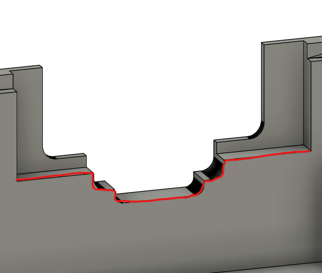

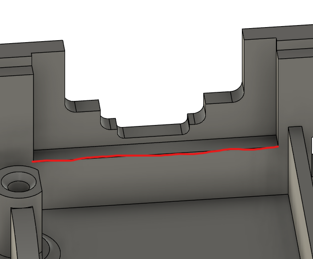

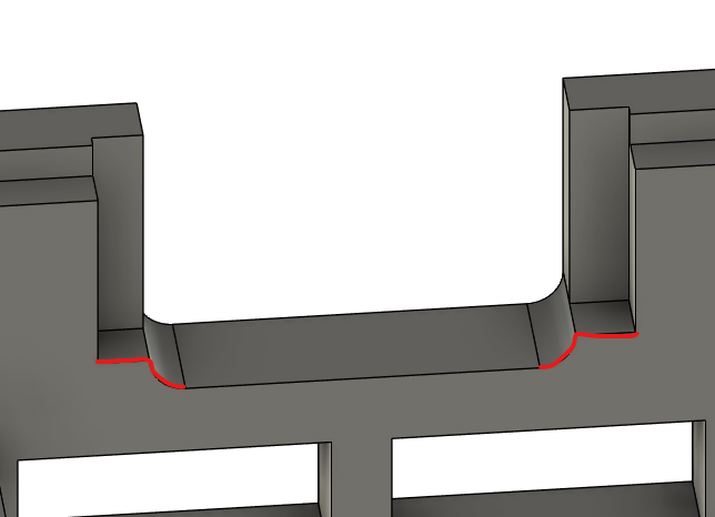

Yeah, it looks like the issue is around the ethernet port on the top half. Both v1.1 and v1.2 bottom halves were a tight fit but still ok. v1.1 and v1.2 top halves both resist(?) around the ethernet. Here's how v1.1 looks like. I think you can see where the problem is
In a v1.1, this portion sits against the ethernet port and won't let the case to sit properly
In v1.2 this lip seems to be too low, which also prevents the shell from closing properly. But I am not sure about that.
I think that the boards we have and the board that was 3D scanned might be different revision. While the model numbers are all good, Sony might have minor differences between board revisions. This is just a wild guess though.

Can you guys try the attached files out and let me know how fitment goes
I printed this version and it still won't close at the rear. But this time it looks like the problem is not with the ethernet but with an optical audio port. I have another 79XXX coming my way, I will try it with all the cases I previosly printed. I think there is a decent chance there is something with my board.

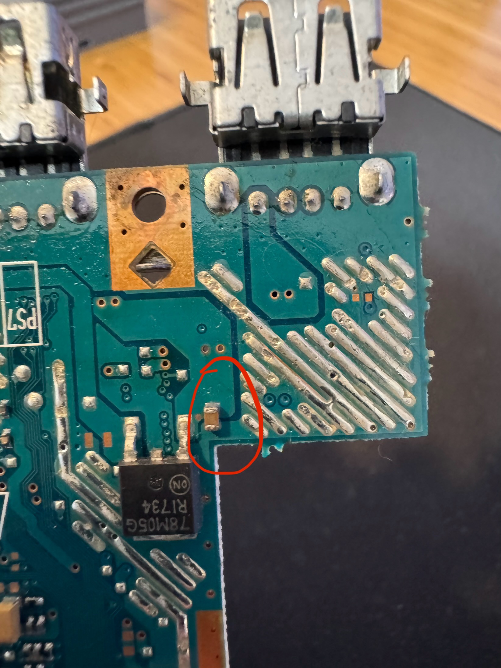

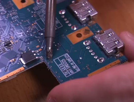

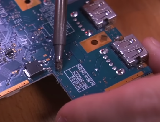

How did you cut this board, I have the same one and there is a small cap or other little electical device right in line of where you cut the USB port off on the back side. Is it ok to remove that small little piece the cut the usb part of board off?
In his video (link w/ timestamp), Macho Nacho desoldered this resistor(?) and I did the same and cut the USB

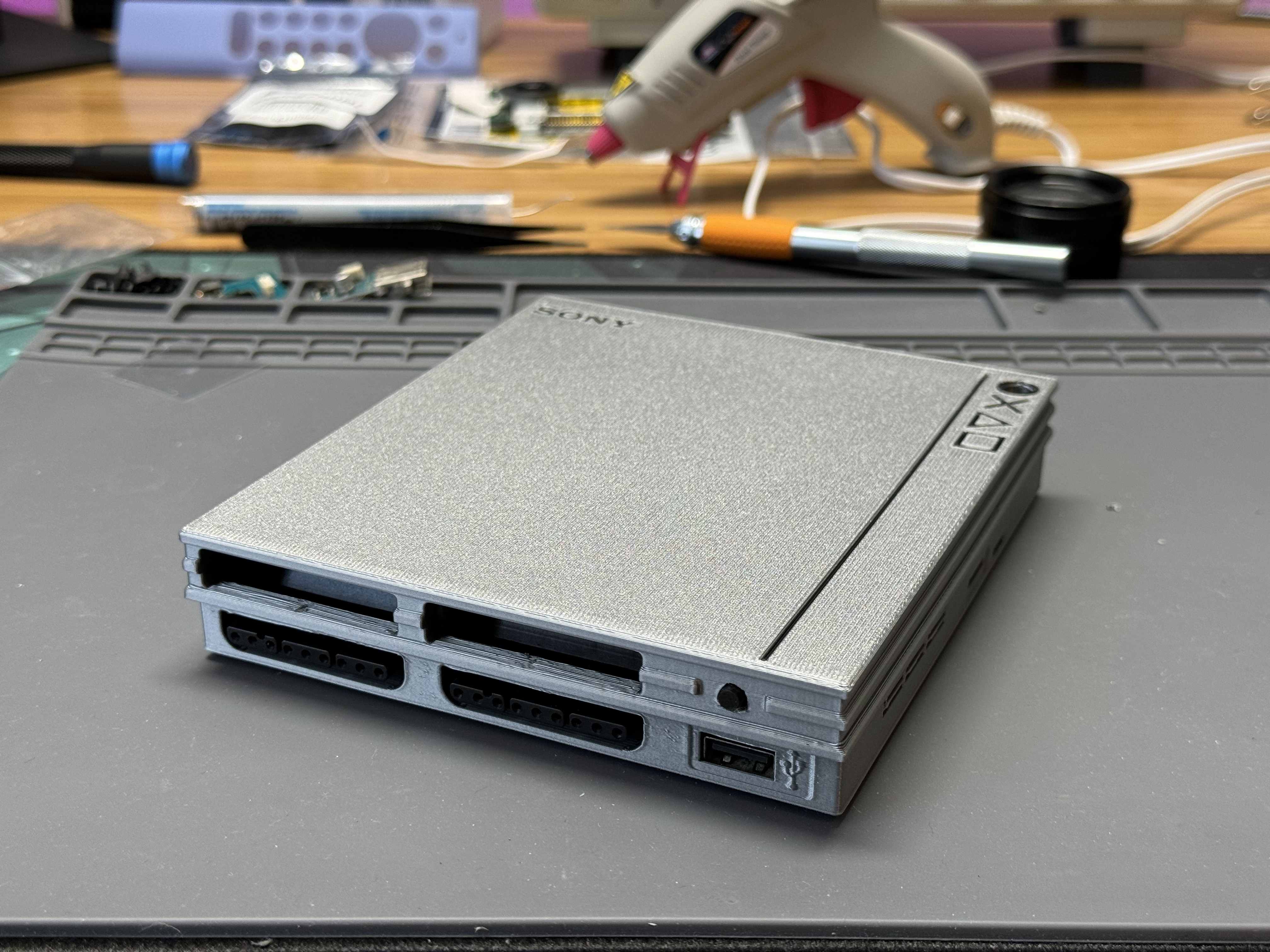

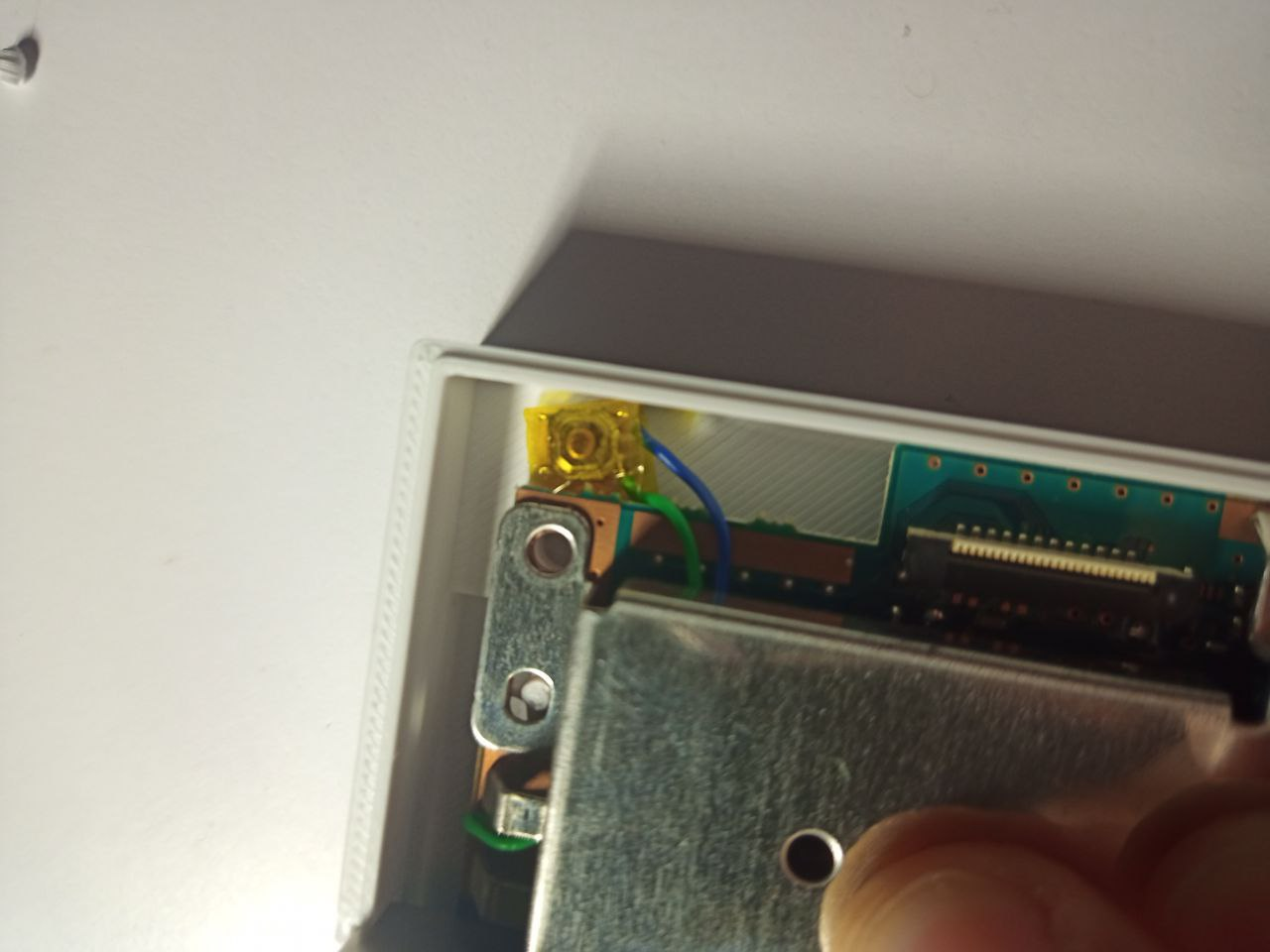

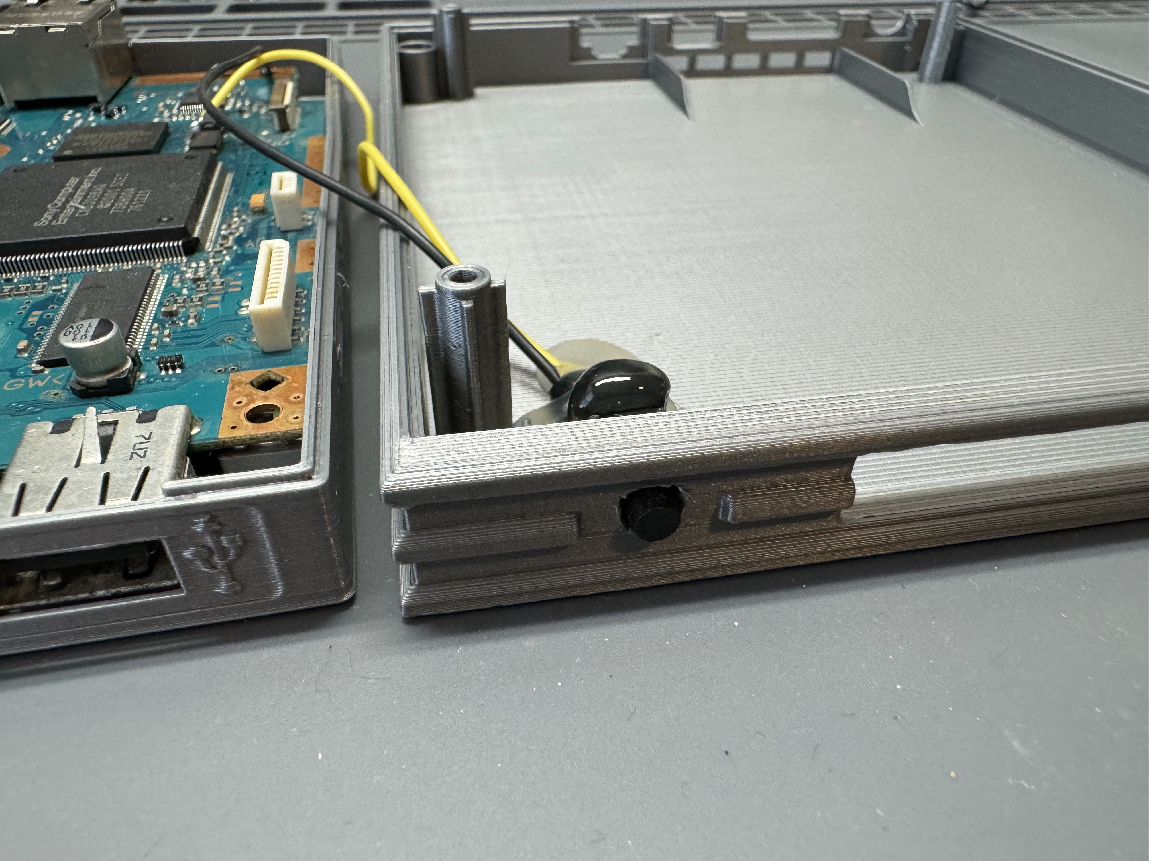

Finished my initial build. I do still want to add the SD card reader and the HDMI output, but that can wait a little while longer. In the meantime I did something a little different and since my board didn't have the lid switch in the back and I needed a new switch anyways, I put it up front ;) I really like this design style having the button up front, just a simple button with a 3d printed button cover. Had to make the hole a little bigger but it works really well. Would be nice if the case could be modified to allow for a specific switch to be mounted there instead of having to use hot glue though in the future.

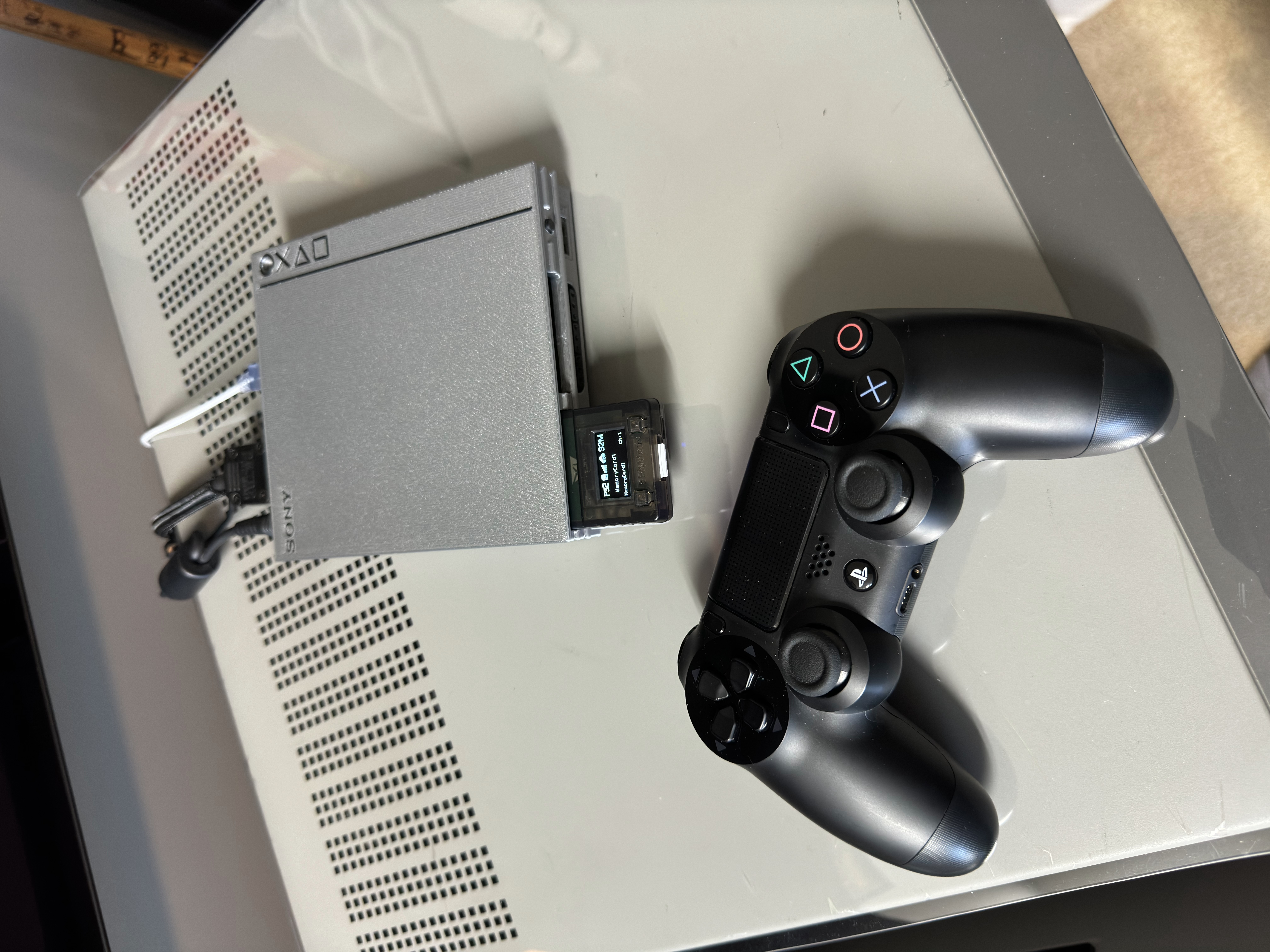

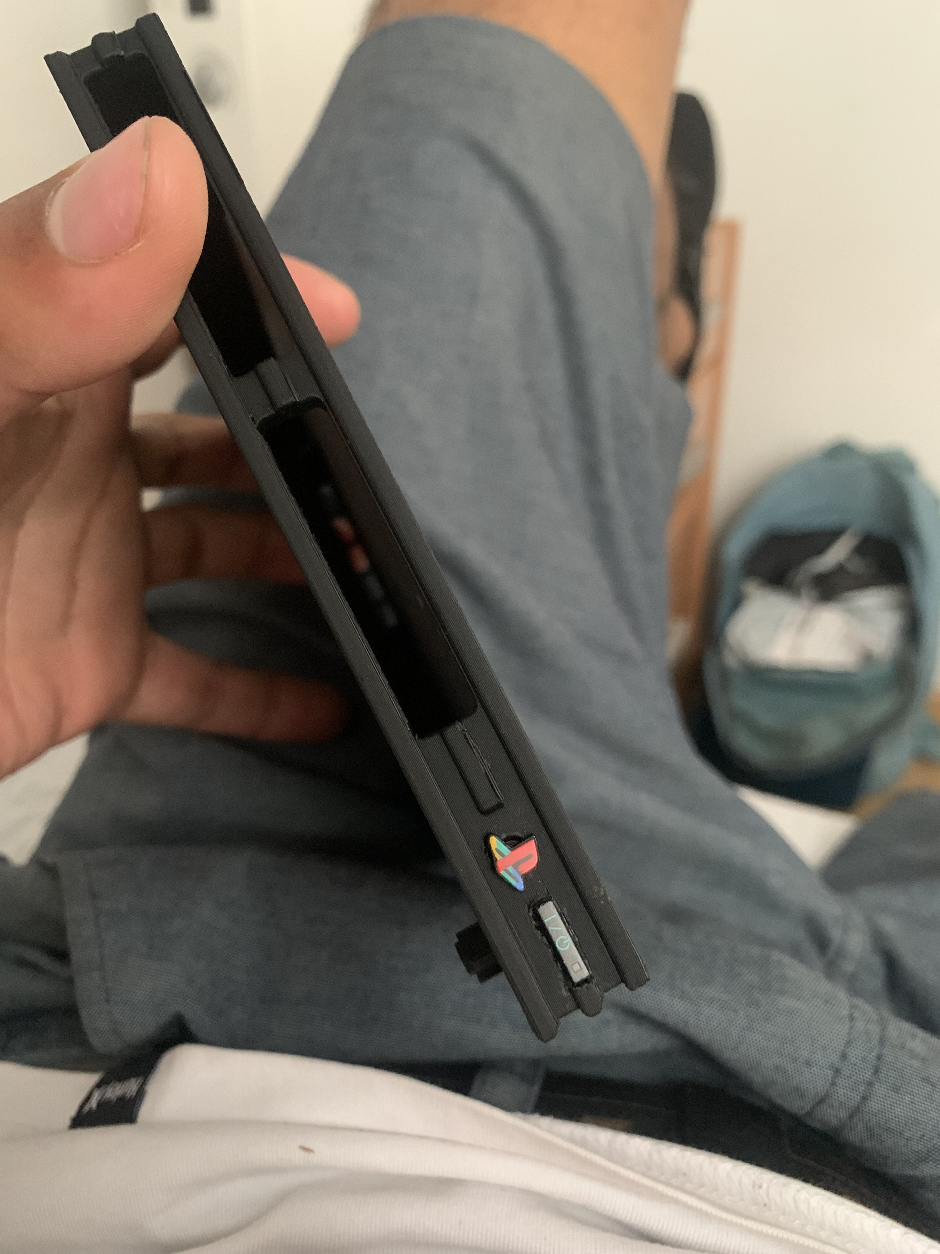

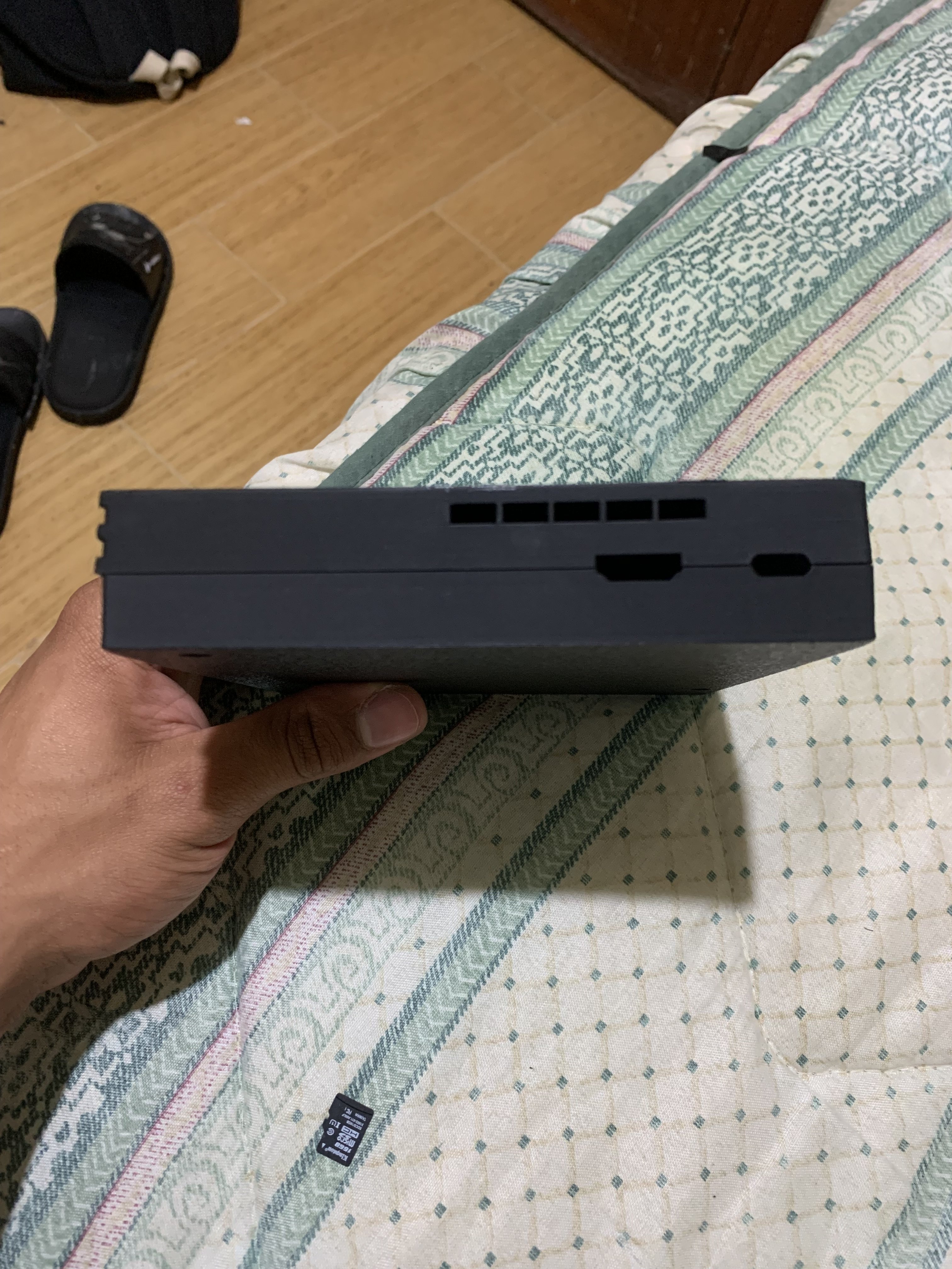

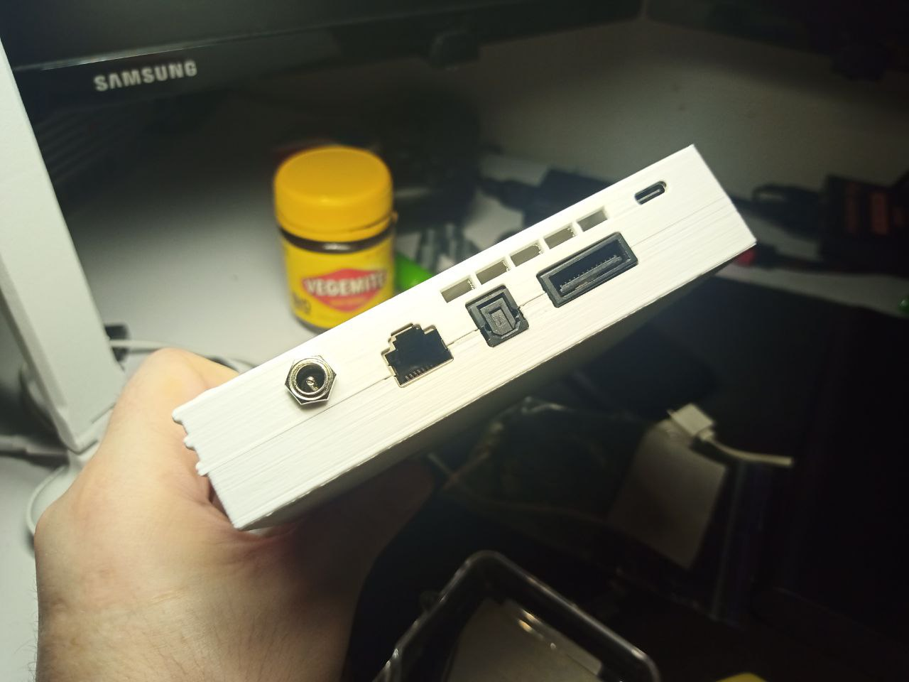

Ps2 ultra slim elimine los conectores de network y optical y puse una entrada hdmi y un adaptador usb-c para la corriente
Ps2 ultra slim I removed the network and optical connectors and put an hdmi input and a usb-c adapter for power.

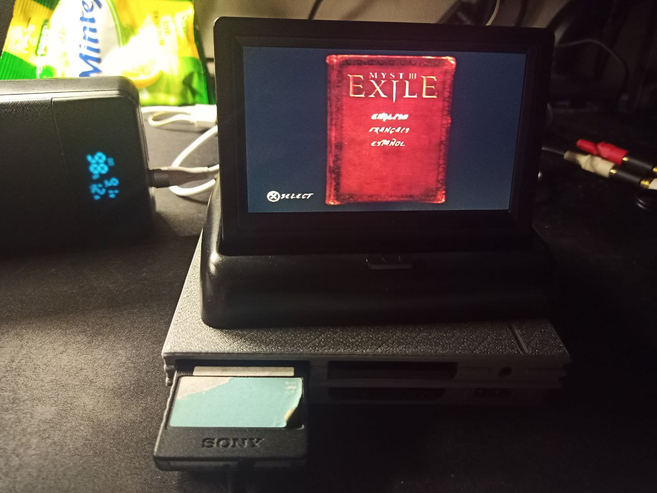

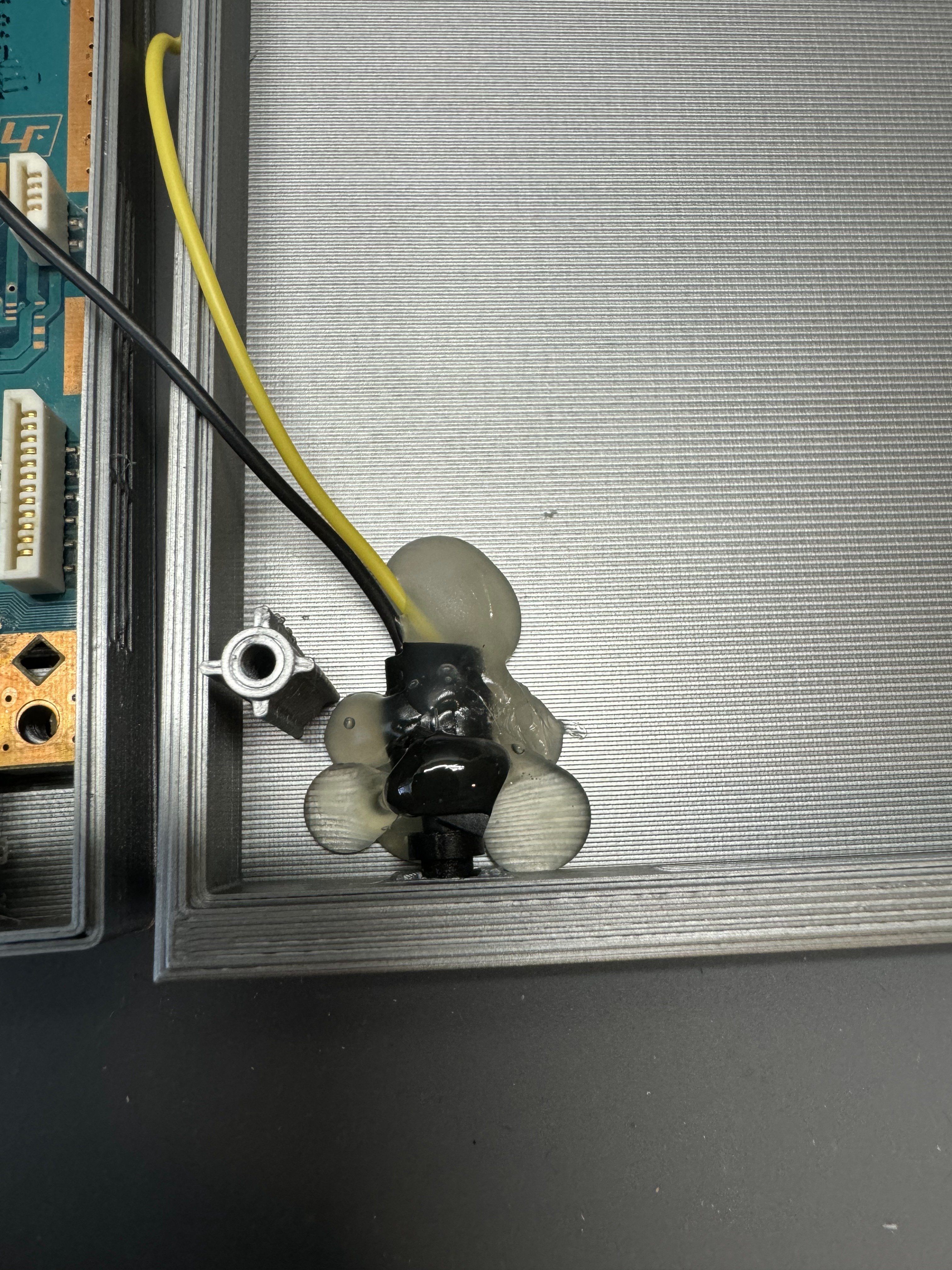

Ok so I finished the build.
I made a few modifications to both the case and the motherboard itself (v.1.2). I removed the original power plug, replaced it with a 9V PD trigger board and also wired it to a separate DC output. I made modifications to the top shell to accomodate both the board and the barrel jack. And no, I didn't have to unscrew the halves after everything was assembled because I didn't install a PD board retainer, why do you ask?

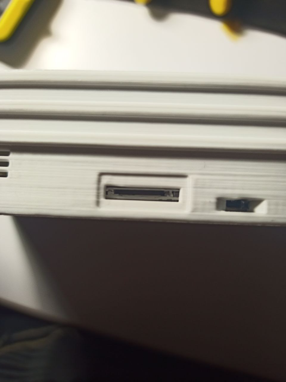

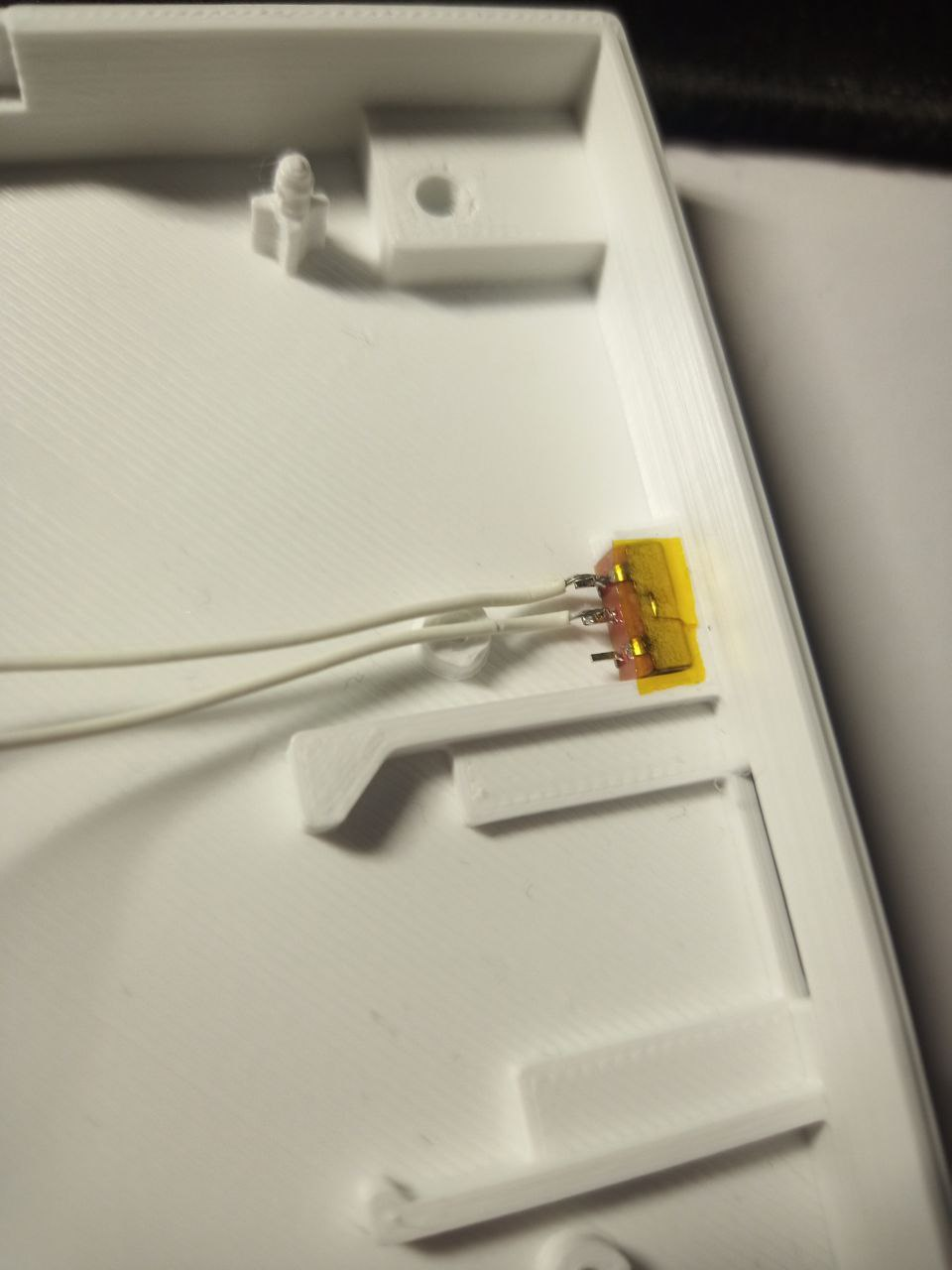

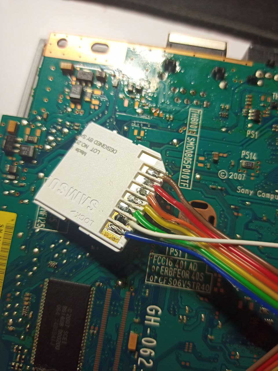

Since I didn't have a requred MX4SIO/Memcard switch, I adapted the bottom half to take in the one I had on hand. I also absolutely definitely did not forget to bridge/put a resistor between ACK and GND on an adapter and it predictably worked flawlessly on the first try (no, seriously, it did work. Maybe that's because samsung adapter or idk). And I put some kapton on top of the switch. It has metal housing and is slightly bigger than what Wesk suggested so I thought better safe than sorry. And yeah, I glued that in because I didn't have an opportunity to test fit the print. I also repositioned the SD card opening .5 mm lower because it seemed too high. Now it is spot on.
Next was the button. This version of the board didn't have a lid switch, so I just went to a local repair shop and asked them for a button. They gave me the button. I soldered in the button. It has become The Power Button. I also wrapped it around with kapton because of metal housing. I didn't fix it in any way but it kinda just stays there so I think I'm good. I also made the printed button a bit longer.
Finally, I put together the parts. It was an exclamation mark on everything that had led to this point. I released my finger from the trigger, and it was over. I was expecting it to not sit well as it was previously, but I made one crucial change. I removed a lip around optical audio and all of a sudden, it fit like a glove. I don't really know why this helped me while nobody else had this issue but I figured I'd just share. @Wesk might wanna look into it?
So, all in all, it was a satisfying build. Or even a journey of being able to only print one piece a day and trying to adjust the design to fit my board. Apart from minor printing artifacts, I'd say it came out pretty good.
Oh, about that 9V DC out. I have a cheapo analogue automotive display (you know, the one for a rear camera). I use it as a portable display to be able to play when there is no power. It requires 12V and while the console needs 9V, I cannot just stick both into my powerbank. The plan was to have the console output 9V directly from PD board and then integrate a boost converter into the cable to boost 9V to 12V. Surprisingly enough, the screen actually works with only 9V power. And it works really good without artifacts, with good brightness and contrast and all. I'm guessing it has some conversion circuit inside of it but I am not sure.
So there's that.
P.S. If somebody knows a decent screen with a driver that I could buy on aliexpress and that would be easy to solder in please let me know. I want to convert this thing to become fully autonomous, much like PSOne with LCD attachment but also with internal battery. I know I will not be able to make it fully portable (and I don't really want to), but I'd like it to be sorta all-in-one.
