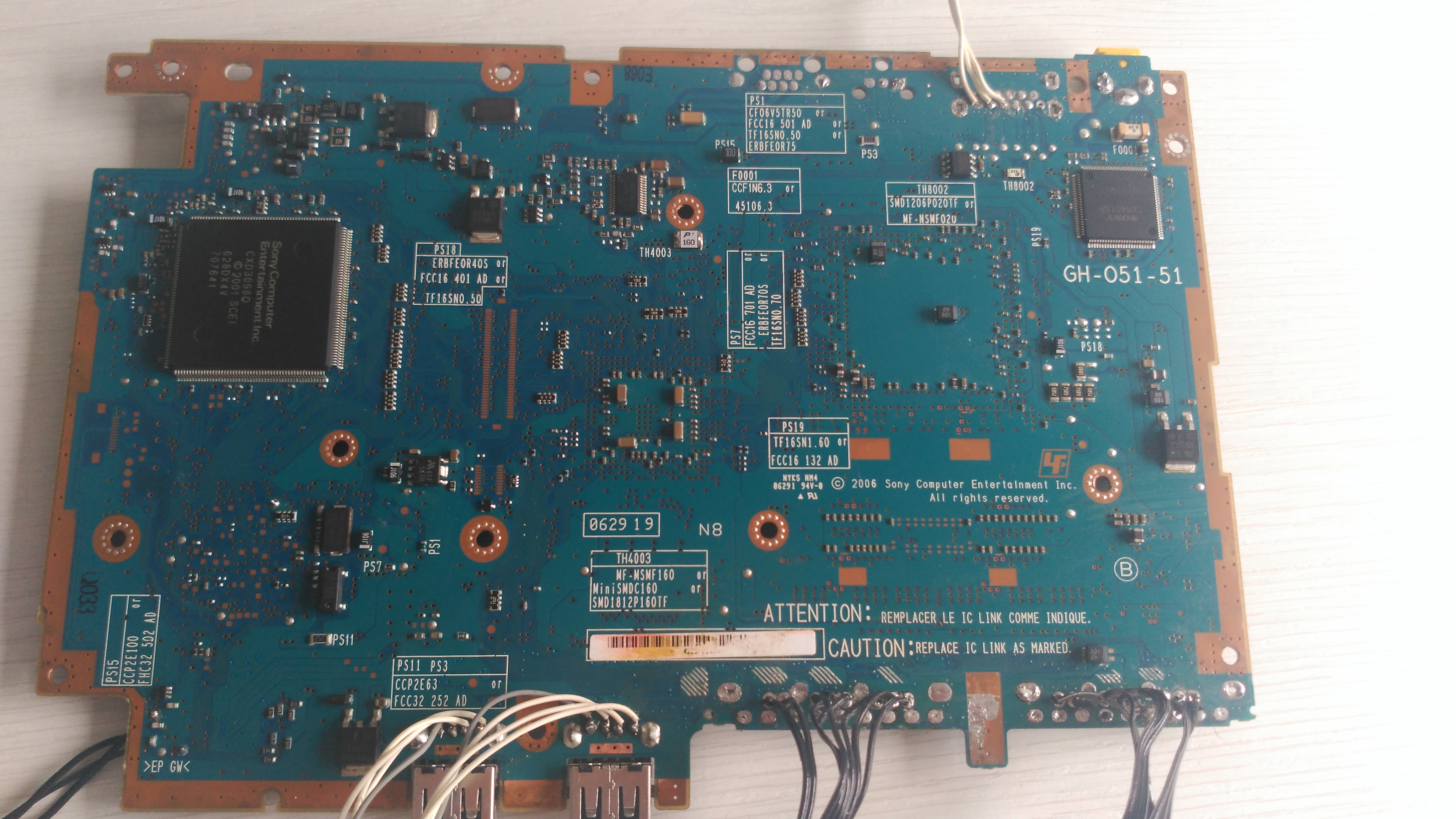

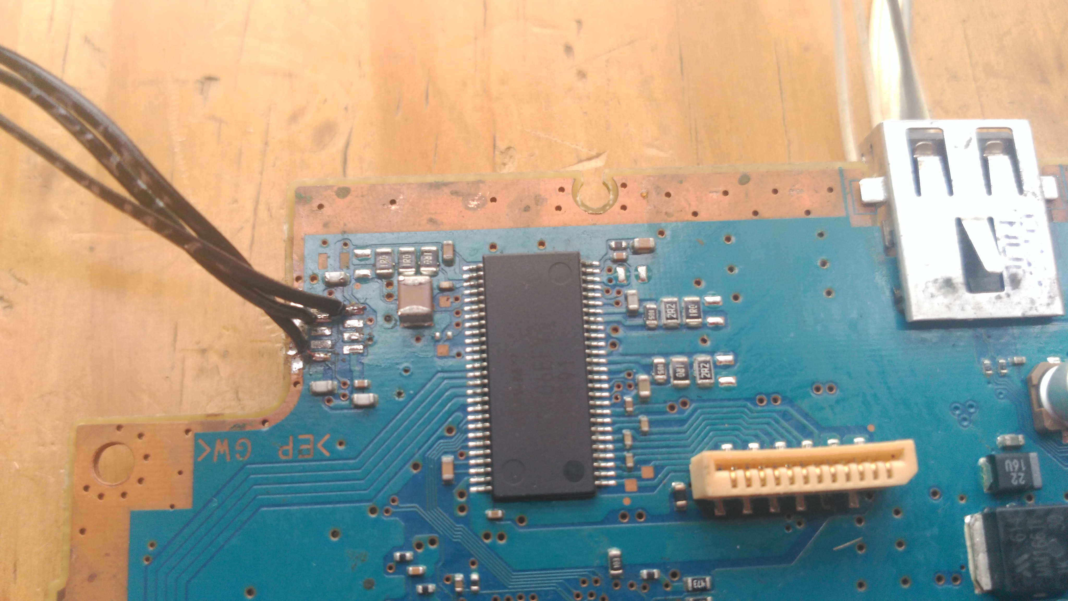

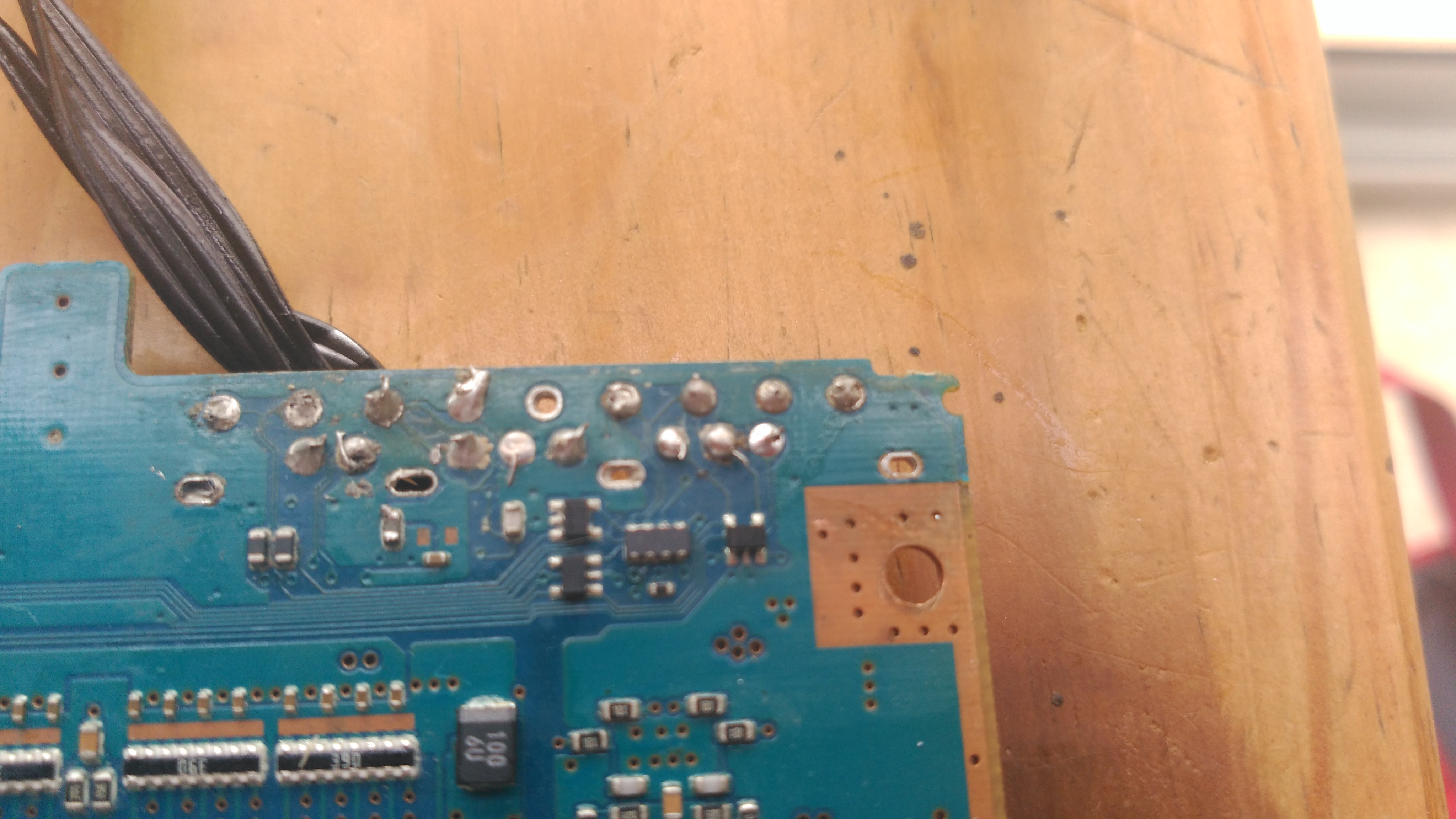

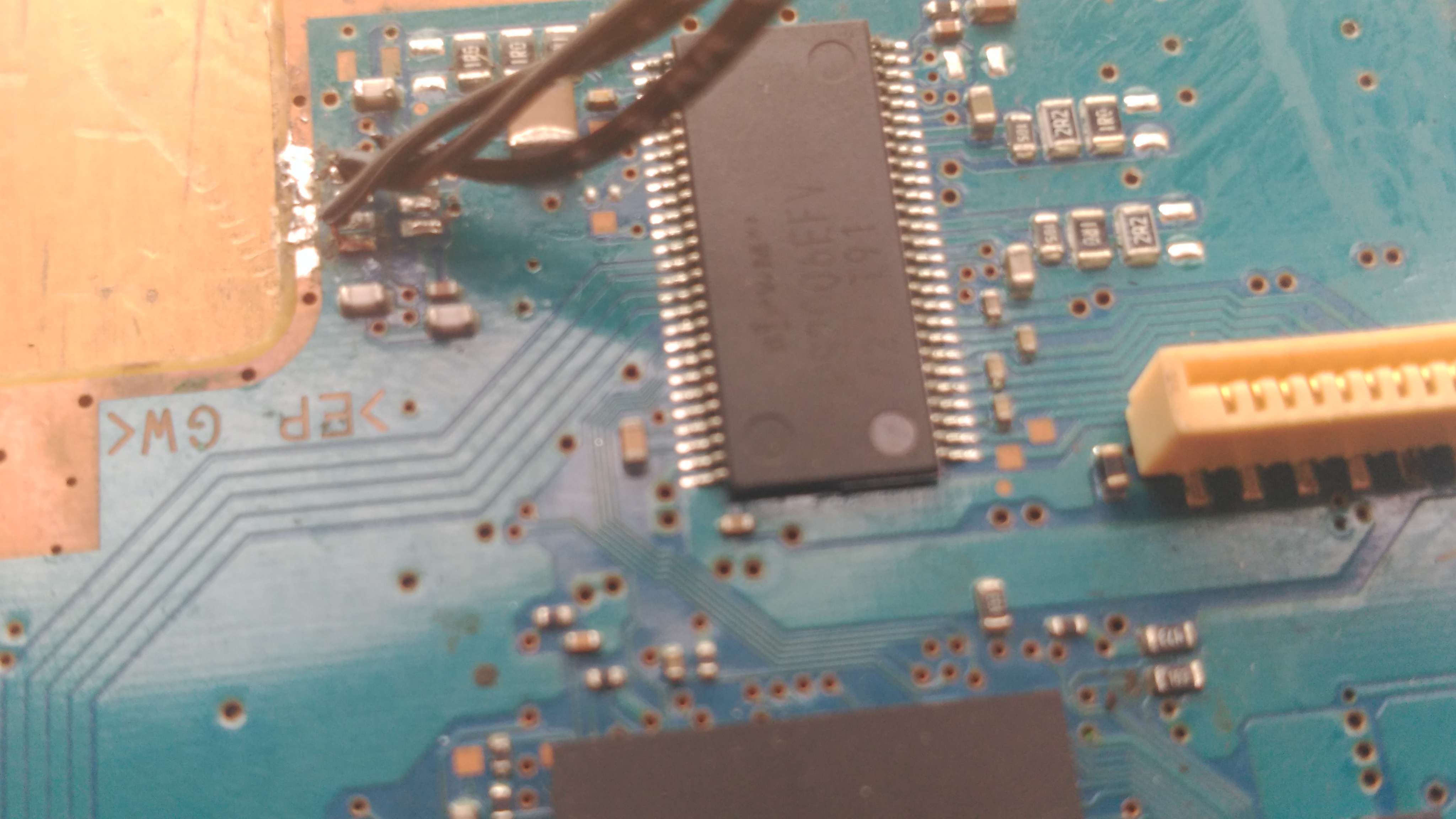

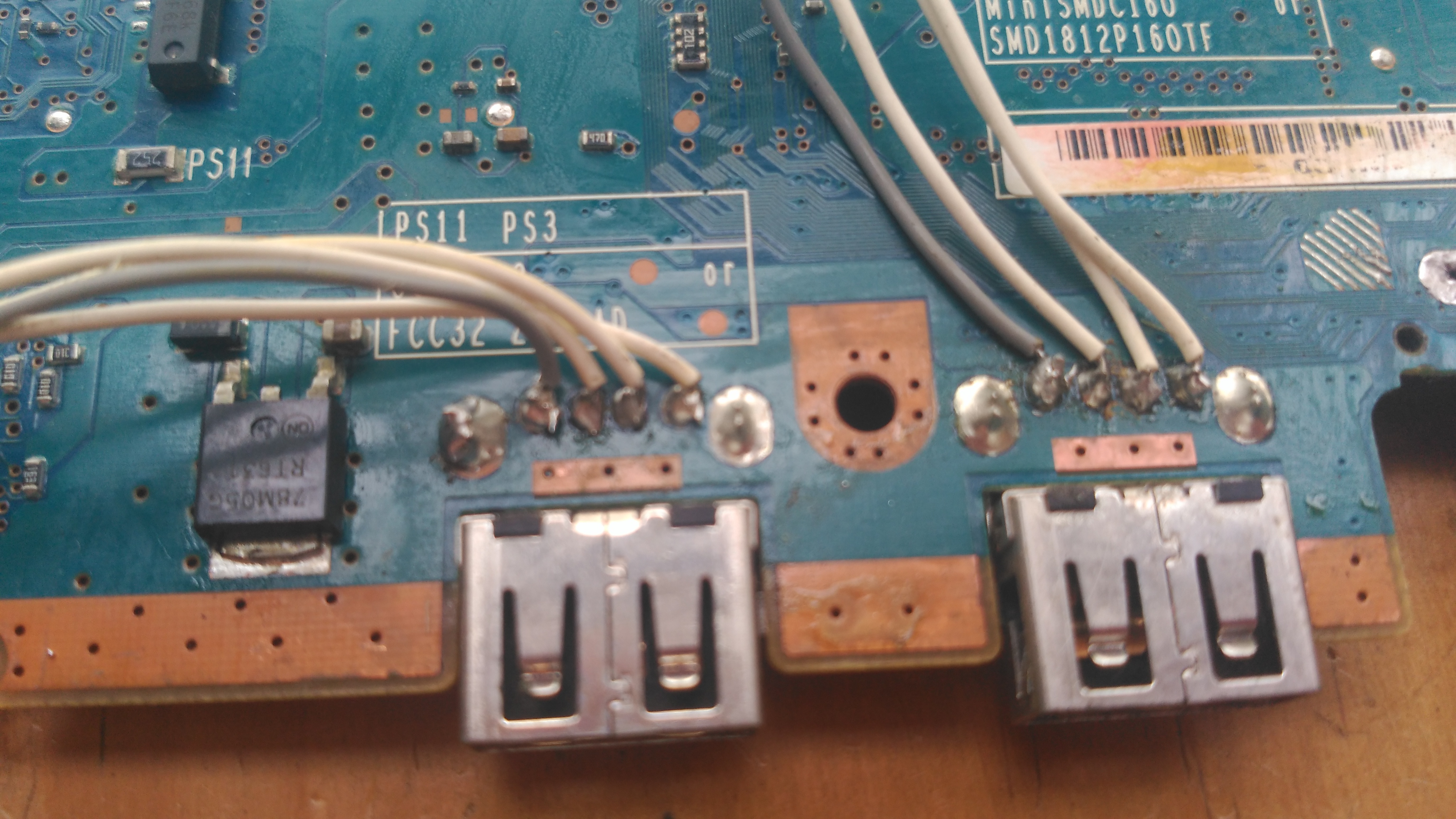

I removed the connector for the light and power switch beacuse it was almost broken (so I don´t lift up a pad accidentally) appart from that, the memory card wires might be looking like they´re shorted but they aren´t (I know, my soldering skill is pretty bad) sorry for the quality, the best that I could get with my phone.
Also, get a toothbrush and clean up that shitty gunk around the joints. And use a multimeter to check for bridges just in case.
yeah, I checked it again, it isn´t shorted but I should clean it of a bit more
EDIT: Should I put a pullup resistor? I can´t find shorts or blown fuses, I have power and the IC seems to work (since the light turns on and I have the lid closed buttons lines powered) the 70000 service manual showed up that there is a resitor and a capacitor that I couldn´t find nearby
It worked, 10k pullup resistor between 3.5v (IC main supply voltage) and one of the pads for the power switch, wired again the power switch, pushed it and booting up.
Thanks to everyone who tried to help, with some sort of luck I´m not going to be asking much more, instead I´ll ve trying to help others:D:D
