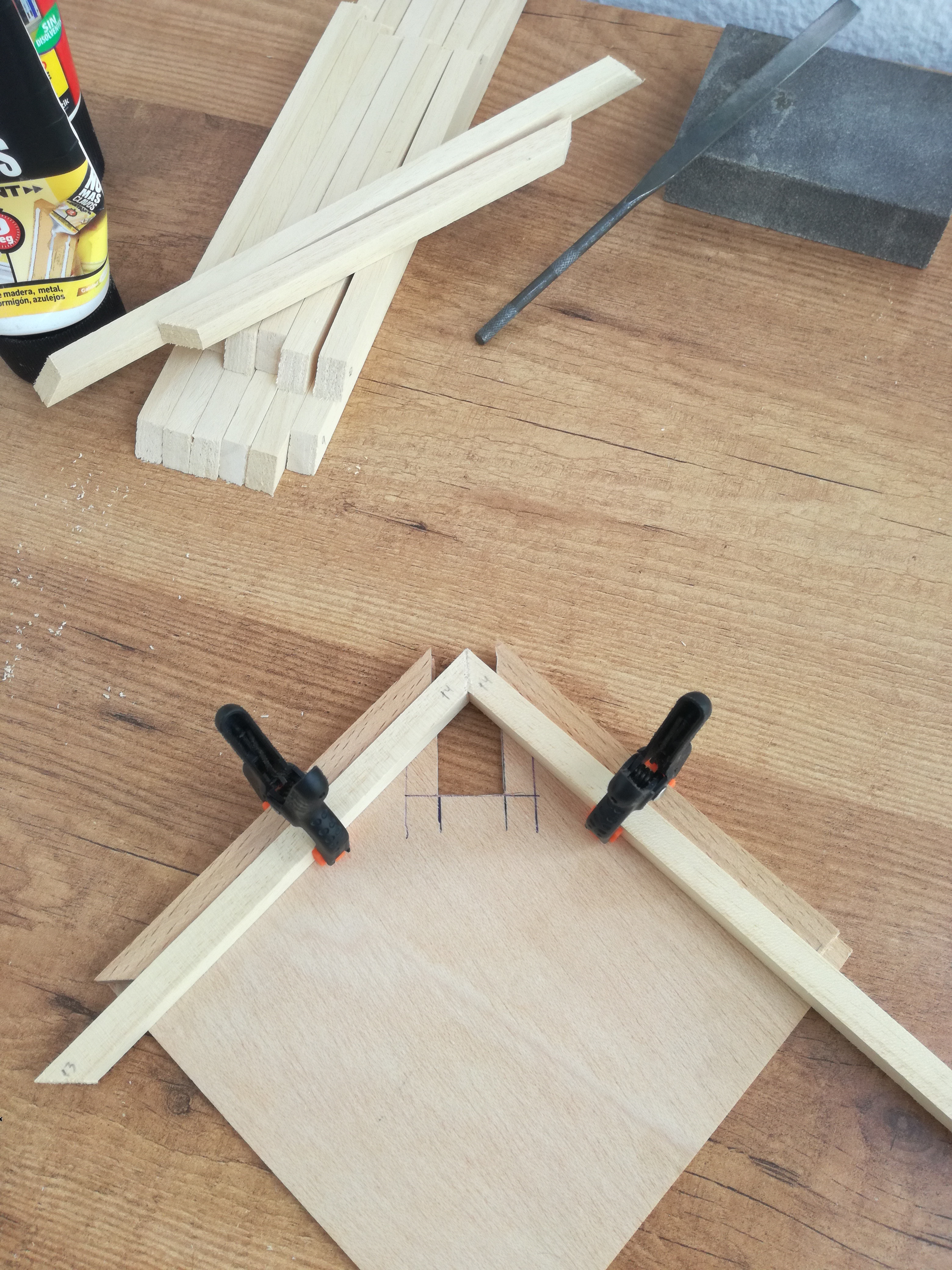

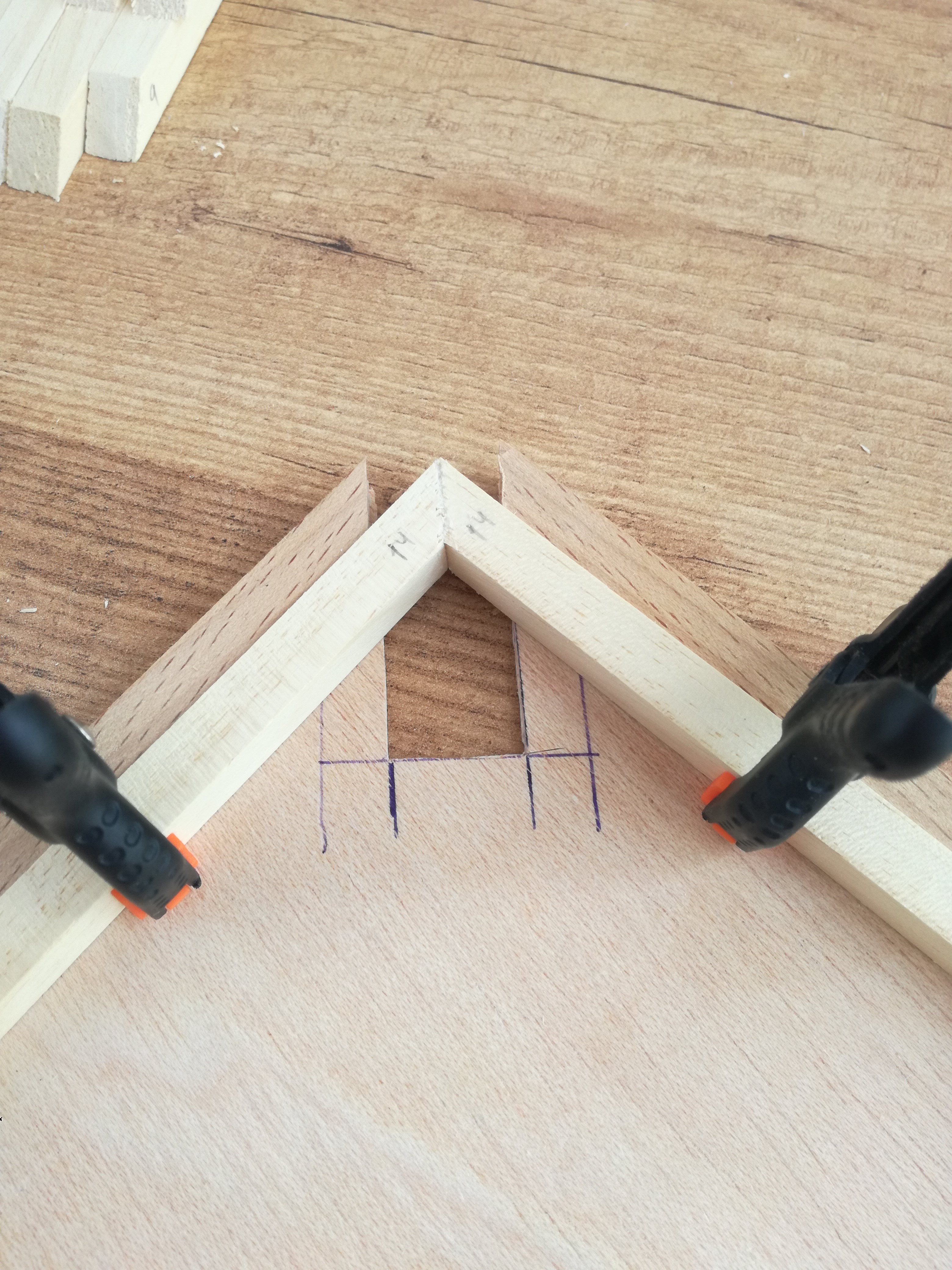

I`m posting this so that means that I finally have some time to work on the PS2p. The frame-based desing is actually easier than I expected, bought 2 200x1x1cm wood pieces and started cuting them with 45 degrees angles
mmm perfection made corners
After cutting them I started assembling the 4 frames (one of them is actually a leftover because I misscalculated the top half height:facepalm:)

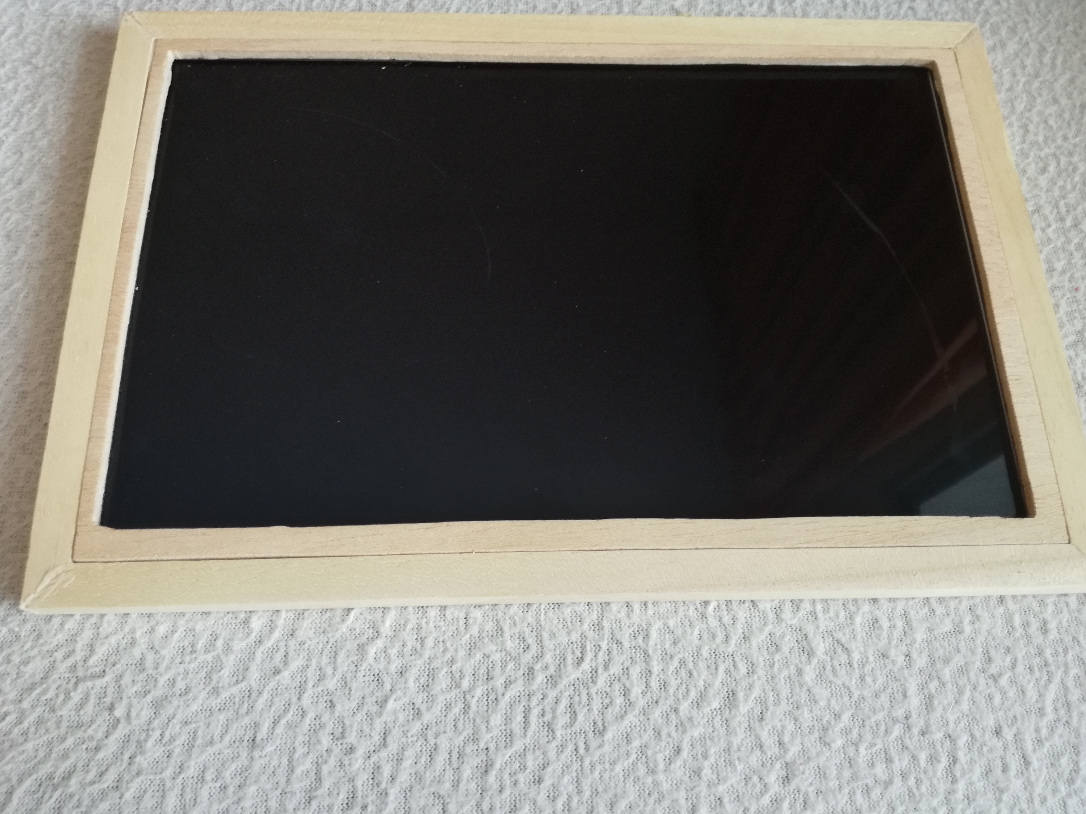

This is the top frame before sanding the inner part and filling the gaps between the screen frame and the full frame. These frames have been carefully measured so the screen is held mostly by friction (I will add some suport to the cover in the back to make sure that it stays in place)

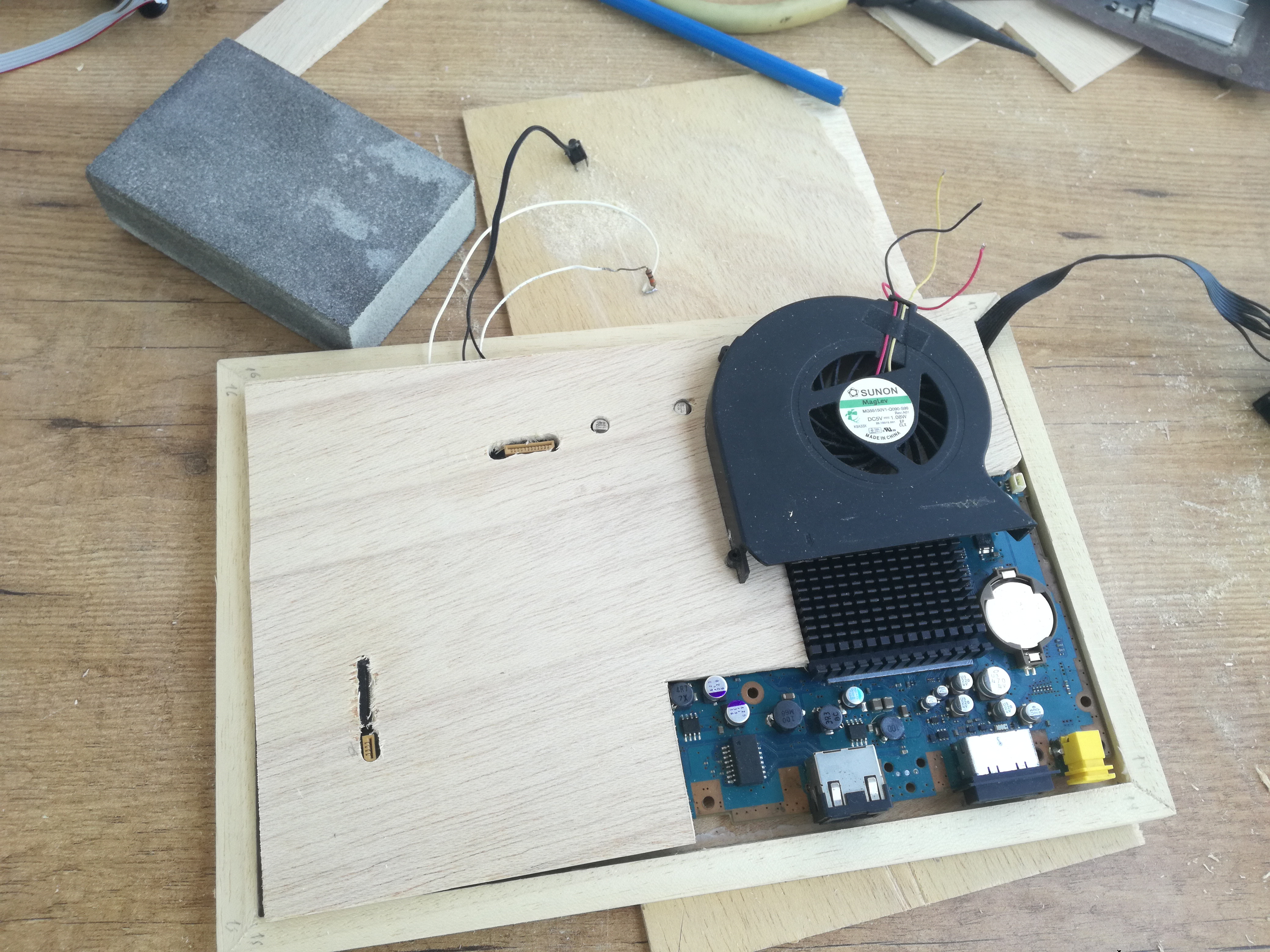

Once I finished the frames and the top part I started working on the bottom half. I found a small heatsink lying around that has more surface area than the stock one, the wood glue that I´m using works on metals too so I only need to sand a bit the edge and it will be ready to glue
The workbench is a bit messy and the wood on top of the ps2 needs some work. I think that I can make this more compact than I spected and without spaghetti wiring and without hot glue.
I have free space on the left for the connector of the original idea of making a dock

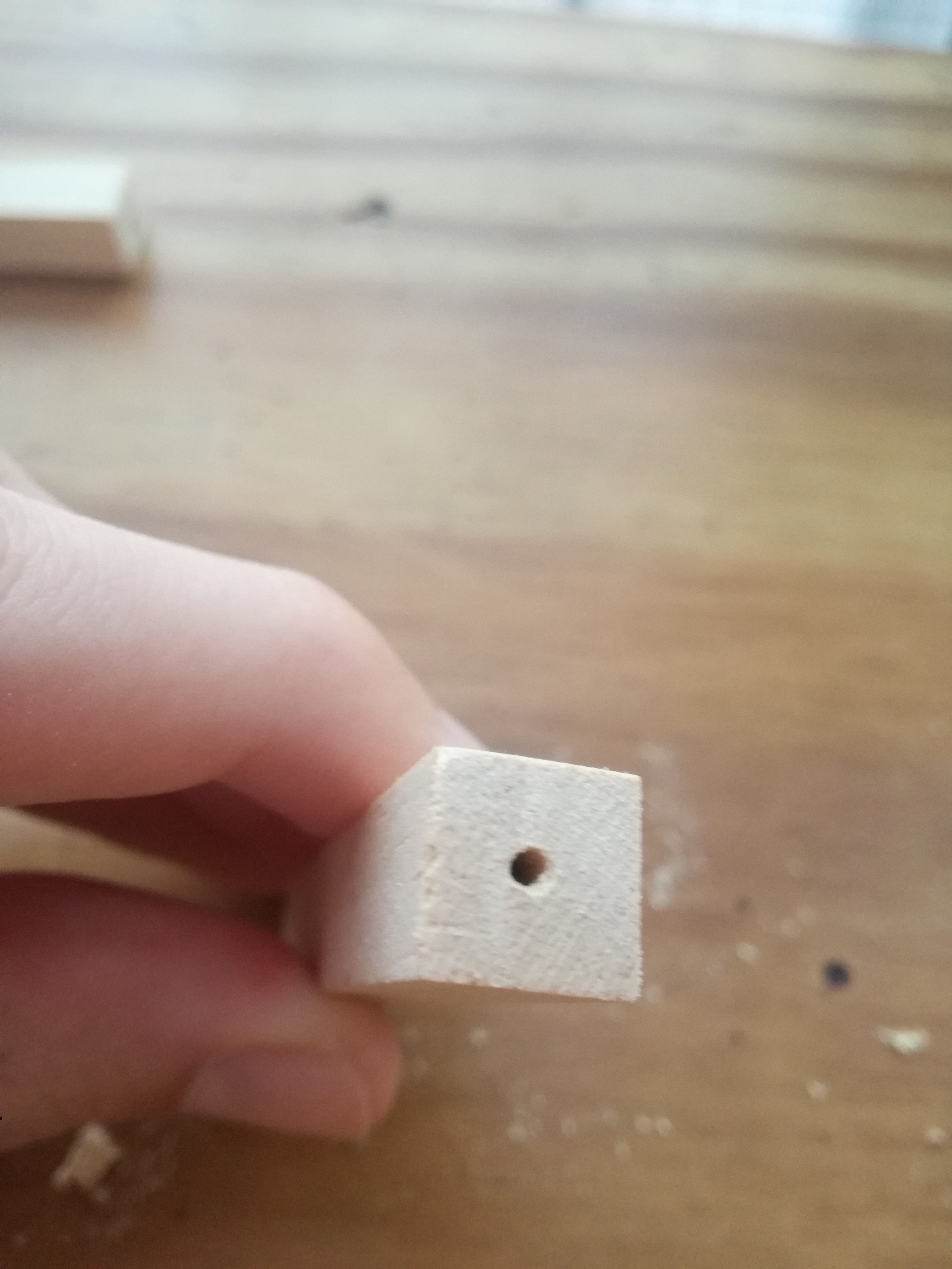

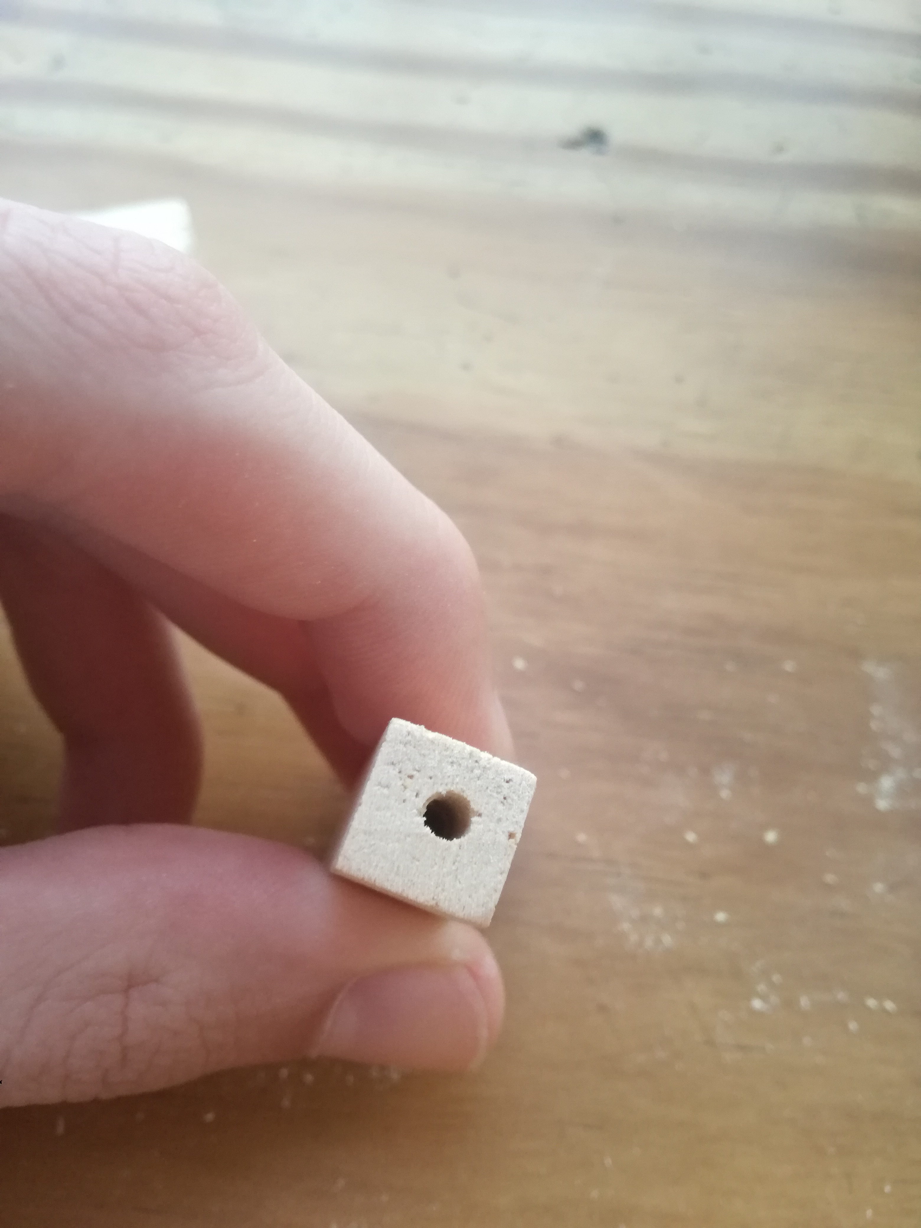

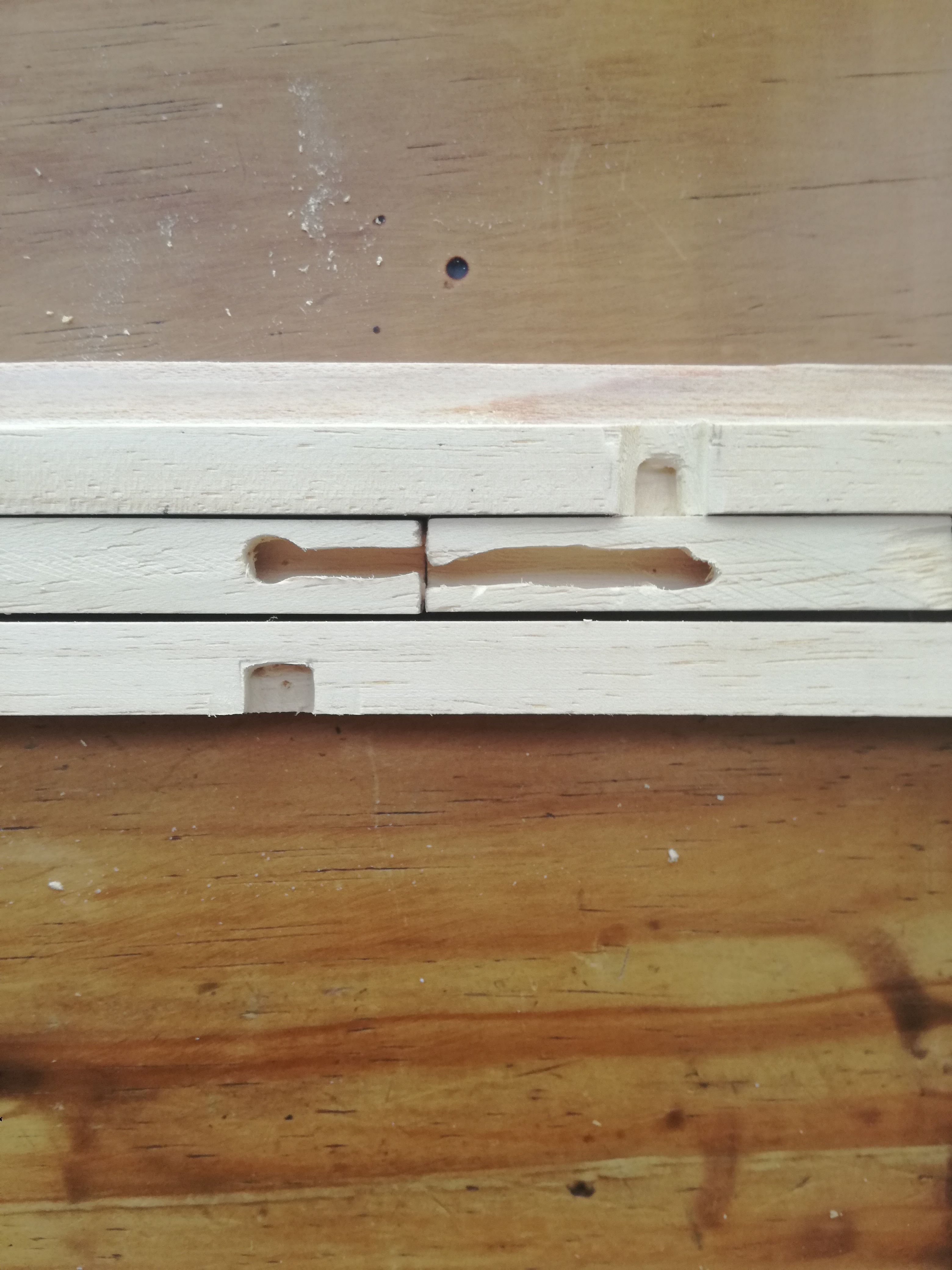

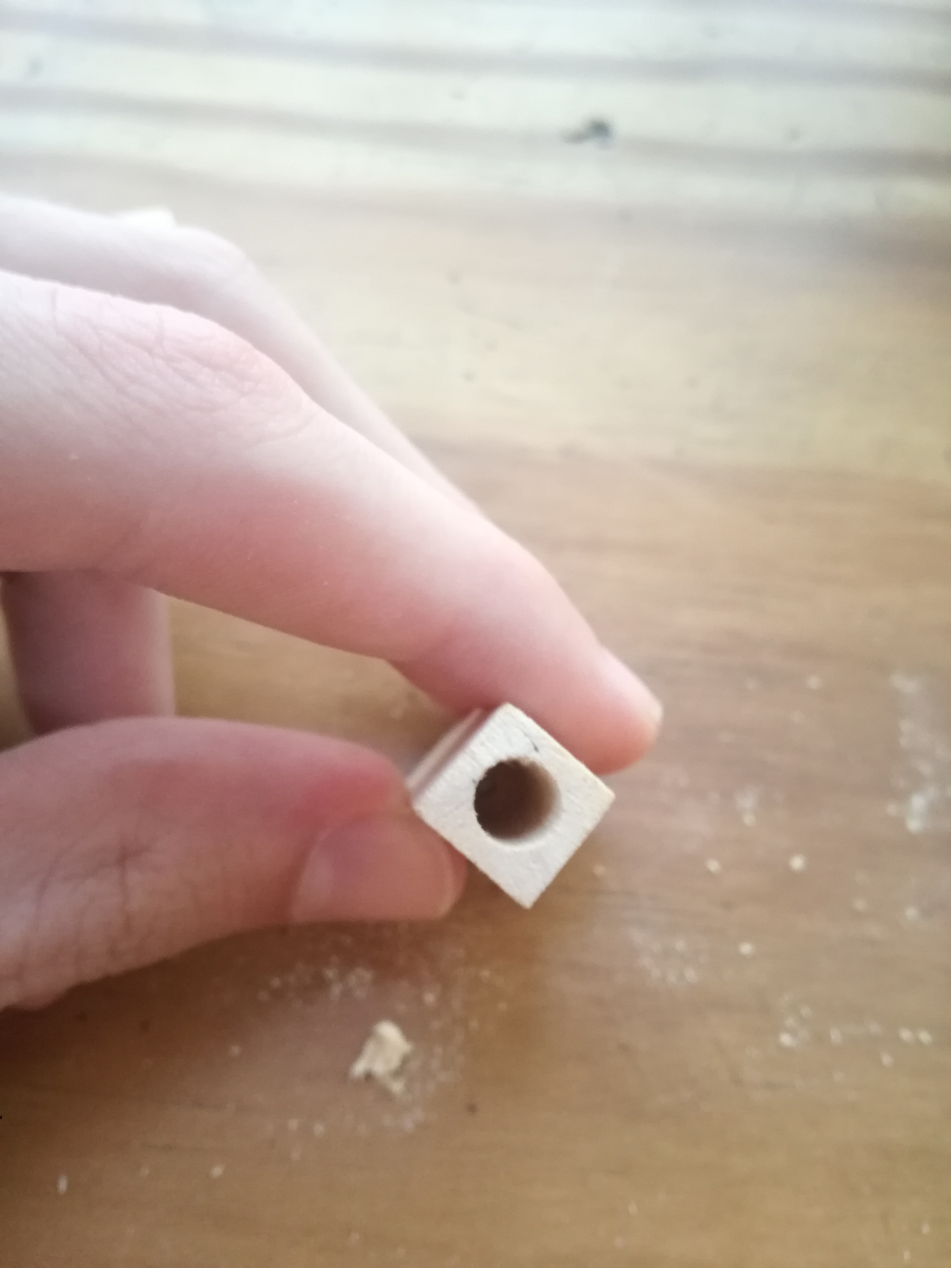

I carved the holes in order to have the 40pin LVDS cable going from bottom to top. As you can see, I started carving the pieces in the middle (don´t worry, the inside of them is a perfect 6mm hole) and then I got some skill to do almost perfect pieces into the top frame and the hinge base
The hinge is gettin tension from 2 screws that makes pressure so friction is created to hold it (if it is not enough I will add a rubber ring spacer)
There´s a big hole to put the screw head trough (It digs deeper making sure that the screw has sufficient wood to pull
A smaller one to be able to pass the screw through and retain its head
The even smaller one as a gideline to the screw (As I mount it the hole will be threaded by the screw making a perfect tight fit)
