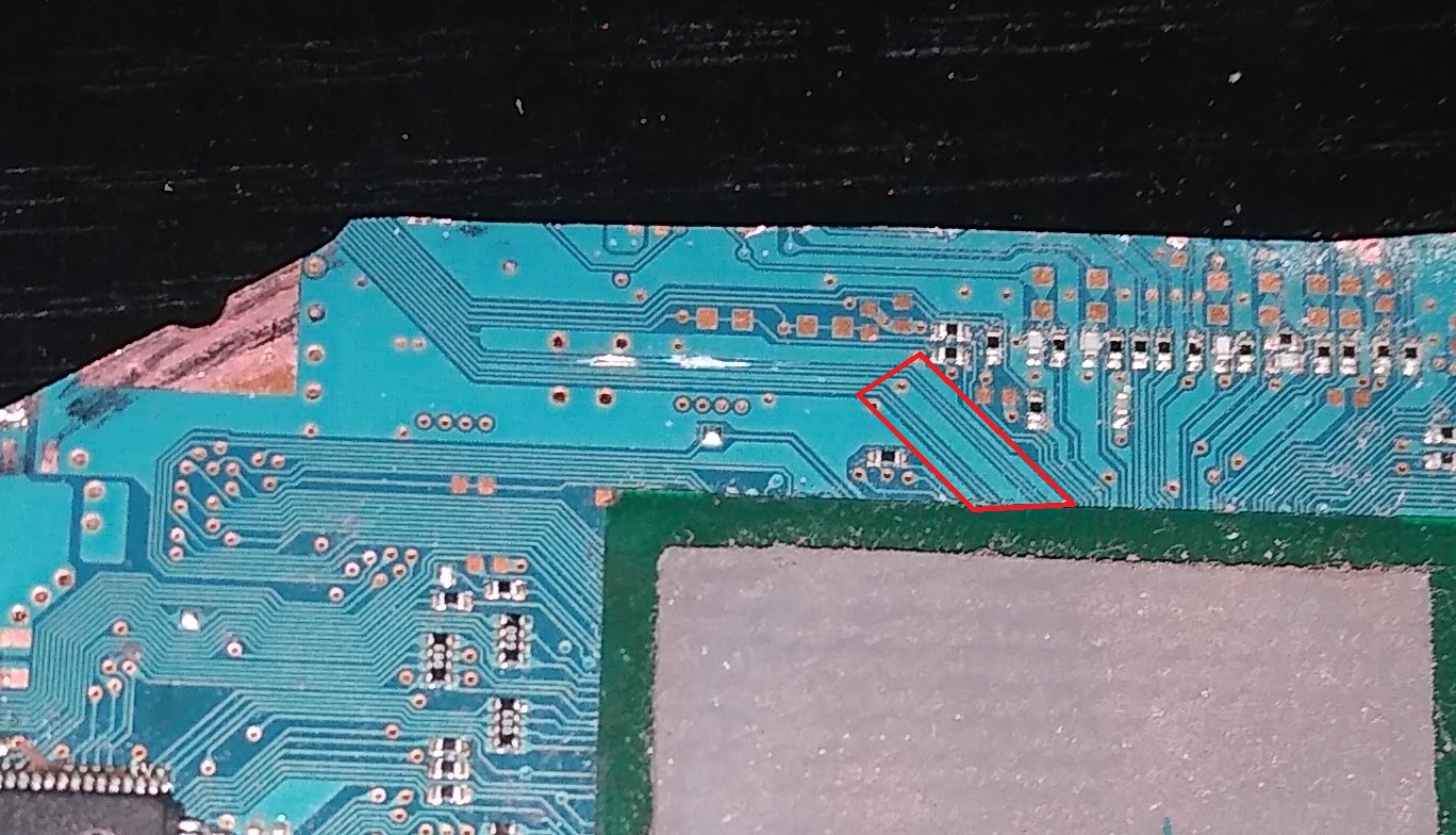

So i trimmed my PS2 Mobo and cut the usb ports off, without knowing that i have to solder the USB ports to two tiny traces that i have to scratch on the mobo. Are there any alternate points where i can solder the usb to that isn't a trace, because that's near impossible. I'm a noob. I've been trying for hrs. I feel like i f'ed up badly.
Alright thx man. I eyeballed it, that's why the traces came out pretty whack I'mma redo it like so. Thx again for the help, I'm new to this, but I've been wanting to make one since forever.
Whenever you are scratching traces always start as far away from the GPU as possible, so if you do mess it up like you have you can just move down a little further until you get it right.
If you only require a single USB port you can also jump over to those lower traces and try from there.

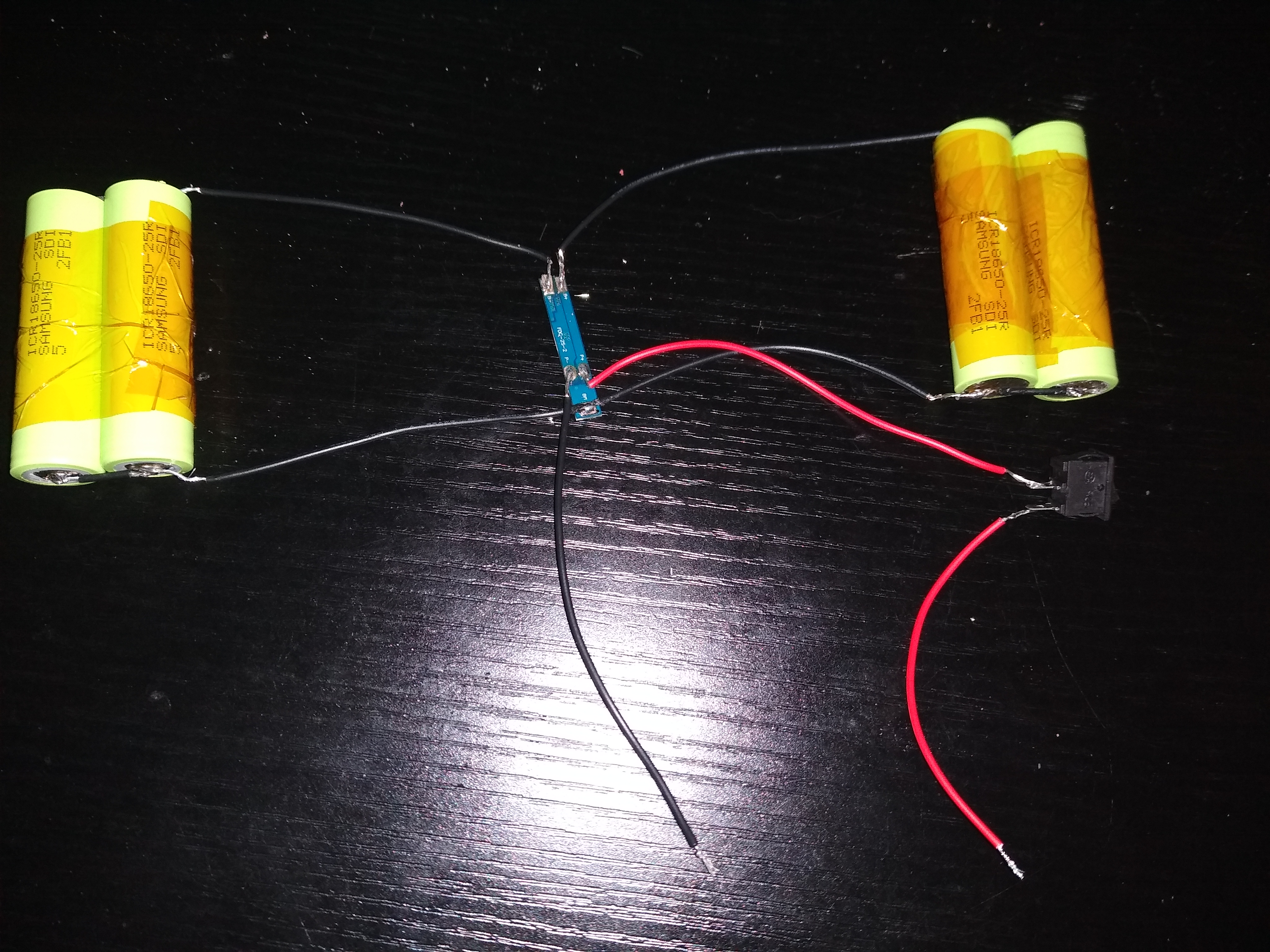

I'm completely stumped now. The black and red P+ and P- (in the picture below)go to where the yellow ps2 power port was, right?
https://drive.google.com/open?id=1gUQK-8d8MnLh3QtVx8OuWJe-zWsIVQZd
No, you need a power management unit. Battery voltages don't stay solid, they rise and fall depending on their charge. Those batteries fully charged will put out around 8.4v and as they drain they they'll drop to around 6.8v or lower.
I haven't trimmed a PS2 before but I'd dare say that after trimming you'll need multiple regulators with multiple voltages.

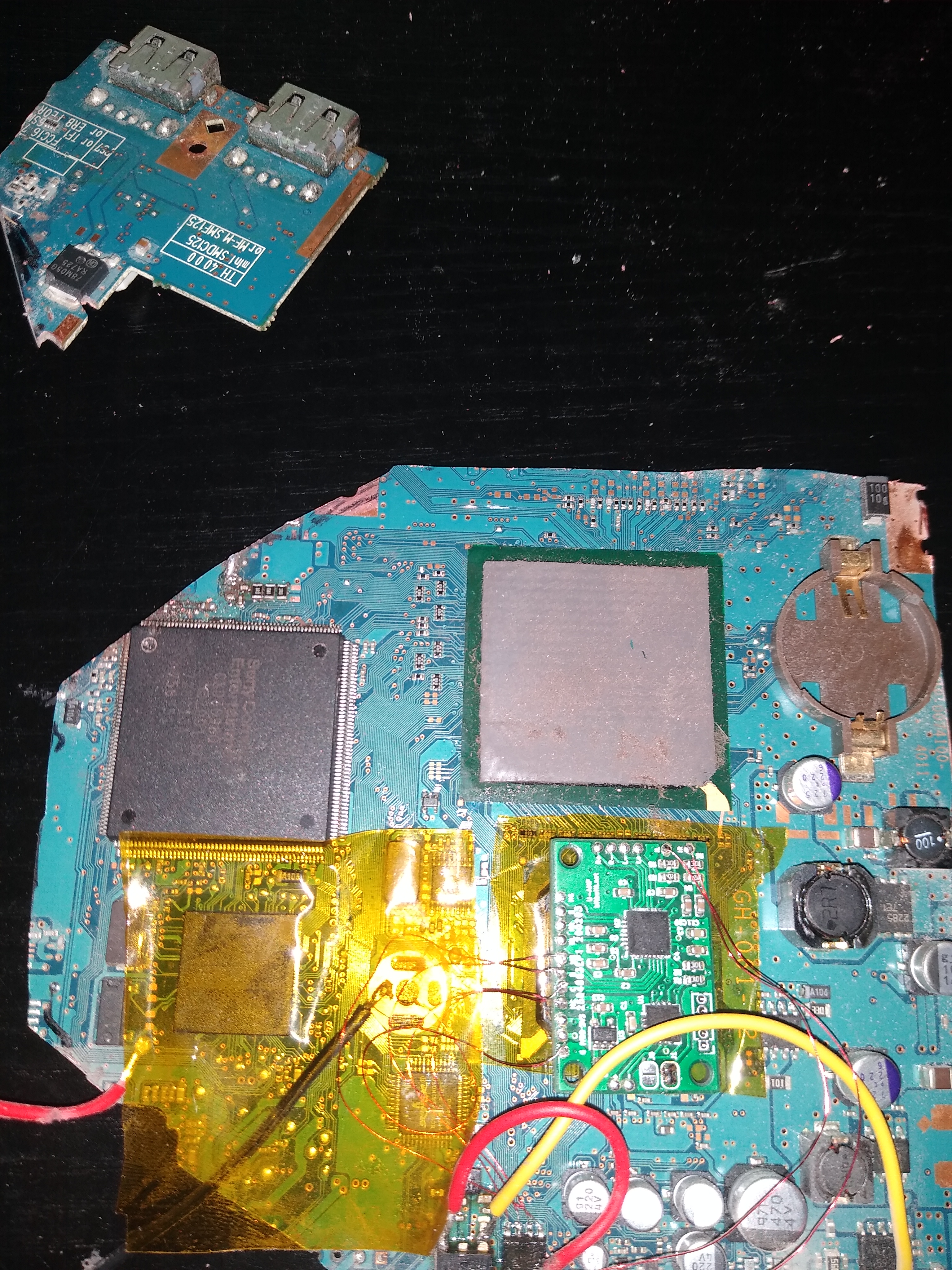

There's a 2s BMS (power management system) attached to them. I have them in 2s2p, and the ps2's motherboard is the standard trim, so i don't need custom regulators, i just don't know where on the board to solder the battery pack too
If you want to make a PS2 portable and be able to charge it, it's best not to put the ON/OFF switch there, since it will disconnect the battery from the whole device entirely.
And the battery pack needs to be connected here:
You need to read the guide to understand more about it.
