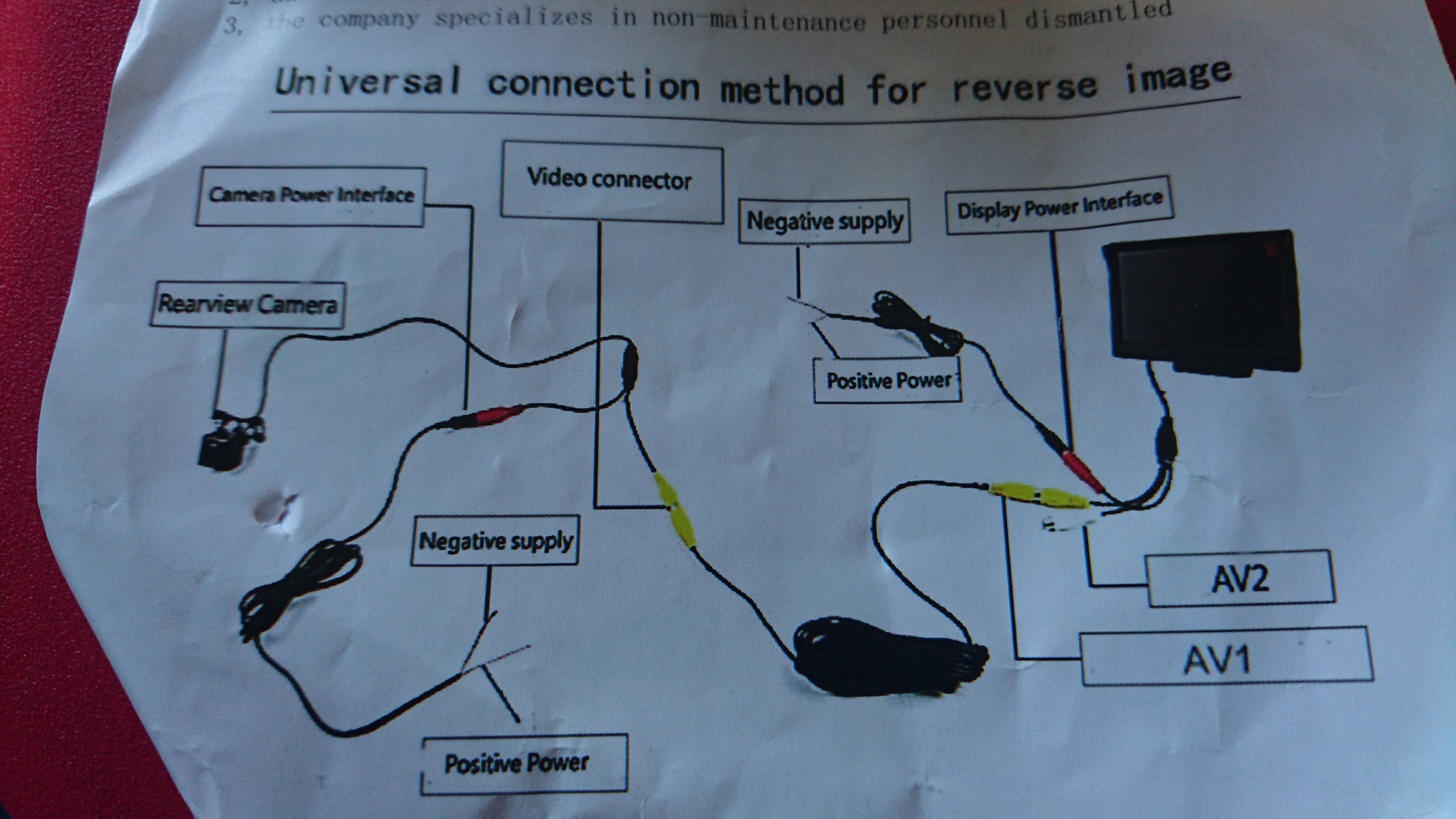

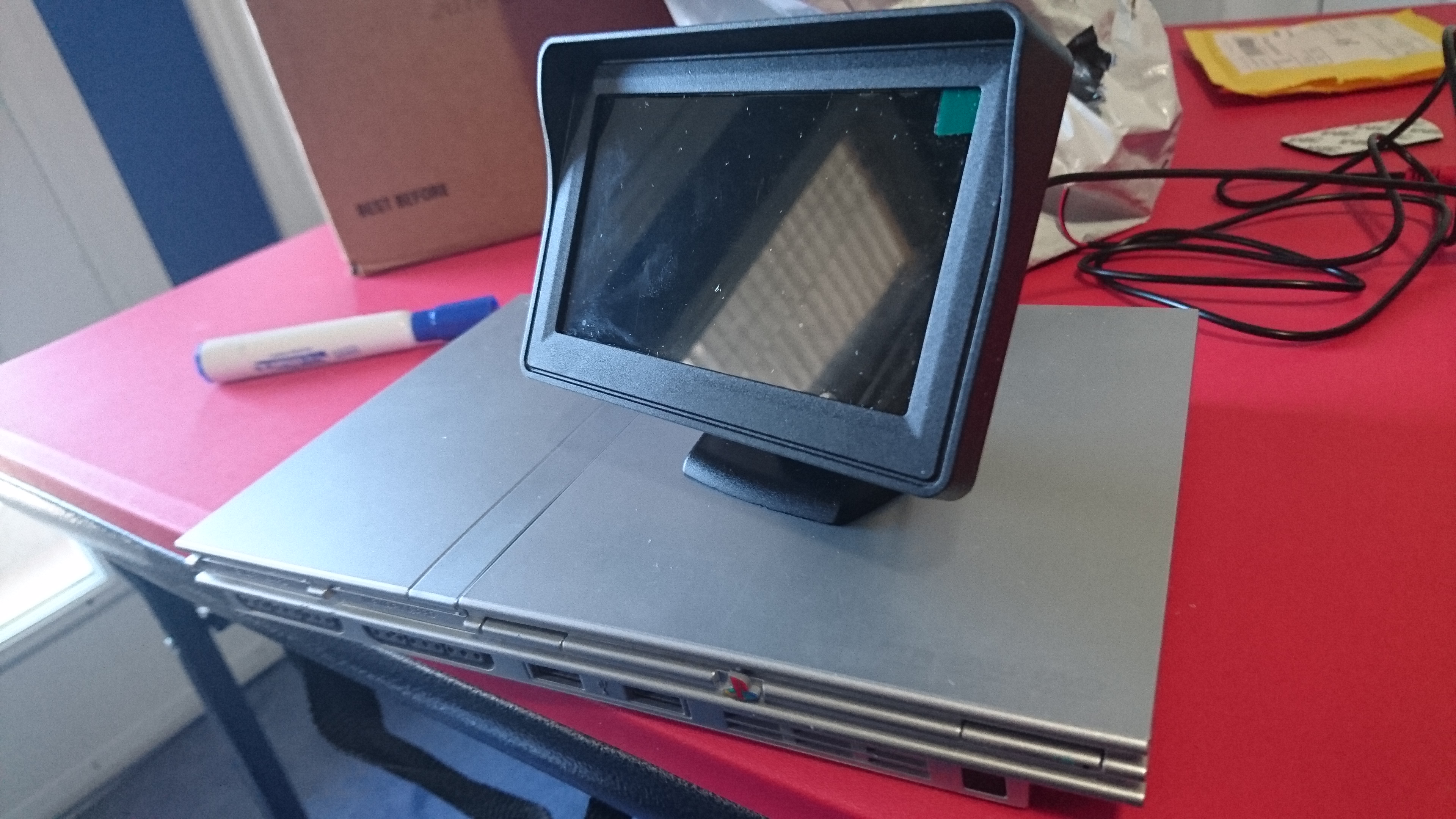

I figured I'd let you guys take a look at the LCD I got and maybe give me some pointers. How do I power this thing and how would I go about connecting it to my PS2?
The diagram shows a backup camera (it's meant for use in a car), so I guess just imagine the PS2 is there instead?
