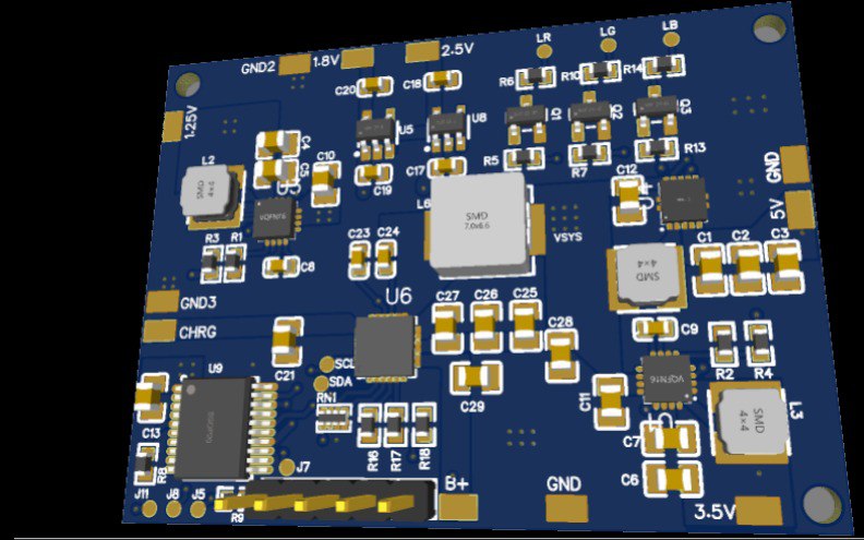

This regulator project is derived from the work of @Gman that he did for the Wii, I made some small modifications, it was in this project that I learned how to develop PCBs and a little bit of reverse engineering of PCBs, the project is tested and 100% functional, completely open source. It was my first PCB project and I never remember to post it here. Thank you @Gman for your beautiful work on these regulators, it was a great learning experience for me.
https://mega.nz/folder/eN9HFBDA#NfWZCeH6ELEEKPa8bG2ehA
new update: https://oshwlab.com/linkmarlonvrb/Reguladores-Personalizados

For anyone wondering, this is NOT the board mentioned in customledmods' "UPDATED ps2 21700 use these" post.
That board is found here, and is also designed by Mister M.
I noticed that the BOM from the updated link doesn't really have product codes and so is a bit harder to upload to sites like Mouser and Digikey.
Here's a copy of my list (hopefully all the parts are correct/suitable):
[Also note, apparently the TPS61232DRCR is a suitable replacement for the TPS61230DRCR, since Mouser was OoS when I ordered the parts]
I'll update if everything works once the parts arrive.

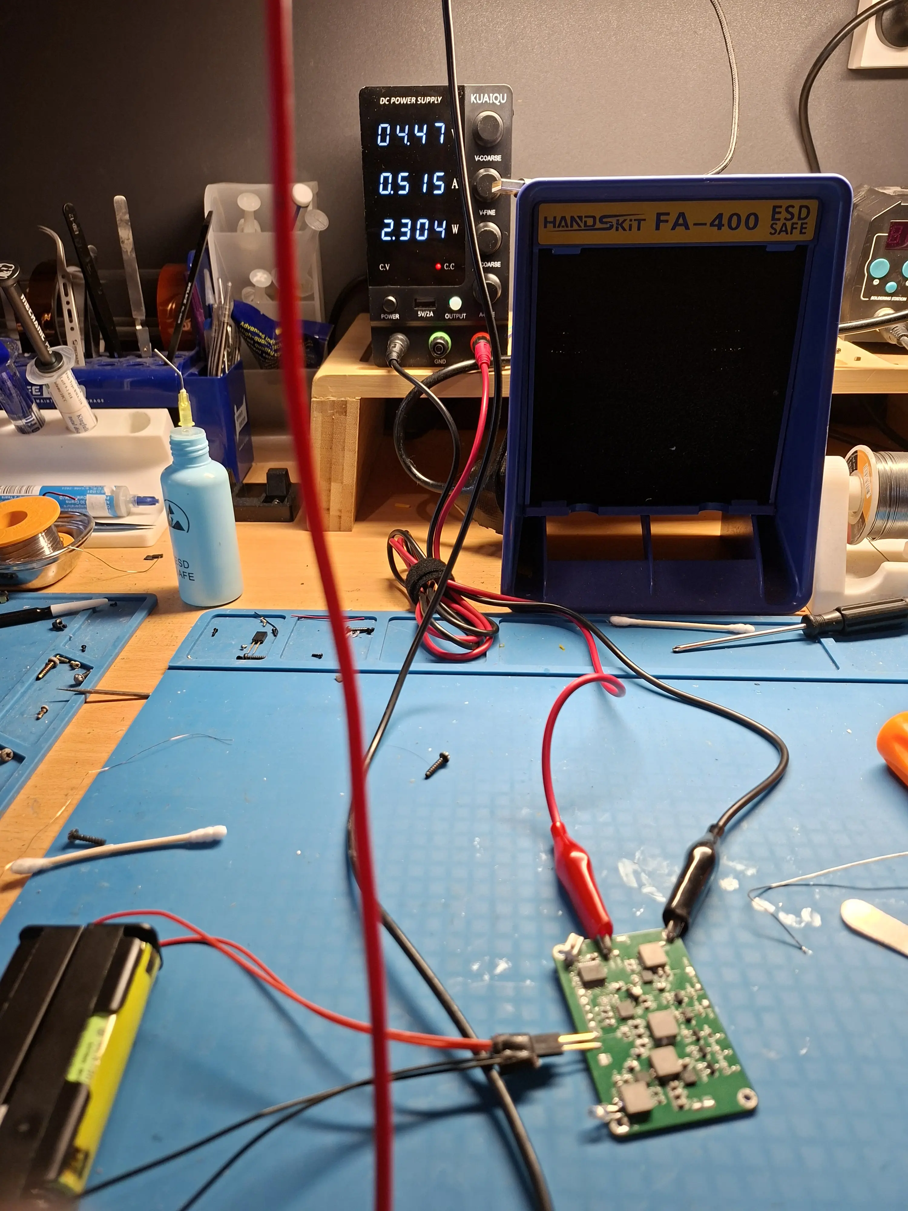

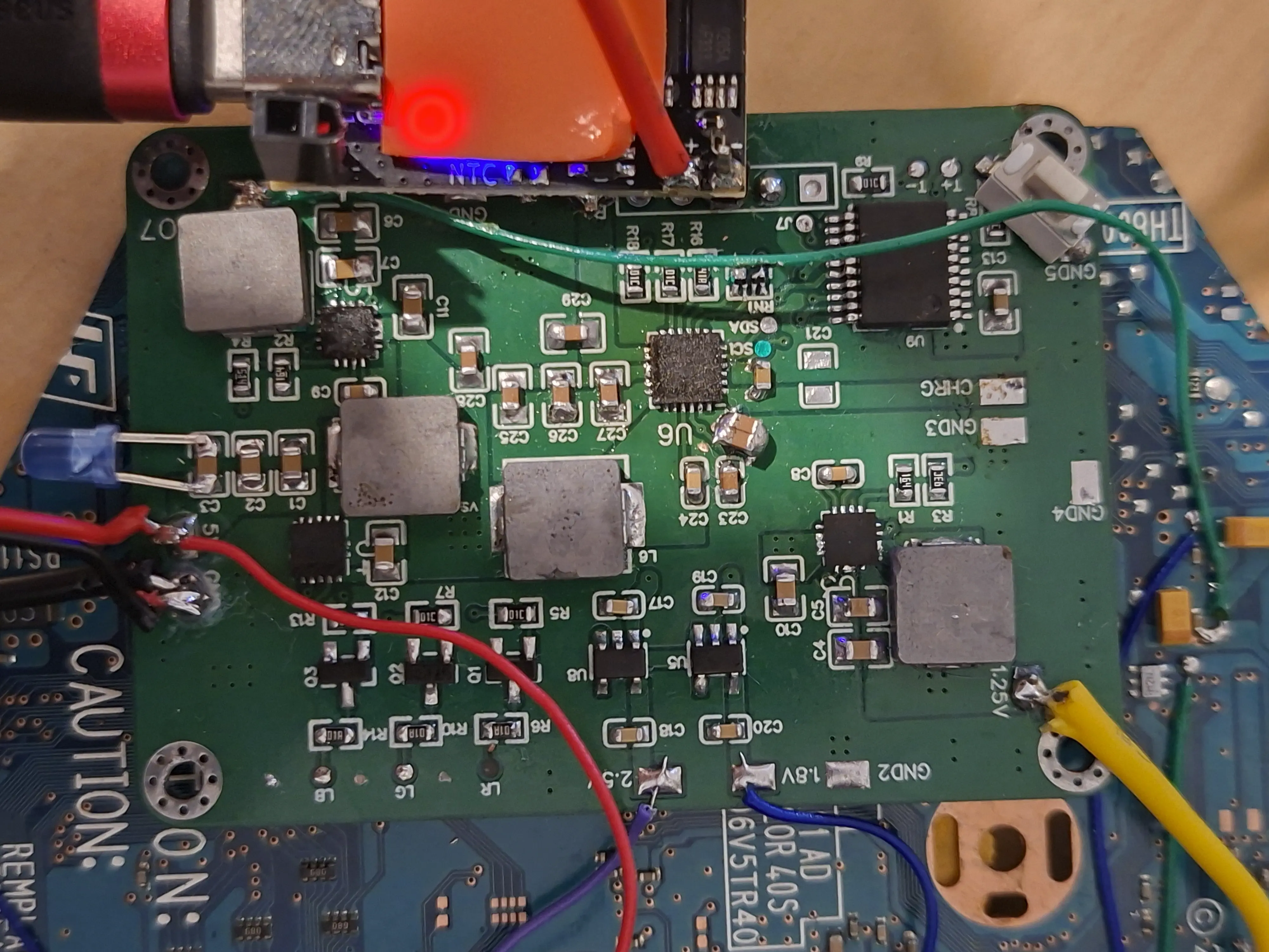

Just as a note to anyone who wants to use this board for their builds, there's a small issue and a rather problematic one.
The PMID (pin 23) is grounded in this board, which will cause a short circuit when attempting to charge the batteries via the board.​
It should instead have a separate section with a capacitor bank (according to the datasheet).​
The other thing is that the BQ IC PGND plane is a little too large and can easily cause shorts.​
I ended up applying a 'windowpane' of solder mask to reduce the overall size.​
I couldn't get charging to work even after making the necessary adjustments, so that's a shame, but in terms of providing power and correct voltages, this board works great. I just used an external 'charge and play' board from Aliexpress to manage the batteries for me.
Some potential improvements/notes:
  • The PIC chip needs to be programmed before populating the board. I'd recommend doing this first (I used a Pickit3)
  • The 'button' pad is actually to turn on the board and provide power to the PS2, not to power on/reset the console itself.
  • The three small pads (labelled LR,LG, and LG) are seemingly for LED colours (to show charging etc), but I could not get these to work (maybe because the charging circuit wasn't working? Also not sure if anode or cathode)
  • Pin headers (for PIC programming) are standard arrangement, but not labelled
  • Some of the component labels and alignment circles for the ICs were were a bit hard to read.

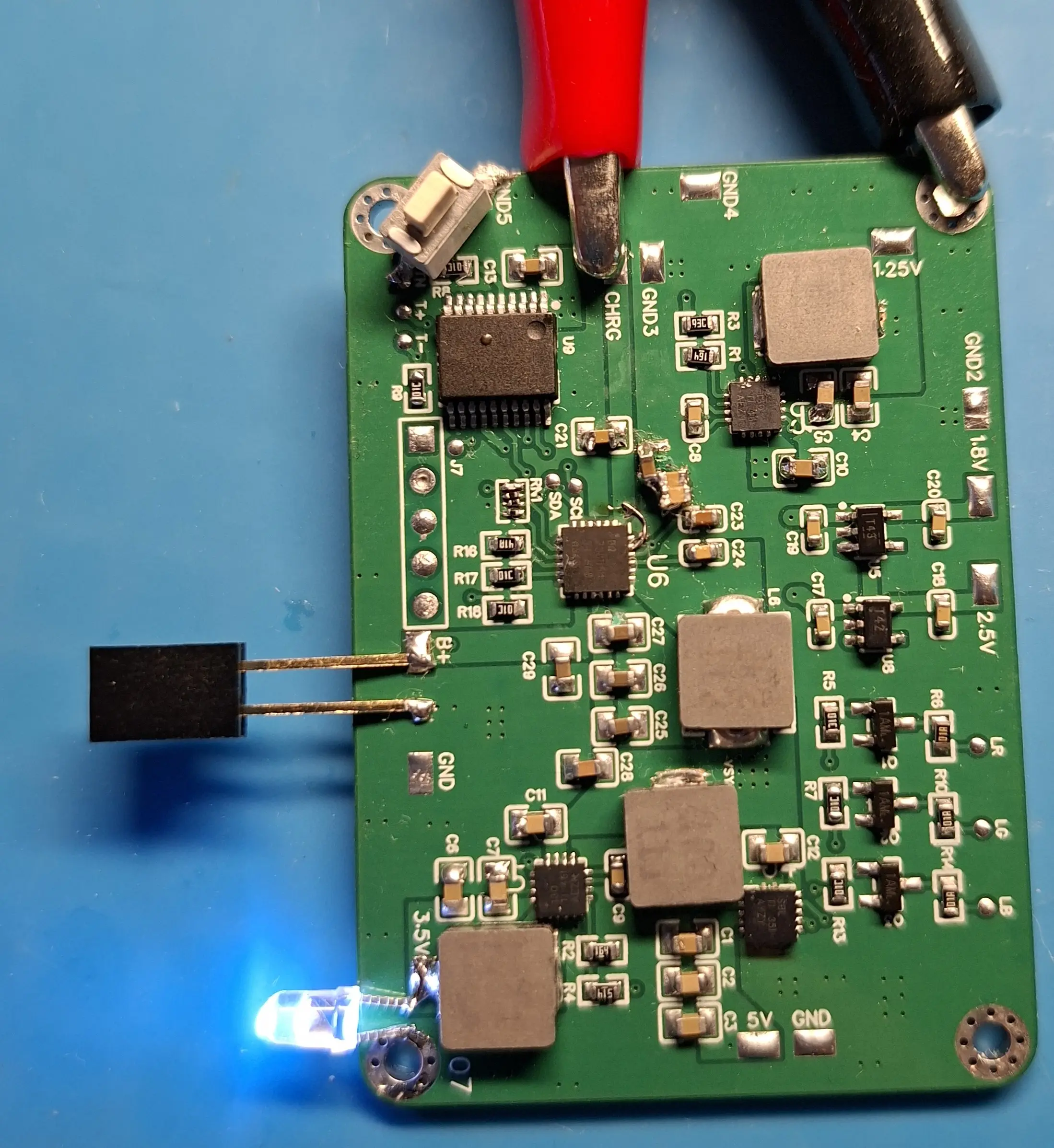

Additional notes from my experience:
  • I added an LED to the 5V capacitors to give a power indicator light during testing. Having a convenient pad or similar would be very useful.
  • I accidentally used the wrong size 1R0 inductors and had to grind the plane to mount them. Not a big deal, but maybe both sizes could be accounted for?
  • C21 should be as close to IC as possible according to datasheet, so I moved it closer when trying to get charging working
  • 'button' pad didn't have a convenient ground pad nearby
  • I ordered the wrong resistor array (x8 instead of x4), but individual 0201 resistors worked fine
Thanks Mister M for creating and sharing your board!

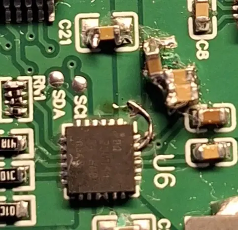

Great news!There is a fix for the charging issue.
If you order the board as-is, you will need to grind away the PMID <> PGND connection, and also grind away the common GND connection (leave space though!)
Then you can add in a capacitor bank to the PMID 'island' to common GND (minimum 47uf).
The image below showed PMID (pin 23) connected directly to VBUS (pin 1), but this was not required.
You can see that the 3v3 line has power from the LED glowing and I check all other voltages and they are outputting as if the battery was connected. This is direct power from my bench supply. The capacitor bank is 4x 22uF and 2x 10uF since I didn't have anything else on hand, but it should be sufficient (minimum recommended is 40uF [47uF] for standard charging)
I drained the battery voltage down to ~3.85v and got the board to charge!

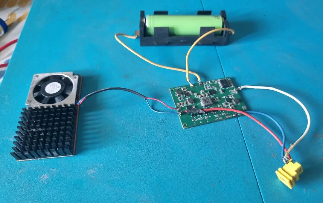

Do I need to have 2 batteries connected in parallel?
I only connected one as show in pic
The small fan is not even spinning and it's connected to 5v.
I even used multitester, and it doesn't even output 5v.
One battery should be fine, but parallel is the way to go.
Have you programmed the PIC?
If so, make sure you short the battery pad to ground, which will tell the PIC to enable voltage output.
