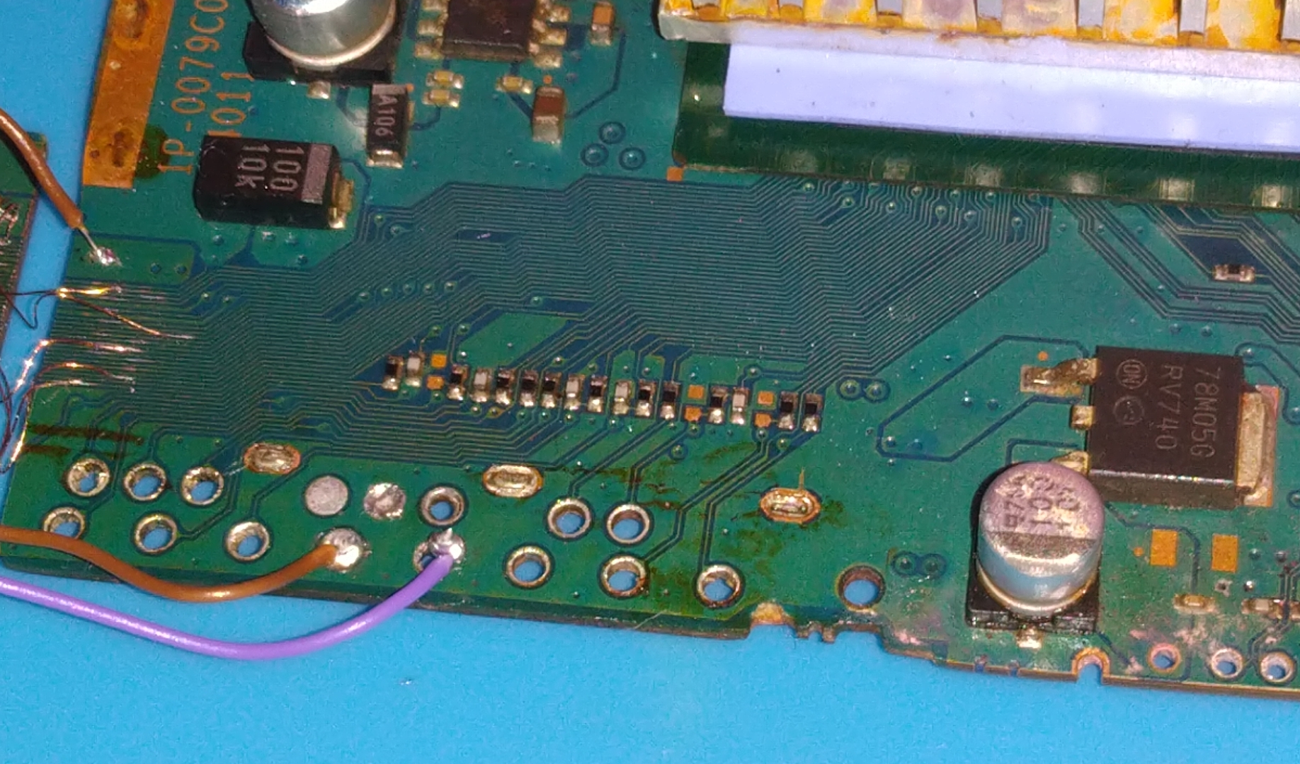

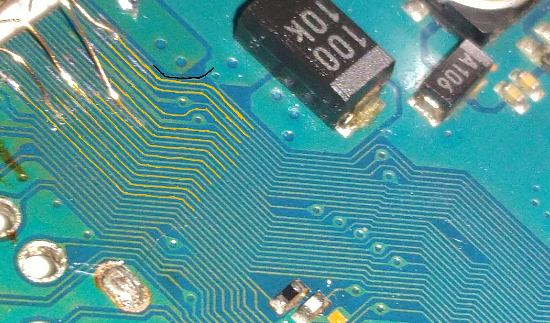

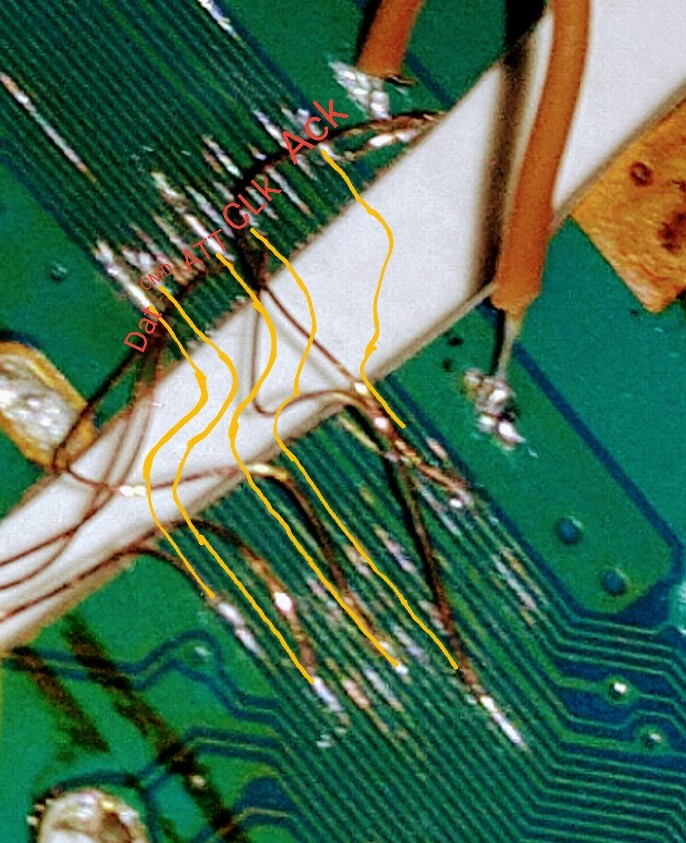

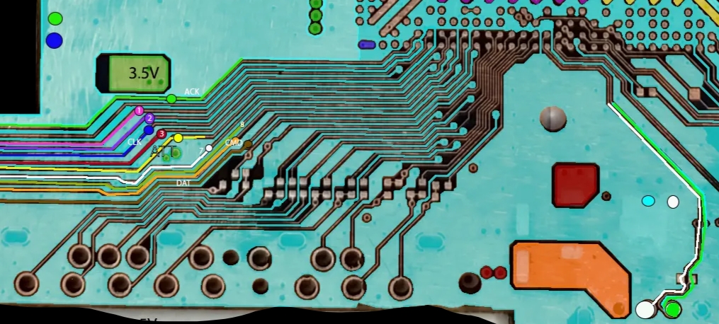

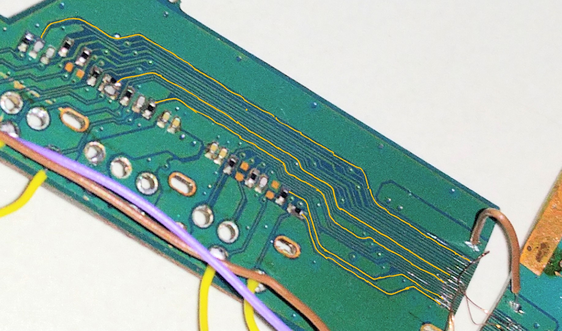

Try to relocate ps2 controller port 1
Ack, clk , att ,cmd ,dat
GND and 3v i take from controller port 2
And when turn ps2 on the controller not functioning already check each point and solder was fine but still not working ..
The routing channel has no error but the controller can't be used.
Did you wire only controller? I have done this before when I only solder joysticks with not memory card the controller is not functioning but when i solder both its ok try solder both controller and memory card
