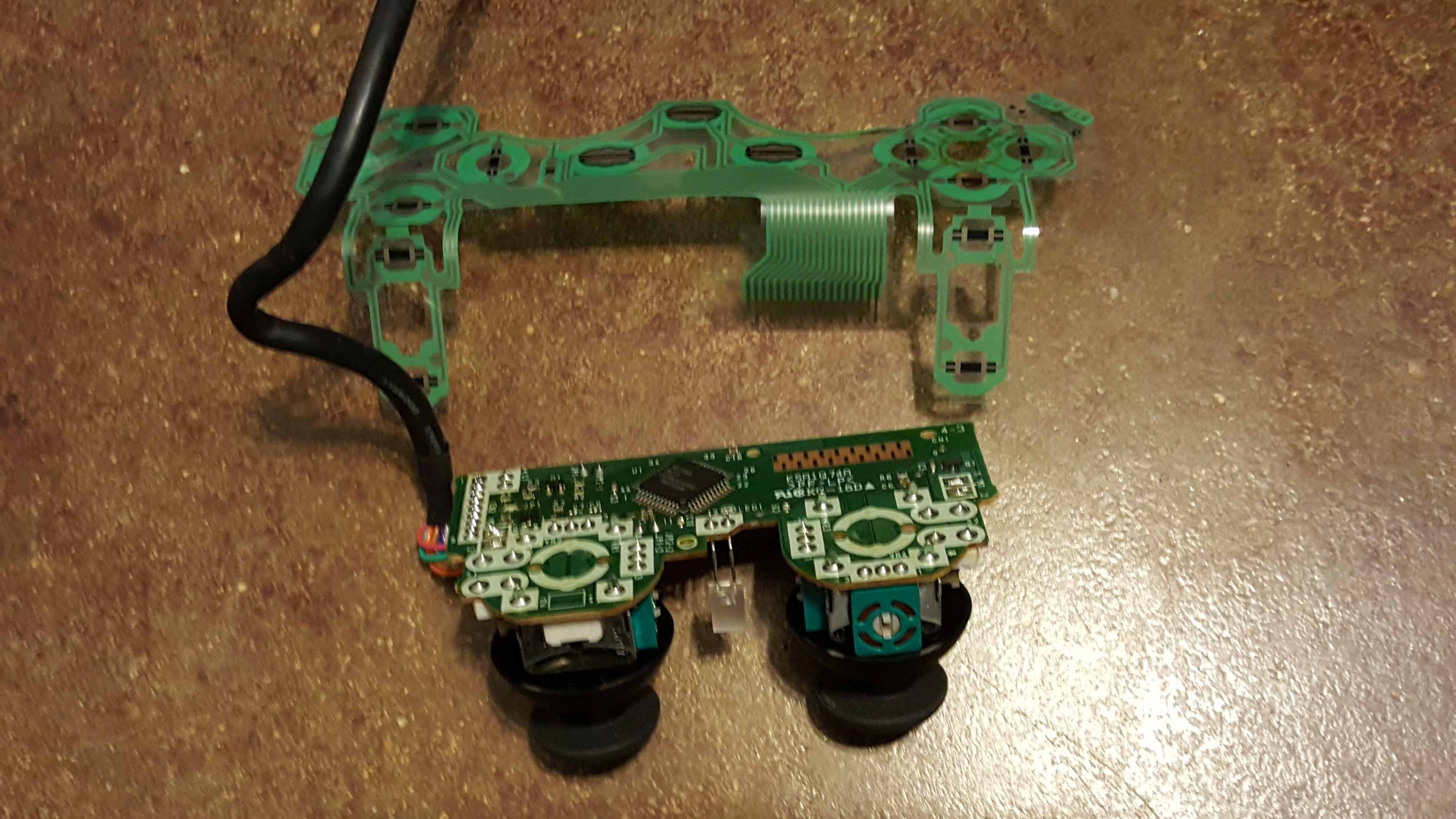

And the insides:
The reason the select button didn't work was that the entire board ended up being slanted in order to fit the d-pad underneath it. Because of this, the square button was sunk low, the start button had to be pushed fairly deep down, and select couldn't be used at all. The analog button functionality was removed in order to fit all the wires from the d-pad in.
To start with, I decided I needed to slice the board one more time in order to have the x/o/tri/sqr buttons all level.
I cut it up, attached wires to the points I needed, and put epoxy on them. Here they are drying. You can also see the controller shell with Bondo Glazing and Spot Putty drying in the background. The d-pad isn't wired up yet because my dremel needed to charge.

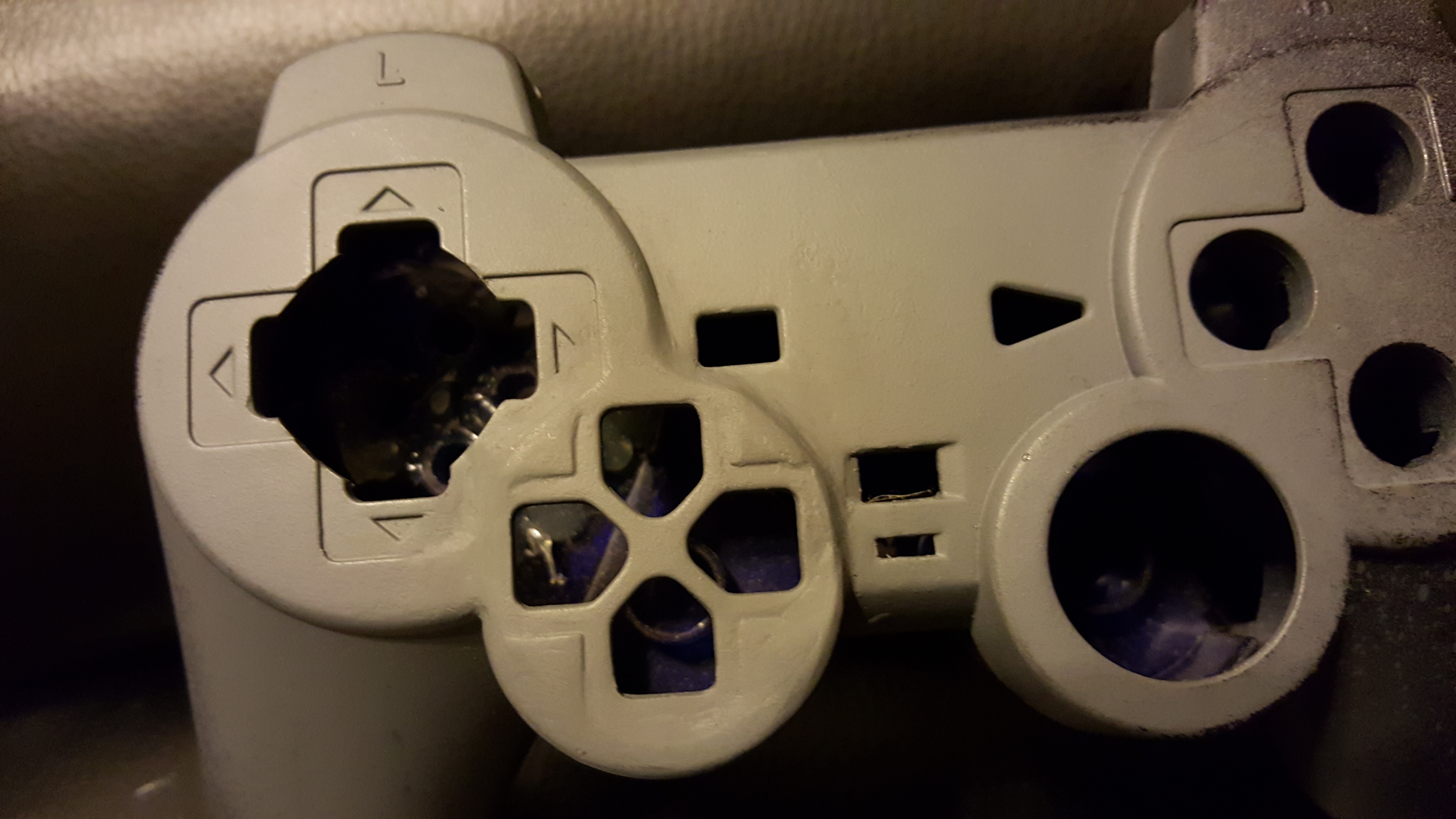

I Bondo-ed the case and put primer on it so I could see any imperfections. There are one or two spots that could use a little work, but overall it's not bad.
I'm out of primer as well, so this project won't be finished until I can get that and the paints for the airbrush. (And until the weather isn't raining anymore).

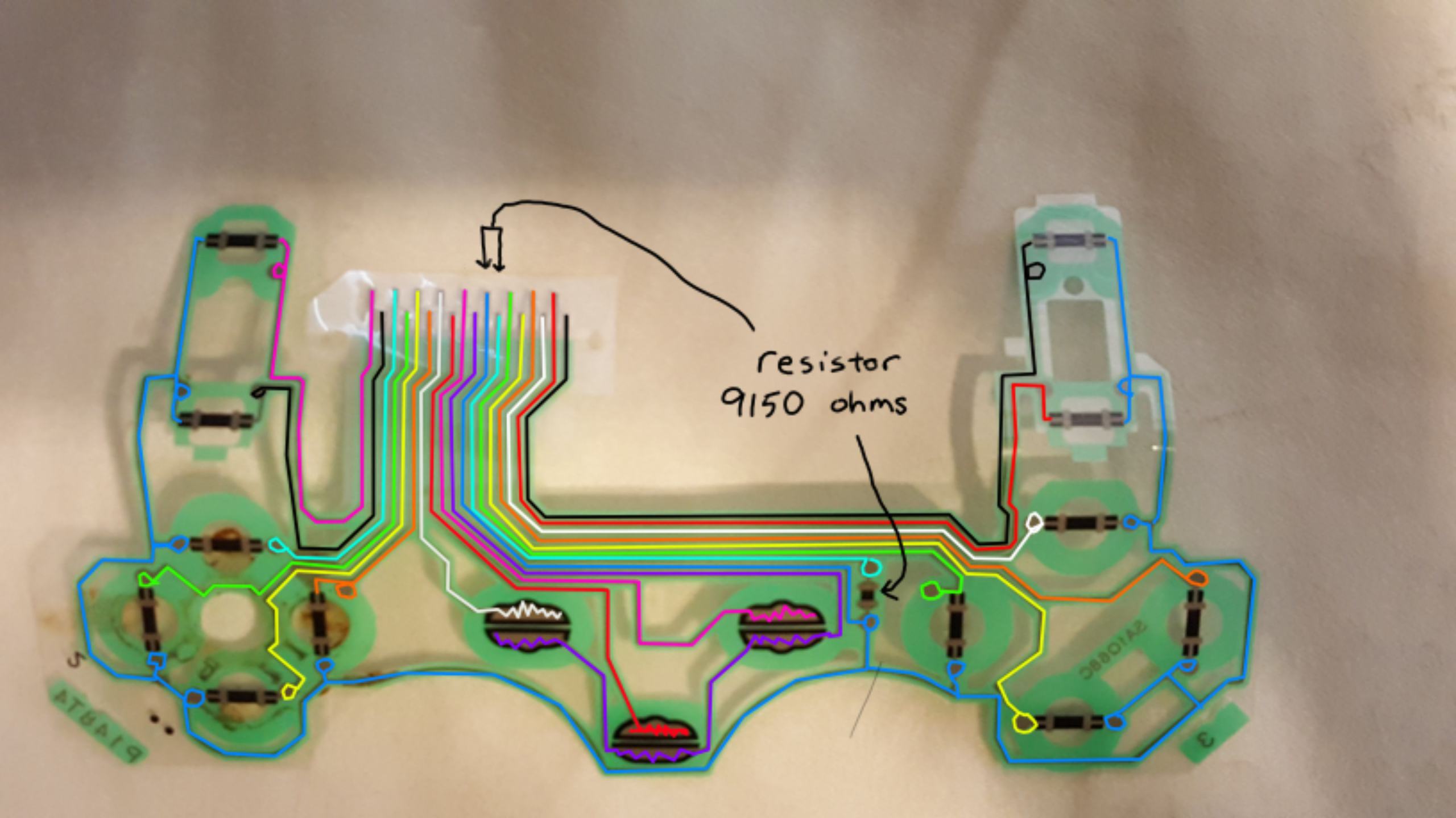

Okay, so I got my new ps2 controller today. I plugged it in, and it works. So I open it up and remove the plastic conducive film (no desoldering needed this time) and guess what? The controller scrolls up! So apparently it won't work without the film attached or something bridged.

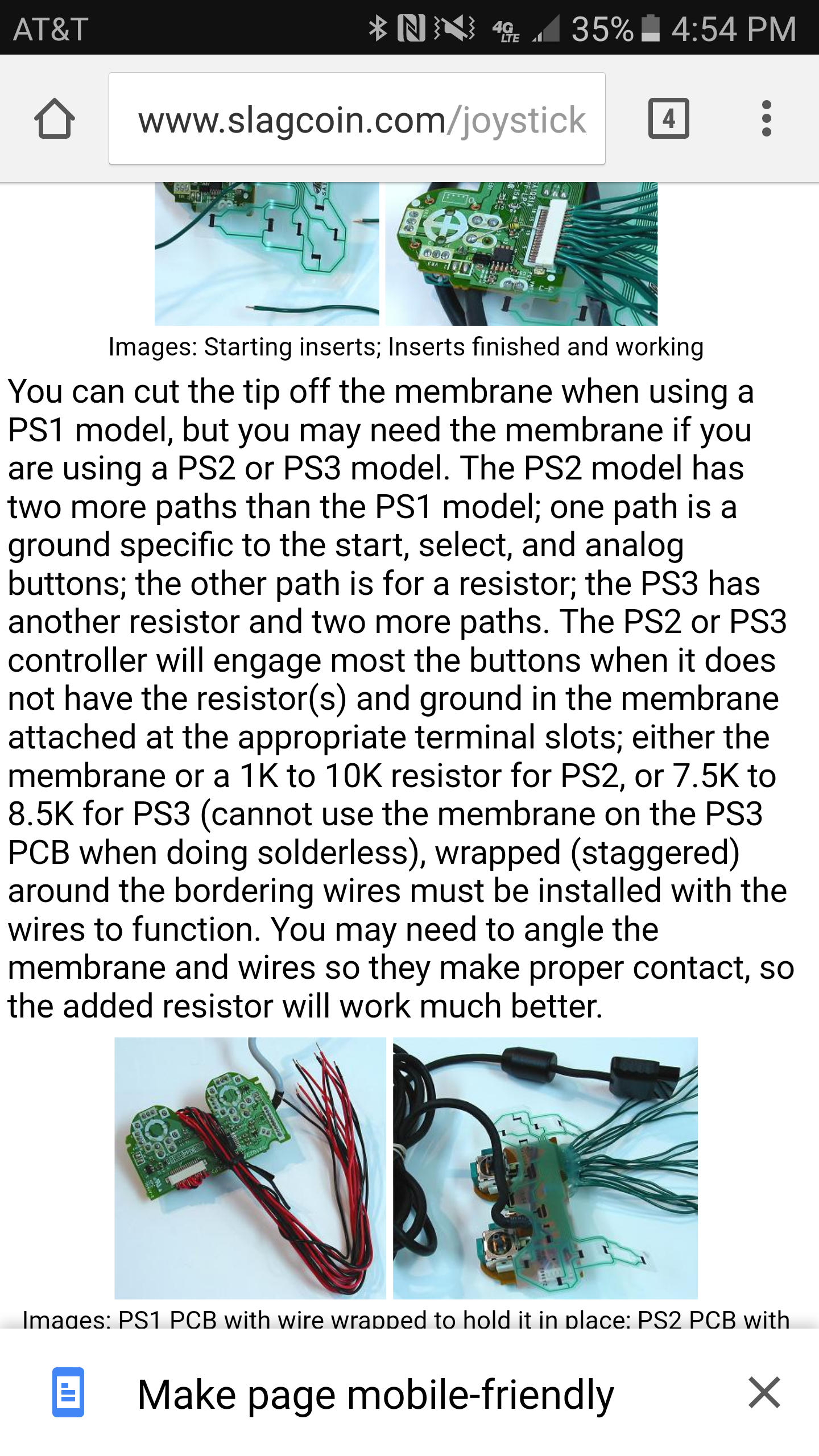

Here is the film I mean. I will look at it more closely, trace it, and see if it actually DOES something when the buttons aren't pressed. It must do something in order for the controller to know whether it's attached.
I tried looking it up, but no dice. If anyone has experience with this, that would be great :). If not, I'll keep messing with it and update if I figure out anything or give up.
I may have figured it out and will test soon. I traced out all the traces on the ribbon and none of them appeared to connect either visually or with a multimeter. But I noticed this little thing that wasn't a button and figured it might be a resistor.
Ta Da! It was a resistor. It measures about 9k ohms. Just to be sure, I rechecked everything else. At about 25k ohms, the other pins will connect, but I believe that those are due to forcing the electricity through the black pads, not because they are really connected. Of course, after figuring it all out, I found this.
This would explain why buttons kept getting hit when the ribbon cable wasn't connected. It also doesn't mention the other buttons being connected, so I think it's safe to say that they work just like gc buttons.
I'll wire up a resistor to the pcb and see if that fixes it. Hopefully it will and then I can use either this controller or the one that was scrolling since I now know what it was :D more to come soon.
The buttons (eg X, O, etc) on the PS2 and above (maybe ps1 as well, not sure about that) are actually analog, so it's probably just confused why it's not seeing any analog values.

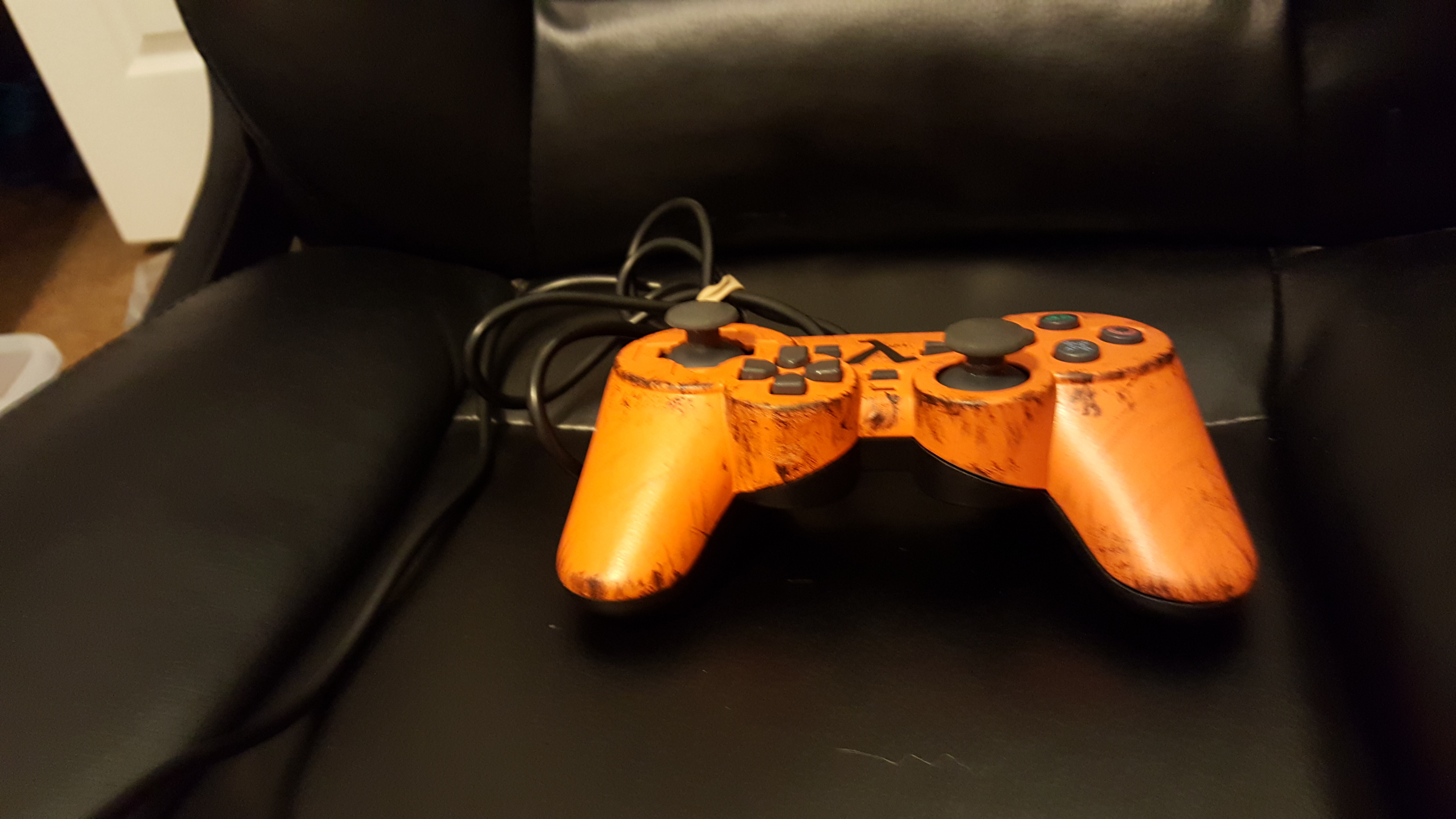

Almost done with this! It's been a long time coming, but I've been through a lot trying to perfect this lol. I just haven't been updating this worklog every time I screw up another controller or am not happy with the results. I'm making this for me to use as my main/only ps2 controller so I want (need) it to be perfect.

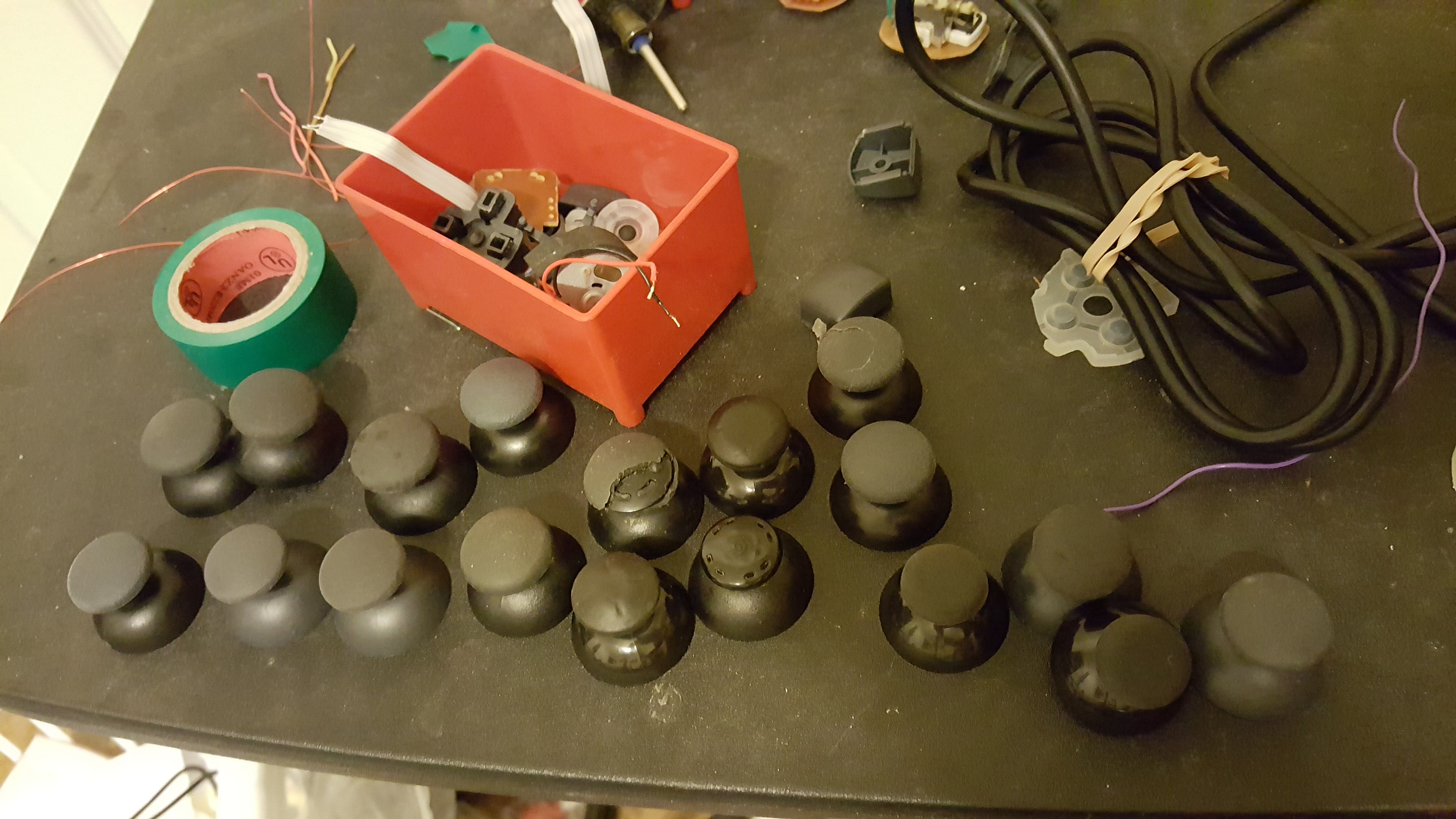

I got 99 caps but a matching set ain't one. I really don't have two caps that fit, match, and are in good shape for this controller. I'm about an inch away from buying a new one just so they aren't asymmetrical.

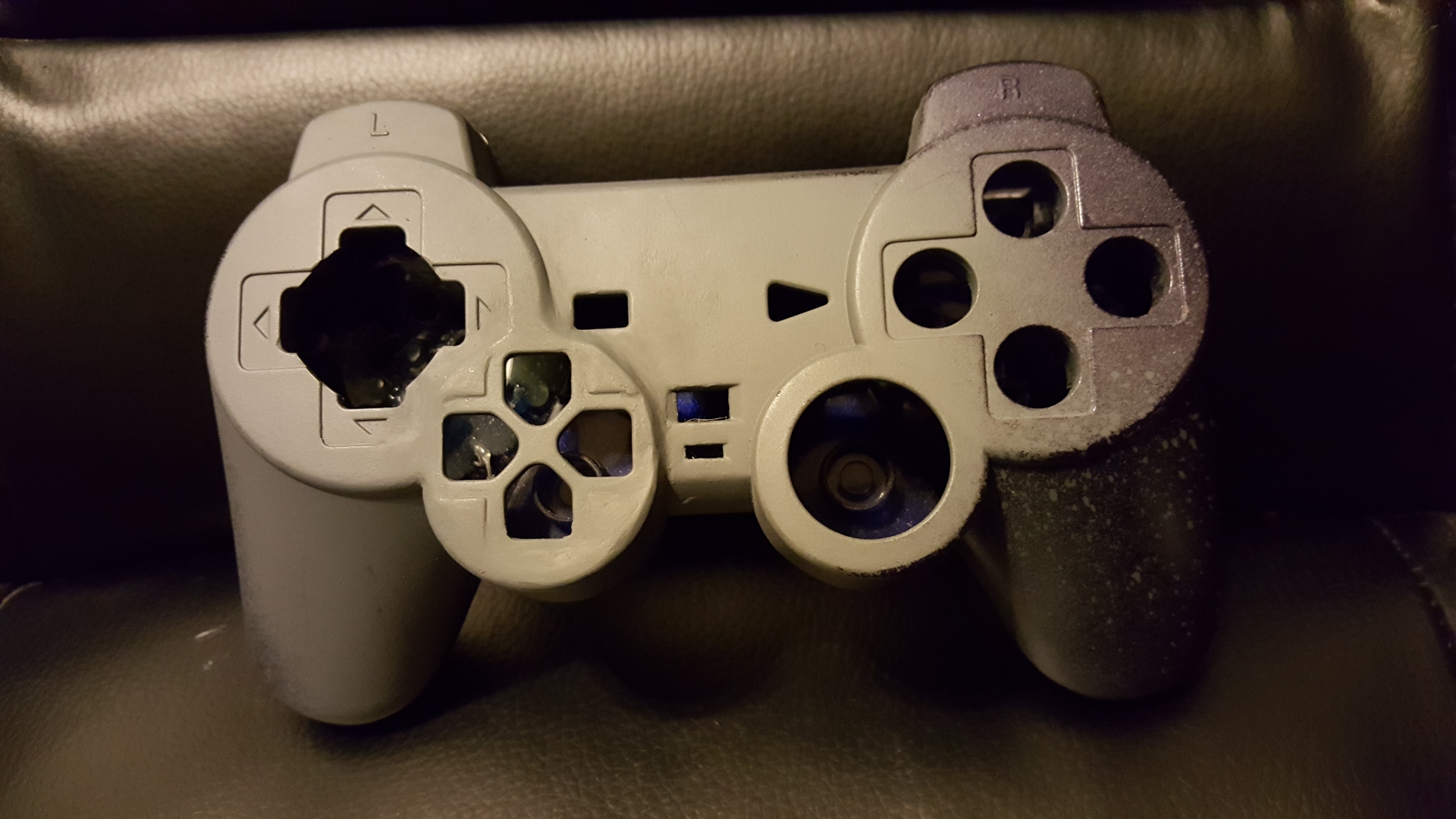

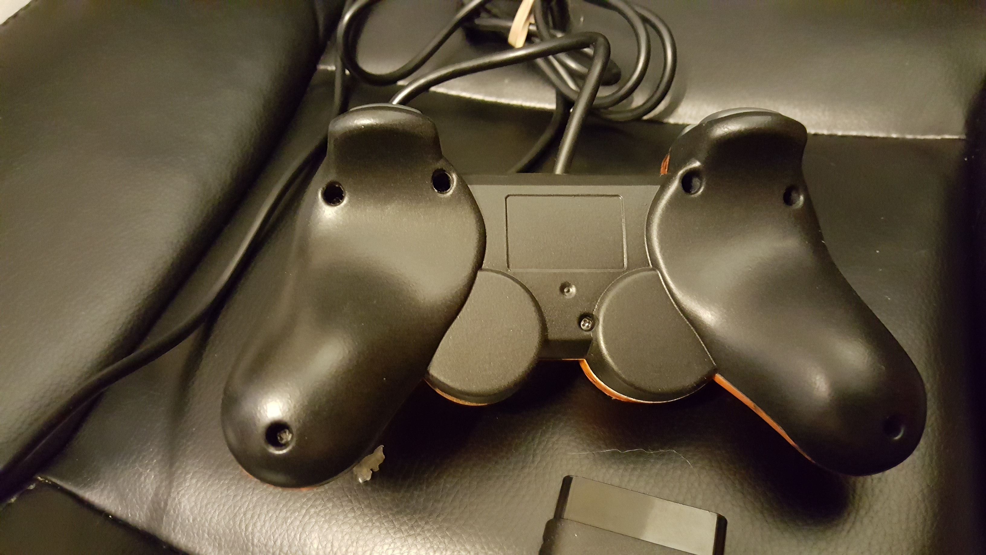

The frankencasing is done. I tried my best to make it look like it was made that way. I'm going to paint it tomorrow and assemble it and then I'll be done :) Fingers crossed for the paintjob to be cool!

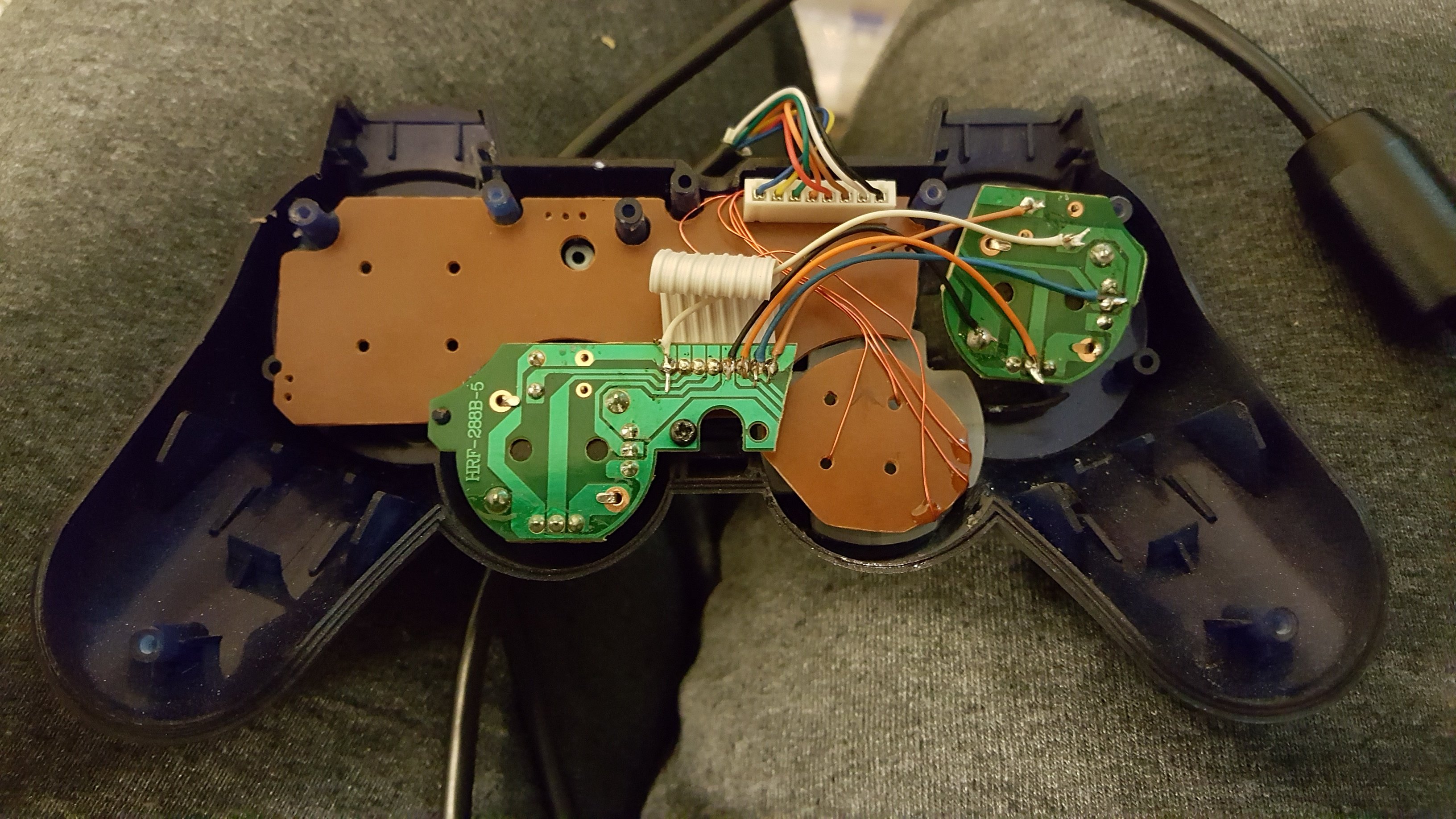

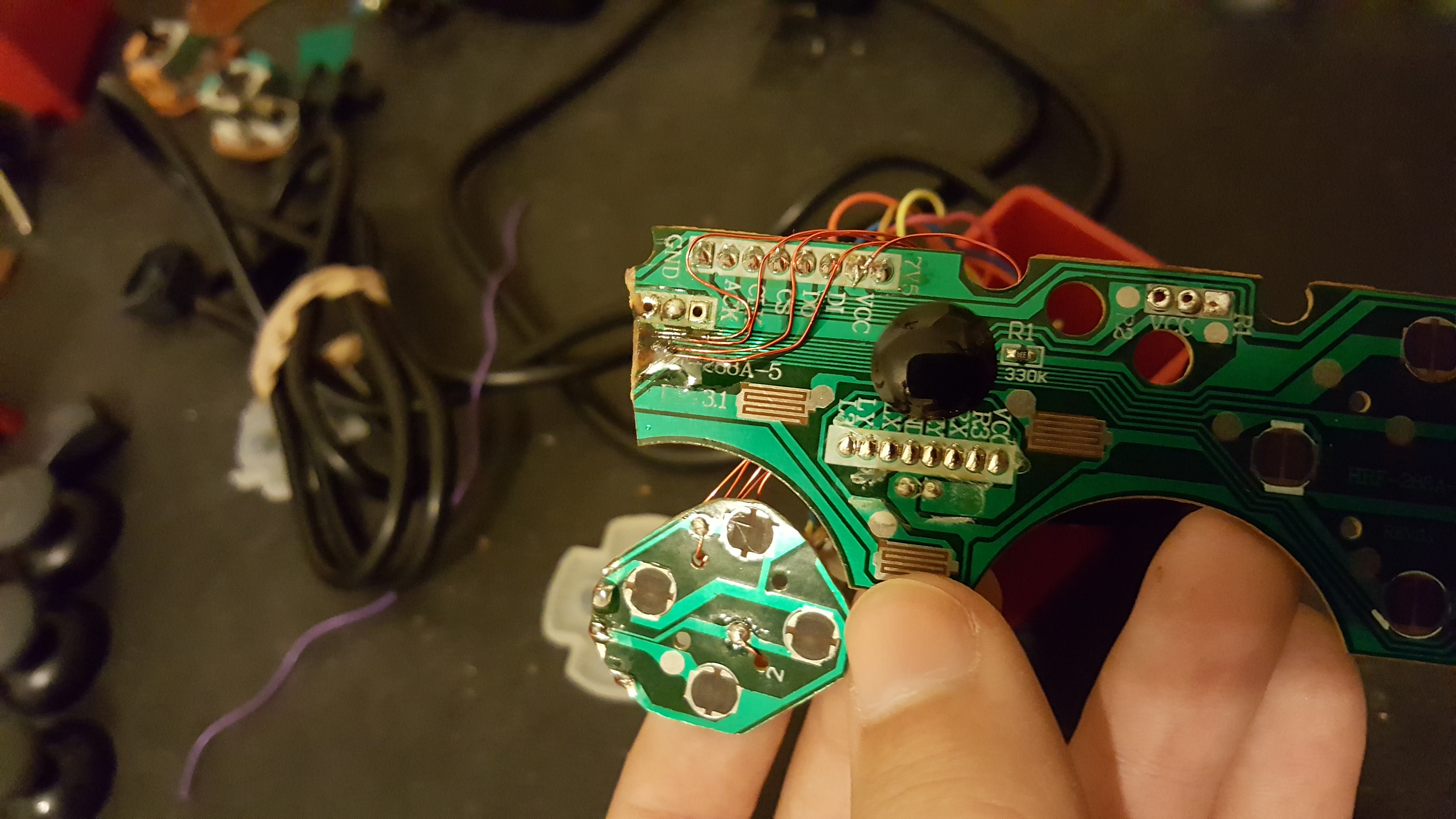

This time I used 28 gauge magnet wire to wire up the dpad, and have it flipped upside down. So what was the down button is now the up button. That size magnet wire is confirmed to work for this and is significantly better than the regular wires I was using. This way, I can have the wires coming out from the bottom of the dpad, fold over the back of it, go over the back of the main board, wrap around the top, and then come down to the pins from the inside.
This solves the issue of wires getting too close to the joystick, causing it to not have full range. It also means that I can use the original start, select, and analog buttons so I don't have to put tact switches in after all. I put epoxy on the dpad pins so they're drying overnight, but I want to replace the joystick wires because the ones I used feel unusually flimsy. But right now everything works perfectly and fits in the case nicely. More to come soon!
Edit: The epoxy is dry and I rewired the L1/L2 buttons since they got cut off from the VCC line by removing the dpad. I replaced the crummy wires for the left joystick with nicer ones, and also made them shorter so it's a neater fit. Everything is looking good :)

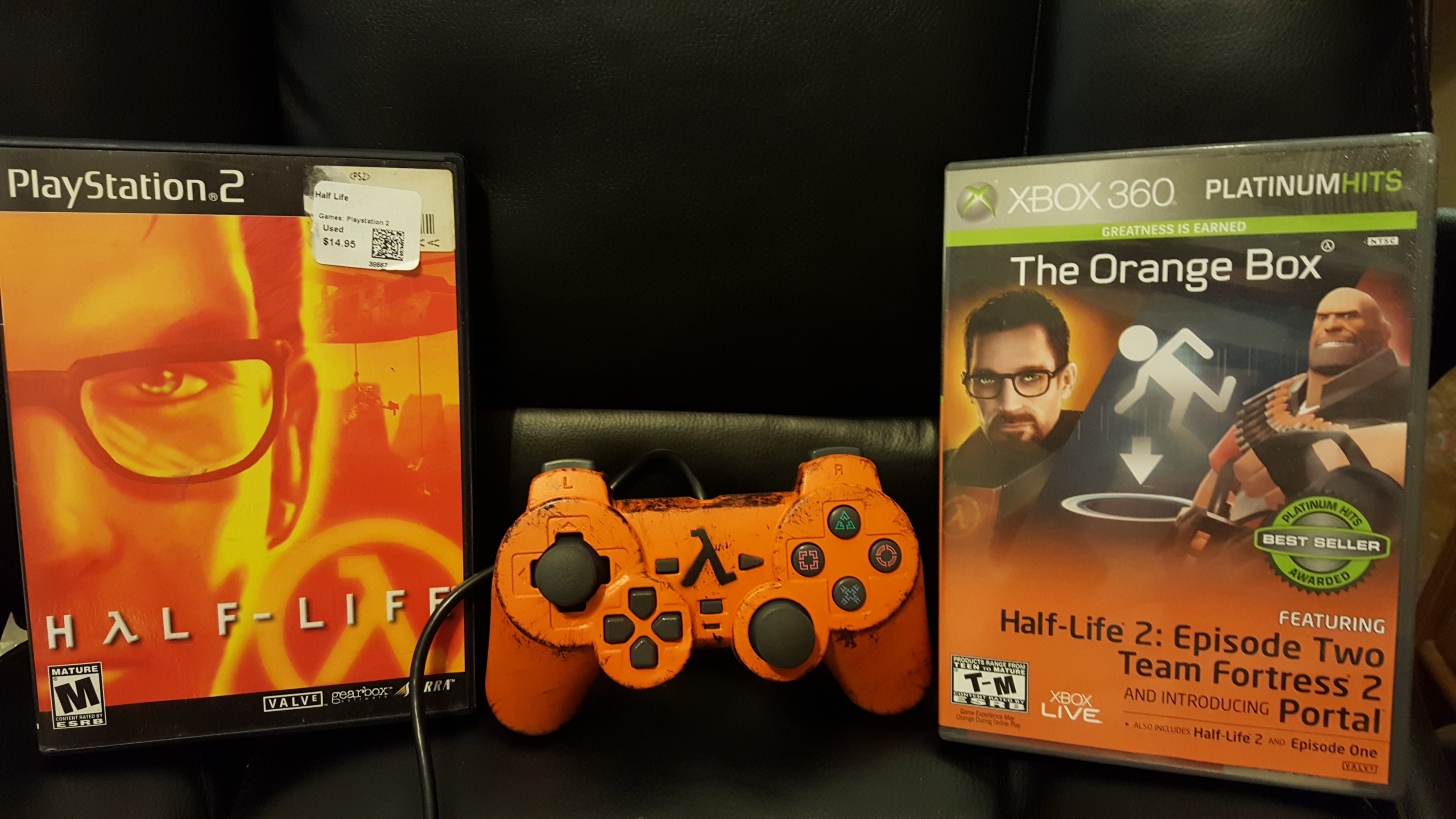

Here it is all done! It's comfortable and fully functional. I'm reasonably happy with the paint job, although I think I will do another one of these later on that is purtier. Now that I know the best way to do this, it shouldn't take long to do another.
Dayum! That weathered look is nice! A shame PS2 only got one of the Half-Life games.
