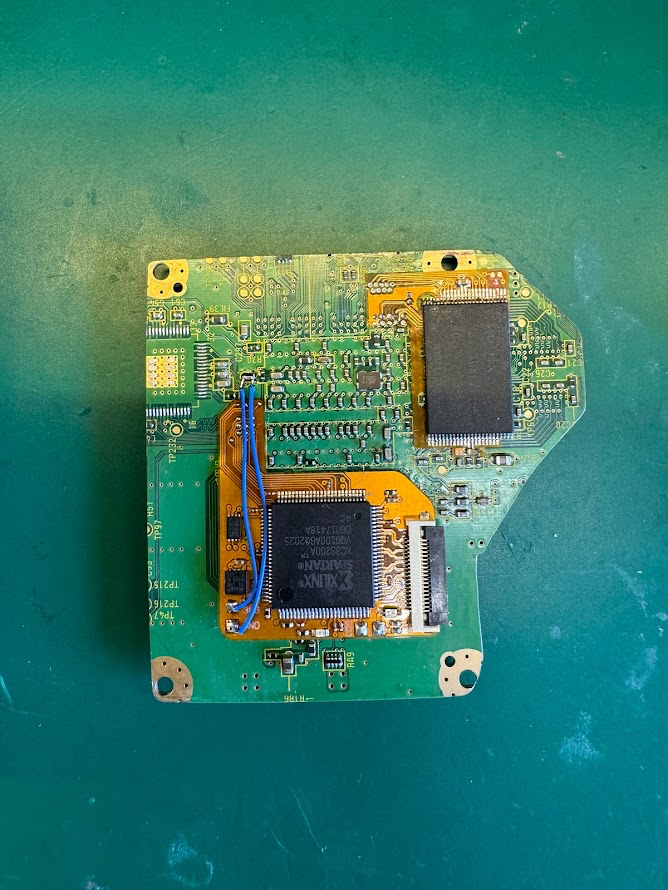

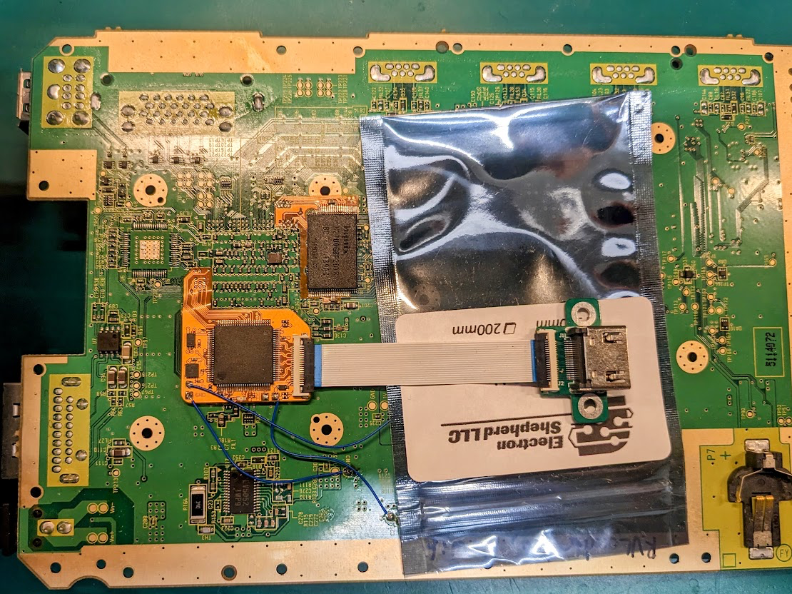

Before trimming I did the the “wireless” U10 relocation, NAND relocation, and AVE-HDMI installation and verified everything still worked, and then it was Dremel Time™.
Given my requirement for robustness, I really wanted to keep the Wii motherboard mounting holes so my trim was more like an Omega Max.

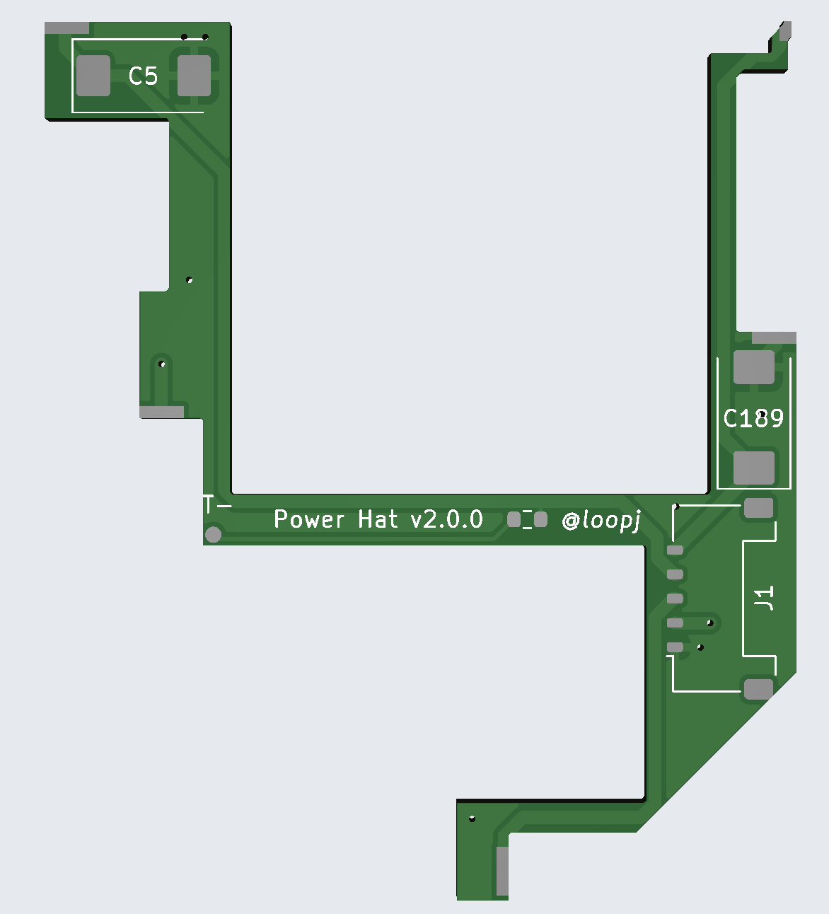

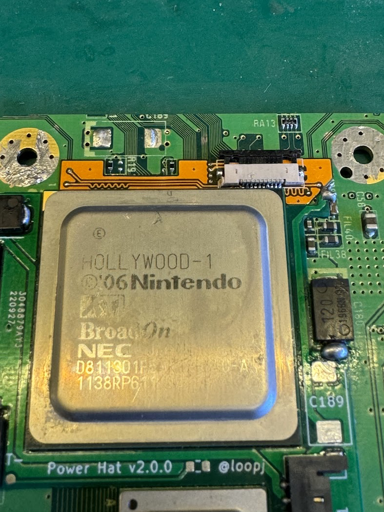

The first board is what I’m calling the “Power Strip” PCB. This mounts to the top of the Wii motherboard, and does the following
  • Delivers 1V, 1.15V, 1.8V and 3.3V to the motherboard
  • Allows for easy relocation of capacitors
  • Adds a low-profile connector for connecting/disconnecting to the power supply board
It was a real pain in the ass getting this shape just right, I 3d-printed about 15 iterations of the board outline before finding the right fit.

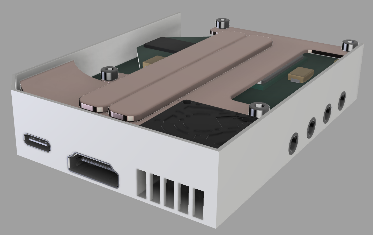

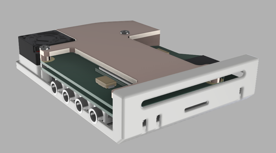

Case design
During the design process, one of the candidate layouts accidentally had a very familiar shape - similar to the original Wii - so I decided to go all in and try to make a “Wii classic” style case design and thermal layout.
Designing this case was an absolute obsession. I wanted to ensure that it was as small as possible (~40% scale, same size as a deck of cards) without sacrificing any of the aesthetics of the original Wii. I wanted the connectors and airflow vents to be in the same locations as on the original, the microSD card slot to be where the SD card slot is on the original, and wanted to leave the top of the Wii completely clean (no holes).
The thermal design was also a big challenge - and is currently untested. I found a tiny 20x20x8mm blower fan which puts out a decent 0.84CFM at 5V - it might just do the job.

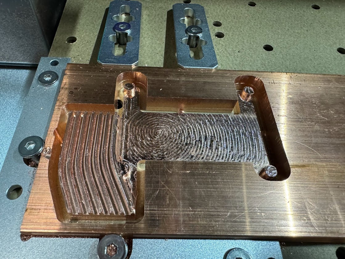

I also decided to try my hand at milling my own heat plate and heatsink, since I wanted an excuse to learn how to use my new desktop CNC.
I have so far avoided making any flaps/panels to cover the Gamecube ports or the SD card, since it is challenging to make these in such a small space. Wesk had the great suggestion to try a print-in-place or magnet attached approach, so I might try this in a future iteration.

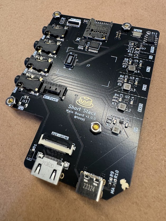

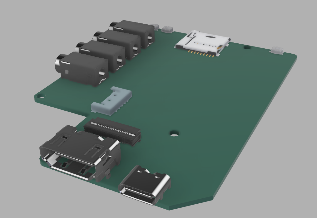

Peripheral/power PCB
Now I know how much space I have to play with in the case, it is time to design the peripheral/power PCB.
The case design constrains both the “maximum” size of the PCB, and the locations of the connectors.
I’m making decent progress on the PCB schematic, next step is the actual PCB layout.

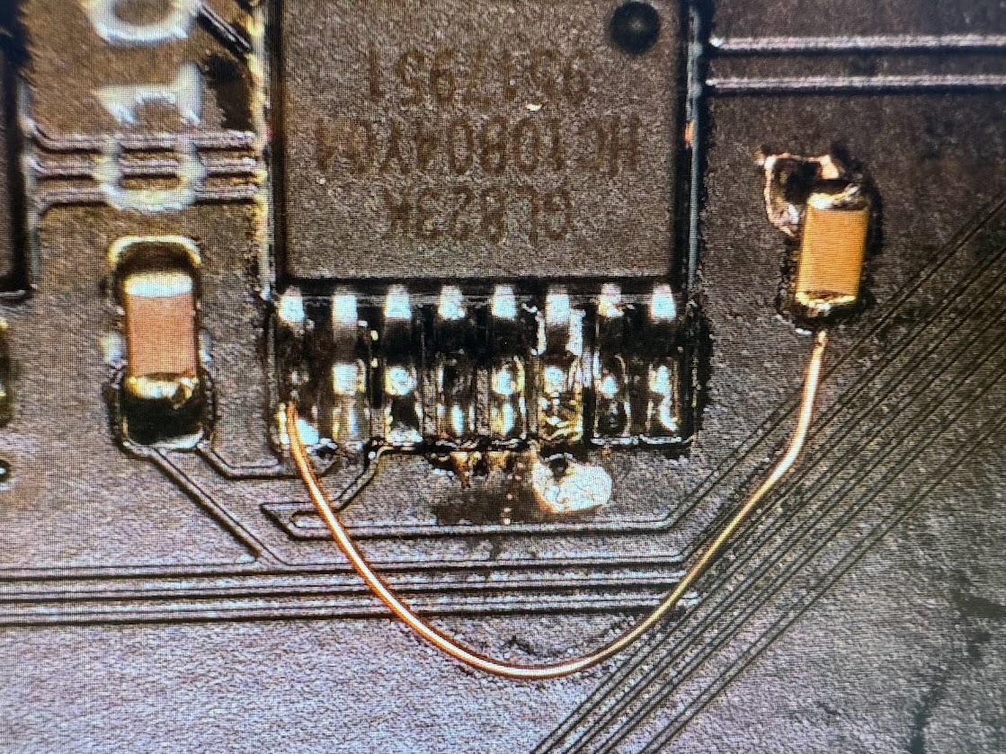

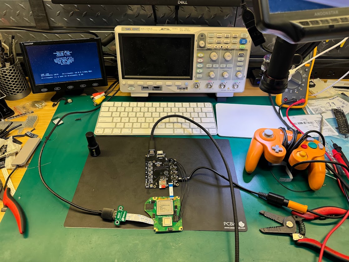

Back in January I ordered my first revision boards. Assembly was fun, it was my first time using solder stencils so I decided it would be a great opportunity to fail at it on a livestream (shout out to @Y2K, @supertazon, and everyone else who joined!). I also got a chance to try out my controleo3 reflow oven build for the first time.

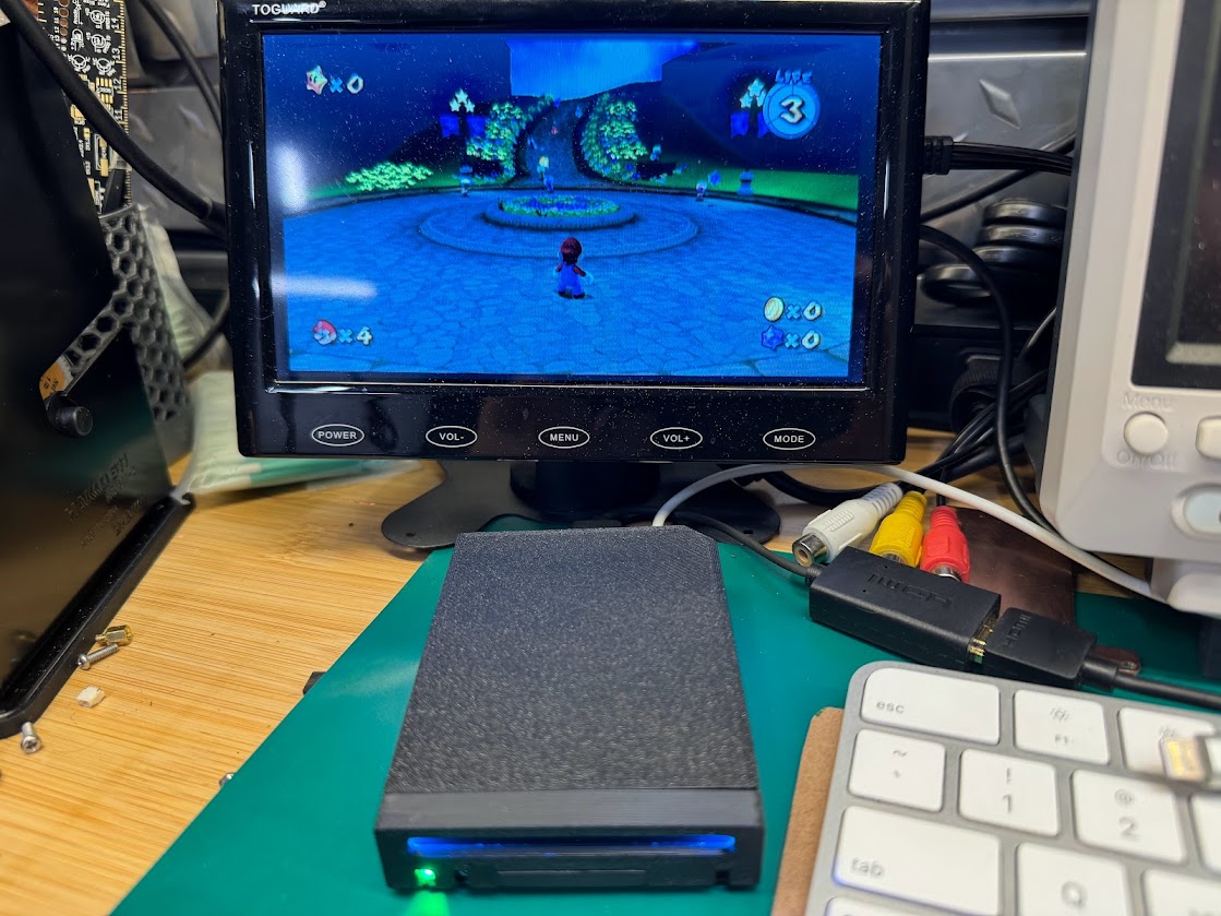

After some rework, the board booted a Wii! But oh no, no USB detected! Turns out I missed a capacitor on the GL823K, so I bodged one on which fixed things right up.
(Thanks @CrazyGadget for helping me figure that out!)

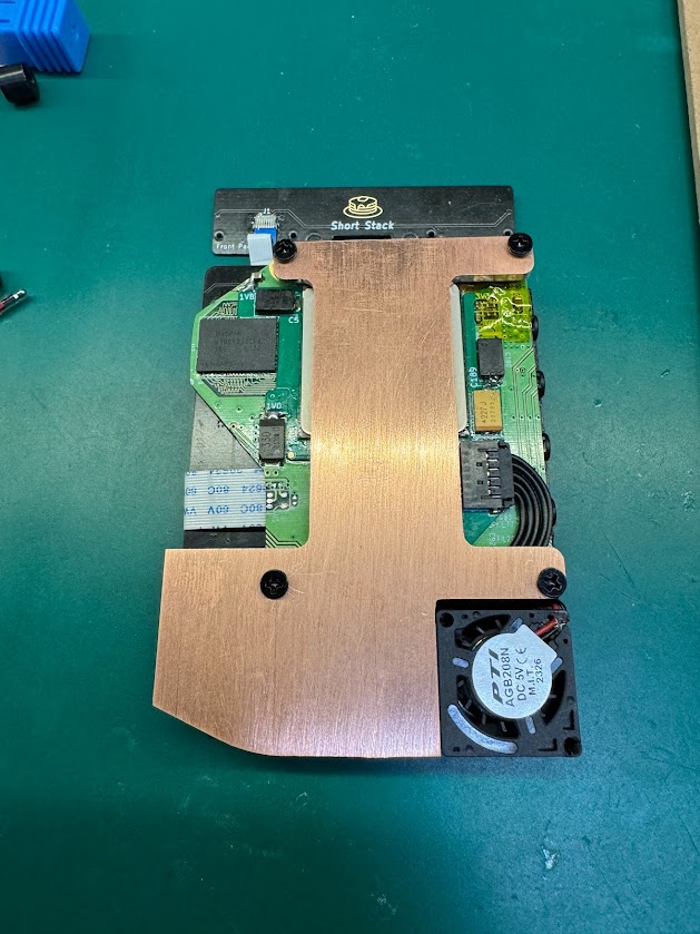

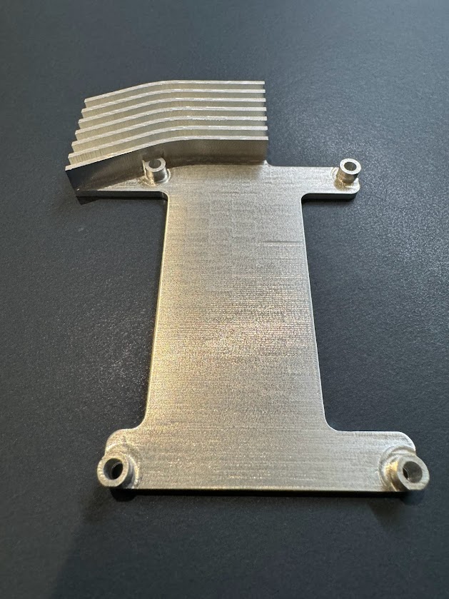

Speaking of cooling, since I decided on a custom heatsink design for this build it was time to actually make it. It turns out machining metals is really fucking hard. Many many hours in Fusion 360's Manufacture tab, and many more broken endmills later I finally had something.
I also tried machining one out of pure copper just in case the aluminum wasn't sufficient. For a beginner, this turned out to be MUCH harder than machining aluminum and let's just say I won't be machining copper again any time soon.

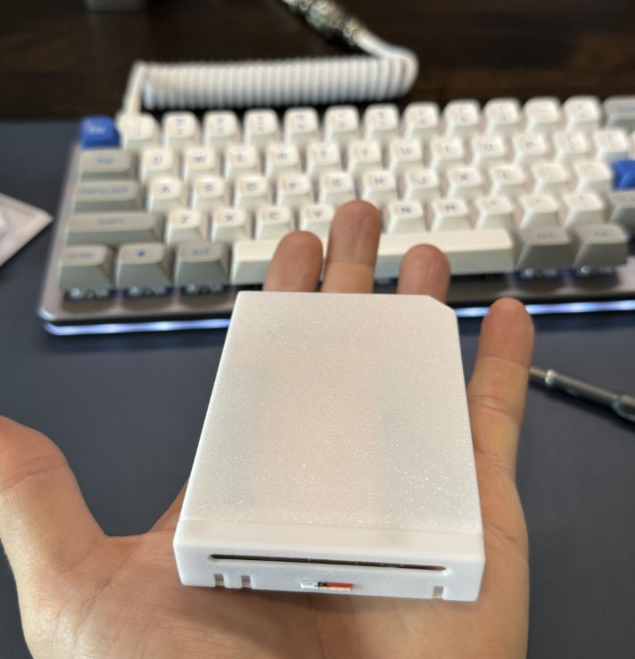

Once I had it all put together we finally had revision 1 of Short Stack.
Although it was working, there were multiple issues with the revision 1 boards. A bug in circuit design meant the fan was constantly running, even when in standby mode, I had made some dubious decisions on my choice of low profile FFC connectors, and I wanted to fix that capacitor bodge. In addition to this, my prototype Periphlex board did not have enough mechanical support to help it stay flat and attached to the Wii motherboard - causing me to tear a USB trace.
Or in other words:
It was time for revision 2.
I see in your final build you went with the GL835 instead of the GL823K. Any particular reason? The biggest difference I see is GL835 supports SD specification v3.0 for faster MicroSD speeds.
The GL835 runs from just 3v3 as opposed to the GL823K running at 5v. So I assume the change was made to save some power
At the time it was much easier and cheaper to source GL835s and they have the advantage of not needing 5v as legend says as well as being much smaller. Unless hand soldering is a top priority I would always use a GL835 these days.
