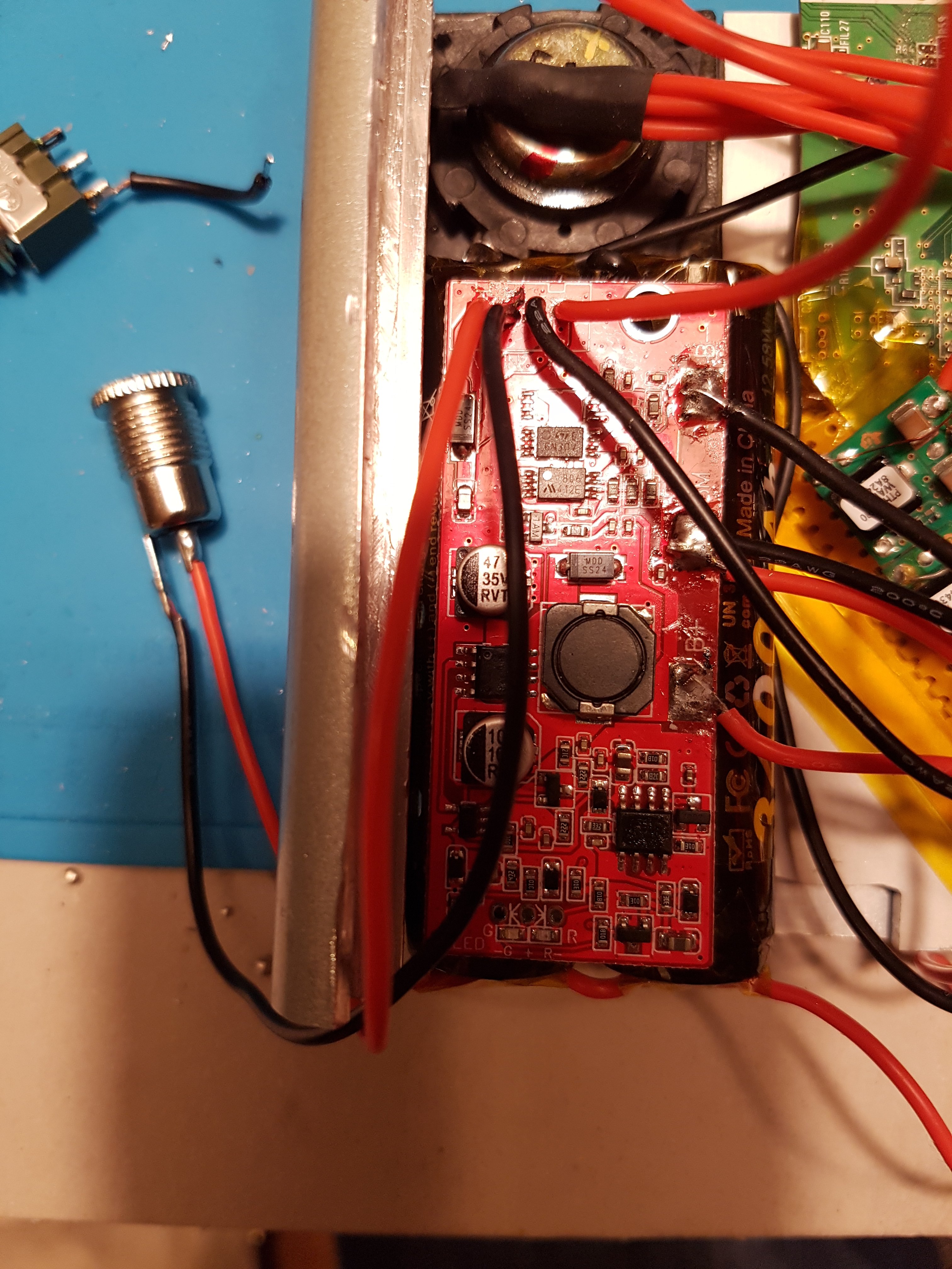

Hello,
I have a problem with my pms. The wii works when plugged in and the charging works too.
If I test it without load I have 8.33V on the output fully charged, bug as soon as I put a load on it(turning on the wii), the voltage drops to 4.2V. The wii is working (I have the sound of it). No display, but it's not turning on because it needs 5V and it's not enough.
I guess that maybe it has something to do with the pms's output IC but I don't know.
Is it fixable or do I need a new one?
That is the PMS model I use: https://www.aliexpress.com/item/32948772265.html?spm=a2g0s.9042311.0.0.27424c4dupkLtm
Best,
Emetsys

photos of wiring pls

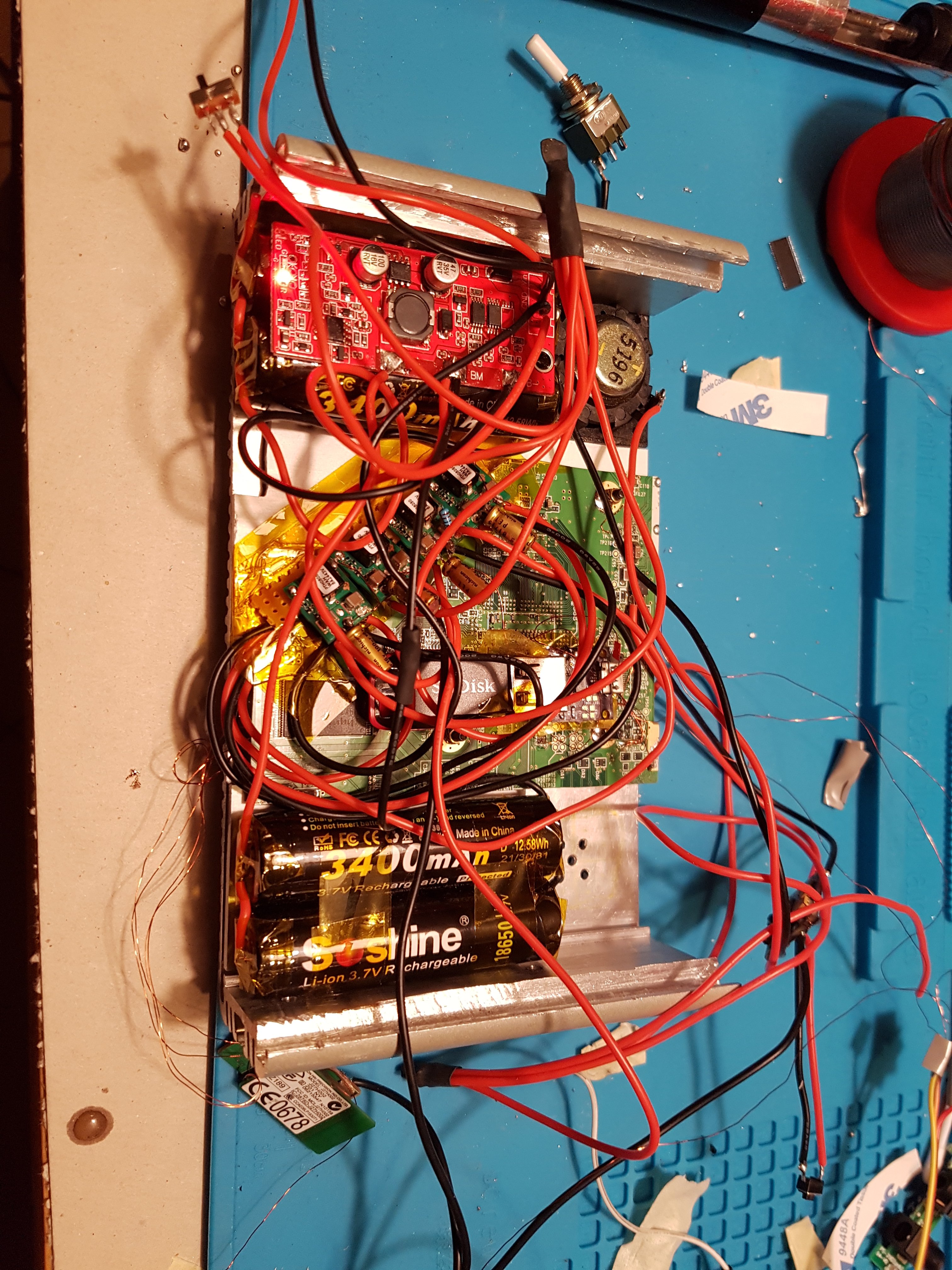

post photos of ALL wiring pls
It works when plugged in, I guess it was because of the short between the 5v and the gnd.
I can post a picture but it is spaghetti.
Honestly, you should probably scrap all that wiring and start over. That's too much spaghetti, not managing it is only going to cause more issues down the road
