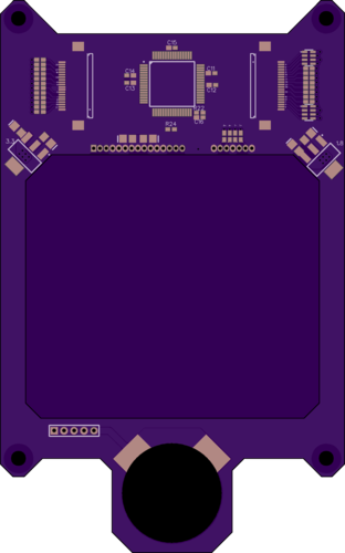

but i will have to trim the motherboard slightly to make it goes in, (will need to remove less than a cm) is this a 'good' trim (as in safe, simple and working :D ) looks to me than the only thing i will cut is the ground and a bit of the ethernet port pins (which i dont care about)

Can I make a suggestion about trimming before you start?
Because if you're gonna use the HDD connection tools with the two FPC cables then you'll want to leave the bottom edge (orienting to the photos you posted) intact
You can however trim more from the top edge, like so:
Yup seems like a better idea, nearly forgot the FPC's, as i have ordered them but still no new in the mail, and a big plus to the fact that only one side would be trimed, by the way, what is the role of the big chip you cutted of ?
Also is there anything i need to remove on the board or to relocate after this trim ?
Next question, do you know which components can be removed after removing the cd drive ?
That big fat IC is the one that spins the disc, moves the laser, and also powers the laser. Without the disc drive it never gets used, so it can be safely removed in the design you're using. I refer you to my guide on removing ICs:
https://bitbuilt.net/forums/index.php?threads/removing-ics.1530/
The only thing to relocate is the reset switch, it requires soldering to a via though
