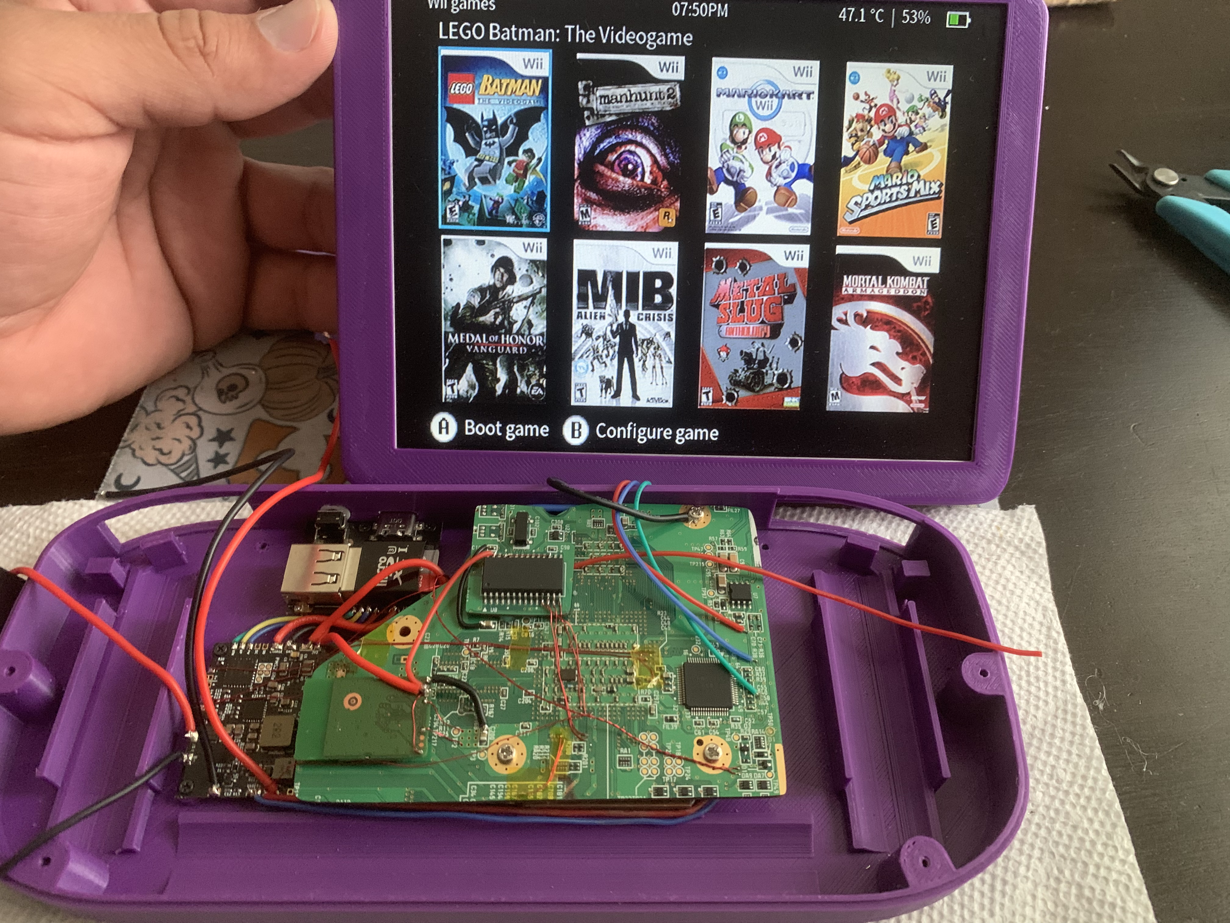

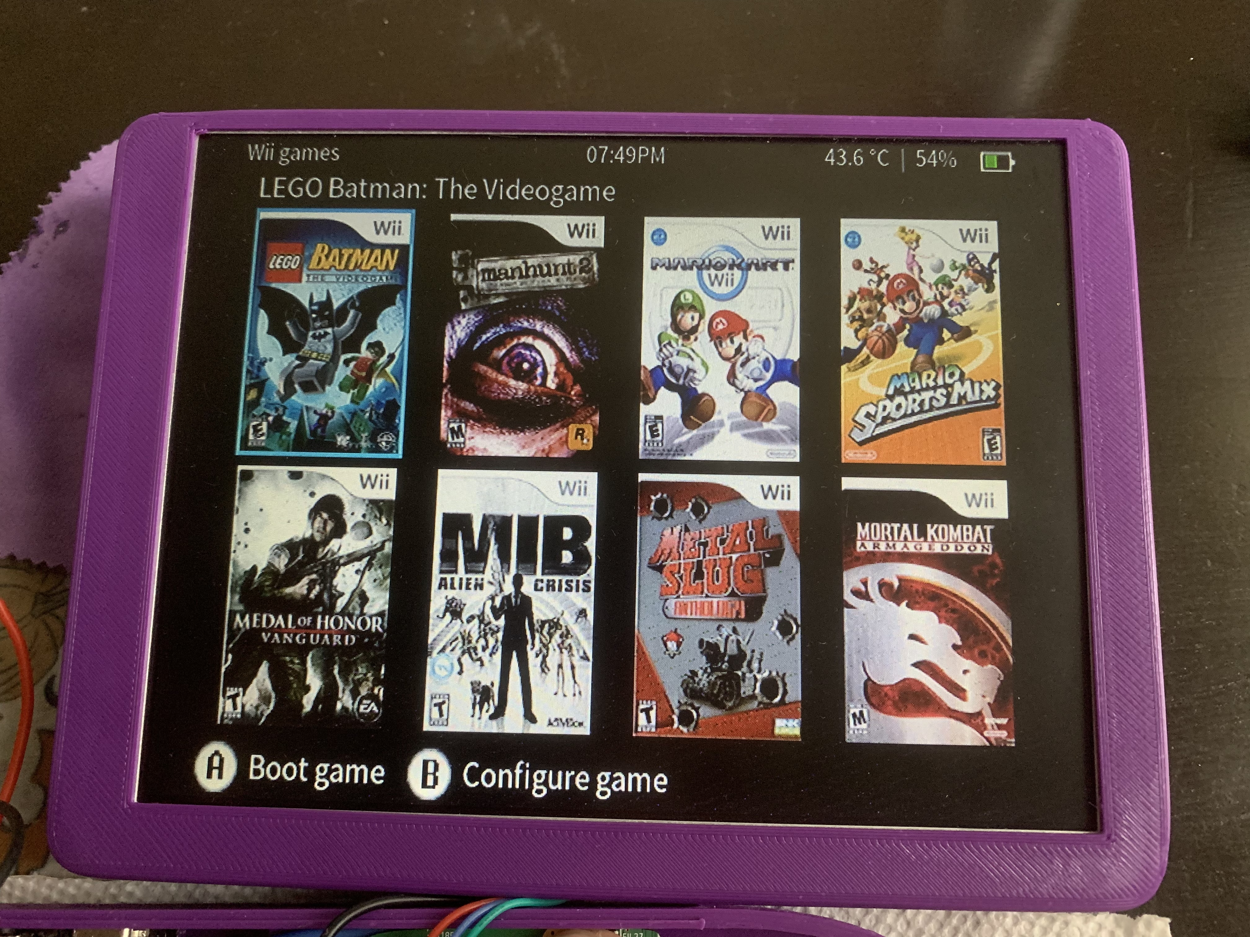

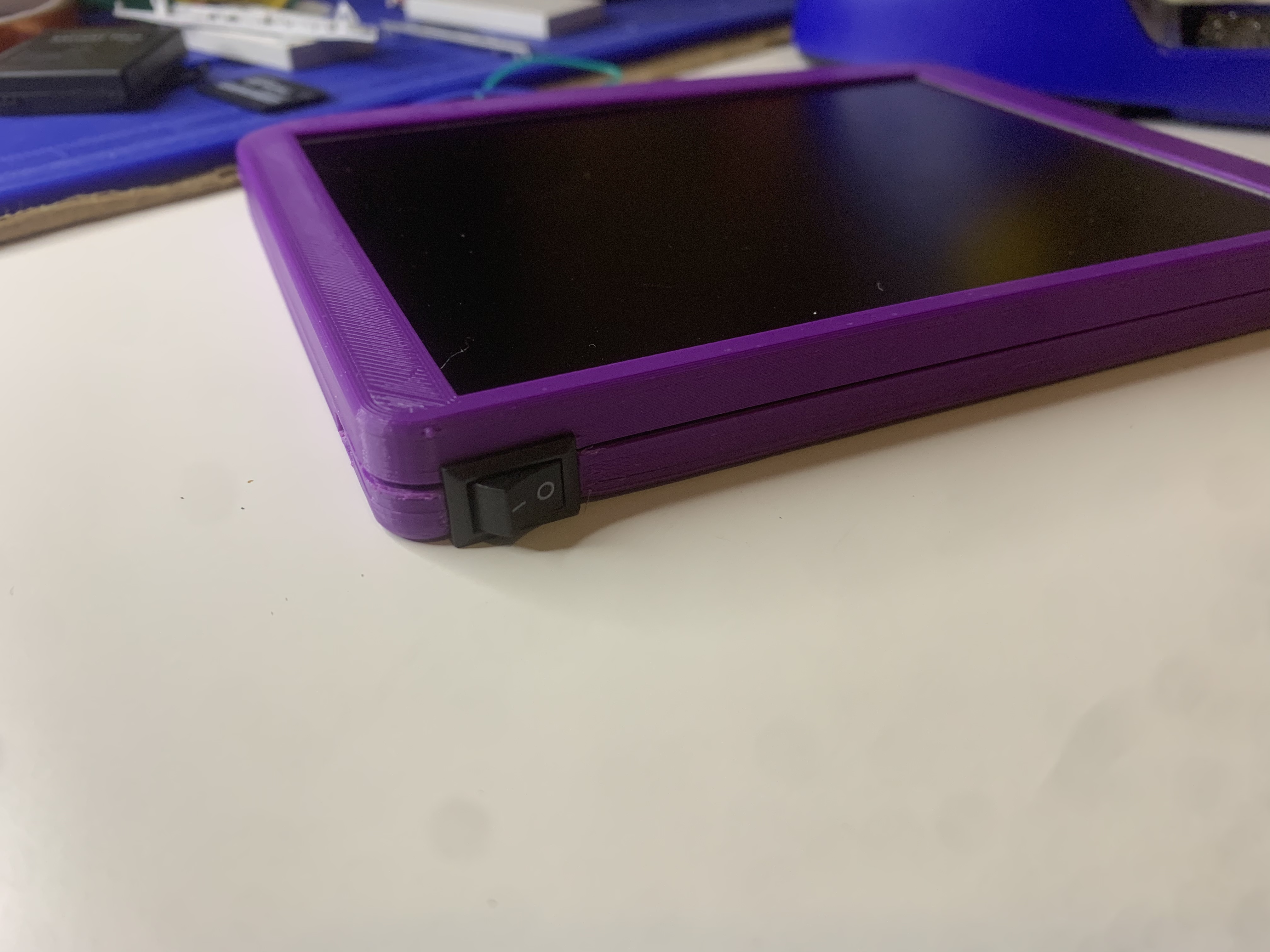

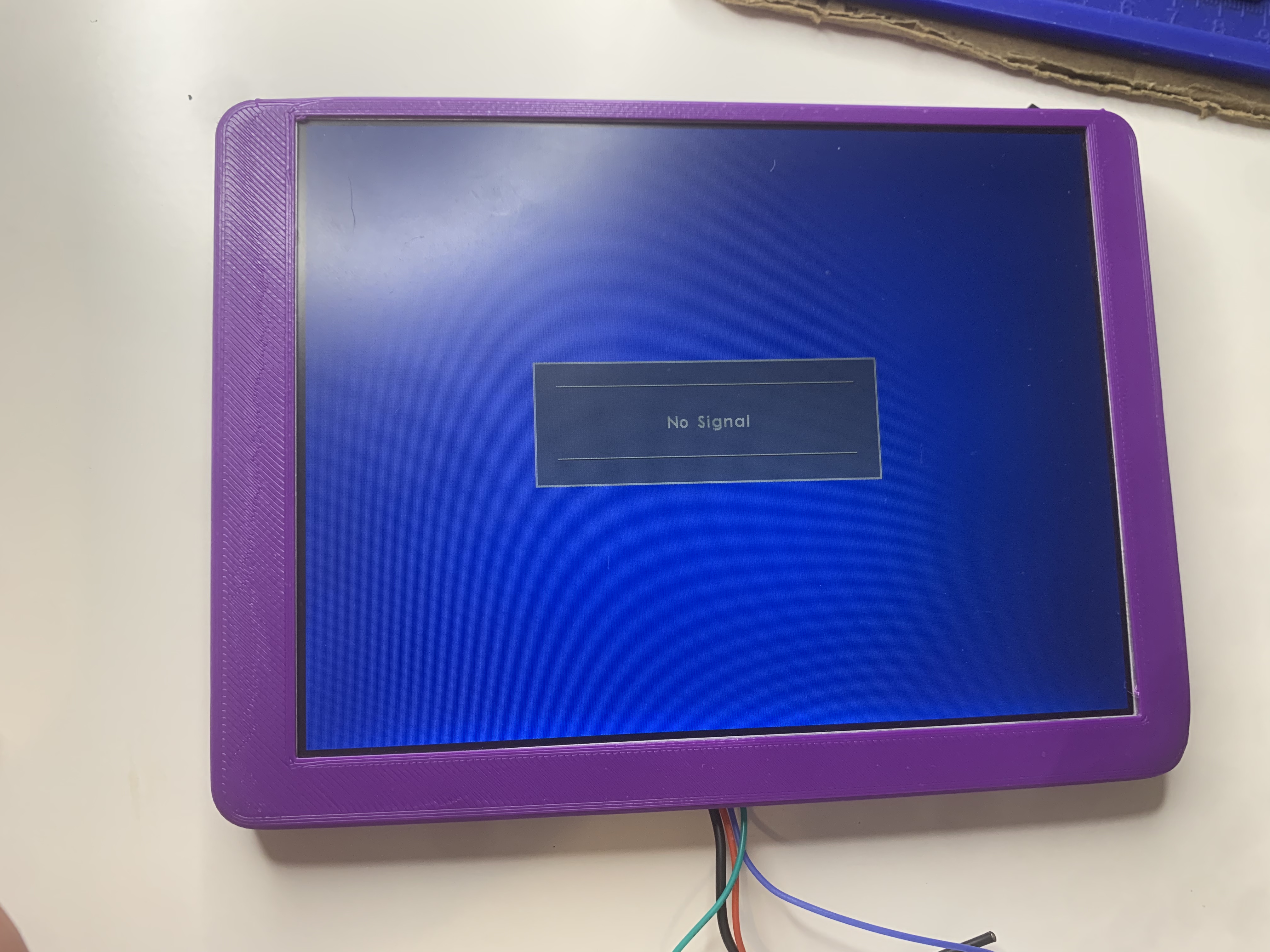

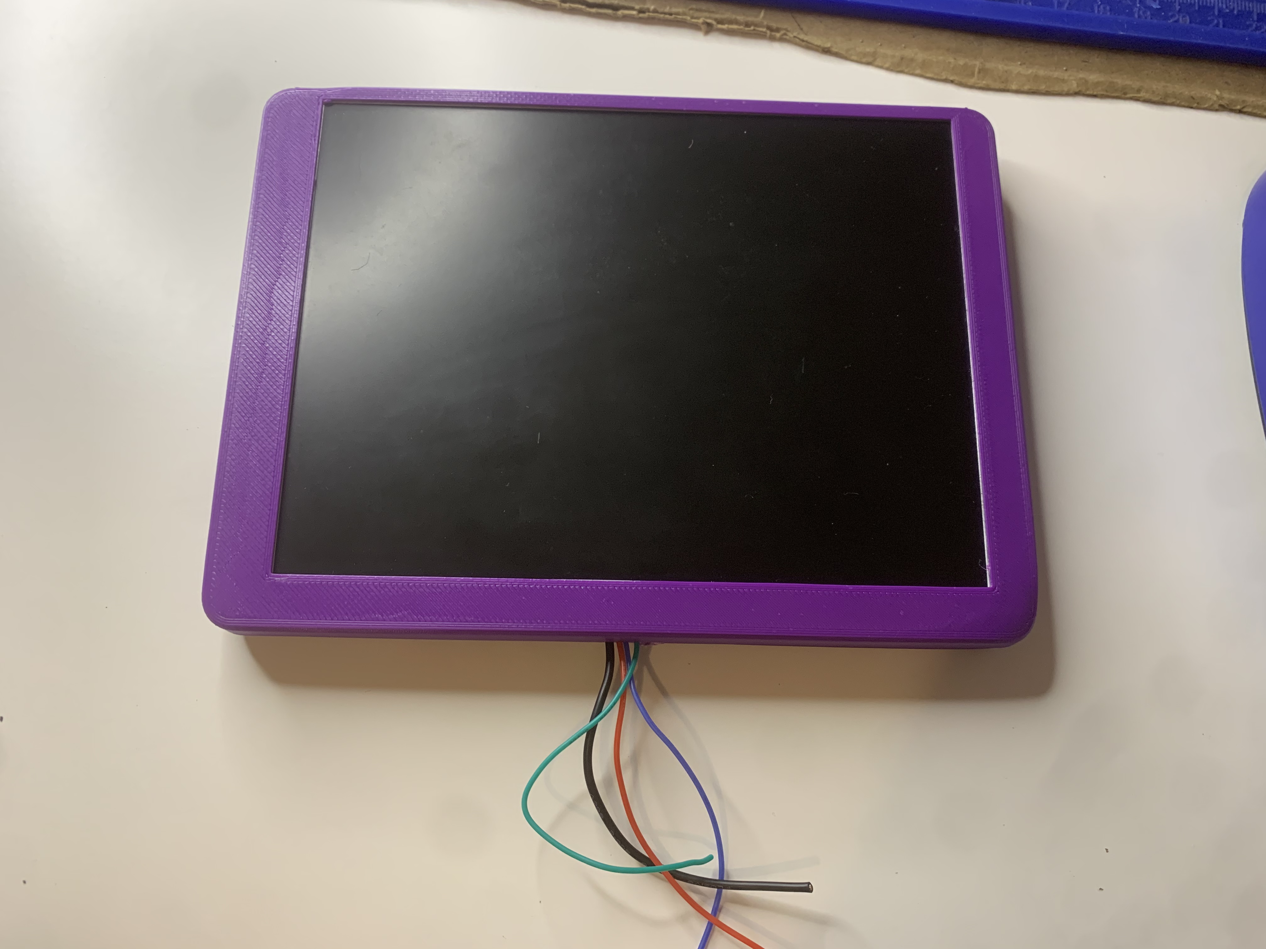

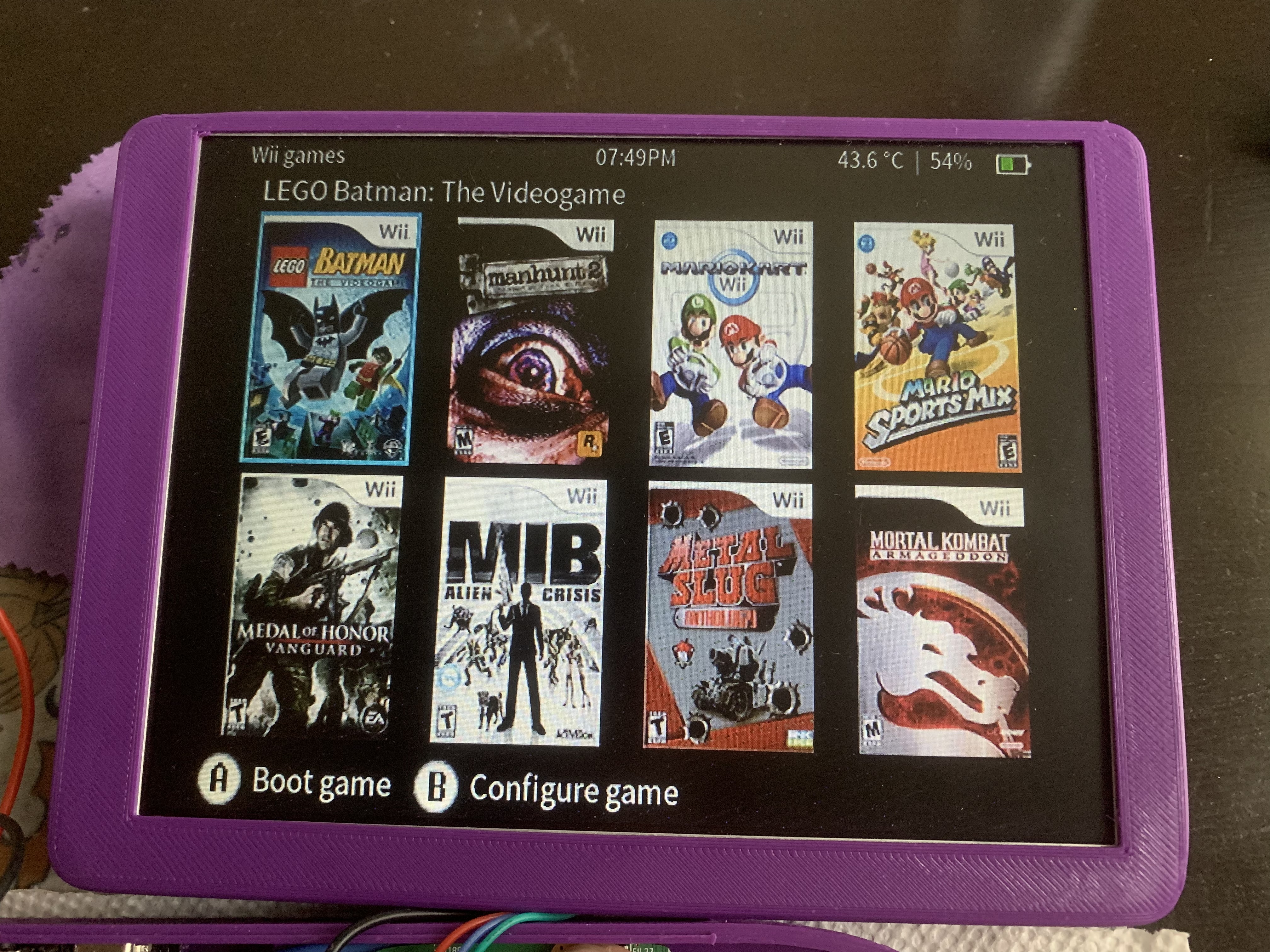

Finished a simple portable 7” lcd for testing trimmed motherboards. I like this lcd because I only need rgb for testing.

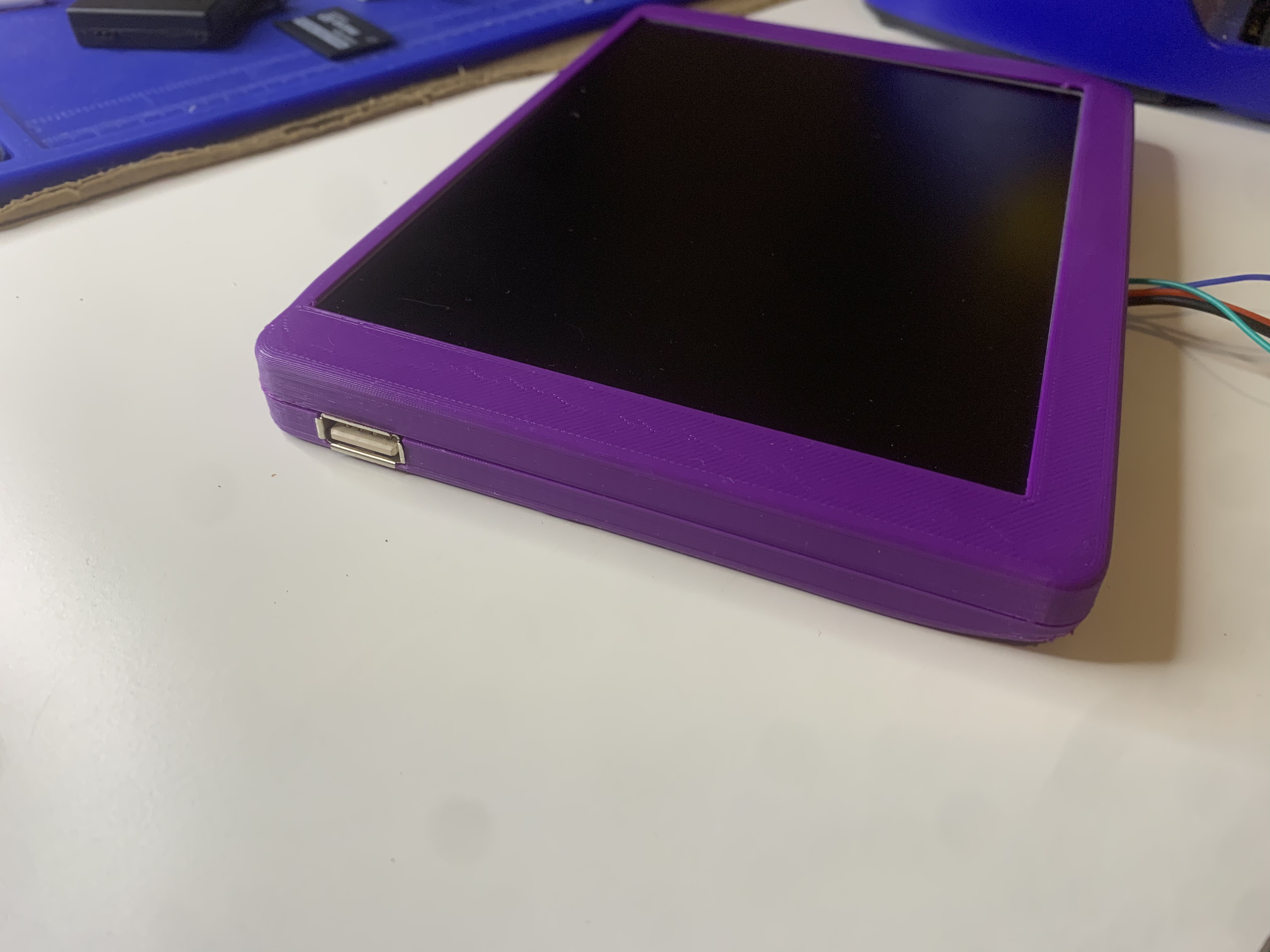

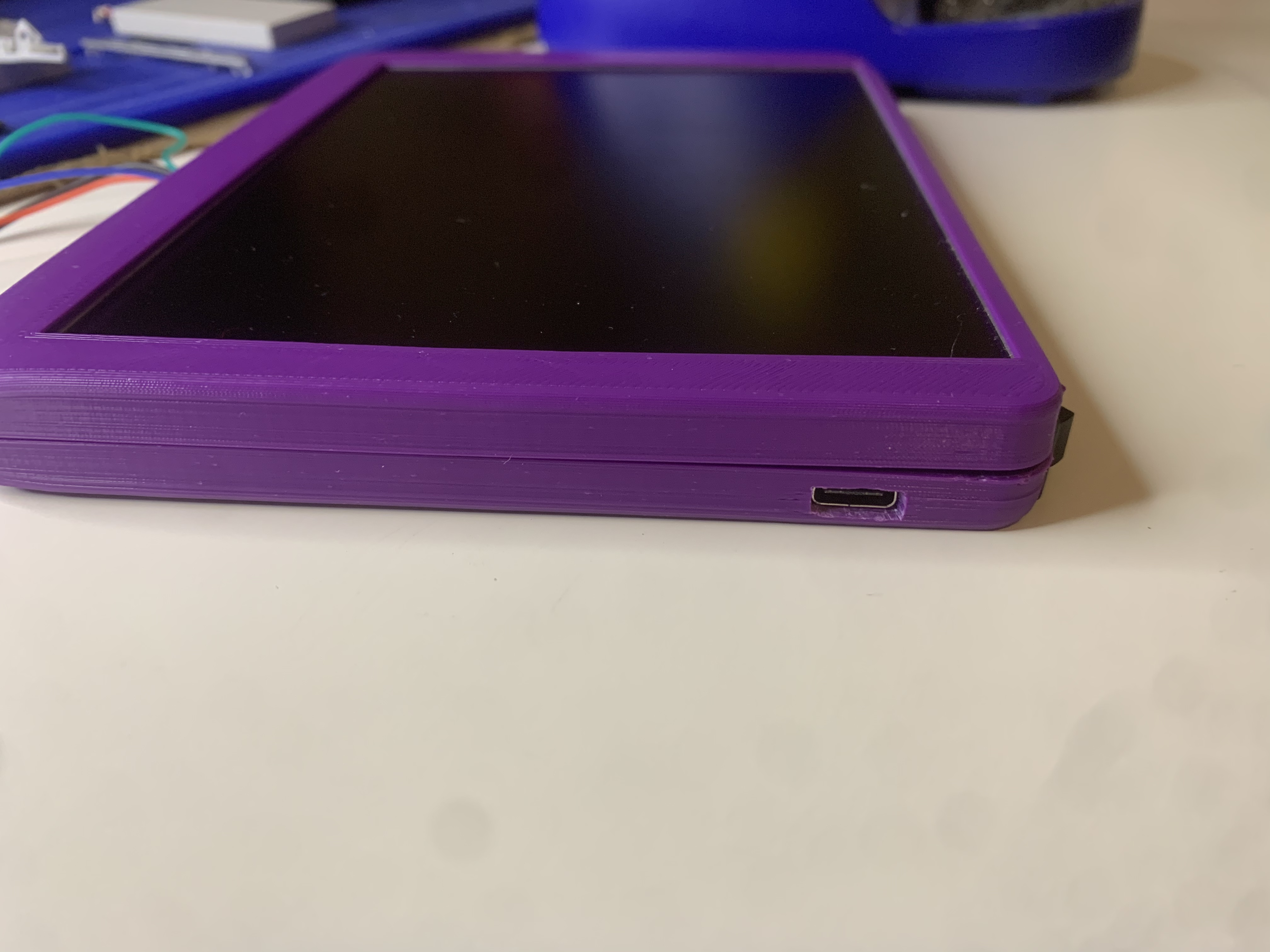

Usb c charging
On/off switch
Usb 2.0 with 5v out

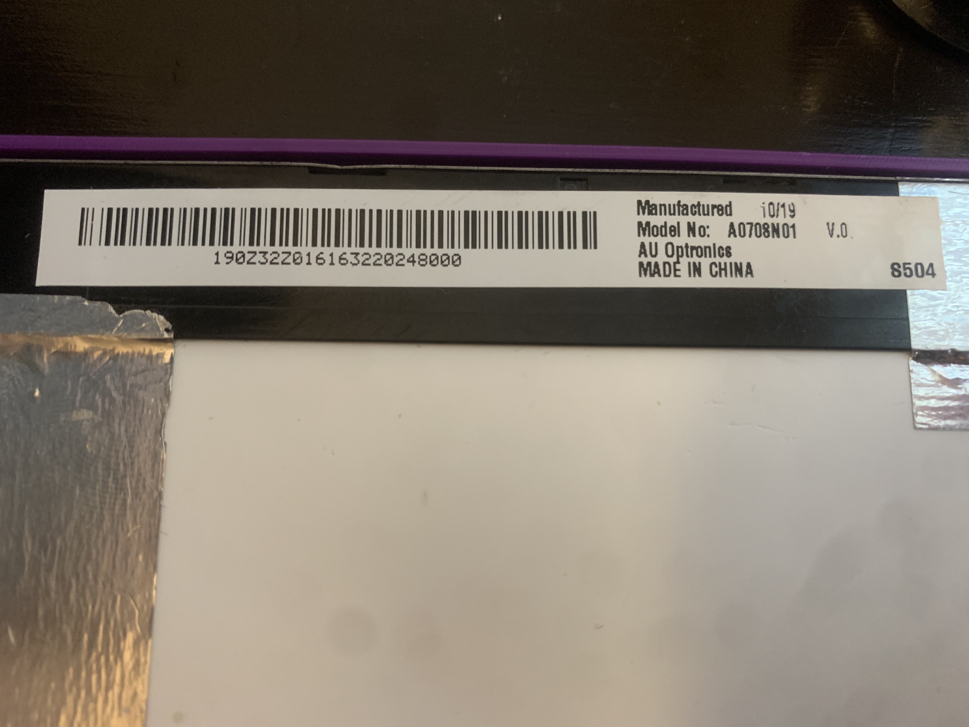

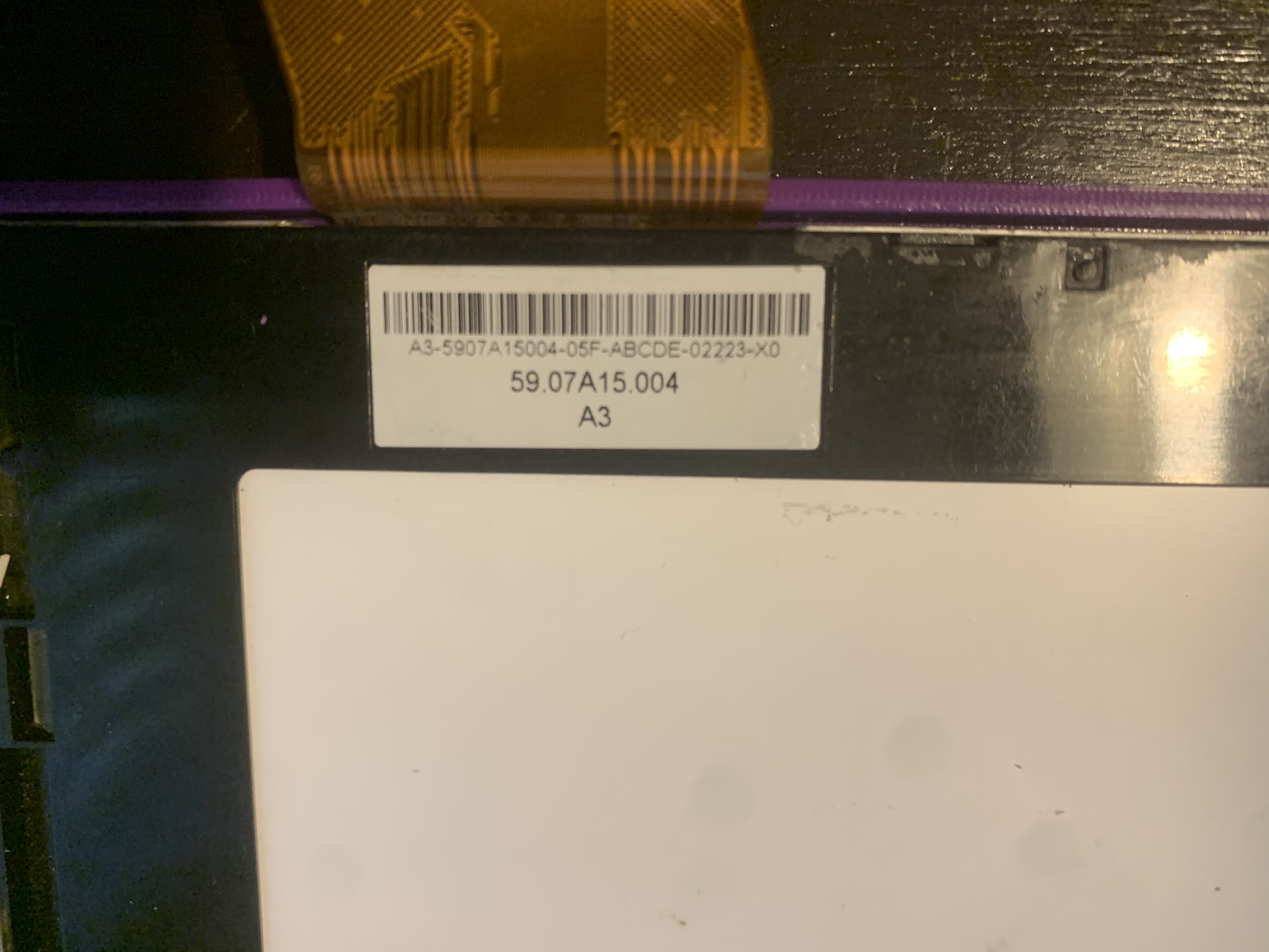

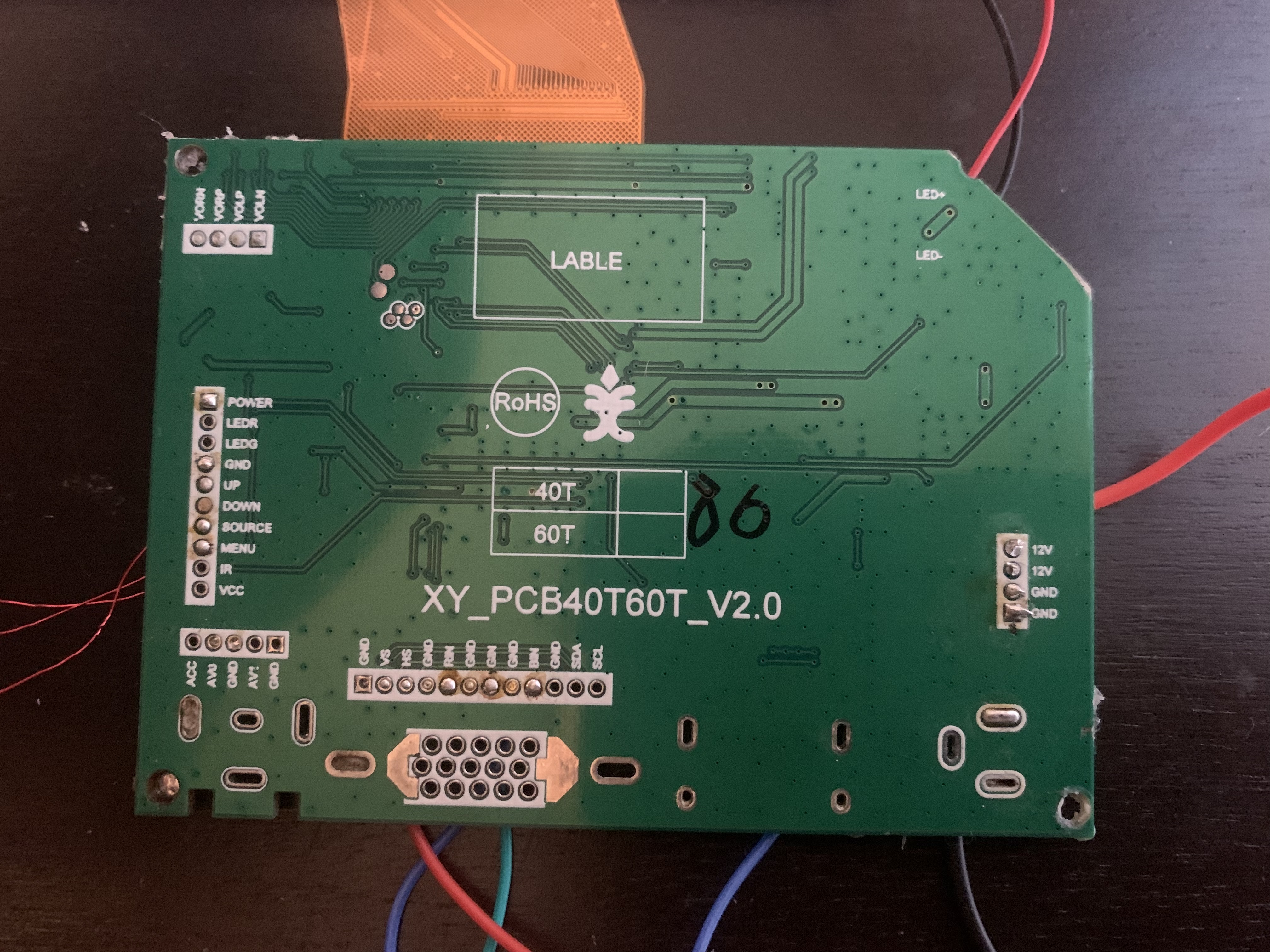

Love the setup, RGB as in component output? Would you be able to post that lcd info? I only know of the 5" eyoyo that has RGB
Just realized this could have been an HDMI compatible LCD with a simple RGB converter input, still great idea

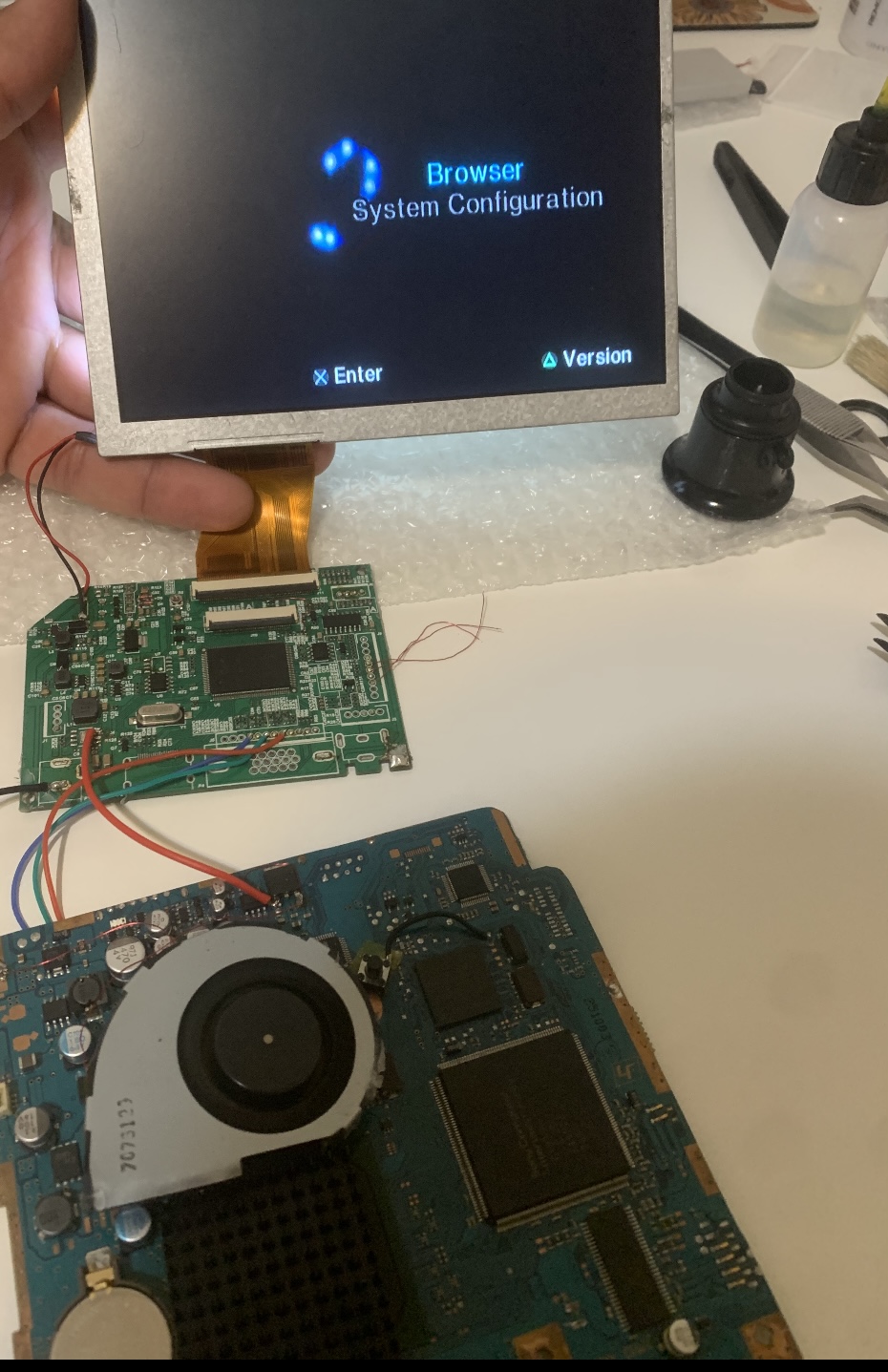

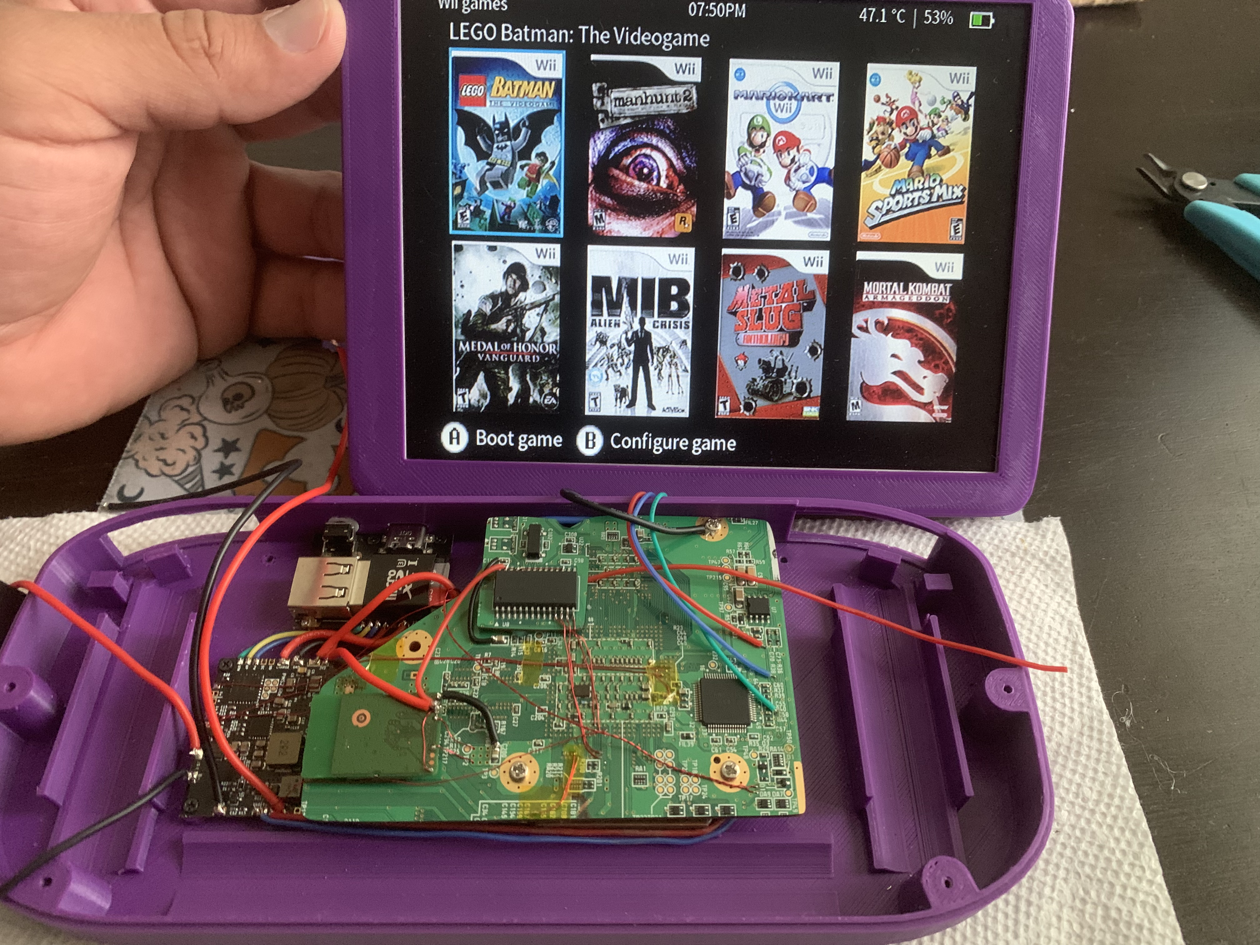

That's awesome, when I saw the RGB lines going to the VGA header I had been skeptical as I was under the impression that RGB component wouldn't work through there but this is sick man. Definitely have to test this on my lcds
Oh yea It works for this lcd I don’t know about other ones. super easy to test projects
