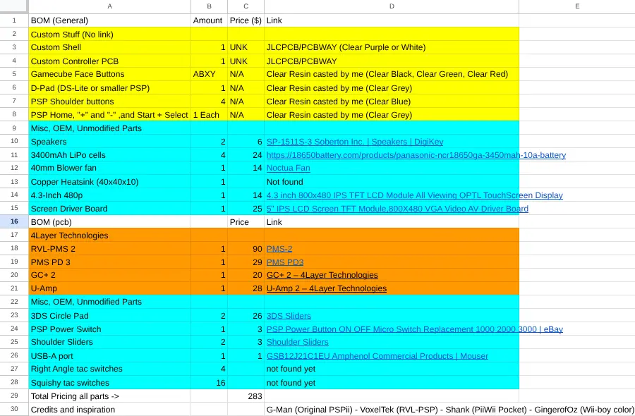

Creating my first Portable so I thought i'd start a worklog for it now that I have more time.
Inspired by GMan and VoxelTek to put a Wii inside of a PSP I've decided to go on that route.
parts list:
EDIT* I am making a custom carrier PCB for the 4layer boards and the controller.
I've officially started work on the pcb and case, i've decided i'll substitute the PMS PD3 for a custom design built into the board because I can't seem to fit the board where I want it to be within the case. the controls will not be the PSP Layout because I don't think it would feel right for a Wii portable, but it is the same layout as Gman and Shank's PiiWii Pocket.
instead of the Scans from Wesk, I am just gonna use the reddit 3d printable Case because it has a simpler all in one design instead of sourcing a custom spacer
