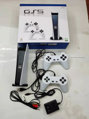

The base for this project will be a GameStation5, which is a cheap and good looking console. Also has a good working space once you remove the original mainboard:

The console finally arrived!
Here's the link, but I don't recommend buying from this seller (see the reason below):
GameStation 5 - AliExpress
It came with bad news for this project:

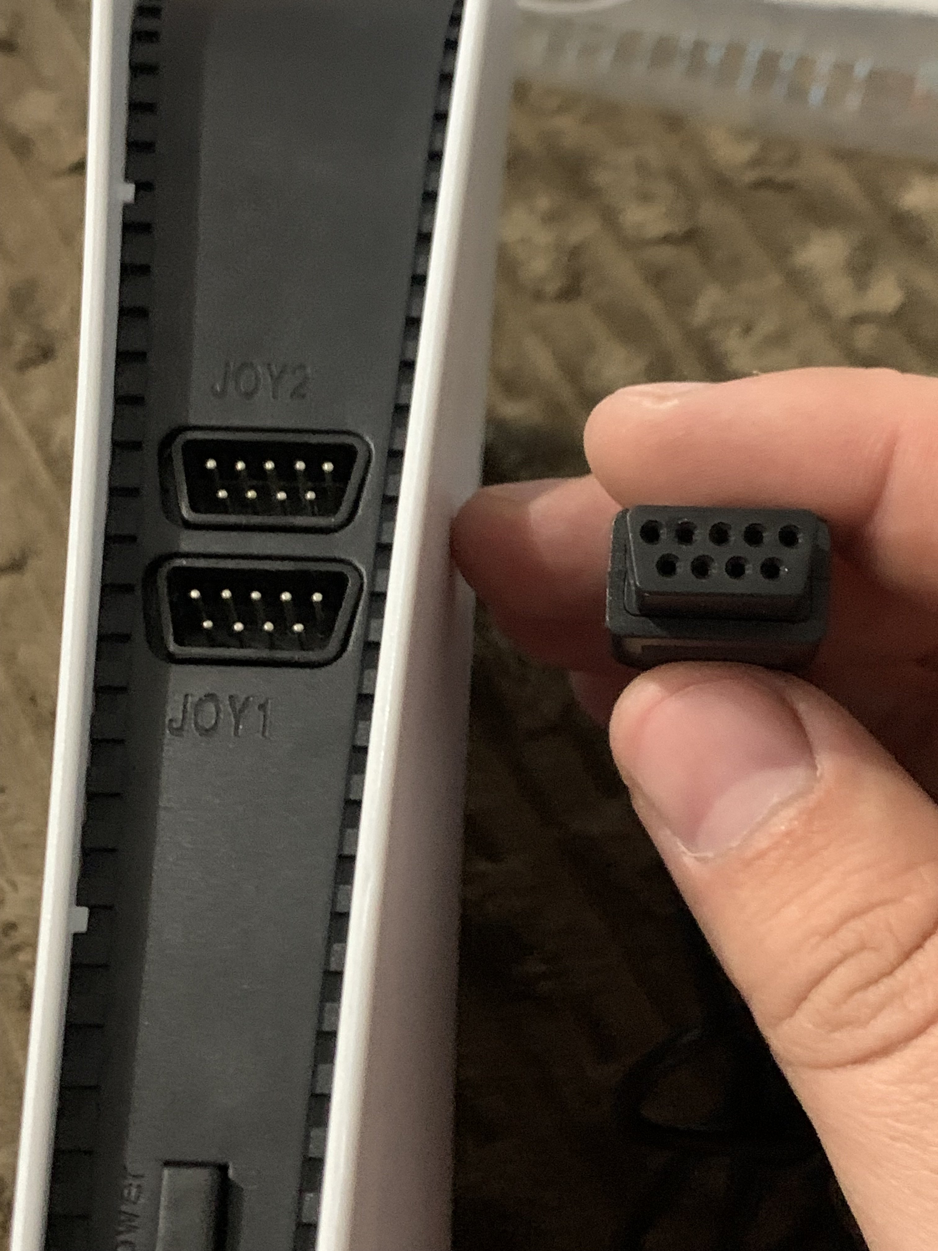

The controller connectors were different than the expected (because they should be USB instead of these awkward connectors)
Immediately reported that situation to seller as "Product doesn't match with the description" but must return the goods to receive a refund.
So,
I will manage to adapt this holes that are bigger than a USB port (because $160MXN doesn't worth to pay shipping for a refund).

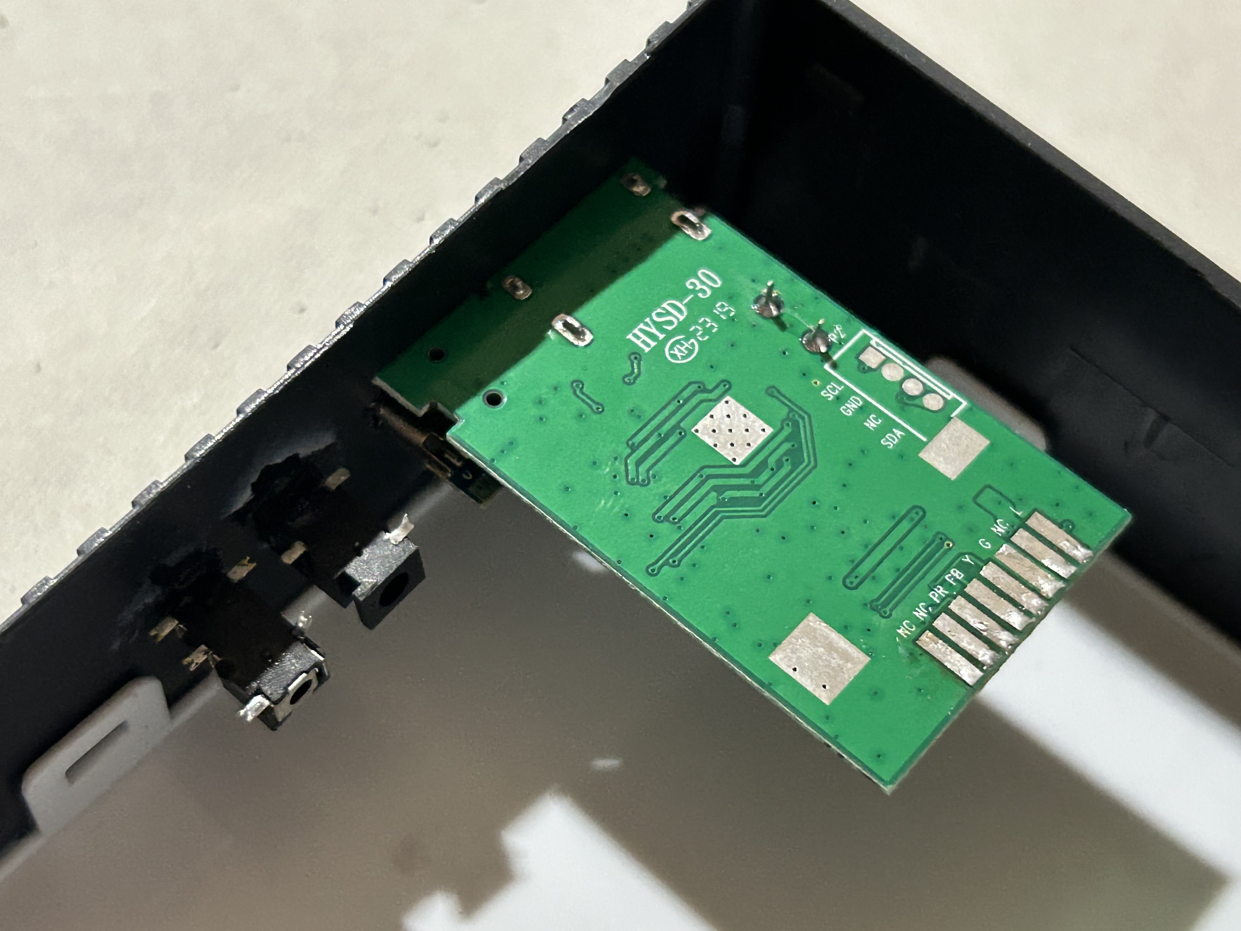

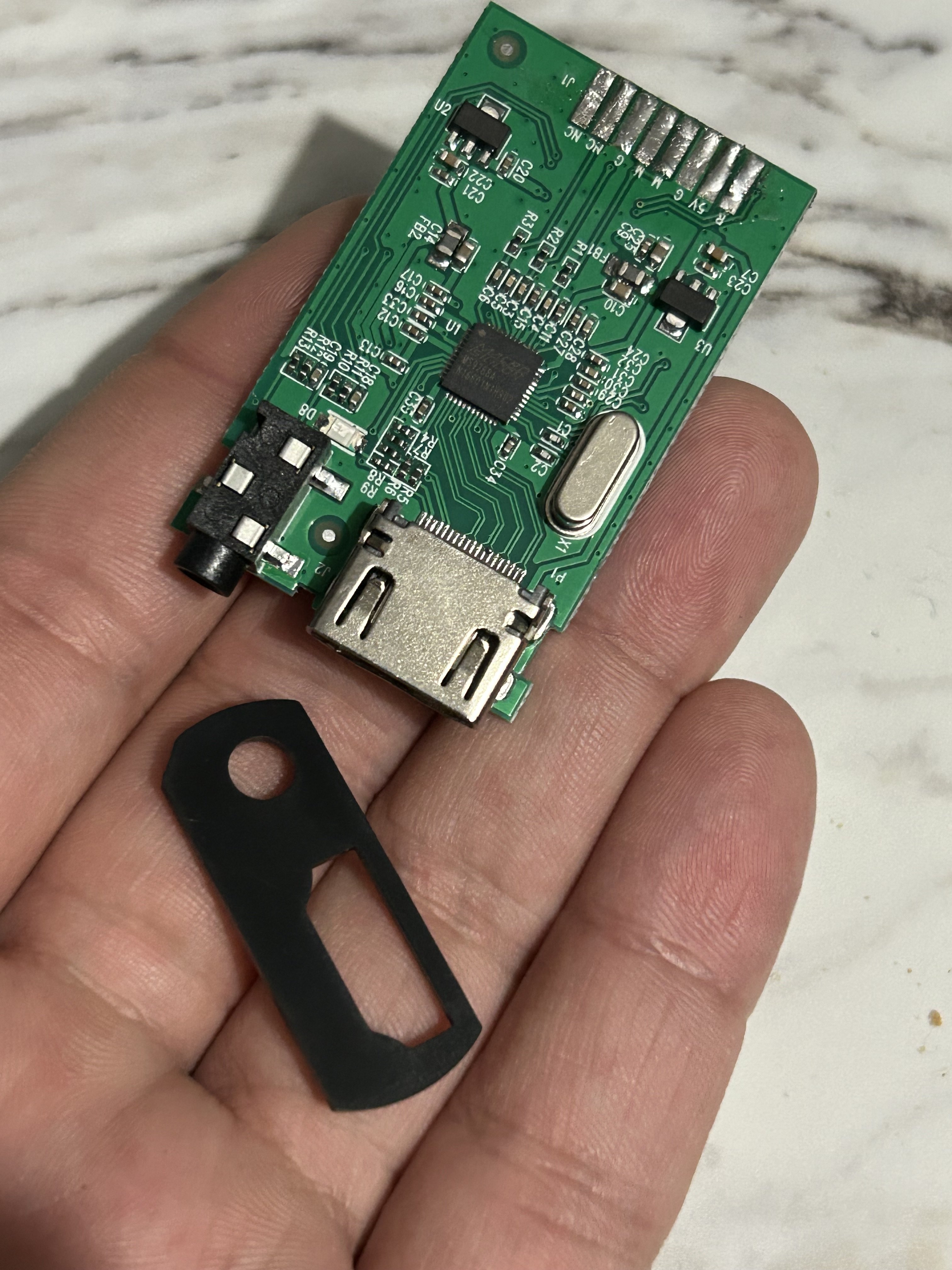

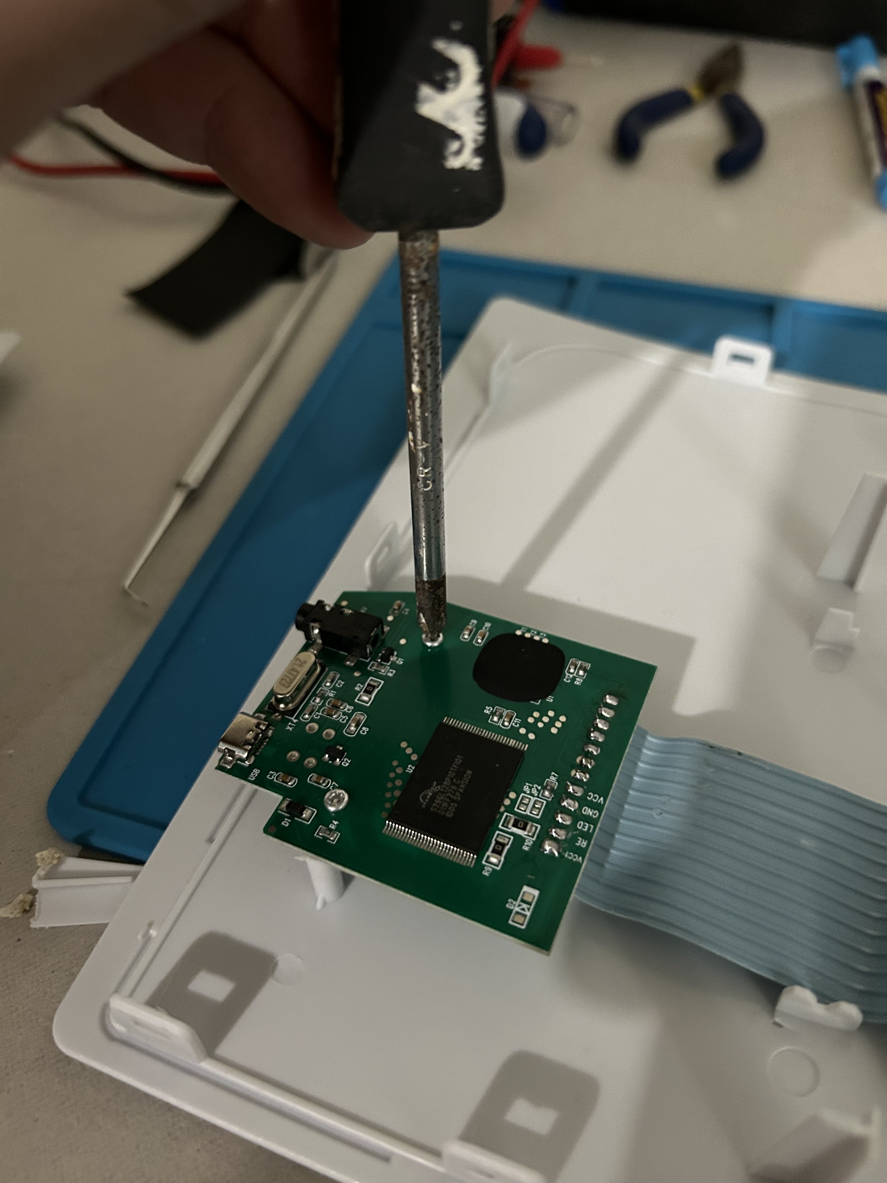

Unmounting Wii2HDMI board. Removed the Wii AV connector and saved the HDMI cover for later:
Here's the link:
Wii2HDMI - AliExpress
Unmounting Gamestation original components (also saved for a further project):

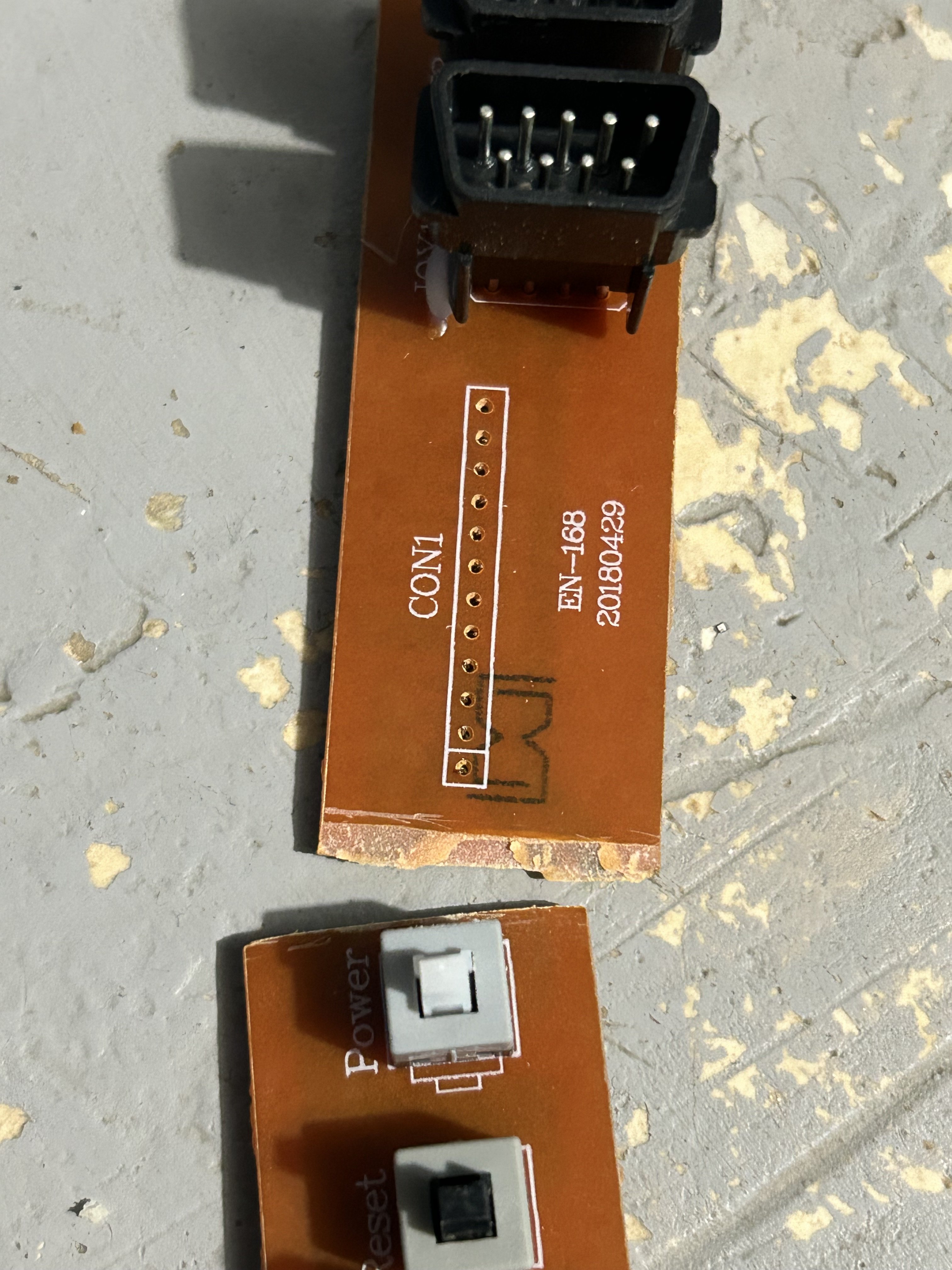

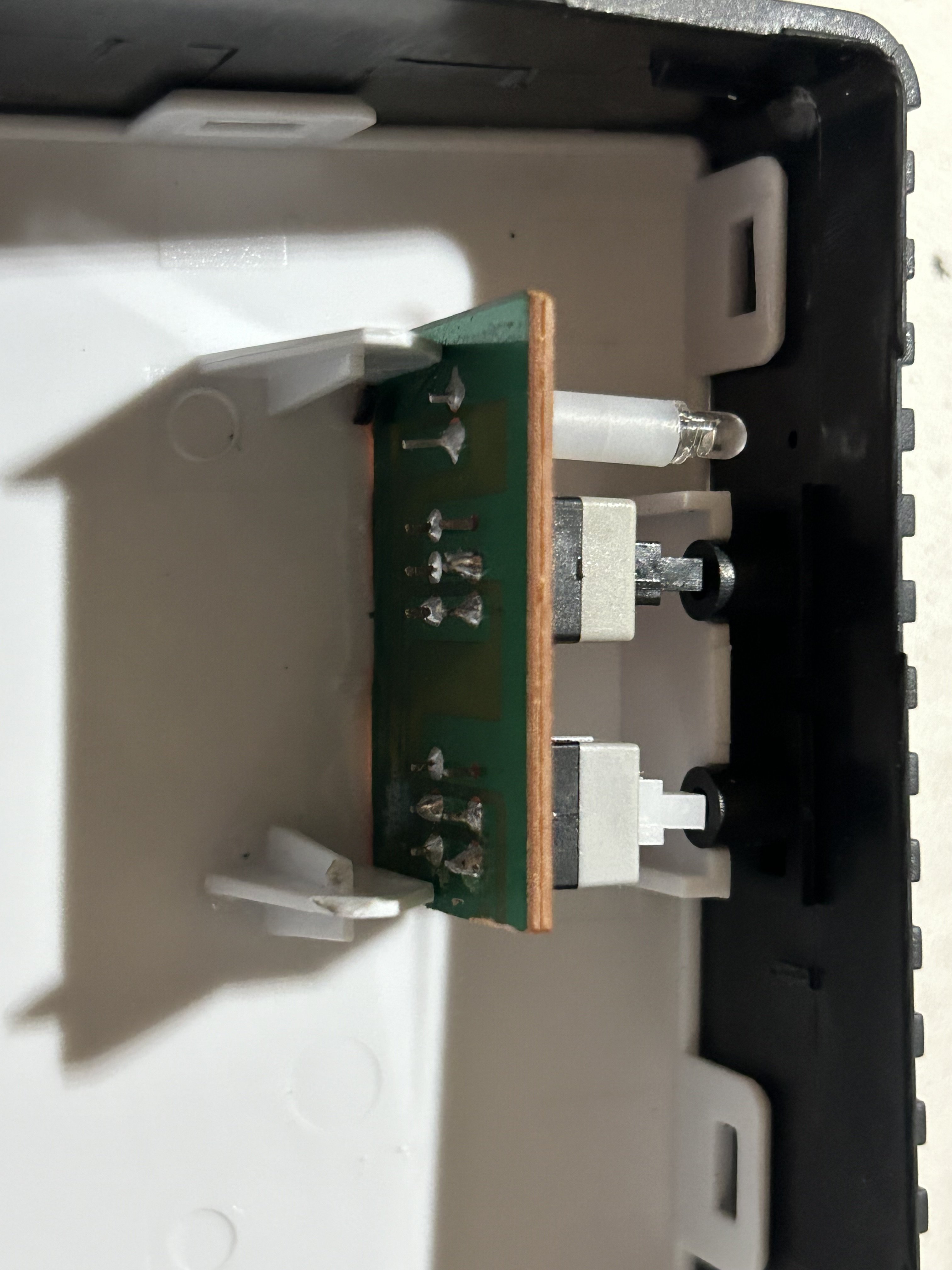

Trimmed the front panel board to save the power/reset buttons and power LED:

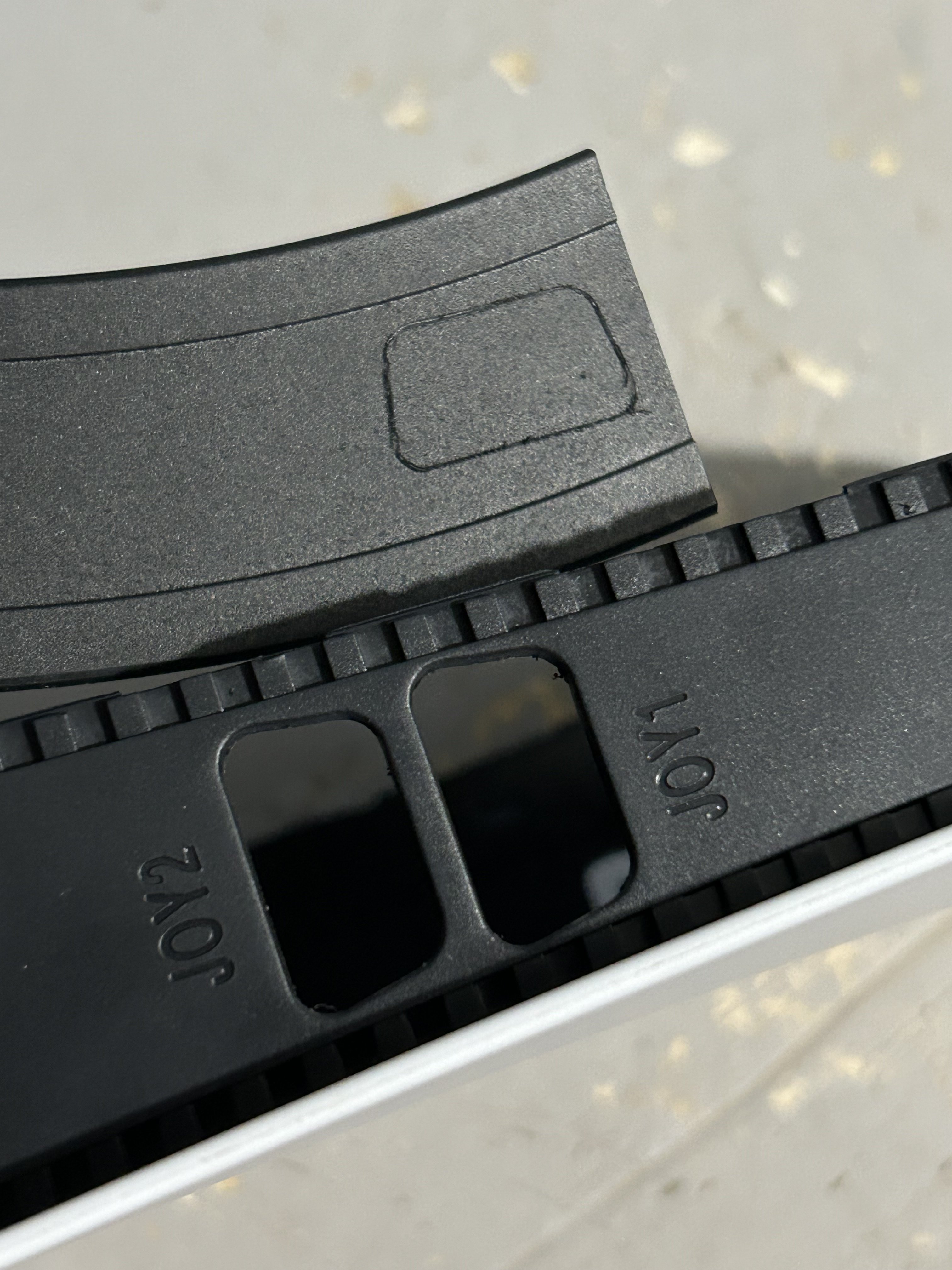

Found some plastic scrap from component reels (the most similar to console black plastic) took the tweezers and traced the connector marks. The idea is to place USB ports in middle and cover the controller port holes:
*REMEMBER - I don't have planned to use a 3D printer

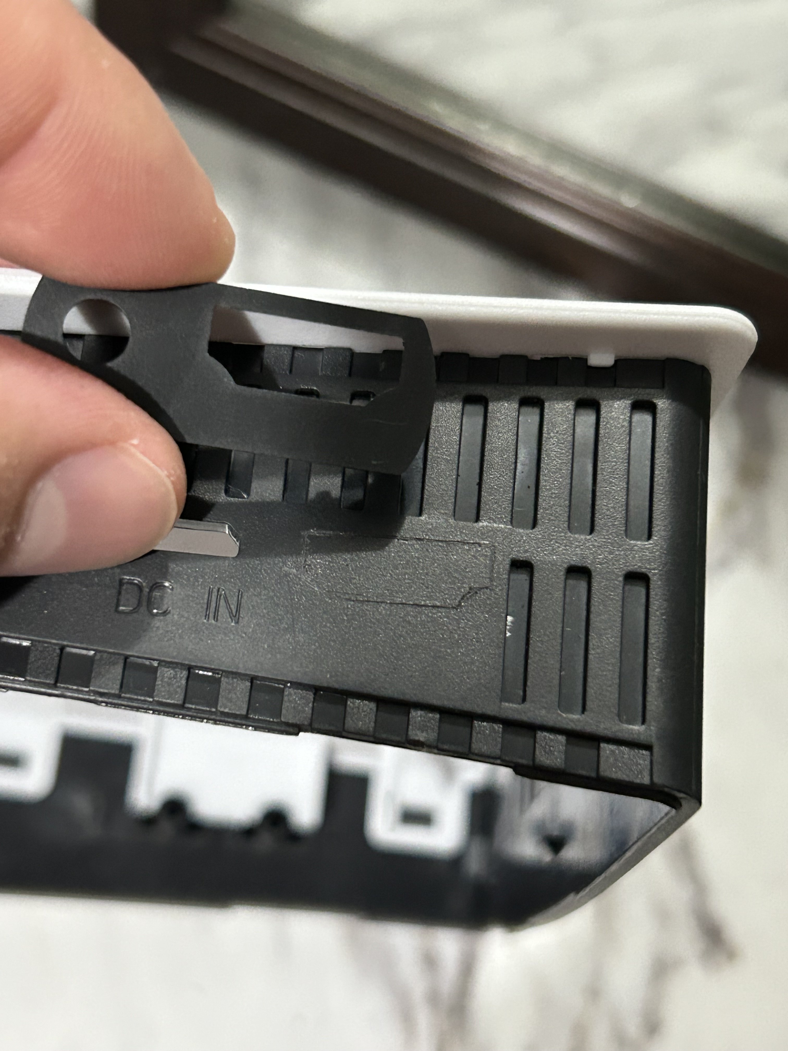

Before using moto tool, I've also traced the HDMI port figure in place (I used the cover which I saved in previous steps as guide)
Also have to resize DC connector from Micro-USB to USB-C size:

The plastic pieces to cover the controller ports were ready:
Remember the original buttons that I've saved from the original console?

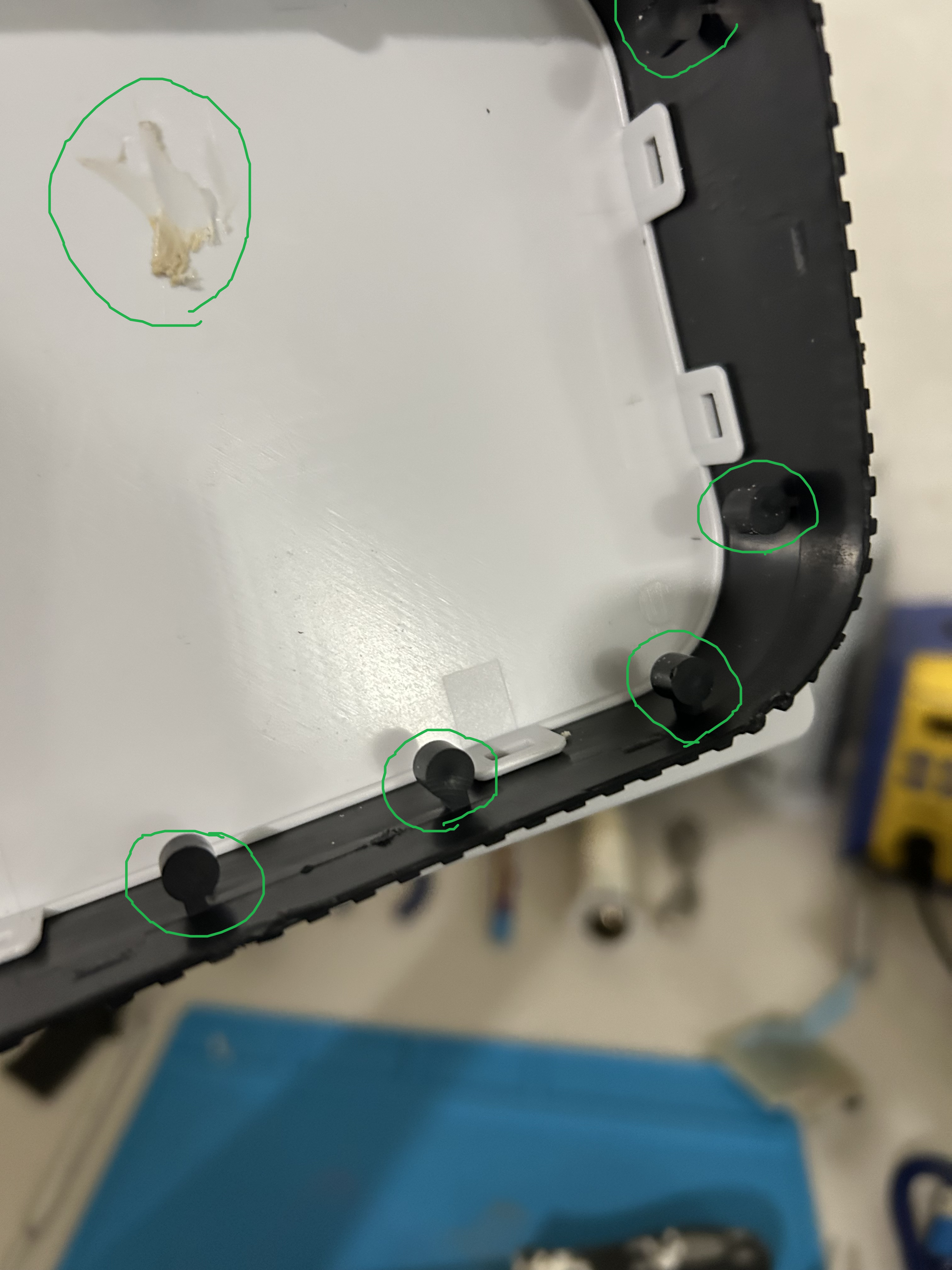

I used some plastic pieces removed from this console to set the button board on place and then used permabond

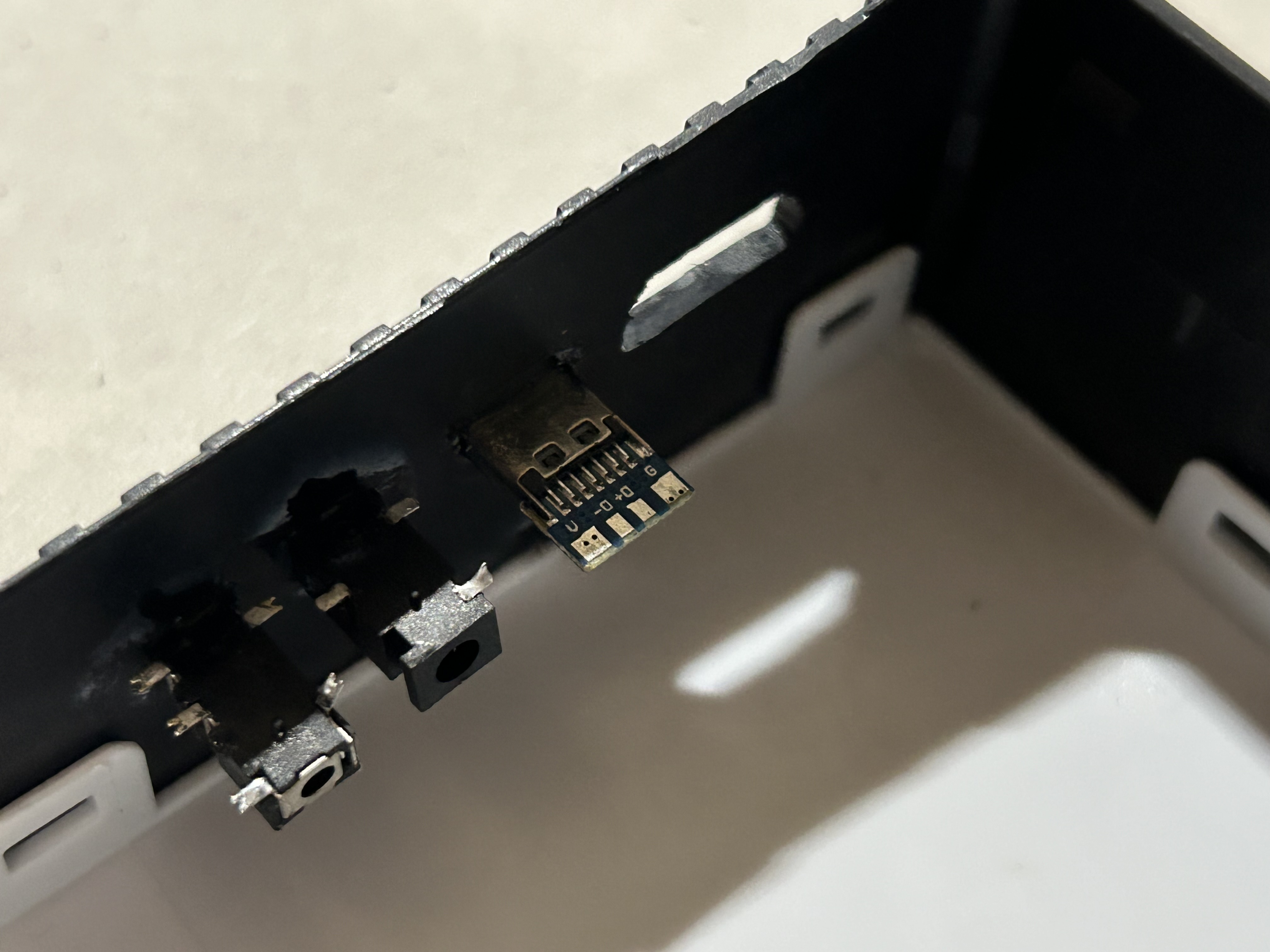

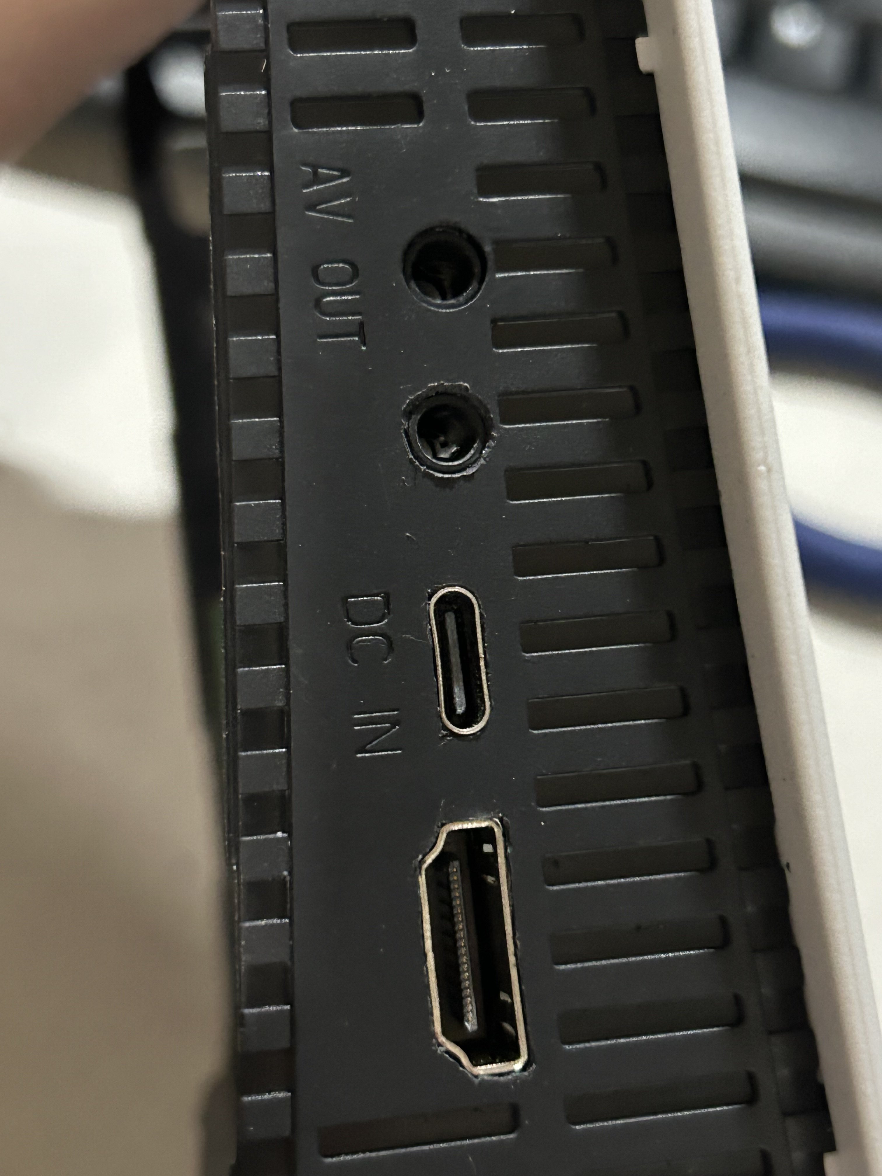

Added the extra ports for the console like HDMI, changed "DC IN" size for using USB-C instead of MicroUSB and a 3.5mm jack for the external sensor bar
*Temporary placed the HDMI board, will be set in place after wiring USB-C port
**I know that the 3.5mm jacks are misaligned, but the original AV output was too close to the center, and I didn't want to drill the "air vents"

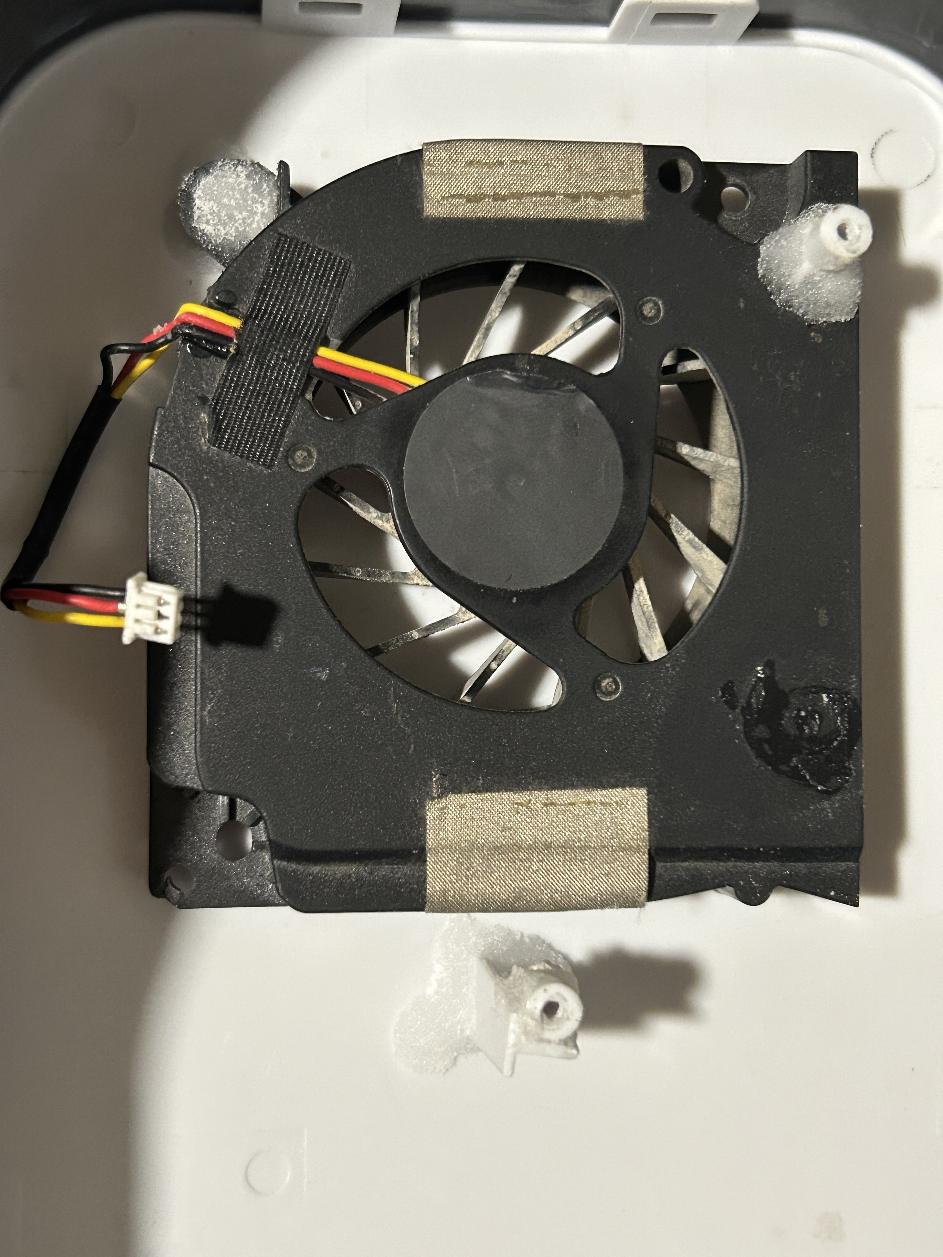

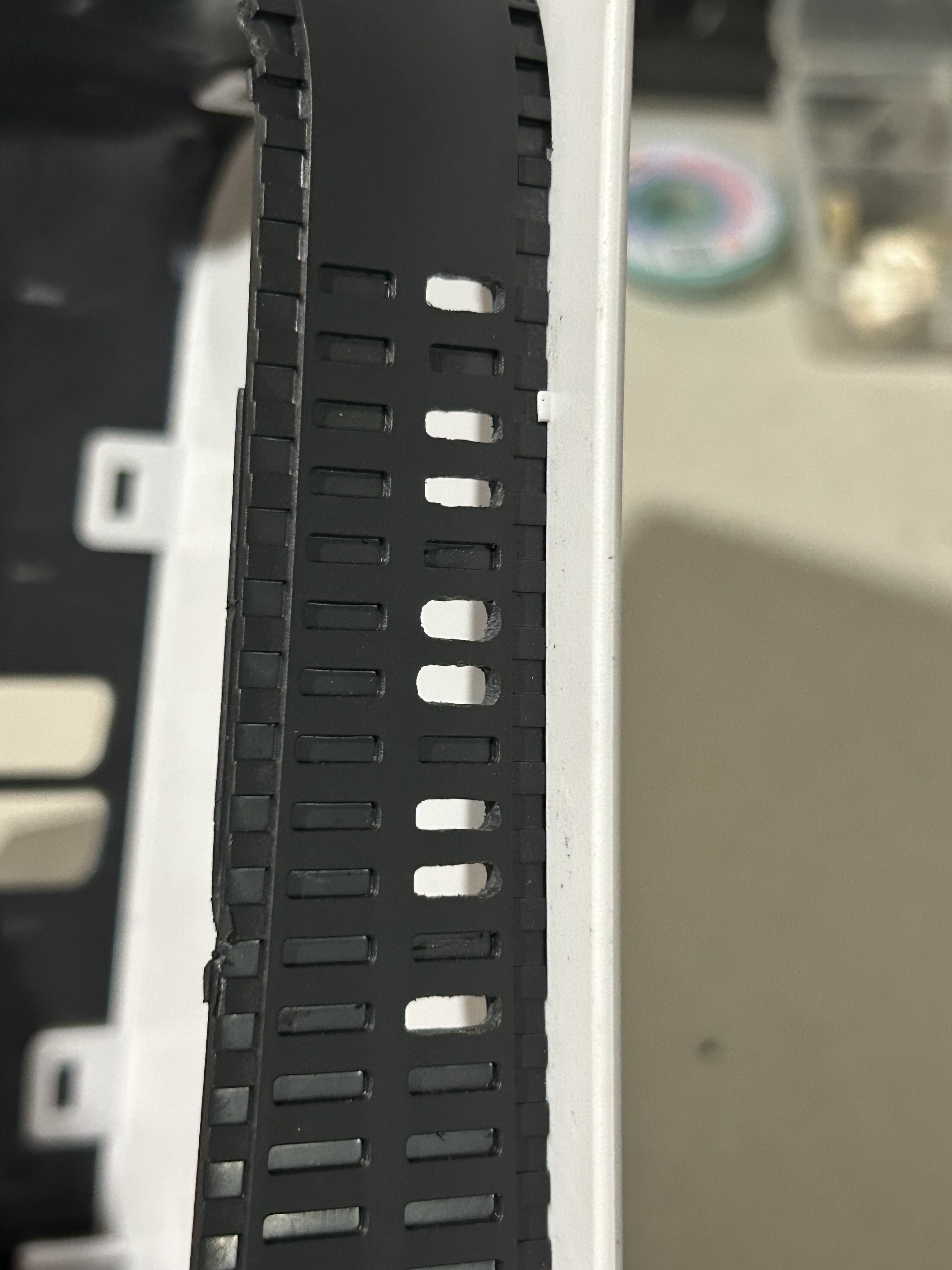

Drilled some rear "air vents" on the upper zone

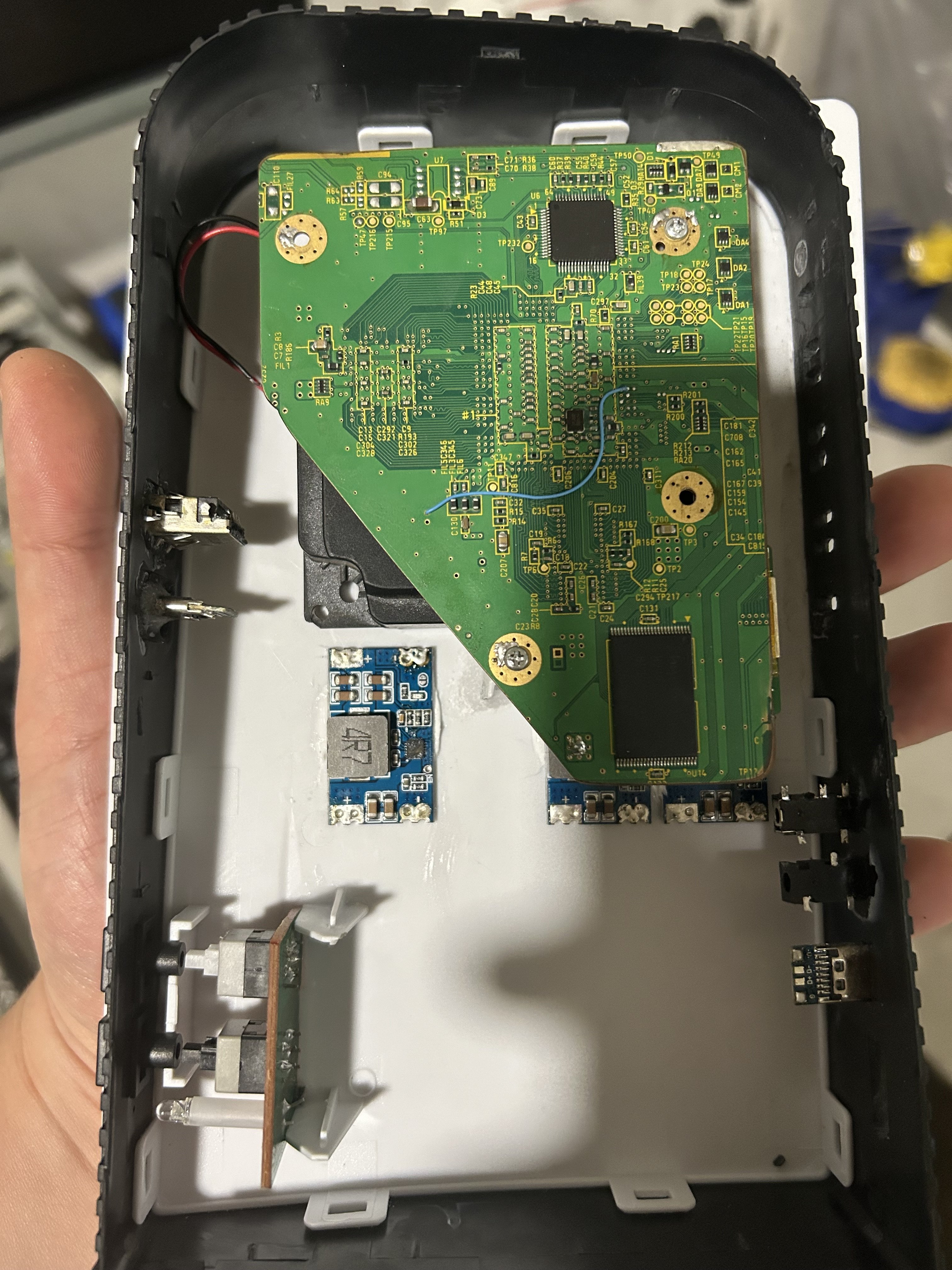

Glued the fan in place pointing to rear "air vents"

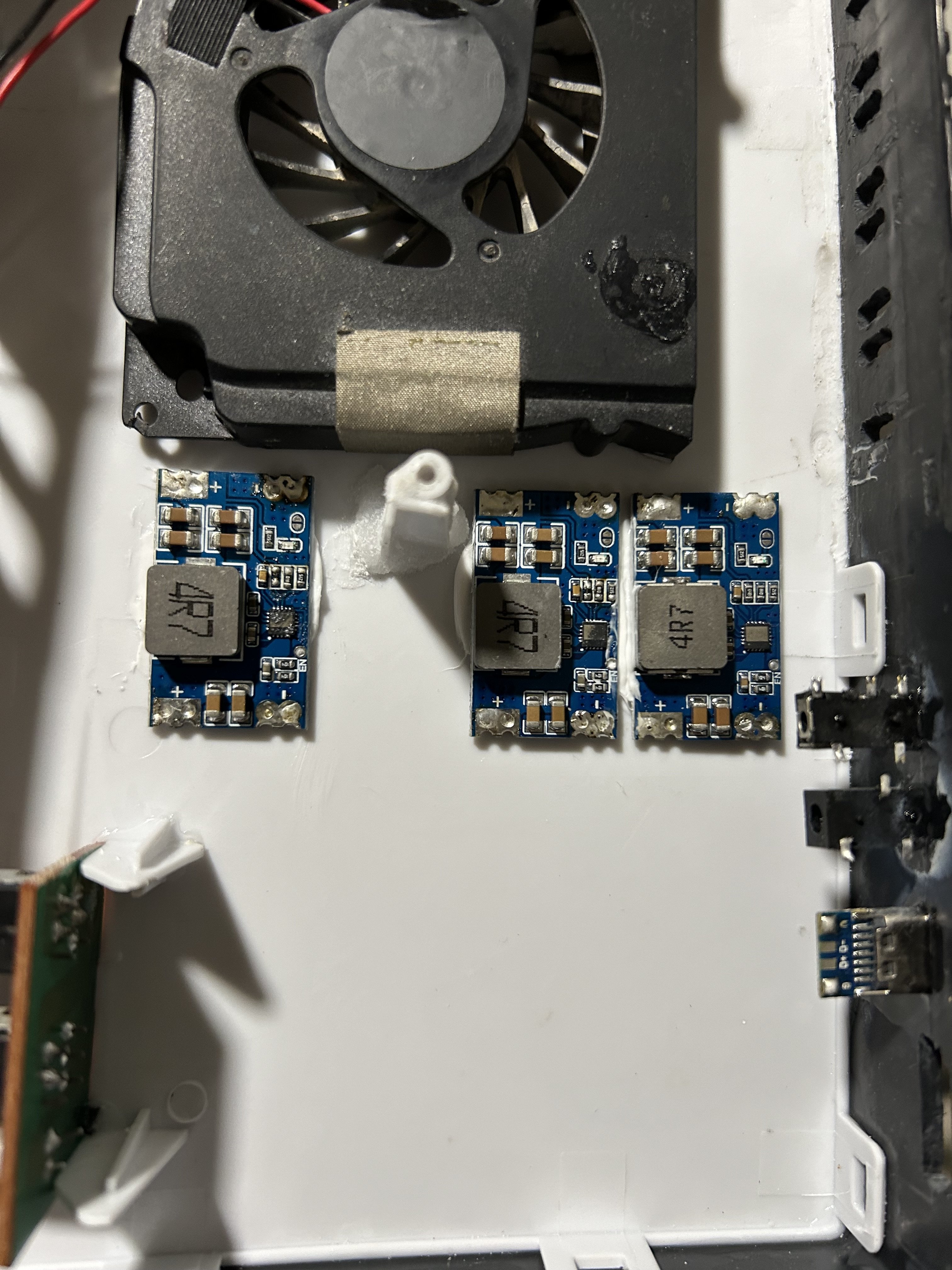

Added some supports for screwing on the Wii board (used recycled plastic parts that we saved from this console, the board will be set after wiring regulators)
Glued the regulator boards on place
I planned to use some custom regulators that I've trimmed from scrap CPU boards, but they couldn't fit on the "No custom boards" goal for this project, so I've used mini560 regulators (cheap, stable, and easy to buy, efficiency is not critical because this will be a tabletop console)

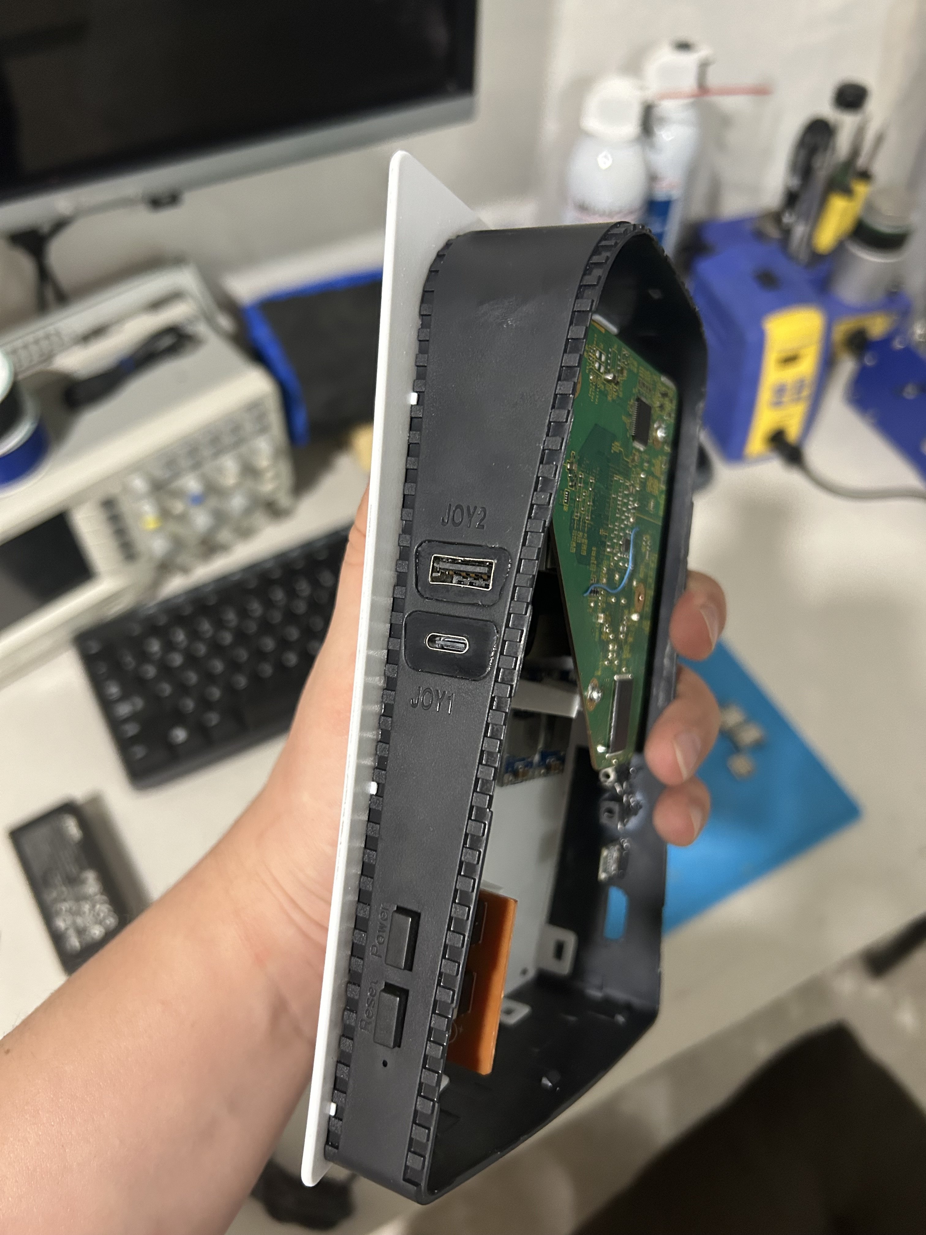

Finally, the USB ports were set in place
I've selected 1x USB-A and 1x USB-C since this is similar the PS5

-Maybe will make an air conduct between fan and air vents to prevent airflow flowing to wrong places
