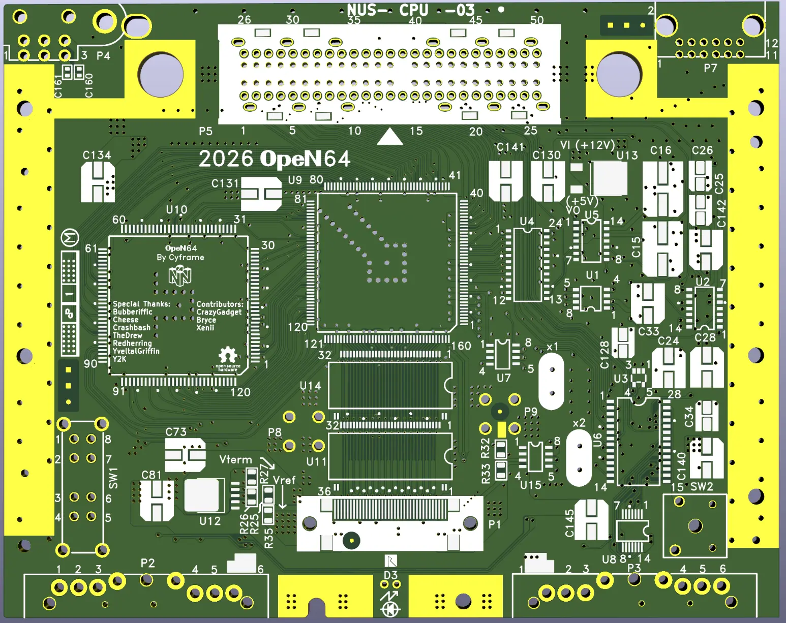

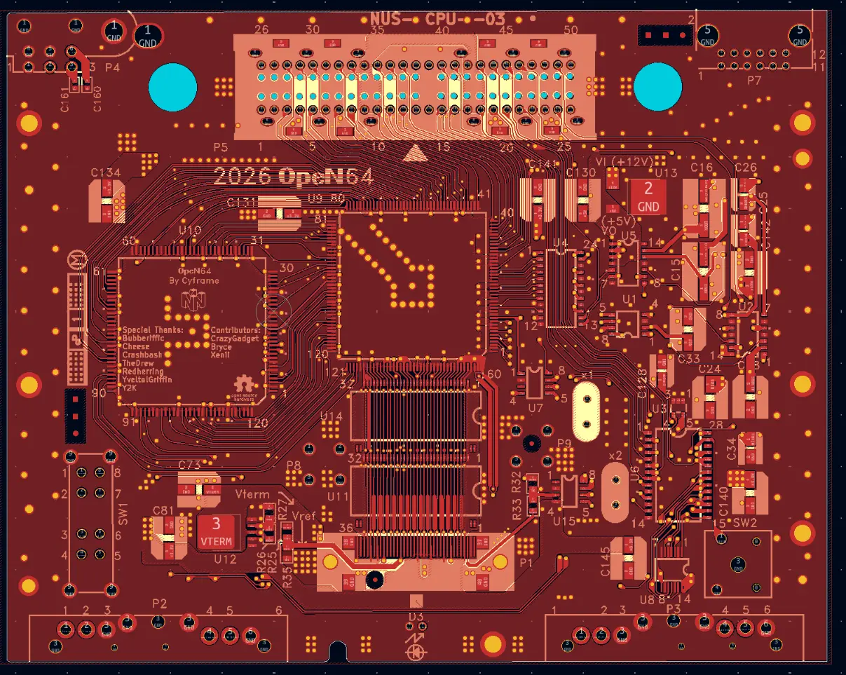

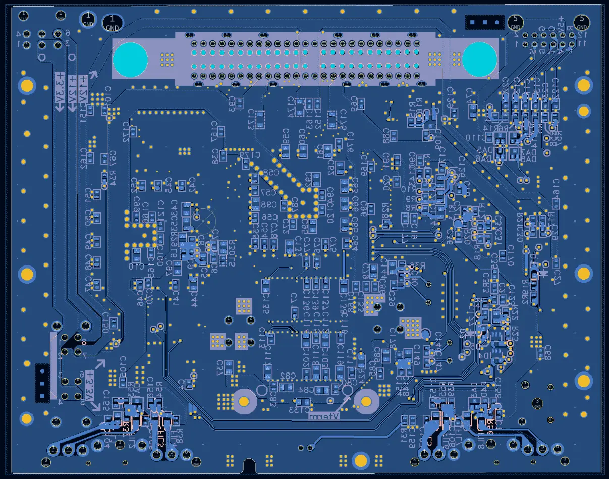

OpeN64 is essentially a 1:1 recreation of the N64 motherboard. The project was designed in KiCAD, and was made to enable and inspire N64 related mods. OpeN64 is based off the 03 revision of the N64 motherboard, but for most AIO portable type mods, motherboard revisions between 01 and 04 (05 may or may not be supported) should work.

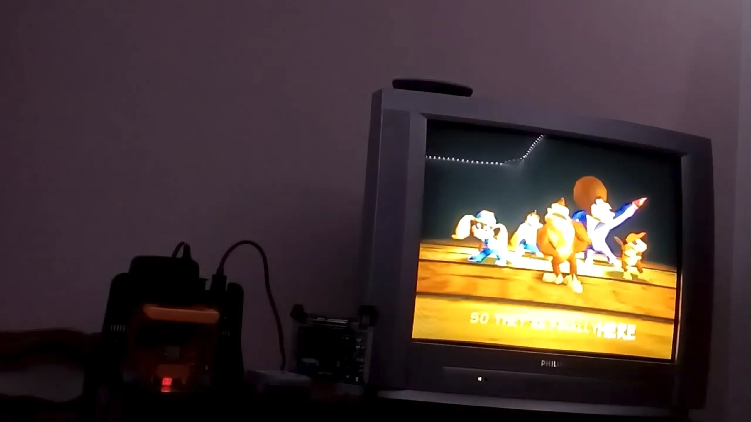

Here's a video I made covering OpeN64:

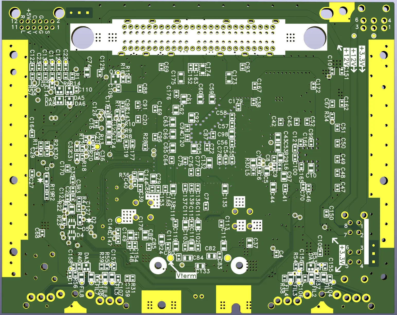

Here are some images covering the KiCAD view:

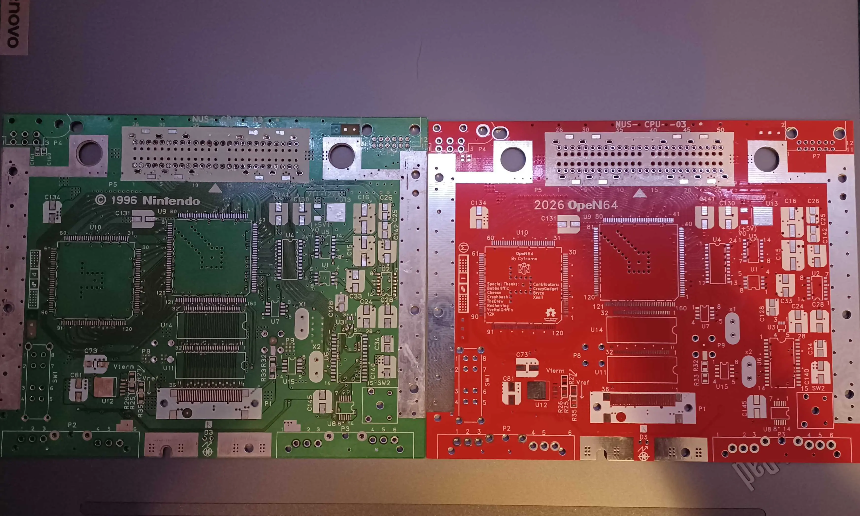

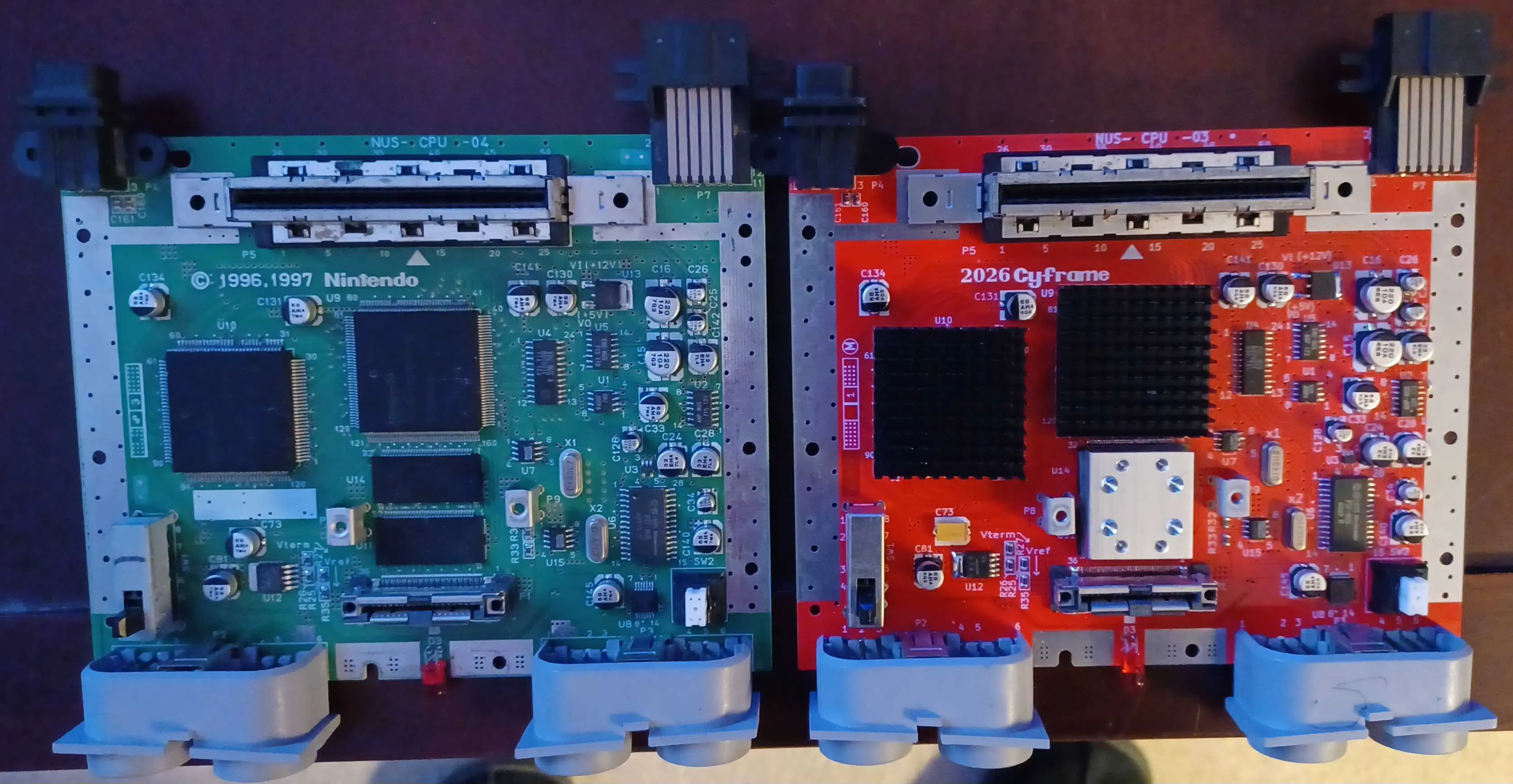

And here is a picture of the unit I assembled next to an OG board:

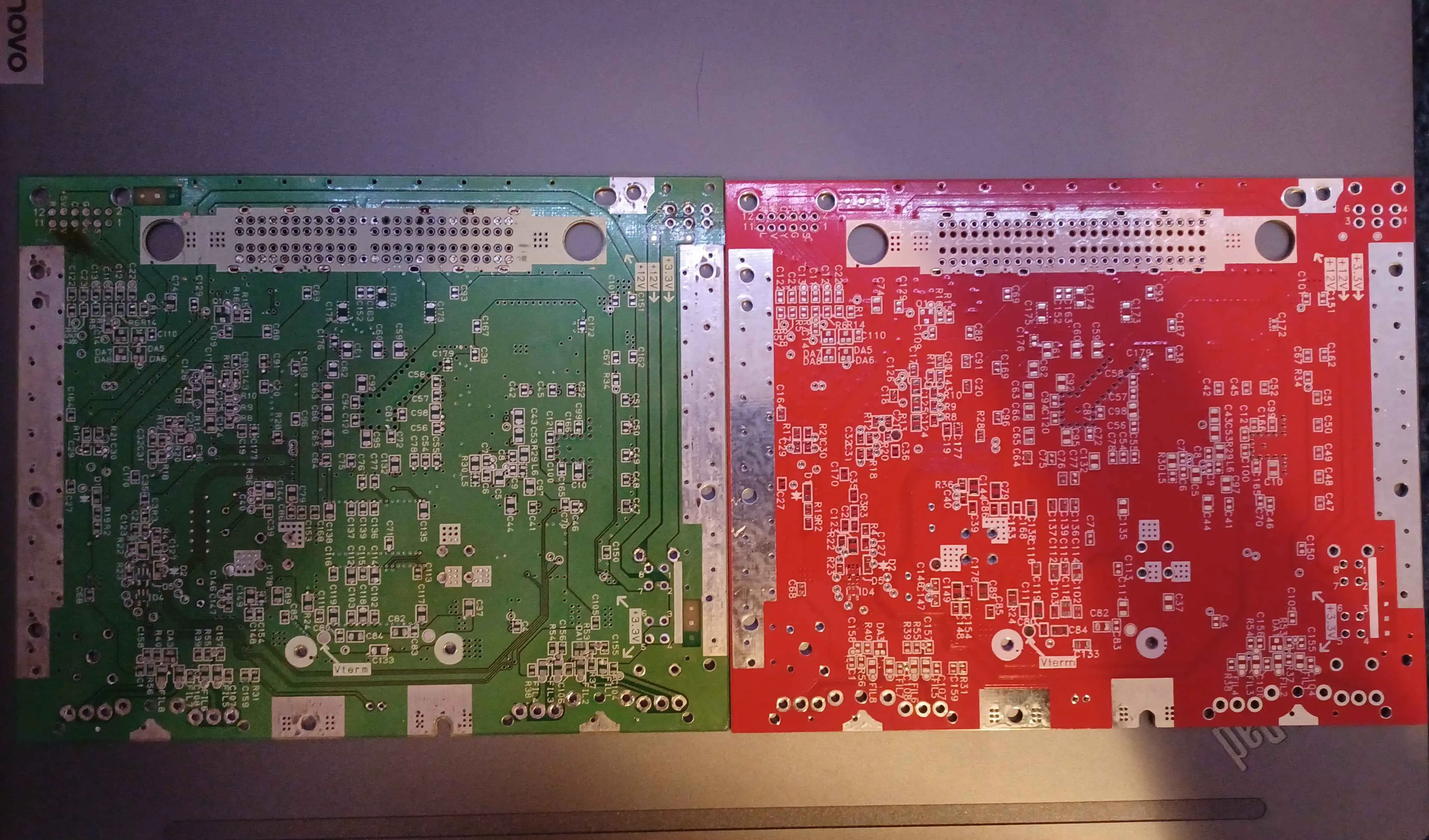

Here's a neat comparison between the newest revision of OpeN64 and an N64 motherboard with nothing on it:

I have put this unit through multiple 8-12 hour stress tests, I've regularly gamed on it for hours, and I have not yet seen a single sign of trouble. This may as well be an original unmodified N64 because that's all I've seen from it! I believe from the bottom of my heart that this project has been a wild success, and that any project based on it WILL work so long as no stupid changes are made to it. It is the original N64 board layout after all!
