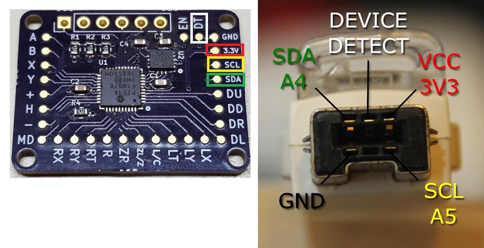

Please help with advice. I received PCBs on the oshpark.com. Soldered the microcontroller pic16f18876, resistors and capacitors.
I want to use this as a classic controller - what do I need to do to achieve this? I thought that it would be enough to connect the contacts to the outputs of the wiimote, run wii homebrew application and use "Update Classic+". But there they tell me that the CC+ is not found.
What am I doing wrong ? Maybe before updating I need to flash it somehow?
I used the following contact mapping:
GND - GND
3.3V - VCC
SCL - SCL
SDA - SDA
DT - Device Detect (not sure about the correct choice )
Is it correct that after installing all the parts on the board - EN and 3.3V became closed ?

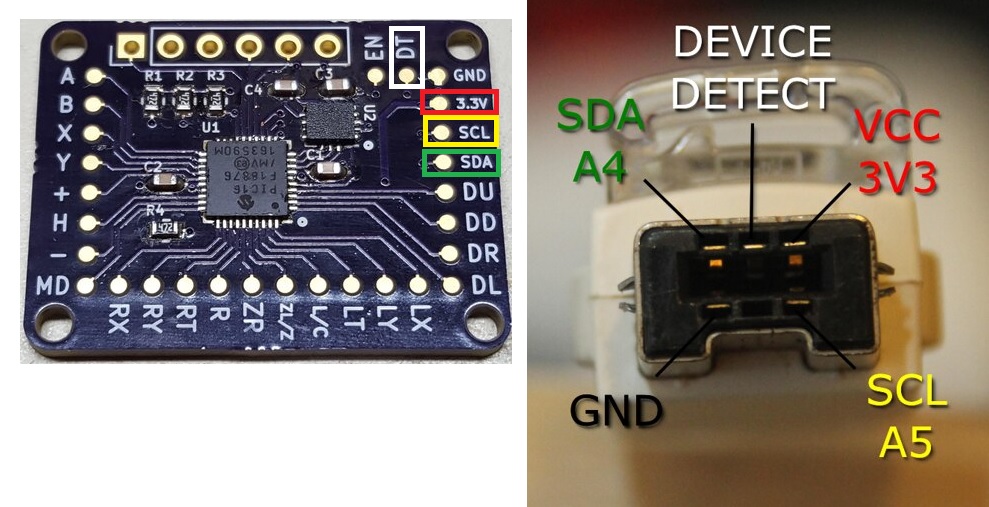

GND - GND
3.3V - VCC
SCL - SCL
SDA - SDA
Hey, your pinout mapping is correct. And yes, EN should be connected to 3.3V.
It looks like you may not have programmed the microcontroller initially. Before you can use the homebrew app, you’ll need to program the board using a PICkit 3. It connects to the board via the 6-pin header to the left of the EN and DT pins. The arrow on the PICkit should point to square-shaped pin hole on the board. Good luck!
Thanks for the quick help! I guessed that it was necessary to program through these contacts, but it was better to clarify.
Now it remains to purchase a programmer.
