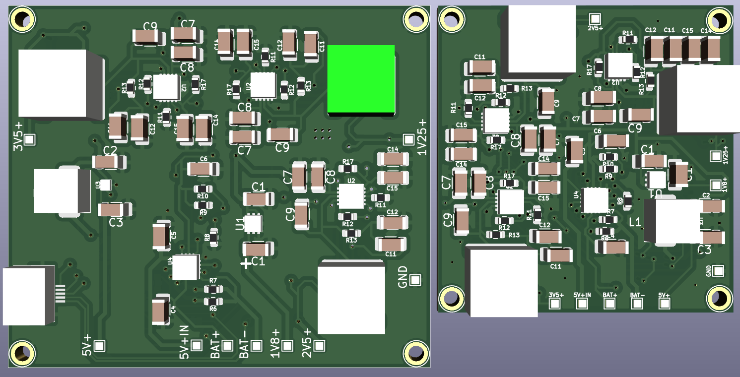

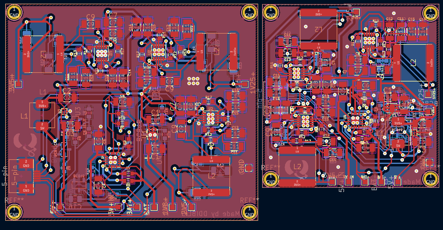

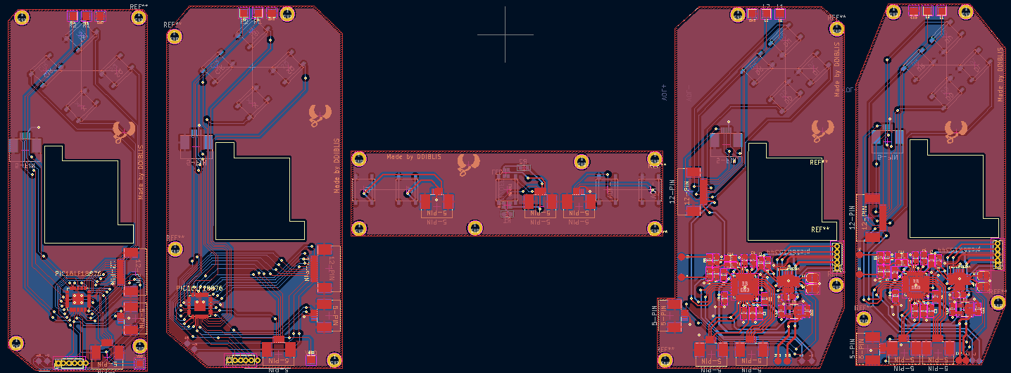

Alright everyone, time for an update... I've sunk countless hours into this over the last 3 weeks, and through that time I've learned a lot. So without further ado, I present to you the big small 3:
First up we have the ps2-pms:
Currently just need to find a 1uh 10mOhm inductor for the board that I like and it'll be complete. It takes in 5V through a BMS, charges the batteries, and has an internal VOUT for the rest of the regulators. It has a SYSOFF pin which cuts power from batteries but still allows charge when it's connected high, and allows power through when connected low, and for that, there is a latching power switch that will switch the signal high and low at the press of a button. To make it so there are fewer soldering cables hanging around I've decided to use a 5pin FPC connector for the ON/OFF switch and led lights. The BMS also has an optional charging led circuit which will be wired to BLUE.
There are 5 regulator circuits outputting at 1.25V, 1.8V, 2.5V, and 3.5V for the PS2, as well as a 5V step-up for the AV chip and USB-A circuit. And finally, a low voltage transistor cut that will power on a red LED when you have roughly 30 minutes of playtime left.

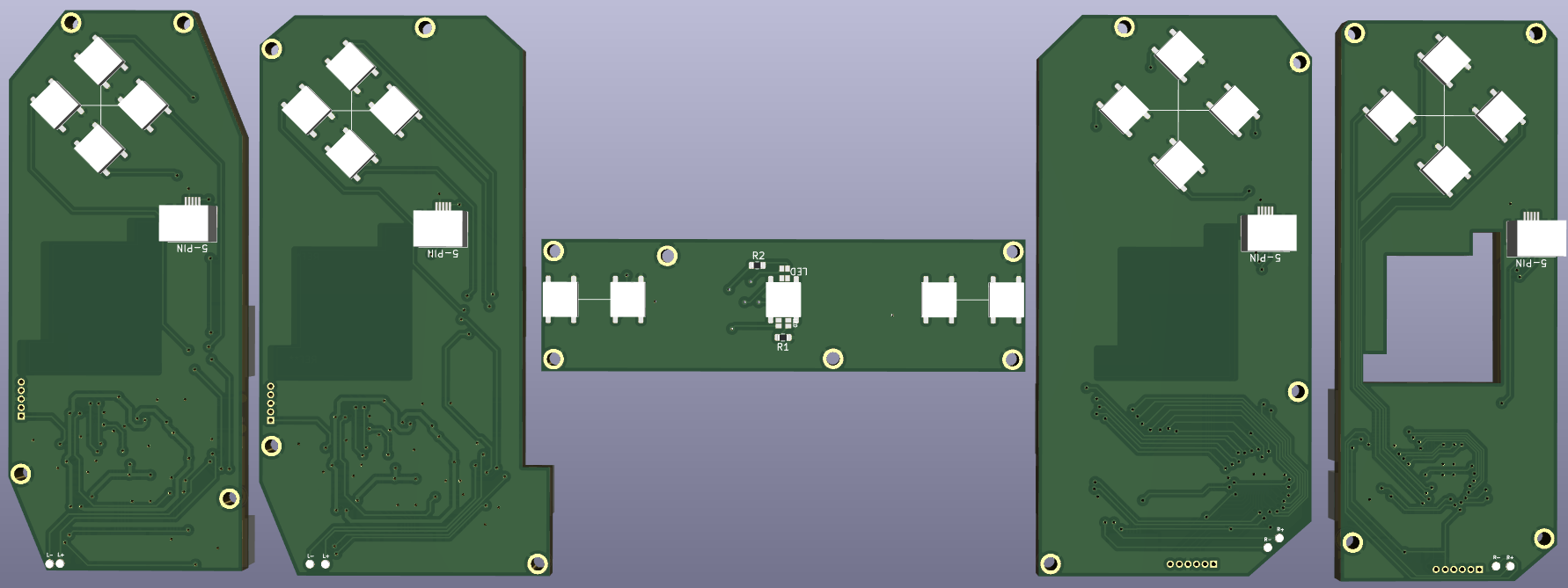

Next is the right controller PCB:
Housing the start, select, and action buttons, as well as solder points for the right speaker, and right shoulder buttons, but wait, what's that right next to the start and select buttons? That's the ON/OFF power button, but it's not just that. You know what I hate? LEDs sticking out of things, the ps vita has a home button that's transparent down the middle specifically for LEDs, so why not add them next to the button and have a nice and clean-looking indicator? It also houses a modified chip footprint since the original one in GMAN's files was unavailable to purchase. Same chip, smaller footprint. And a twelve-point connector for the...
Left controller PCB:
Simple enough face, joy-con connector, directional buttons, but with the addition of custom-designed vol+, and vol- buttons conveniently on the face. And the rear houses the UAMP, the left speaker solder pads, and the left shoulder button solder pads.
And for my crowning achievement, the USB-C plug:
usb-c-adapter final.pngusb-c-adapter-front-final-3d.pngusb-c-adapter-back-final-3d.png

Great work on all the pcbs they look beautiful, hopefully more people will start building more ps2 portables soon.

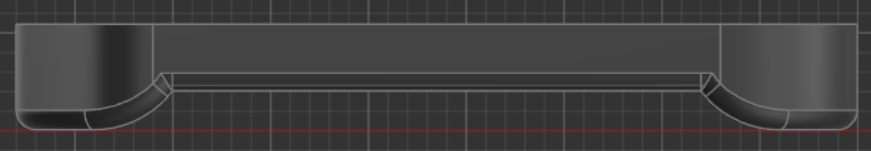

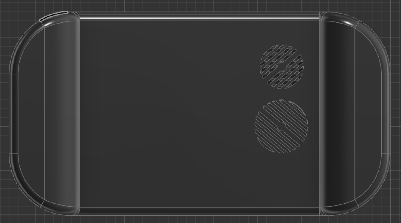

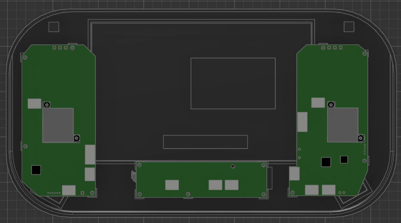

The case is simple enough, I'm not much of a designer though I'd love to have the battery parts thicker and the rest thinner on the bottom side of the case but I have no idea how to do that, so eventually I'll get to doing that if I figure it out.
The case is 3cm thick at the moment which might actually be too small to be comfortable for long play sessions. the fan and heatsink design is really basic and I'm playing around with the idea of having a cooler looking design for the fan intake, we'll see what I decide on.
The bottom of the case is pretty empty and will keep being empty because i designed the entire portable to use ribbon cables (other than the power lines). I added a headphone jack to the usb-PD board for cleanliness but still have the original files without the headphone jack in case people are interested in the smaller form factor. And it uses 2 21700 batteries running in parallel for 10000Mah at 3.7V.

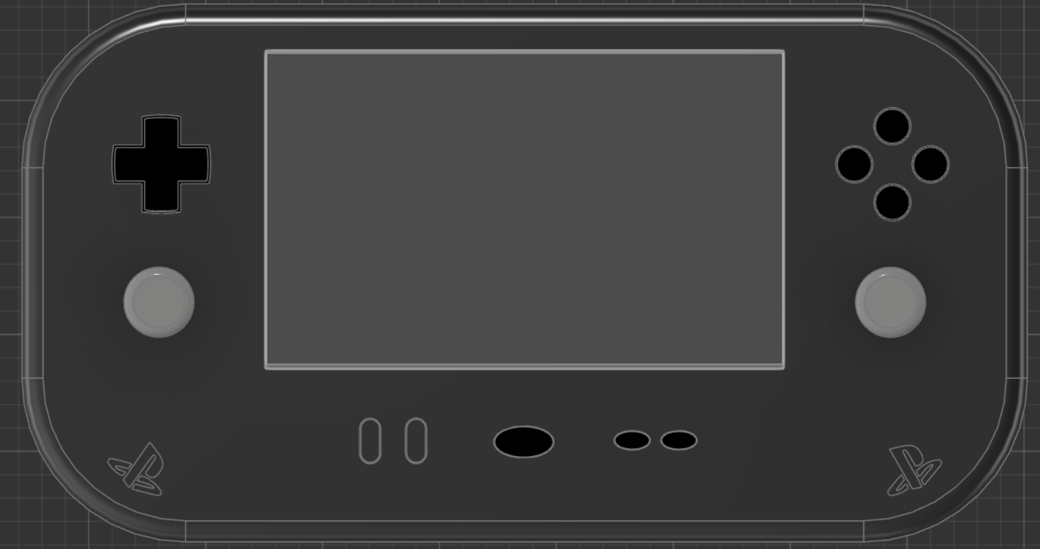

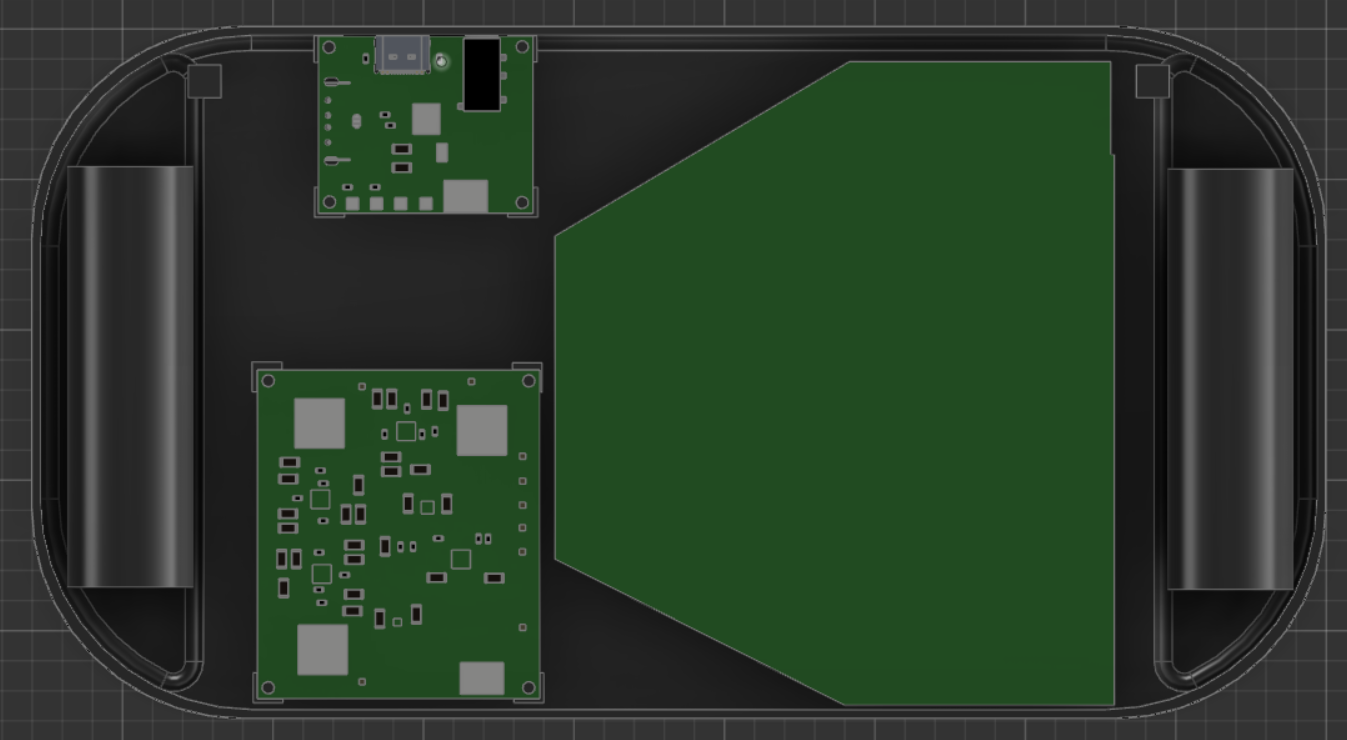

The top of the case houses 3 custom made PCBS (I made some small changes to the ps2+ board I posted before due to clearance issues in my case) The right side houses the ps2+ chip and a few buttons along with 4 ribbon connectors for the controller, and for connectivity to the joycon and other sides of the board.
The left side houses the UAMP chips along with the connectors necessary for the joycon and connectivity to the other boards.
On the front, the speaker grills are made in the shape of the ps logo, with a power button smack in the middle of the case, the start and select to the left of it, and the vol+/vol- being on the left side.

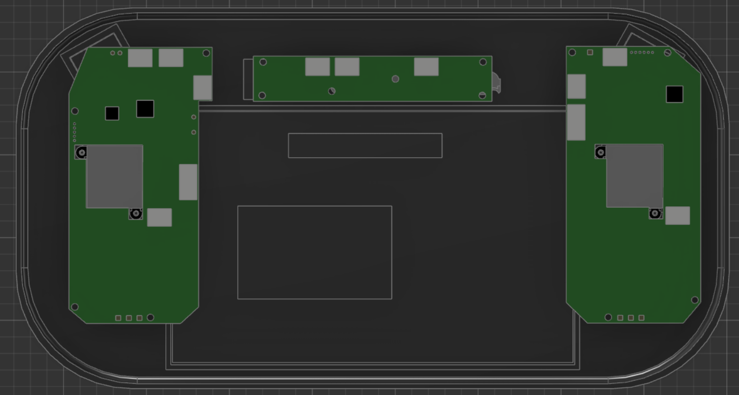

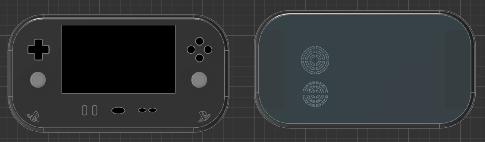

Alright guys update, you know what doesn't make sense? Spending literally weeks designing and perfecting the PCBS and then clobbering together a quick square with filleted edges as the case design. So fuck it, I spent a few more hours on it. Case 2.0 it is. It's not original, it's dumb, my 3d printer will be going through hell trying to print this thing, might have to slice it into several pieces and epoxy it, or maybe have PCBway print it in clear for me (if I have the money) but here's the better design. (There are no screw posts for the top and bottom halves because I'm designing it to be snap shut fit)
First is the boring part with barely any changes,
Two tiny posts which will pressure fit a switch against the button, I've tested this model before it seemed to work pretty well, if anyone has any better design tips for those things I'd be happy to take a look at it because I haven't figured out a smarter way to do these stupid things.
The bottom now more resembles the fan grills I used in my first portable which in my experience were a lot easier to sand and my printer had a lot less trouble with printing clearly, as well as the benefit of not actually being able to see through the grills all that much.
The bottom of the case now has 2 side areas which double as battery compartments, and a good way to hold the portable so that your hands don't cramp from the projected 7 hours of playtime this thing should be able to get.
And here's the top view of the same compartments. I'd rather avoid soldering the batteries (and buying a tig welder) so I'll be looking into making a pressure contact point in that area for the batteries. And the same 2 little dumb posts for the L2, R2 buttons. I don't remember how the hell I designed the shoulder buttons last time and that's a problem for tomorrow's version of me. But I'm on the final stages of design.
I'll be finalising everything within this week, I'll be sending the PCB out to be ordered by thursday and sending them to a buddy of mine for testing, once I get the all clear I'll be making them public.

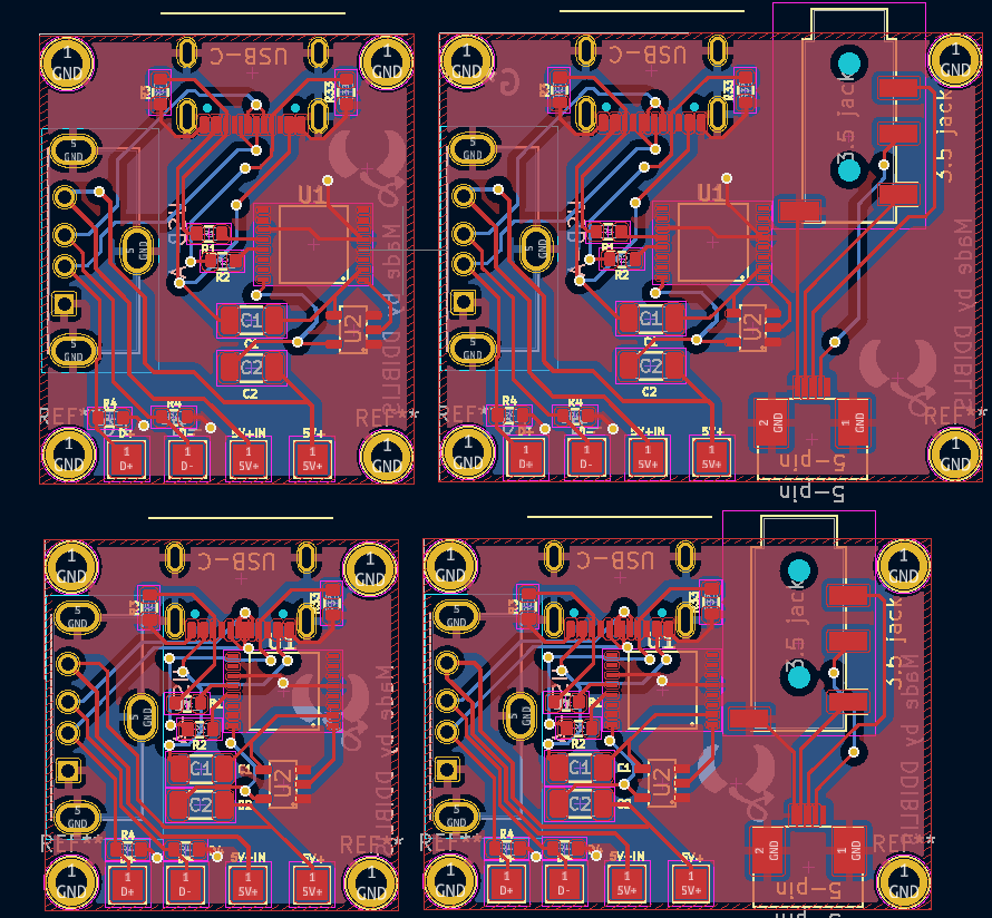

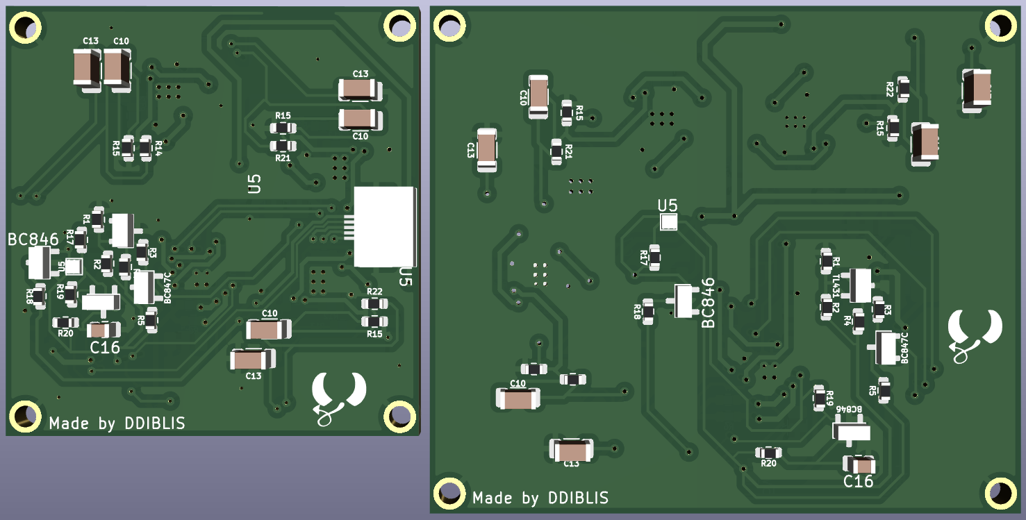

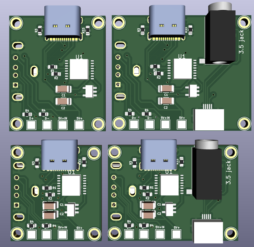

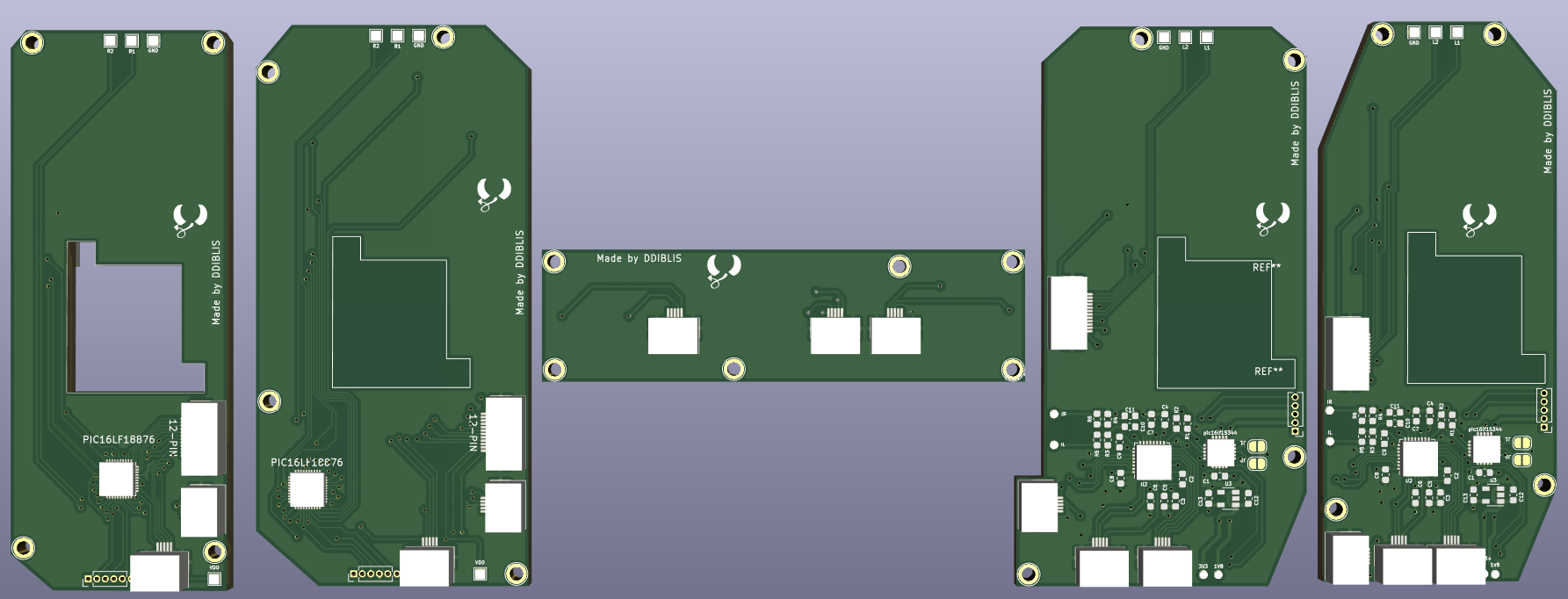

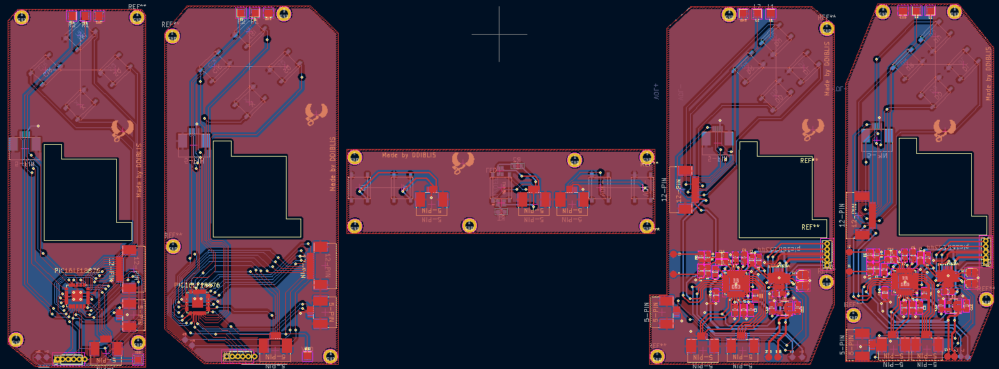

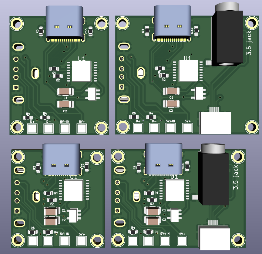

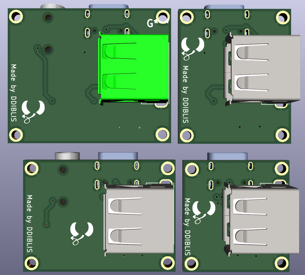

So I've been waiting on chips, ICS, microcontrollers, components, and who knows what else, I've lost count, for over a month and I pretty much ran out of things to test without the board being ordered, which I don't want to order before I have the money to buy the hot air station (Don't judge me my brain works in stupid ways) But so I decided to rework a few things.

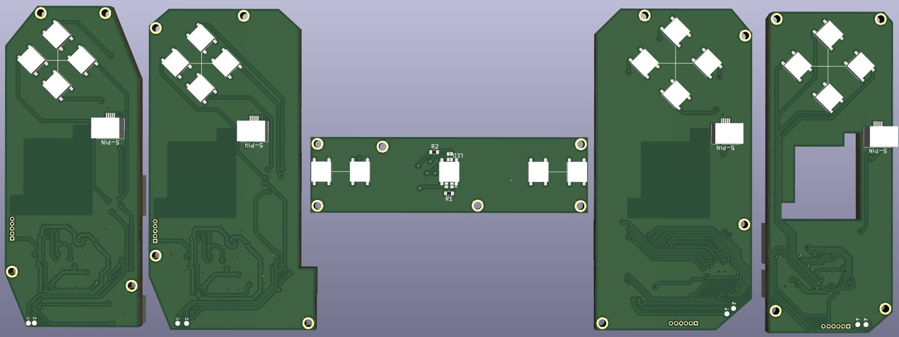

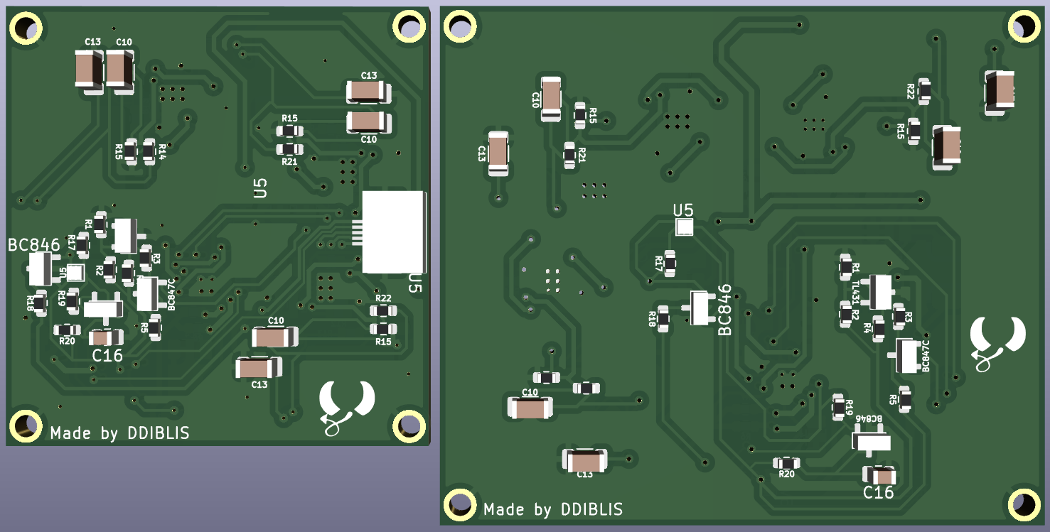

Not much of an explanation is necessary, same functionality, same chips, just compressed things and eliminated dead space while making sure that all nets were correctly connected.

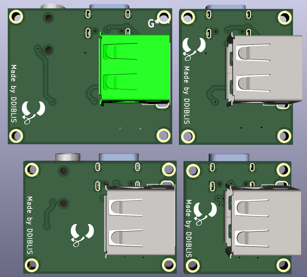

USB-C board with a headphone jack and without, older is on top:

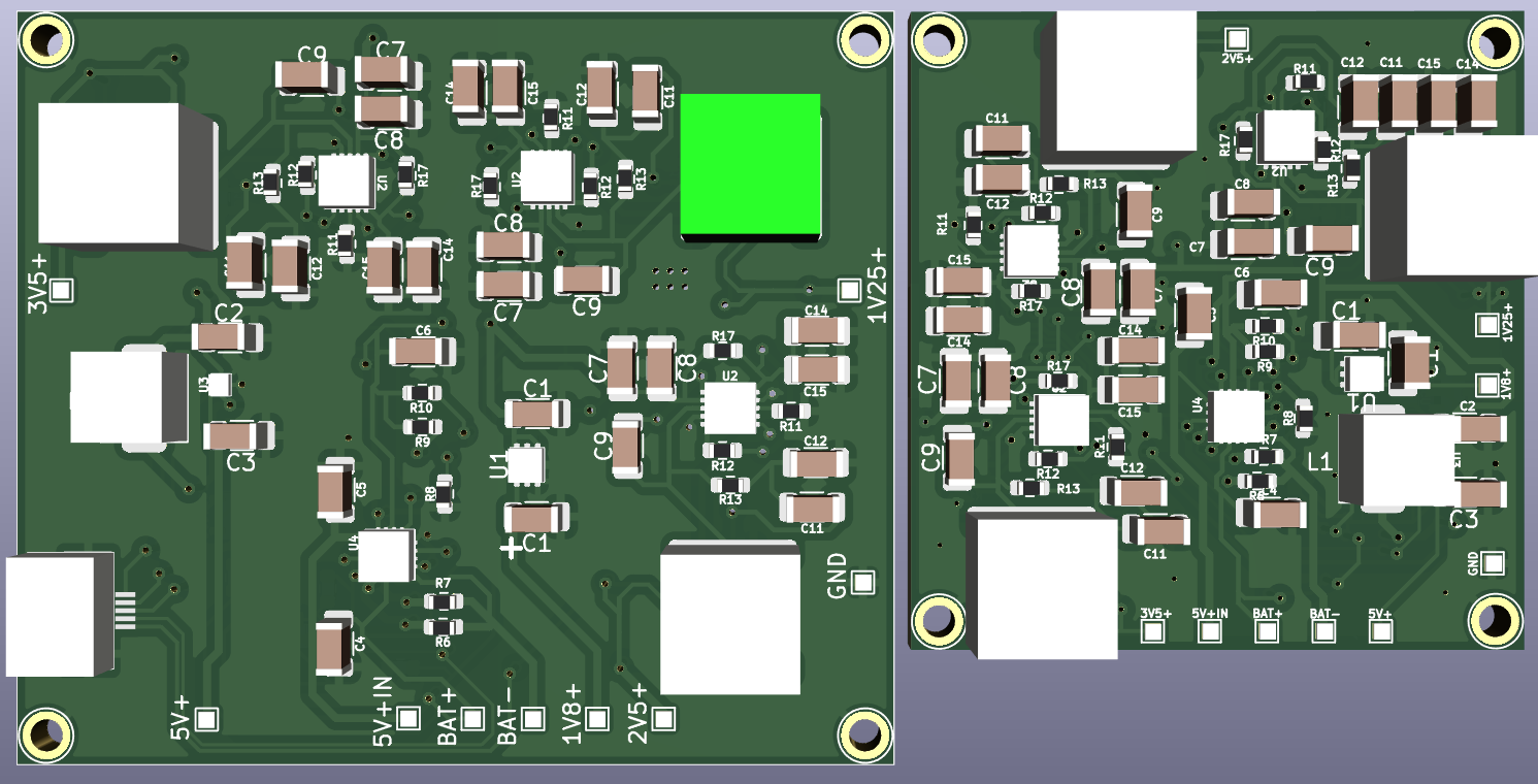

PMS: Older is the bigger one
Controller boards: middle one is for start, select, volume, and on/off:
I'll rework the case a bit for the smaller PCBS and order them soon. Once I'm happy with all of it I'll print the case and update here with the links to the PMS and USB boards.

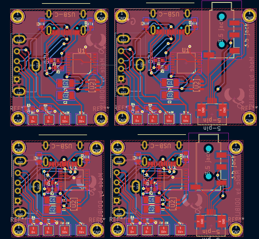

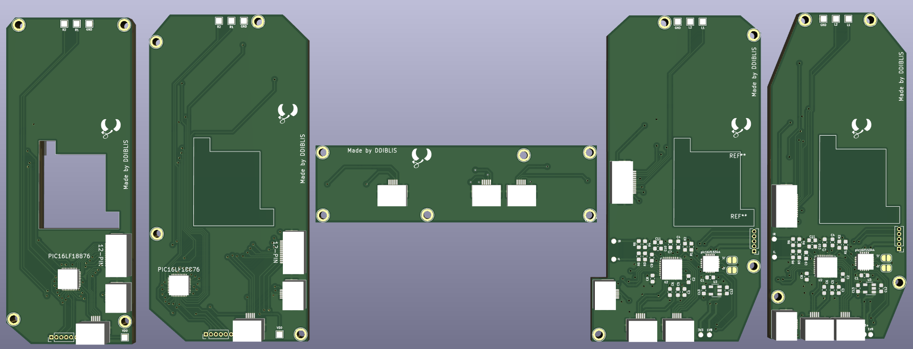

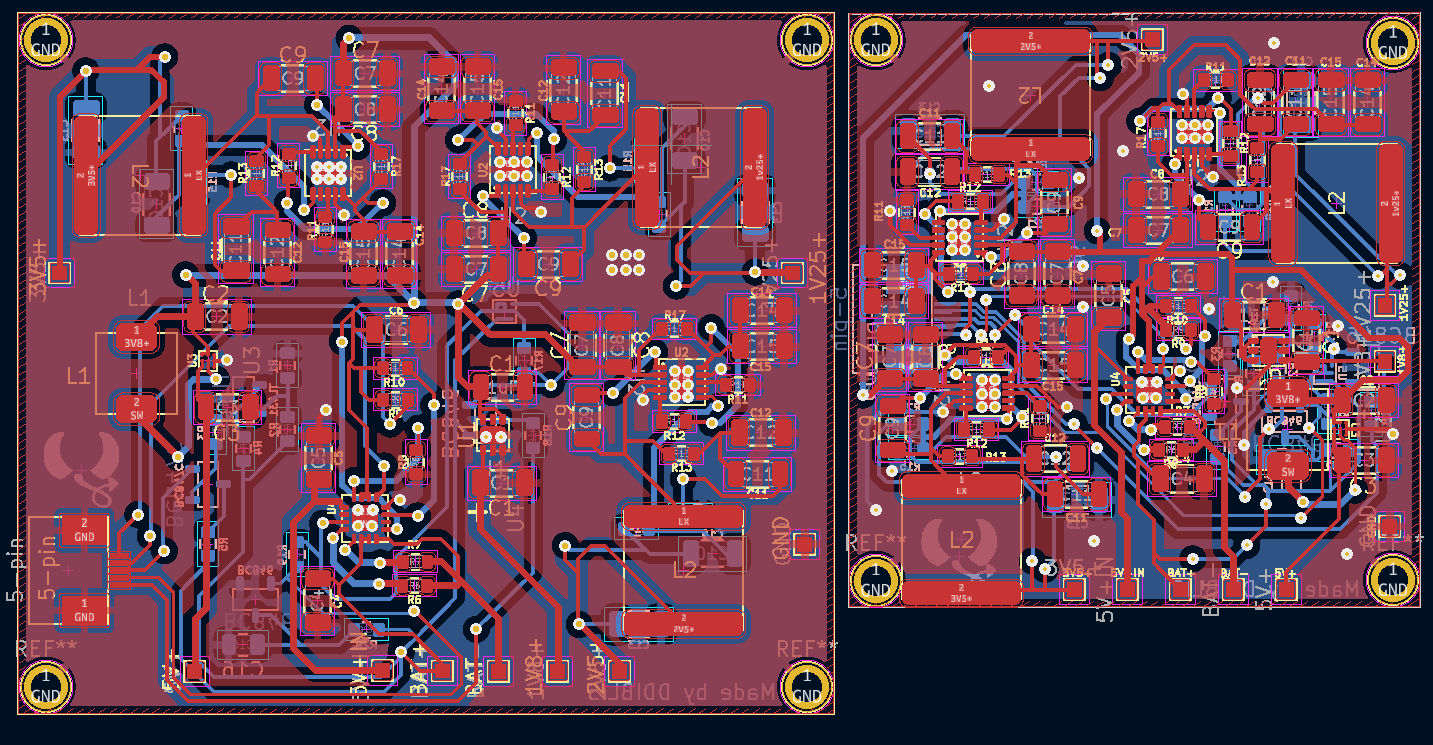

View attachment 22750View attachment 22751View attachment 22752
View attachment 22753View attachment 22754View attachment 22755
Controller boards: middle one is for start, select, volume, and on/off:View attachment 22756View attachment 22757View attachment 22758
They look cleaner I like them, hopefully they work out great with no issues Great work
