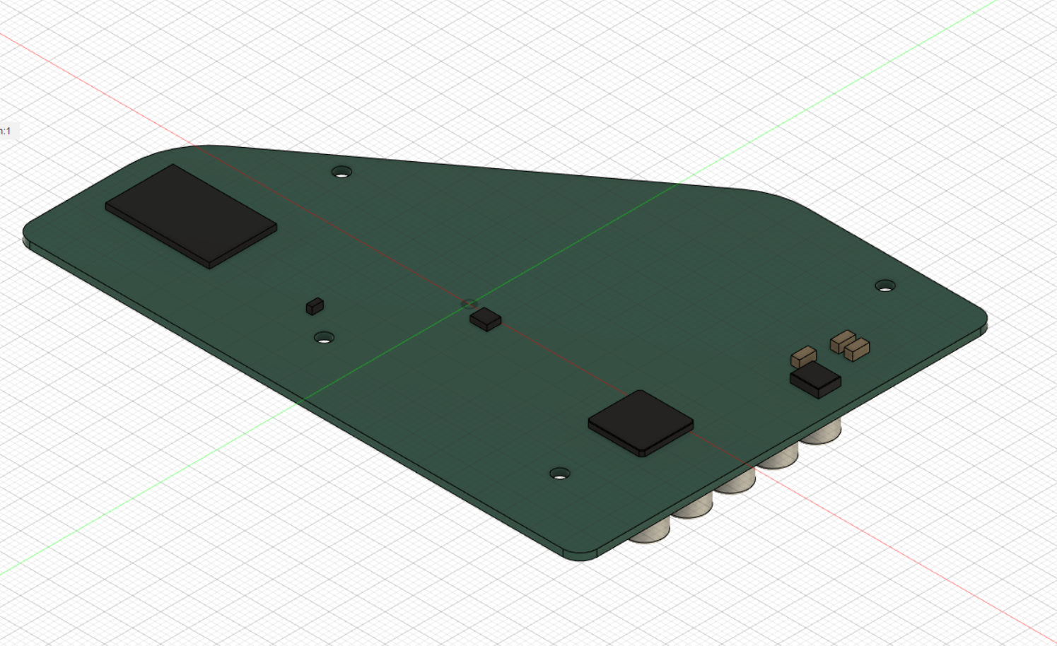

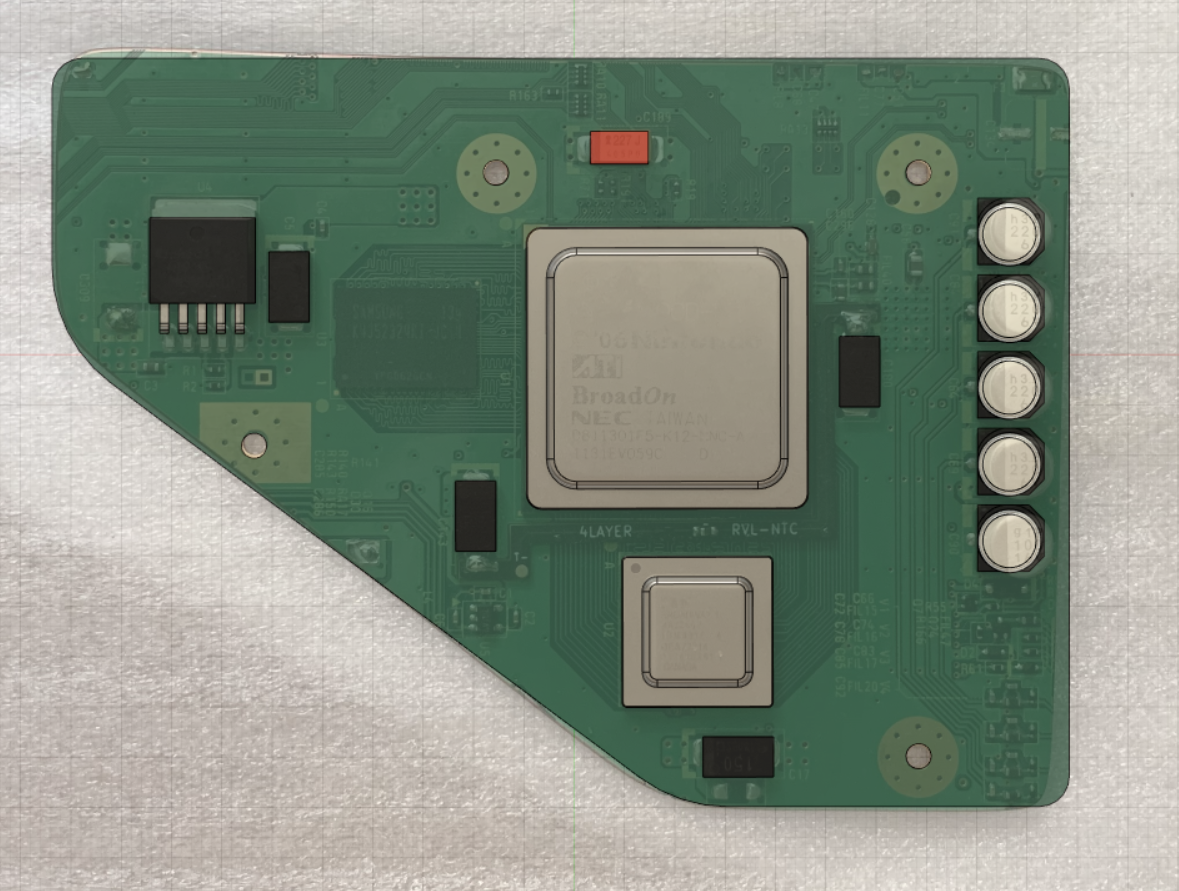

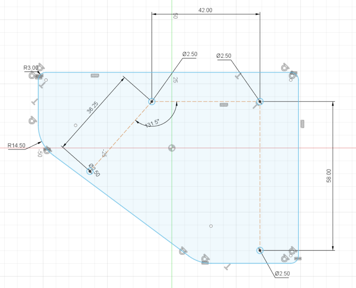

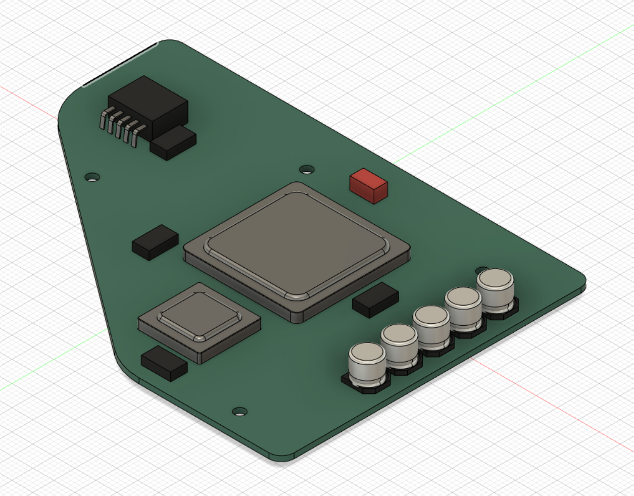

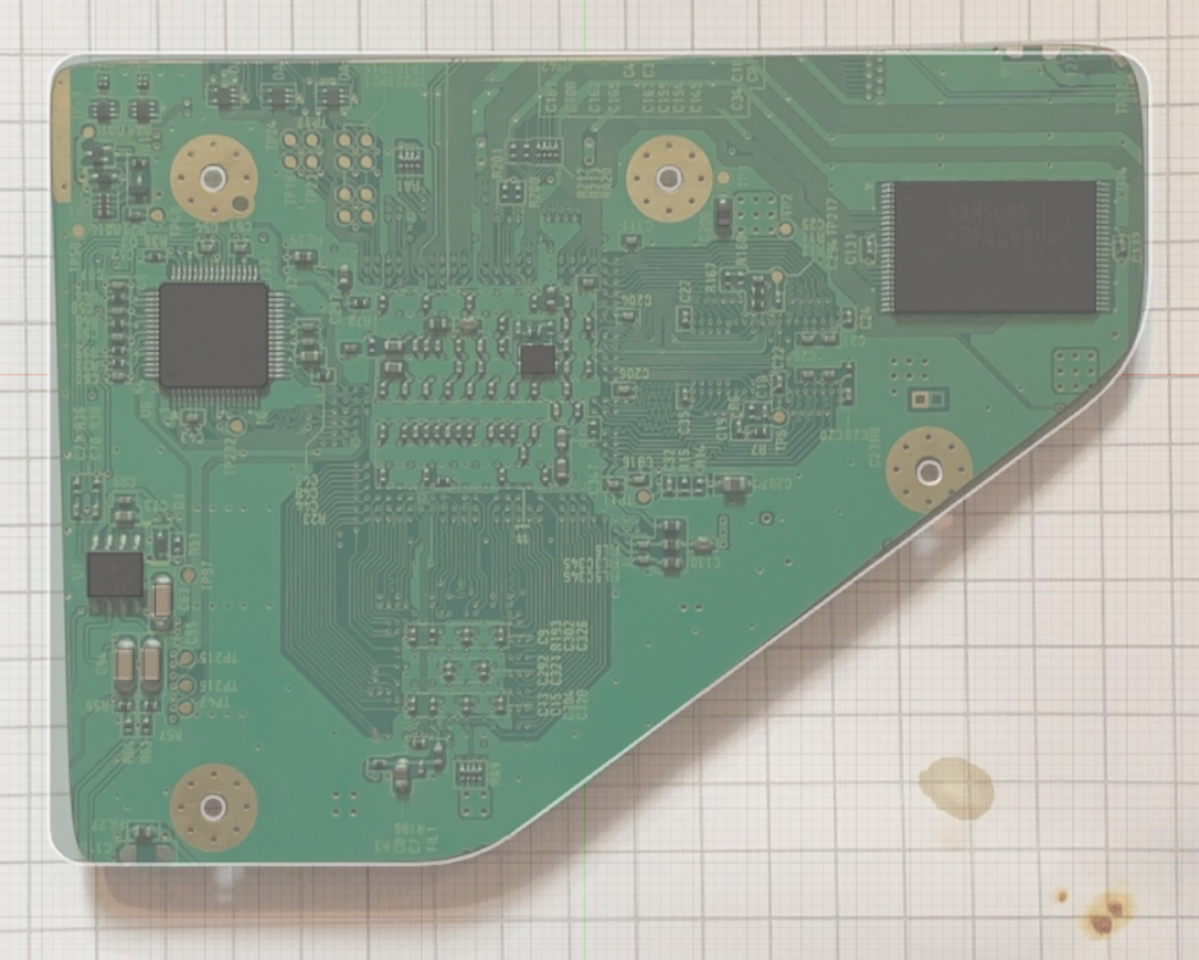

Hey all, I modelled my OMGWTF Trim (RVK-CPU-01) before I realized there was already a central repository for such models. I verified the hole spacing against @jefflongo 's model and can confirm it matches. The GPU/CPU maaaaay be ever so slightly different but not enough to make a difference if using it for reference. Figured I would dump it here in case anyone else wanted a model that included some extra components.
For reference: The three main 2.5mm bolt holes are 90deg apart and spaced 58 and 42mm apart. The 4th is approx. 131.5deg and 36.25mm from the 3rd hole on the left. If I have got that wrong and anyone knows the exact dimensions HMU.
