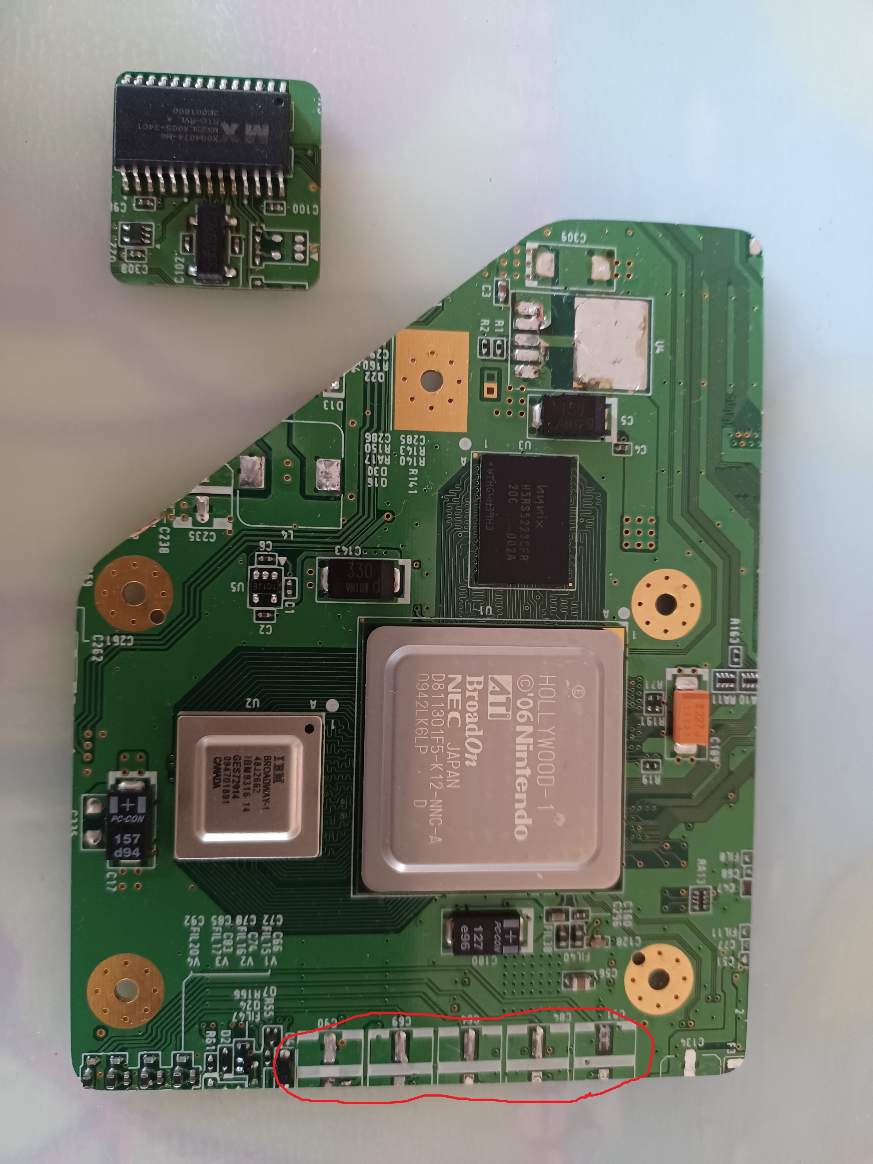

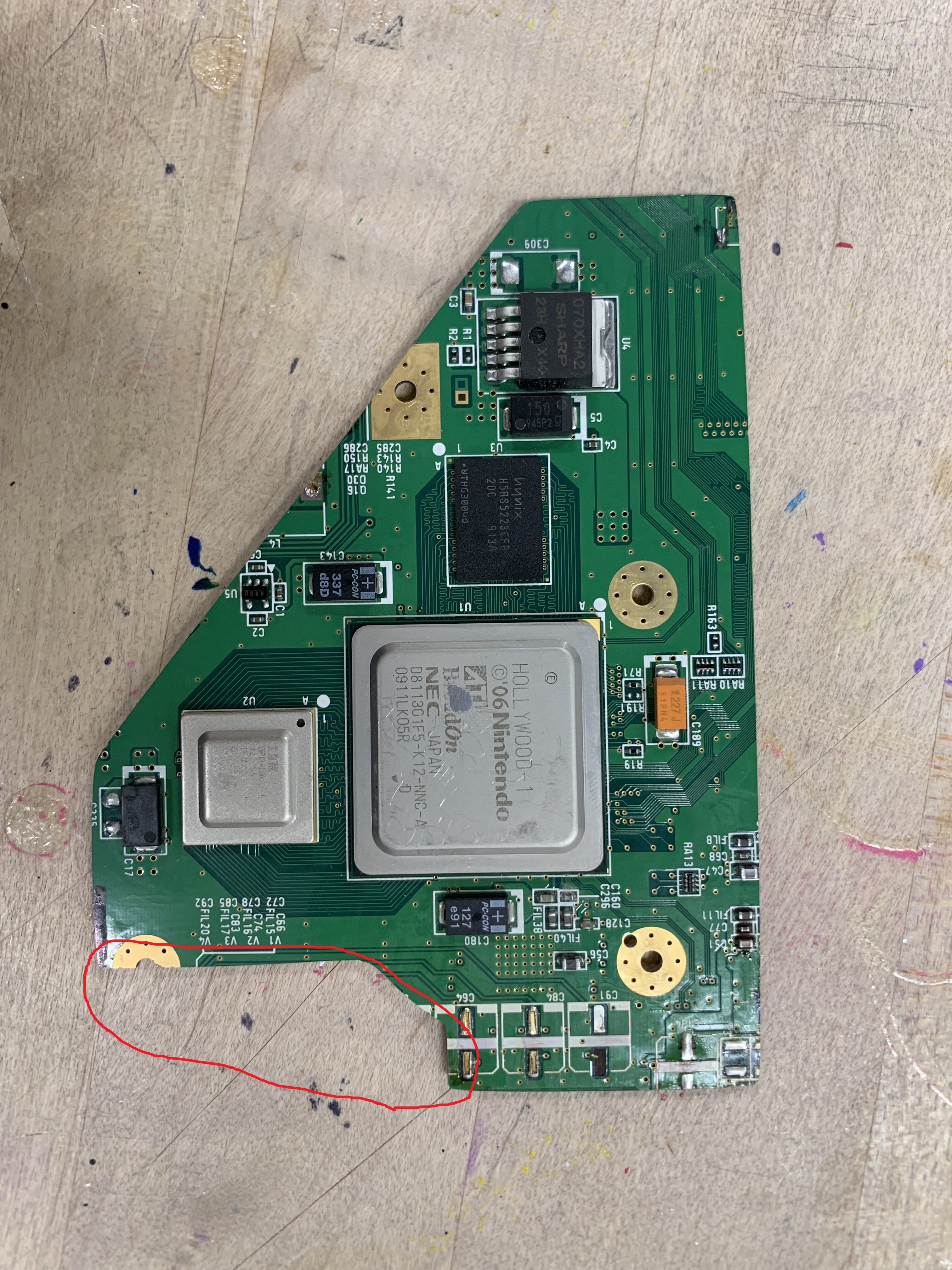

Does anyone knows which is the minimum trim size for a OMGWTF trim? NOTE: without relocating NAND or AVE

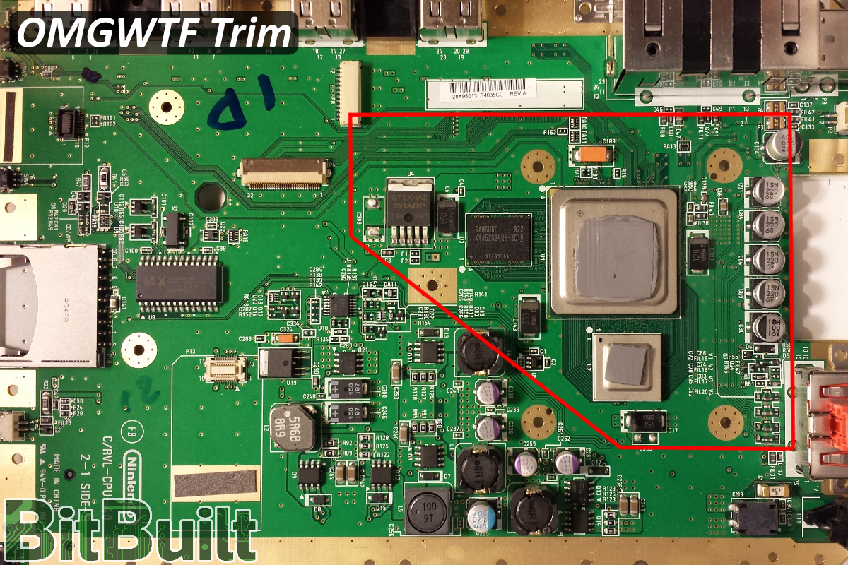

I know that The Definitive Wii Trimming Guide indicates the trim size with red lines, but I saw some trims on this forum that are smaller than the size indicated and seems to work:
The pictures I saw in this forum:
If anyone did some experiments with trimmed boards, hope can help me...
Thanks in advance
you can cut closer on the AVE side just have to be wary of the AVE lines (you also will cut out some easy-to-use Vias). Plus, the top trim line is defined by the NAND traces so if you really wanted to you could follow their outline and then as long as you're doing either wireless U10 or emulation you can cut a lot closer on the diagonal. I think that's about it though. Honestly outside of cutting closer to the AVE, which is even marginal at best, there's no real trim savings that save enough space to make it worth it to deal with the inward cuts and all the trouble of not having straight lines.
A lot of the older OMGWTF trims are going to try and save the Composite pads for easy soldering but they're not necessary.
I would suggest playing around on the compendium to figure out what trim would work best for you!
