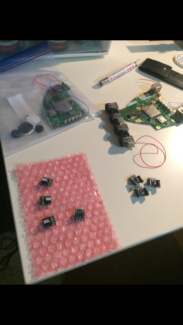

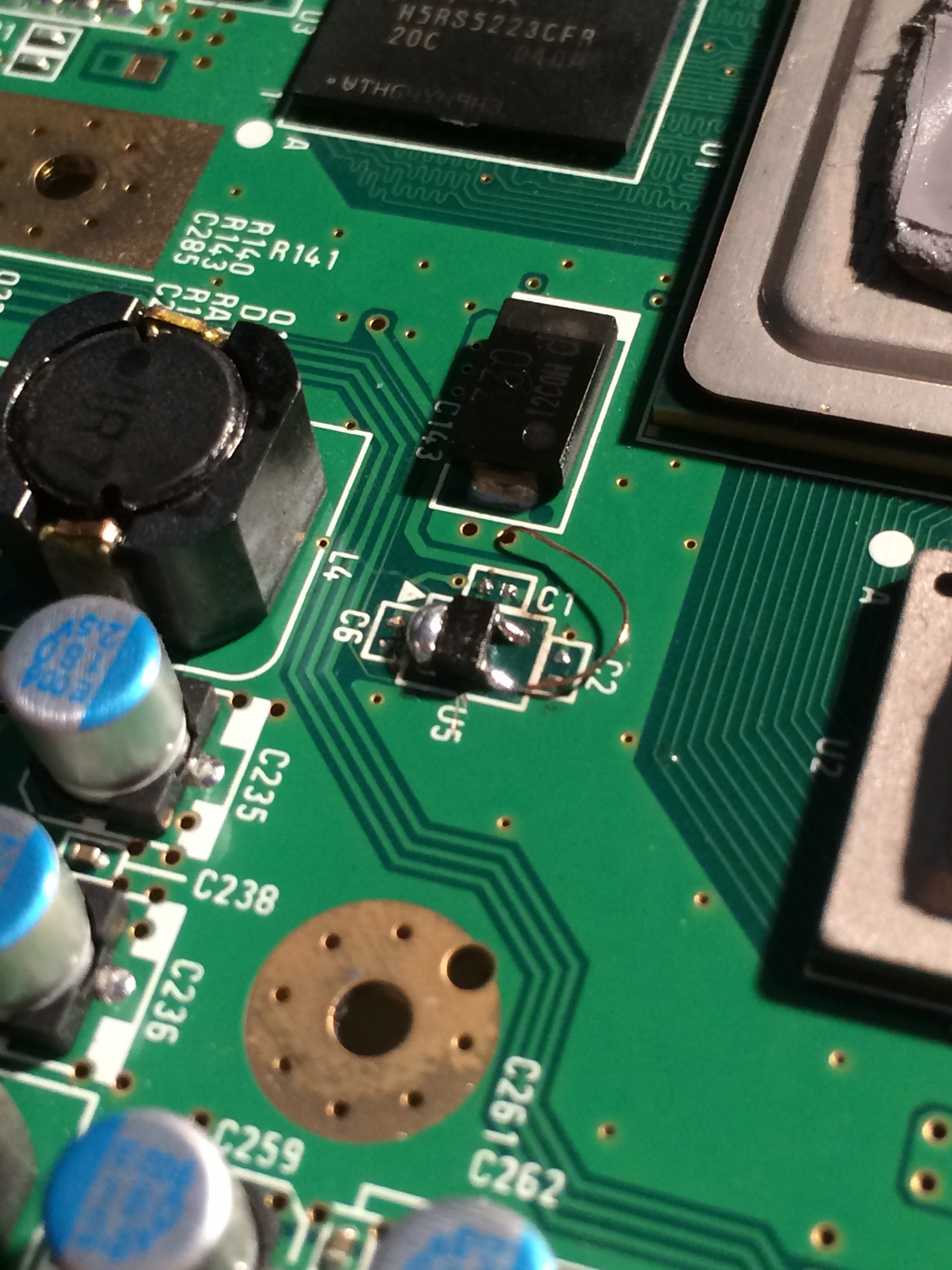

U10 relocation:

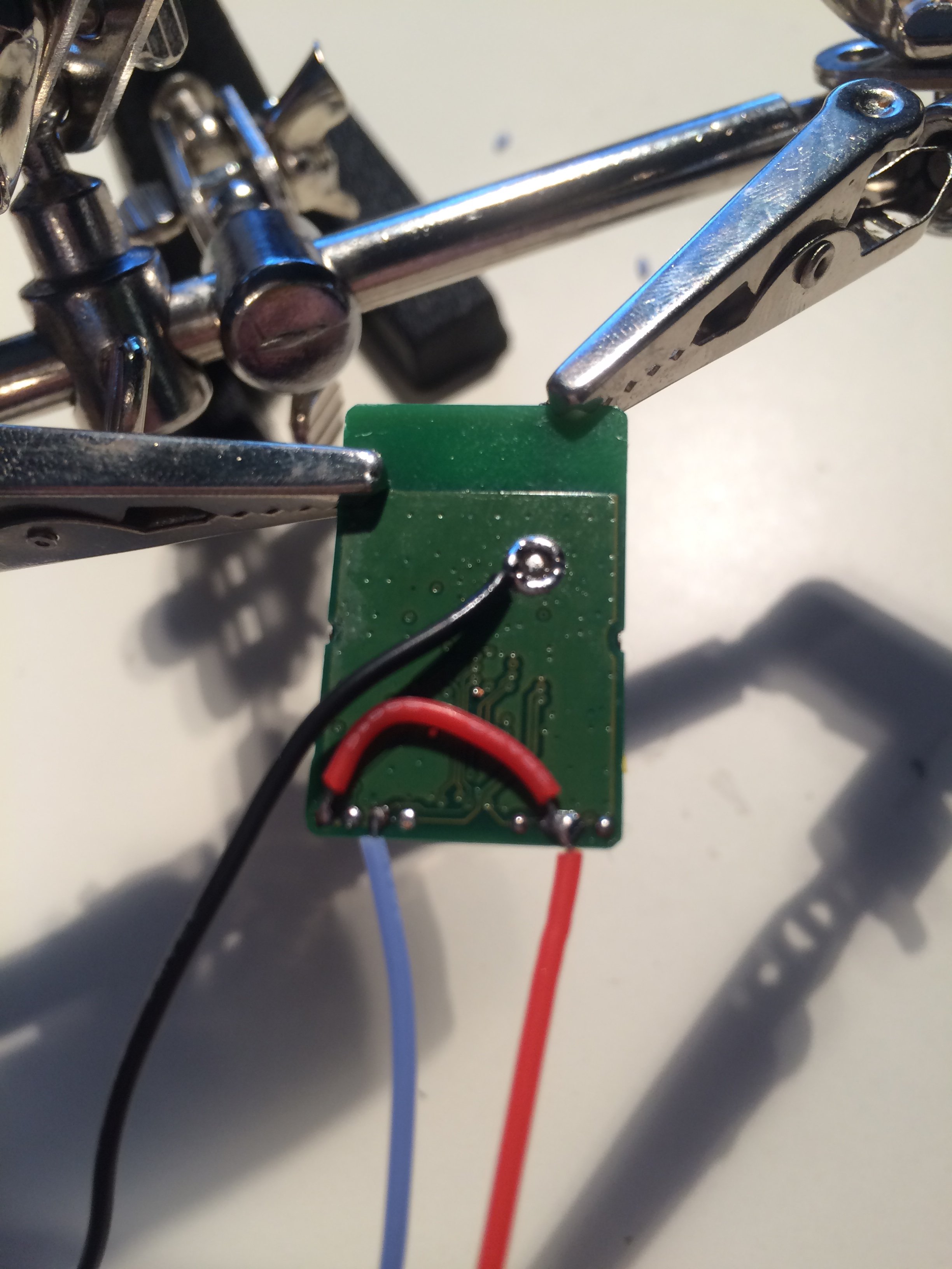

Bluetooth relocation:
OMGWTF Trim: "Its located inside that zip-lock bag"

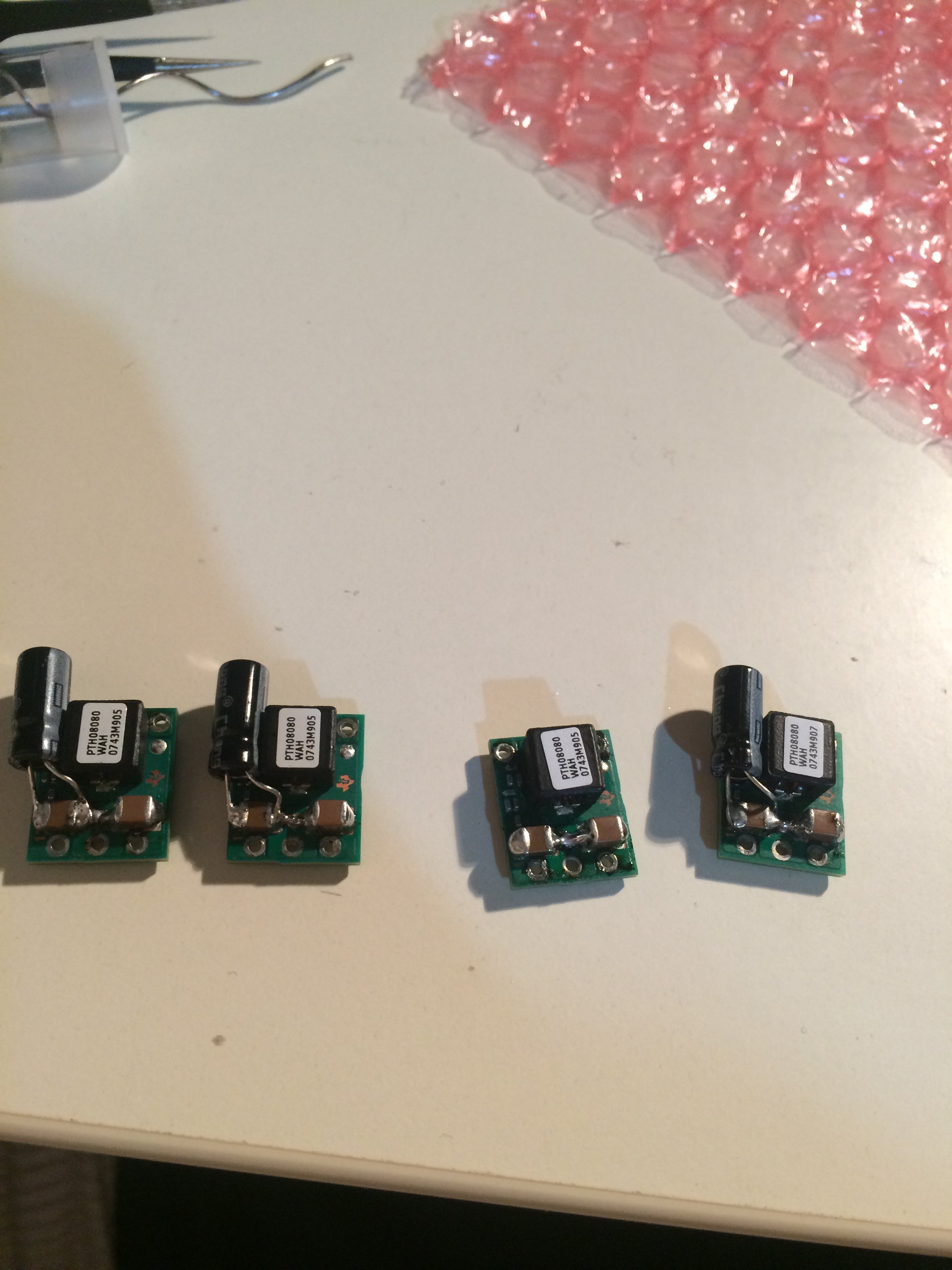

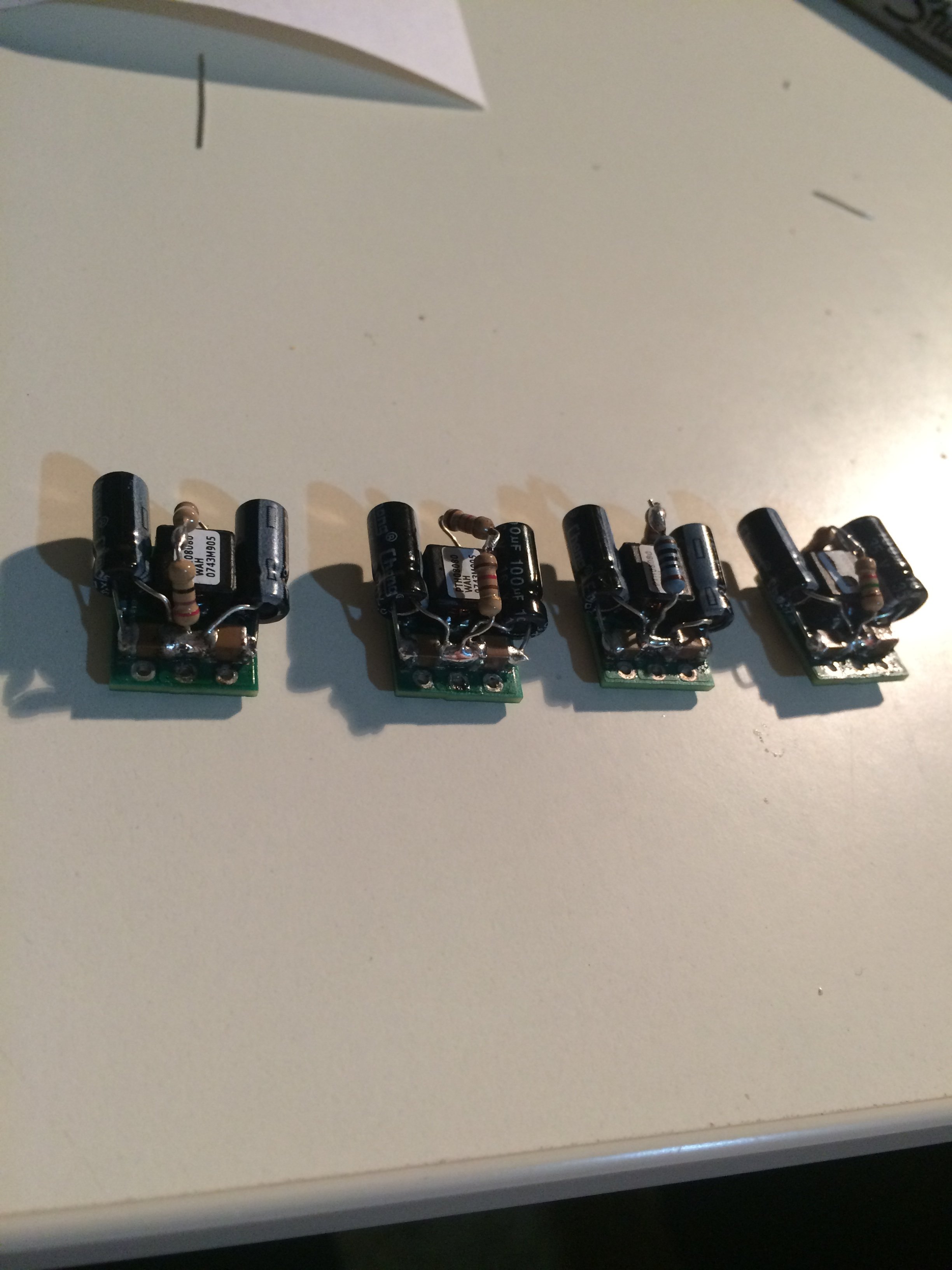

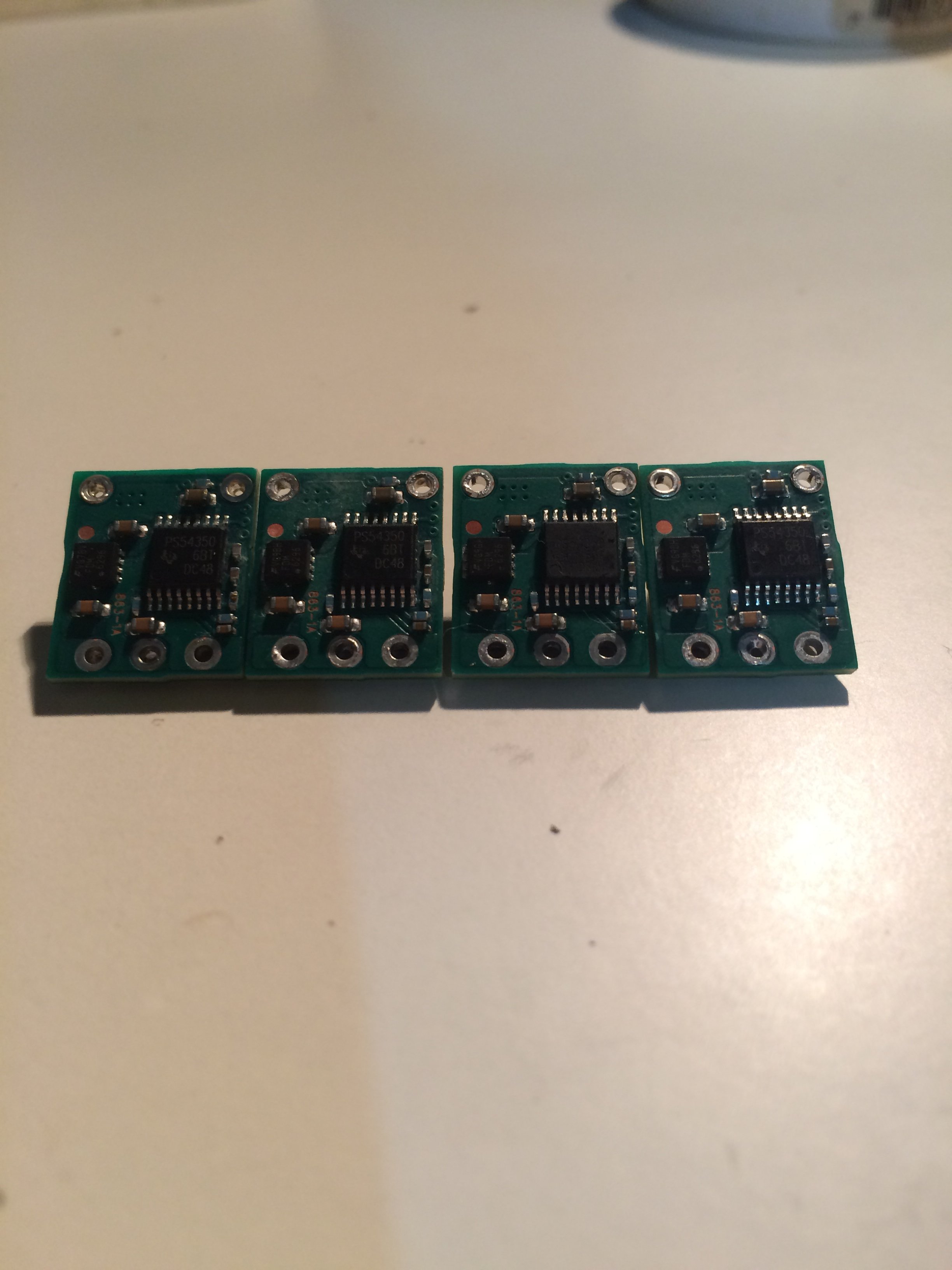

Regulators:

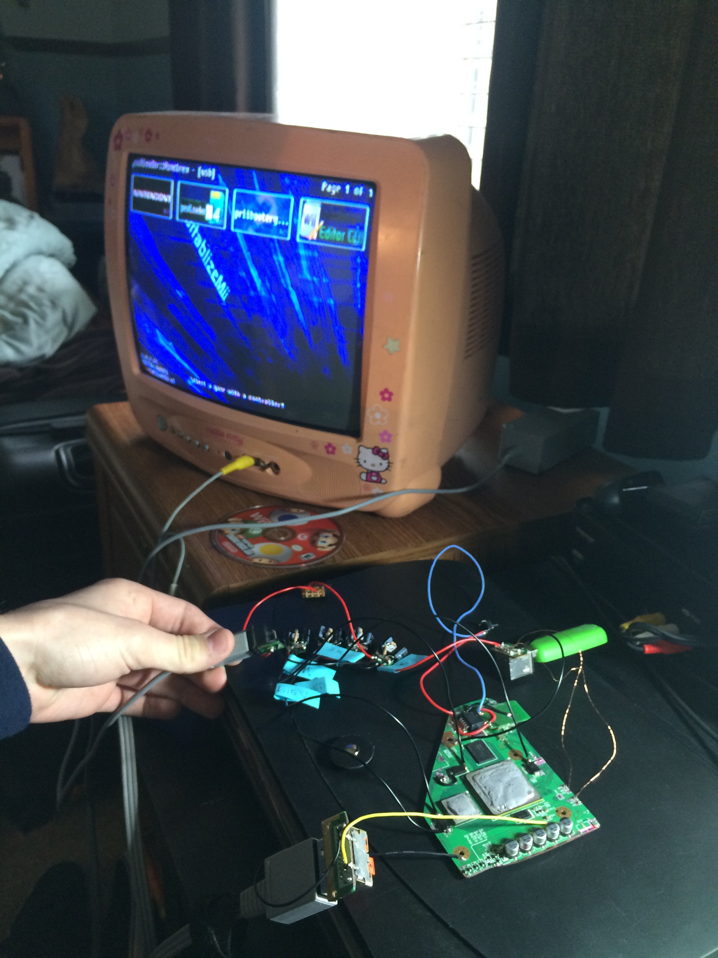

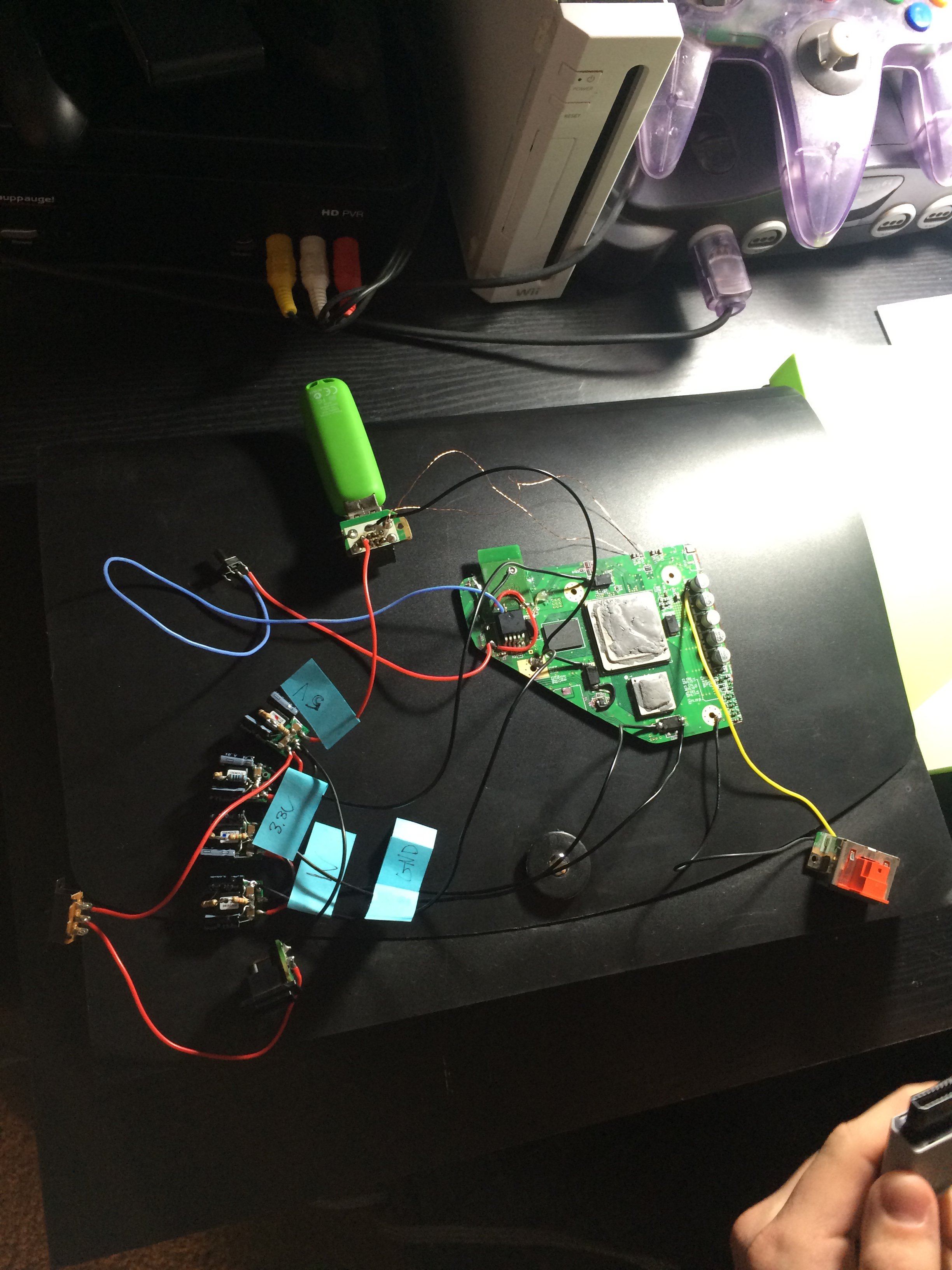

The Nintendo Cream survived the trim and is alive and well! Pretty stoked on the progress so far now its time to design a case and trim down the length on some of these wires.
