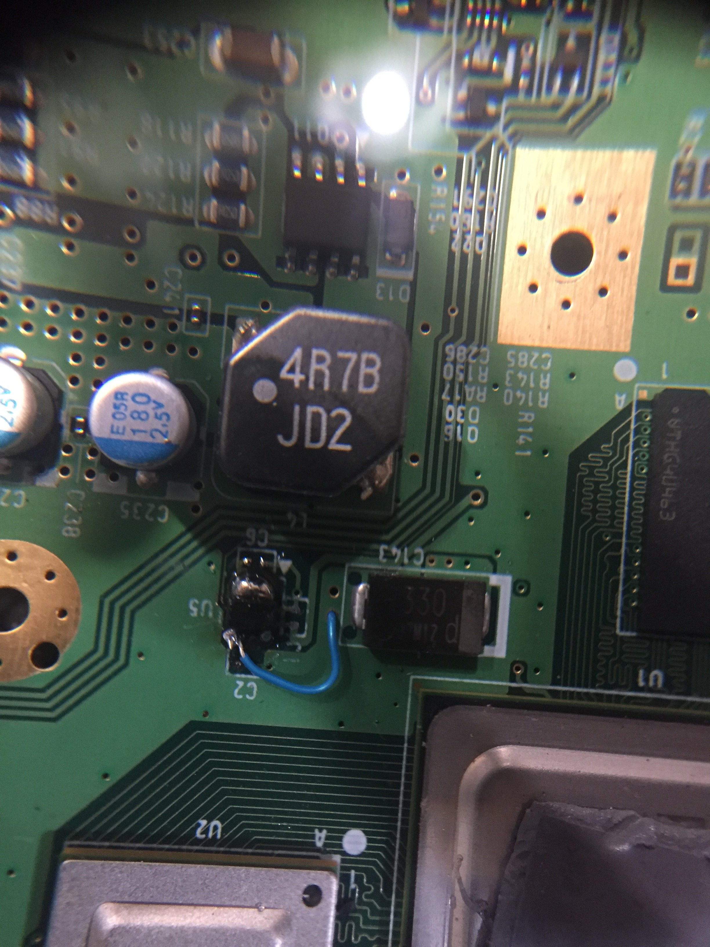

Yup. I'm getting 3.3V in that line.
Edit:
Ok. Well I got it to work....strangely. I checked the voltage on the pad where the gpu wire is and the Wii booted up portablizemii. I don't even ground the other tip, I just tap it and it works. Every time I boot it up I need to tap the pad with something metal and it boots up. Which is strange since 3.3V is going to that gpu trace so I don't think it's a bad solder.
Edit:
So you tested the voltage on the via side as well? Because it sounds like your multimeter probe bridged the pin to the wire which sent the 3.3v signal to the GPU to tell it to boot. If that forces a boot every time, you at least know the issue is somewhere with the U10. I would try reconnecting that wire to the via on both sides regardless.
I tested the voltage on the Via side both where the wire is soldered and on the pad tp119 (where the Via leads to) and obtained 3.3V. I resoldered the wire on to Via and onto the U9 incase it was just a spotty connection. Still the same thing.
Update:
Ok so new discovery. I tried testing the voltage again and it seems to boot up no matter where I test. More over, while it's running and I test the voltage, it resets itself. Is this normal behavior? I'm coming up to the conclusion that the U9 maybe faulty and not giving a delayed signal. Thus when I tap it with my multimeter the voltage drops down low enough for the boot to be tripped.

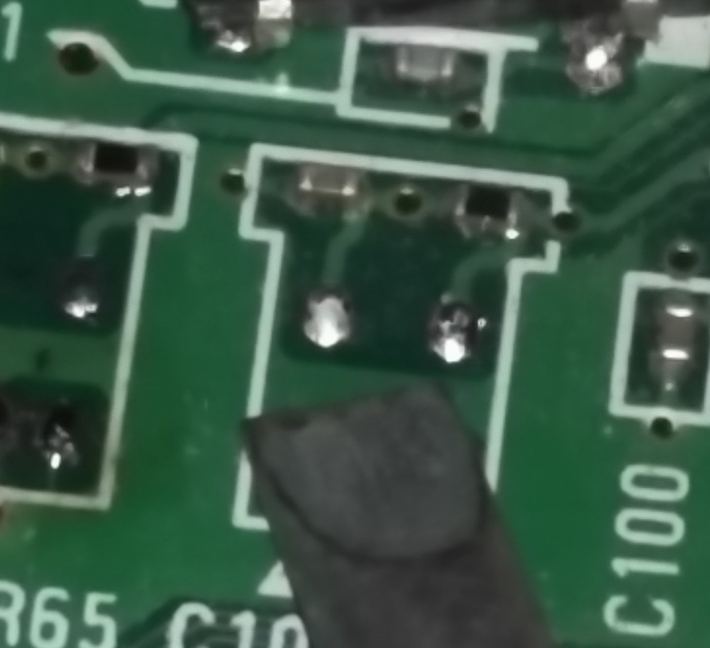

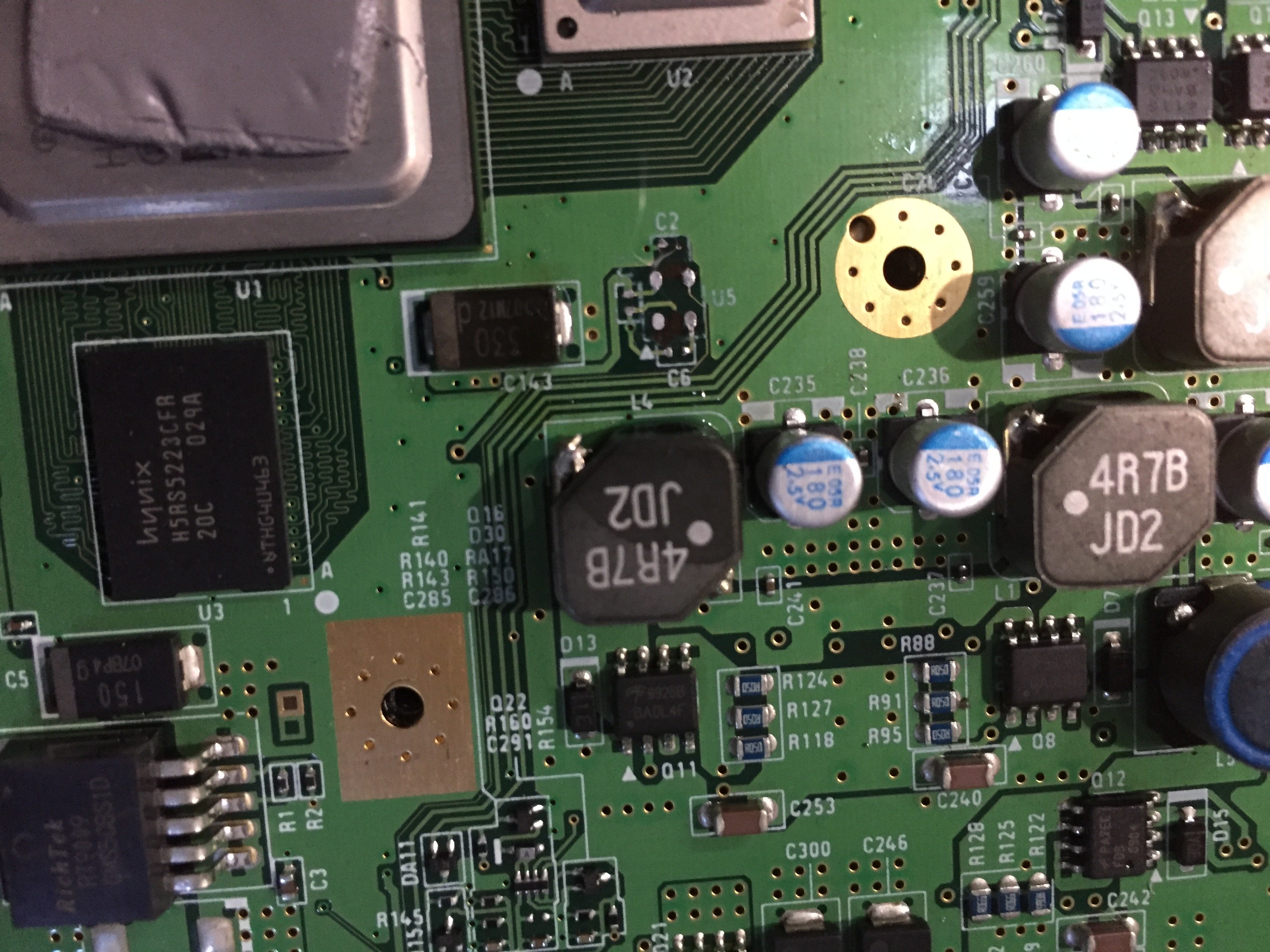

I KNOW WHAT IT IS!!!........Kinda .-. I disconnected the wire from U9 and starting noticed I was STILL getting 3.3V. Ahah! So there has to be a short somewhere on the Via side that's sending 3.3V to the gpu. Problem is, I can't seem to find it with my continuity.
Excuse my terrible pic, it's being taken through a magnifying glass. Is there any known sources of 3.3V around here that could have caused the issue? I almost have the mind of running over all of this with a blob of wet solder on my iron, maybe that'll take up loose blobs. Or maybe destroy everything. Idk. It's late and I'm tired. One more thing to note is that I'm getting around 4 Kohms of resistance between the Via and the 3.3V. That may explain when I'm not getting continuity. But there's still a rouge connection somewhere
UPDATE 3:
Ok. I am almost certain I found the culprit it turns on I'm still getting 3.3V on both pins on the 2 top pads where the U10 used to be. When tapping the top right pad I boot up the Wii. Therefore, somehow there's a short near these pads.
I can't fully tell where the short is, however I'm wondering if I can just remove that small right element and work from there.

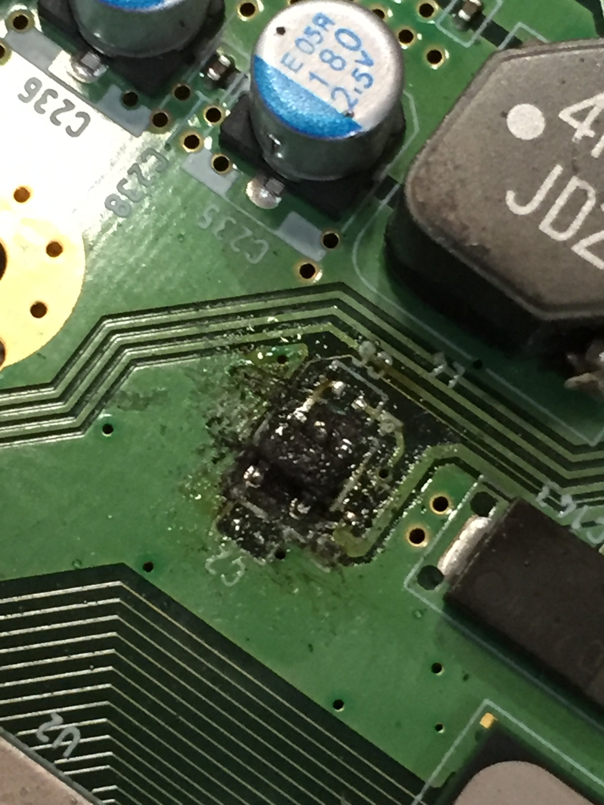

Not only that, but I've gotten to work on the OMGWTF trim.
The most nerve wracking thing I've ever done to a pcb! Looks like I dragged it out of my car on the highway. I'll make it a bit more presentable and sand it a bit more and check for any shorts. Currently got 193 on the 1v, 42.5 on 1.15v, 6.3k on 3.3v, and .4 on the 5v. So probably shorts on the 5v.
