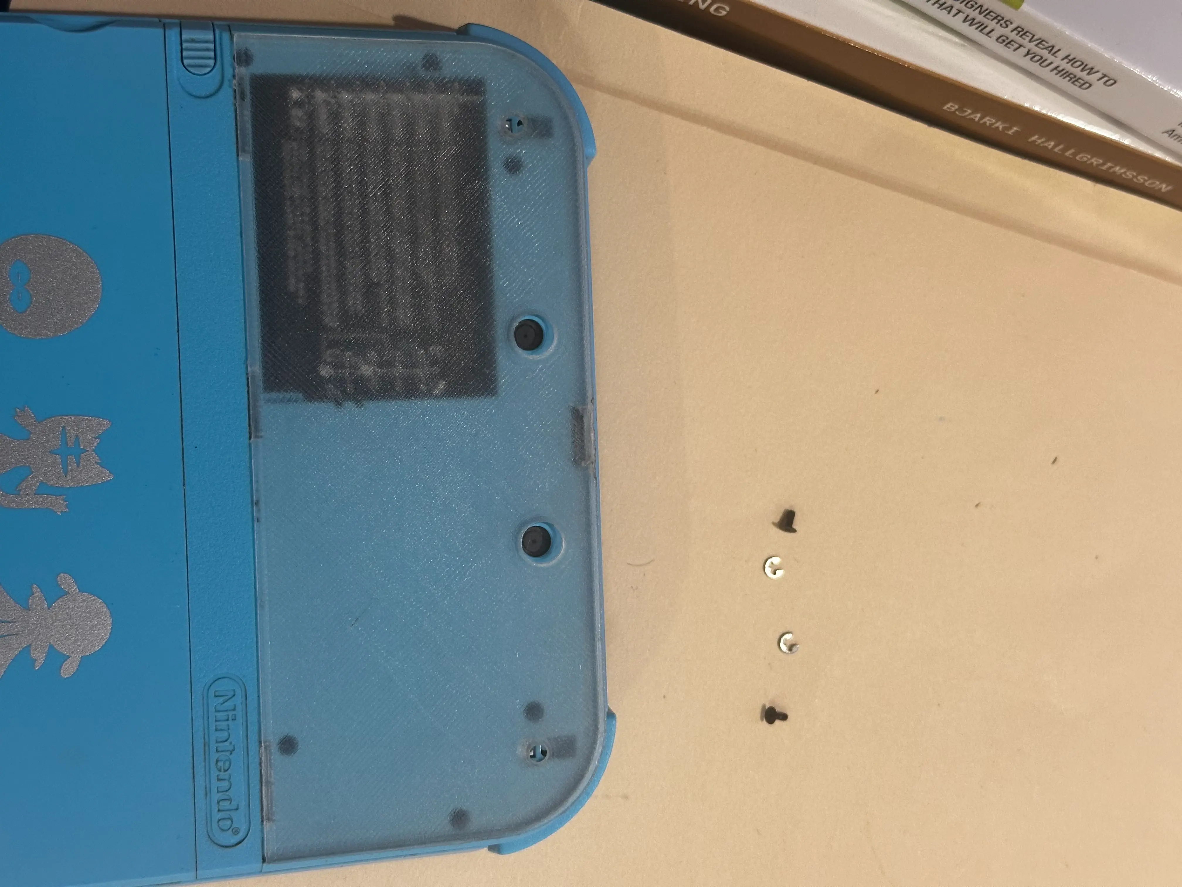

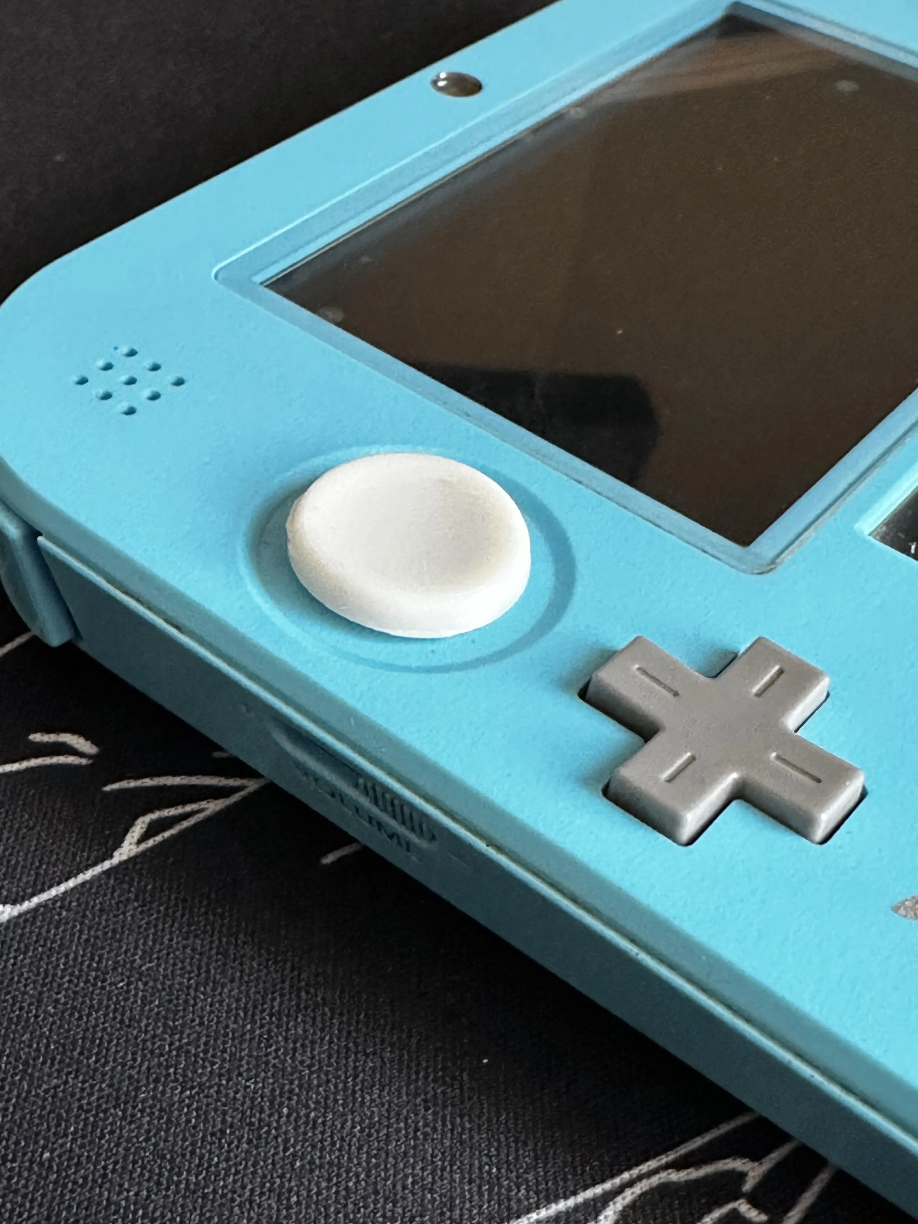

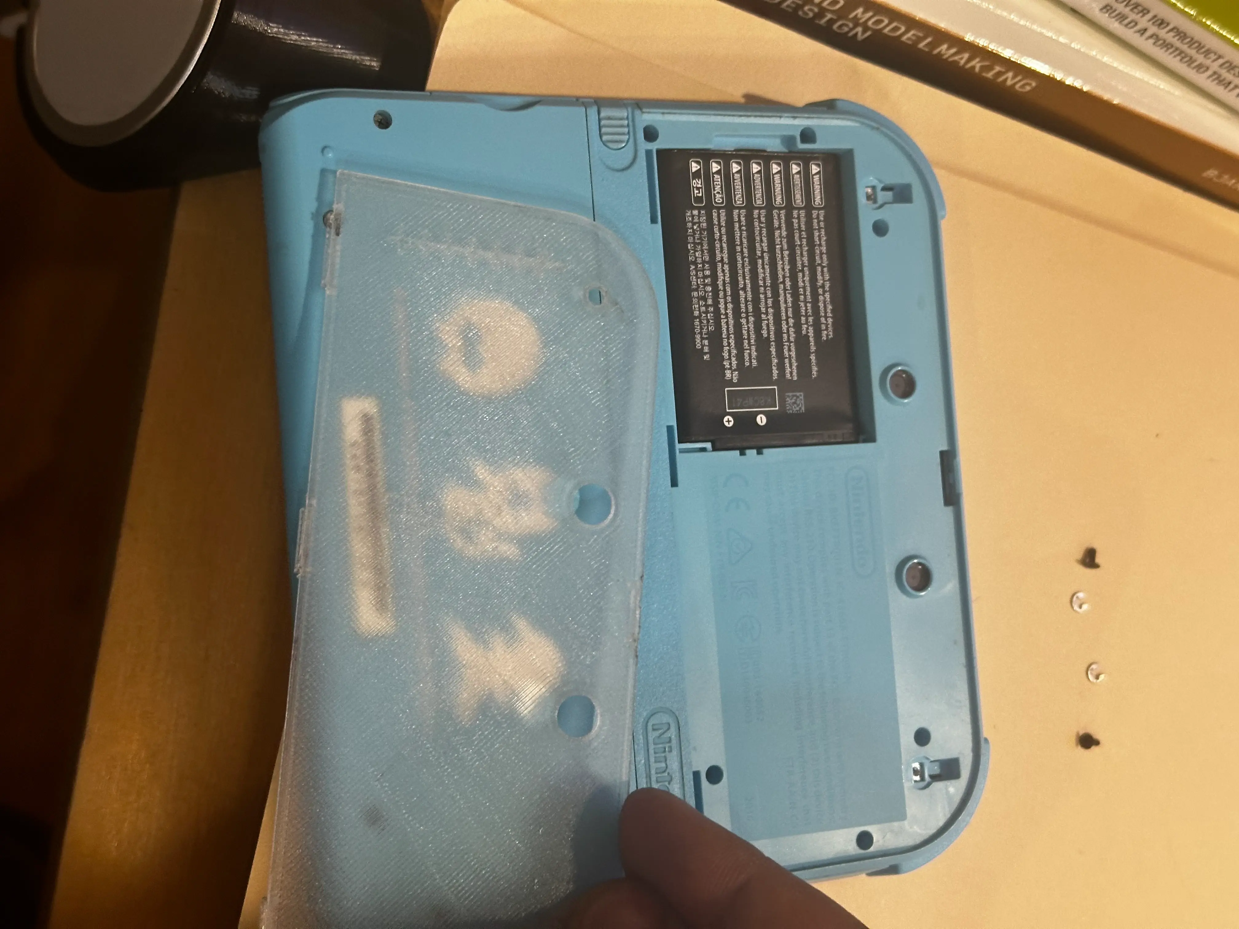

Hey so I did a test print of the battery cover. Printed with PLA transparent on my ender 3 s1 (not the greatest but decent enough). The tabs are pretty easy besides the lone one near the top of the cover, that one broke when I put in in (tolerance??). Attached are images. I feel like when working on projects like this either your printer has to lock in, or you have a bambu lab, other option is resin? Maybe once there are complete files for the full shell.....I might try printing or just ordering thru an online printing service.Also I made a circle pad very simple, and printed it in TPU for my replacement one!

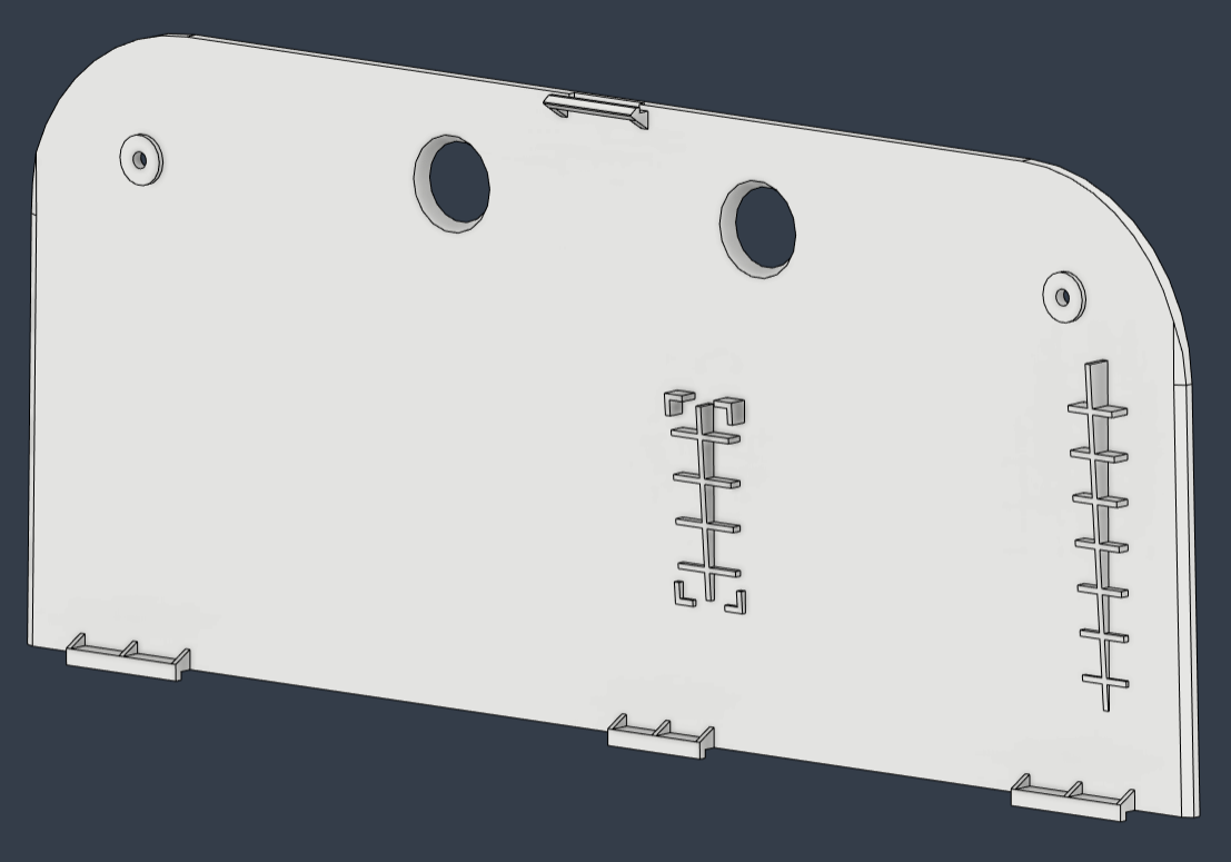

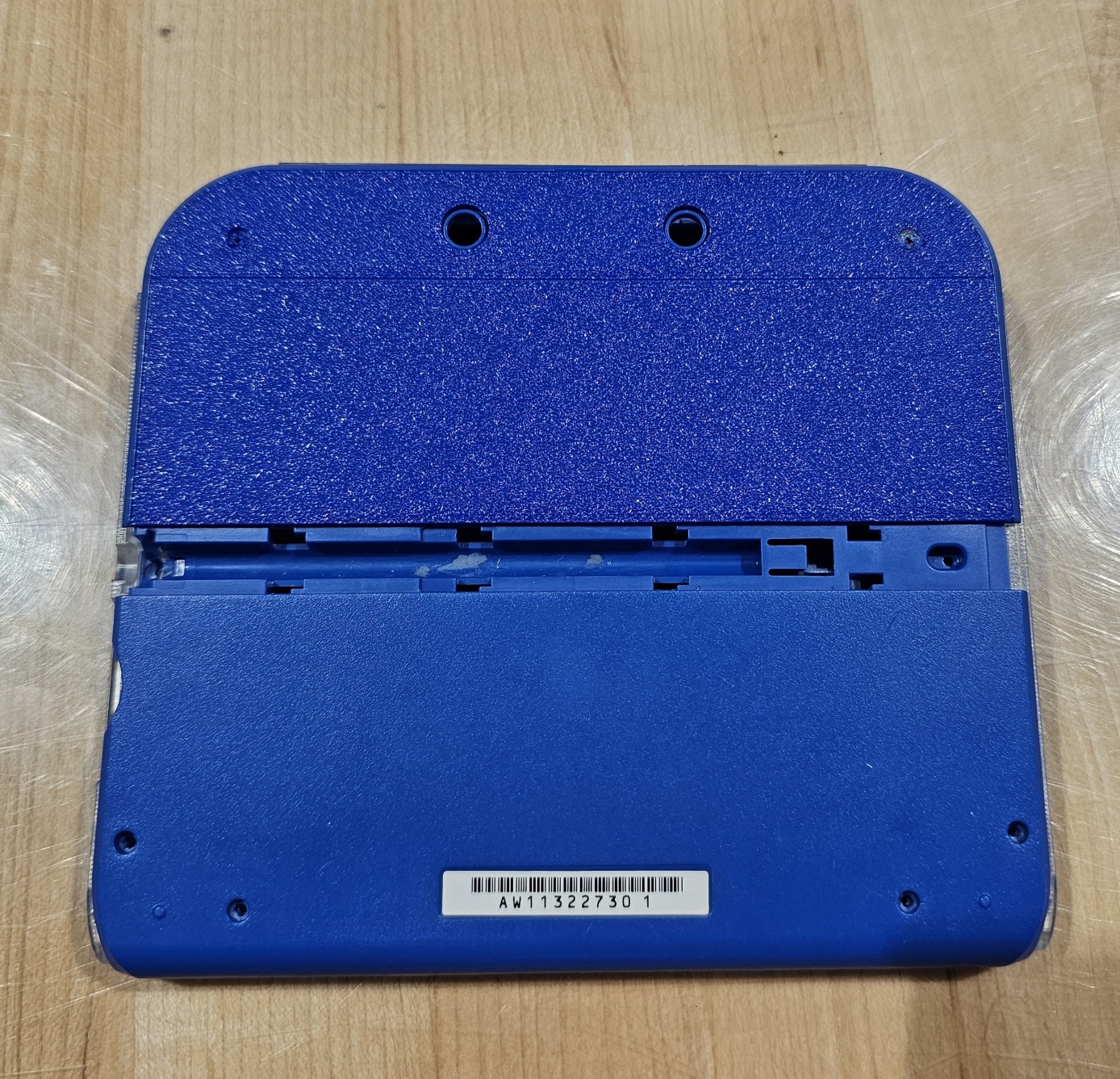

I modeled and tested a 3D printed battery cover to complete the set!
I've attached the STL to this post. It's been printed and tested with a 0.2 and 0.4mm nozzle from Bambulabs printers by myself and redherring32.
I didn't include the small bumps so that it can be printed flat face down.
Some supports are needed for the latches in that orientation.
If you print one, feel free to send me a pic!
If there are inaccuracies with the model, let me know! Happy printing!

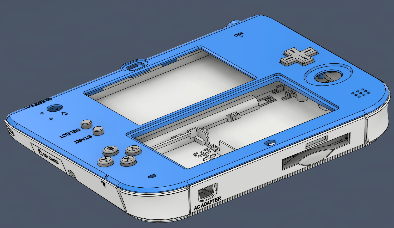

Since noone has done it so far, heres a 3D model of the Volume Slider.
You should be able to clone the Onshape workspace for yourself or export the 3D model.

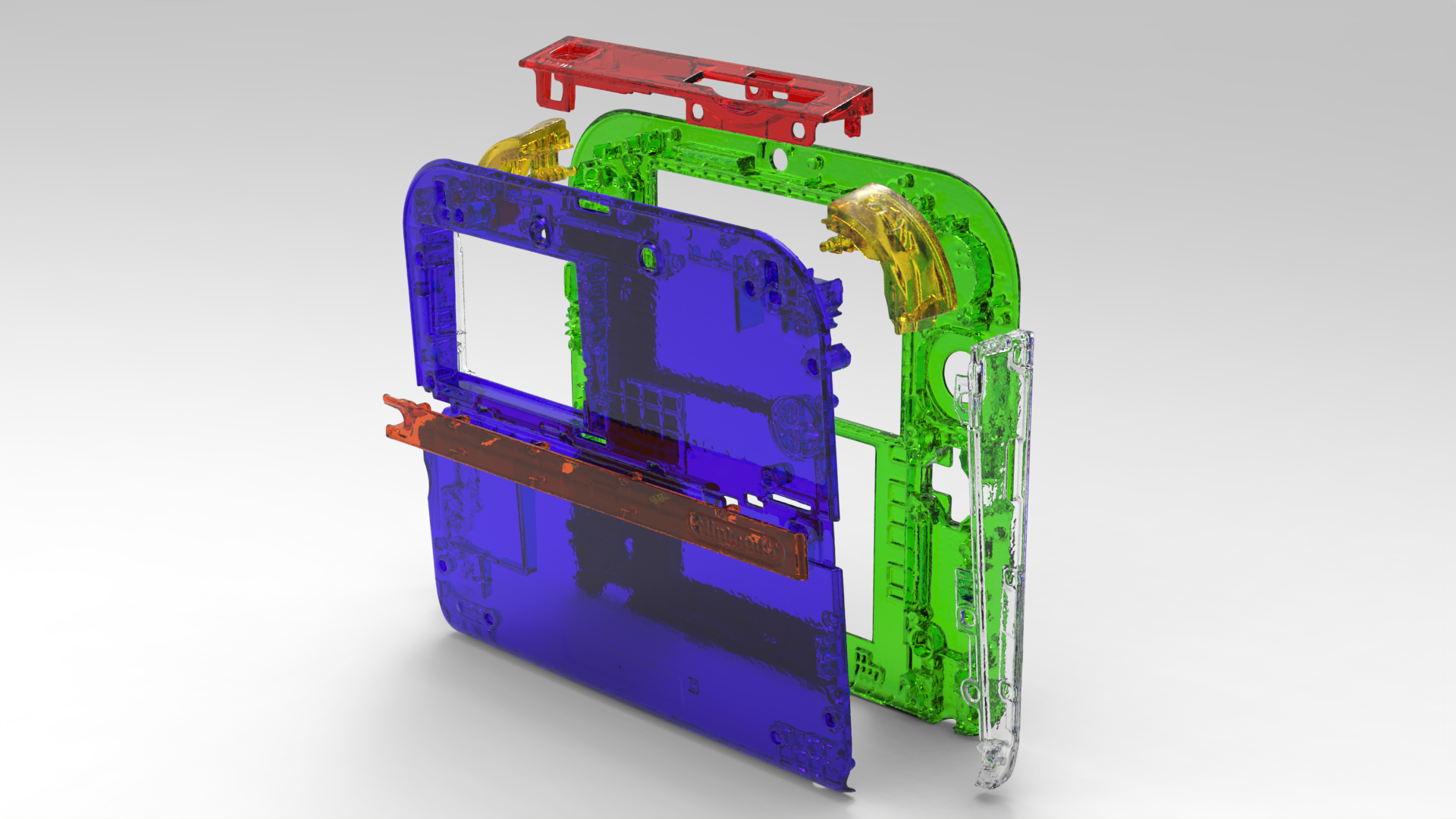

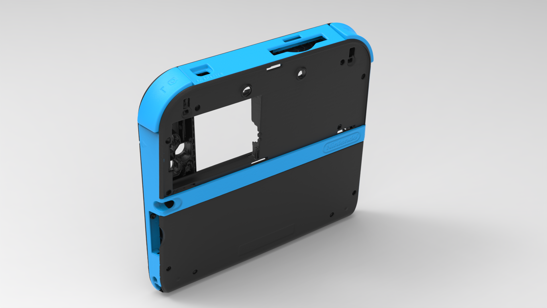

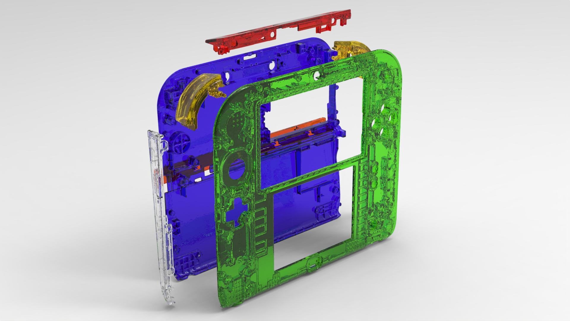

Nintendo 2DS Console
Contains:
2DS Front Shell
2DS Rear Shell
2DS Side covers
2DS Shoulder Button
2DS Cart Port Cover
2DS Stylus Cover
View attachment 33613View attachment 33610
View attachment 33611View attachment 33612
