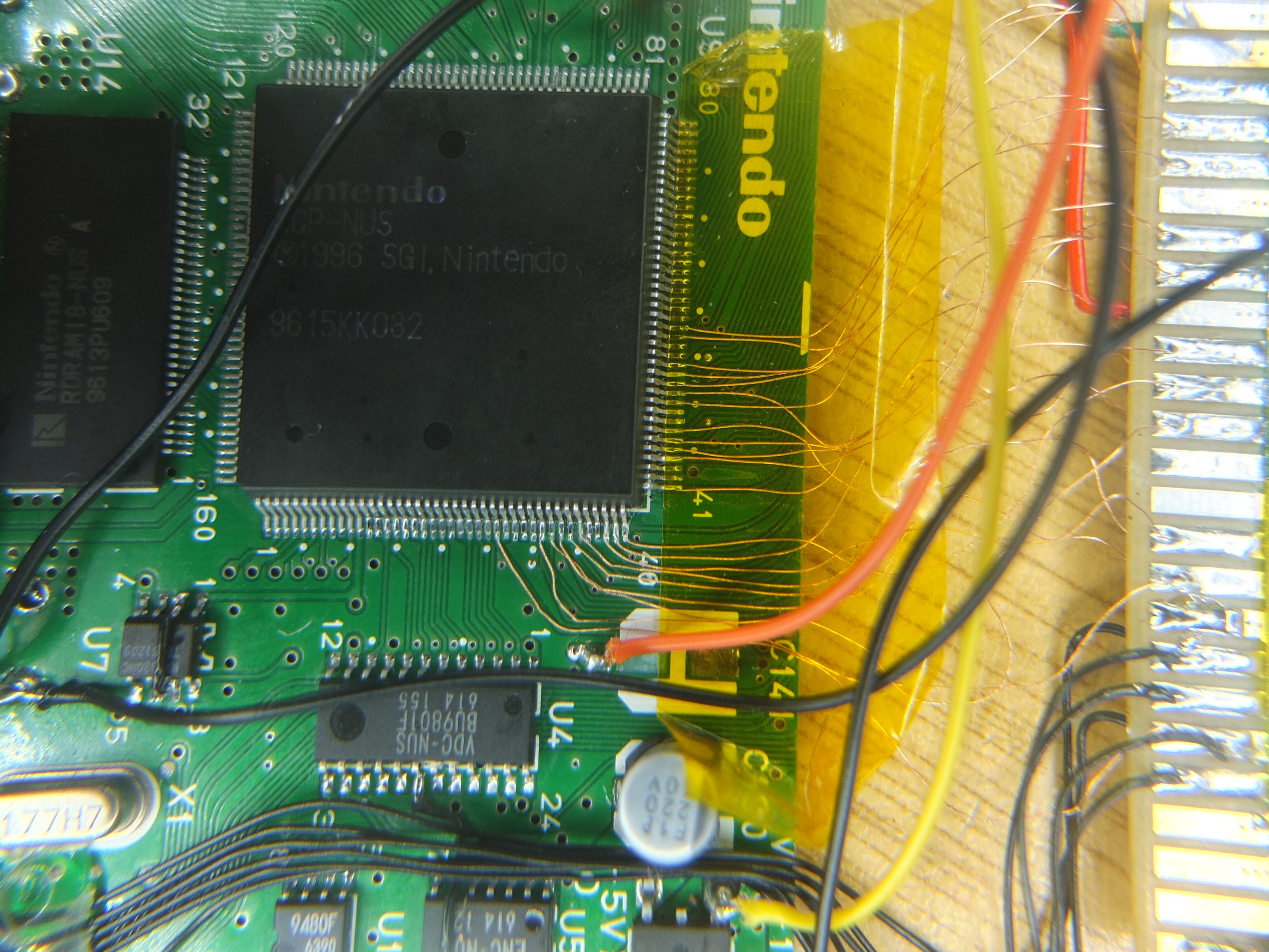

Hi,
I tried RCP wiring this N64 without success, yet. You'll get all information on this video:
Also here's a pic of the wiring:
Don't know what to try anymore.. just hope the RCP isn't broken... but then i could solder in another one, cause it's a RGB-N64-board :(
//Edit: Basically I used the pinout from this thread, but also traced them myself..
https://bitbuilt.net/forums/index.php?threads/rcp-27-28wiring-guide.1516/
Based on where you cut, you probably severed the trace that connects pin 26 of the RCP (the bottom most pin you have wired on the RCP) to pin 6 of the PIF. Those two are connected so try running a wire between them and see what happens.
Sadly that's the "pin 20" on the card slot, that i'm talking about in the video - so yea, i did reconnect that :/
//Edit: Both are connected to the everdrive, that's why you can't see it on the pic...
