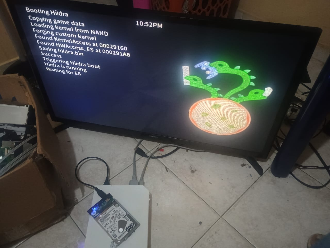

my wii doesnt load wii games with rvloader but loads gamecube good
Mar 14, 2023
5
i have a non trimmed wii with only one problem that is that the wii doesnt recognize any disk drive so i installed rvloader with a external disk drive (generic case + 500gb toshiba 100%) and when i load a gc game loads just fine but wii games stuck in waiting for es

In terms of your question, Wii games are definitely more sensitive to slow drives or just some drives in general due to how they behave. What did you mean by "A usb" and "external drive"? I presume the latter is referring to a USB attached hard drive?

And yeah when i said that was meaning that My external hard drive with a usb adapter have the issue but a normal usb doesnt

That's quite typical for Wii games, as Crash said they're more sensitive. USB hard drives are a bit slow on the draw when it comes to providing requested files, there's a latency that can wig out the Wii. Other loaders have some extra optical drive emulation wizardry built in for maximum compatibility, but RVLoader is designed specifically for portables using USB flash drives or microSD card adapters that respond very quickly, so USB hard drives and solid state drives are quite hit or miss due to that latency and some other factors.
IIRC Aurelio has said that hard drive support is not on the roadmap for RVLoader, so you'll either need to get a compatible USB drive or get lucky with a quick enough HDD.
