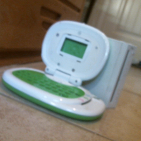

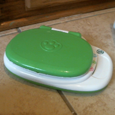

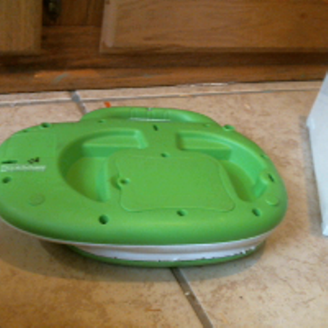

Question My Own Liiptop (My upcoming Wii portable using a "Leap Frog My Own Leaptop" as the shell)
How would I go about wiring the power source to the wii?
