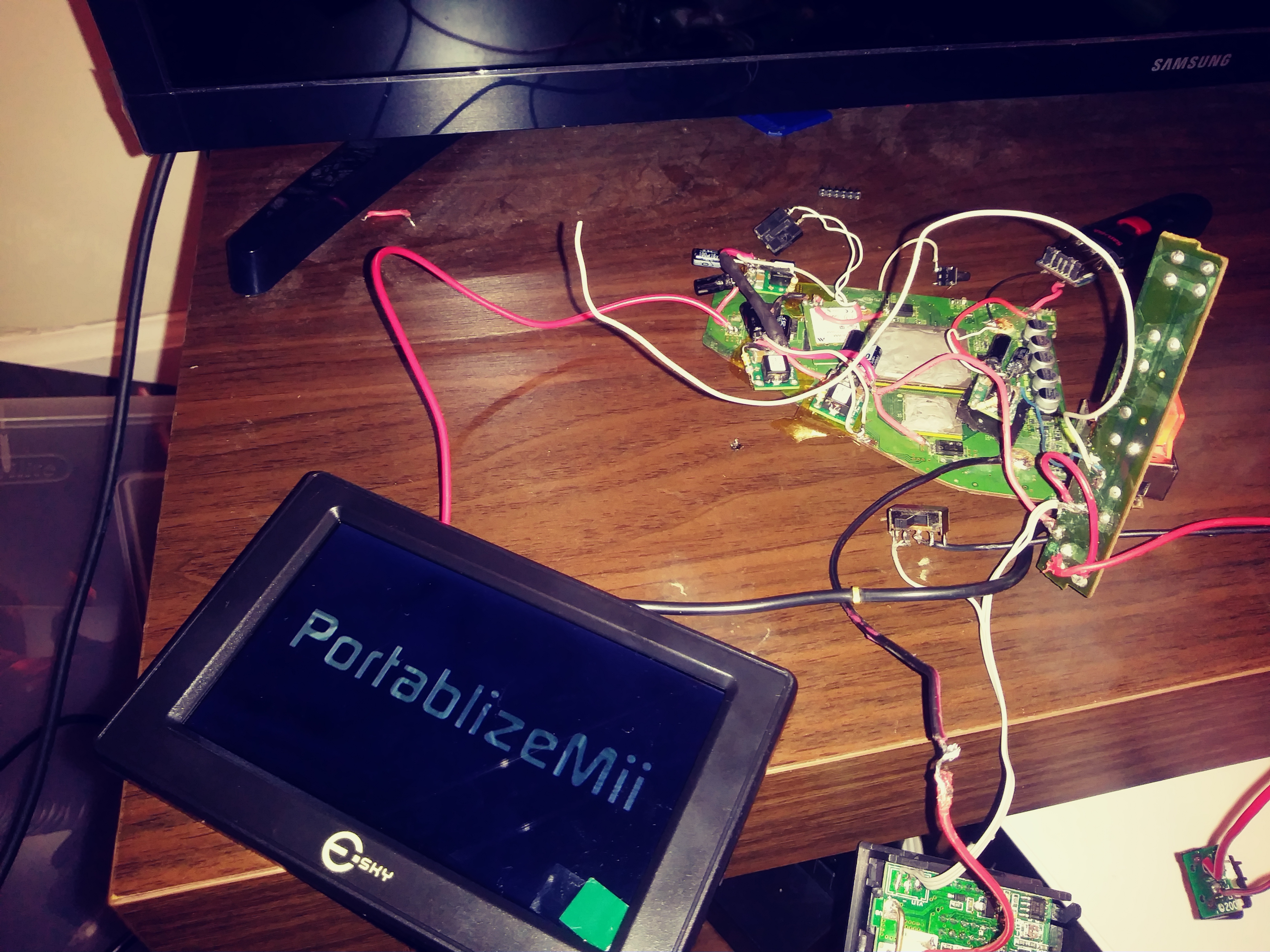

You've heard of wireporn messes, now get ready for...........an even worse wireporn mess........but with a screen now.
