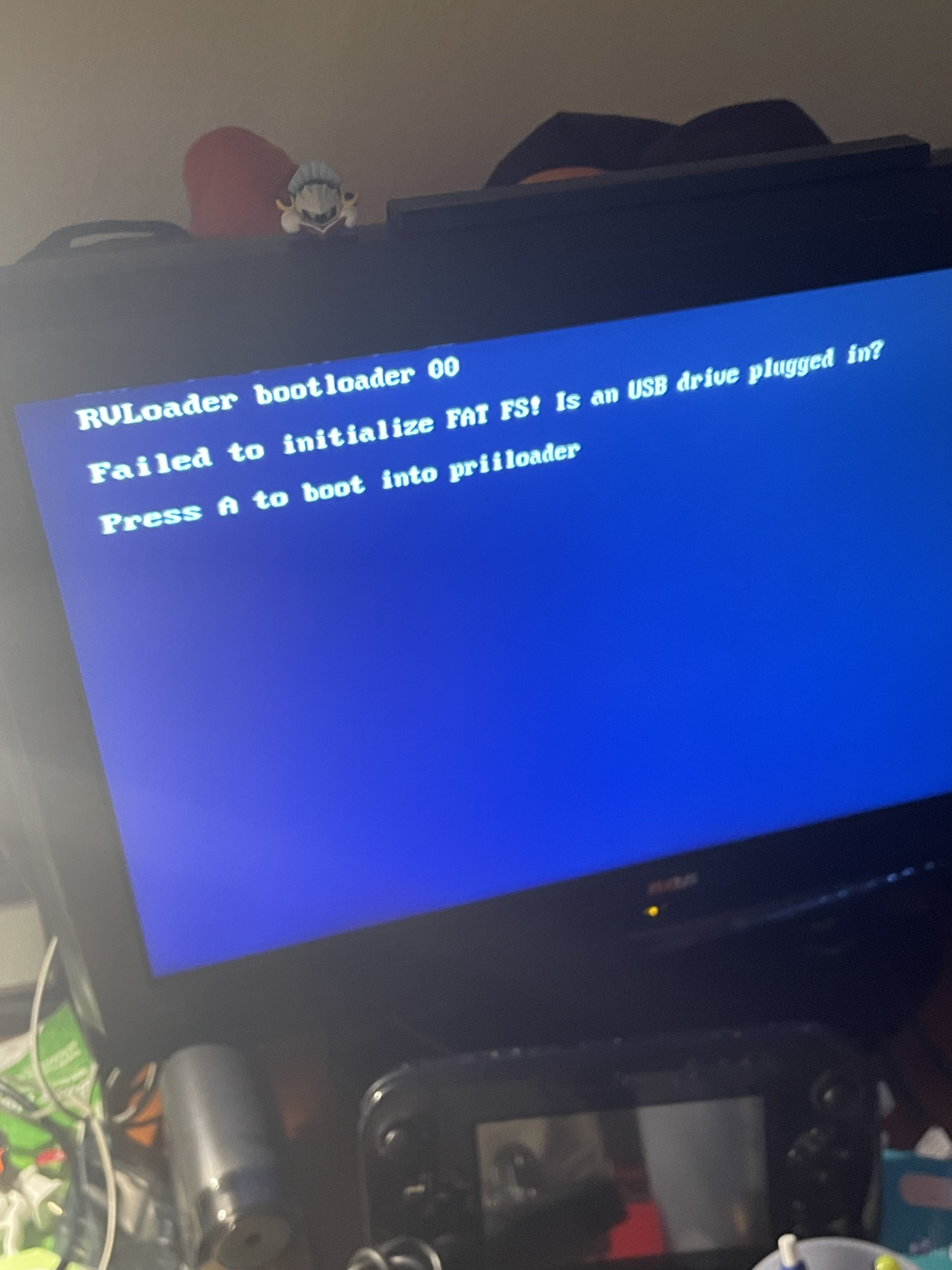

I started this project by buying a black Wii on OfferUp for $20. It seemed good, and I was able to power it on and install RVLoader. I also bought an RVL-PMS-LITE, a PMS-PD-3, a GC+ 2, a U-AMP 2, and a 5-inch screen with the driver board from 4 Layer Tech, along with some cheap AliExpress components like speakers and buttons.

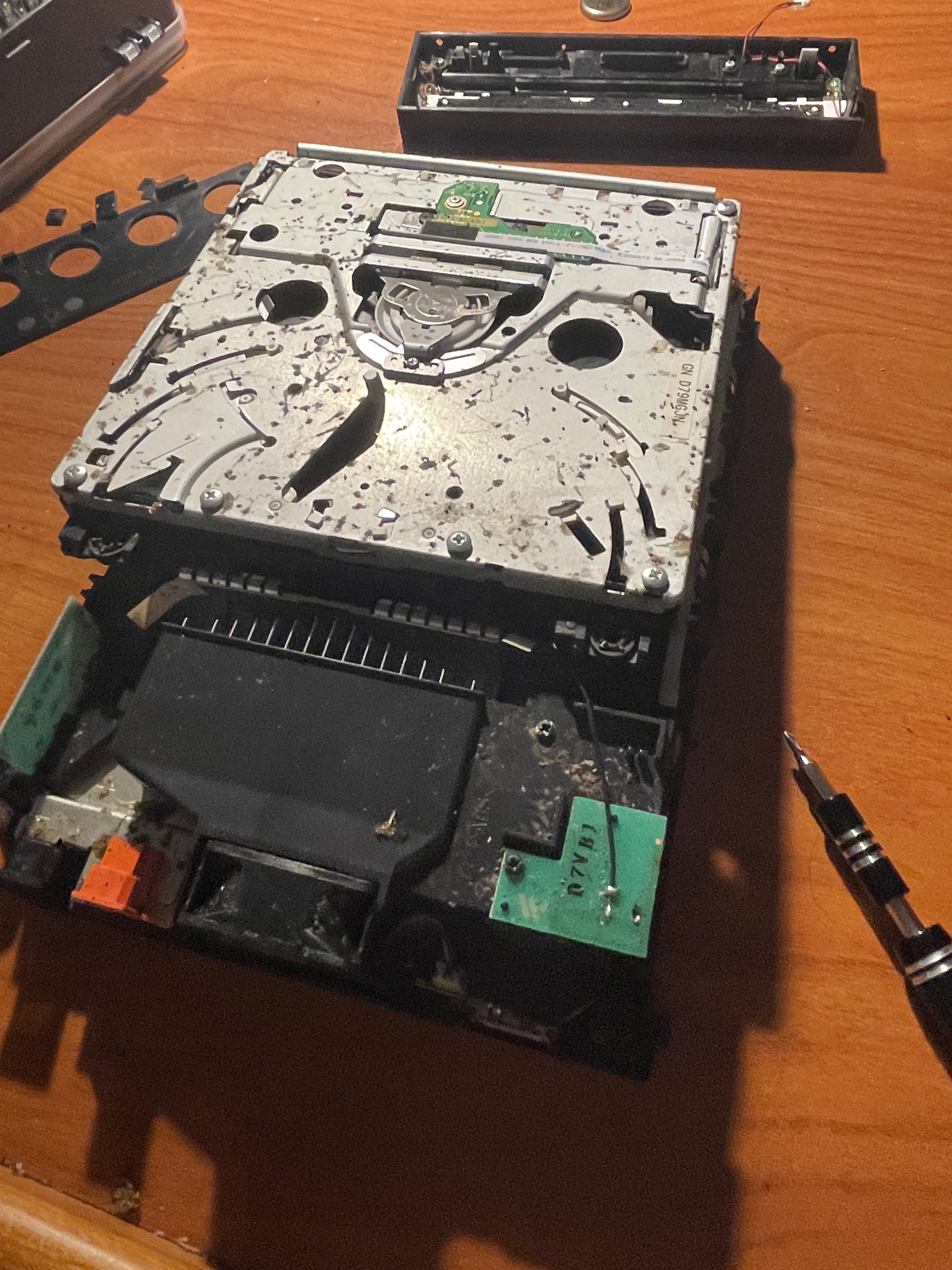

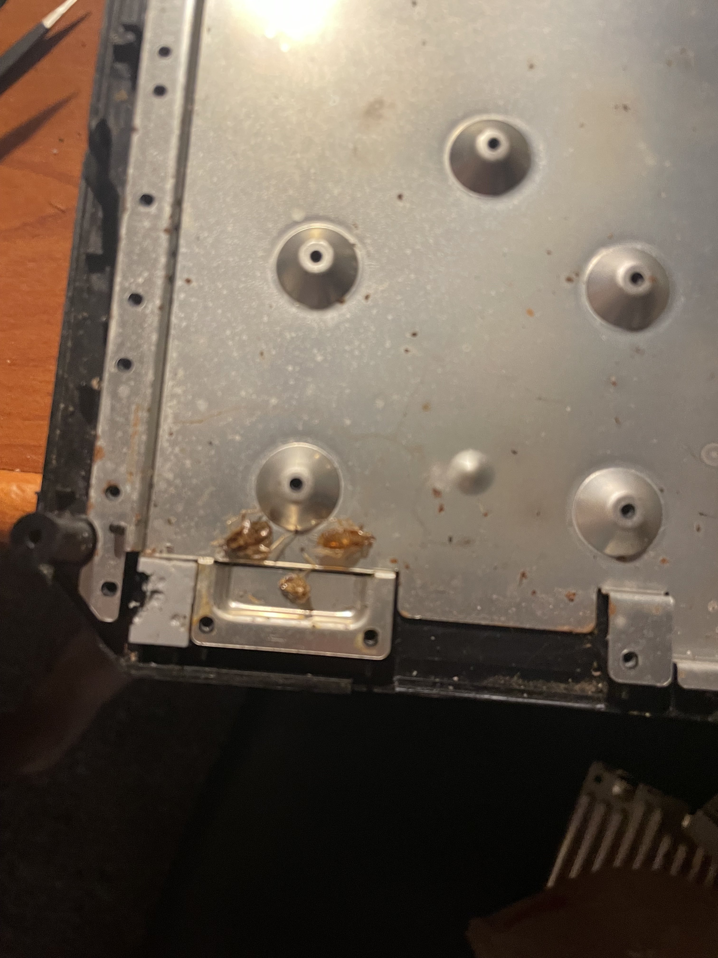

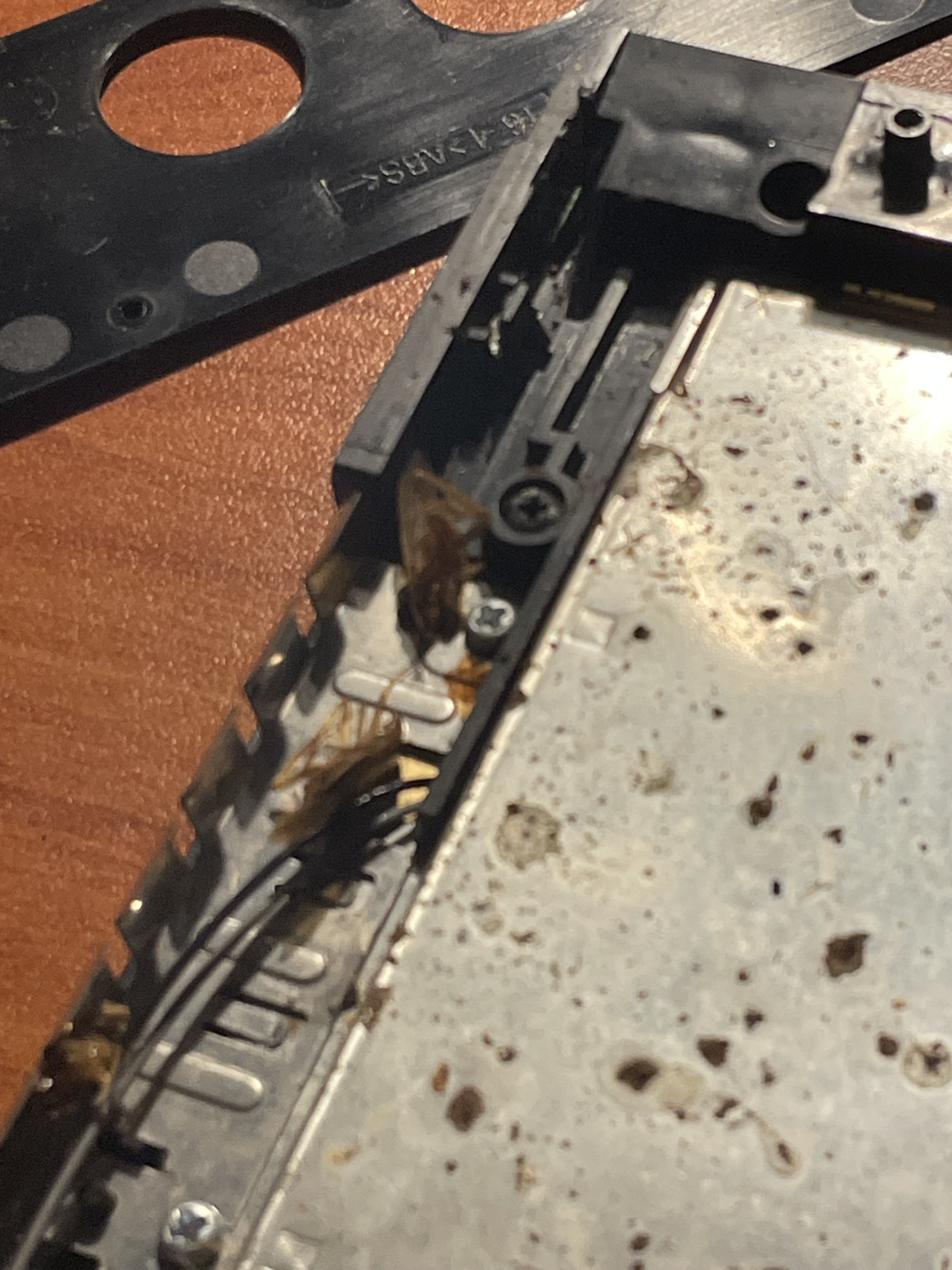

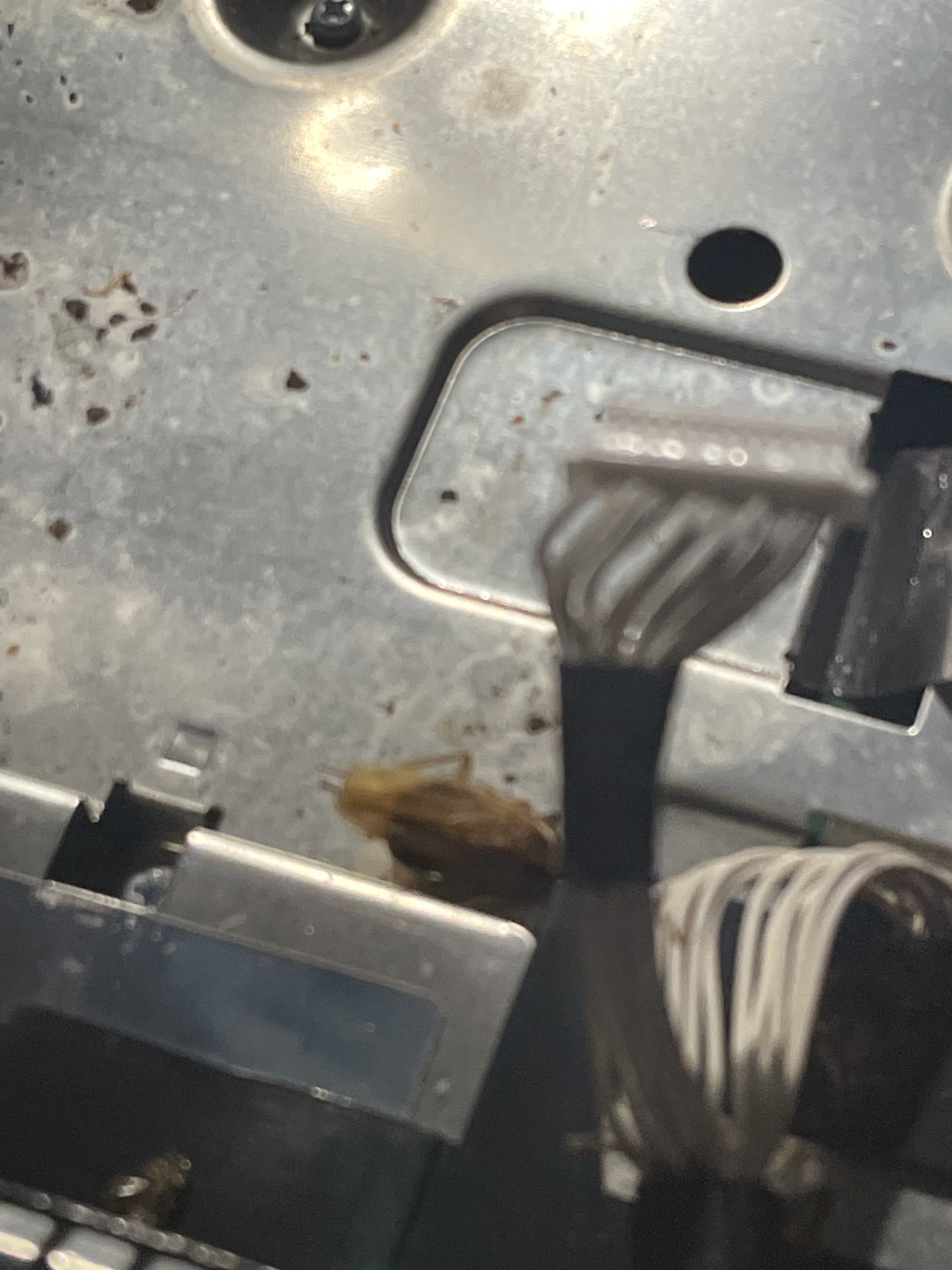

I opened up the Wii and ohhh no, it's filled with dead cockroaches.

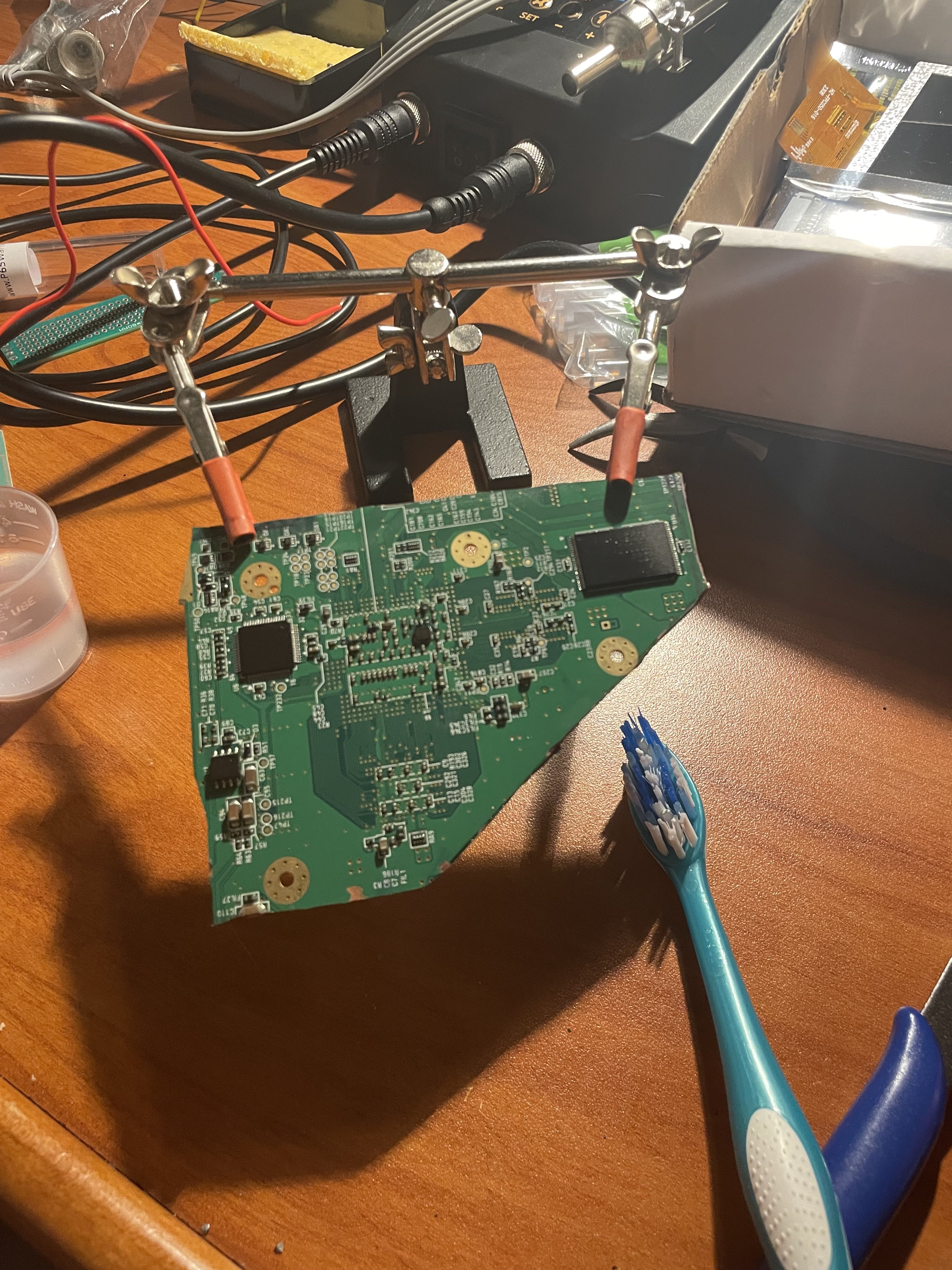

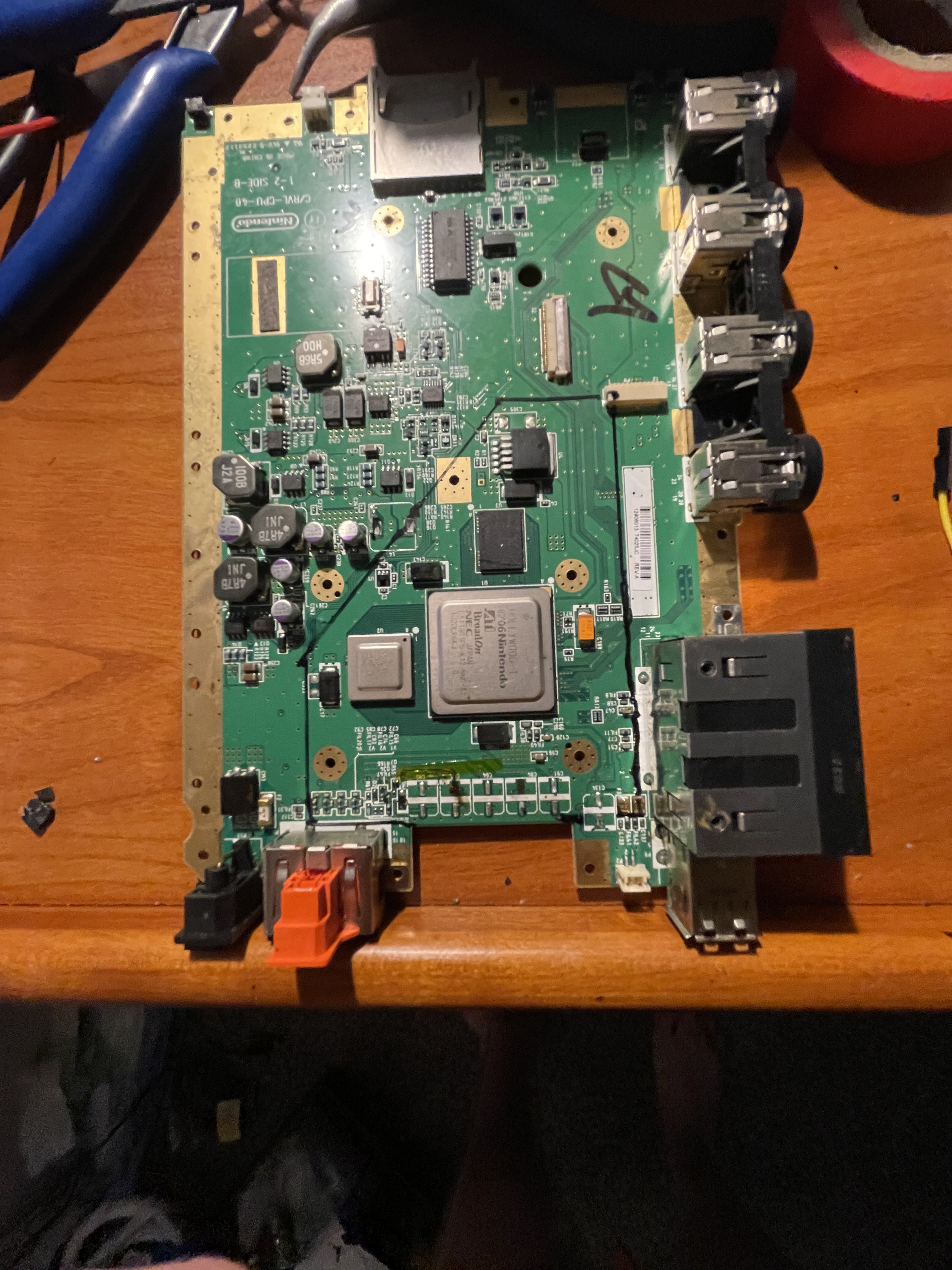

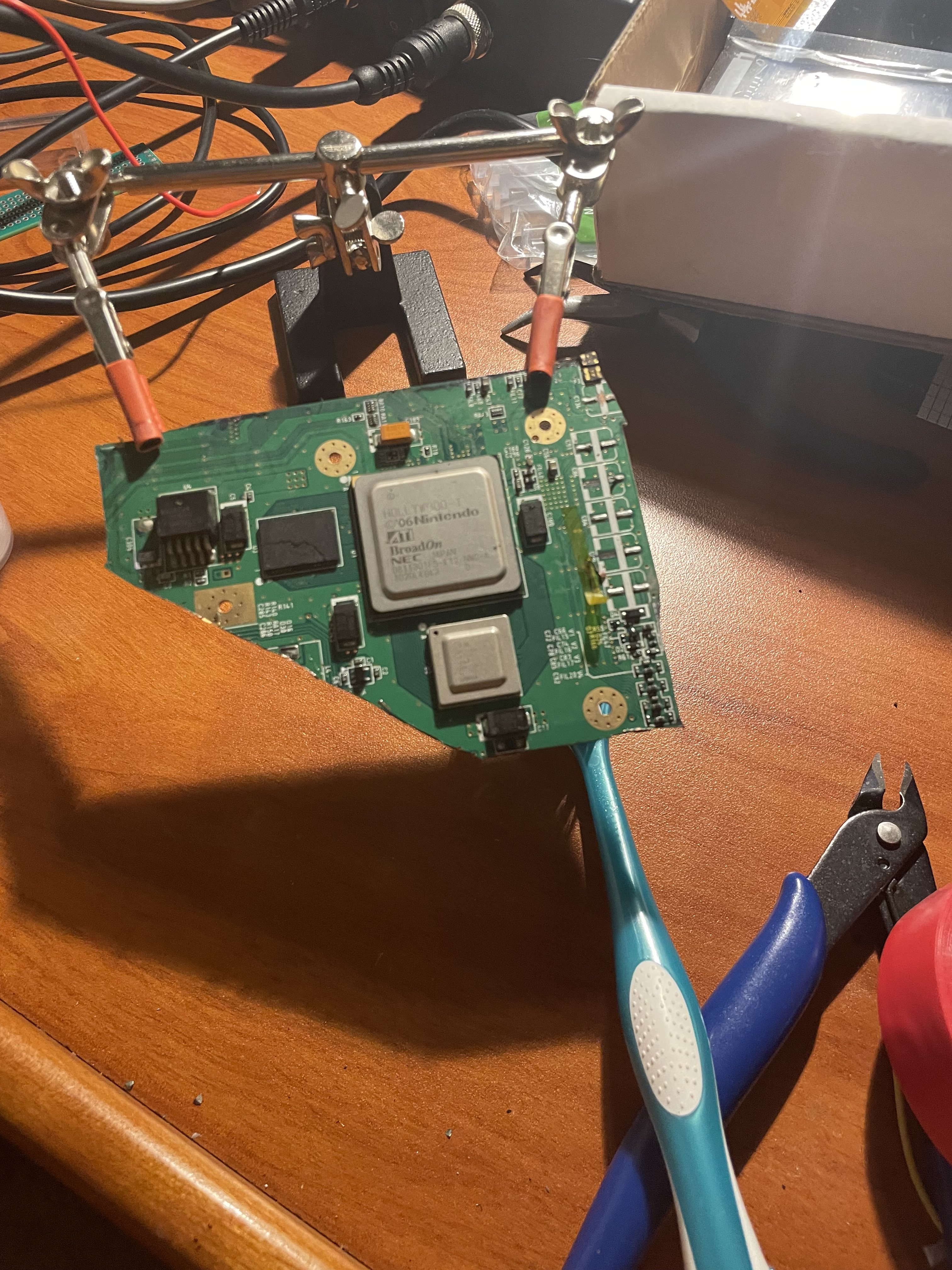

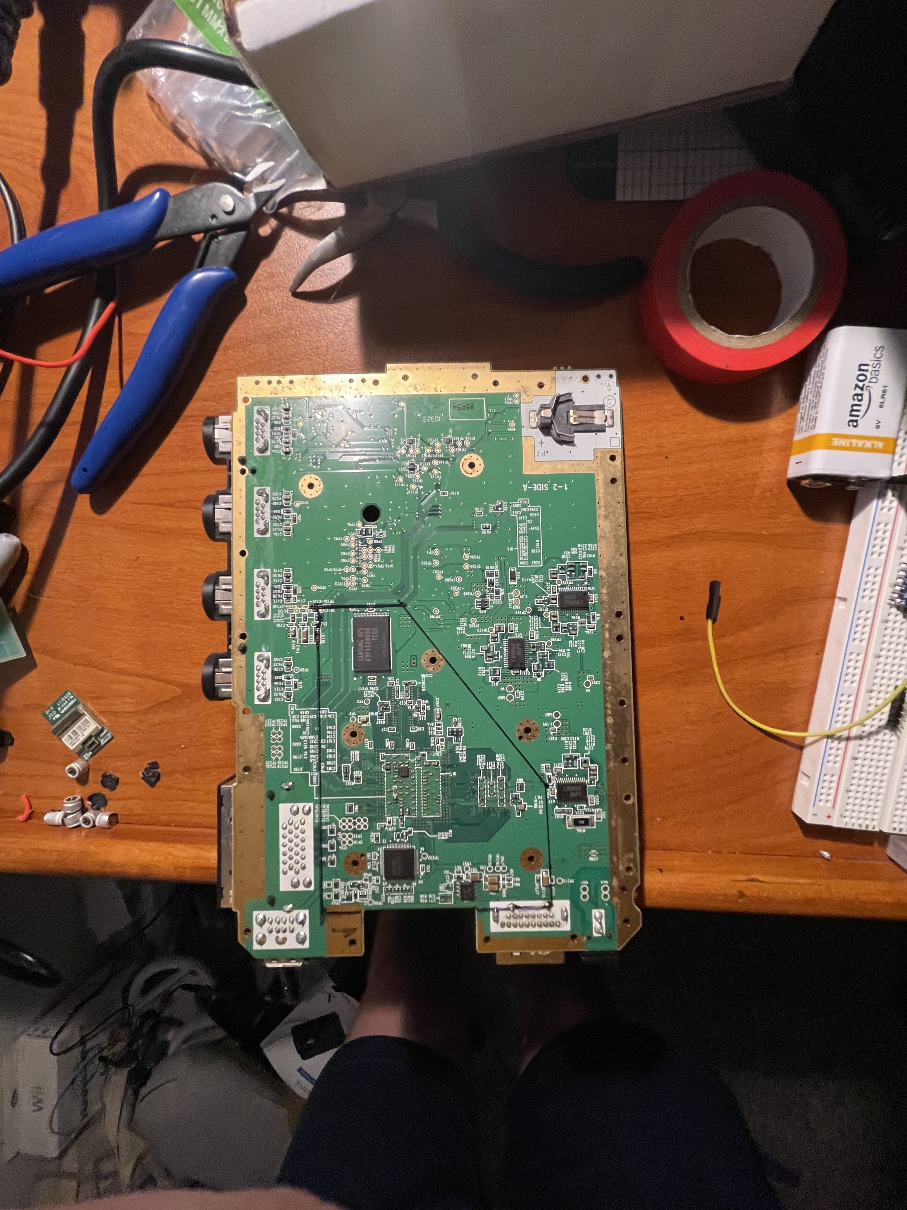

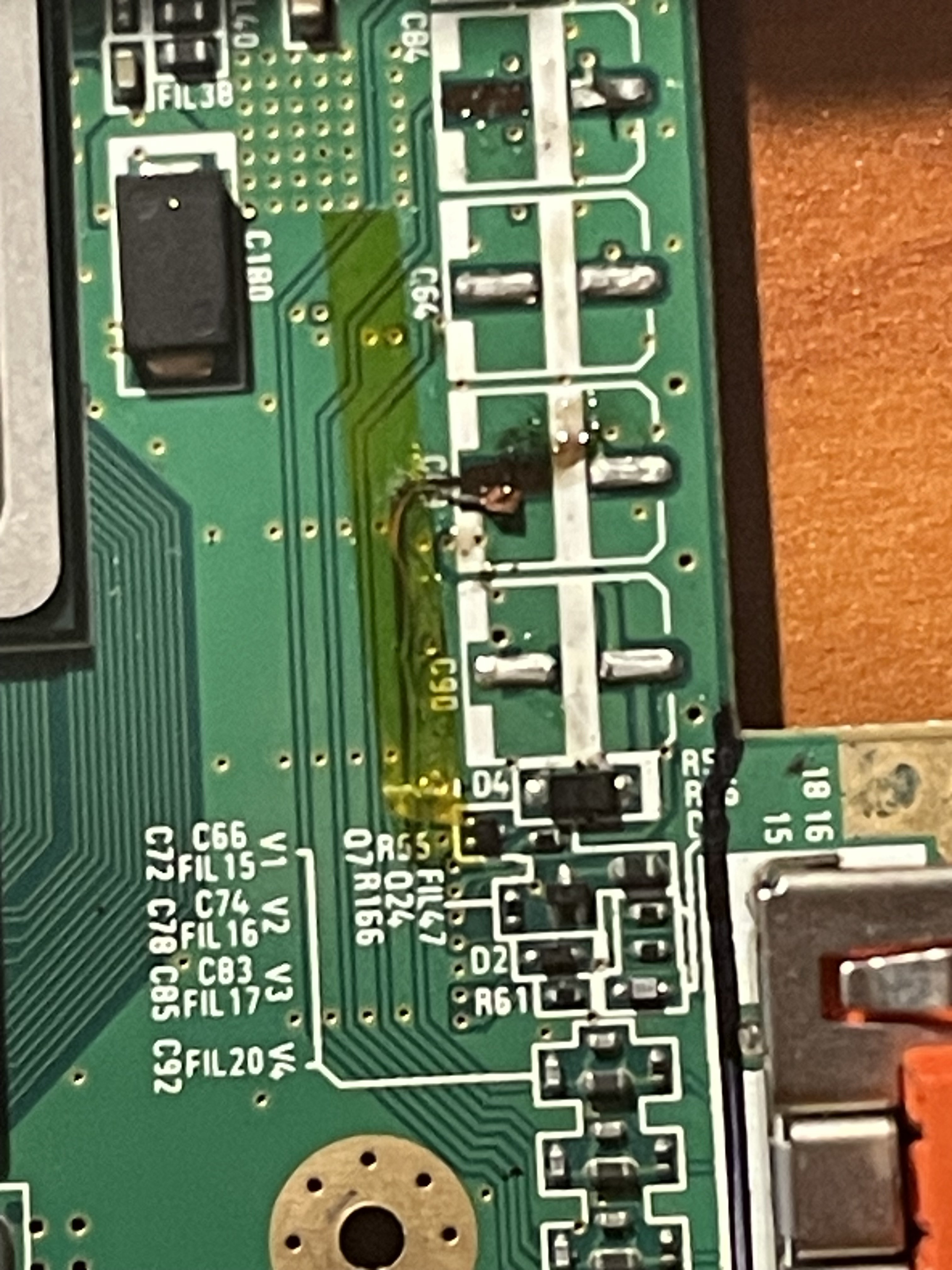

I decided to call this portable project La Cucaracha upon this discovery. After cleaning up that mess, I was left with a bare Wii motherboard. I prepared the Wii for trimming by tracing the OMGWTF outline and removing some of the components in the way. Like the true delicate craftsman I am, I managed to rip up the trace to one of the video output capacitors while removing it. I just stuck it down with kapton tape for now, but if anyone has a better idea of what I should do about it, let me know.
I then cut up the Wii with my Dremel, and sanded it down to a nice smooth edge. I tested the resistance values, and they all looked normal. The below images are of the initial rough cut before sanding.

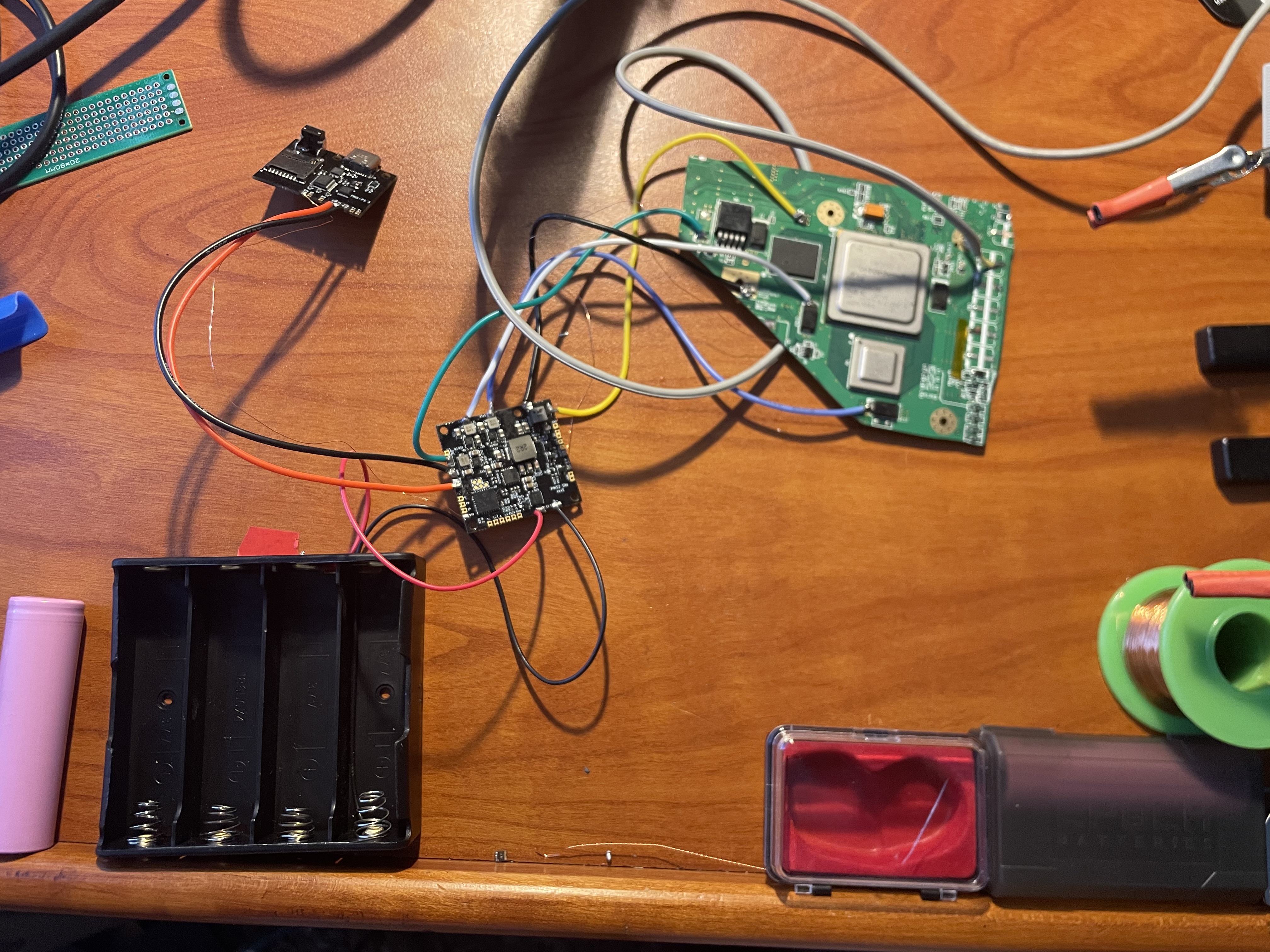

I then started to test the Wii by wiring up the PMS lite to the trimmed Wii, and a battery holder to the PMS lite. I also attached the PMS-PD to the PMS to use the power button and to charge my 18650 battery cells since they were a bit low. I cut up an old RCA cable to get composite video out, and she lives!
