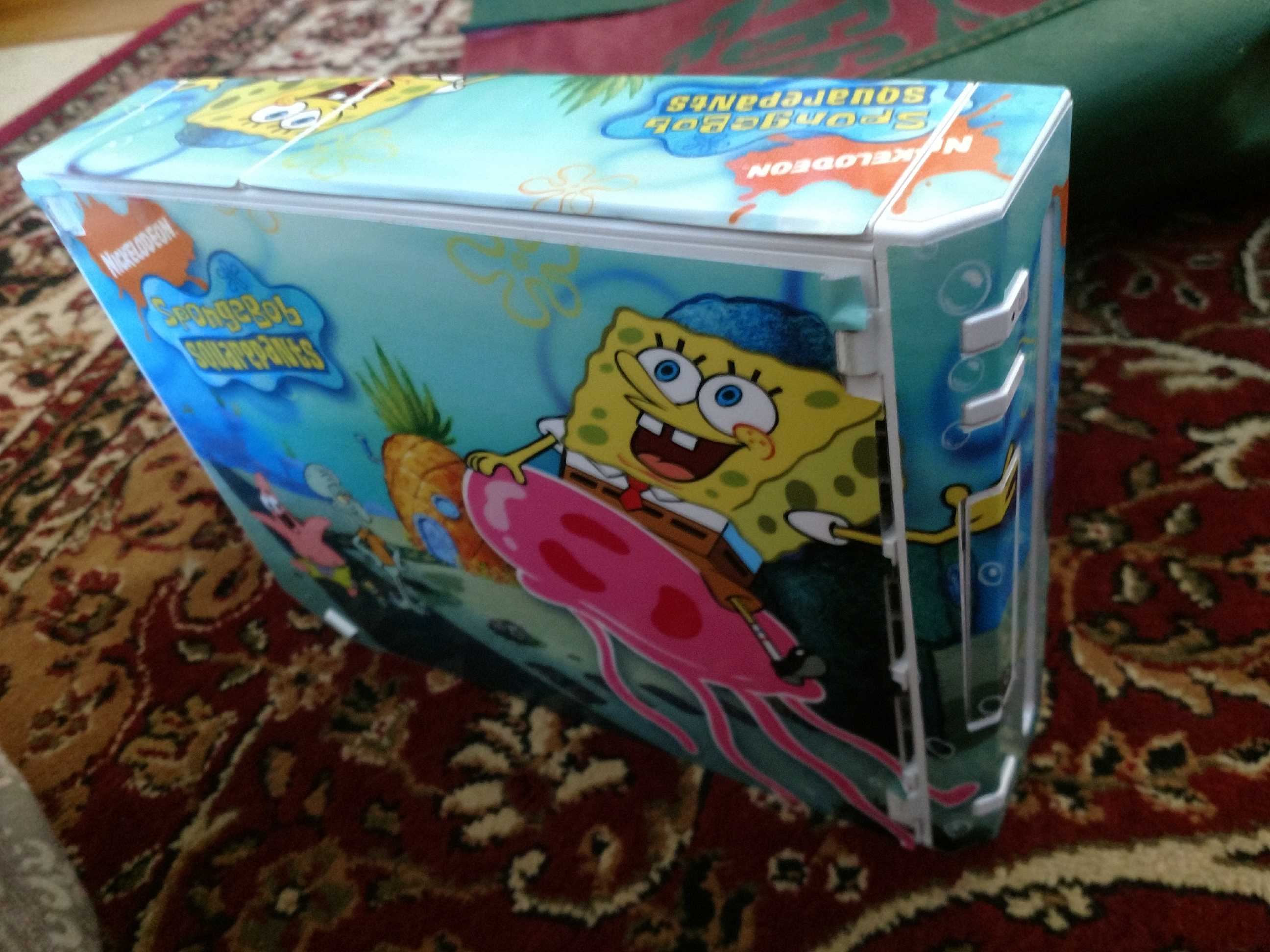

The owner of the Wii was a friend of my sister, they had Spongebob stickers all around it.

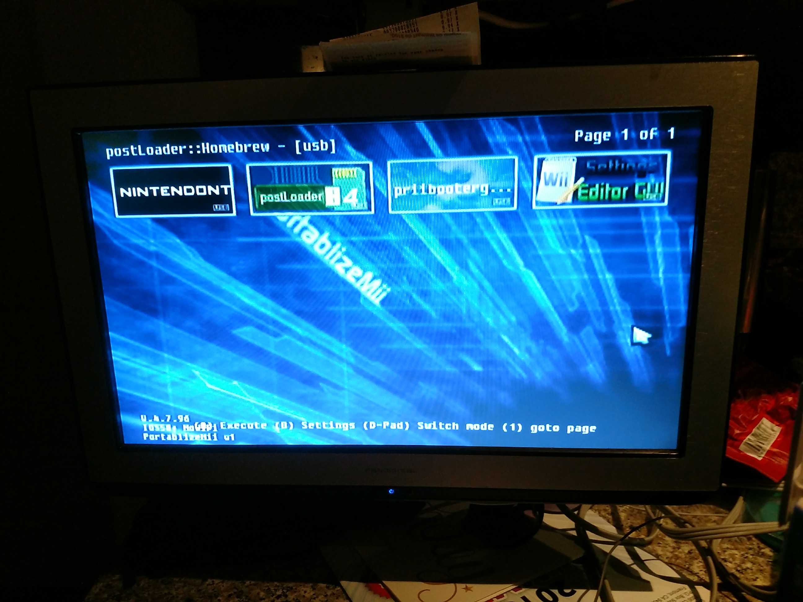

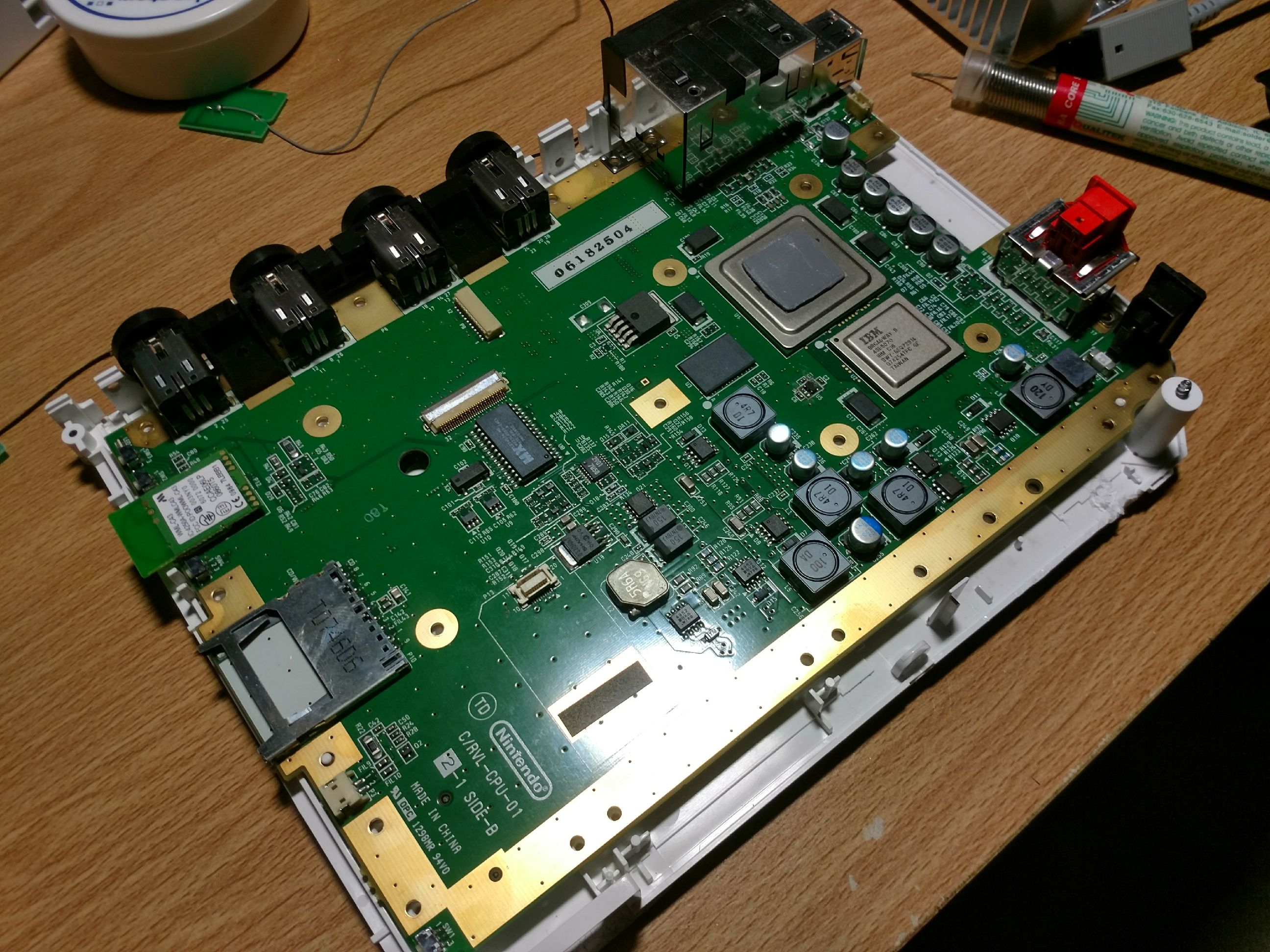

Right after that I checked if everything worked and installed PortablizeMii
Games worked on it fine except Wii games which I am unknown why yet.
Afterwards I opened it up.
It was a 6-layered board, was kinda upsetting, but I'm sticking with it.
Yesterday I purchased 4 PTH08080WATZ regulators and will be expecting it by the end of the week. :D
Just a little bit larger trim of the OM6 trim, the things I just don't like is how the OM6 trim cuts off RA1 which is needed for the 3.3v and the data for the gamecube ports relocation

The RA1 chip just for example. Also when I say GameCube ports I'm talking about the the 4 ports for the GameCube controllers. For the motherboard I've heard people saying that it uses a lot more power and makes more heat, just sucks that I have to restart, and I'm SCARED that the next Wii I buy will also be another 6 layer. :(

If the Wii you buy is a family edition wii (any color), or not the color white.. it will absolutely be a 4 layer Wii.
Doh :facepalm:. Dunno why my mind immediately jumped to memcards, sorry about that.
And keep in mind that these trims have been extensively tested, so if any of the parts cut off were important it would be explicitly stated in the guide.
Gman gave a nice TLDR on which Wiis to buy. Here's the full guide. I'll generally go into eBay, search "black Wii broken", and hunt for an inexpensive one that has issues reading discs.
And don't be afraid to start over now. This is the best time to start over, rather than months down the road. Good luck!

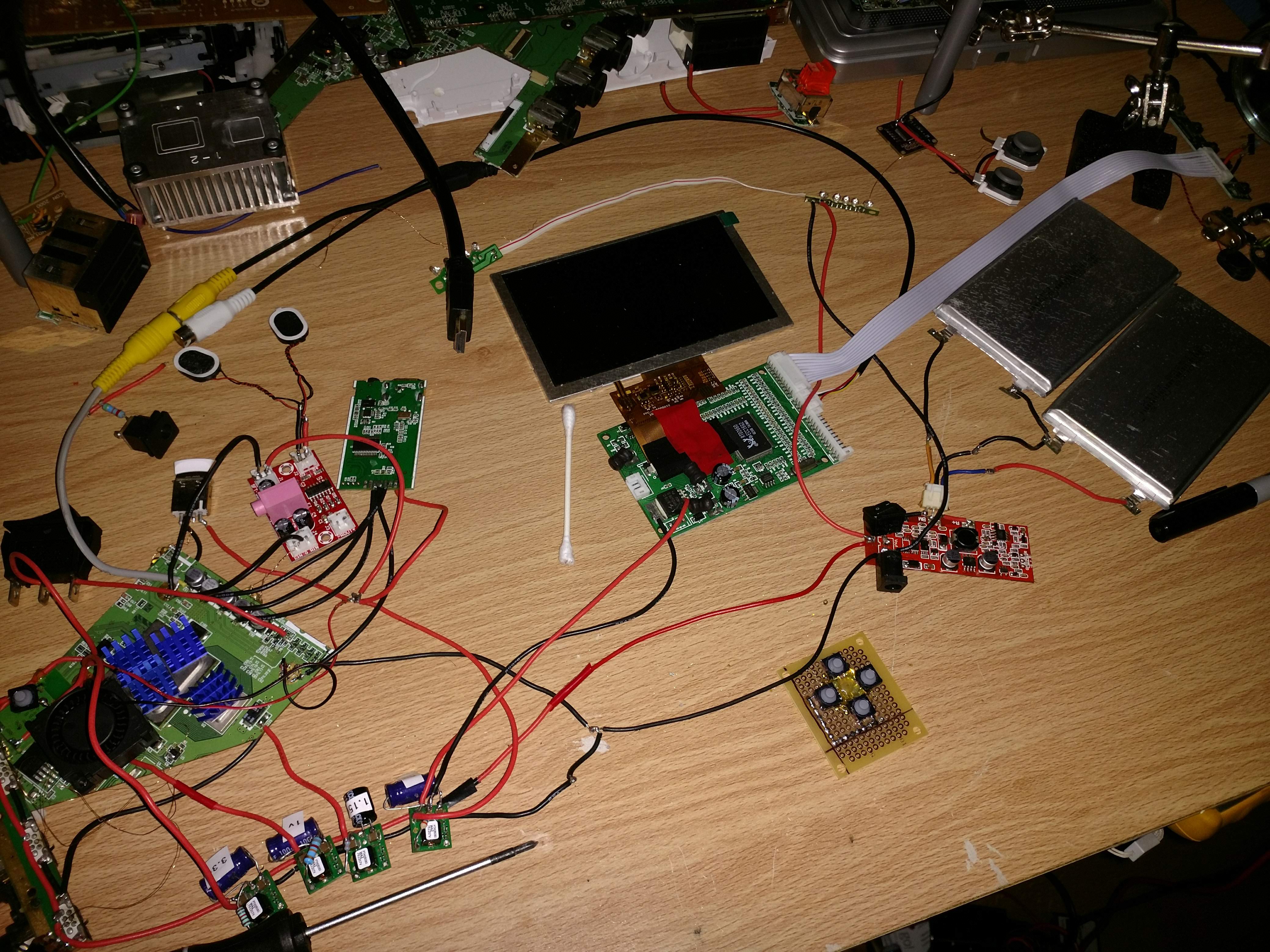

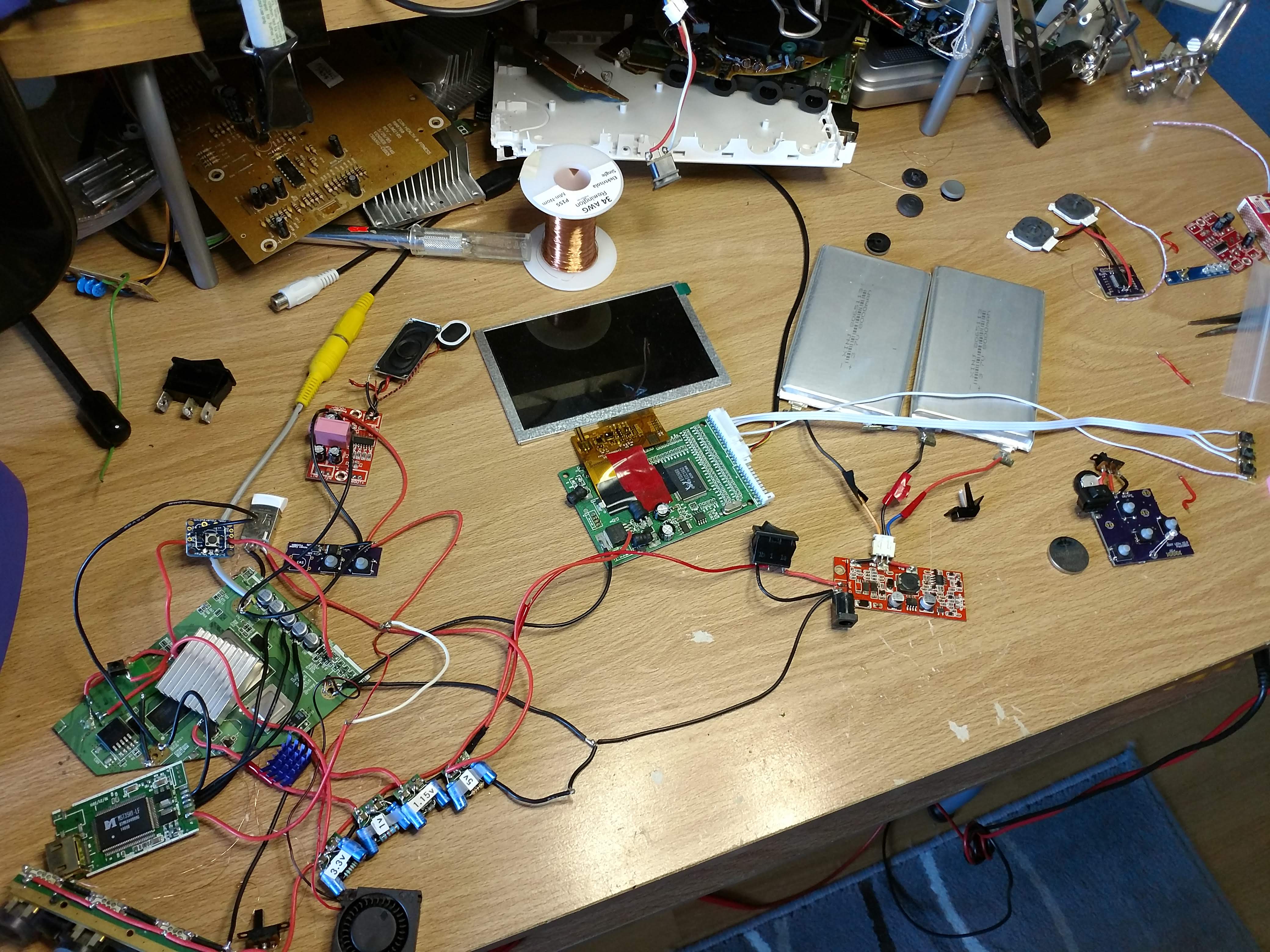

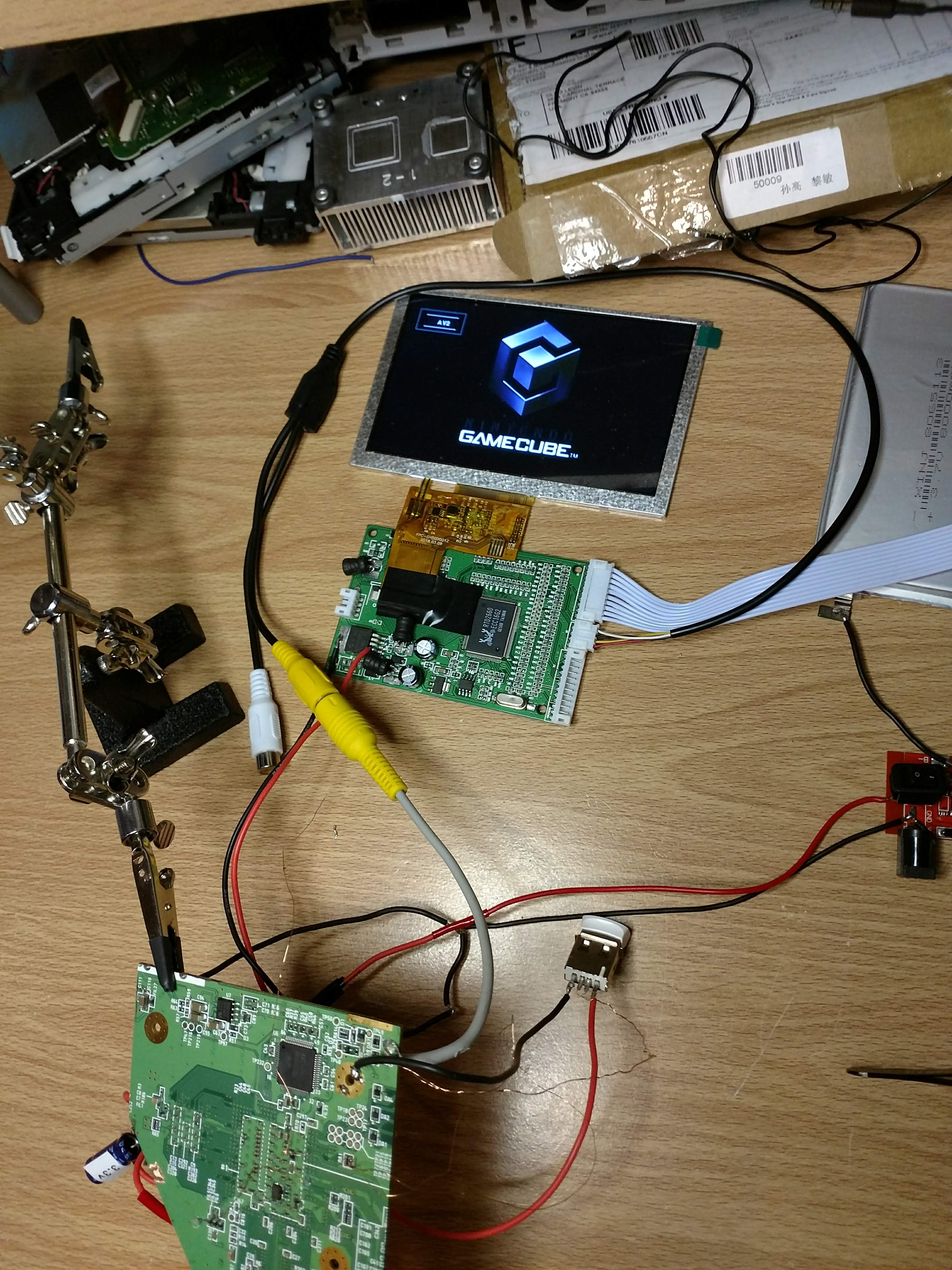

I got a new Wii, black 4 layer and I successfully relocated the Bluetooth and u10. I trimmed down the Wii, got regulators with 2 8000mAh lipos, and a 5" screen and it all booted up. https://www.ebay.com/itm/181915367832 https://www.ebay.com/itm/311721987212 https://www.ebay.com/itm/291812803861
Then after that I got audio working using a lm4863 https://www.ebay.com/itm/282273883752, internal controls using a GC+, got HDMI out using a Sewell Wii to Hdmi that I ripped the case off, and wired up the Gamecube controller ports. Also I got a 35mm heatsink and blower fan to keep it cool. https://www.ebay.com/itm/322829680260

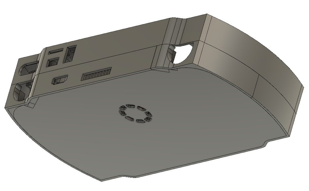

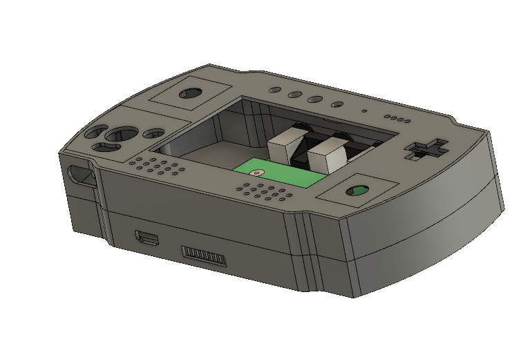

Then I started working on the case, I planned on 3d printing the case.Ceeapture.PNG Capturhhgfje.PNG

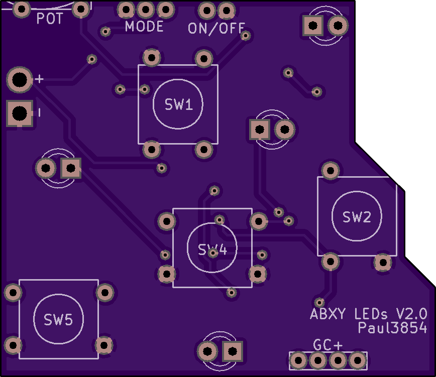

ABXY LEDs, this was something inspired by Madmorda's amazing casted buttons, I had some clear oem colored ones and I had to add some LEDs. For some reason I wanted it so that they would turn on when you pressed the button, but also be forced off and on without messing up the button functionality.

And this is it now, a bunch of wire spaghetti. All is left is to make the USB Switch, finish the case, and just rewire everything inside :!:.

I connected audio from the Wii to a digital potentiometer pcb I talked about earlier, and then took that audio into the lm4863 with two speakers, one for each left and right. This is the speakers I used: https://www.ebay.com/itm/1pcs-40x20...h=item4b4db69b62:g:Tz8AAOSwxjxa8Q8w:rk:6:pf:0 I haven't really tested them out fully but they seem to sound fine.
For the GC+ I bought it from Madmorda, thank you Madmorda, I've did the basic testing and that all, decided to use 3ds slider for the joysticks.
also, if you want to, you could use VGA on that screen, if you are confident in your ability to soldering to the AVE
I want to have HDMI out of this portable and the Wii replaces component with VGA so I can't do that.
