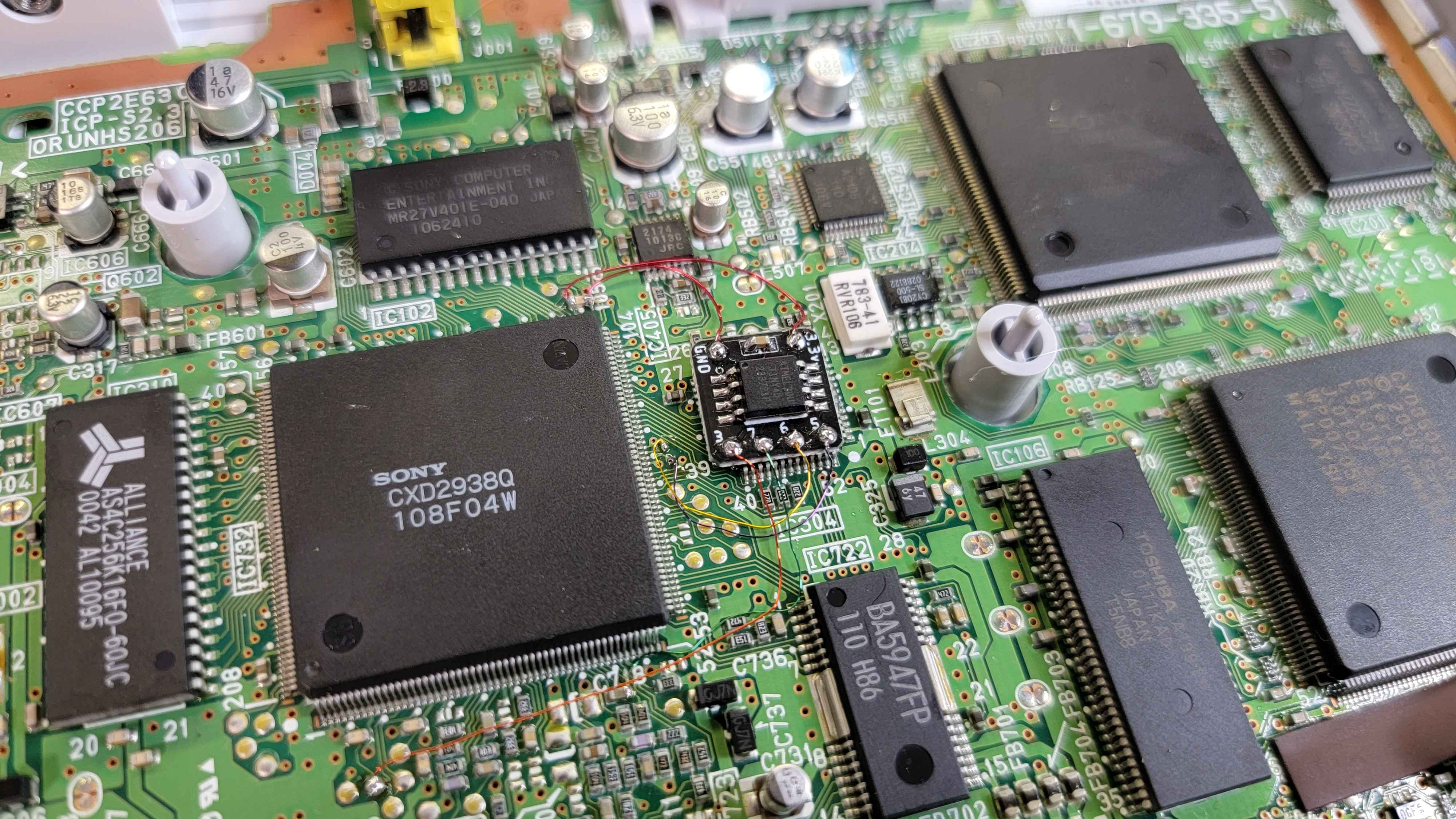

I've got a PSOne modded with all the mods that the final build will have. The mods will be pretty light overall. There's a PSNee installed to run backup discs off of.

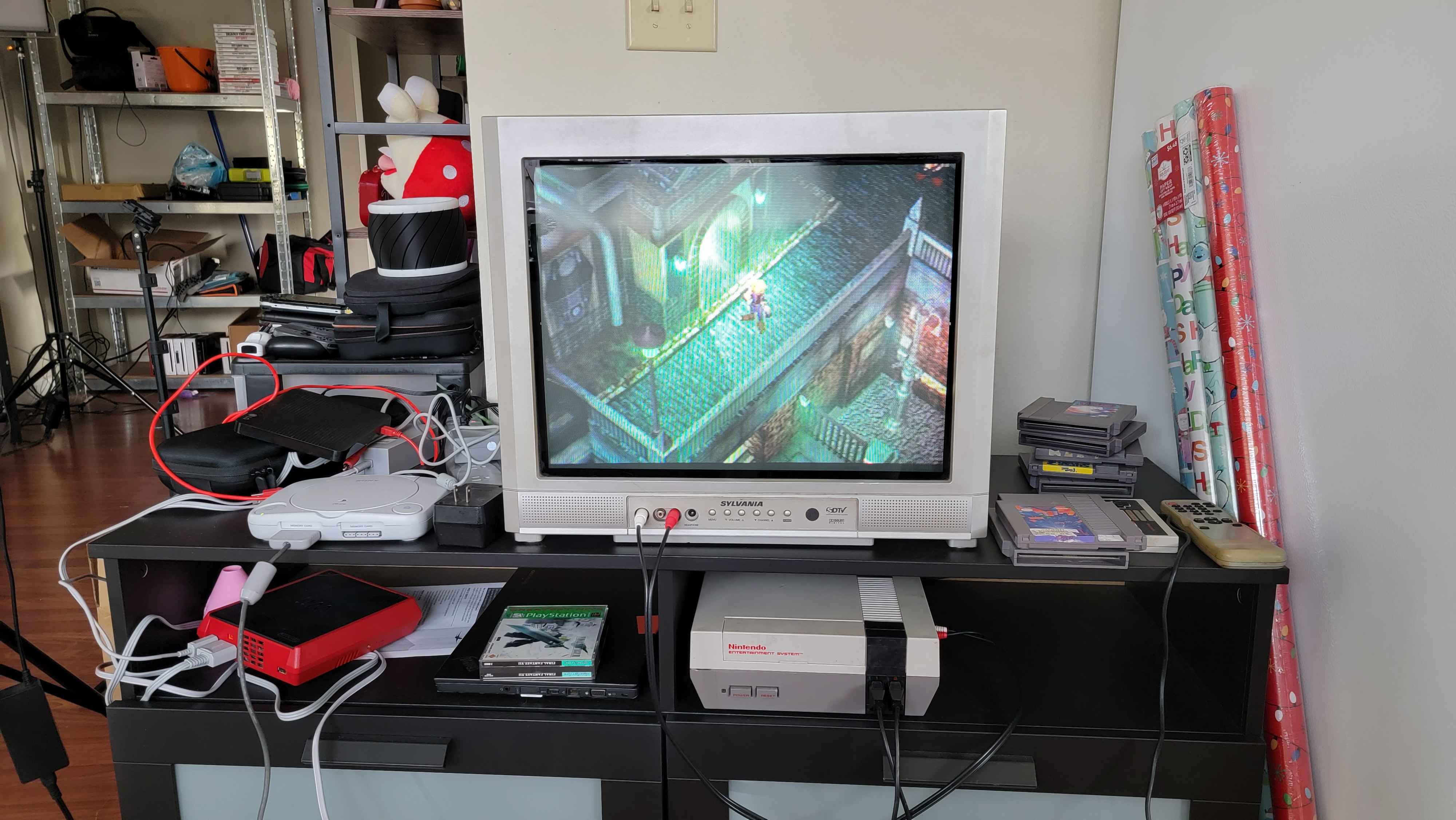

I considered picking up a RetroGem for HDMI output, but the price tag is tough to swallow right now. I picked up a $40 CRT off of Facebook Marketplace and will use that as my "authentic video mod" for now. A quality Retrotink or similar scaler might end up being my solution for modern displays, as I can justify the expense with a "yeah this'll work for every retro console I could ever own".

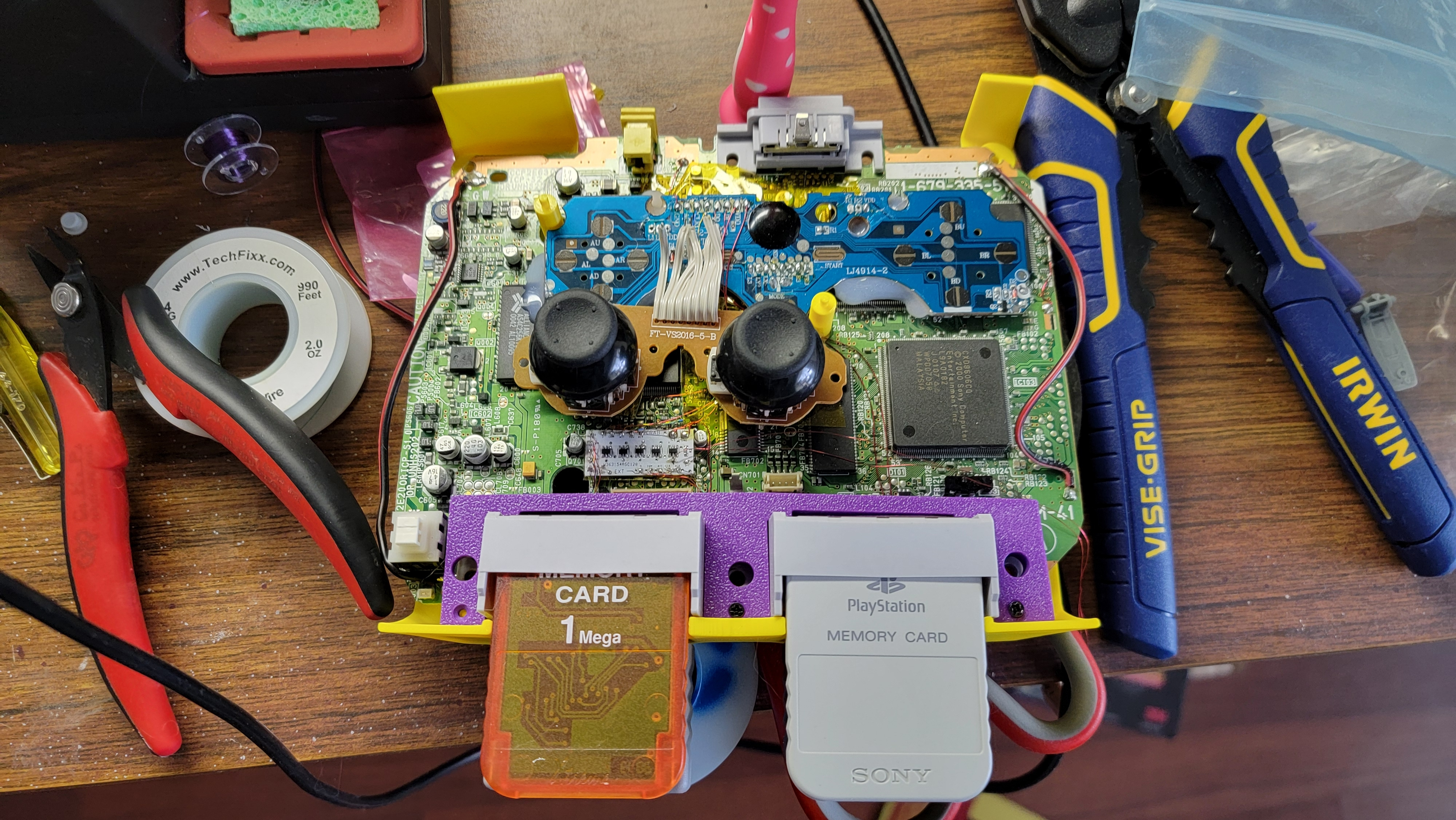

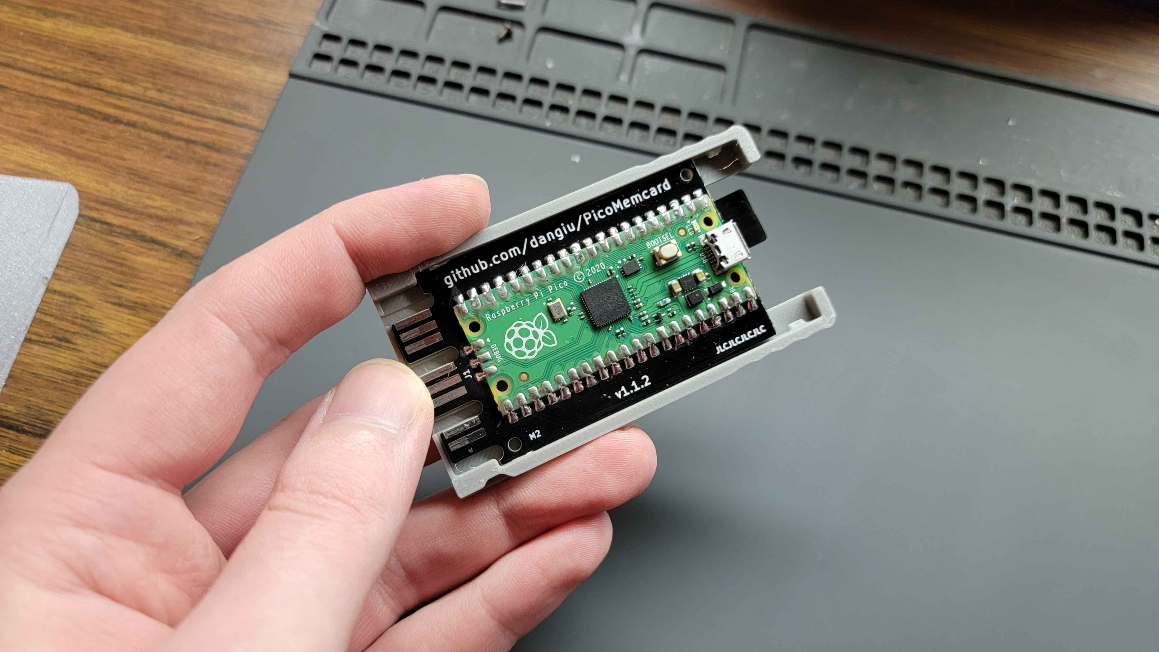

I also threw together a PicoMemcard+ as my memory card solution. It looks like there are slicker options out there for home consoles, but this will work fine for now. I plan on designing my own shell for the PCB that'll suit the Playstacean theme.

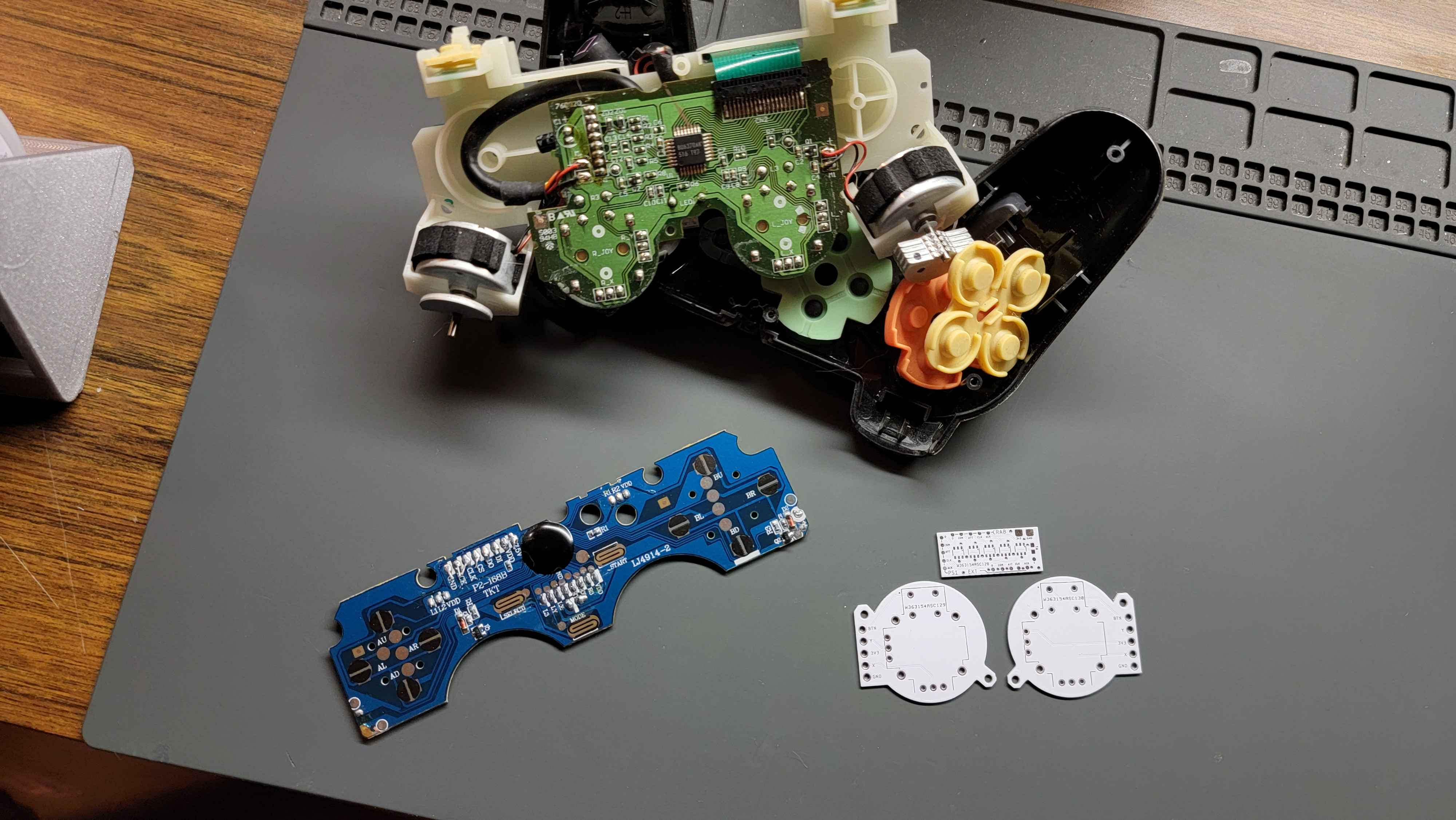

Then I need to make my own "mod": the crab controls on the shell. The plan is to frankenstein a broken Dualshock 2, a 3rd party Dualshock, and a little multiplexer board together to allow me to toggle between the crab controls and the player 1 port. We're going light on the custom PCBs this time, just a couple of simple ones for the sticks and the switching circuit.

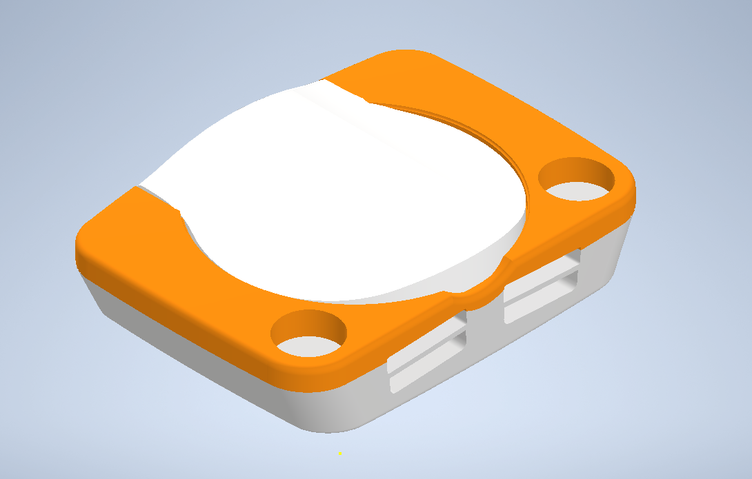

The soldering and assembly for this build should be pretty straightforward. The real challenge is modeling every piece of the crab in CAD. After starting over half a dozen times, I finally got an overall shape that I'm happy with.
The overall shell is a bit chunkier, partially because that's how the artwork looks, and partially because the artwork has the memcard and controller ports angled, so a bit of extra height is needed to accommodate that. The slope from the bottom of the case up to the orange is going to make trimming the PSOne motherboard a necessity, but I should be able to get away with cutting off the ground planes on the sides without too many issues (I hope).

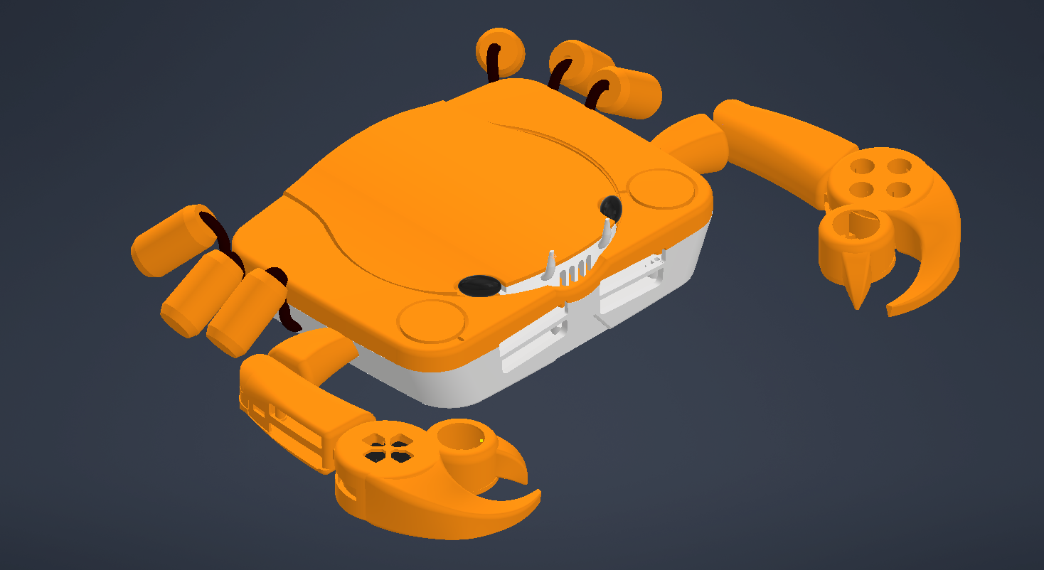

The process of modeling the crab took way longer than anticipated. The CAD work was a real challenge, but it was really satisfying to work out the issues with each piece. I ended up getting a little more comfortable with the loft tool, and was happy to have a reason to use the "mirror entire part" button in Inventor. I would have liked to better nail the look of the eyes and get more details on each piece of the controller arms, but I think he still looks pretty good, simple as he may be.

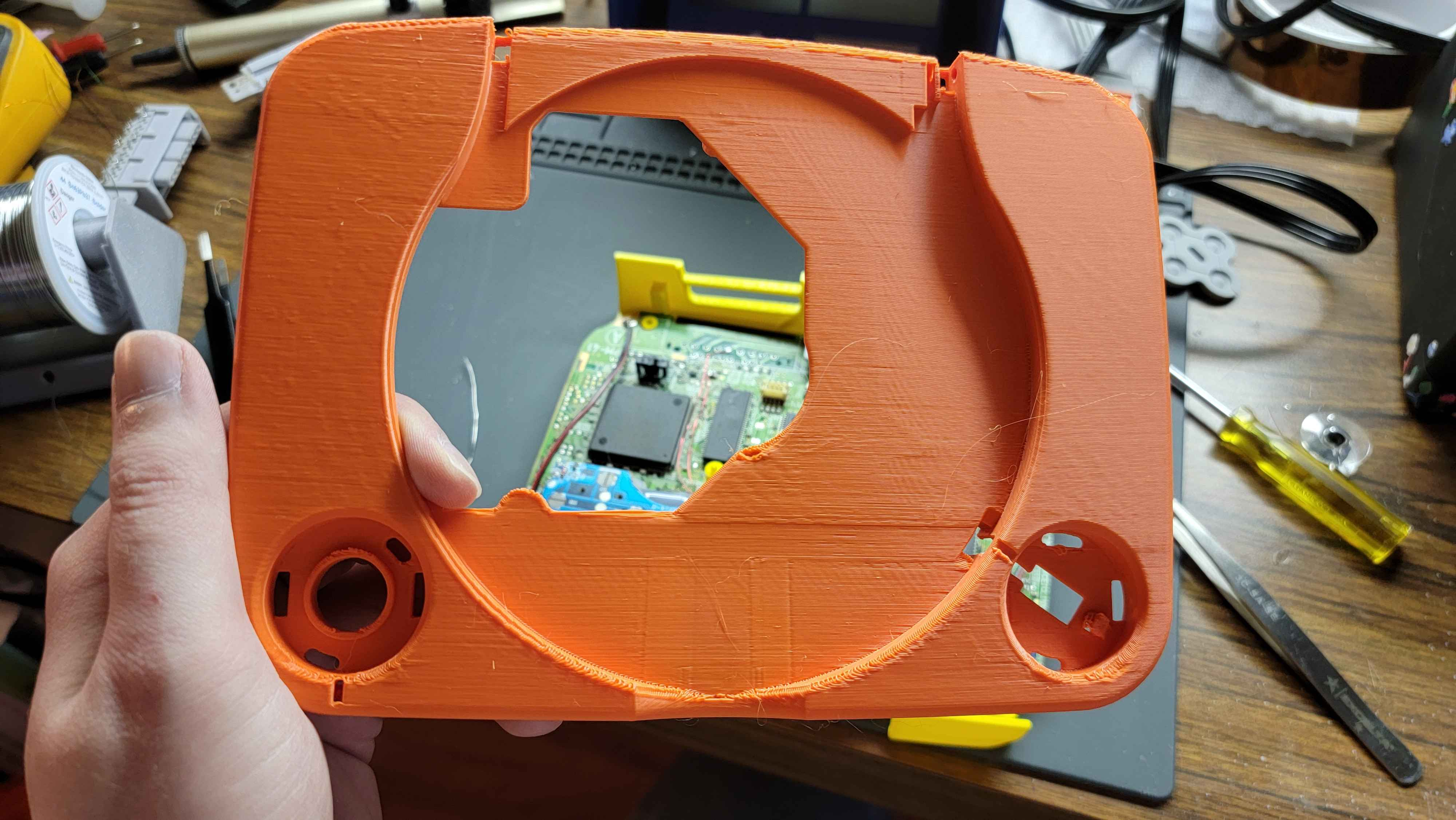

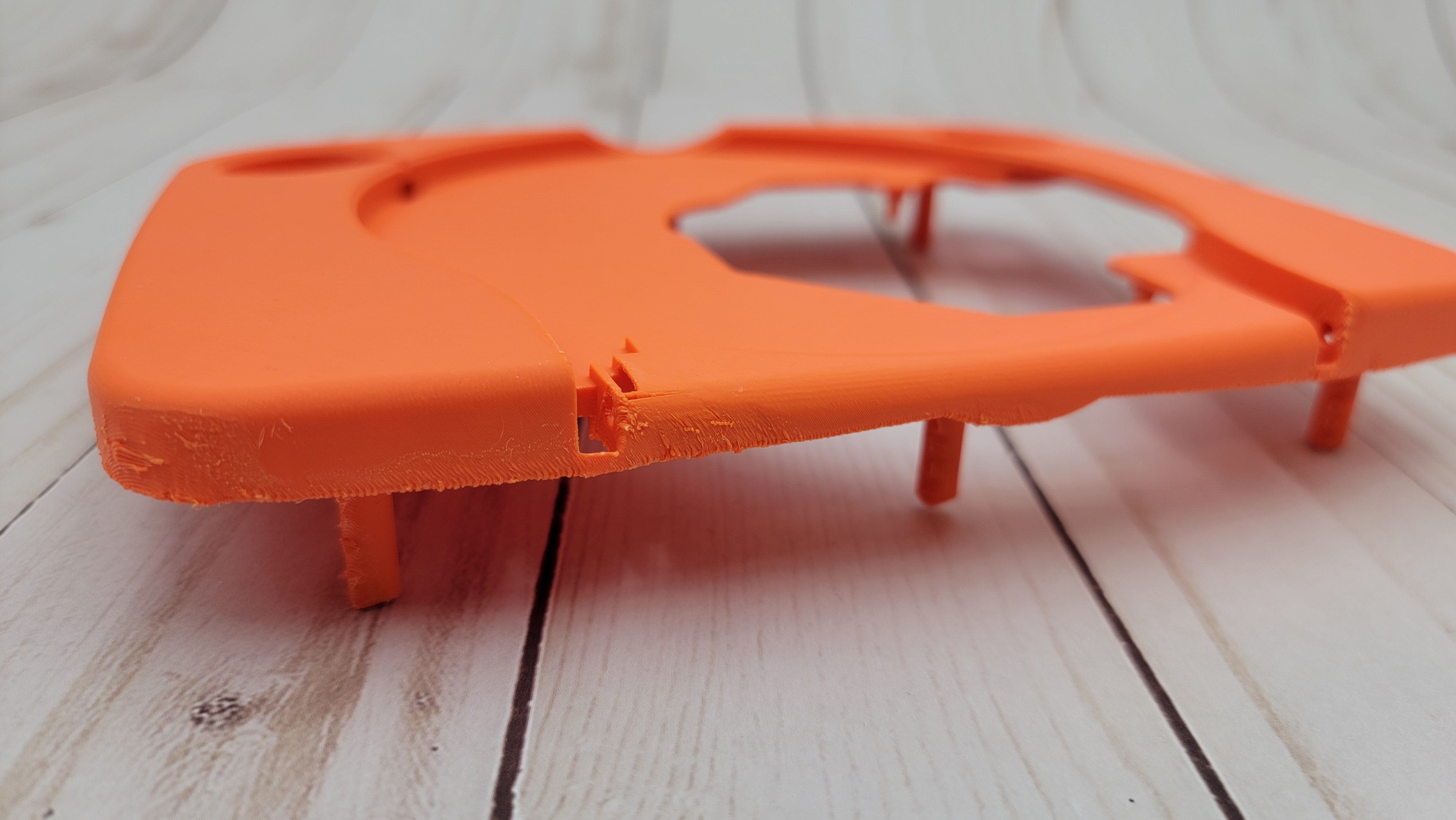

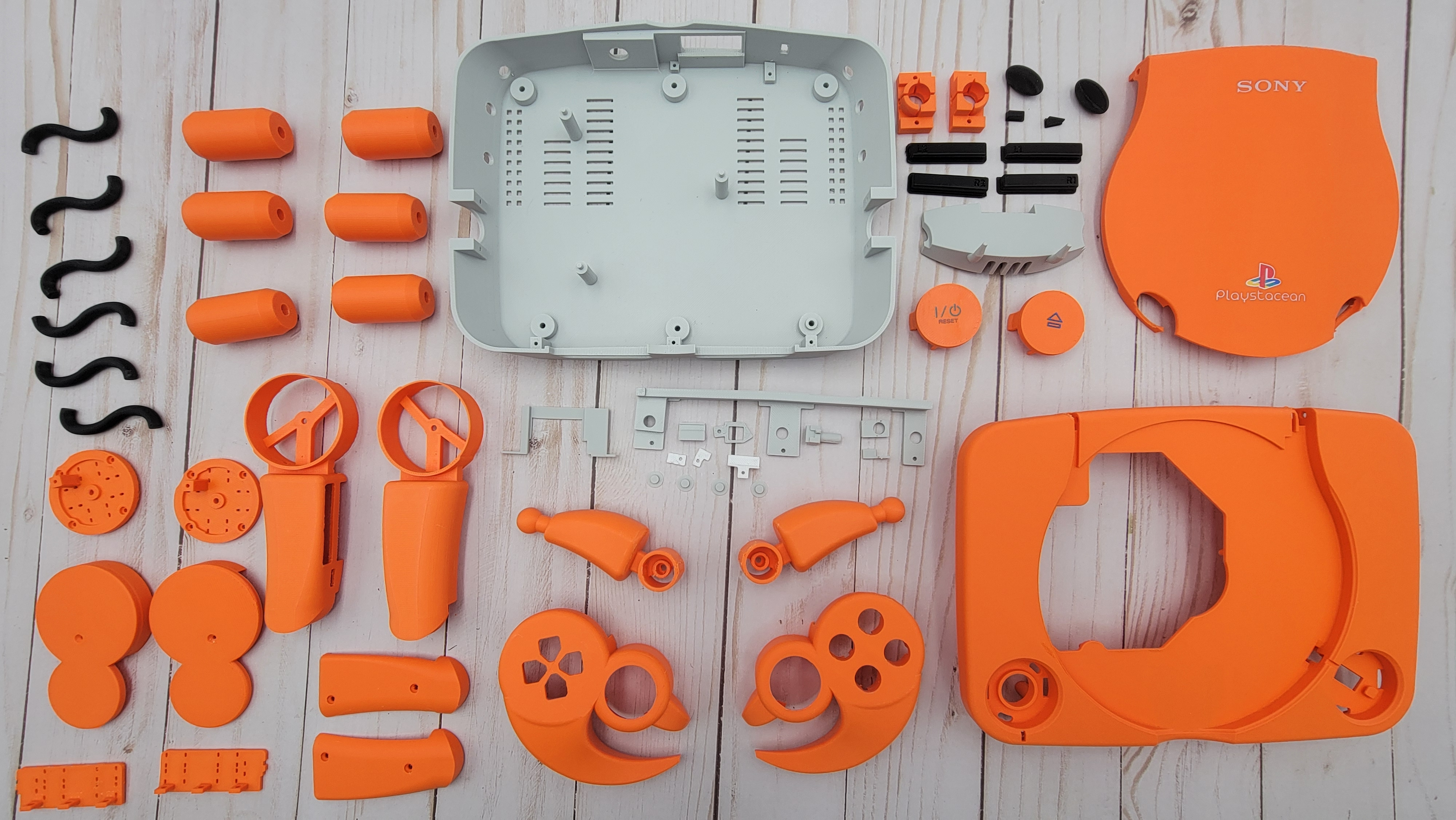

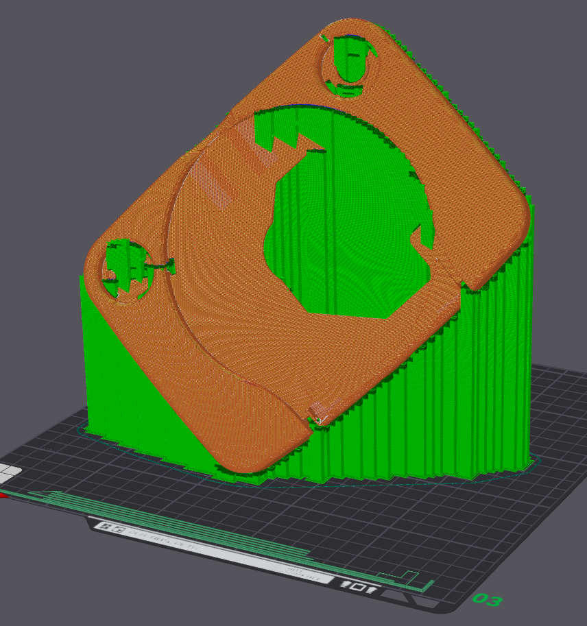

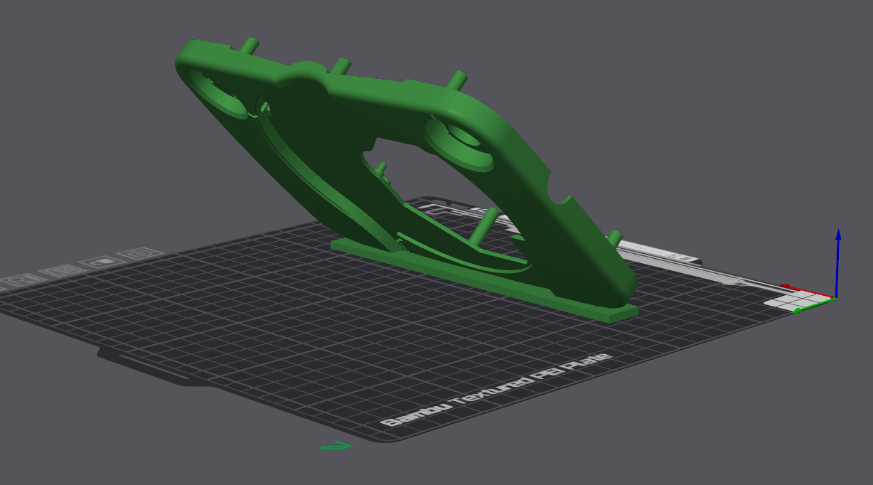

I did NOT want to do any post-processing on the 3D prints for this project, so I spent a decent amount of time experimenting with angles and supports. This custom raft system from @Wesk was lightning fast compared to any other orientation I tried, with the added bonus of not needing to spend time removing supports. Definitely a system I want to use in the future for prototypes at the very least.
The finish wasn't as clean with just the raft as I would've liked, so I went back to trying more traditional supports. With FDM printing, one angle had to be ugly no matter what, so I tried to condense the ugliness to the back half of the shell. This orientation worked really well, and I don't mind too much if my crab has a bit of an ugly butt.

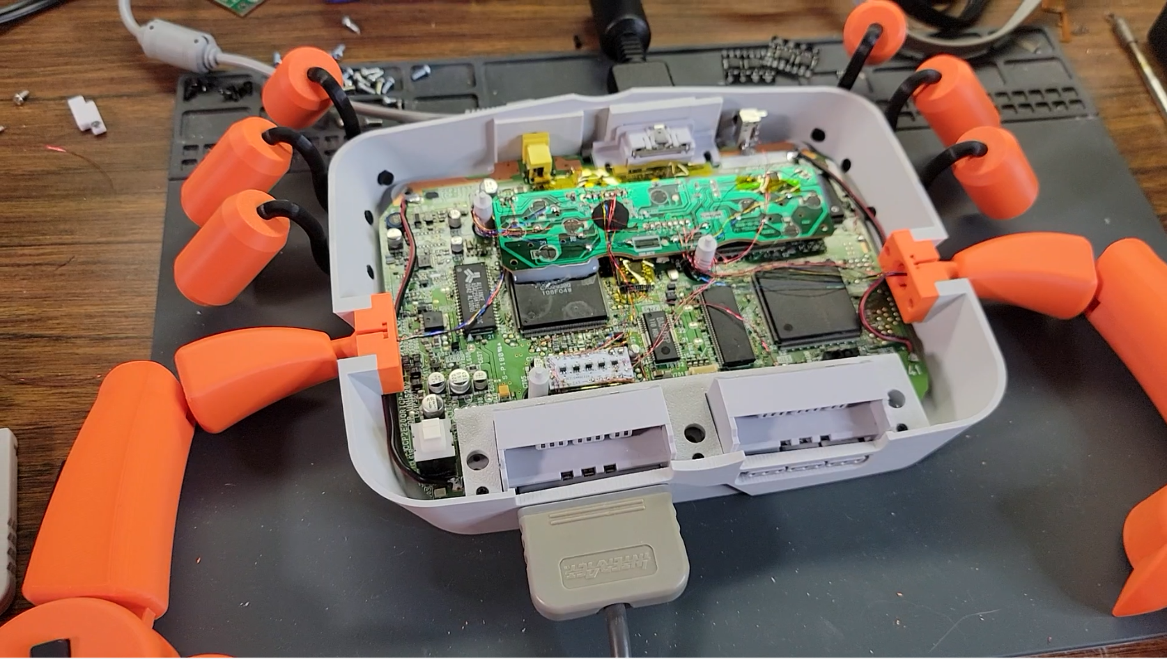

There were a couple of issues with the controller stuff. First, I had to switch from using digital muxes to analog muxes, because I didn't know that the direction of the signal matters when using digital muxes. Thank to @YveltalGriffin for pointing that out. With the analog muxes, the port controller worked fine, but the crab controller put out random inputs. @Customledmods told me that the 3rd party controllers spam random inputs when there's no joysticks connected, and sure enough it started working much more consistently once I reattached the joysticks! The blue controller board did still have some random disconnect issues, so I swapped in a different, green 3rd party controller board. There weren't any issues after that.
The angled ports on the front were a real pain as well. My player 1 ports lined up pretty much perfectly and could be soldered at a bit of an angle as is without any fanfare. At some point, something got screwed up the the positioning of player 2 ports, so they were slightly off and wouldn't fit in the board and the case at the same time. I ended up running wires for everything on the P2 port, and secured it in place with a handful of 3D prints to keep it from moving. The ports feel surprisingly robust, if a touch tighter than the typical setup.

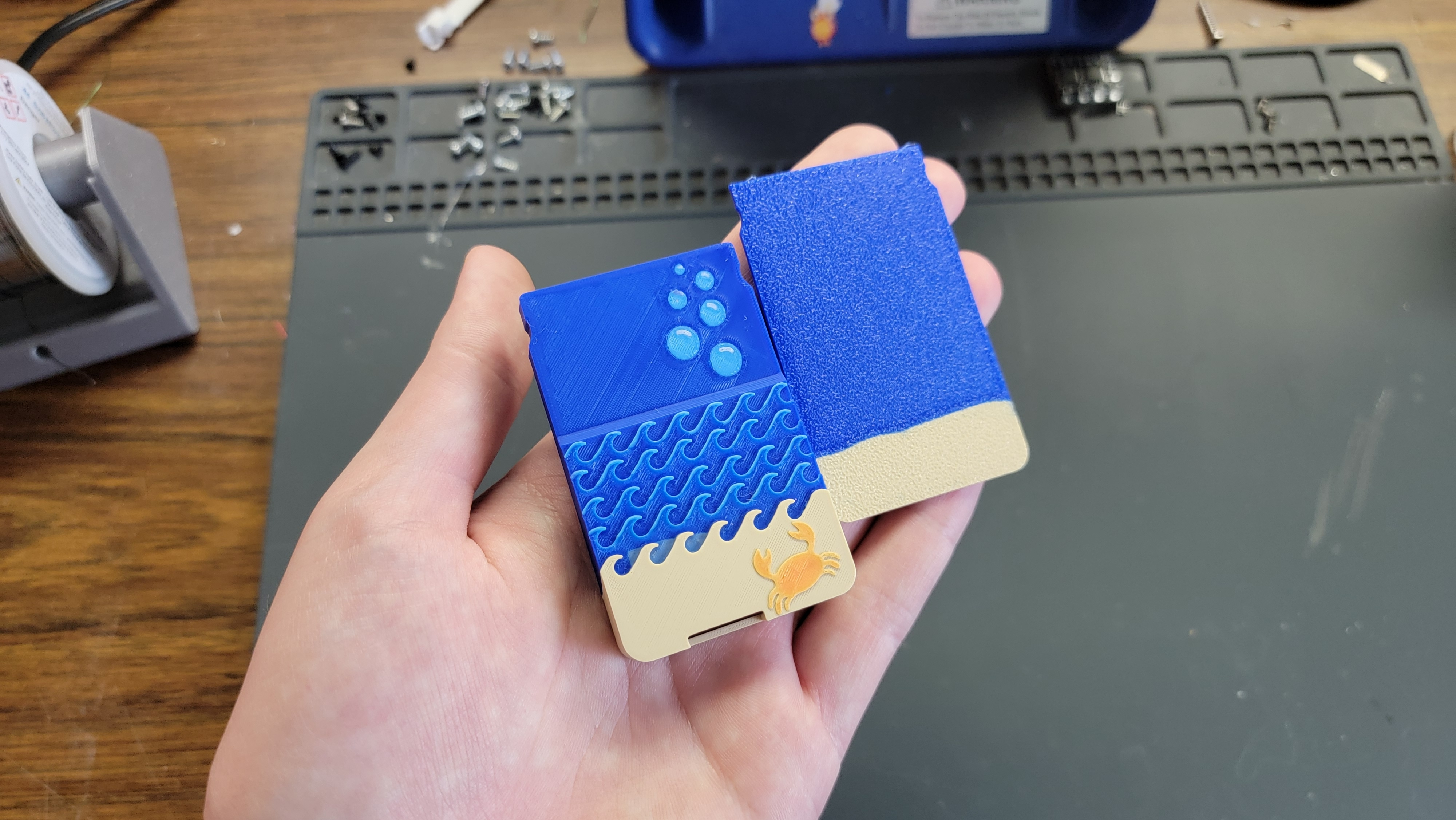

The custom Picomemcard shell was fun to make. I used a 0.2mm nozzle to get some of the details, though it certainly increased the print time a fair bit. A couple weeks later, this SD2PSX popped up on Aliexpress. I might go back and tweak my shell to be able to fit the hardware from one of these in the future.

I used PETG for the orange pieces of the crab to try and give the ball and socket joint some resistance. This worked really well at the start, but the arm are already pretty loose after just a couple of weeks. I dunno if there's a good solution for keeping him nice and stiff, but I'll survive if he's a little loose.

Sorry for the double post, but I did want to bump this thread and ask what layer height and what angle(if you know) was this project this printed at? After seeing how nice the shell turned out at MGC, I'd like to try something similar to this sometime. I'm also curious to know how long the the top and bottom took to print.
I dunno the angle, it was very steep. I did 0.08mm later height, top and bottom took a while to print, but I don't remember the times
