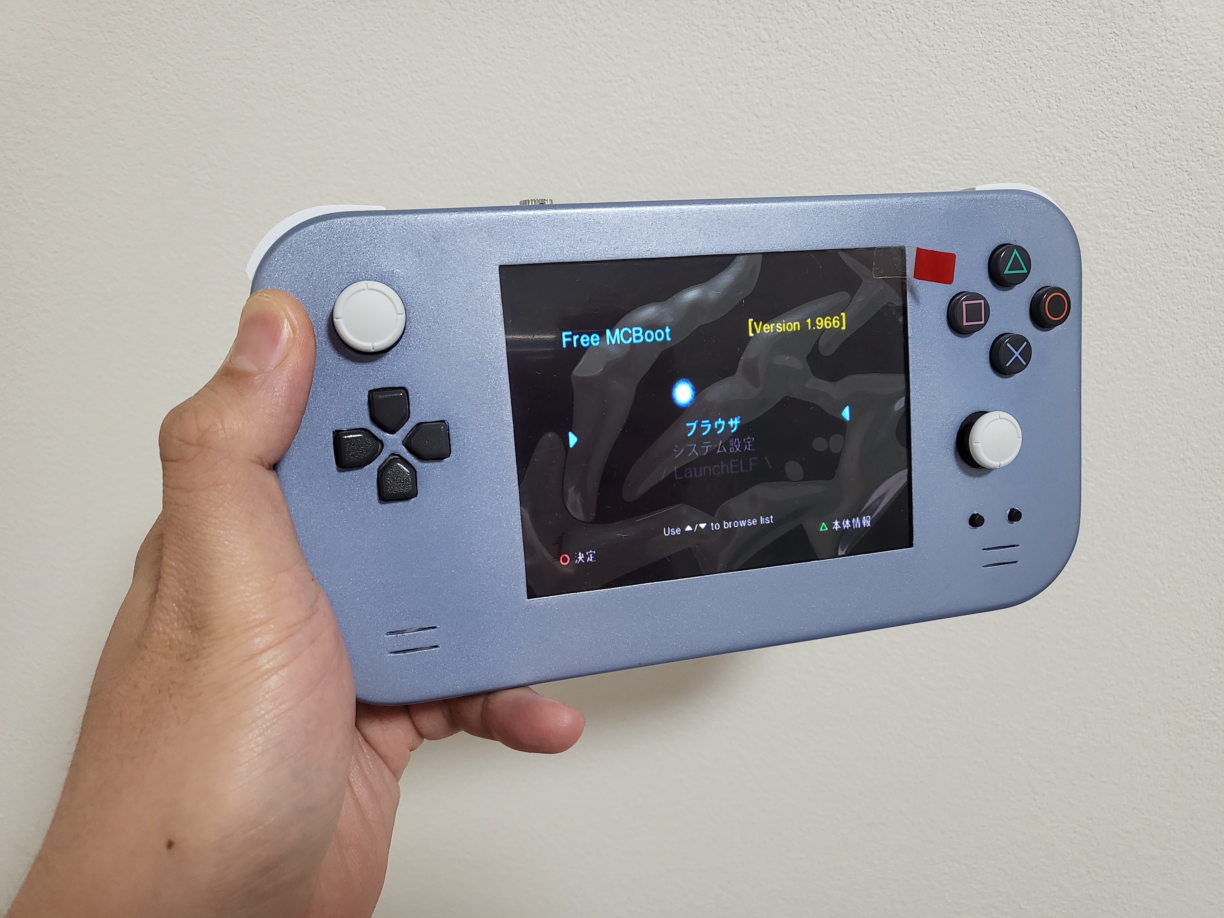

Hi.
Two years ago, I made a small sized ps2.
I decided to make a new ps2 because of the small size of the screen and the feeling of operation.
- PS2 scph-79000
- 5 inch LCD
- 18650 battery x 2
- PS2 controller(fake)
- SD loader (MX4SIO)

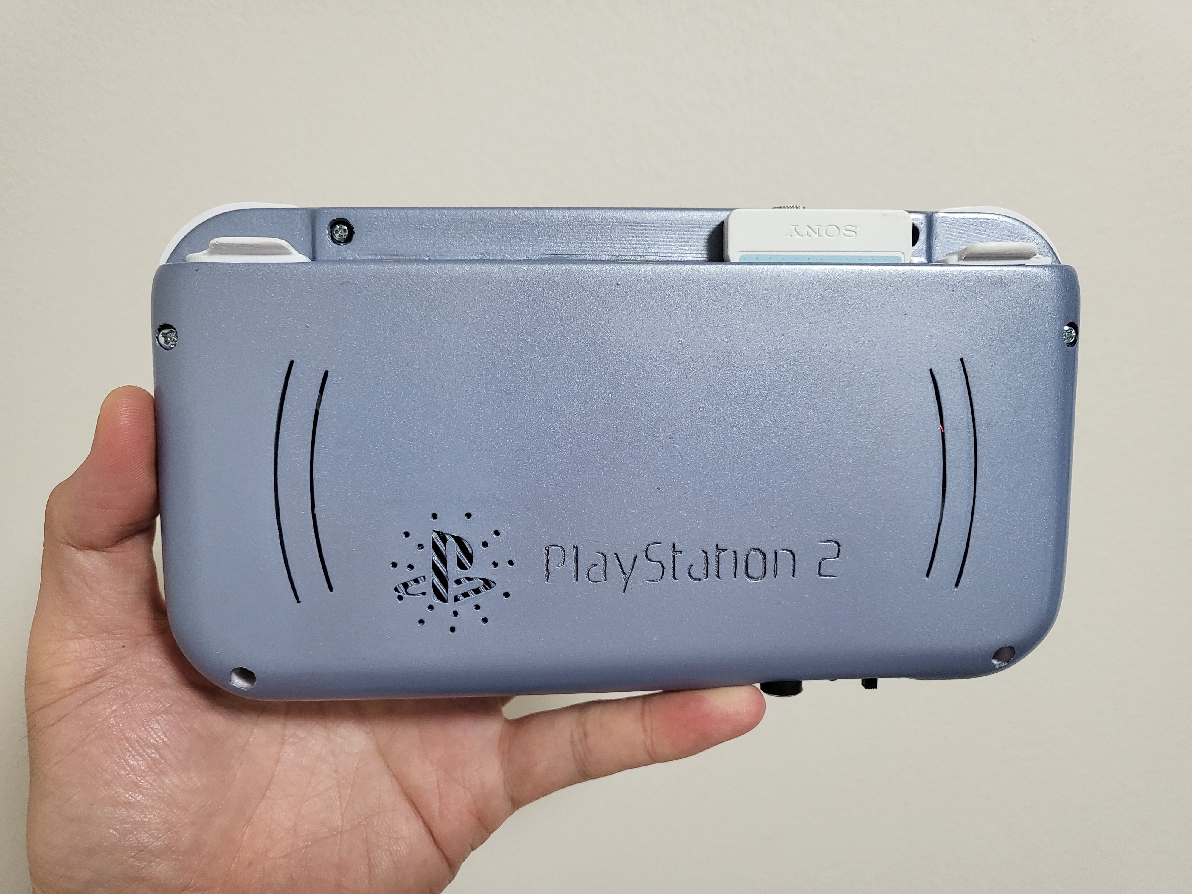

This is a portable ps2 I made 2 years ago.
The small screen is inconvenient.
I used a standard trim.

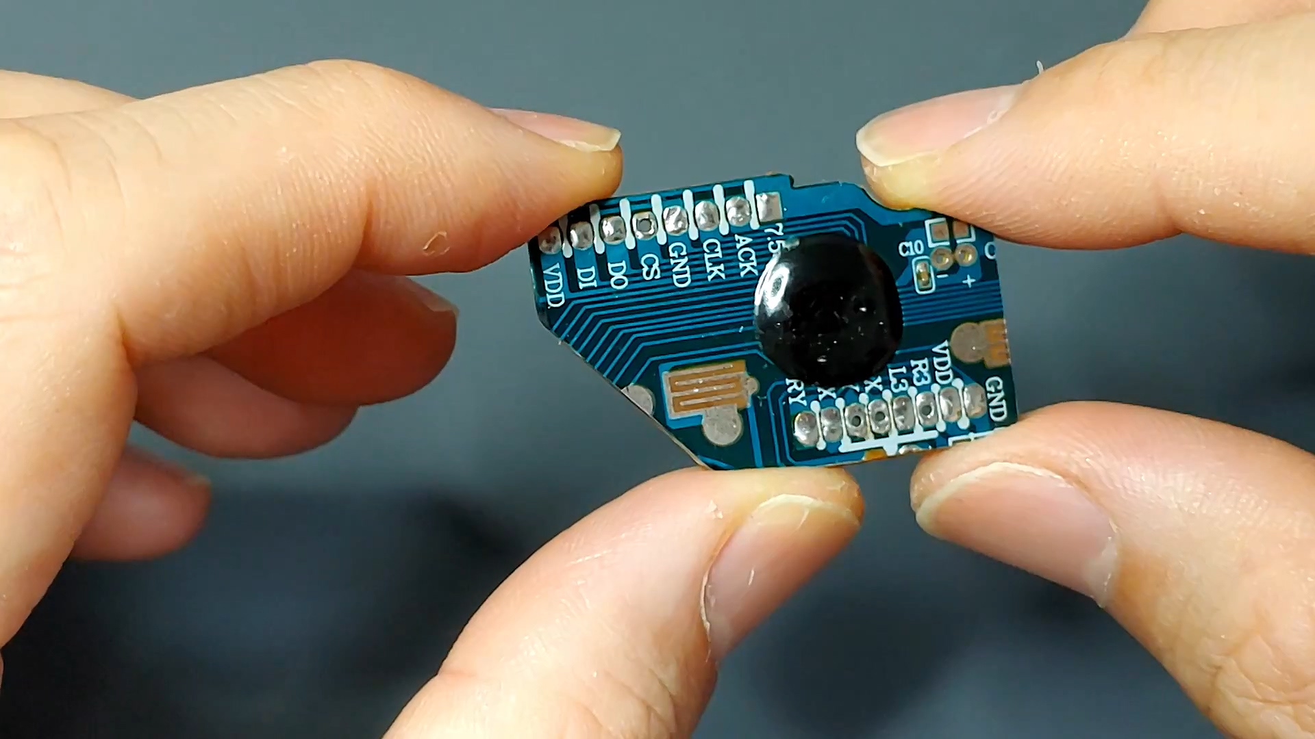

I decided to use a fake controller that is easy to modify.

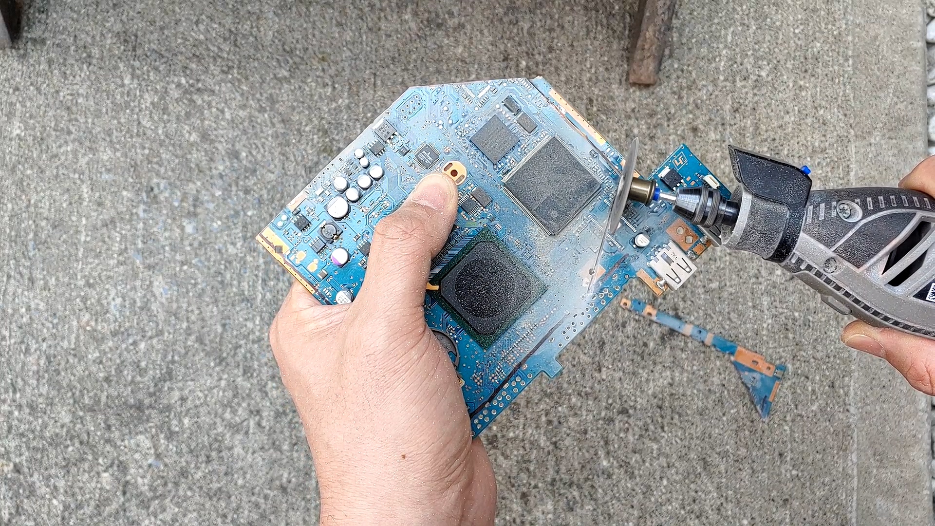

The cut was made to the smallest possible size.

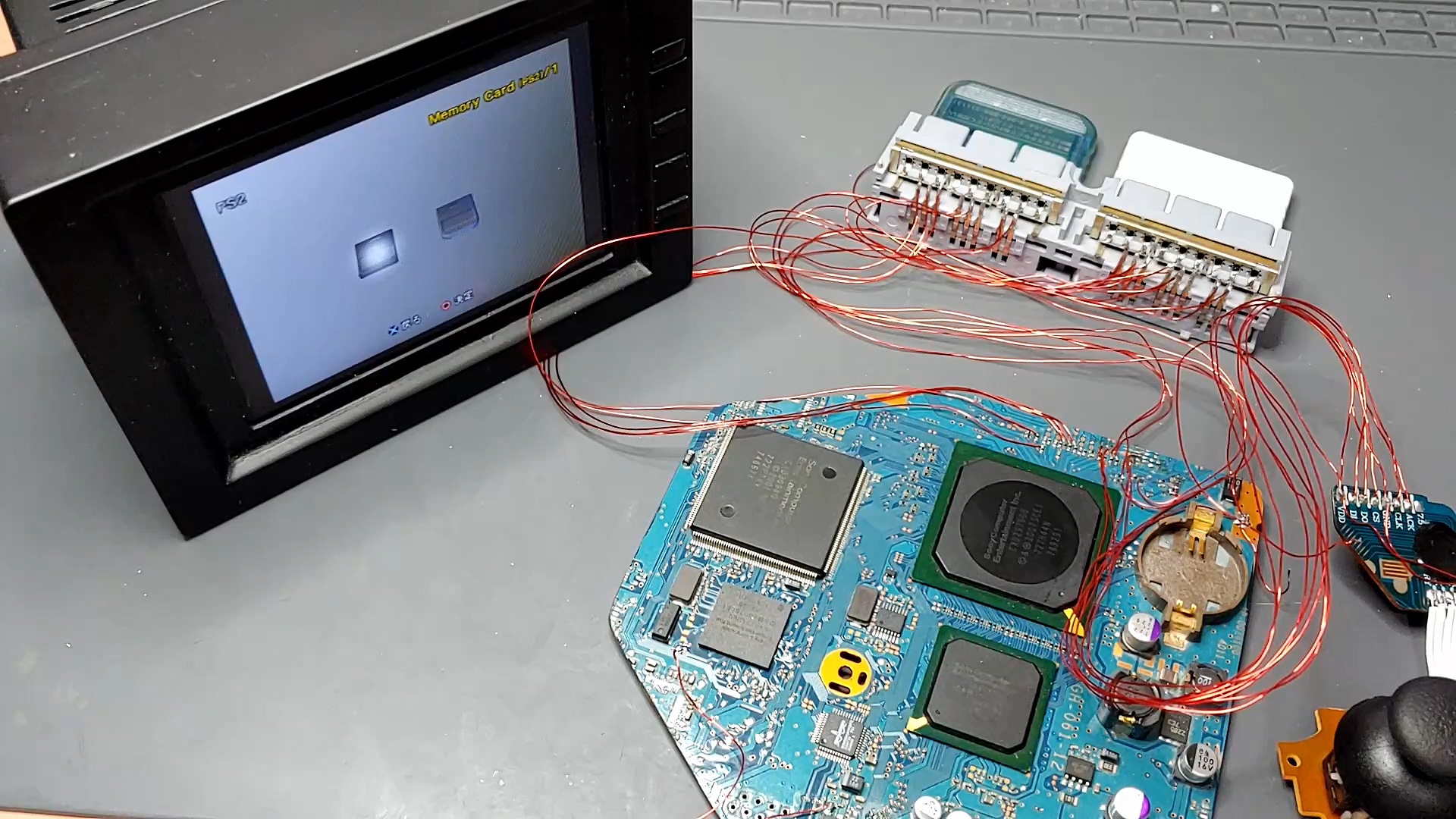

There seems to be no problem when connected to the ps2.

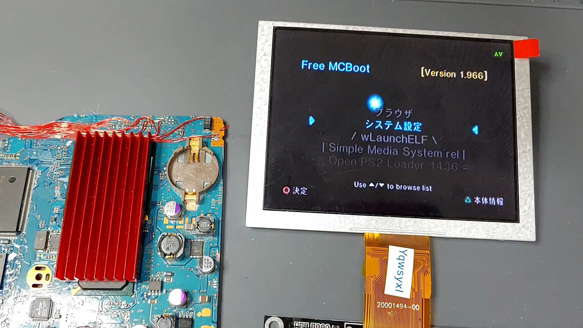

I want to use 2 memory card slots.
I checked it by connecting it to the connector disconnected from the ps2.
Fortunately, the 480i output from the LCD I have was connected to the vga and I decided to use it.
There are a few design mistakes in the case, so I'll fix it and upload it again.

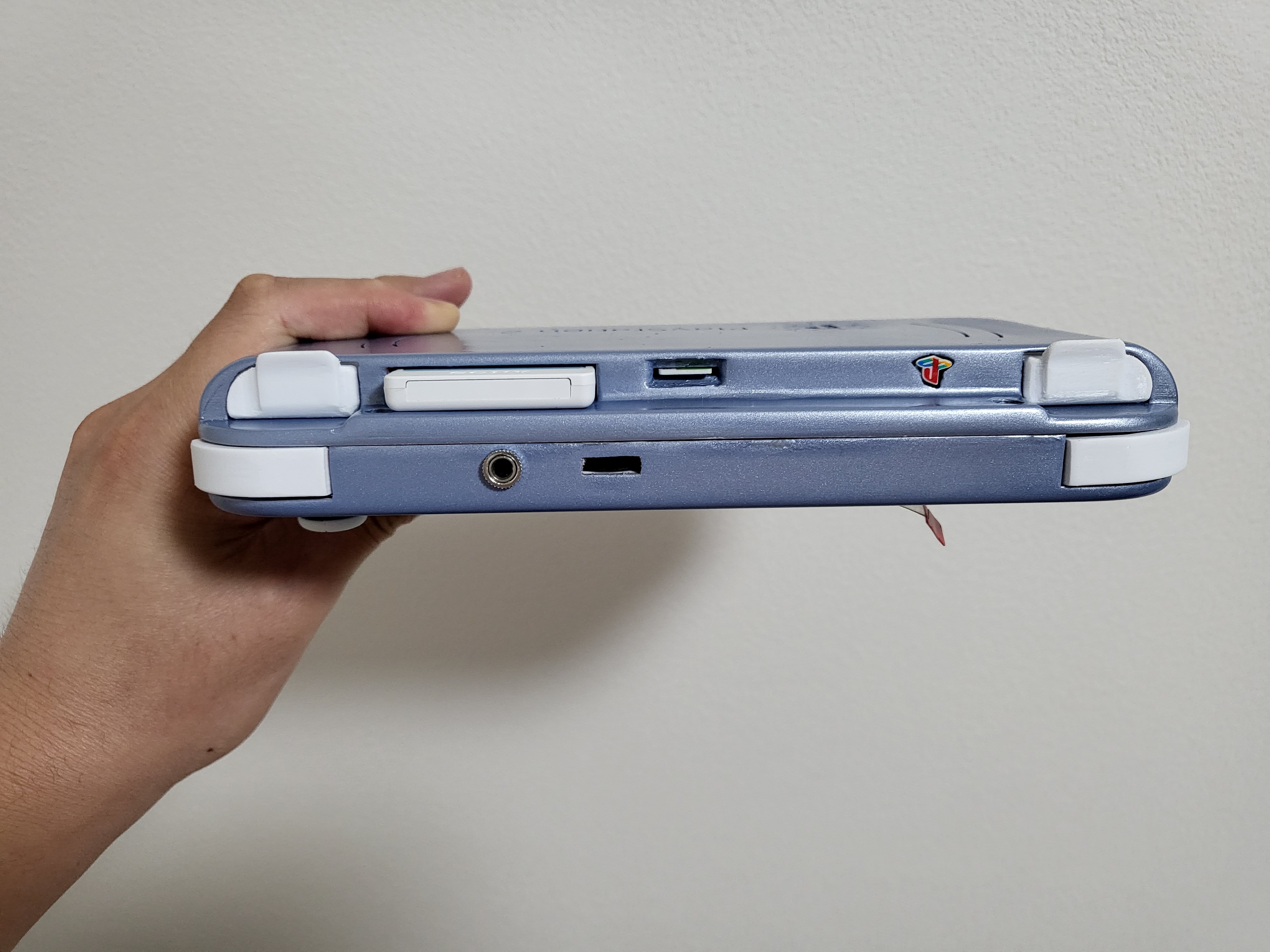

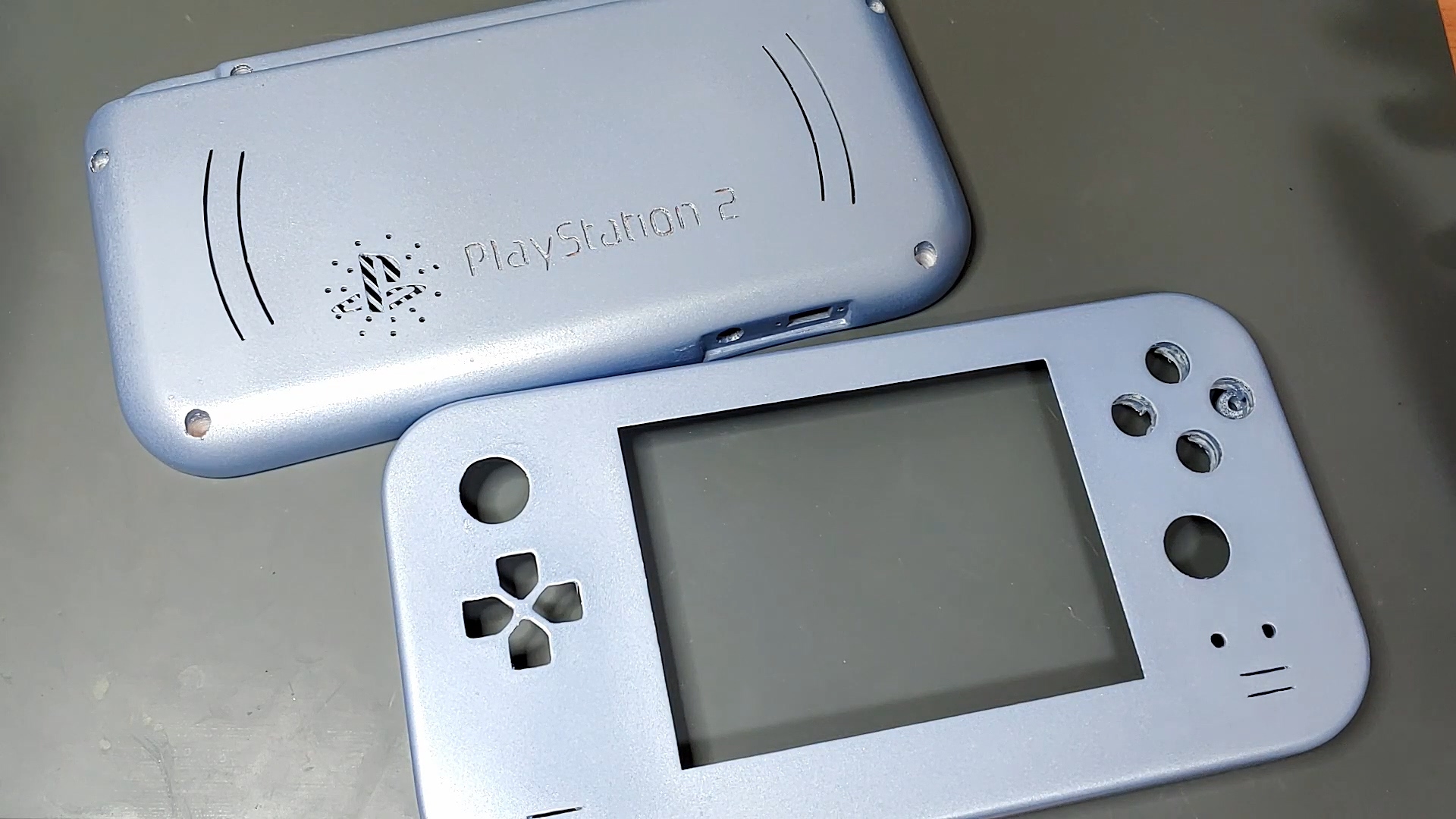

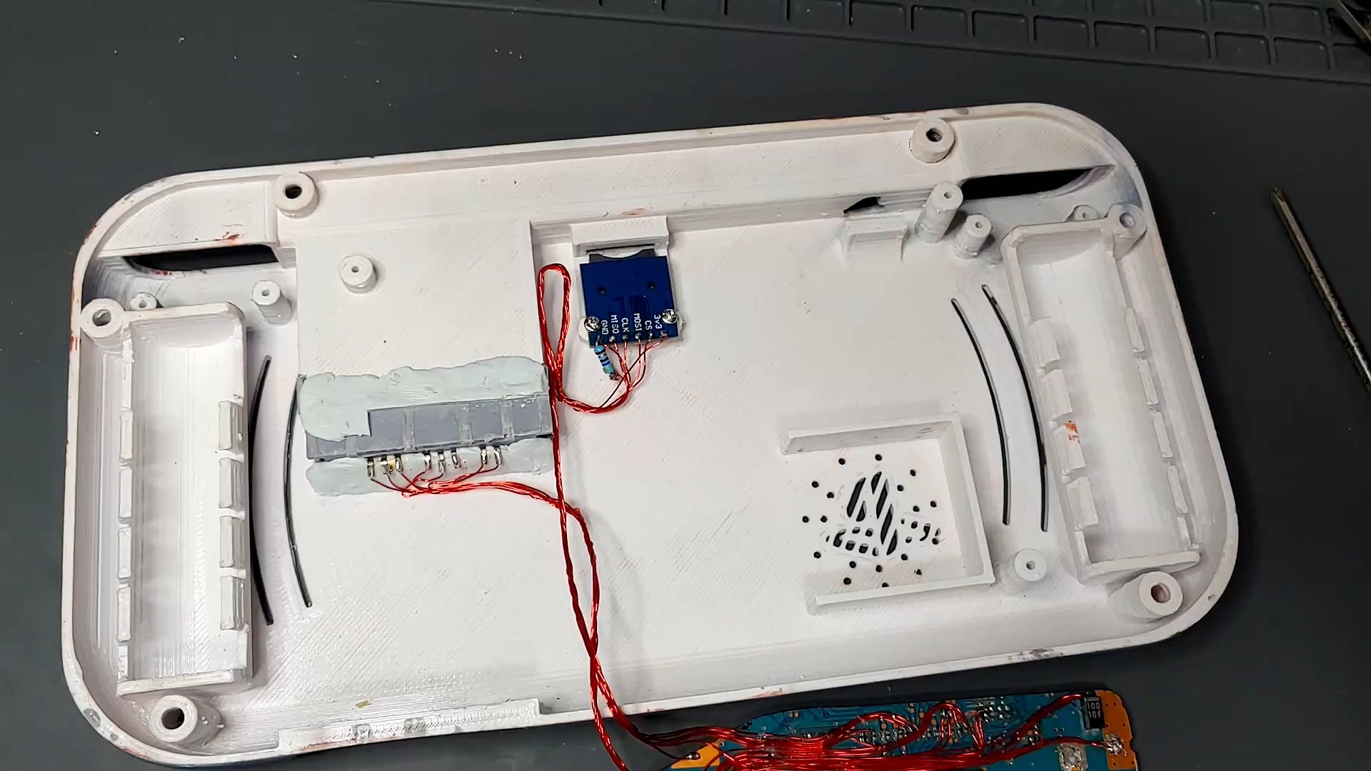

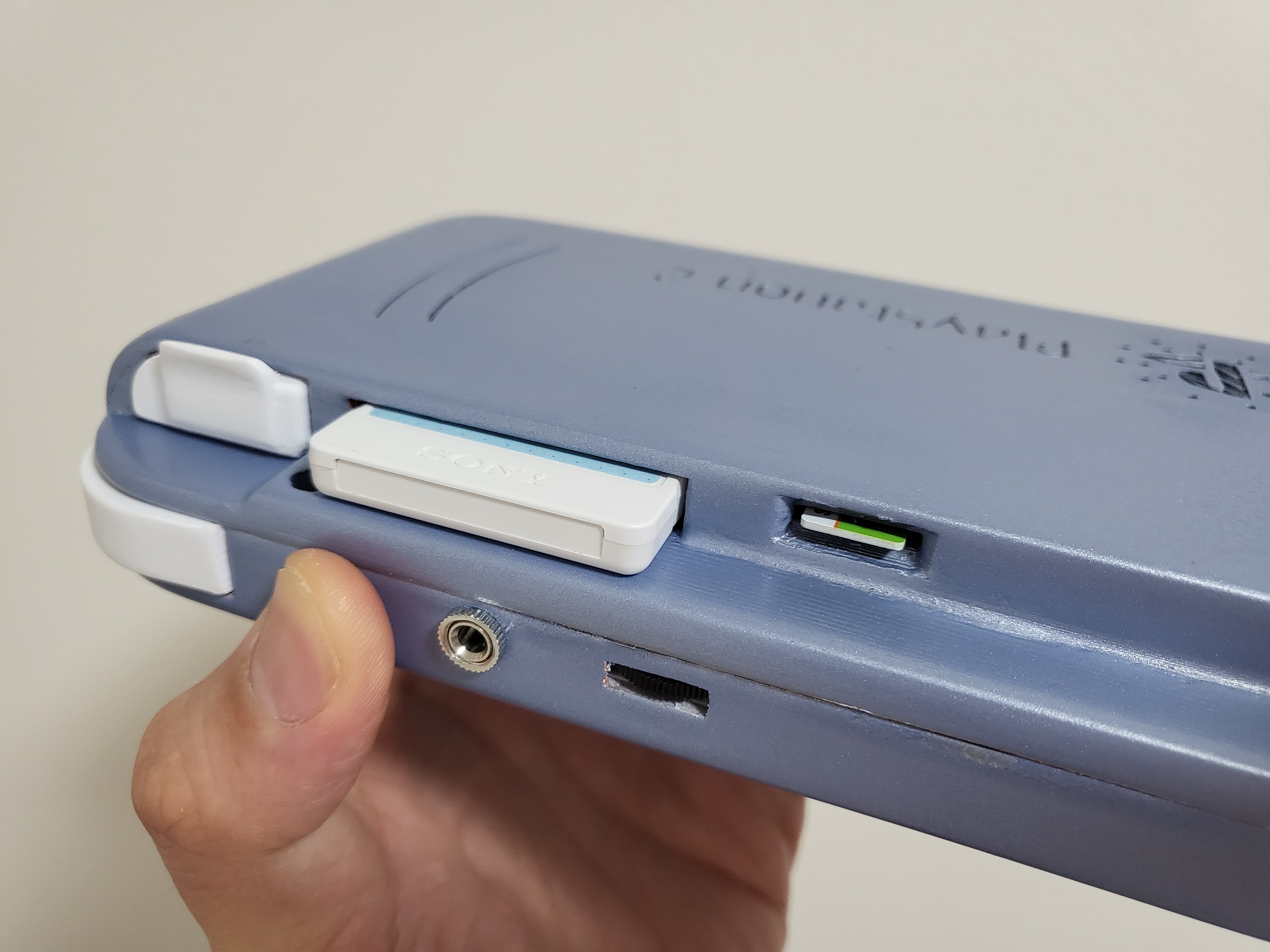

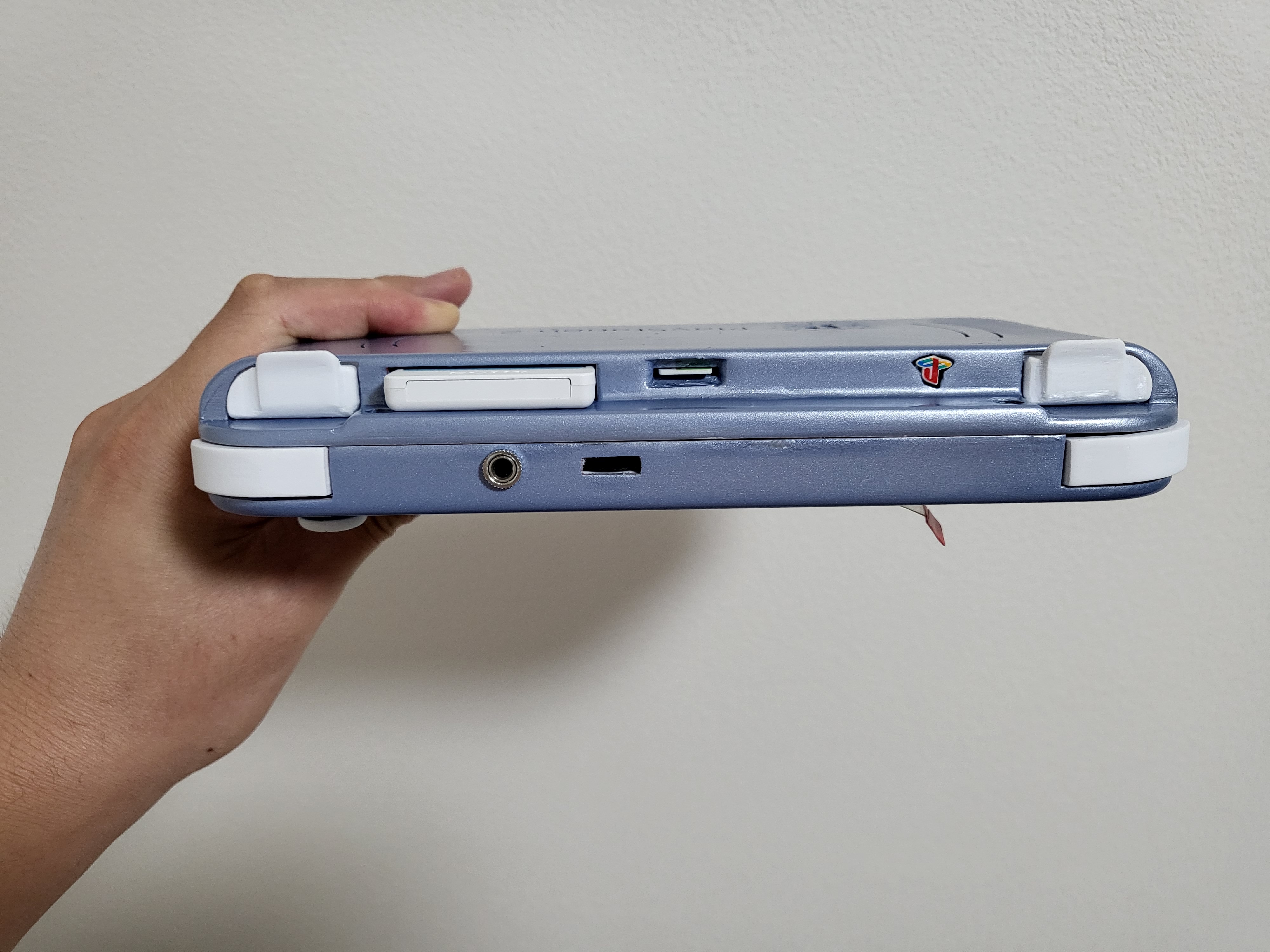

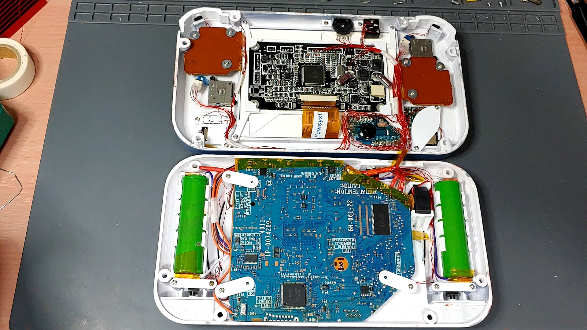

3d printer output is finished.

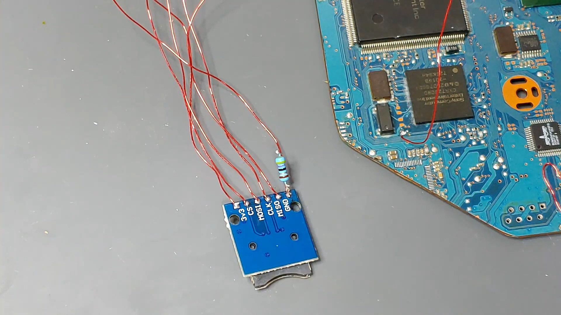

We decided to use sd card loader instead of USB for games. (MX4SIO)
For MX4SIO, it is slower than smb but faster than usb.
Videos are rarely choppy and loading is not that long.

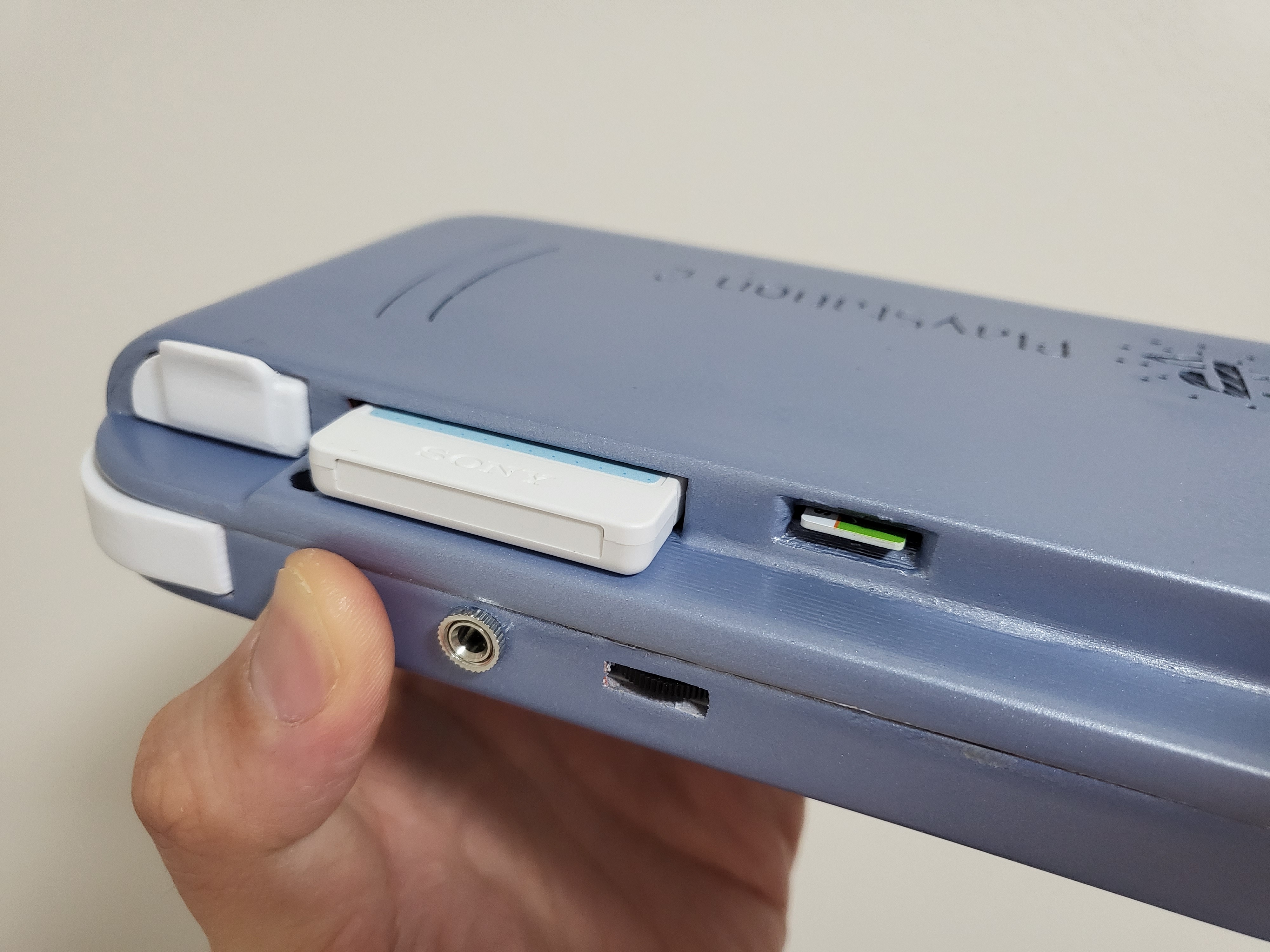

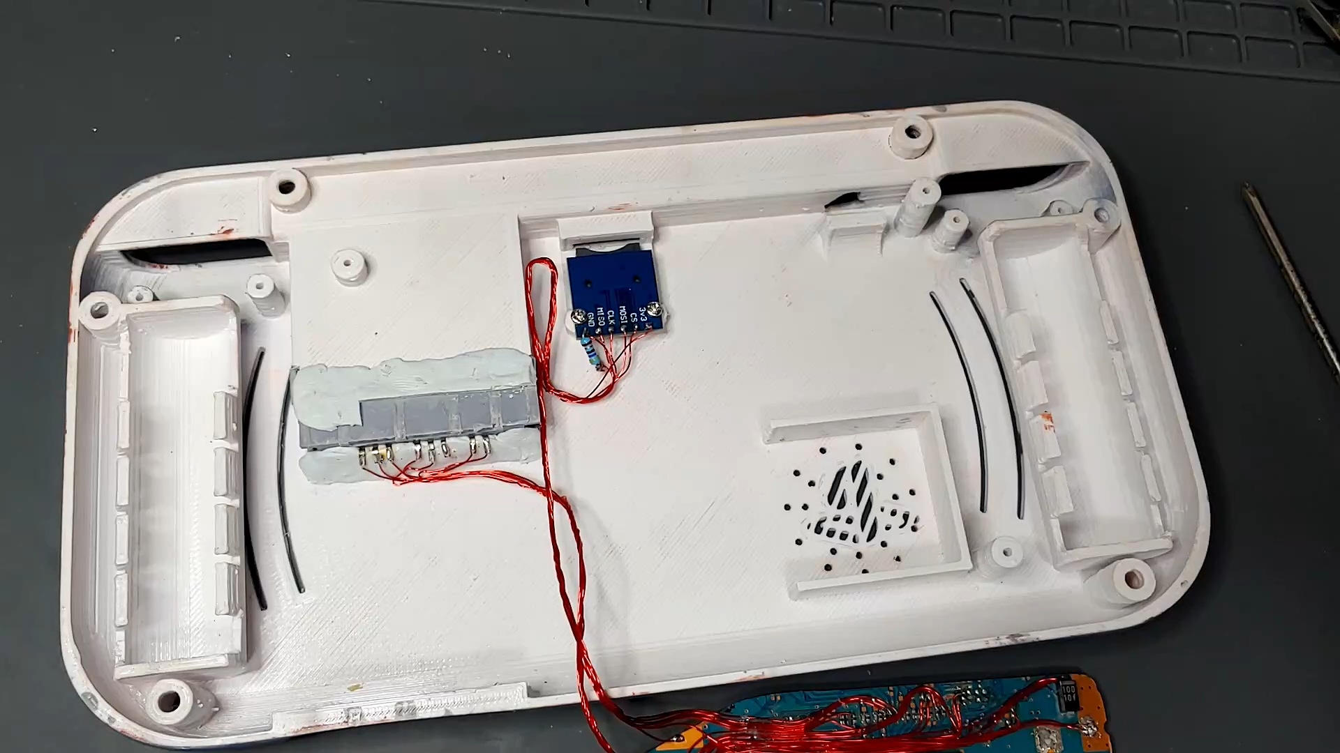

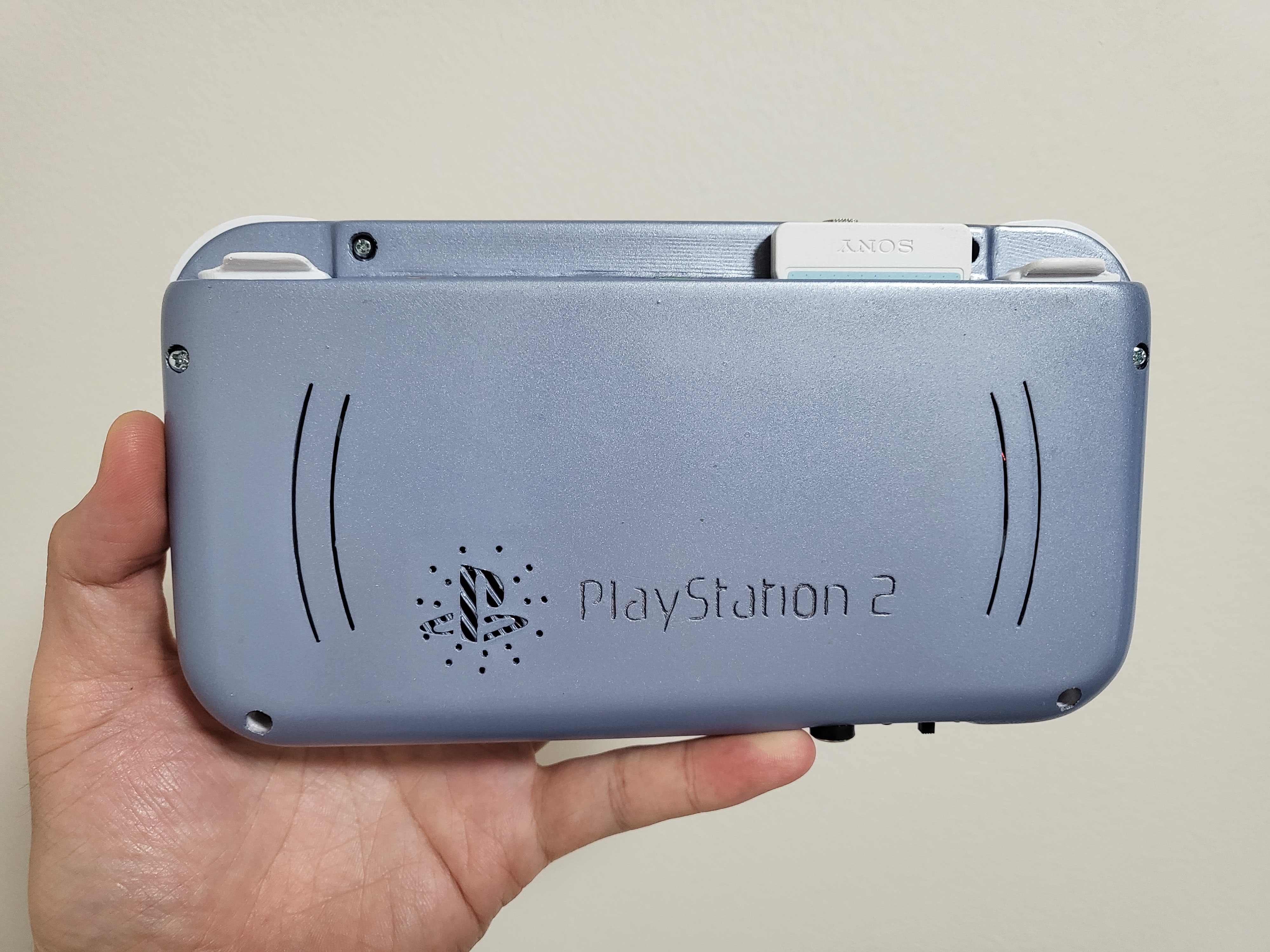

I connected the ps2 memory card slot 2 to the micro sd adapter.
A memory card slot and sd card slot were made in the case for easy replacement.

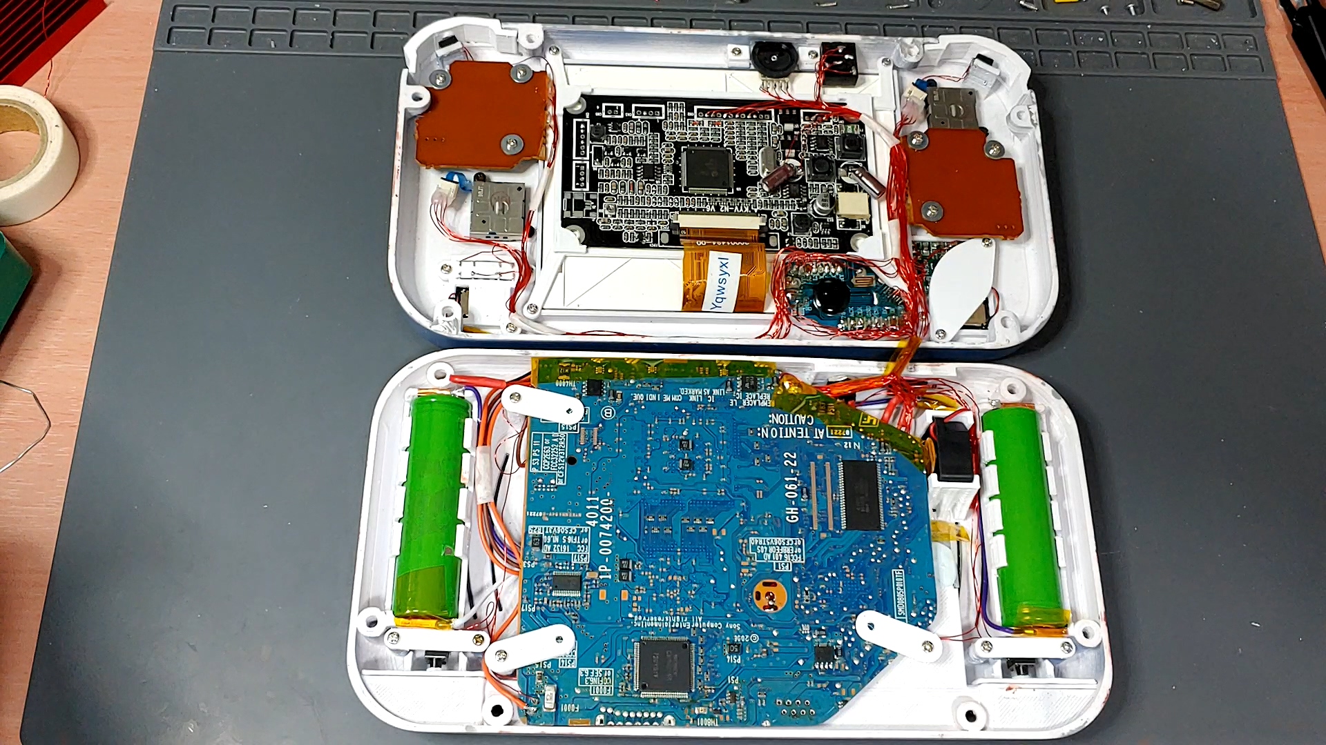

The internal wiring is complete.

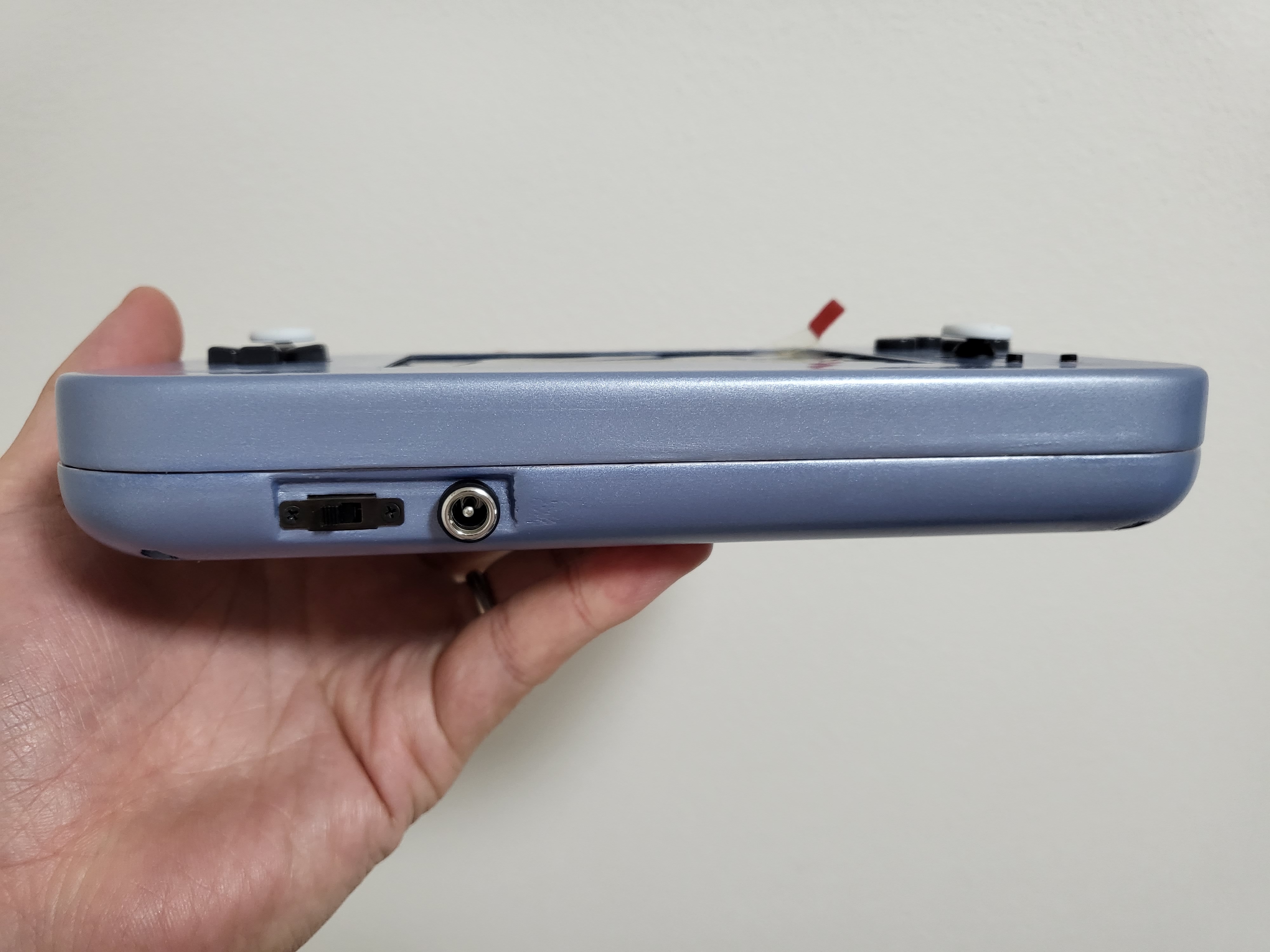

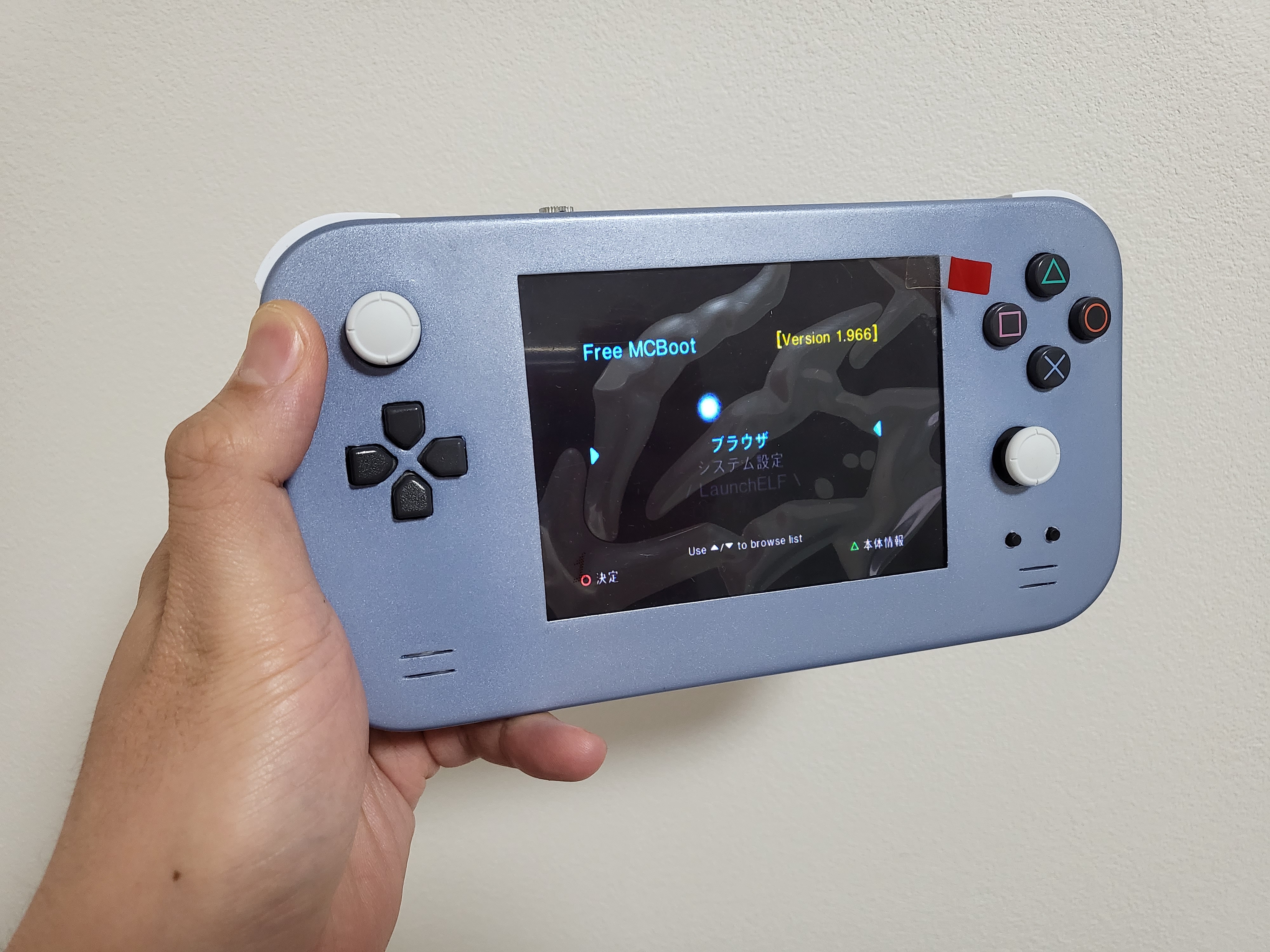

It has been completed.

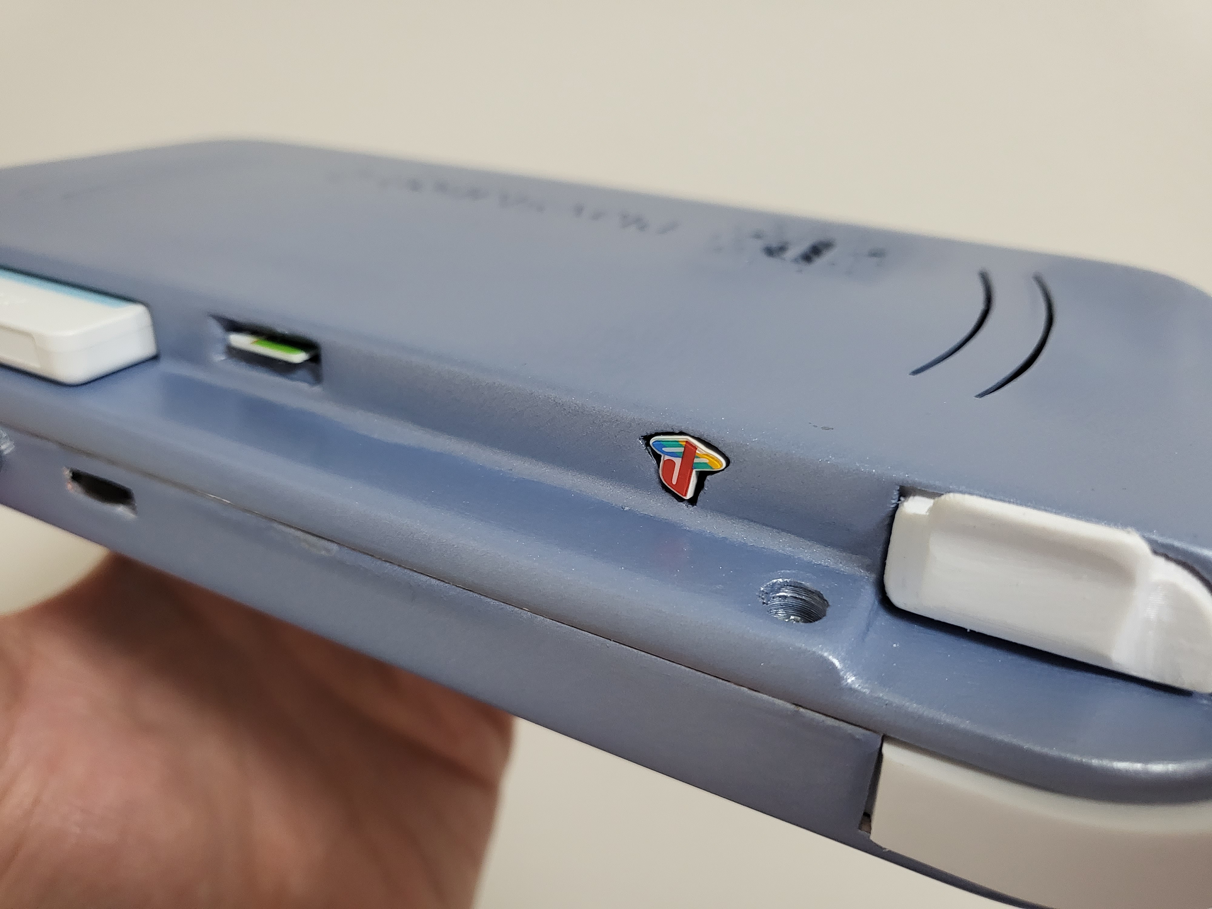

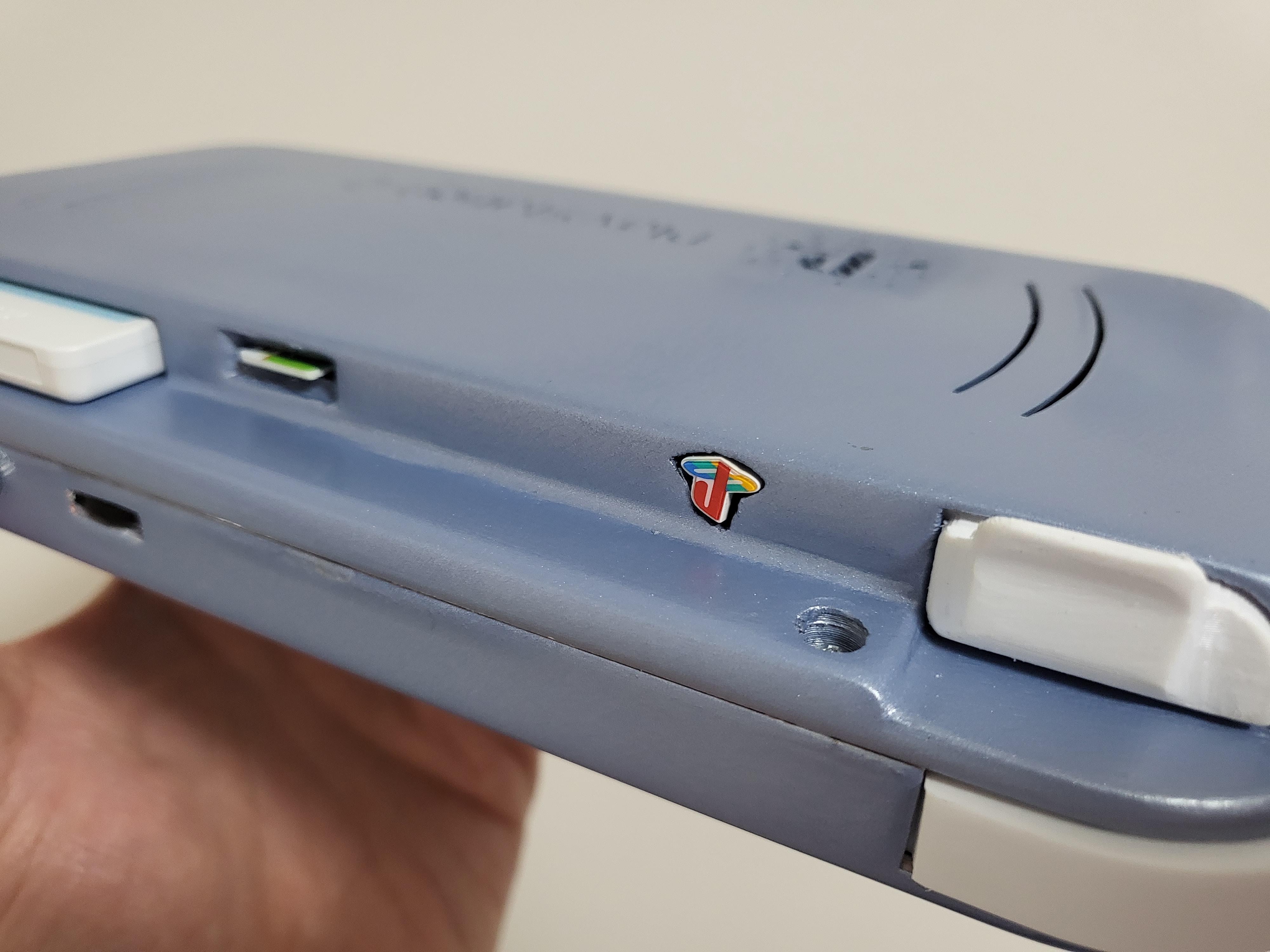

The memory card and SD card can be replaced at the top part.
The ps logo is the reset button.
Completed the second portable ps2 work.
Thanks for reading.
