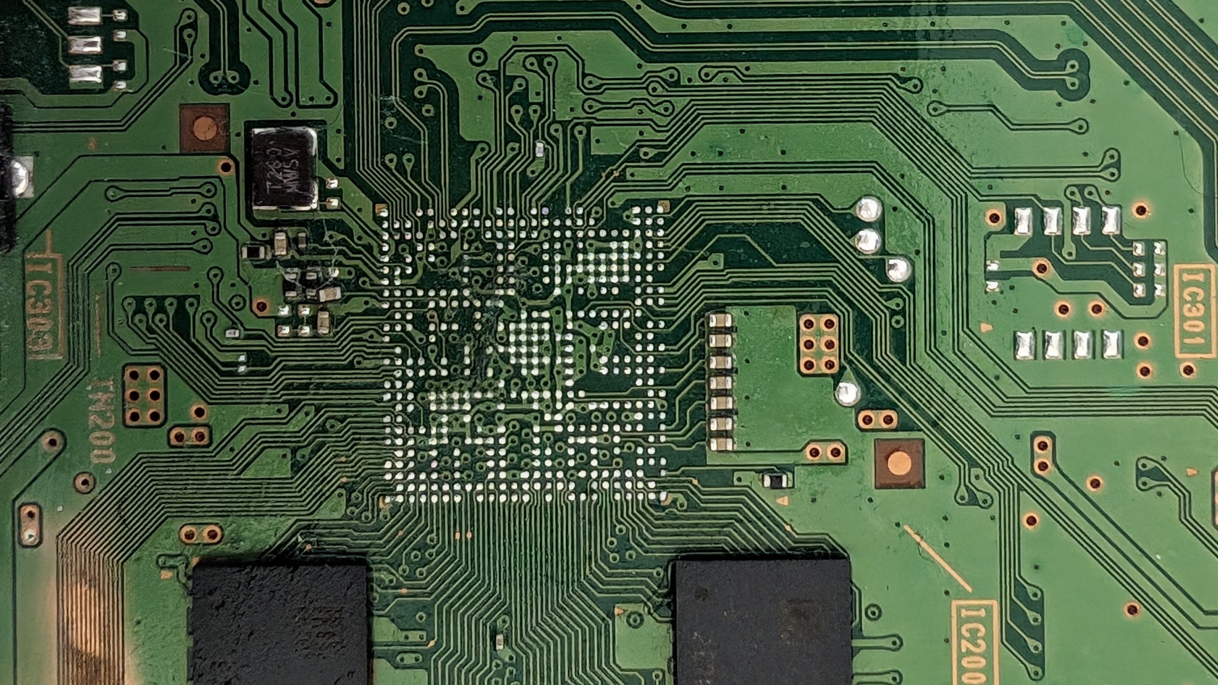

Hello I am trying to figure out what the Playstation Classics BGA package is for its CPU.
I have a friend that does BGA rework on PS3,PS4,PS5,xbox, PC's,GPU's,Macs, as well as cell phone tablet repair.
Is the BGA package custom or standard?
Is the CPU Architecture custom or a standard? Or in other words, do we know if Sony made any custom Modifications to Architecture of the CPU?
Purpose of this knowledge will be repairs and or modification
I can't find the information online thus far, I could have the chip removed then find out that way.
Has any BGA re-worker removed the chip? That would be the best way to find out what Package was used.

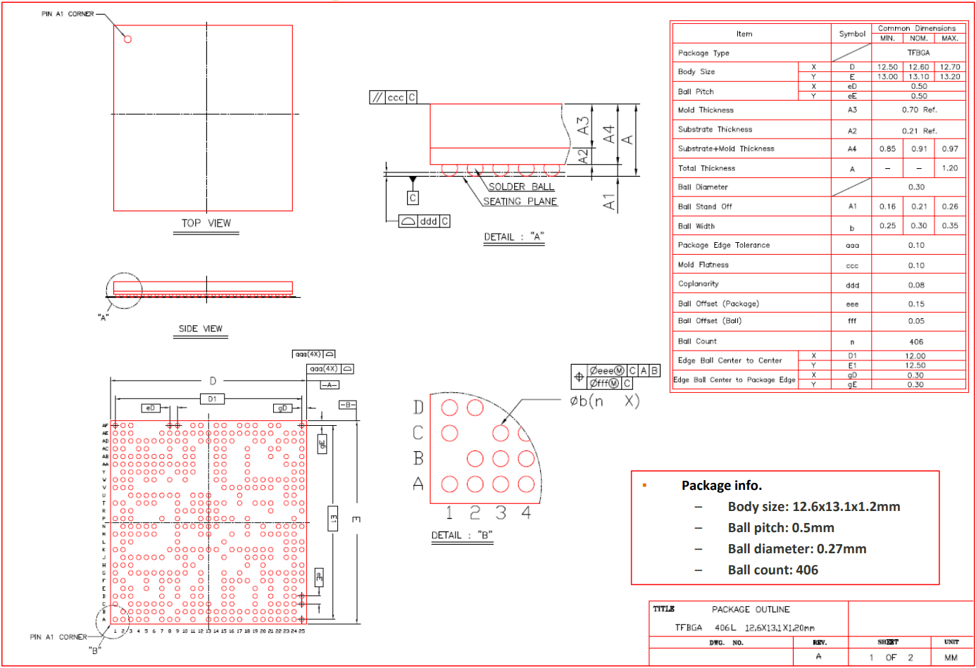

As far as I can tell, the MT8167A is a TFBGA406L. Here are some details:

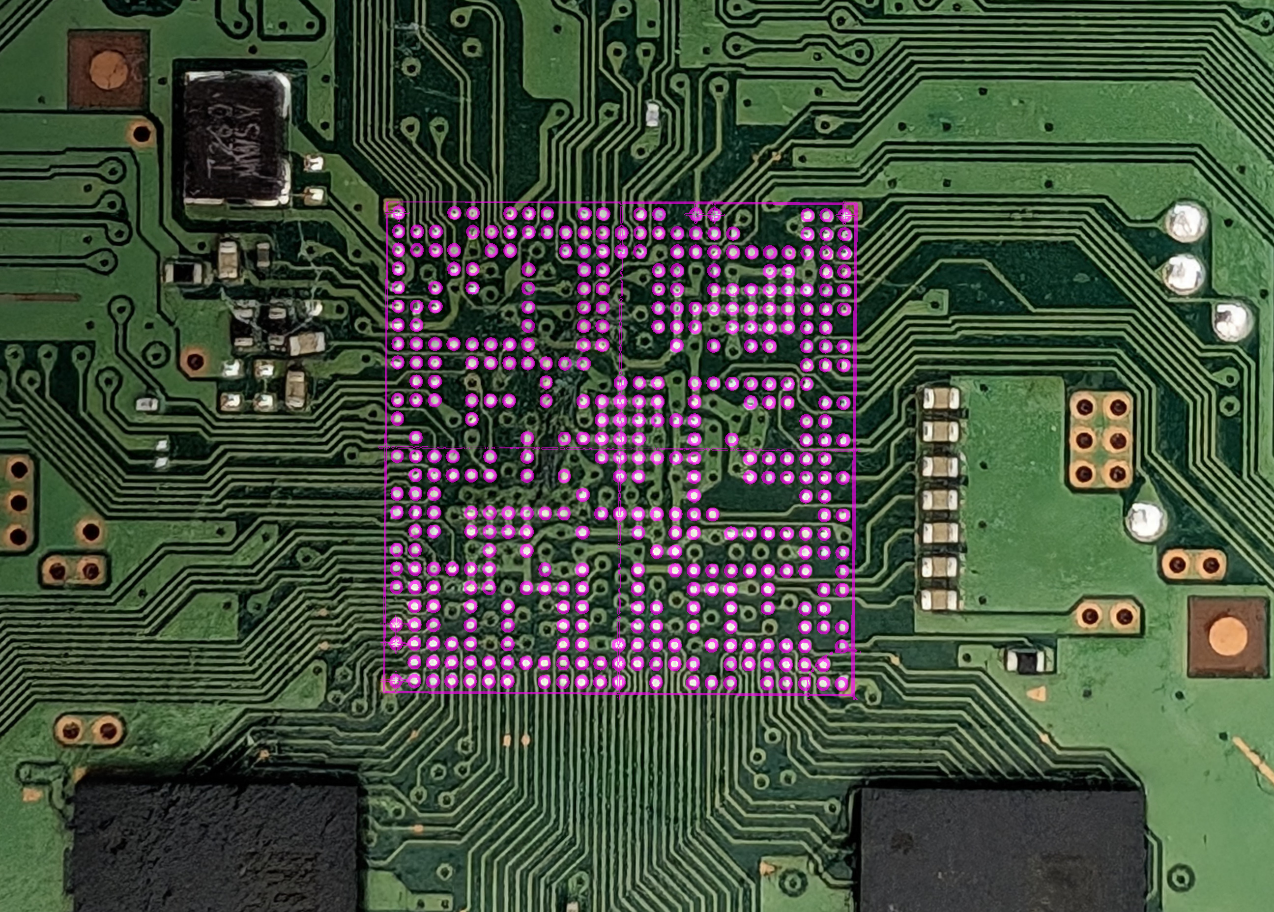

Is there a list of other processors using this package TFBGA406L? Or is it Custom. I checked out the website MediaTek forum it seemed confusing to me. Can't tell if it is asking for money to get information. I didn't want to register for that reason. Are you registered? Would you mind searching a little more on the package?
Thanks again
99% sure it's custom, application processors like this usually are. It's certainly possible some similar MediaTek processors use the same package.
Sorry, I'm not registered on the site either. The diagram I posted was publicly available, and is the most detail you can hope for with a custom package.
