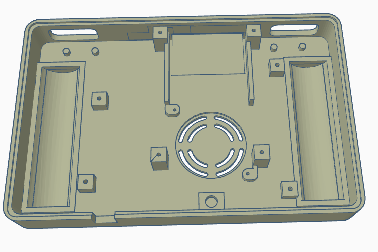

So far what I have is your standard rectangular clamshell design that is 139.80mm x 90.13mm. the bottom half has a height of 20.70mm and the top half is still in production.

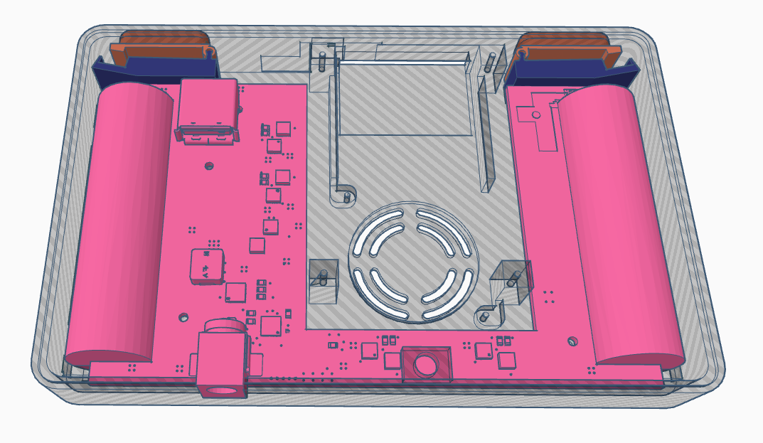

I still have yet to put in screw posts that connect the top and bottom case pieces together, however i left room and am compensating for that when designing the top half of the case. what you see so far is battery, cooling, trigger, and custom pcb placement. the piece with the hole on the bottom is for routing wires to the top half of the case when assembling to keep things together more.

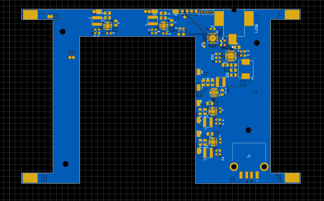

Here is the bottom PCB so far:

Now before anybody starts roasting me about how this may not work or how sketchy it may be lol, this is subject to change and just a learning experience for now, so if I blow some money on prototypes and they don't work. it is what it is, but lets get into some features and ill explain some things:
- RVL-PMS Functionality
- Barrel Jack for charging
- USB port that connects to Wii data lines.
- Sketchy battery pads (will explain)
So pretty much the battery situation is this. I could have probably made a holder in the case with some battery clips however it looked like it was taking up more space then what I have above. so my plan is once I'm ready to assemble the portable and test the board, ill screw it into the case, solder a battery to the left side of the pcb, then I have a jumper I can bridge for testing, then un-bridge when assembling the rest. If it works out alright, then ill just solder the other battery in and call it a day.
Talking more about the bottom half, I was having a hard time designing some triggers, so i truthfully took and modified Wesk's Aran triggers to fit in (bless you Wesk). Here is it all together:
