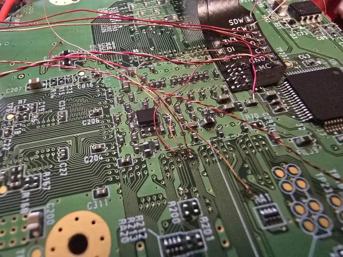

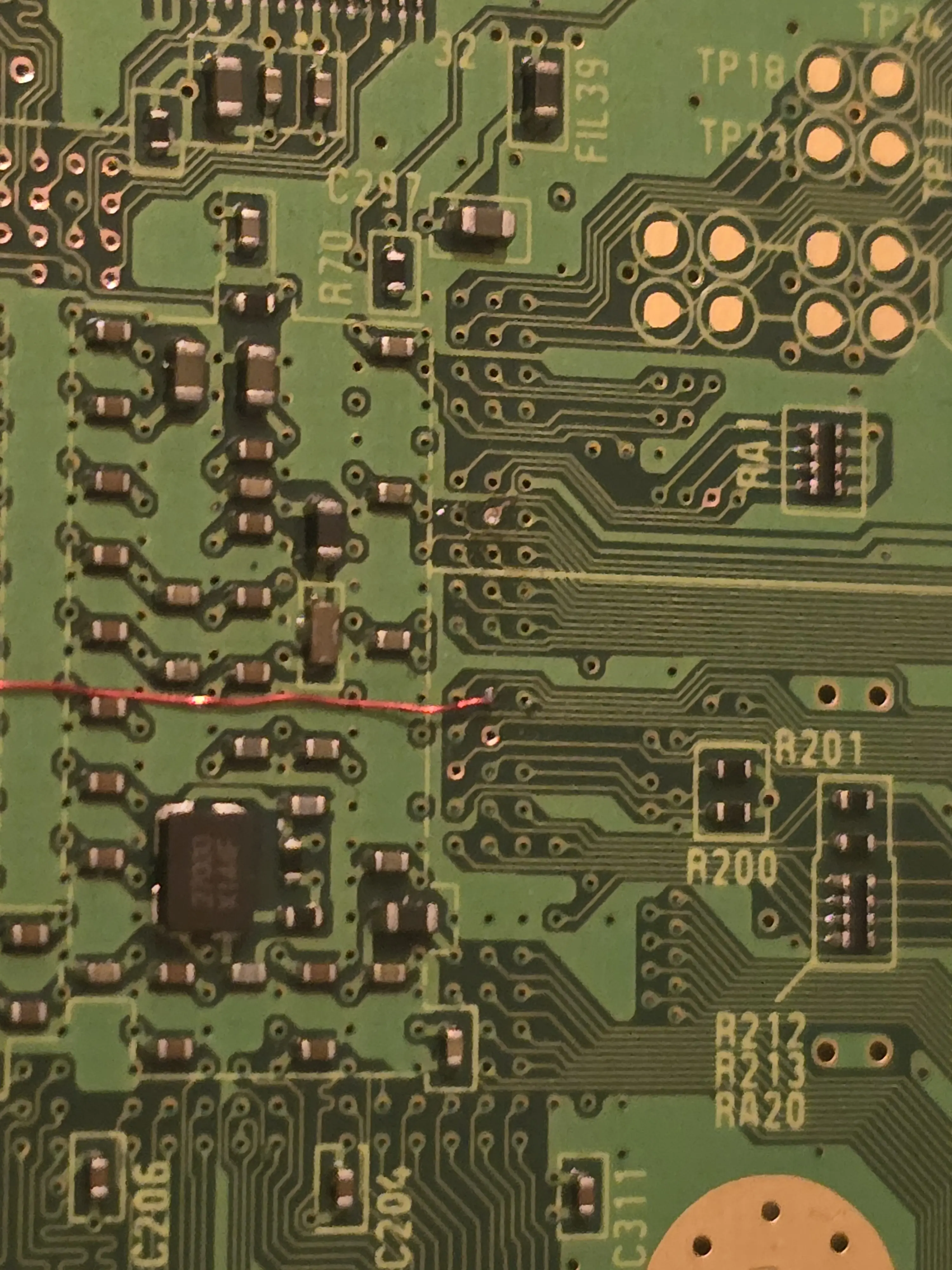

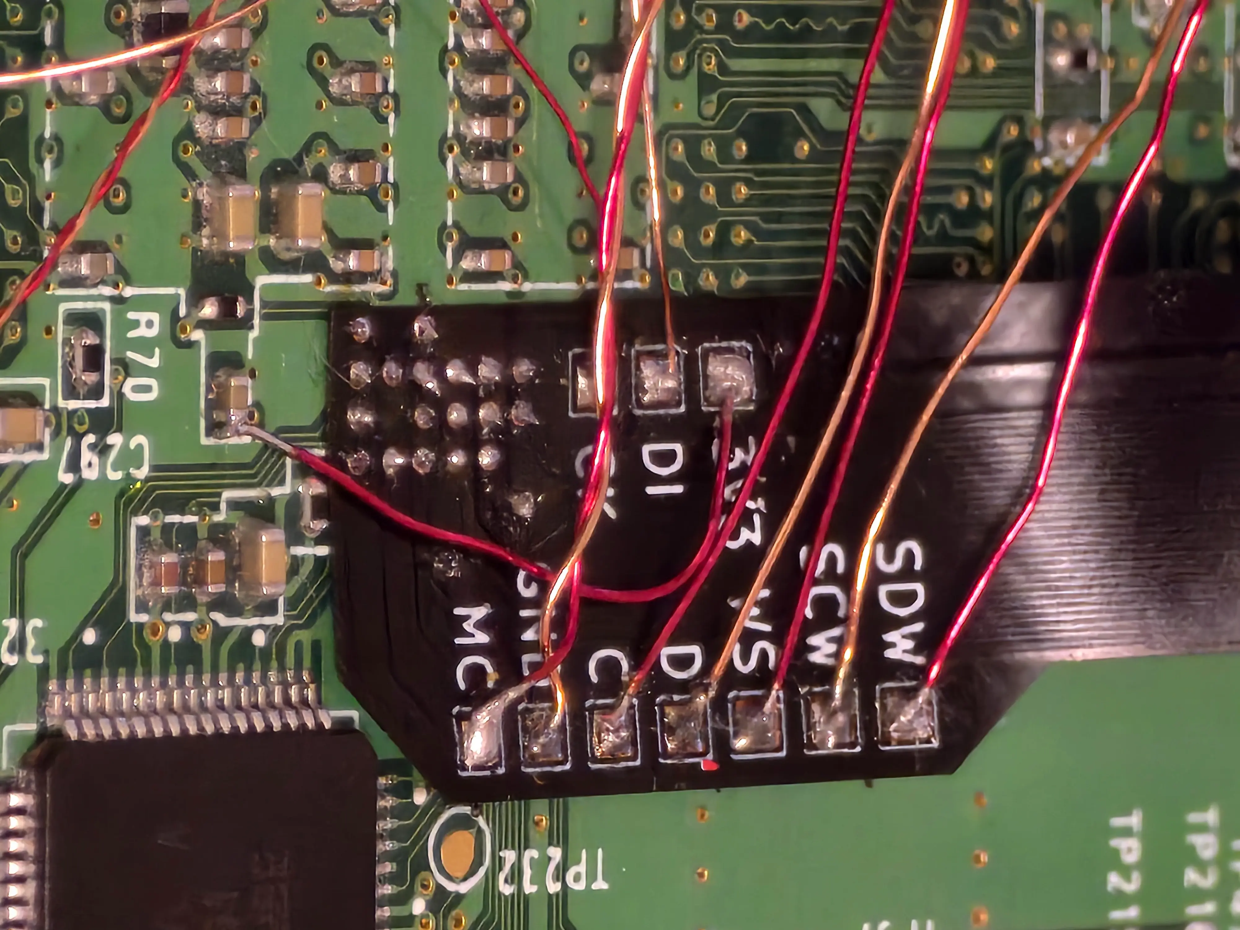

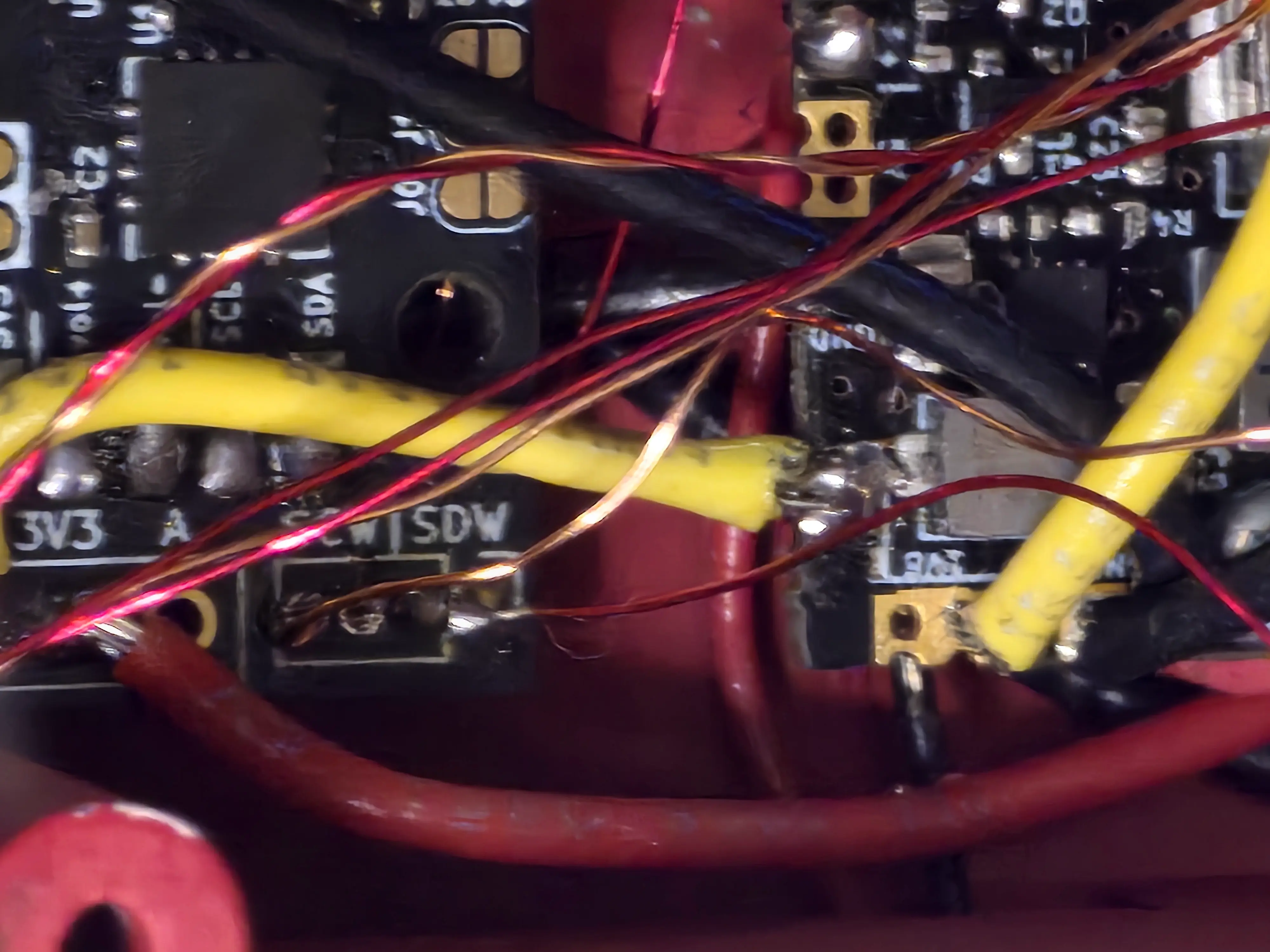

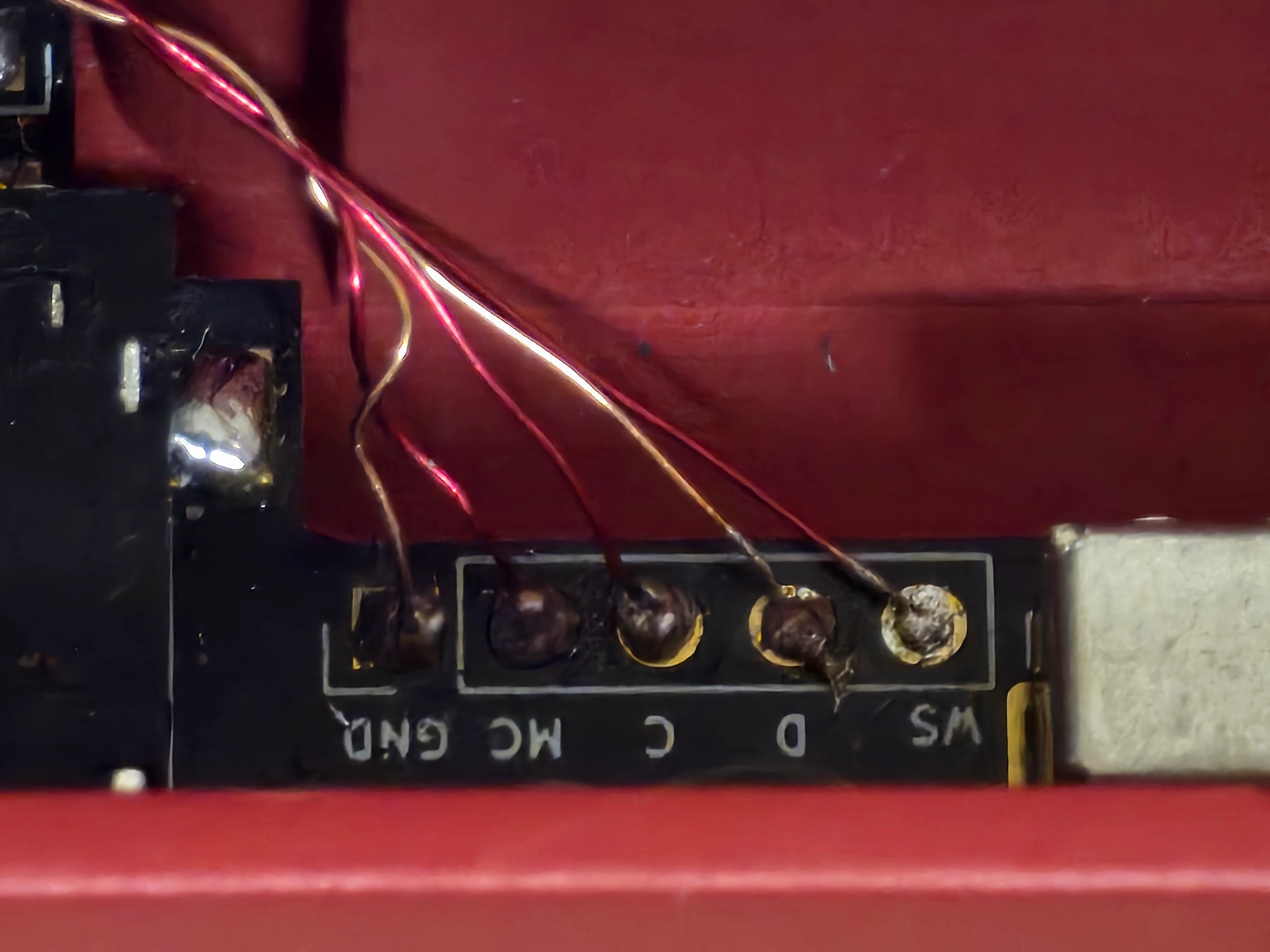

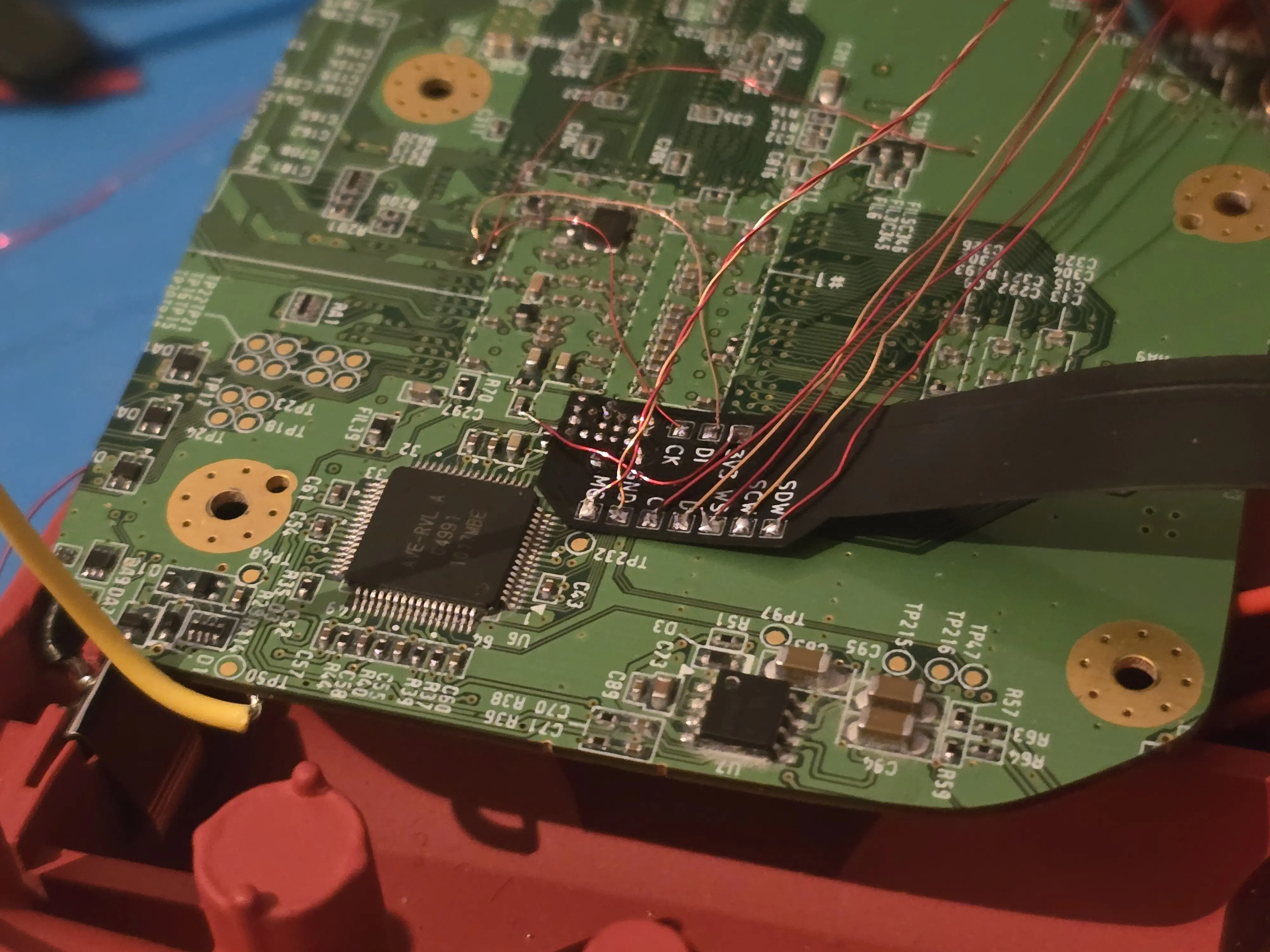

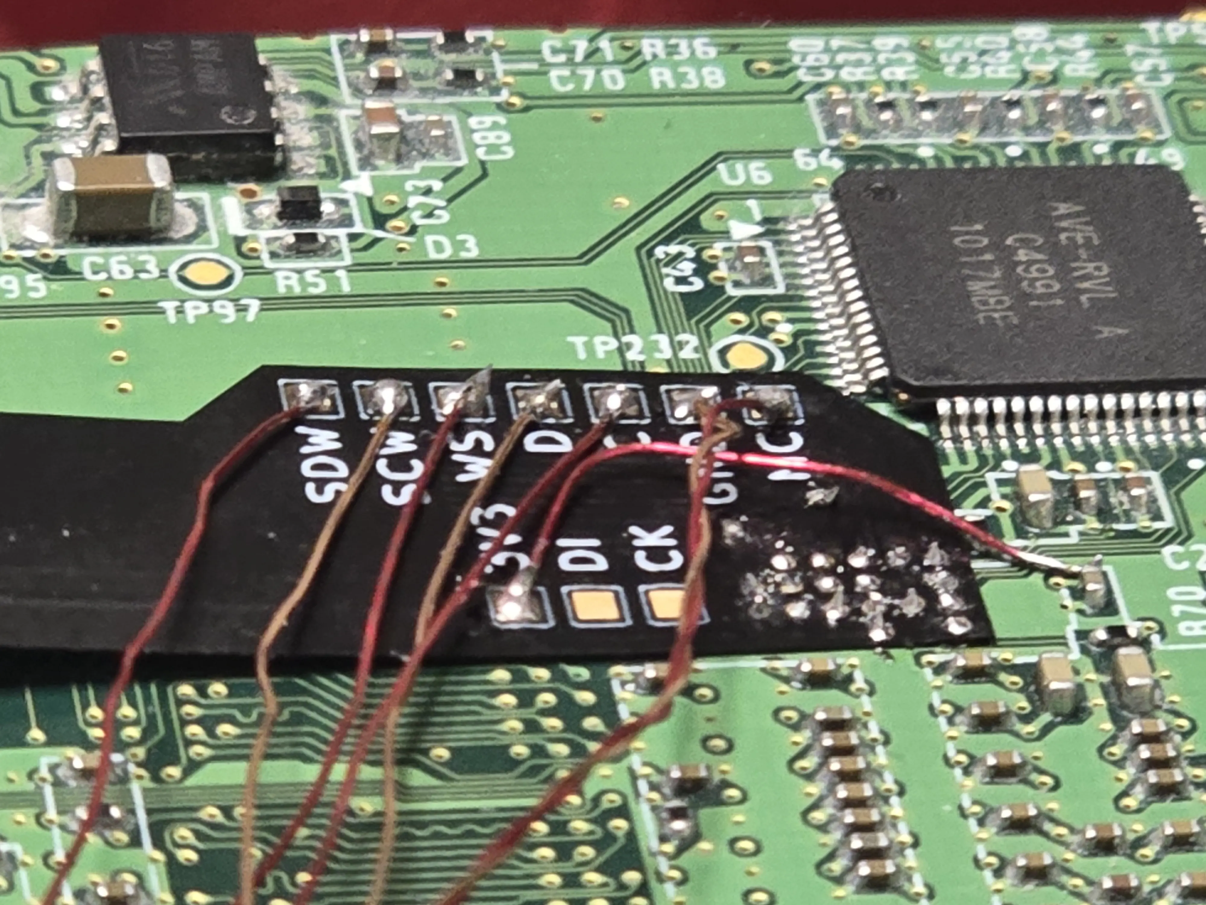

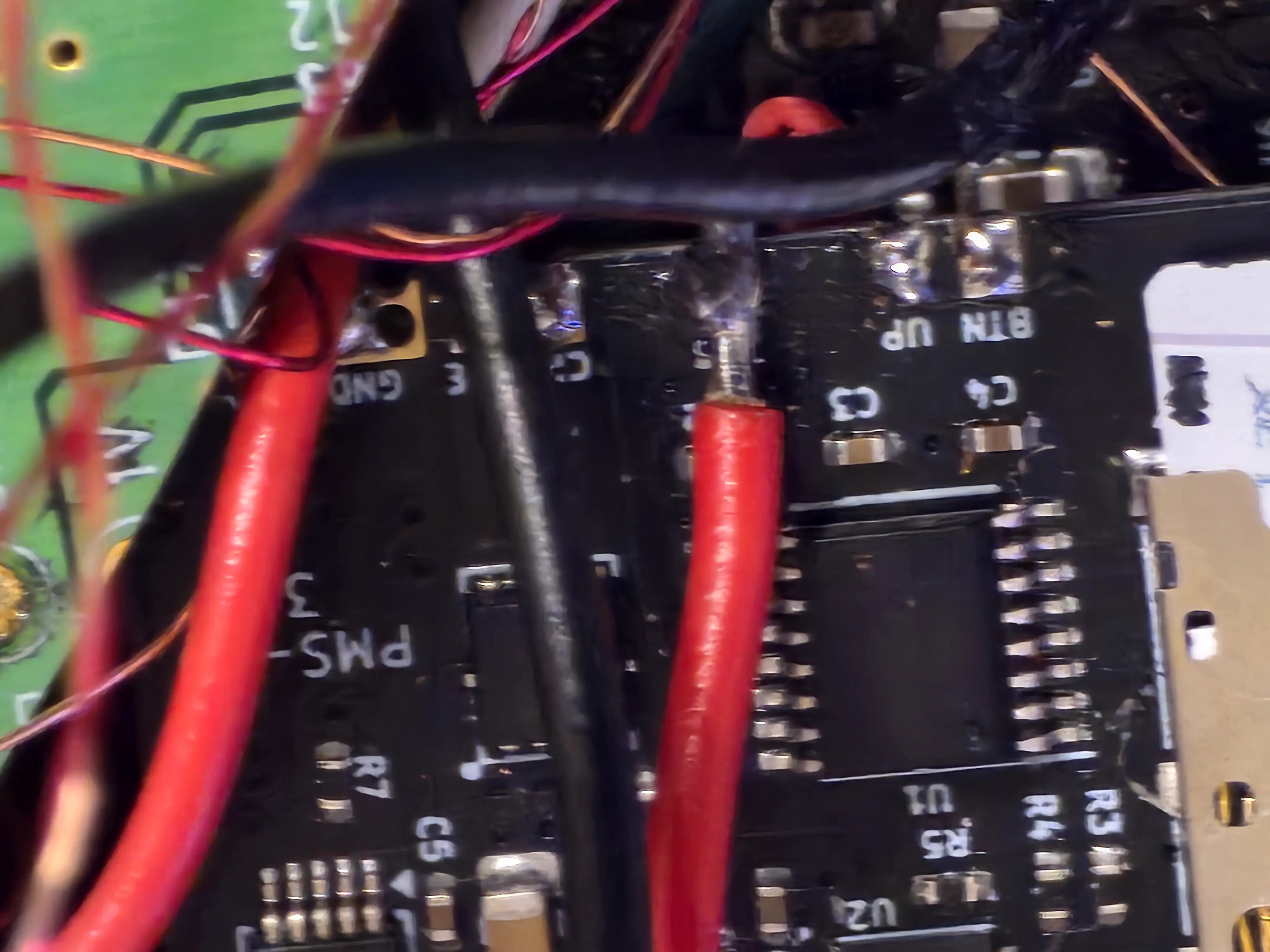

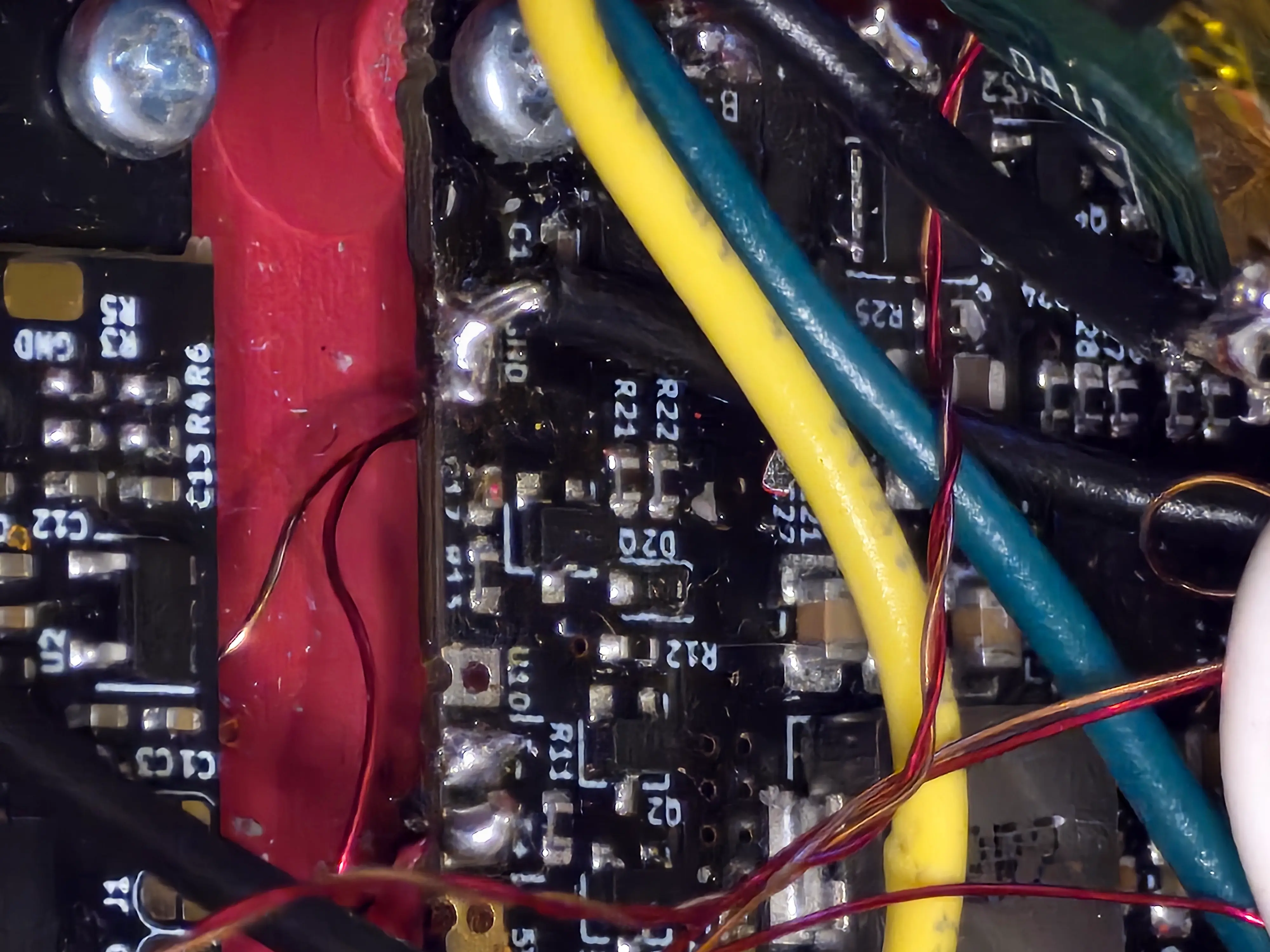

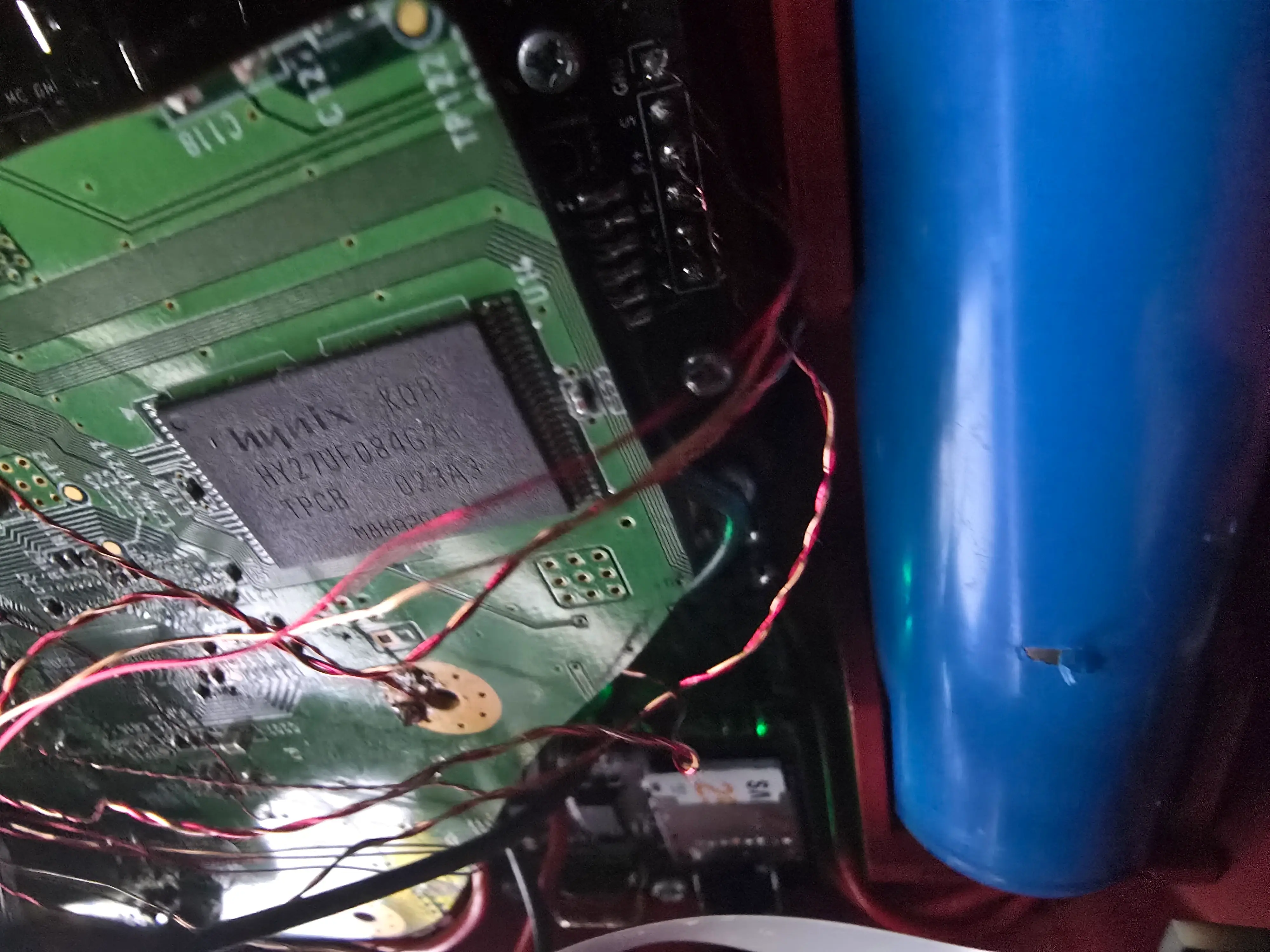

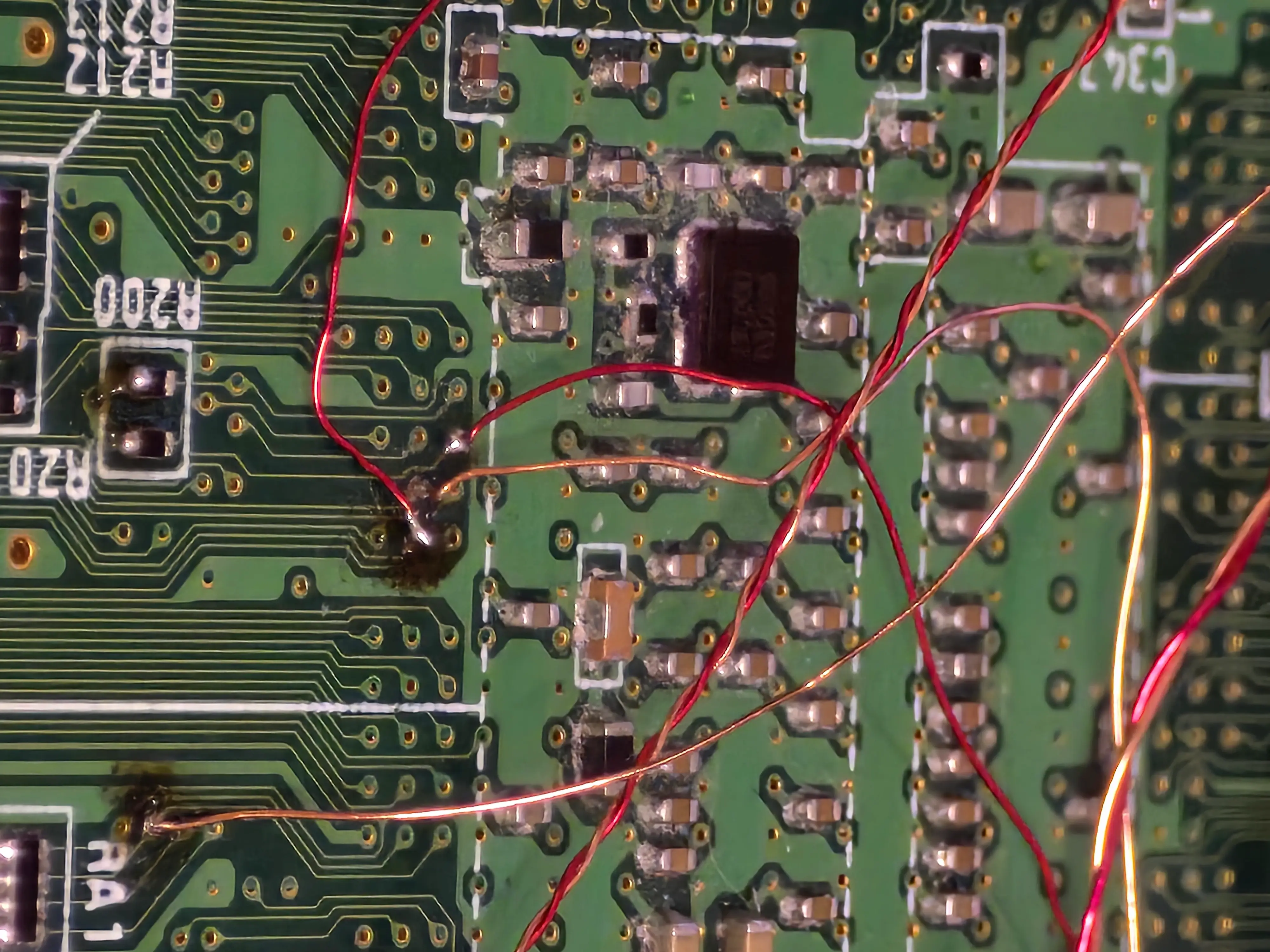

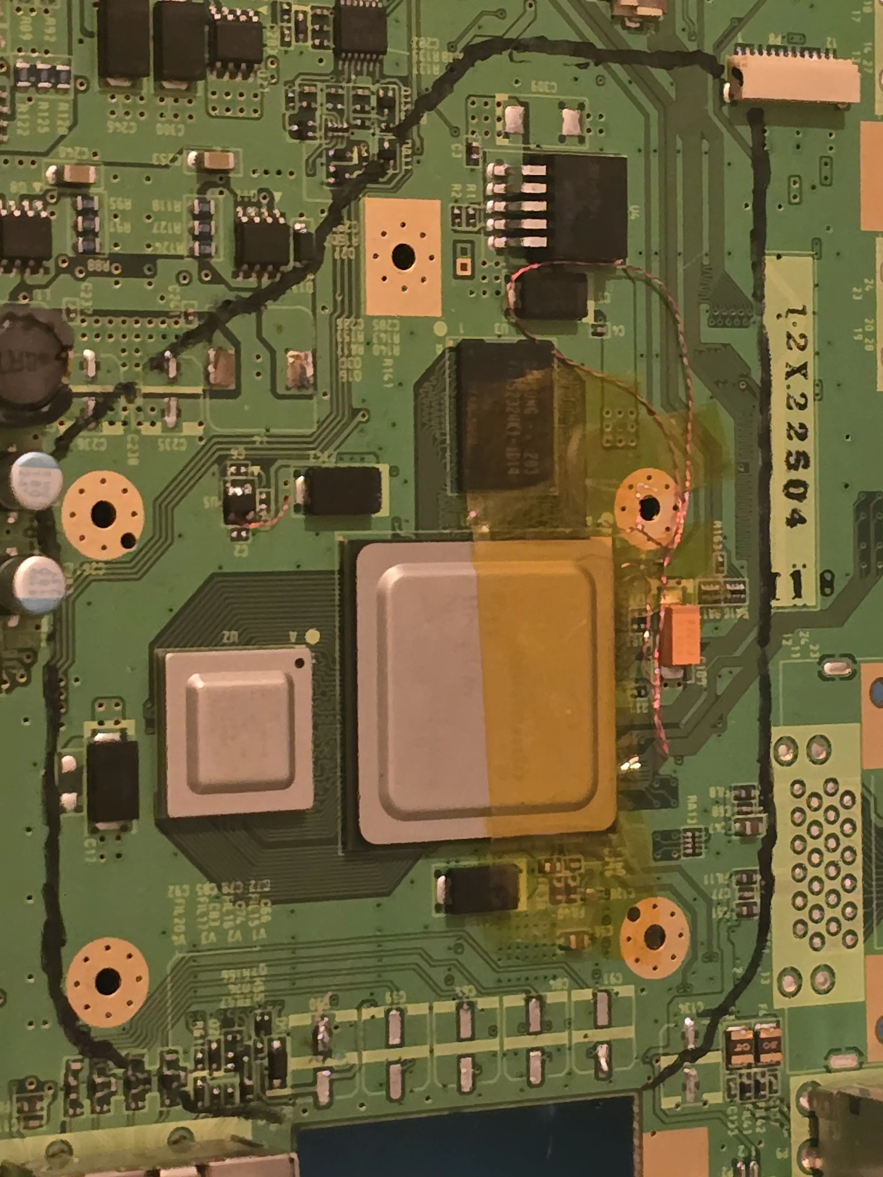

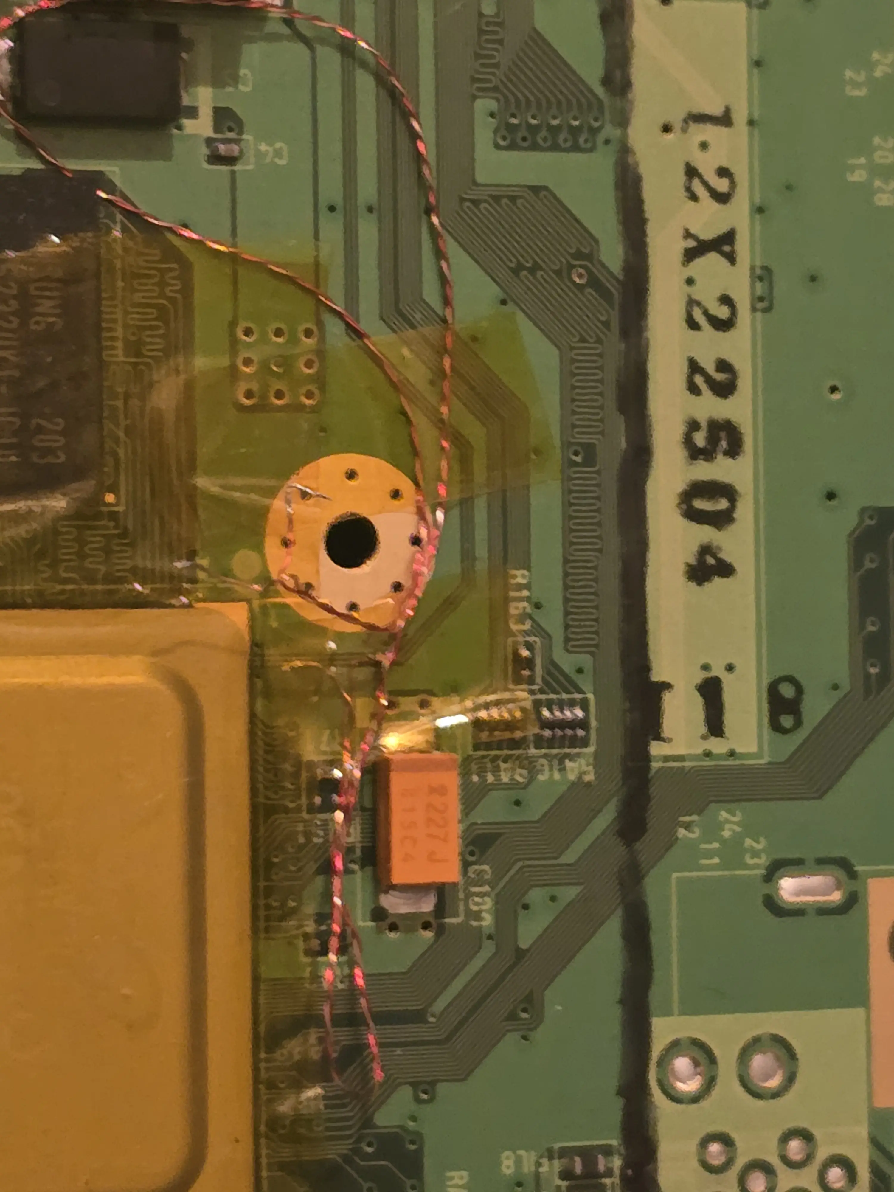

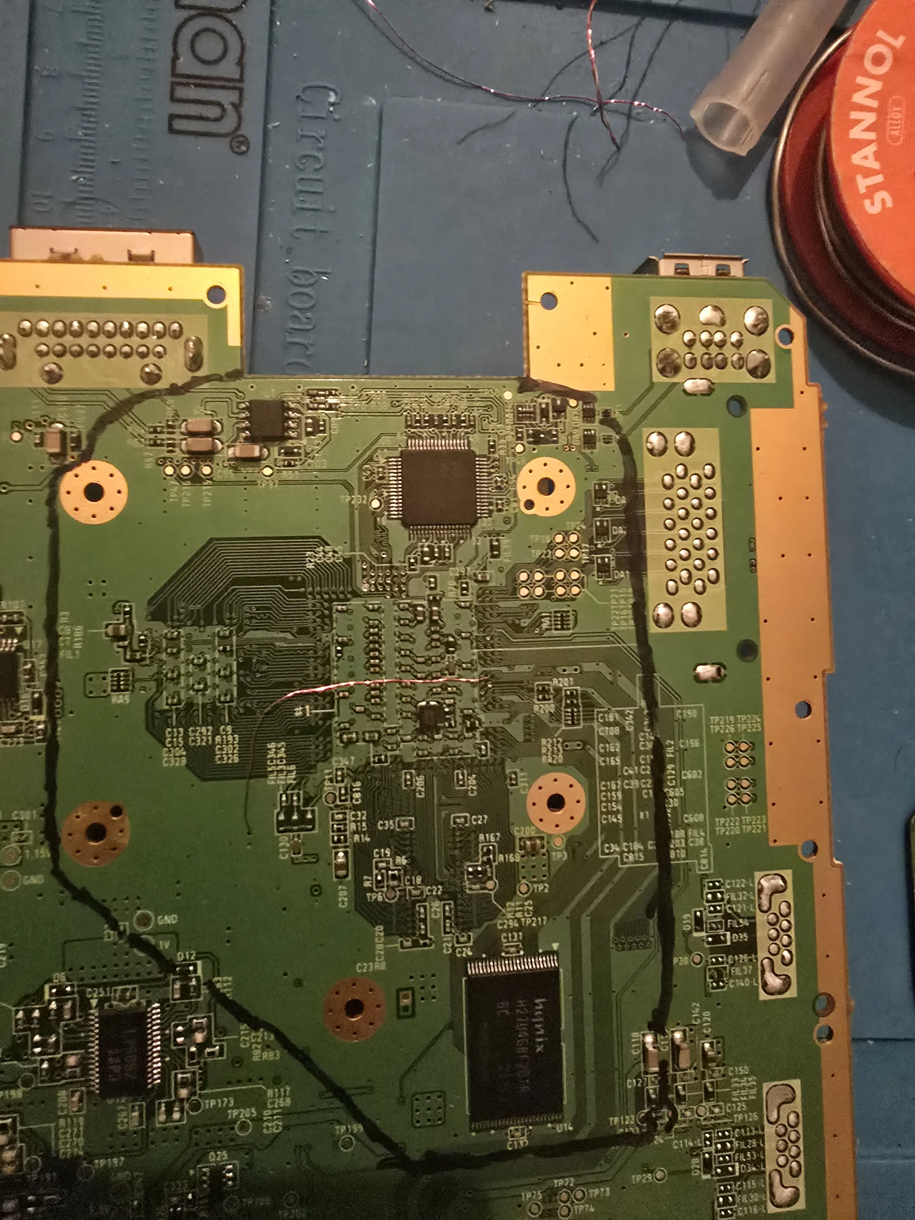

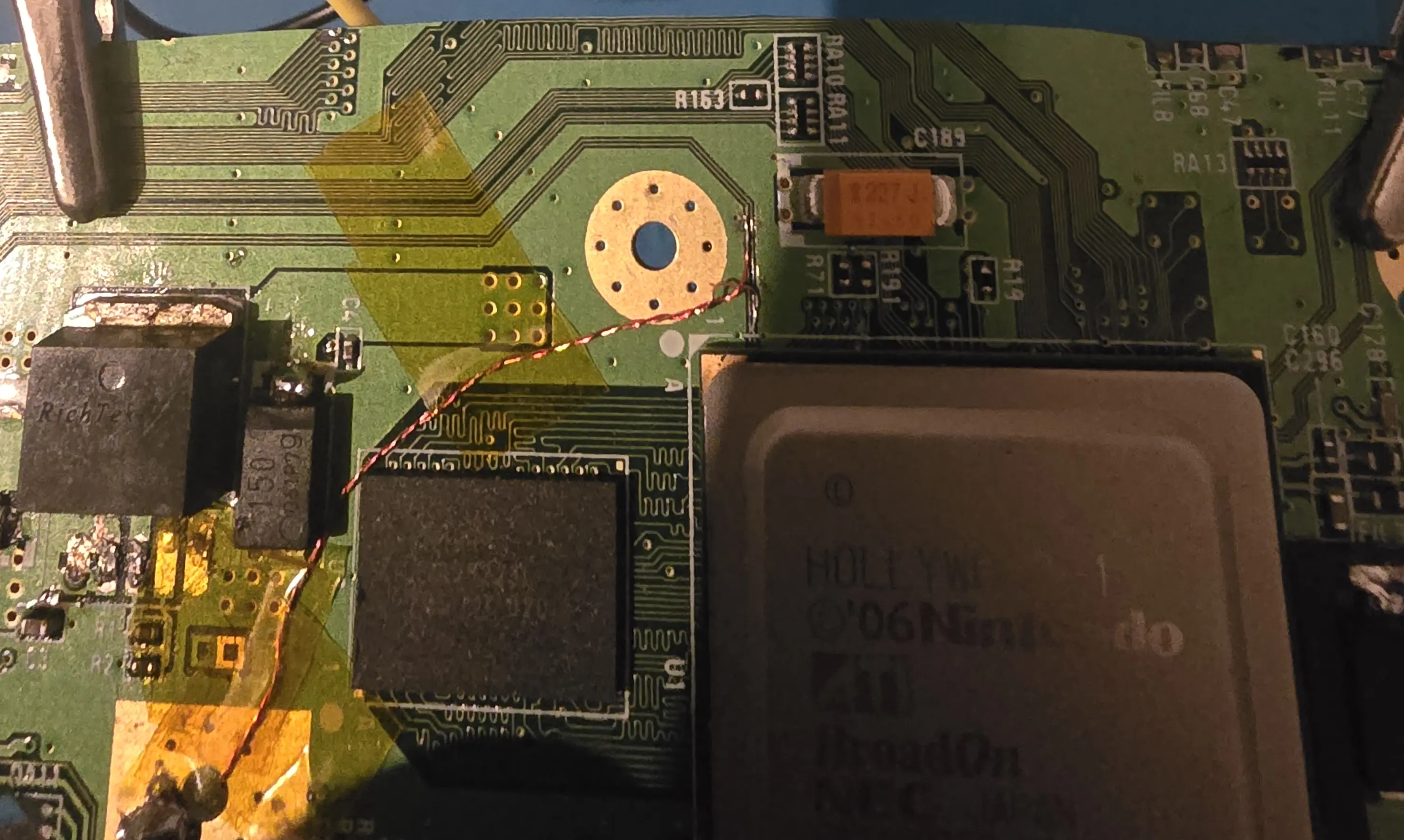

Got some small bad news. The time seems to keep randomising. Everytime I boot the wii, the time seems to be different. I've tried to replace the battery with a new one, but it still doesn't work. Any idea which wires might be the cause?
Afaik that can only be the MX chip. Did you check that all the marked 3.3v legs on the chip are properly supplied and that all the GND legs are connected to GND? Sometimes one magically gets orphaned and it can cause odd behaviour
I believe I fixed it, but it was 1 of the data wires that wasn't deep enough in the via (had lot of the solder exposed).
It's been stable the whole afternoon -> night
Here's hoping it remains such! Been a long journey to get here
Yeah, it has, but I've already been enjoying it and this time it looks to be stable, janky, but stable. Only a bit annoyed that the ashida2 ,or whatever it's gonna be named, is on it's way.
