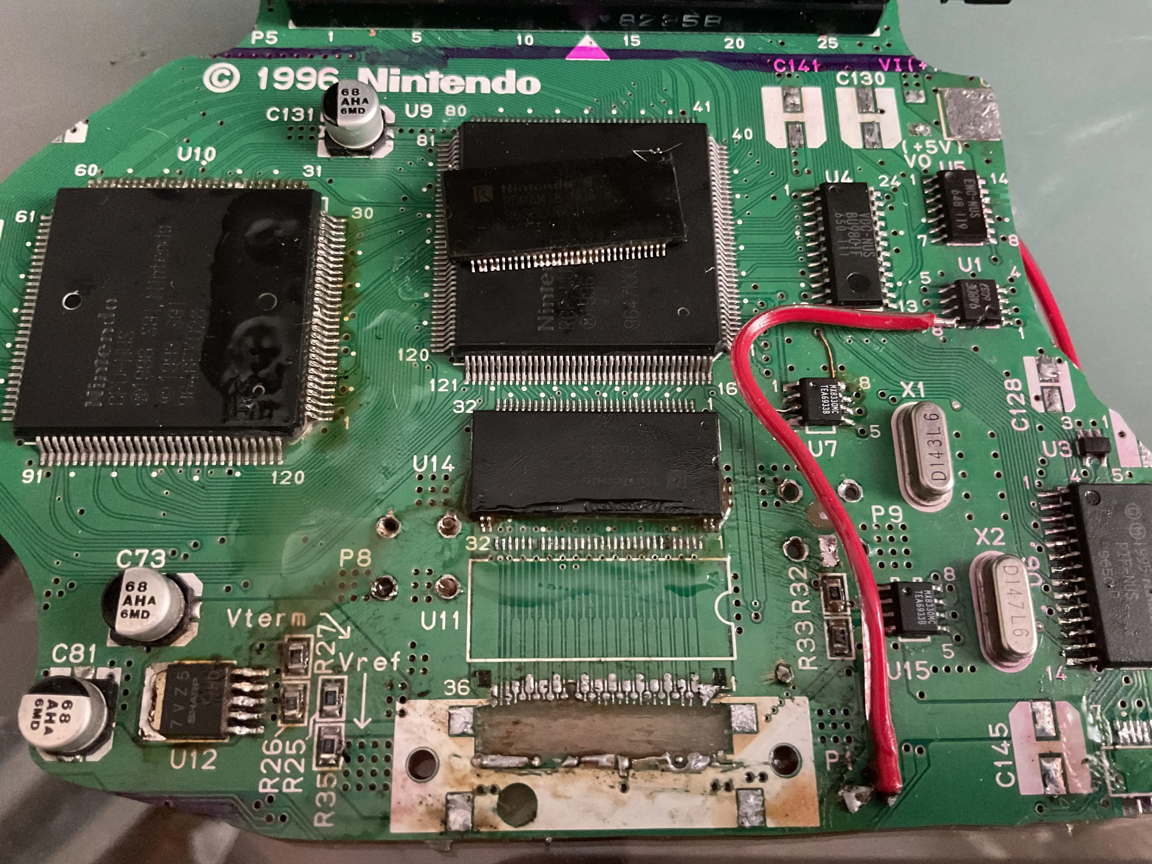

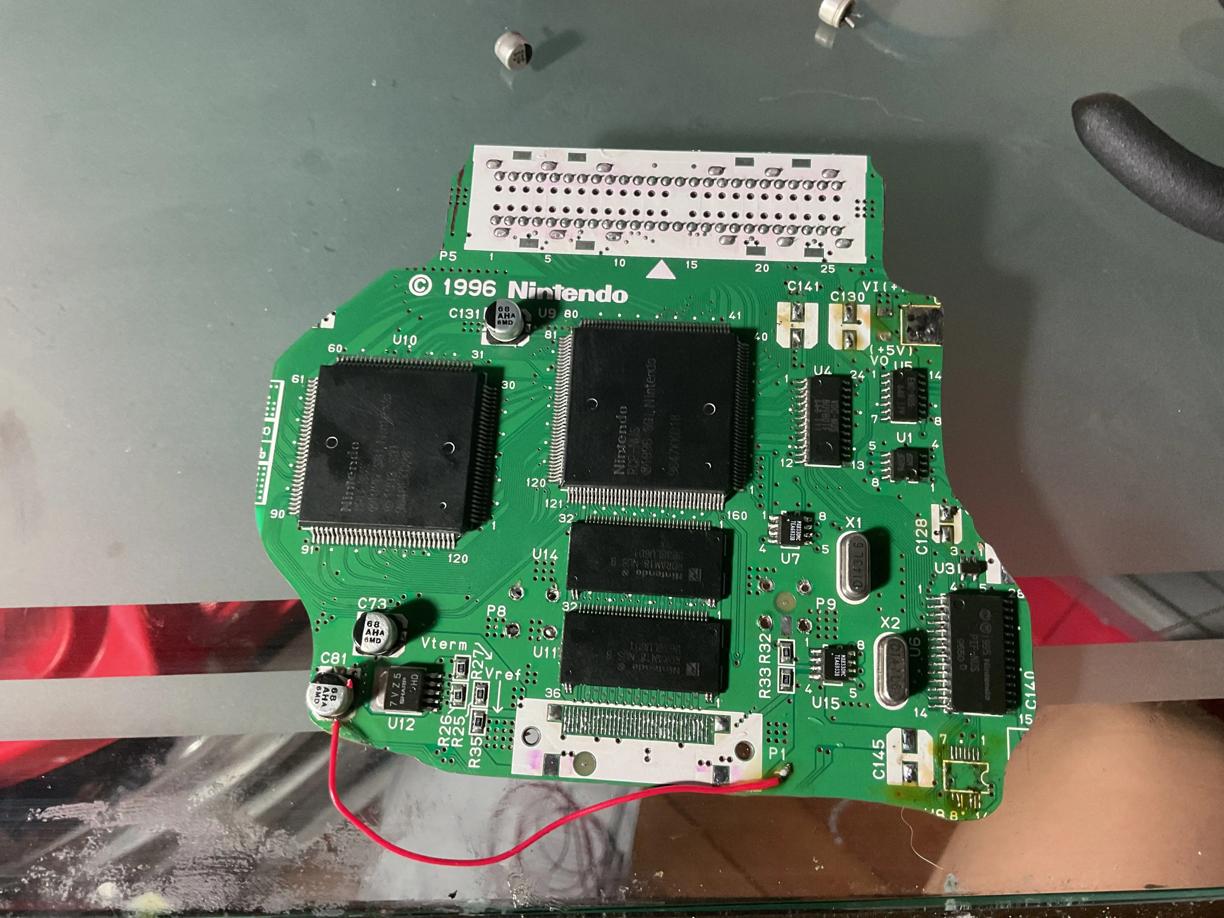

ok so I posted about this on the discord and on here but I just now realized that I haven't made an actual worklog on this project so im starting now.

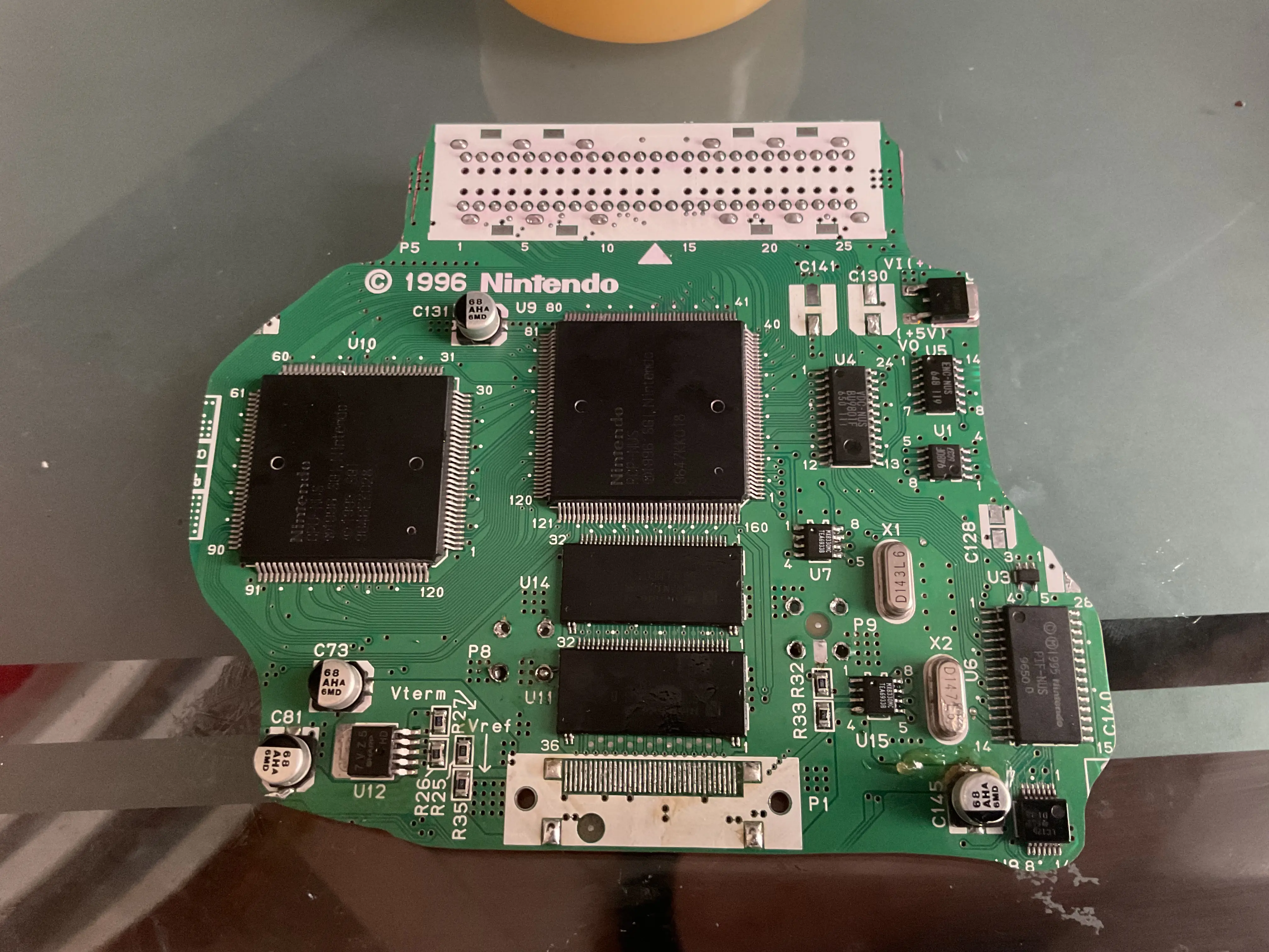

the board has been trimmed
I drew a case design on graph paper

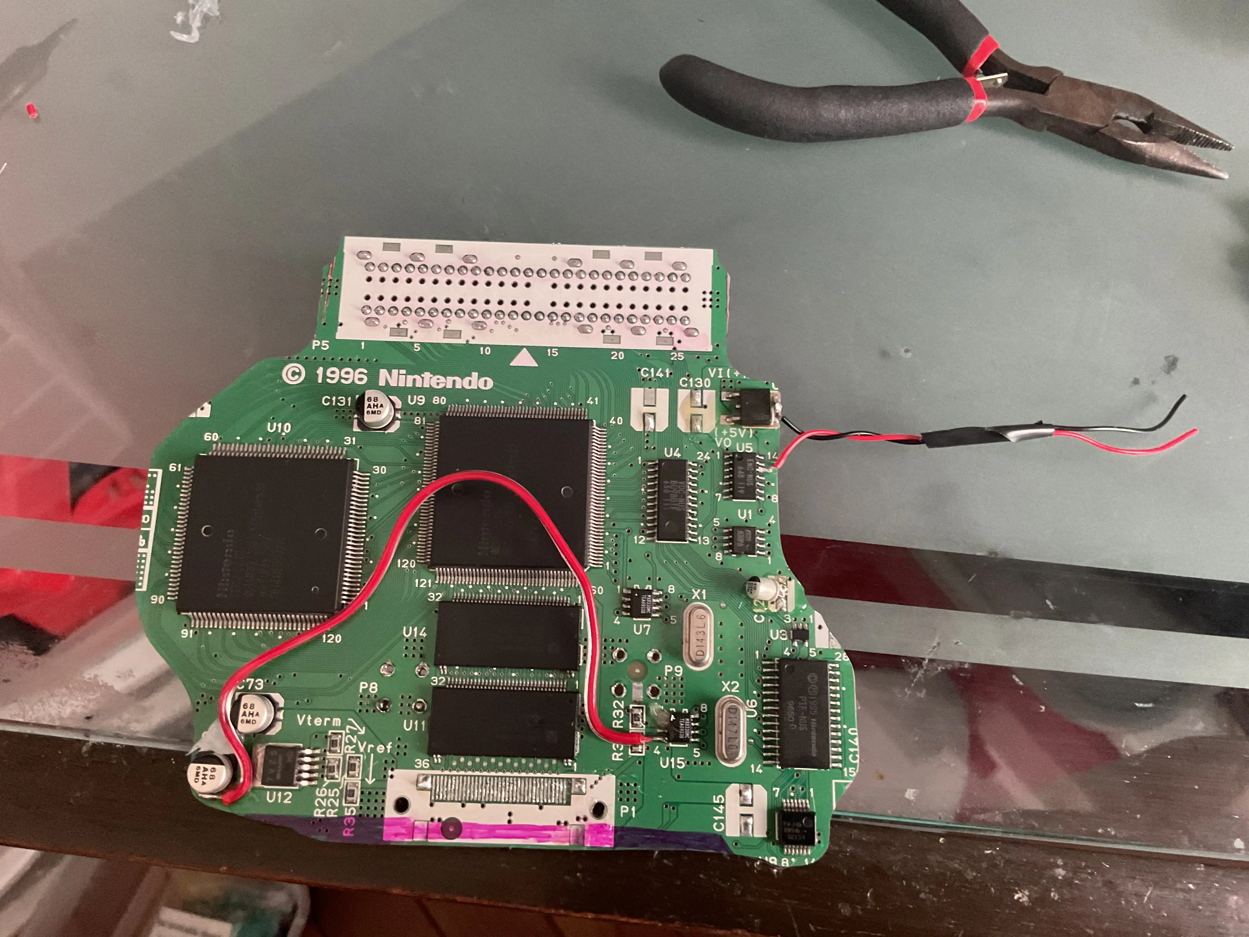

im about to test if this thing actually still works or not.

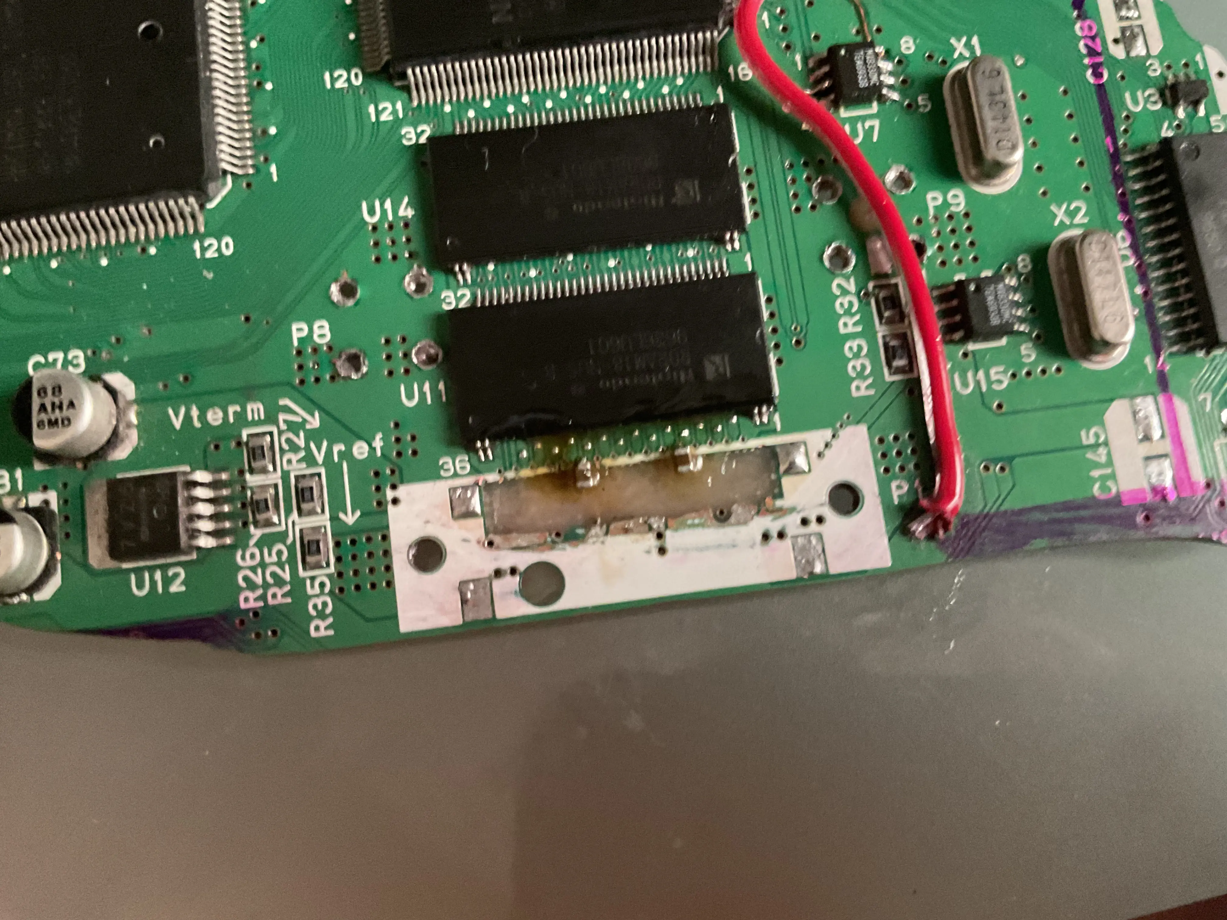

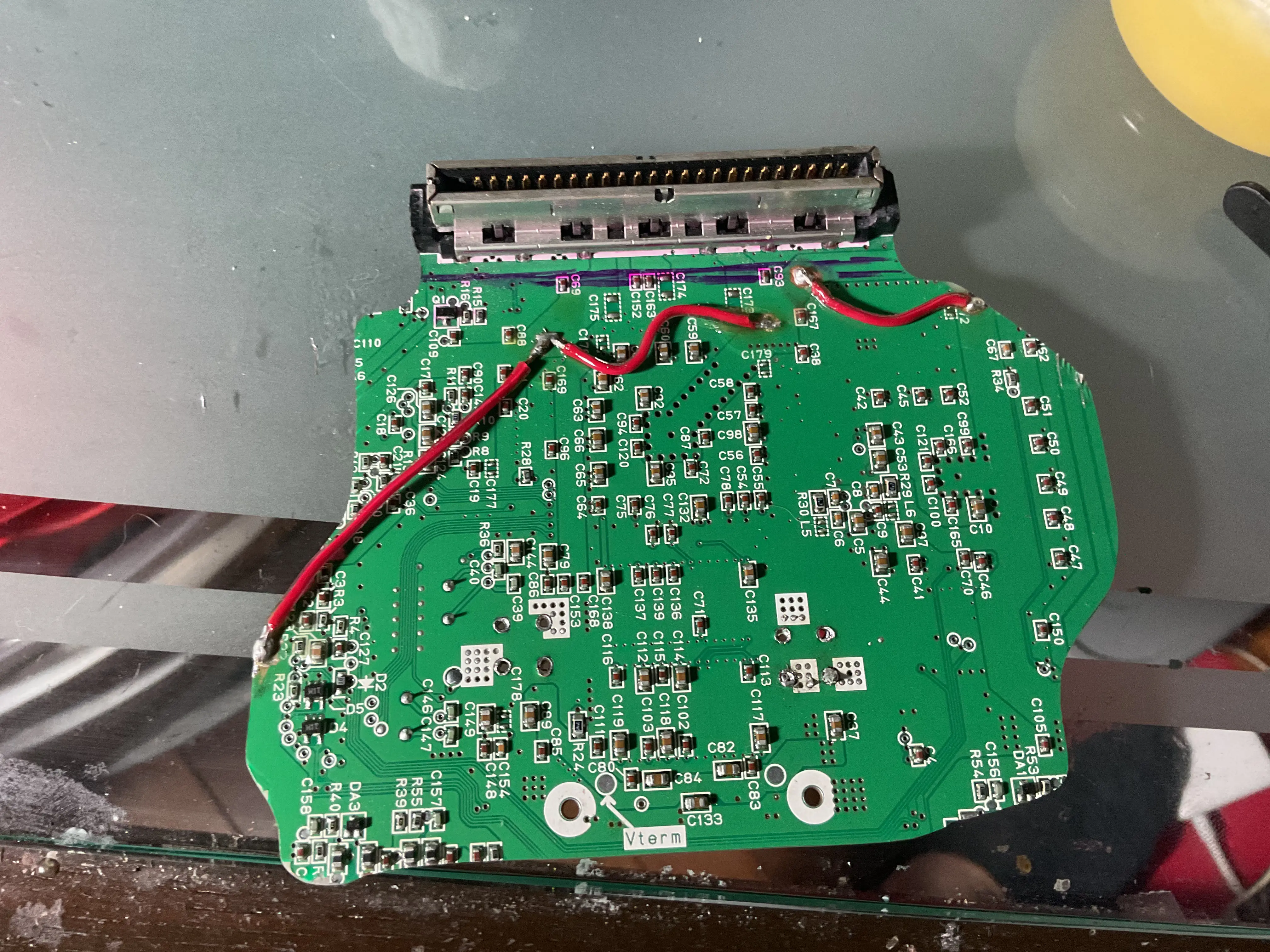

removing some more stuff, shitting around with the wiring I haven't a clue what im doing but im kind of guiding myself using the time tested method of plagiarism but everyones wiring is different >:ovfnejhnweiuweweiundinedfsindfshjdfsndjf vac c jcdjn d
AAAAAAAANAAUHABAIUYANAAIUYBNIEUYFBDRYBNEWH DH DFVHDVJVHJDFN UJF FKJFD KFJDV DFVJDF VDFJV DFOJV DFVJFD
I need to sleep

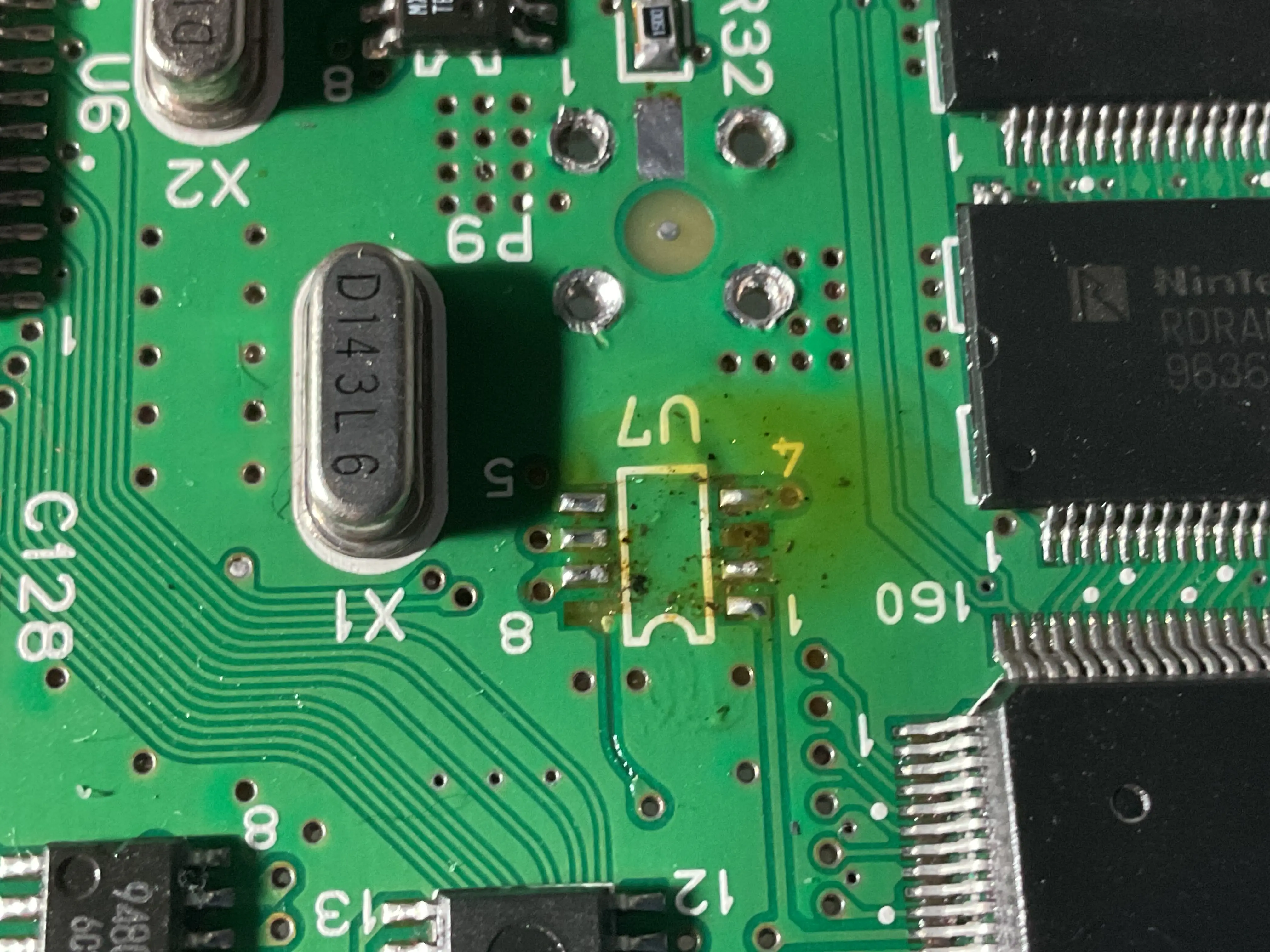

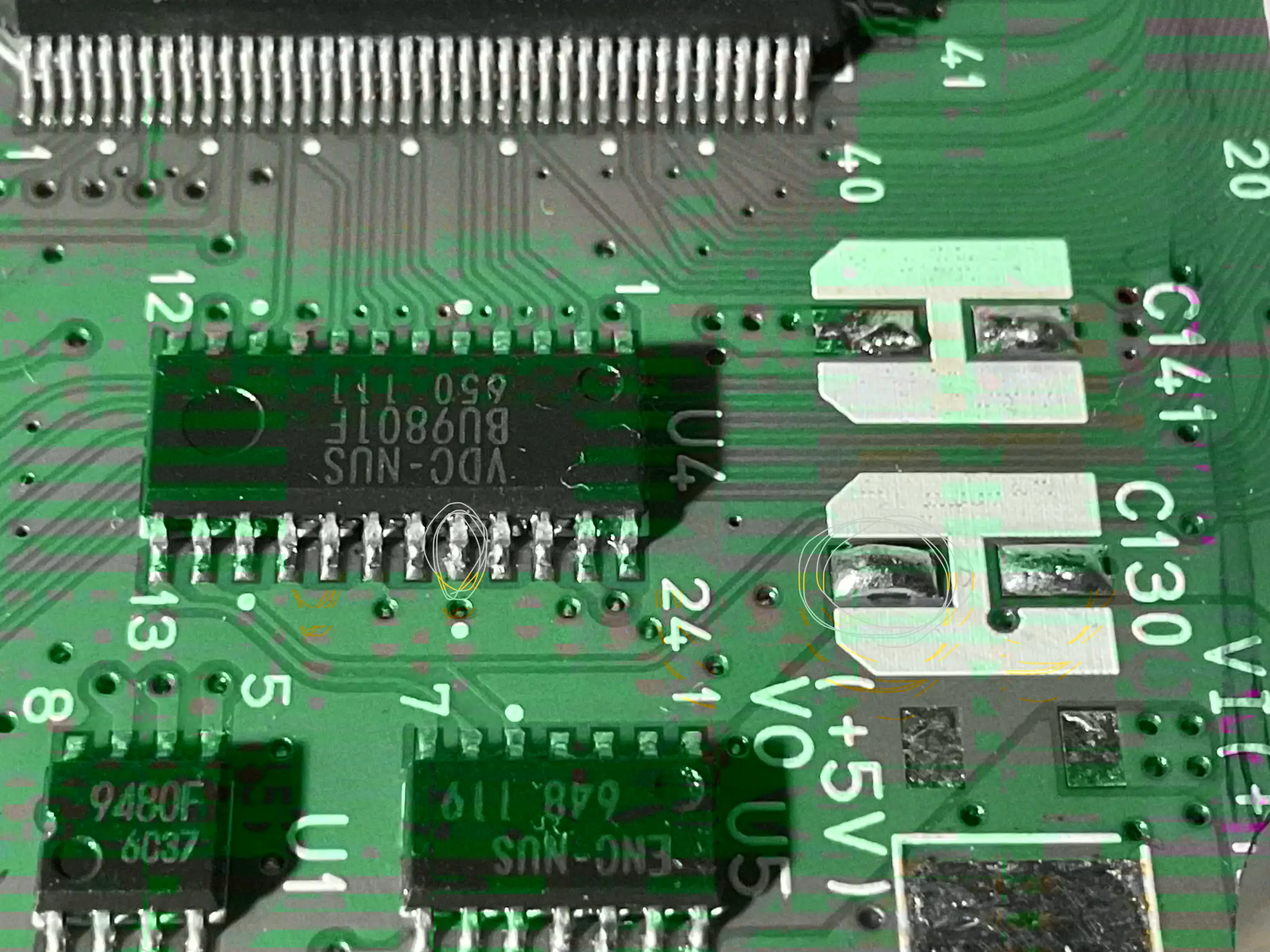

ok so pin 20 on that one chip isn't making a connection to that pad and I don't know what this means or what to do about it but its not supposed to do that

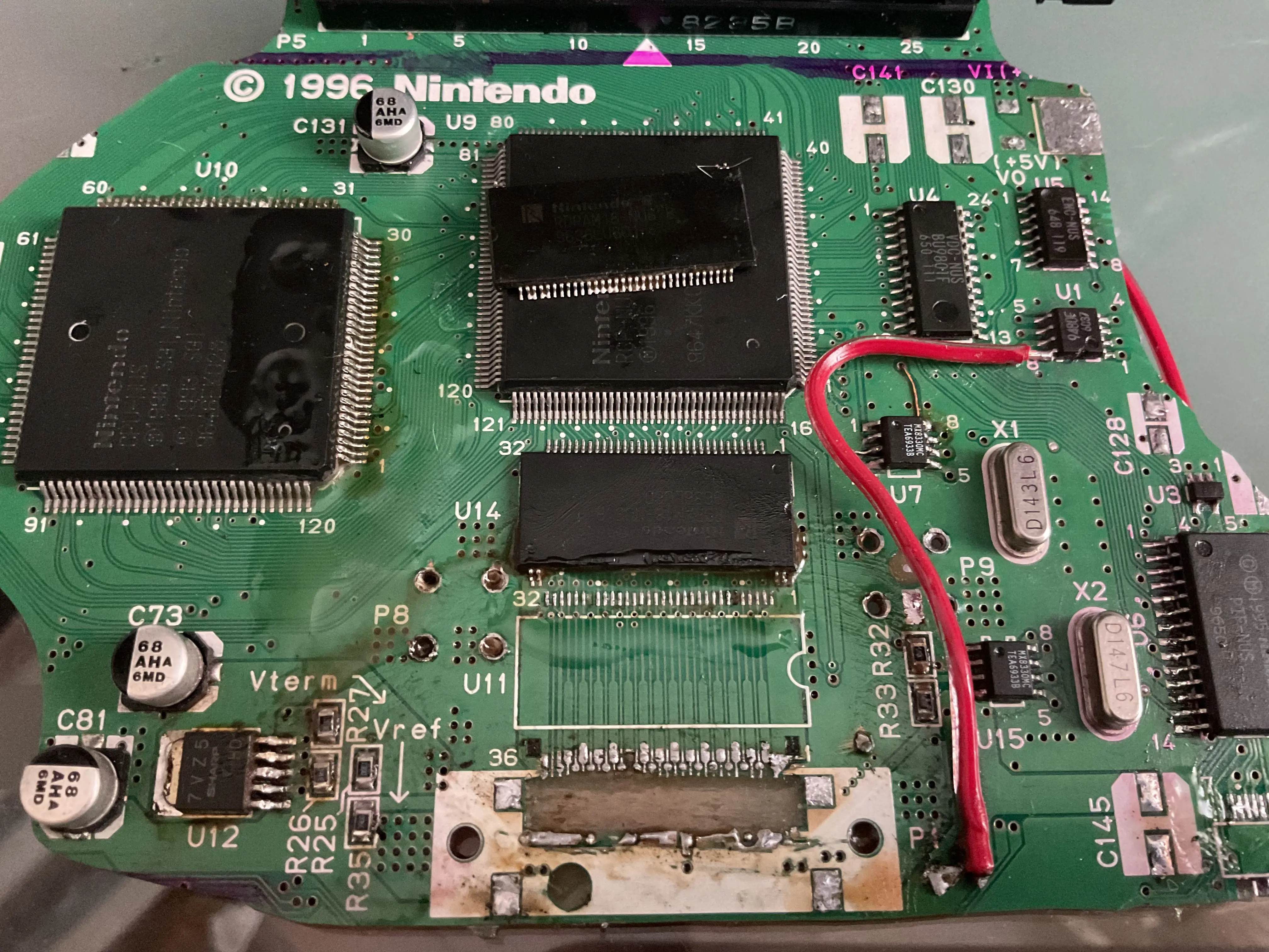

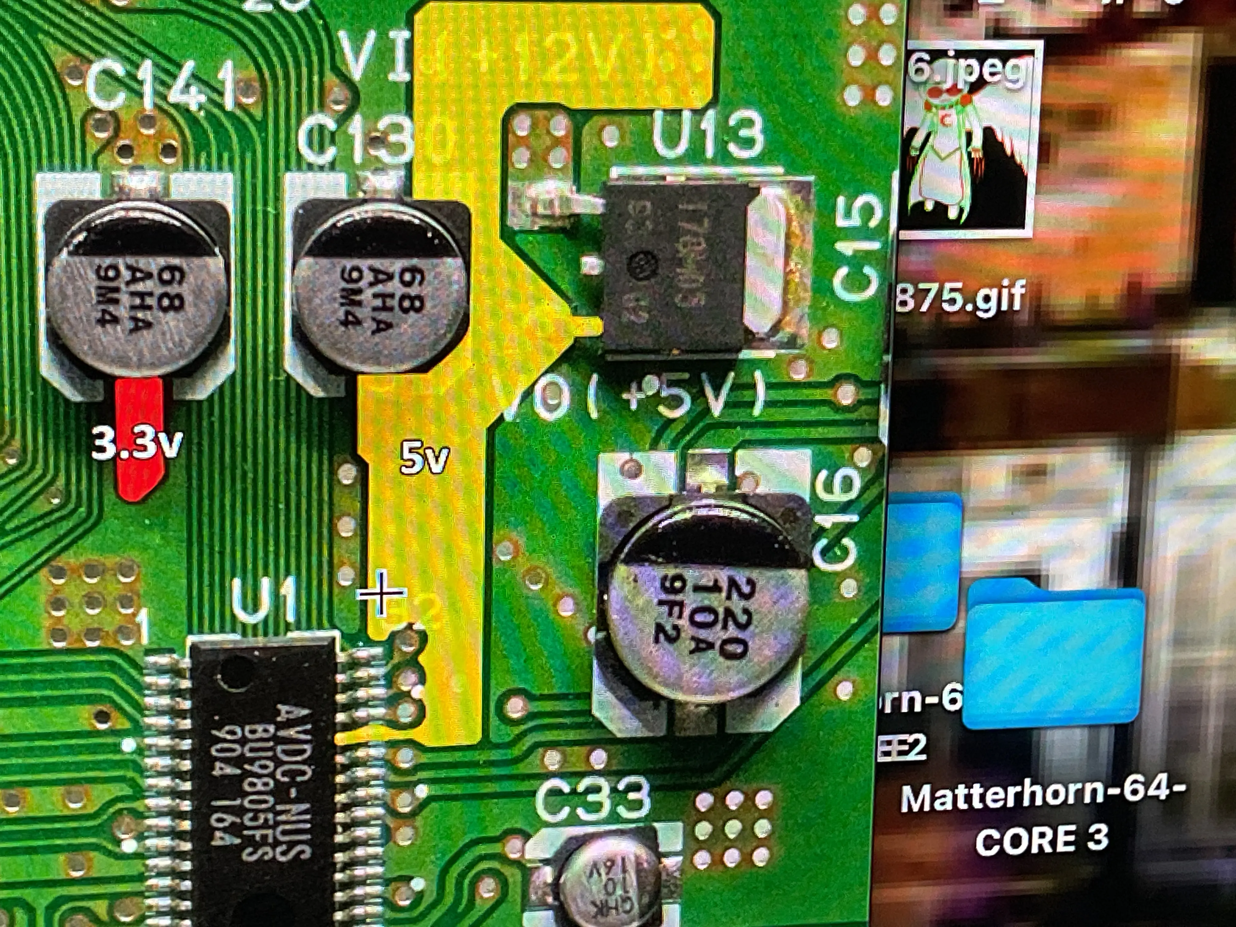

3.3v is fine sorry about the second image being shitty my computer just fucks up images sometimes

well thank you, I do think Im better at drawing than I am at any kind of electronics but I still think its very fun :o)

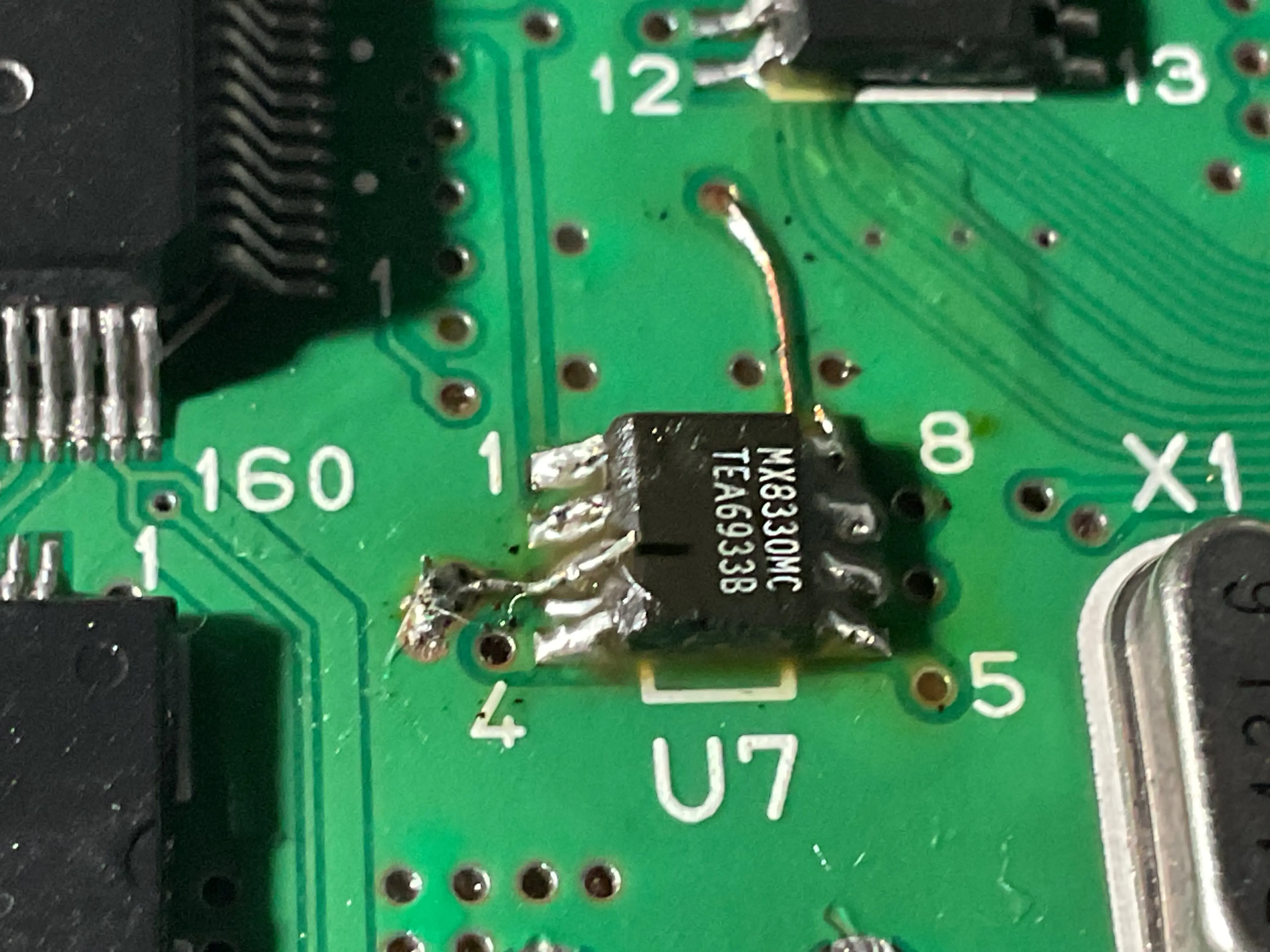

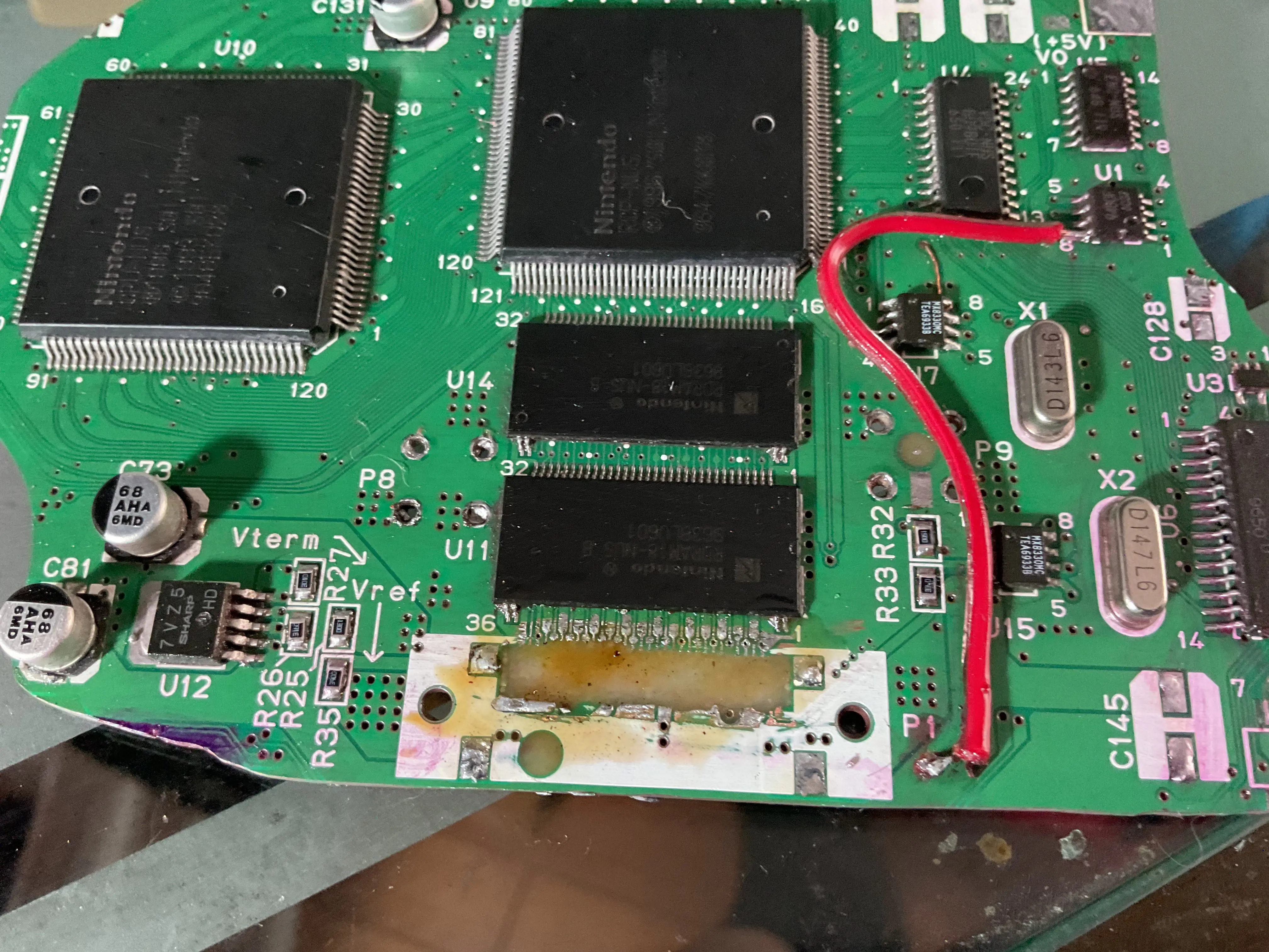

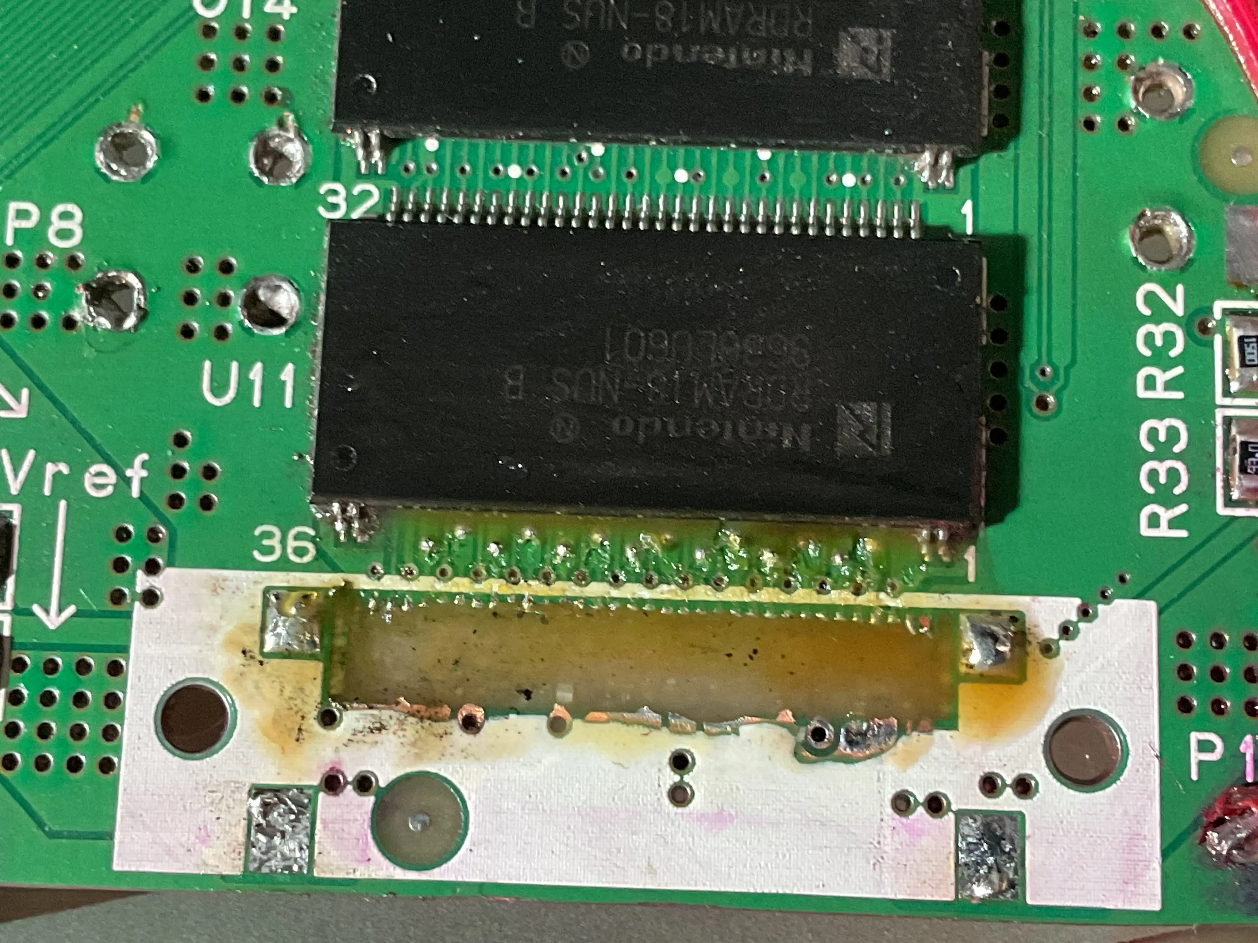

Well shit............................
fuuuuuuuuuuuuuuuuuuuuuuuuuuuuuuuuck : o (
Big oofs man you gotta get yourself some kapton tape for that stuff so you can tape off the other chips and stuff around it!
Something I do as well on top of flooding the legs with fresh solder before blasting it with hot air is when its being stubborn, I'll drag my iron over the legs while simultaneously hitting it with hot air to help it come off.
Its hard to double fist both your iron and hot air but it helps for stubborn chips!
