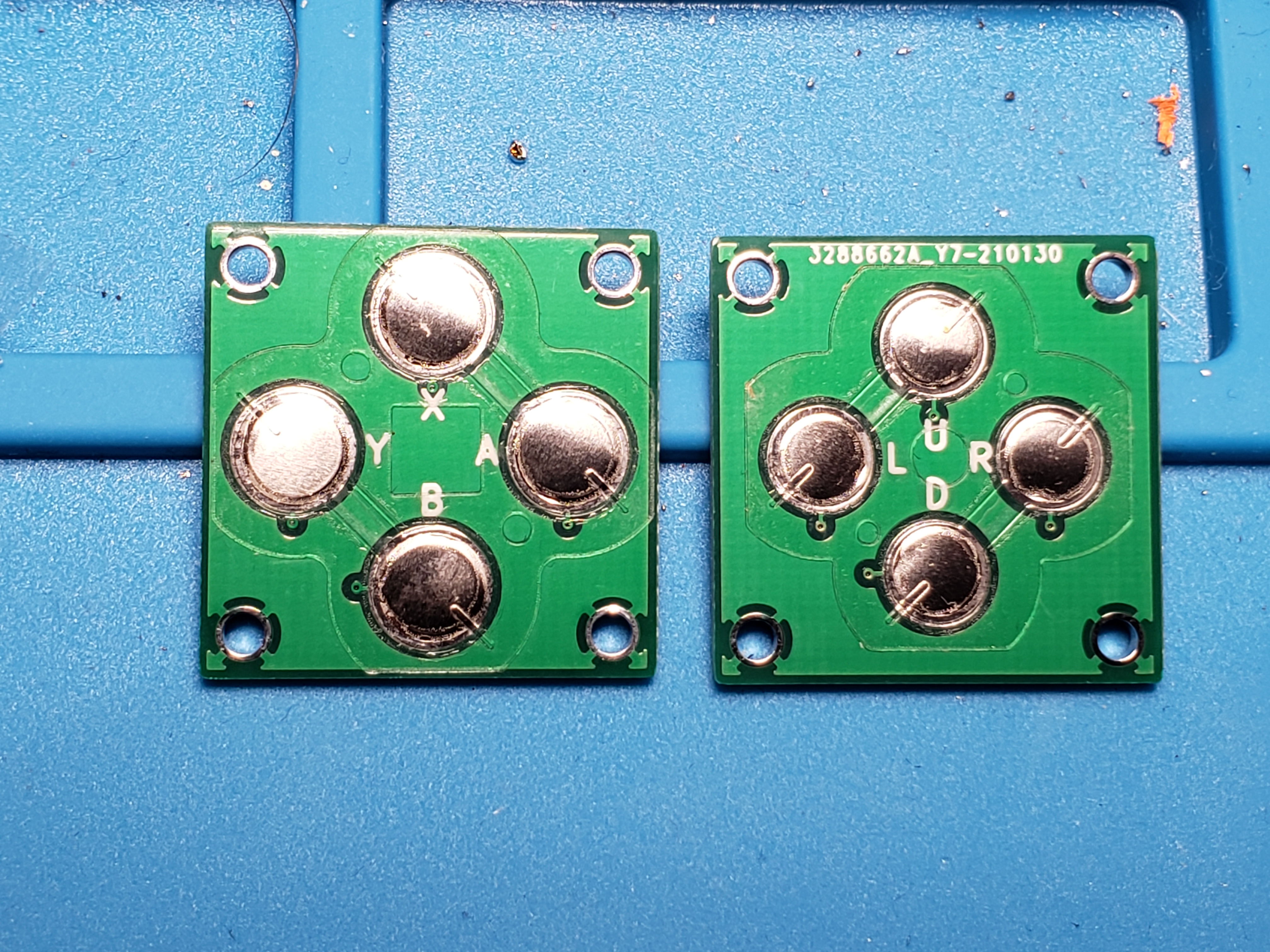

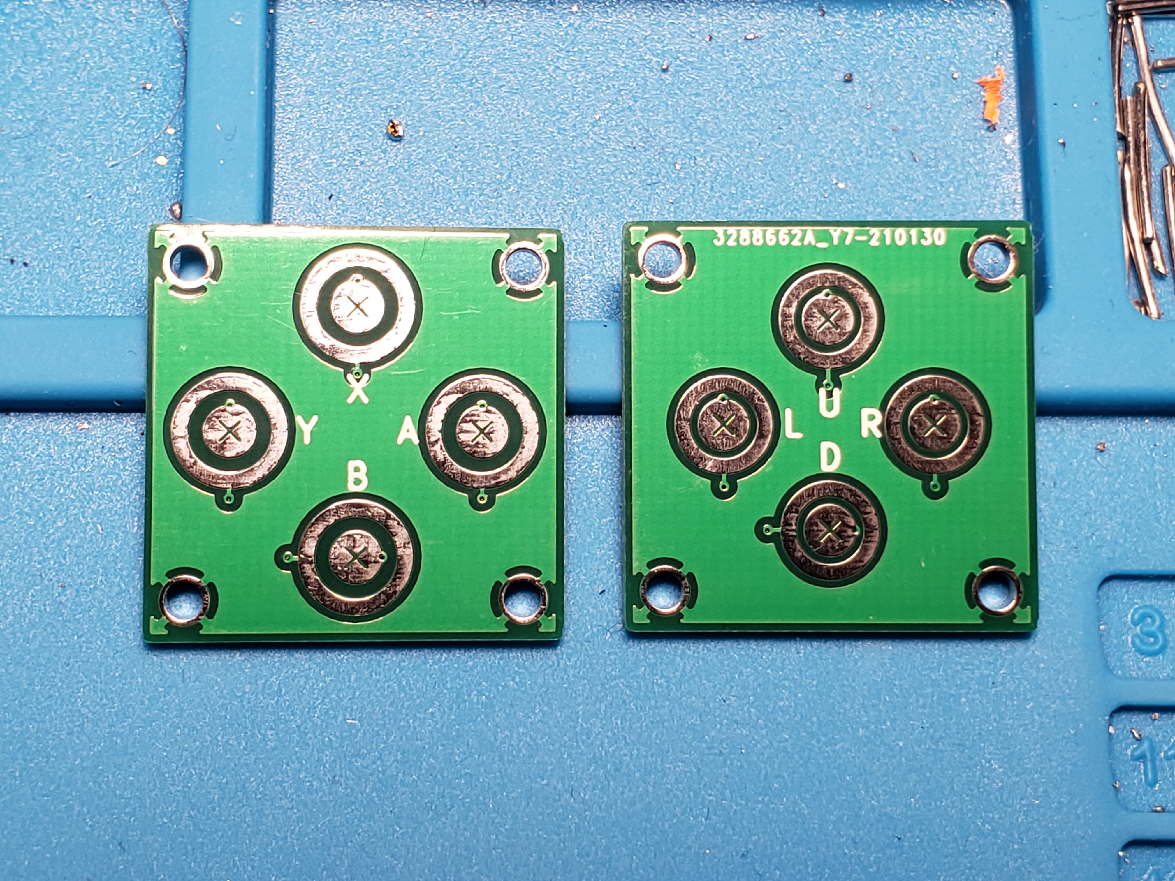

You could go that route (Señor Avacado did that for their GC- Build), or you could recreate the pad in KiCAD and make a simple button breakout board. I did that a couple years ago, and it uses replacement dome stickers to get an OEM feel:

As CrazyGadget mentioned, there are some existing solutions for this. There's a publically available set of ABXY and dpad breakout boards in this thread that you could use. You can submit the gerber files to JLCPCB or PCBWAY for manufacturing (make sure you get the gold contact plating or they won't work properly), and you'll need a set of the DS-Lite silicone conductive button pads to use with it. Afaik the DSI button spacing is the same as the DS-Lite, the DSI buttons themselves are just a bit flatter, so it would probably be the simplest solution to mount and use.

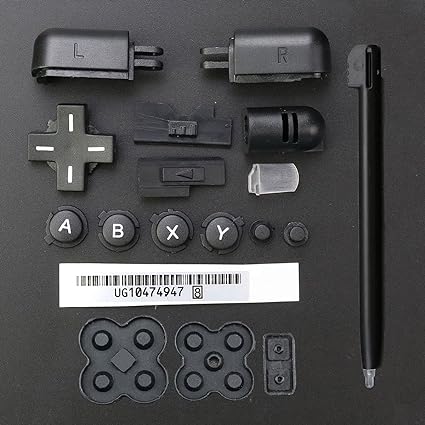

would this work with the DSL button pcb?

As long as you get the gold plated contacts when ordering the PCBs, yes. Plain copper doesn't work with the silicone pads very well.
would i be able to order these from pcbway? with the gold contacts?
I have no experience with PCBWAY, but I assume they'd offer ENIG (gold and nickel) contact plating as an extra addon like other fab houses do
