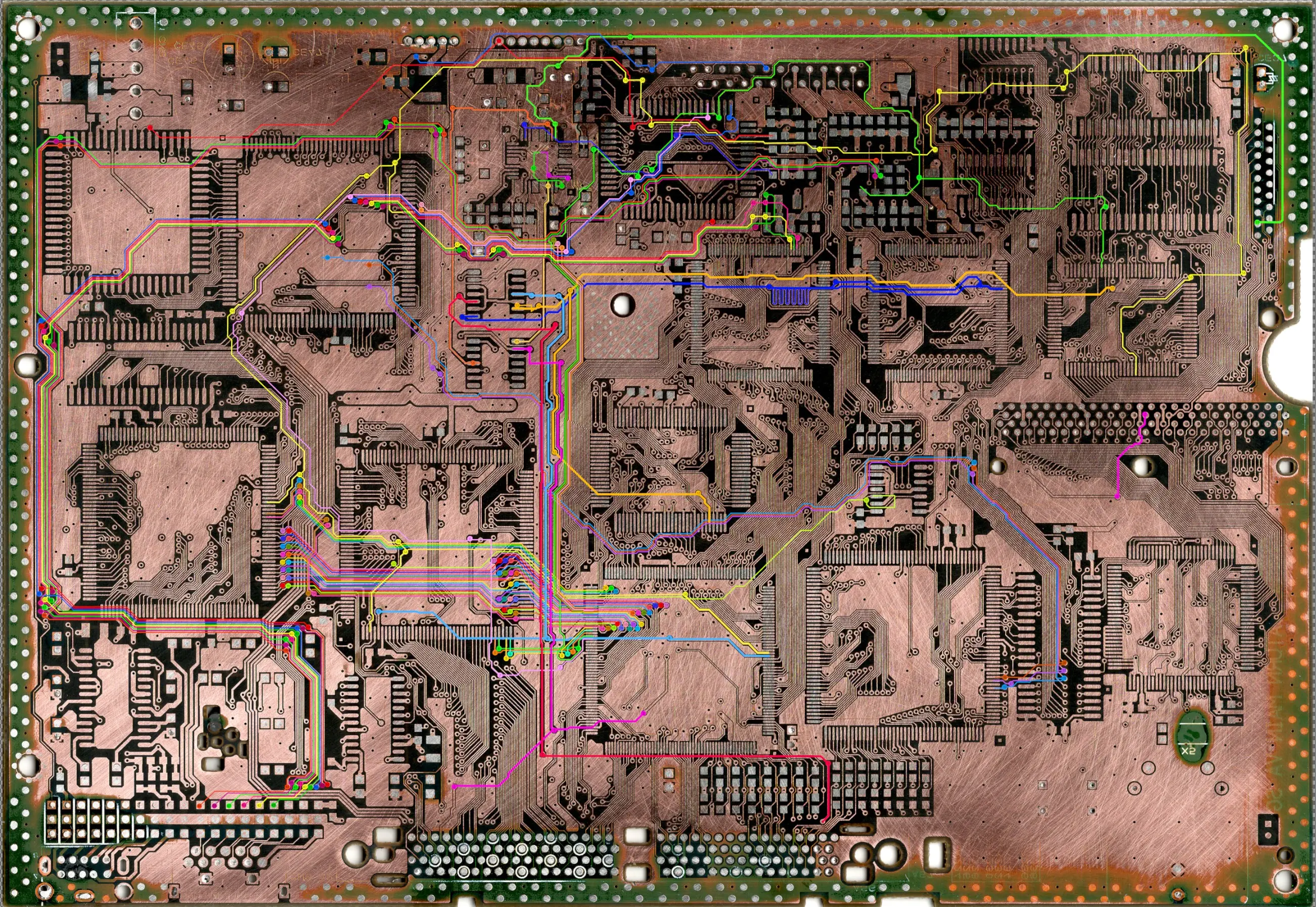

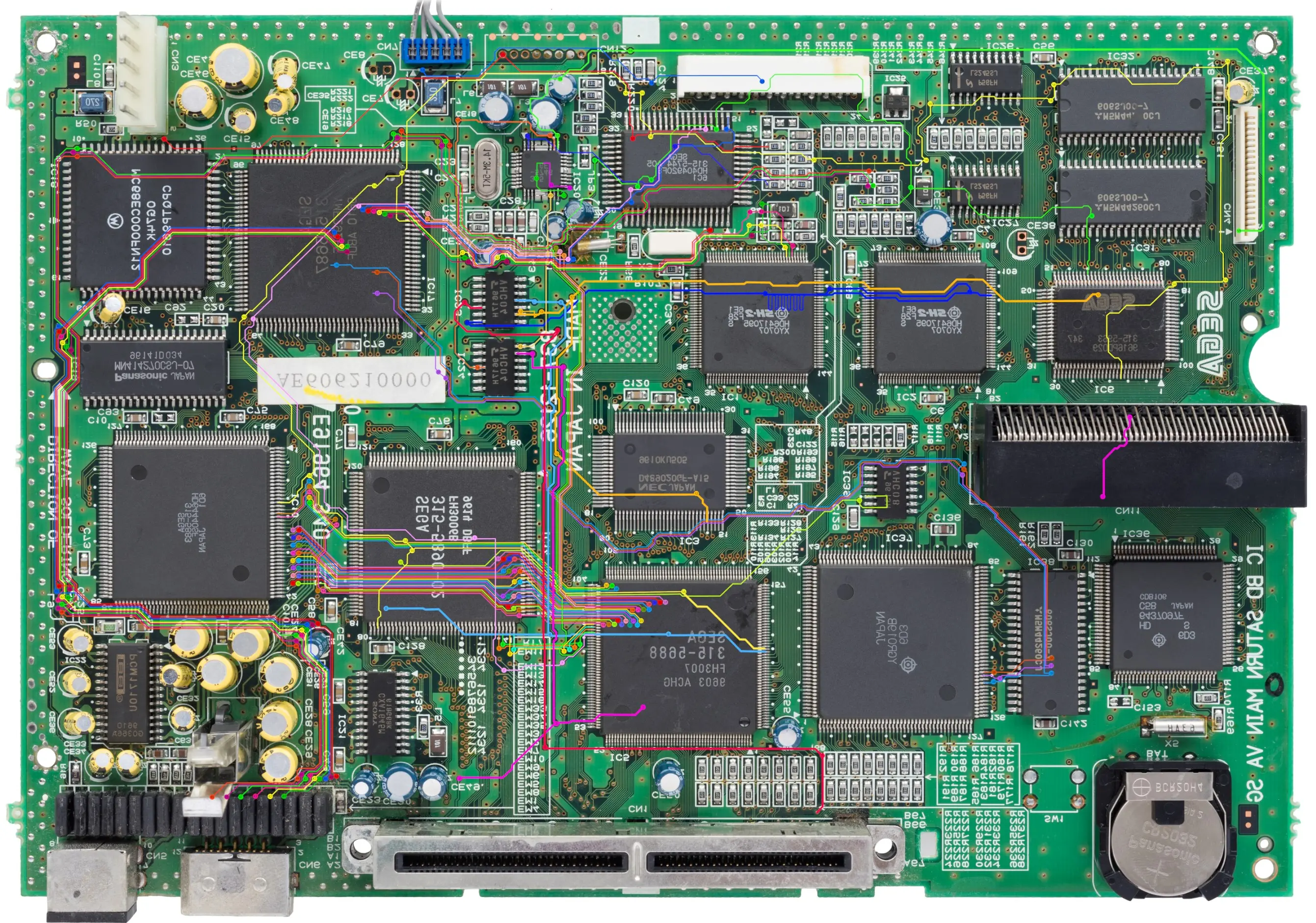

I should post this before it goes missing in the backrooms of my NAS. While working on my Sega Saturn VA-SG fold (for a potential Saturn Mini) I did some pretty detailed documentation on the layers, traces and vias of the VA-SG variant of the board.
While the fold was partially successful (some boards worked for a while, others didn't work at all) I figure the documentation would come in handy for others attempting some Saturn butchery.

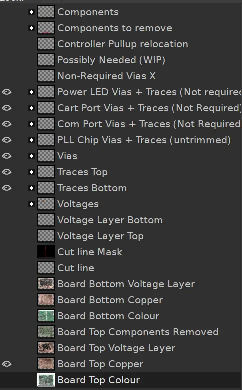

The GIMP file is pretty meaty (over 500mb) but layers are pretty well organised so you should have no issues locating info.
