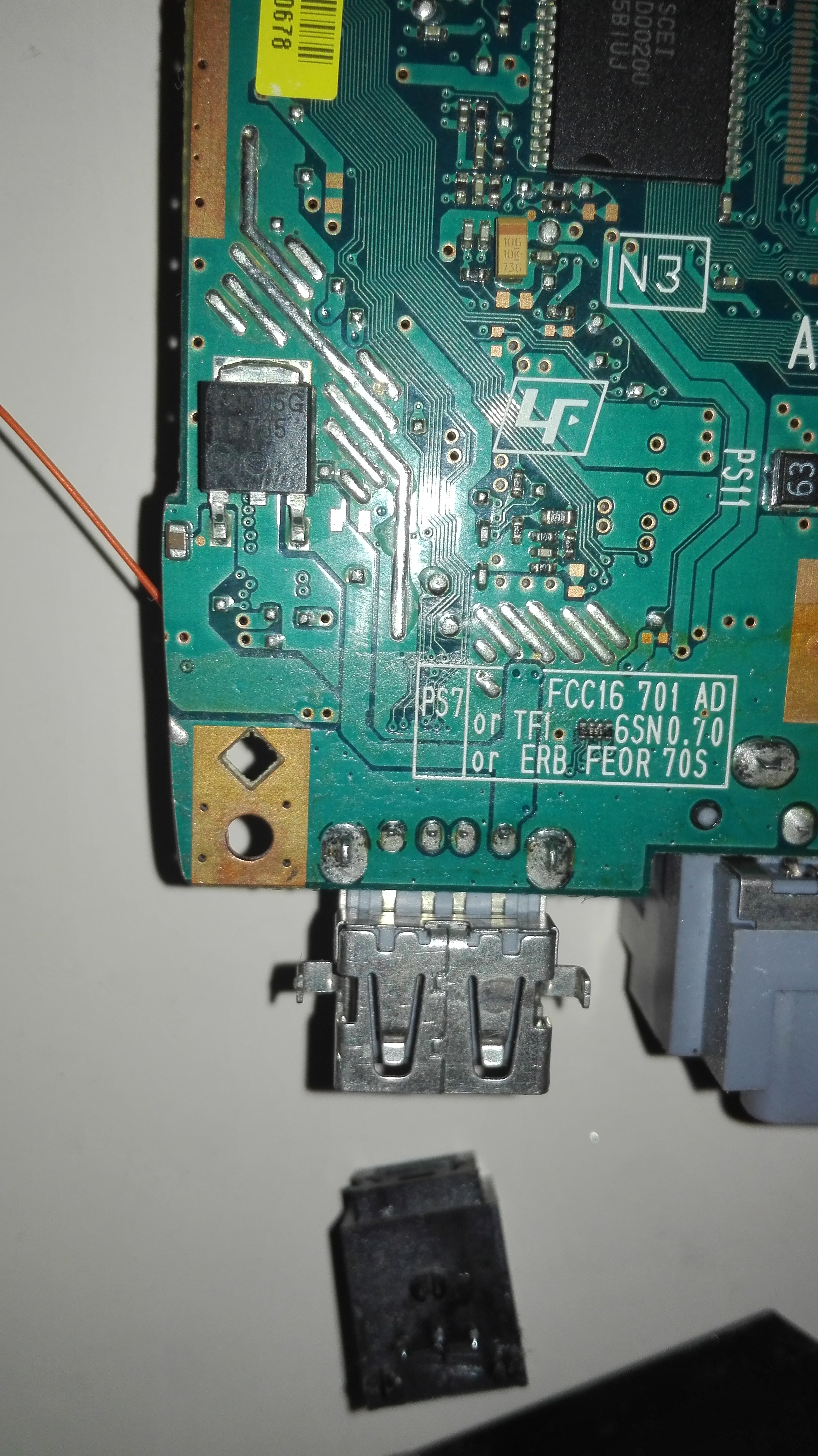

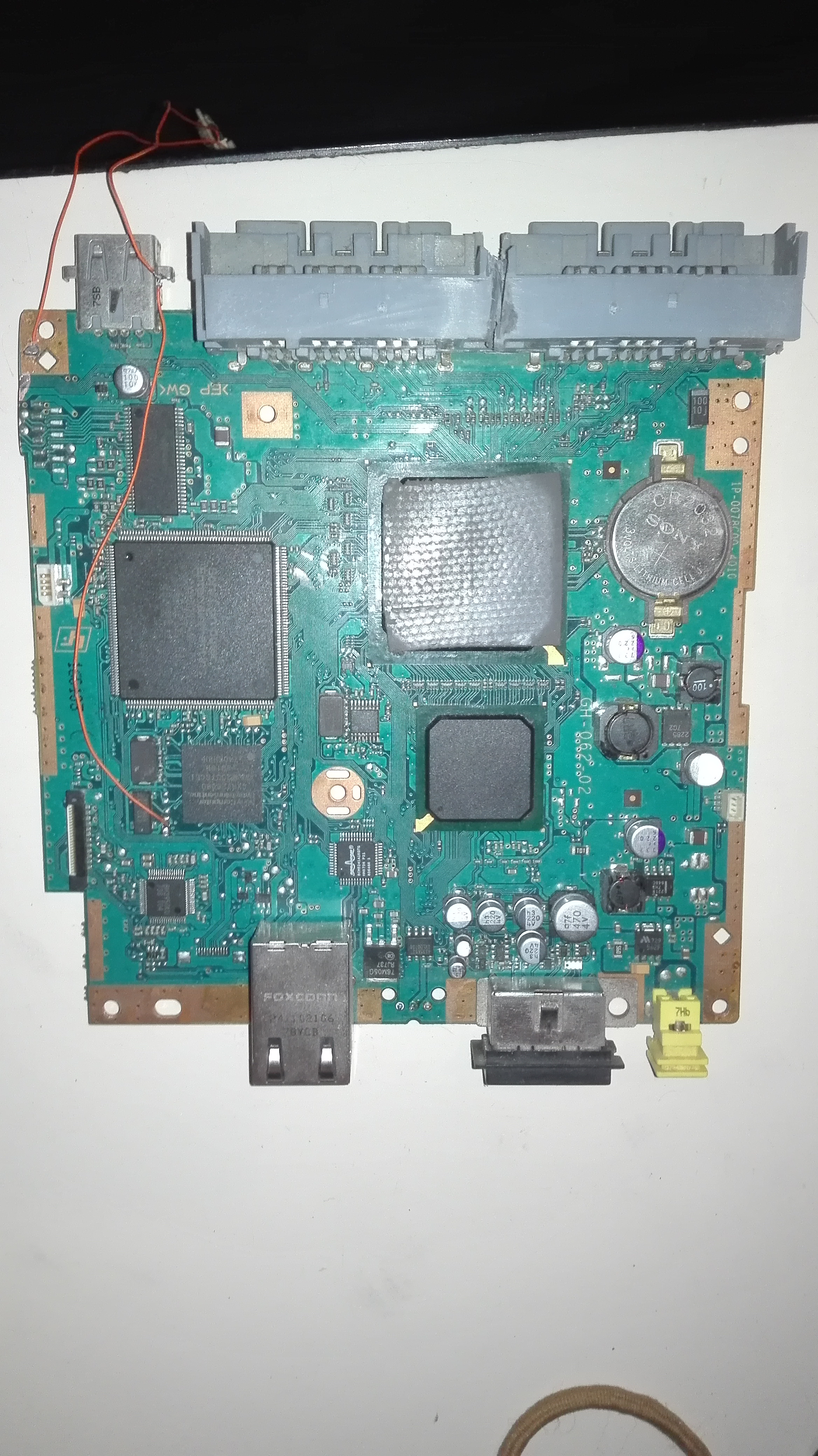

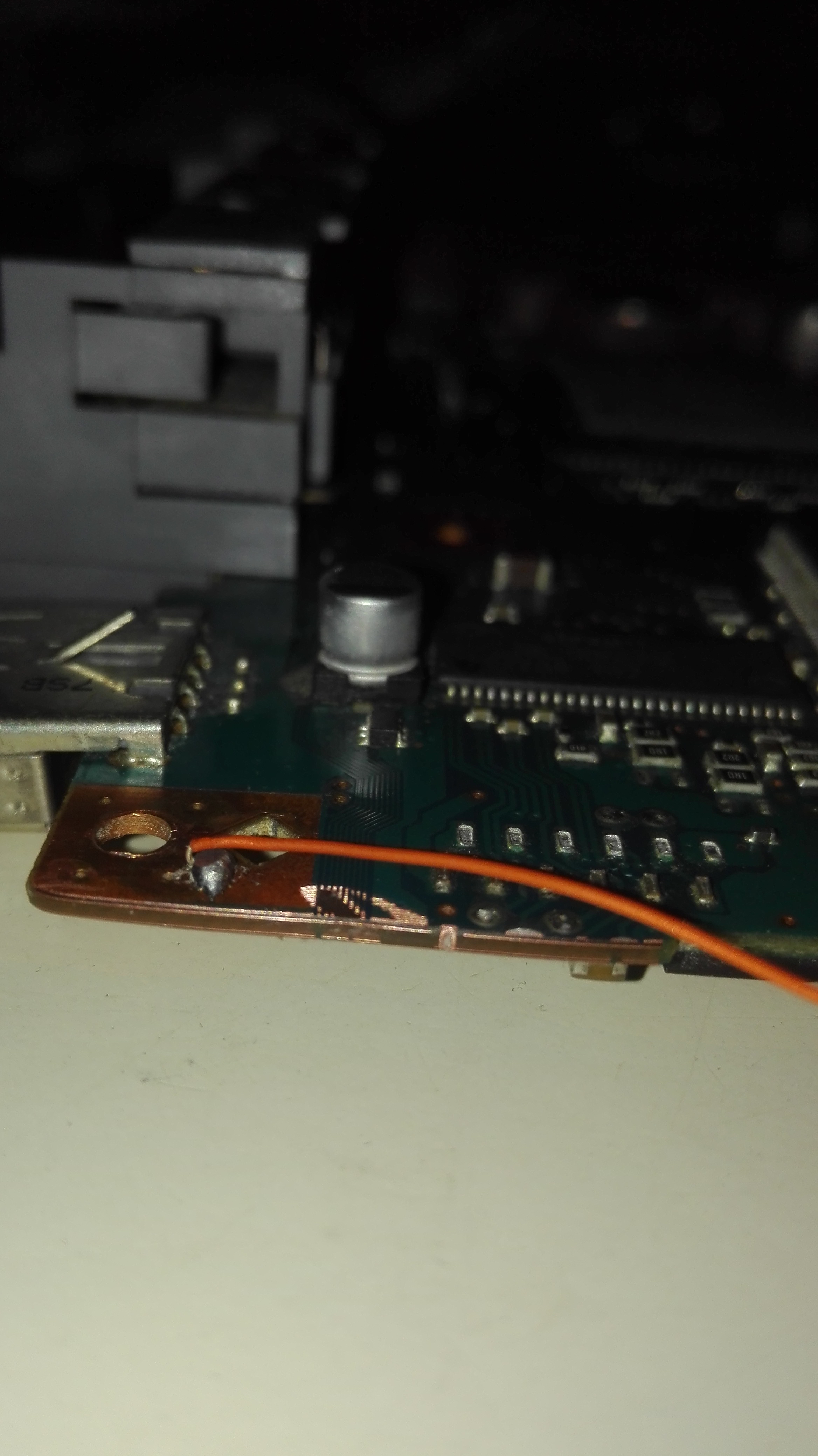

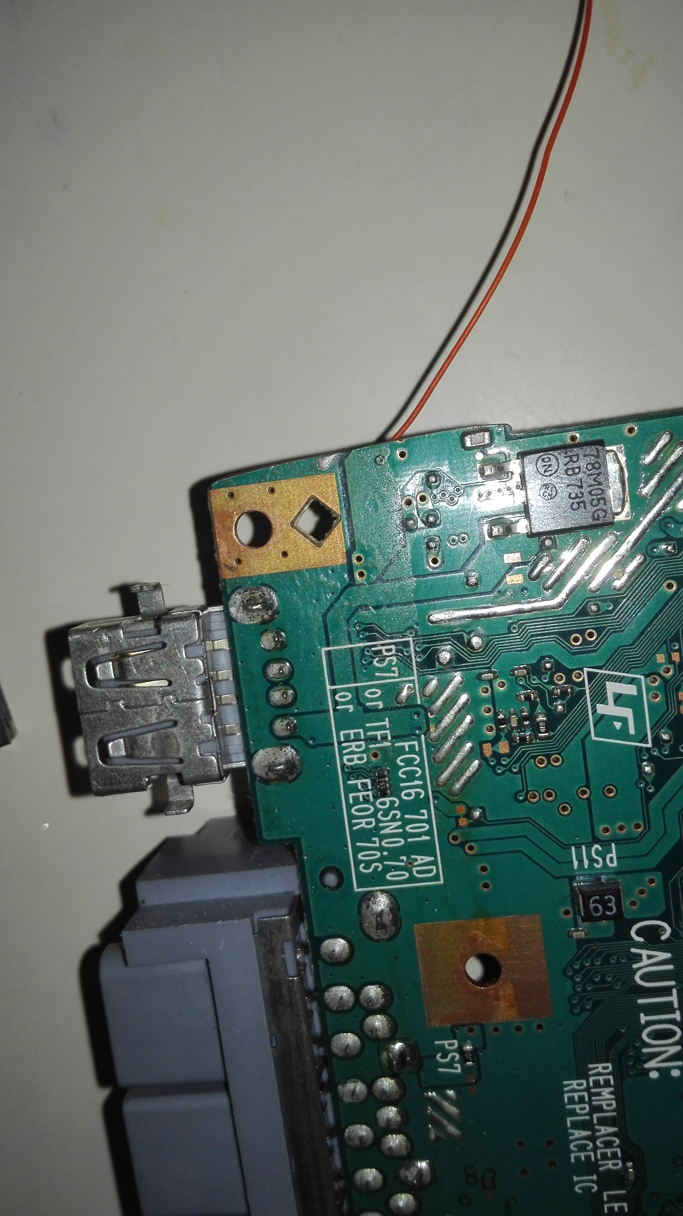

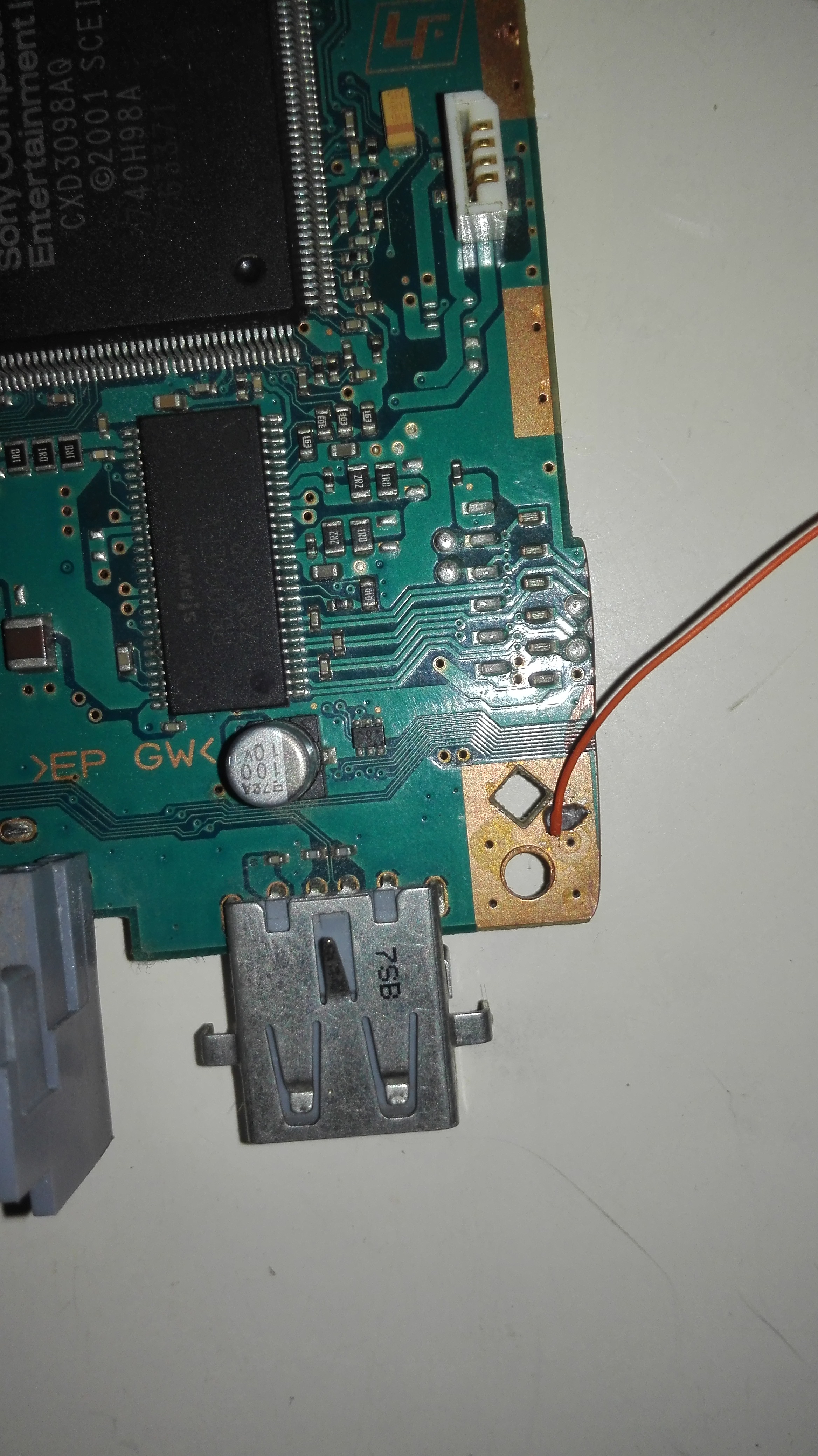

Hello everyone just got all the tools and boards to start my ps2 portable, the thing is that just for troubleshooting tried trimming the 2nd usb port and removing the digital output of the board.
Now it does not show anything on the screen, but the board powers on just fine. Did i just killed the board or something?

Update: Just figured out what happened... After desoldering the Digital Output port there was a tiny solder blob touching the other solder point and shorted that part, fixed the shorting and now it works as a charm again :D
Nice, I had that happen once after a mod chip install, and the worst part was it wasn't even my PS2 lol
