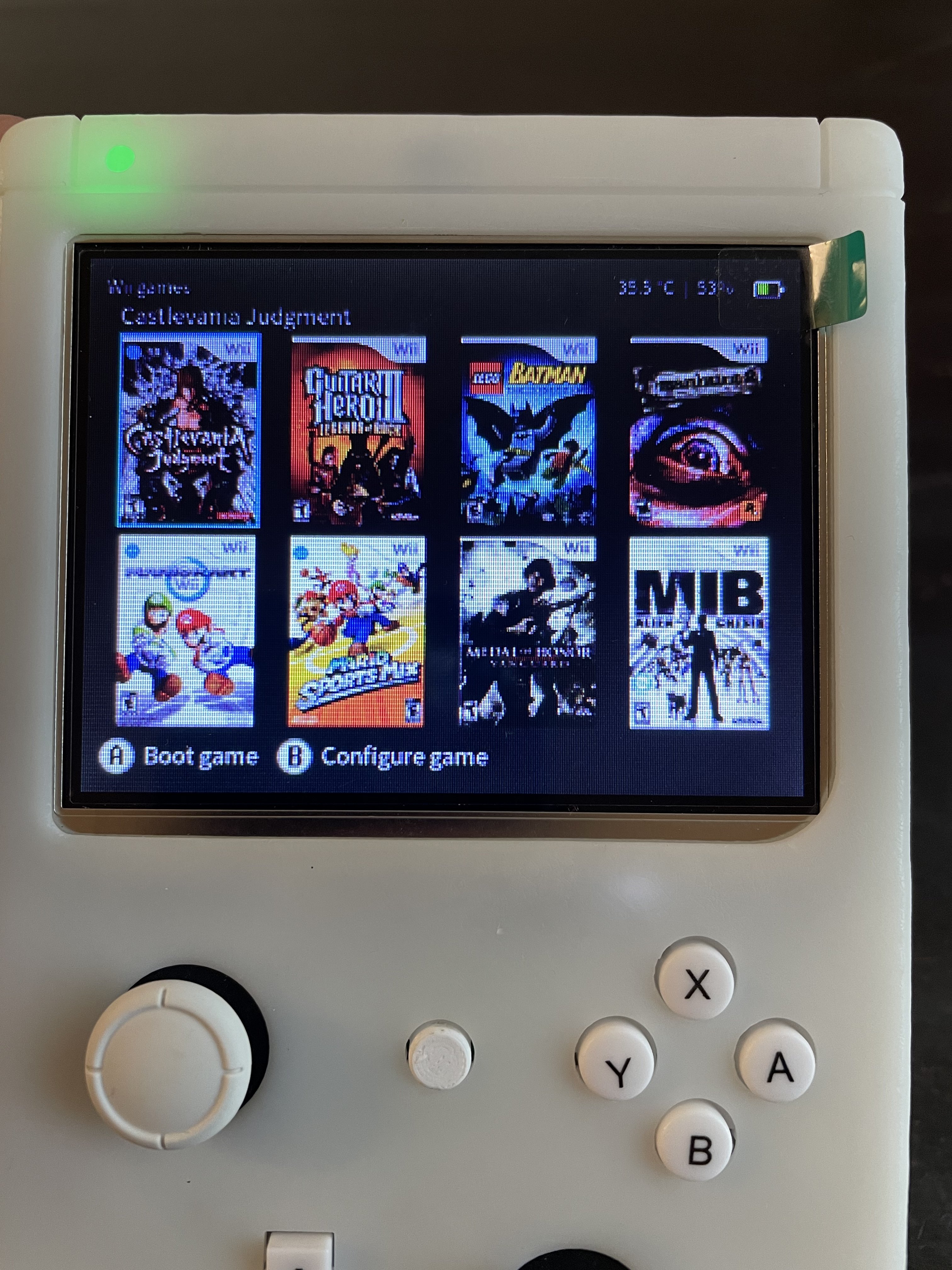

I finished my gboy but have some issues I think.
1st issue when I first turn on the portable it doesn’t load Rvloader it stays on no sync, I turn it off then back on then it’ll start normal.

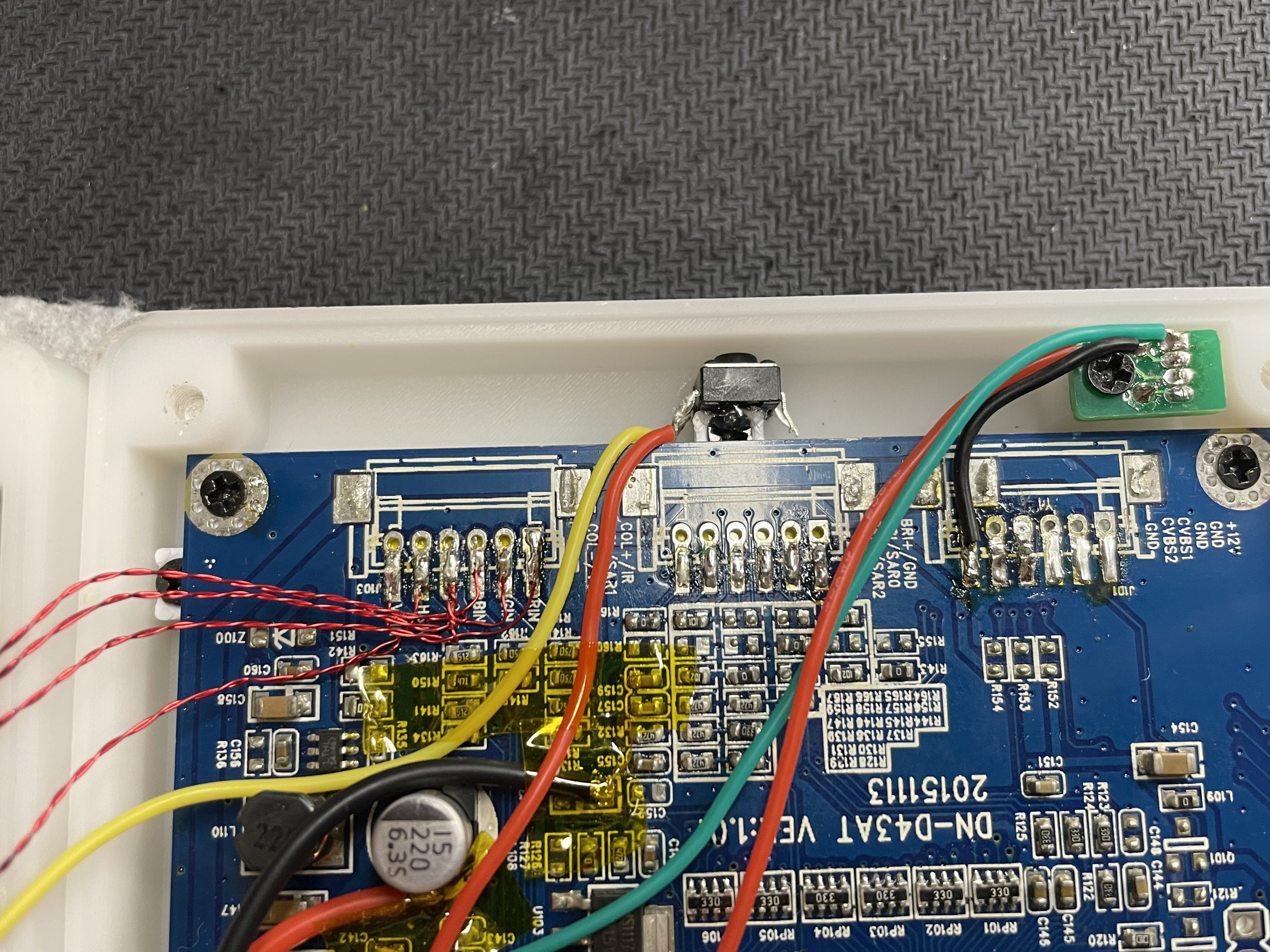

2nd issue I patched out wifi and vga but I don’t know if its just me or the lcd I’m using but the quality doesn’t look that good compared to the gwii I built.

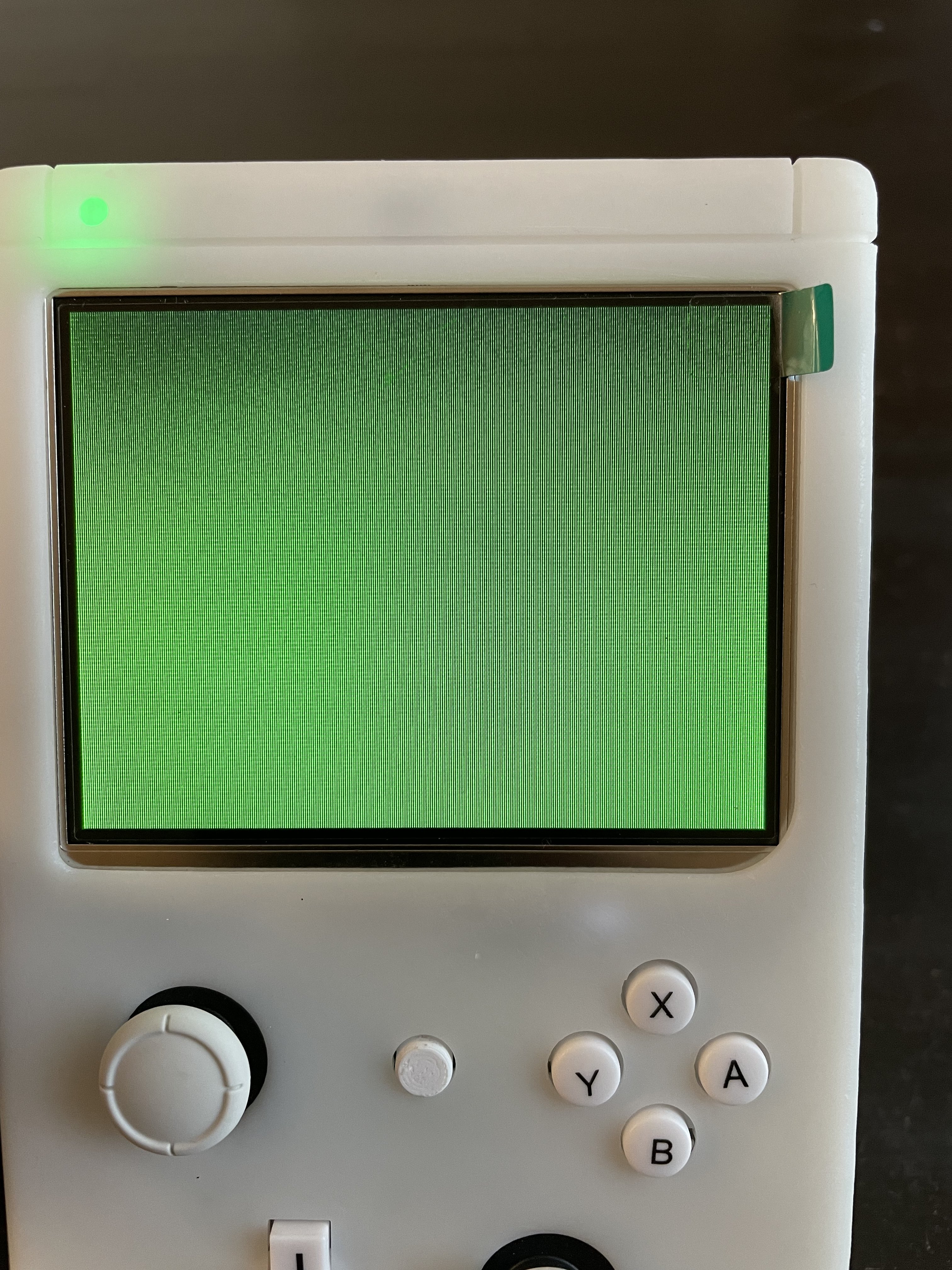

3rd issue when loading games sometimes I’ll get this green static screen and nothing loads.
Any help and suggestions is appreciated I’ll upload internal pictures in a bit
What screen are you using? It looks like 320x240 and not 640x480. For the last issue, are you forcing VGA on all your games?

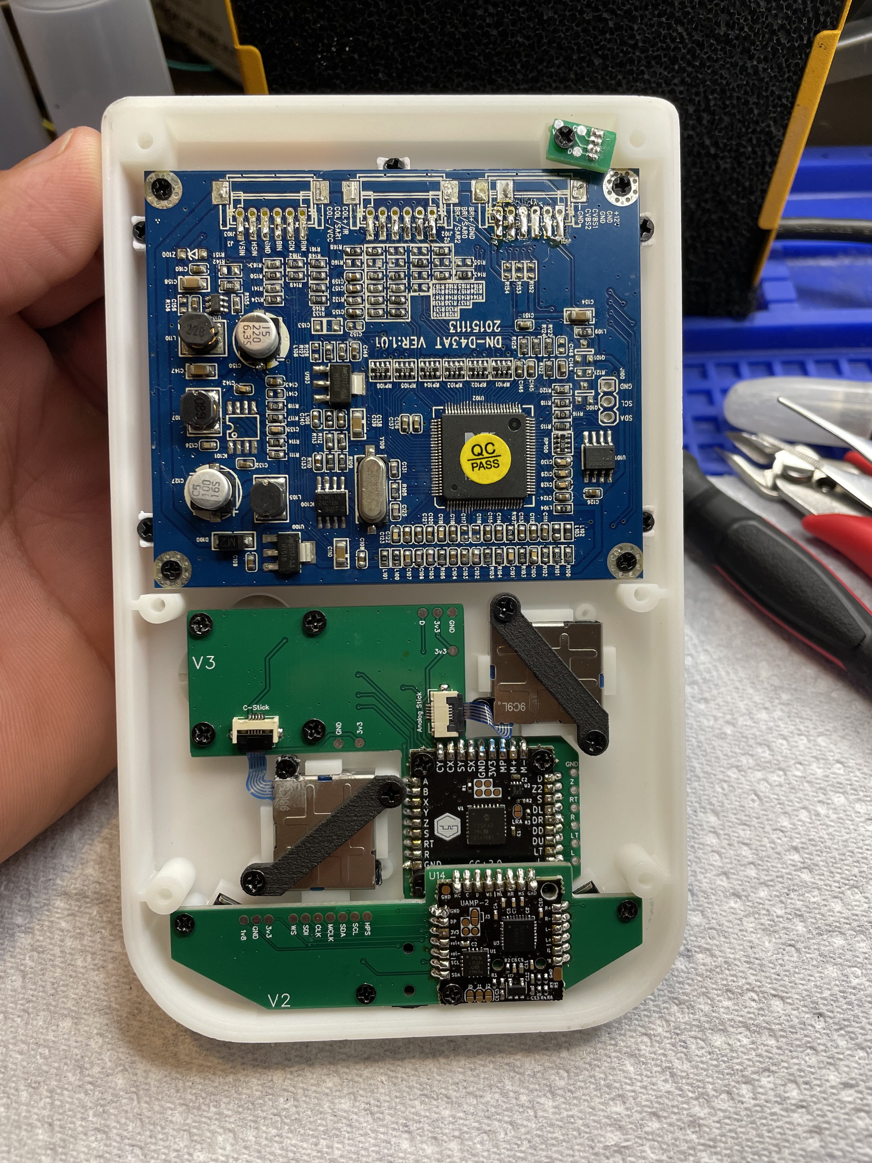

It’s the one with this driver board and yea just launching games with vga enabled.
also using this drive but the 128gb
Yeah, that's the old 320x240 screen, it doesn't look too good. I'd recommend picking up one of the 640x480 IPS screens / driver boards. They look fantastic.
Thanks for the help I just wanted to make sure everything was working as it should, and for my next build I will for sure buy the screen you mentioned.
