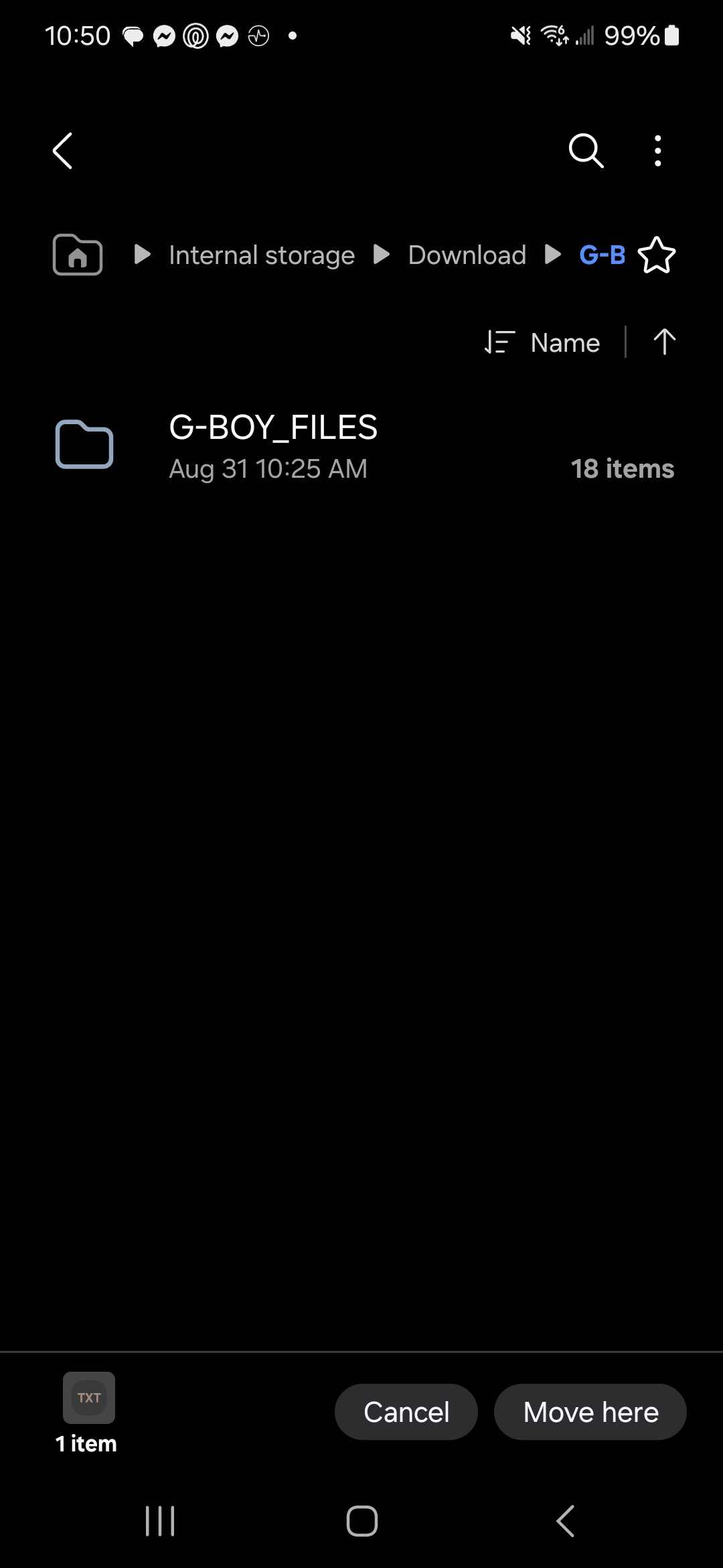

Okay, thanks for the help! I found this file, the gboy one, but how do I use it and whay do I do to put that file into an order at one of the websites? Anyways, I appreciate the help again, and I hope you have a great day as well!

In the Gboy PCB folder, there's a "Gerber_PCB_G-Boy Breakout Boards-GC+.zip" folder.
This is your Gerber "file". Gerbers are PCB files for production. JLC or PCBWay will make your PCB from this folder. Inside it, there are one file for each layer of the PCB (like the copper layers, the silkscreen, etc)

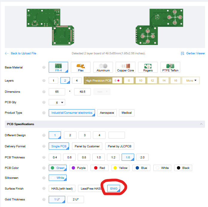

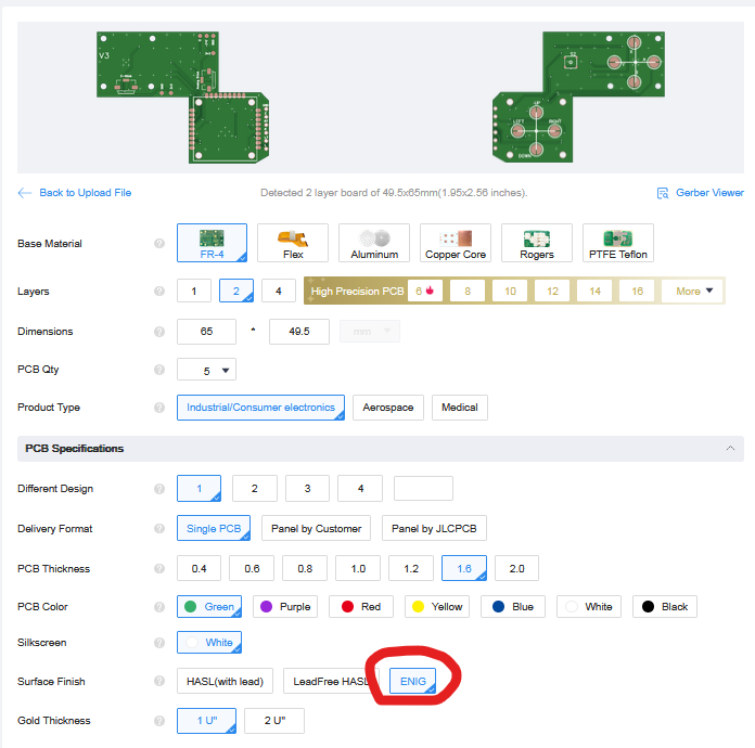

You'll find a lot of options, but you shouldn't modify them. However, you can change the color if you want. Do not forget to set the surface finish to ENIG !
This is what you should have.
