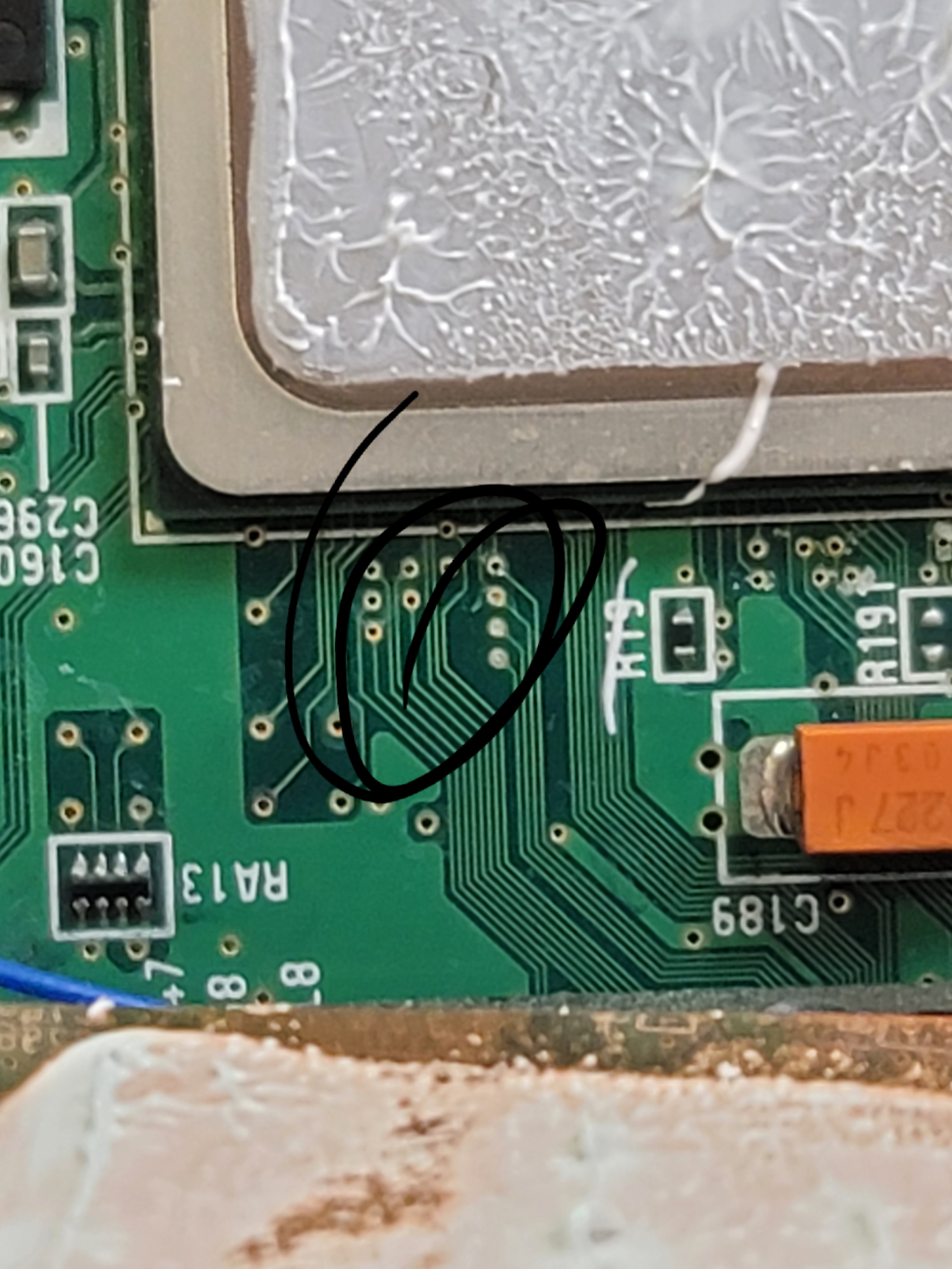

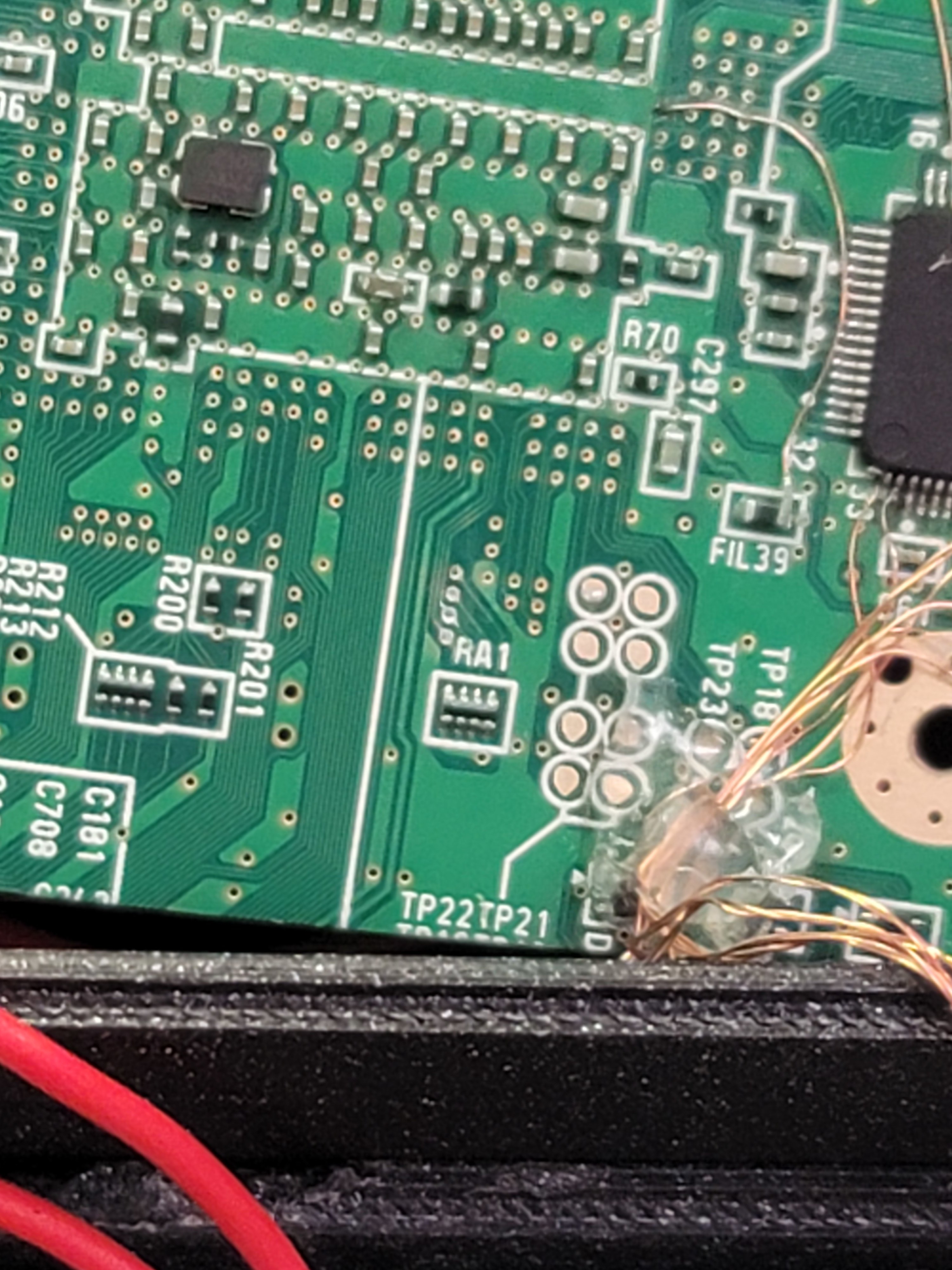

I went in and cleaned up the gcd points on the wii motherboard, here are some pictures of those
