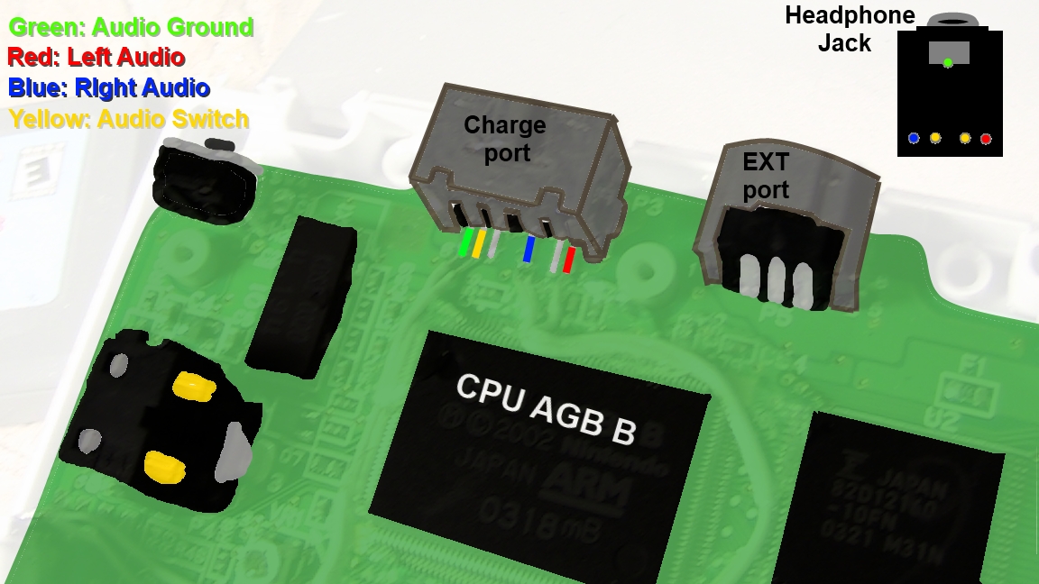

ShockSlayer the real . ヽ༼ຈل͜ຈ༽ノ . Joined Jan 16, 2016 Messages 1,526 Likes 4,076 Location standing up Portables please do not ask!!!! I will NOT respond Jan 3, 2017 #1 found this on my computer, don't actually know if it works, think the switch pin is inverted from typical hps behavior
MiseriesChild . Joined Jul 25, 2016 Messages 163 Likes 121 Location US - Tallahassee, Fl Portables 3/4 Jan 3, 2017 #2 I've still got my GameBoy SP and might try this out. I've been wanting to add a headphone jack to it for awhile.
