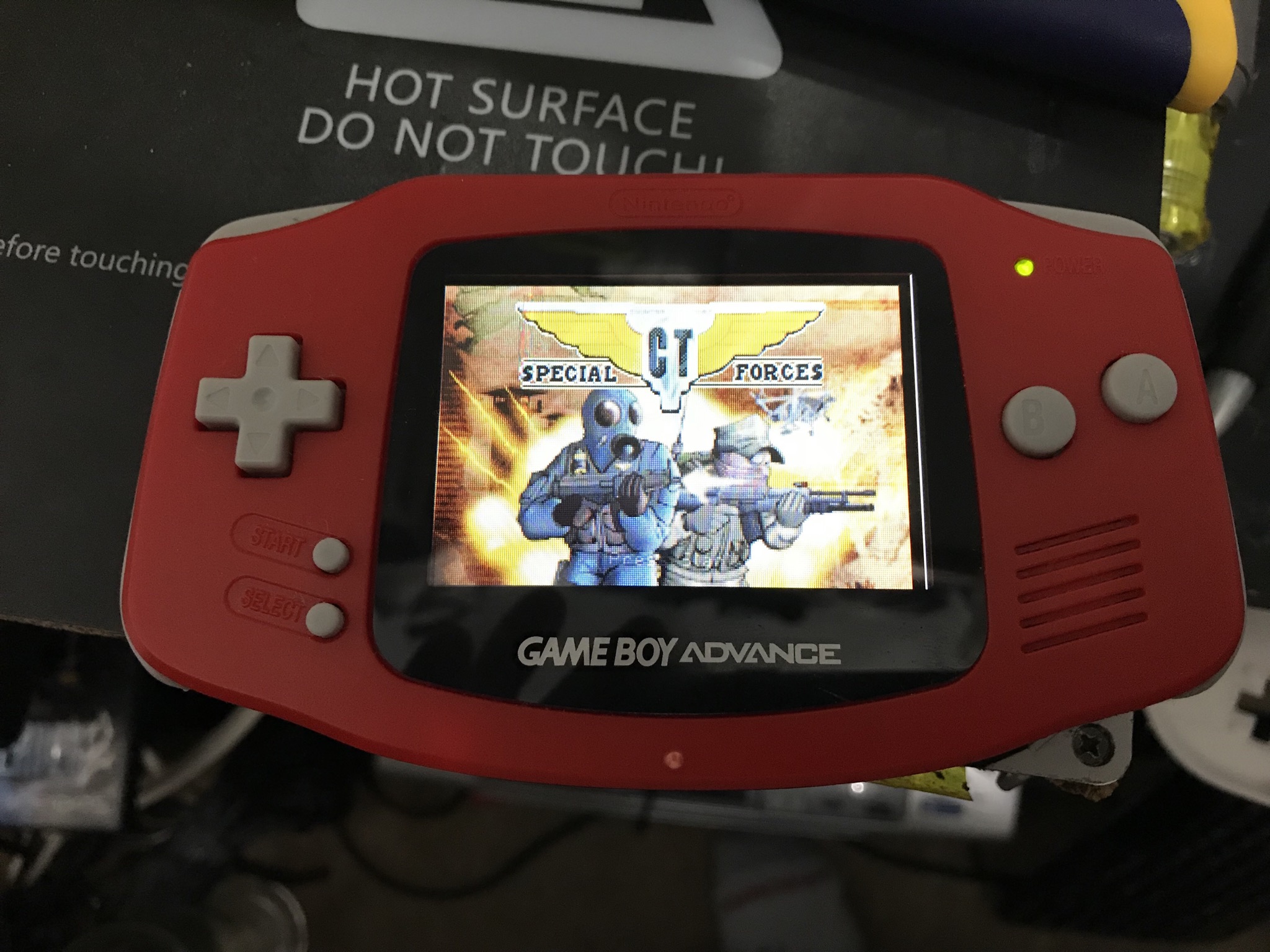

I recommend you to replace the screen with the one with backlight the games look way better,I replaced mine a few months ago as you can see here
