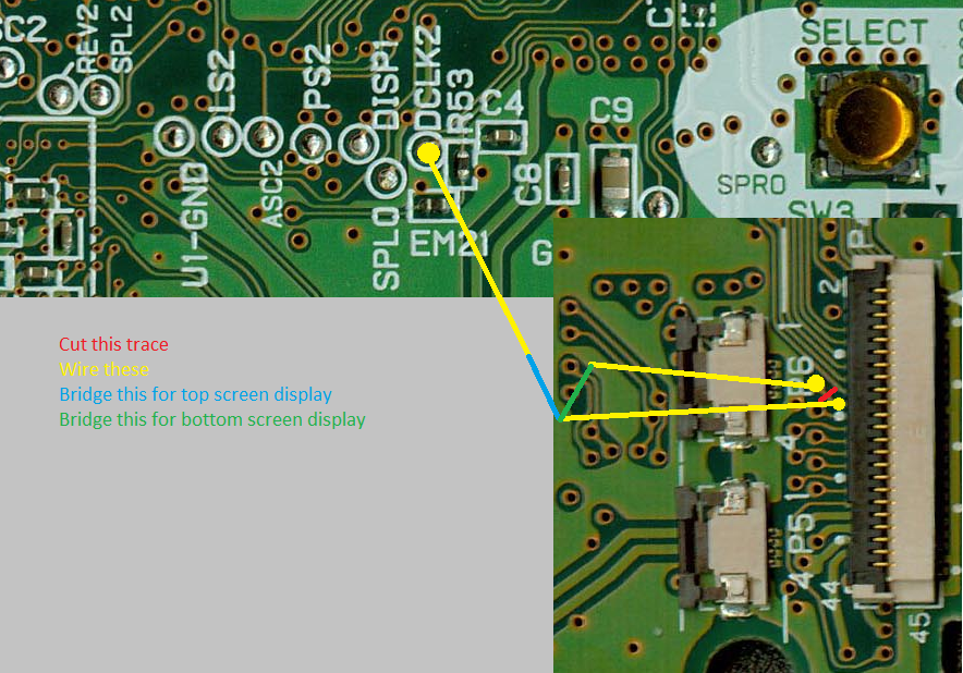

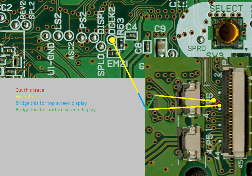

This will let you switch what screen is displayed on the bottom screen of a phat DS. This is usefull for playing some DS games on a Gameboy Macro.
It's not easy, but the main idea is to have DCLK2 go to the bottom screen (this will display the top screen down there). If the trace isn't cut, it will display the top screen, but pixels will be distorted depending what is drawn on the bottom screen normally.
This only works with DS Phat as of now, but I'll probably look into getting it to work with a DS lite.
Thanks to the people at bitbuild, and @cheese for the idea to test the DCLK pins
Edit: DS lite is mostly a no-go. Phat DS Shares it's 18 color pins between both screens, but each screen has it's own DCLK.
As for DS lite, it shares one DCLK for both screens, and has 18 color pins per screen (why nintendo?) This would basically require cutting 18 traces, soldering to 18 pins, and 36 vias, and using a switch with 54 pins
This will let you switch what screen is displayed on the bottom screen of a phat DS. This is usefull for playing some DS games on a Gameboy Macro.View attachment 4212

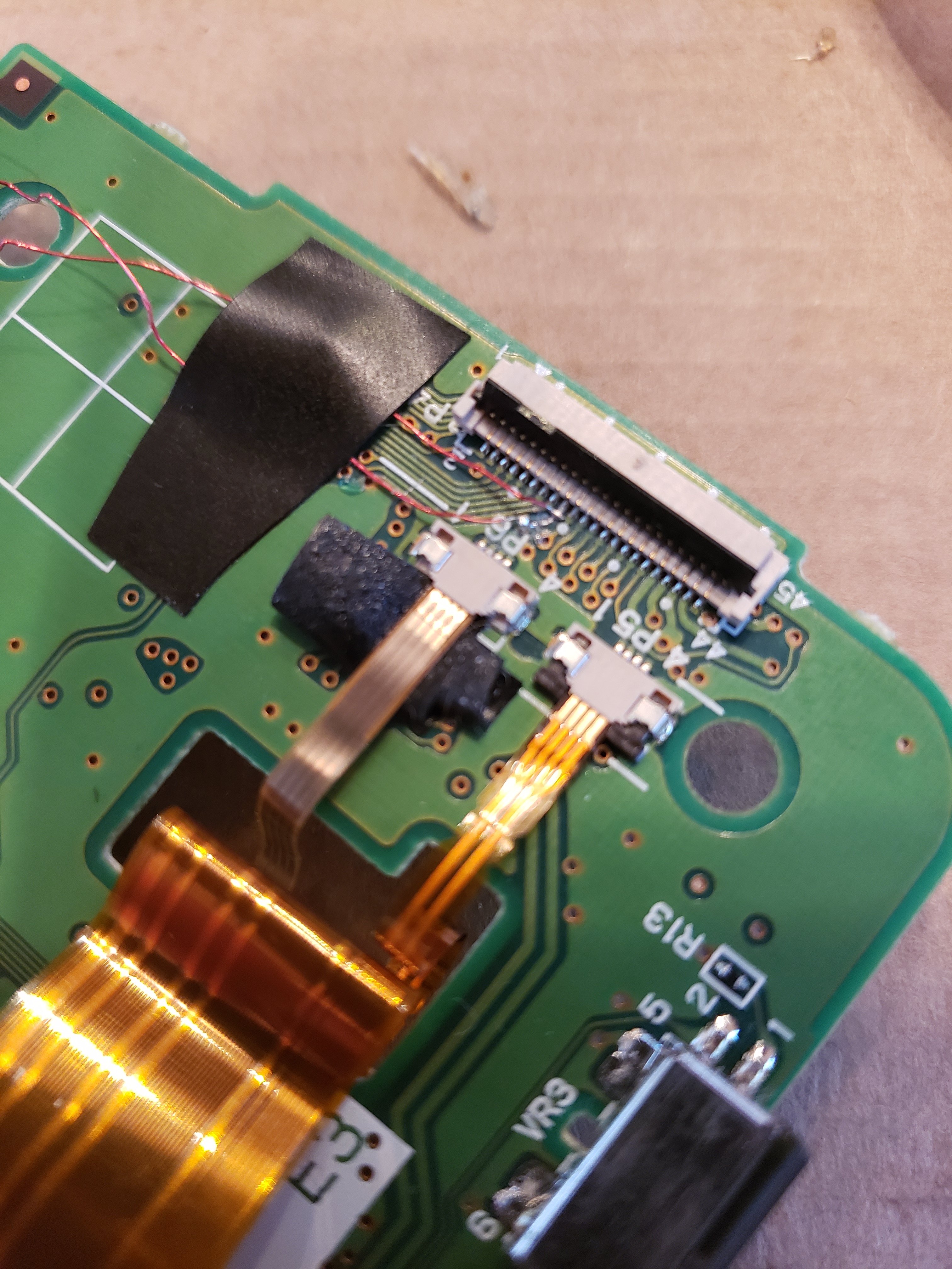

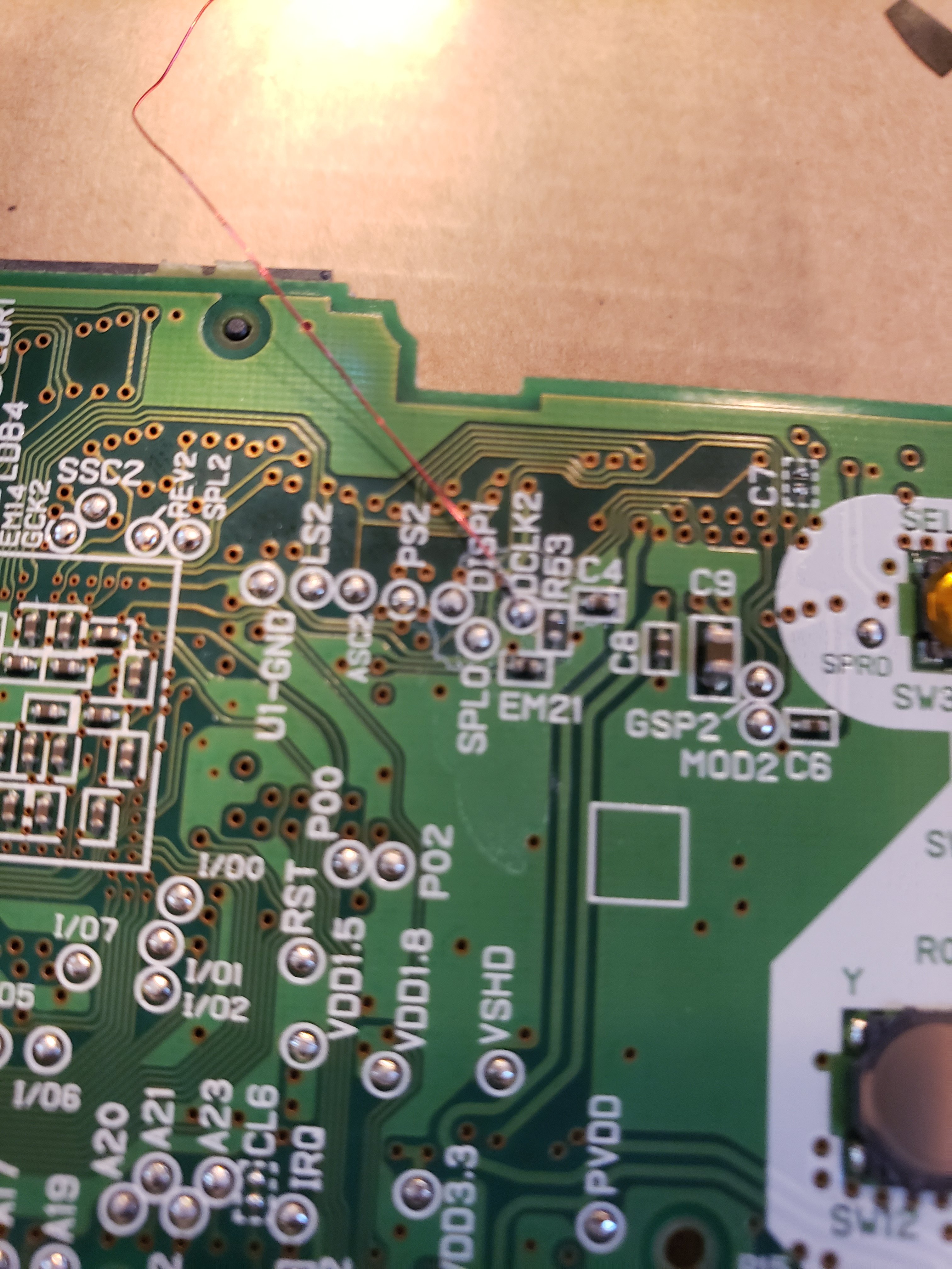

Is this tested and confirmed as working? I've done the setup as described and when I flip the switch to DCLK2 I'm not seeing anything. Some help would be greatly appreciated!
And yes I know, old thread :P

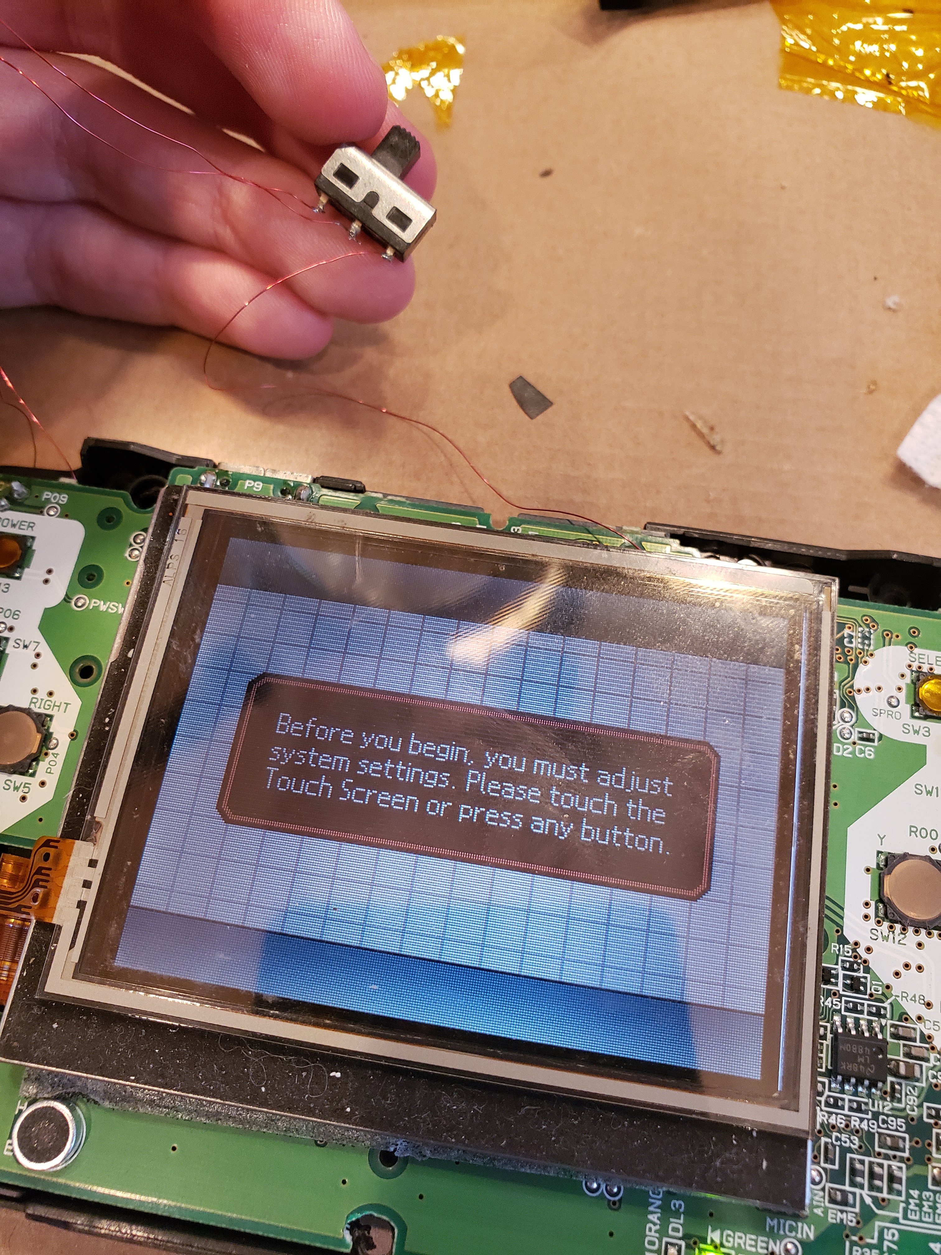

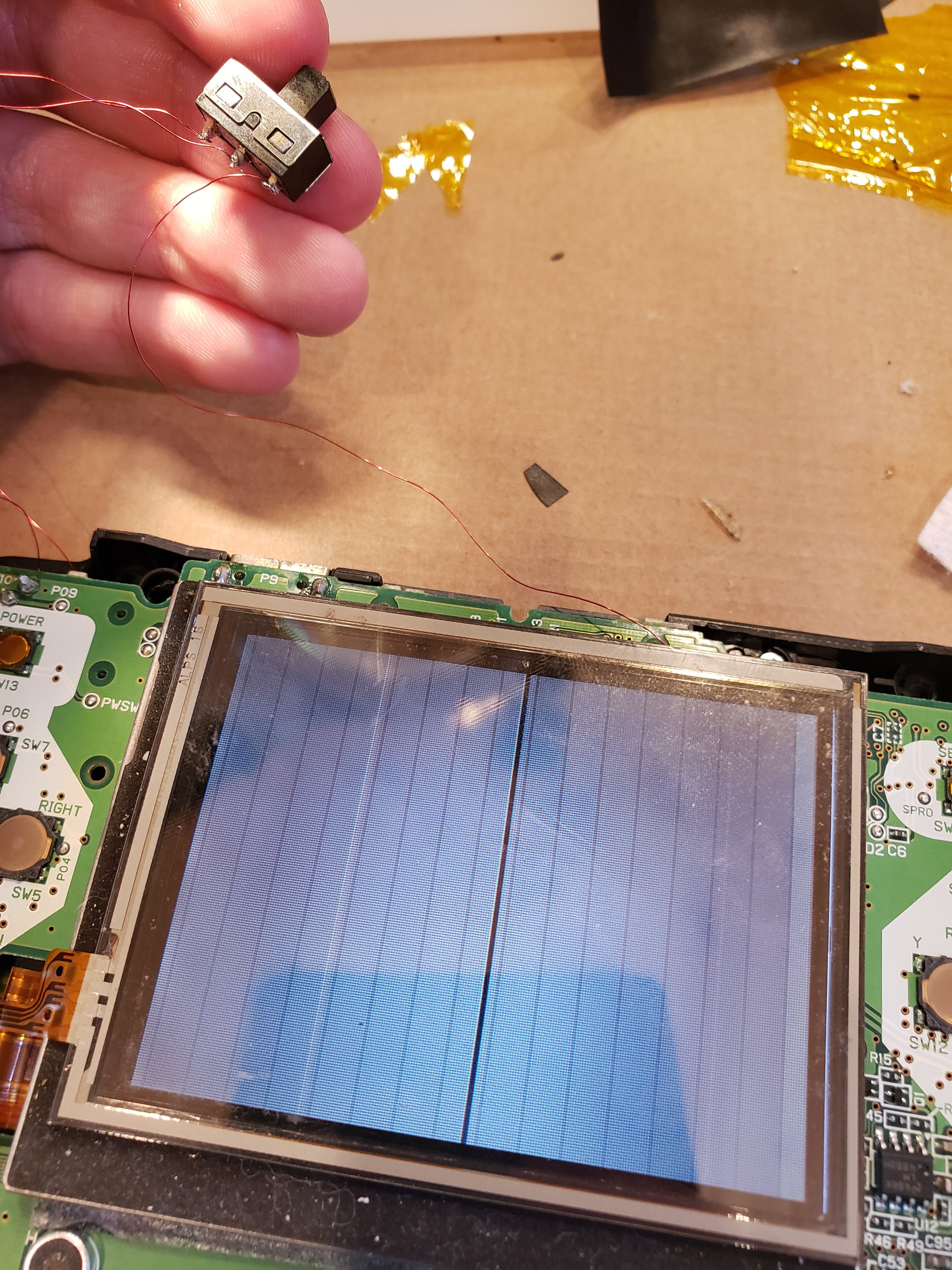

Here's the bottom screen output:
And top screen:
I've checked around with my multimeter and there are no shorts.
I FIGURED IT OUT! Turns out you need some resistance between top screen output and bottom screen input. I used a spare 750 ohm resistor I had on hand.

From what Ive learned so far, it works, but is very finicky.
Requires Flashme, TwilightMenu & NDS-Out to be run before launching any games.
People are hoping there is a FW flash option in the future as the current scenario is messy and R4DS cart depedant
This is how I was able to get the screen swap to work on my DS Phats
