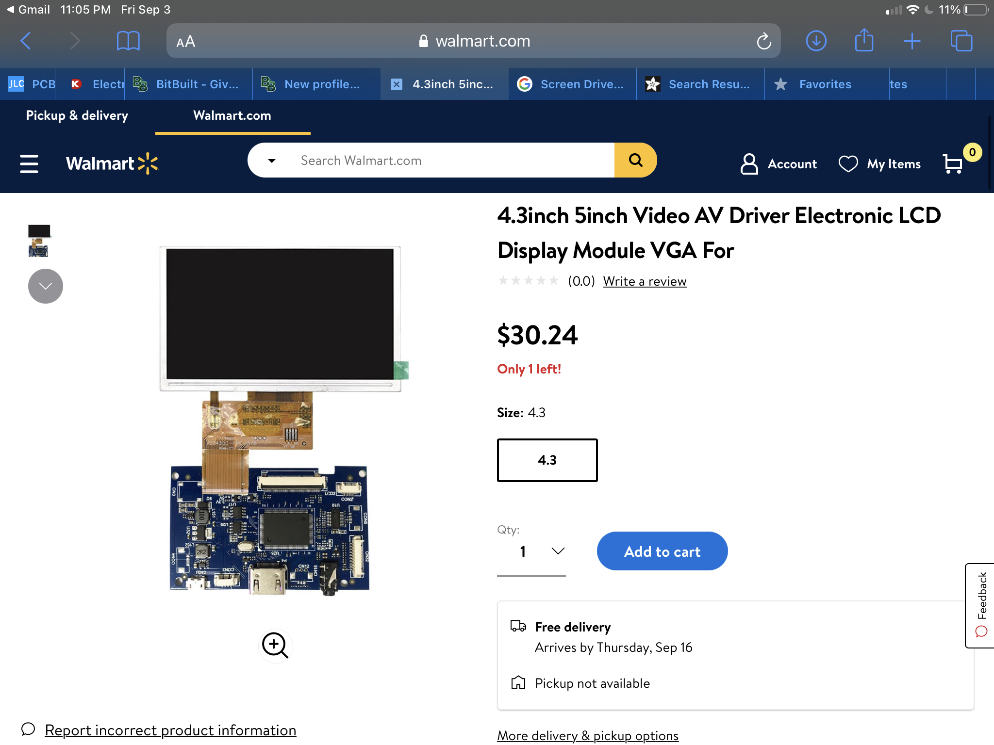

Can I use this screen for the G Wii? thanks
I don't think so... here are some of the boards we have been using:
https://www.ebay.com/itm/353134606441
https://www.aliexpress.com/item/400...xp_id=7792f39a-3d8d-4fb4-bb91-a4d5c1e95806-34
