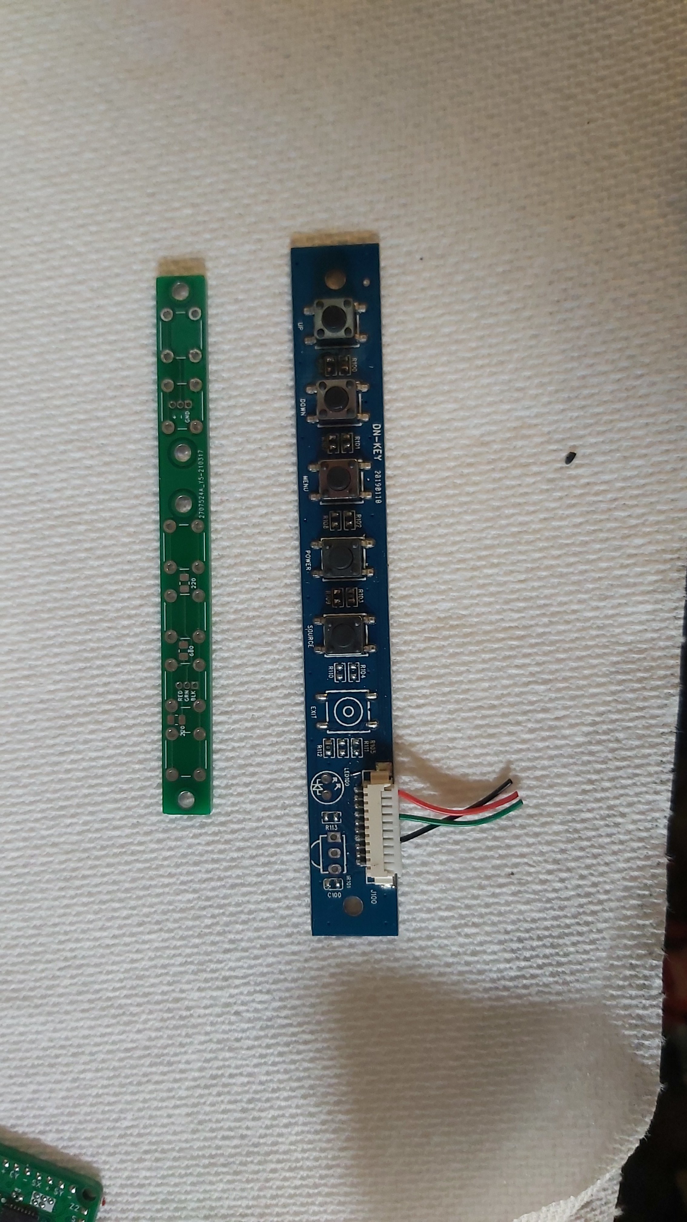

Firstly I wanted to ask, how do the screen controls get wired up? Is there a diagram or something? A little while ago I was using Noah's streams as a reference for this but they're no longer up. I've done a little digging and while I'm sure they're somewhere on the forums, I haven't been able to find them for the life of me.

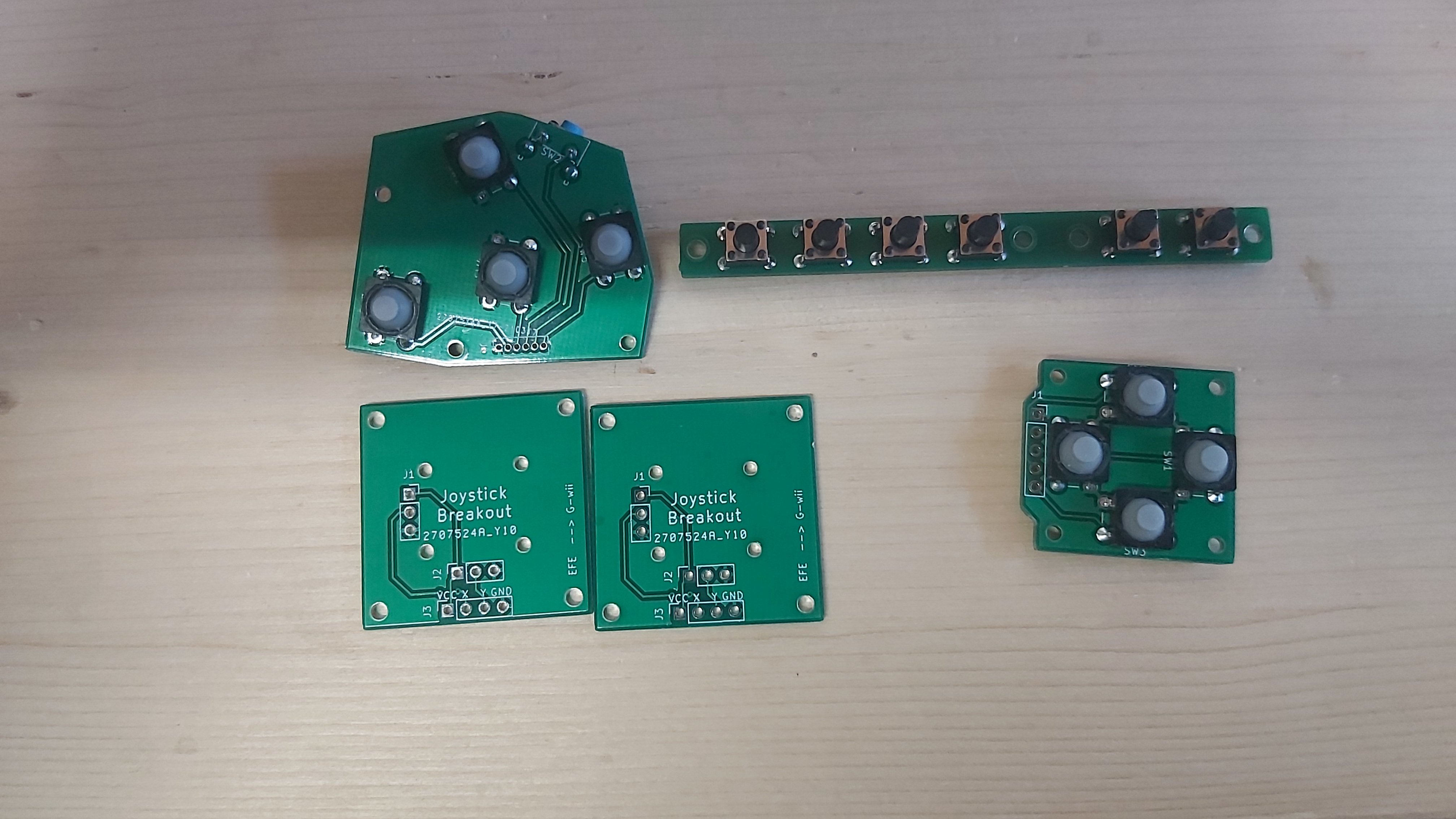

HI there, for the screen controls you can remove the buttons you wish to have and just jump from where the buttons are to the new location on the 3d printed part. i have a PCB which i designed to elminate the screen control board and you just need to match the red green and black connections for it.
i sell it in a kit with the 5 3d printed mounts turned into PCBs

Ah, alright, what you're saying about audio makes a lot of sense, thanks a lot for that! As for the screen controls, I believe what you're saying is to remove the buttons on the screen control board, and then connect the buttons that are attached to the 3d printed bracket which makes sense. Isn't there a way to connect them directly though without the need of the screen control PCB? This would remove the need to include the PCB which I feel is necessary due to a lack of space.
Also, those are some cool PCBs! If I didn't already have my controls wired up and in place I might consider that. Thanks again!
yah you can, youll have to find which value resistor the button you are wanting is using and connect it in line, itll just be a simple case of understanding how the PCB works and replicating its function with new resistors
I remember it being a lot simpler than that when I was initially watching noah's streams. I thought what he did on stream was wire up the button to some of the pins that were on the connector for the controller board. I thought that was how the screen controls got wired up and I would've done that but I thought it was be easier going into it already knowing which pin does what. Maybe I'm mistaken though, thanks for the help anyways

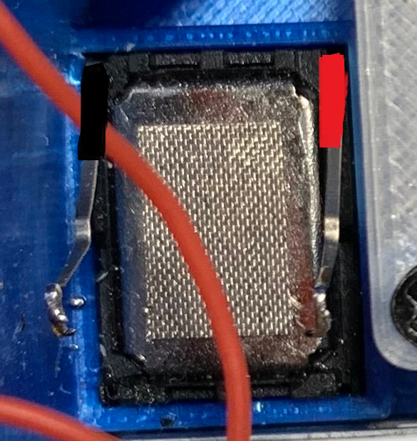

I wired up the speakers like this:
(ignore the random wire, this was the only image I could find and I didn't wanna take pictures)the red spot represents where I wired up the positive wire, and black representing where I wired up the negative wire.
