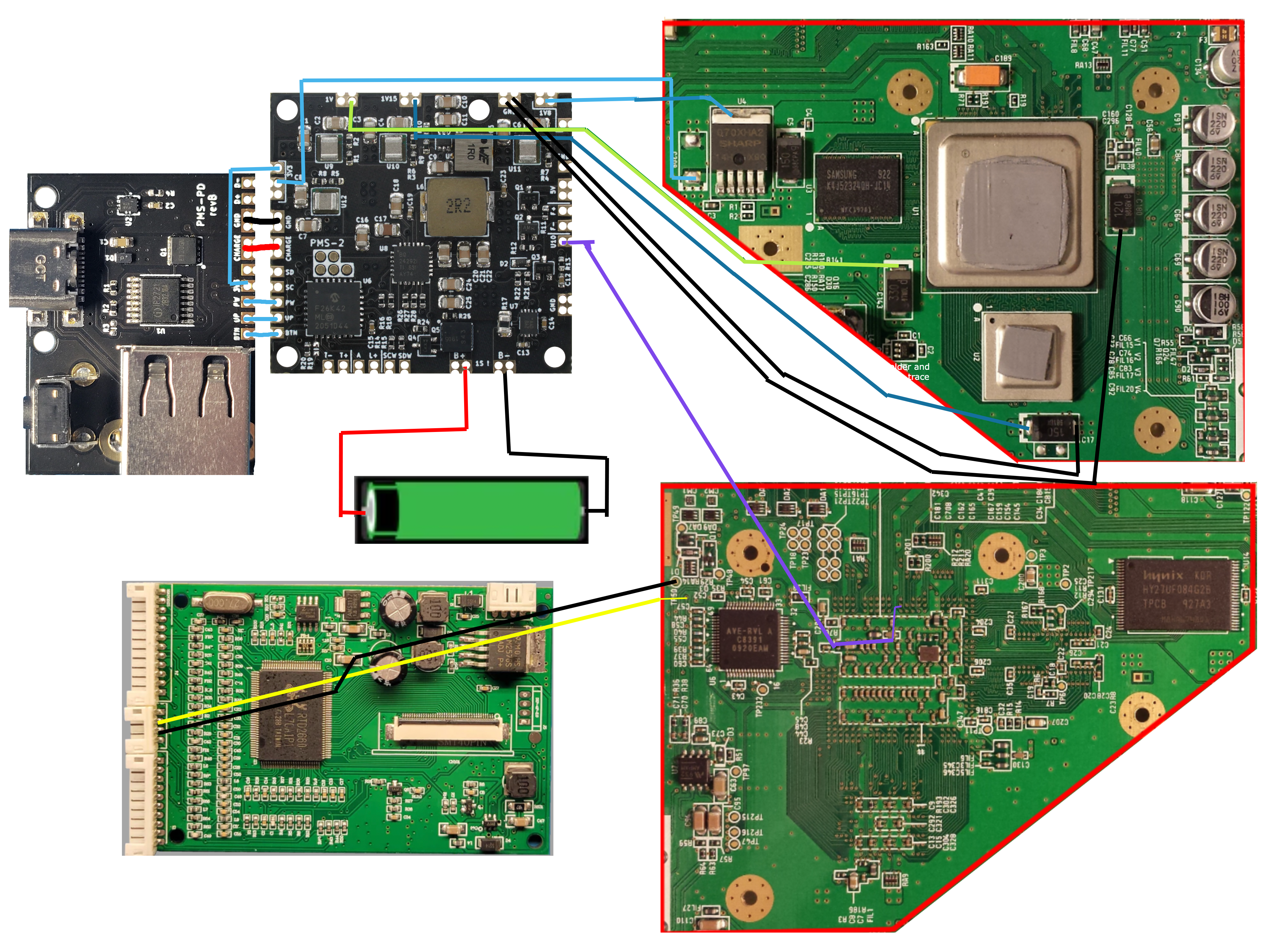

I made this diagram to help me out. Is this right? (I did remove the LDO)

If you removed the LDO, make sure you are using the pms-2 which is out of stock and not the pms-lite.
The diagram looks good.
1. No, the NTC is just for temps in HUD.
2. It can boot but it's not supposed to work without one, so don't
3. Nope
4. If using u10 from the pms then no
5. Yup, it's just power.
