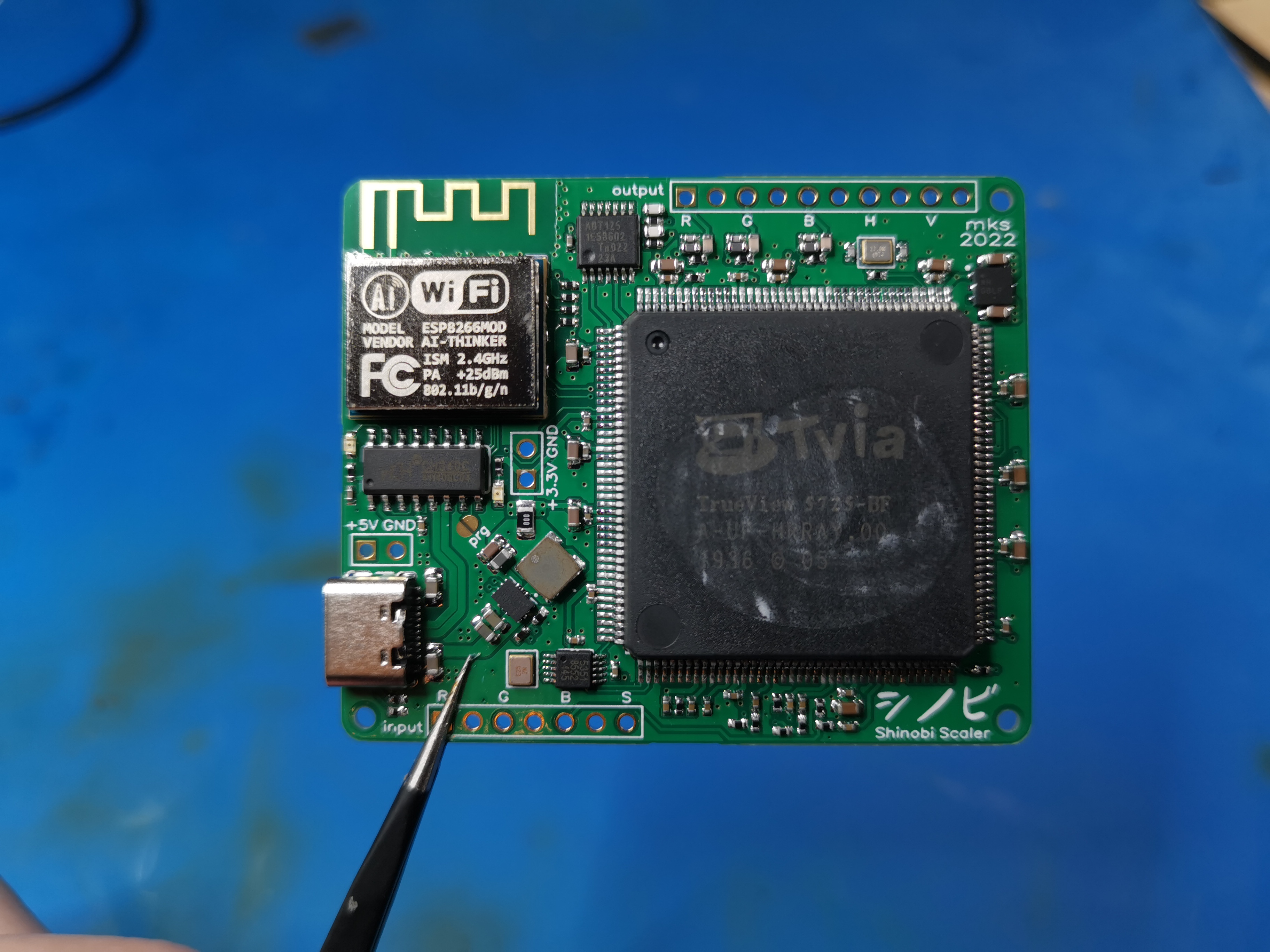

Boards and TV5725 ICs arrived today! Just waiting on a couple other parts from China.
Yeesh, sorry for the delay. Been busy with work and the LCD buy.
There's been a minor Shinobi schedule slip for a couple reasons:
1. Realized I ordered the wrong ferrites for the output filters; yes, I could just bridge the pads, but that might degrade video quality and I don't want to do that. The correct ones will get here in a day or two.
2. I'm trying out a new workflow with a vapor phase reflow oven. It makes fantastic solder joints but is prone to tombstoning. I'm sure it can be fixed with some profile tuning, but I don't have time for that right now. So every board needs a bit of extra rework here and there. The TVIA chip usually needs some touchup regardless so this isn't a big deal but it's delaying everything by a couple days.
(Gotta say, DFM is hard. I wish I used more resistor arrays instead of single resistors, and didn't go so overboard with decoupling caps! Live and learn! :XD:)

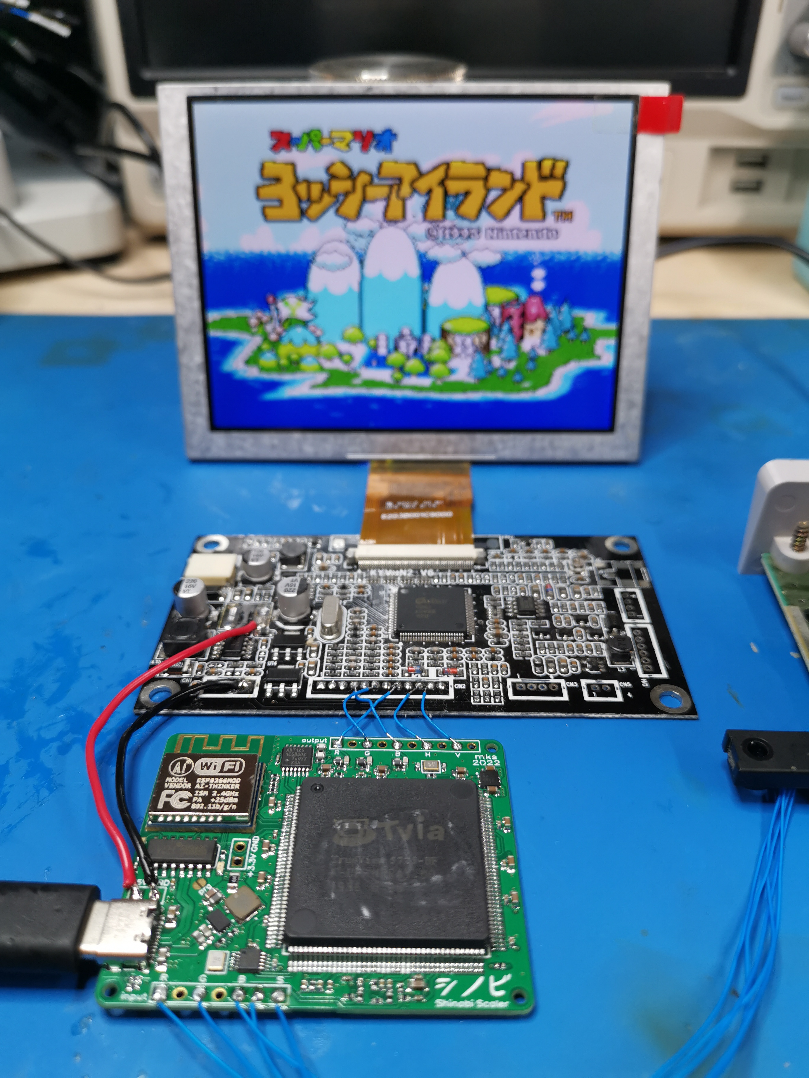

I'm on track to finish up assembly and testing this week. I'll post some photos of a Shinobi connected to the group buy LCD in a day or two.

Just shipped out all (paid-for) Shinobi Scalers! Check your DMs here on the forums or on Discord for tracking info. Each one was tested with RGBs from a SNES Jr. and the group buy LCD, using press-fit pin headers (no soldering).
The 0.1uF decoupling caps for the SDRAM are not populated. You can add them yourself if you'd like, but the boards function fine without them.
This whole process has been a comedy of errors... Mouser actually lost my 1-day shipping ferrite bead order and I had to reorder it. Also, hand placing nearly 2000 components sucks. Suffice it to say I will not be doing another run of Shinobis anytime soon.
Anyway, feel free to reach out to me if you have any questions or comments about the Shinobi Scaler hardware. Remember that a heatsink for the TVIA chip isn't mandatory, but you should use one if you have the space for it.
Just shipped out (paid-for) Shinobi Scalers! Check your DMs here on the forums or on Discord for tracking info. Each one was tested with RGBs from a SNES Jr. and the group buy LCD, using press-fit pin headers (no soldering).
