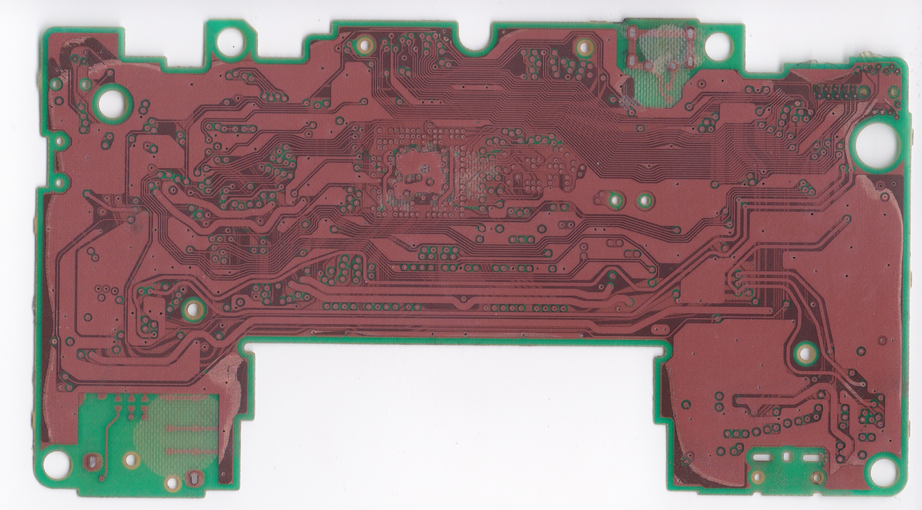

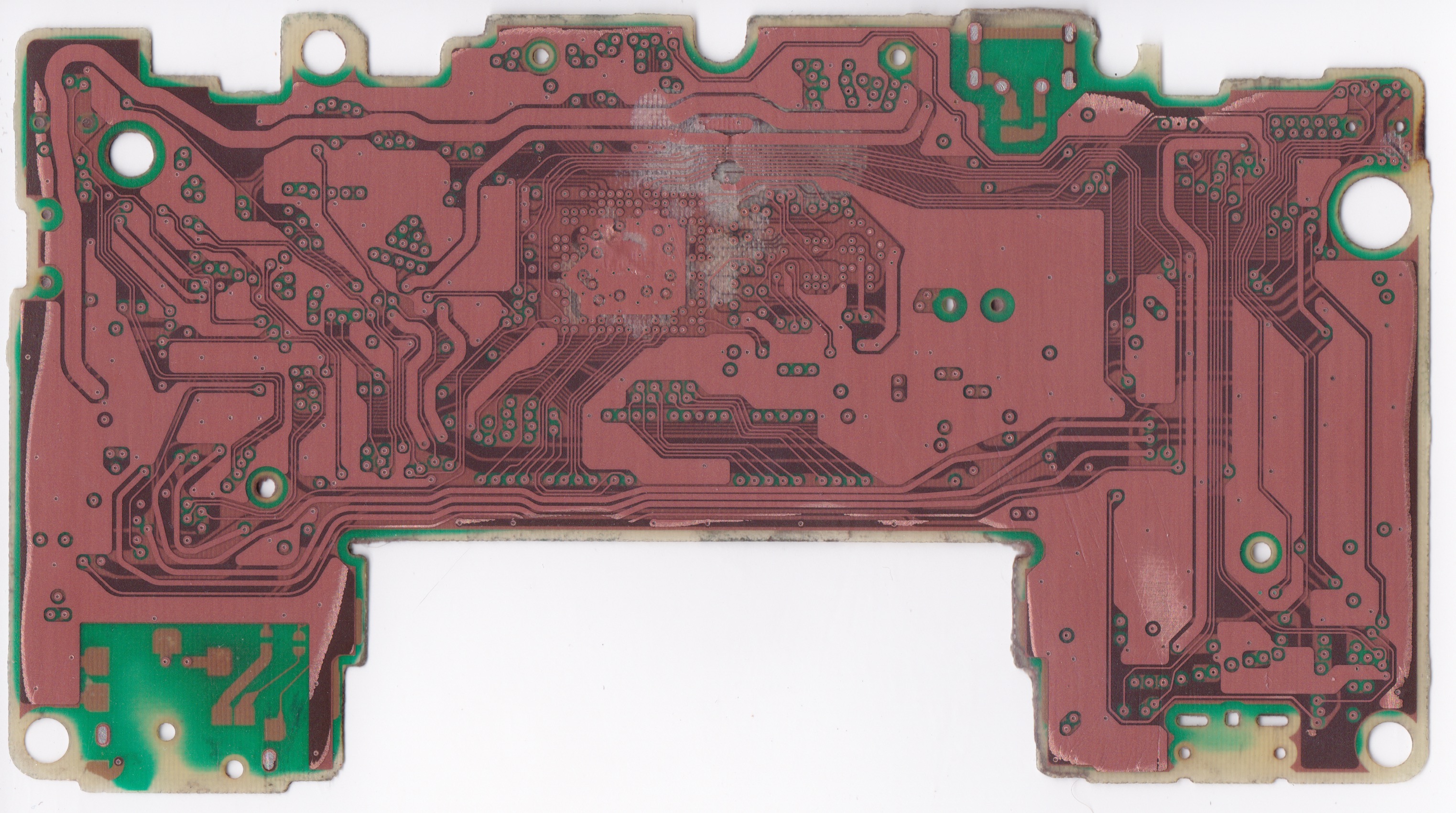

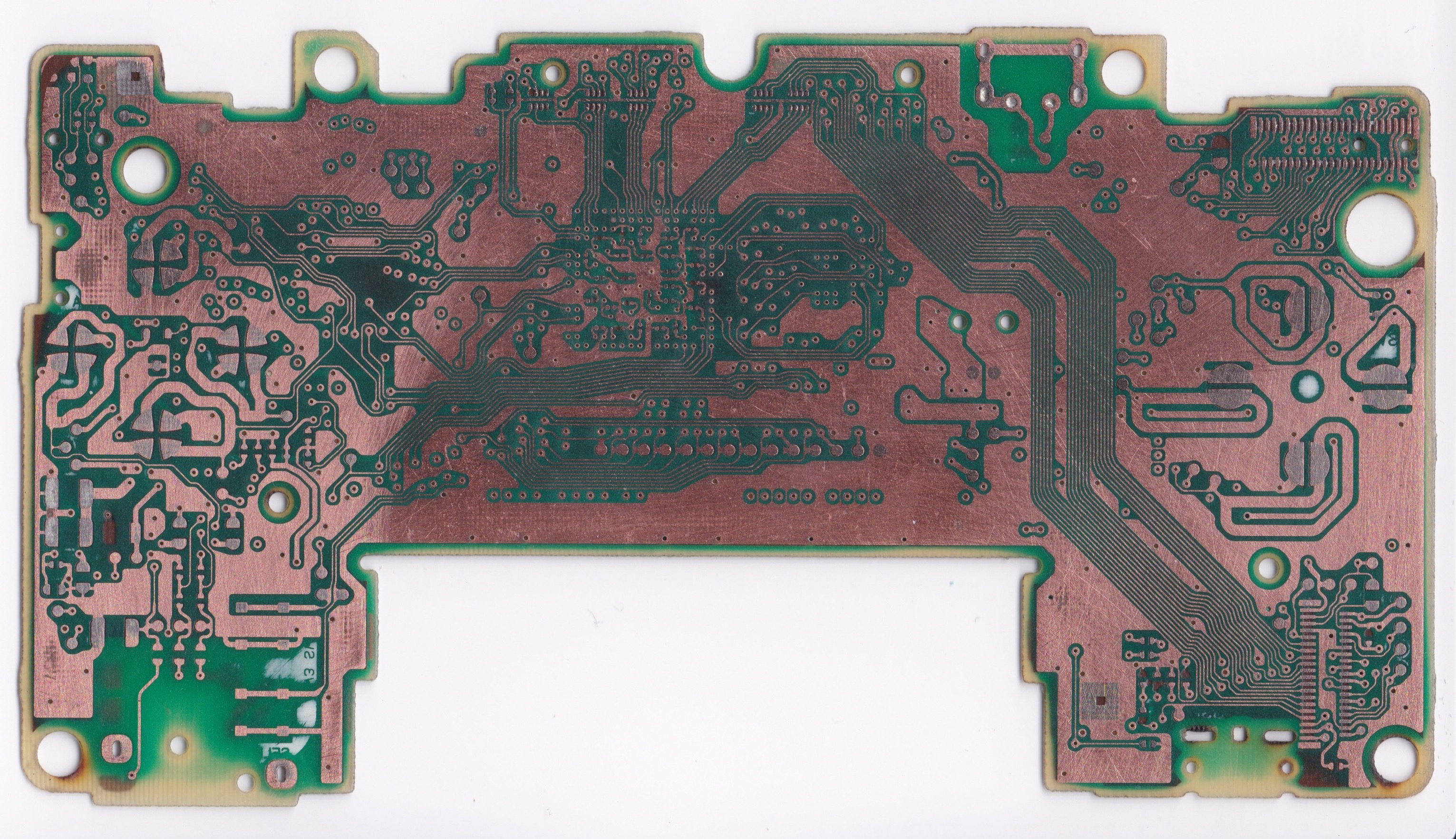

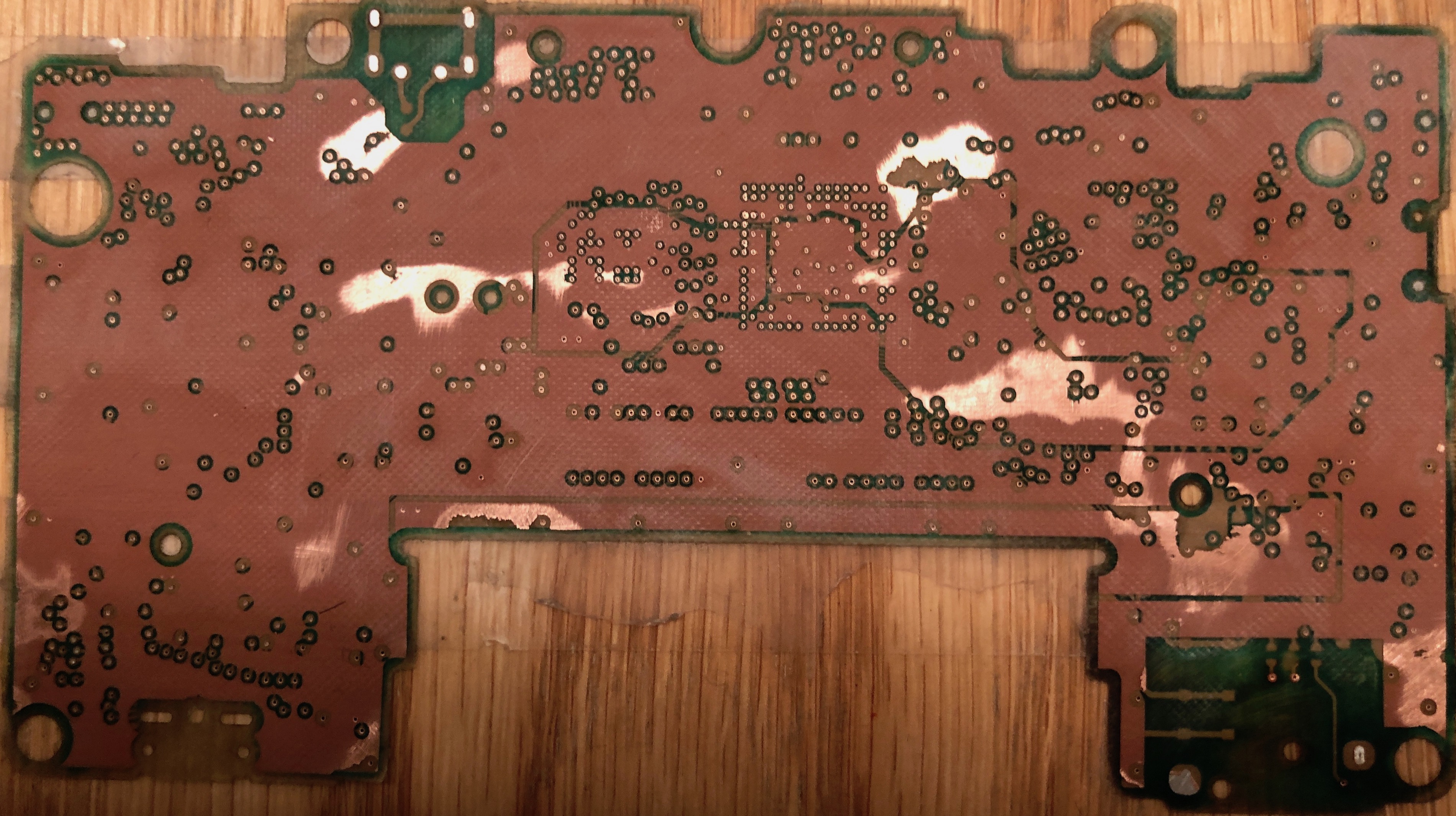

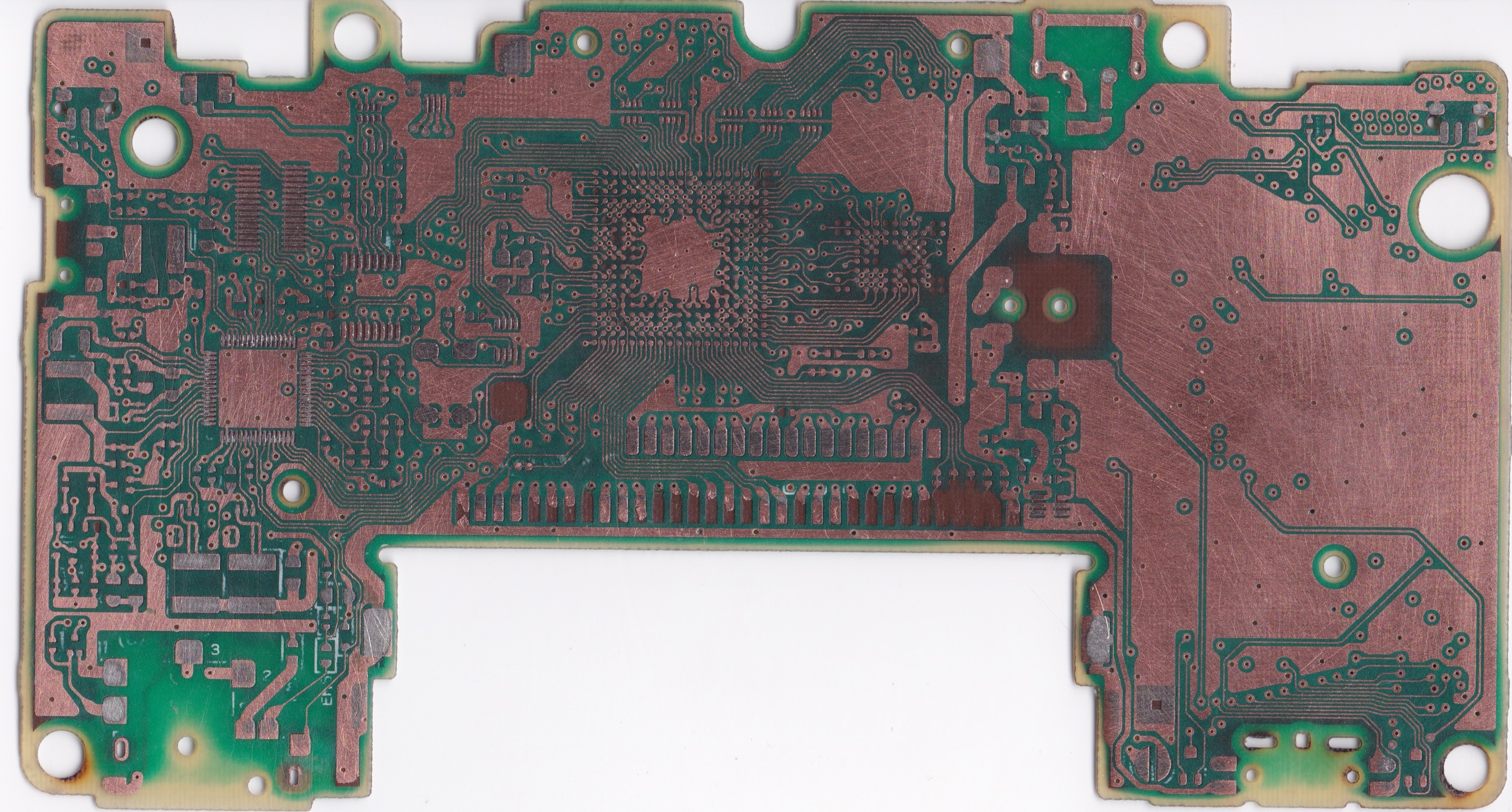

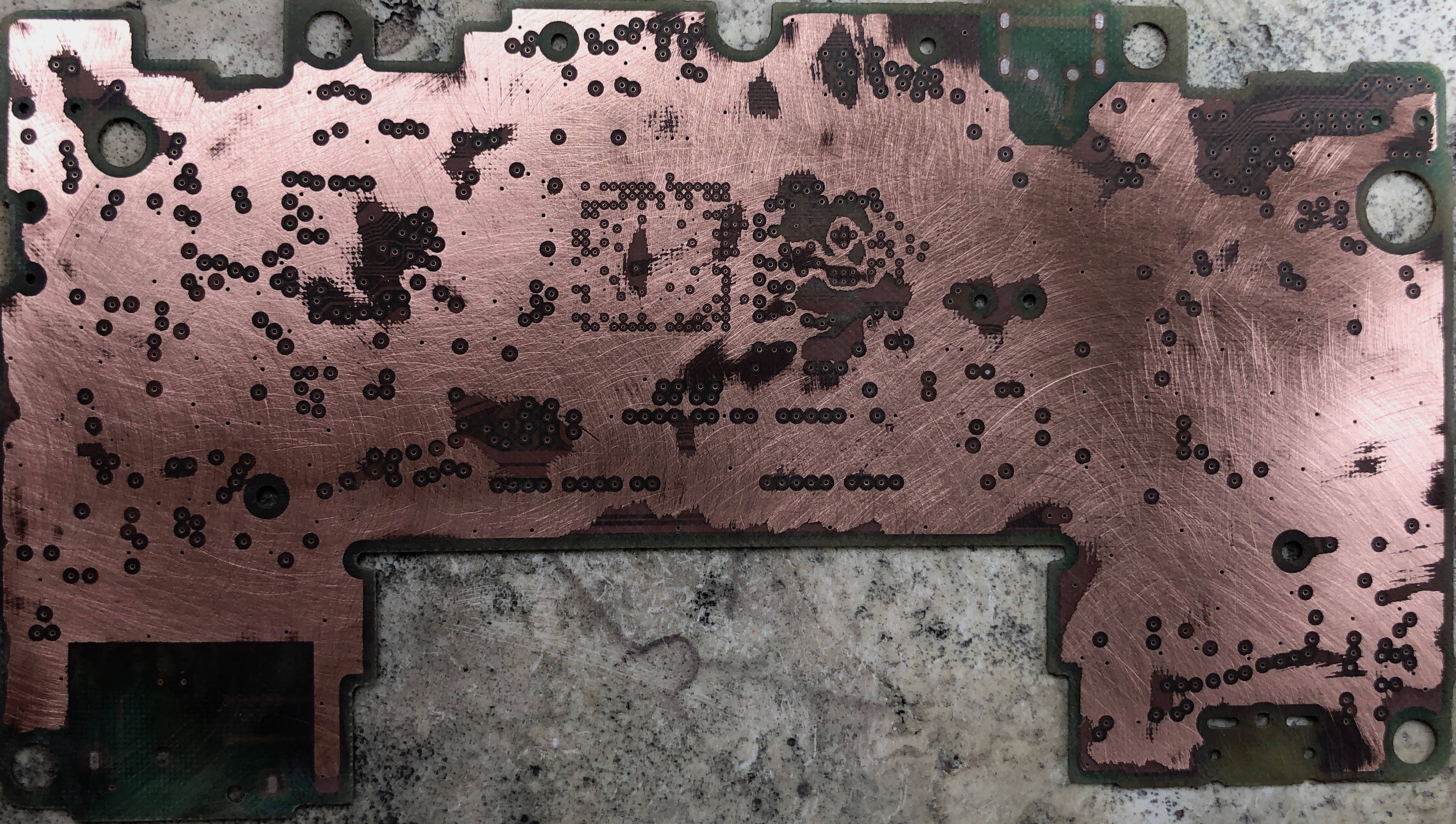

These are the DS Lite board scans one power plain one ground and 4 trace plains I'm new to using GIMP i never even knew about gimp until the WII compendium so I'm still learning how to use gimp. I have an half ass gimp compendium made up It is unfinished cause i have been busy with work. I have Labeled Ground plain vias and Power Plain vias. Now the Power plain has 4 different voltages i have found, 3.75v, 1.21v, 1.8v, 3.3v, majority of power plain is 3.3v. I have not labeled the different section. I will get around to finishing it an upload it here for all to have and use I hope this is helpful for a lot of different projects out there.

I would think u could use one of the 3.3v vias for that just use a multimeter To find one. But I all so think there was a wright up on installing an amp on here somewhere look back an see
