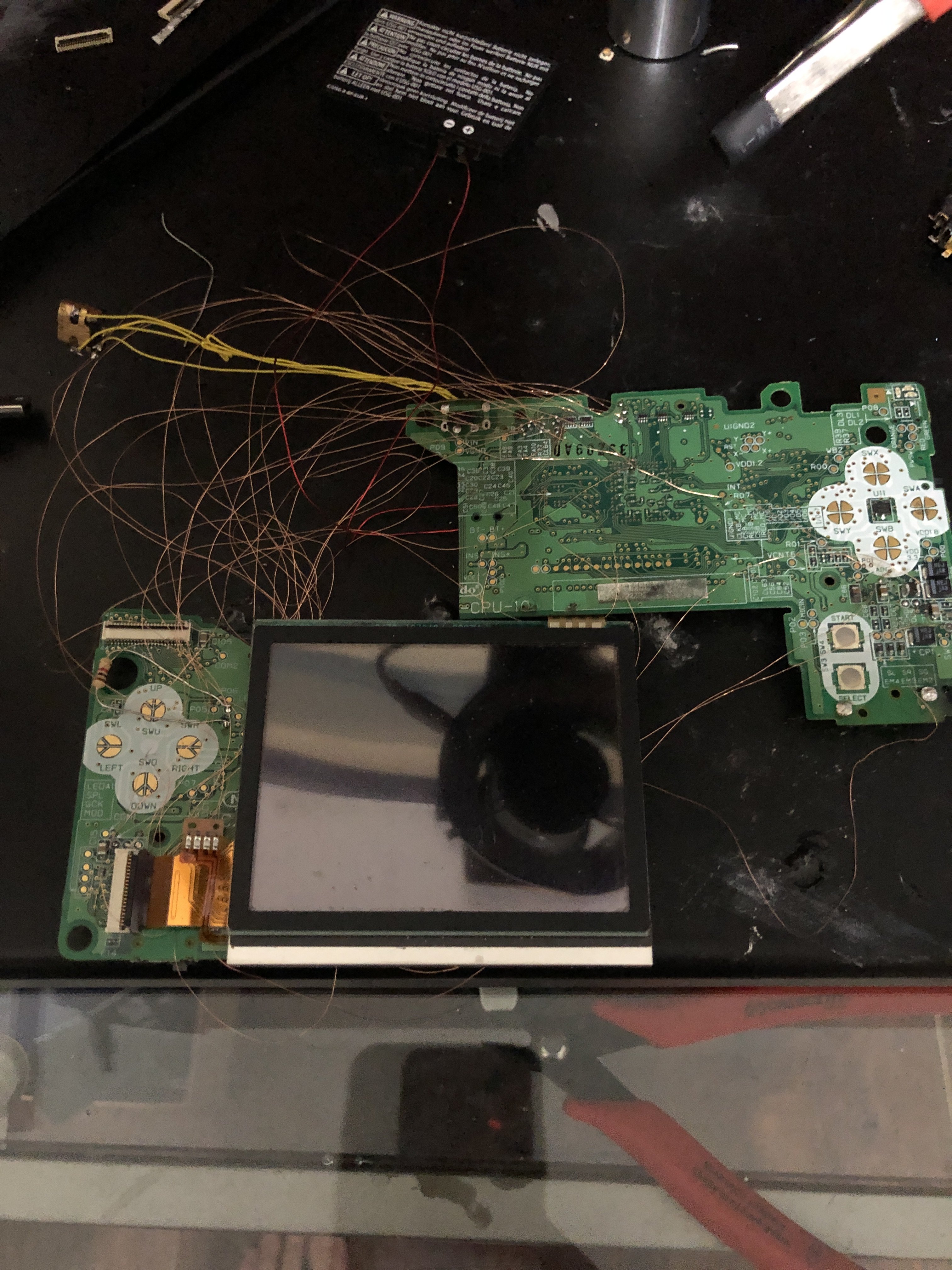

So ds lite powers on but screen stays white stays on doesn’t turn off so im going to double check my wires. This is all for proof of concept if all works well then I will clean everything up and use proper wire.
Have you reconnected the BIOS / WiFi module? This sounds familiar to me when I did a few DS Lite repairs ages ago.
See on just a white screen an yes ill share scans after i have completed

Found my problem all works fine now time to stuff in shell

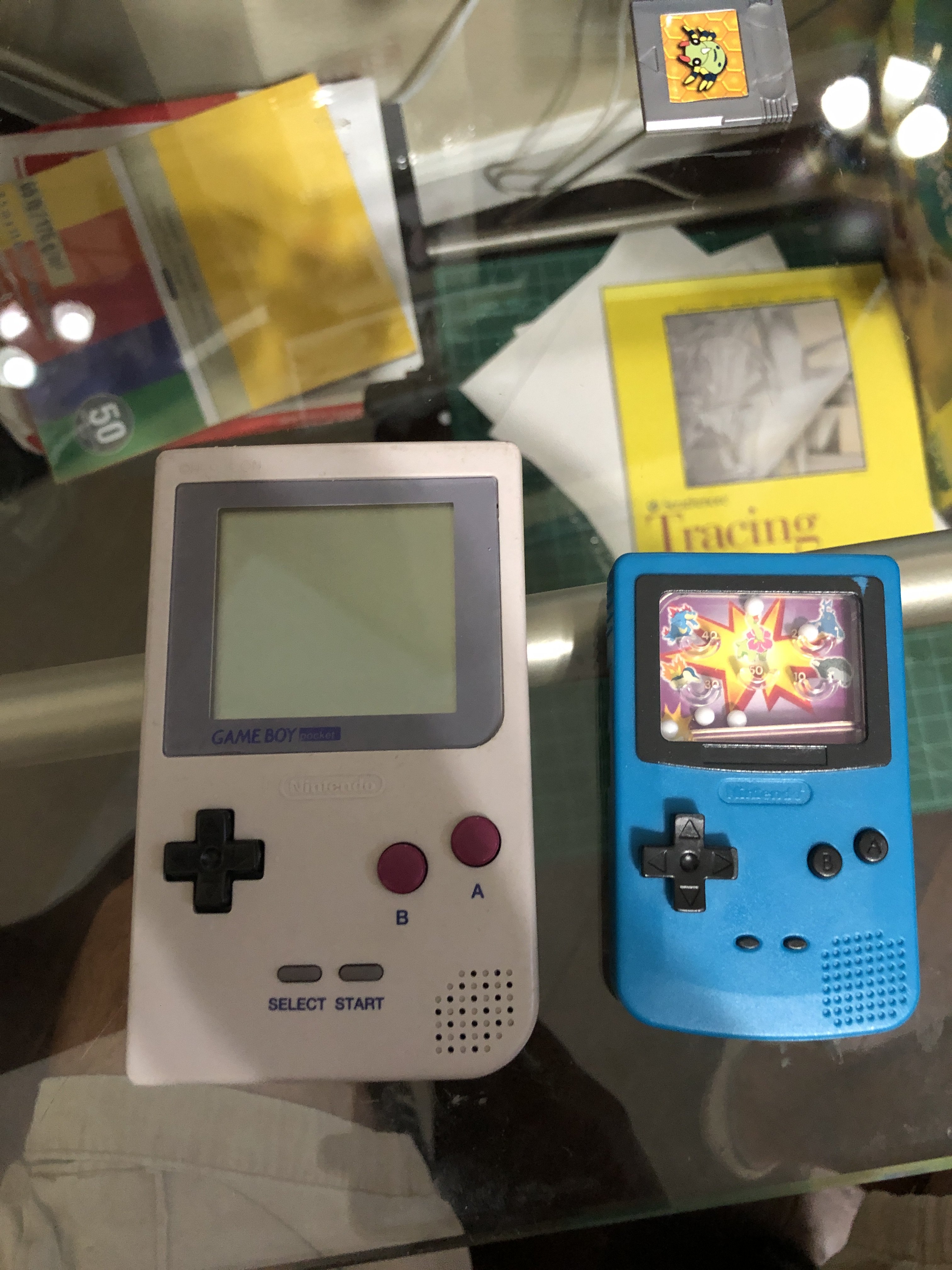

That looks awesome!
Did you get it go work inside the new case?
Anyways, great job

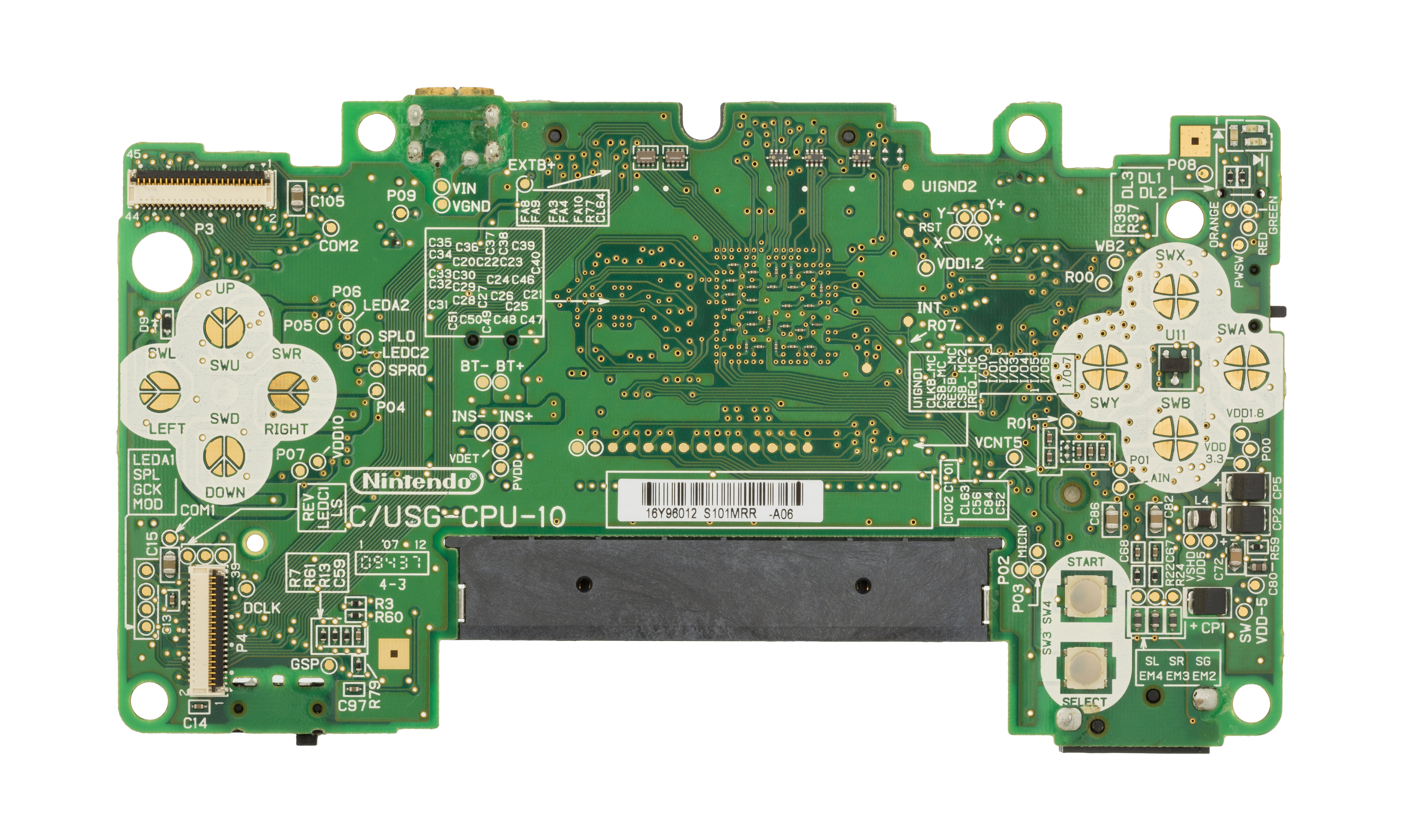

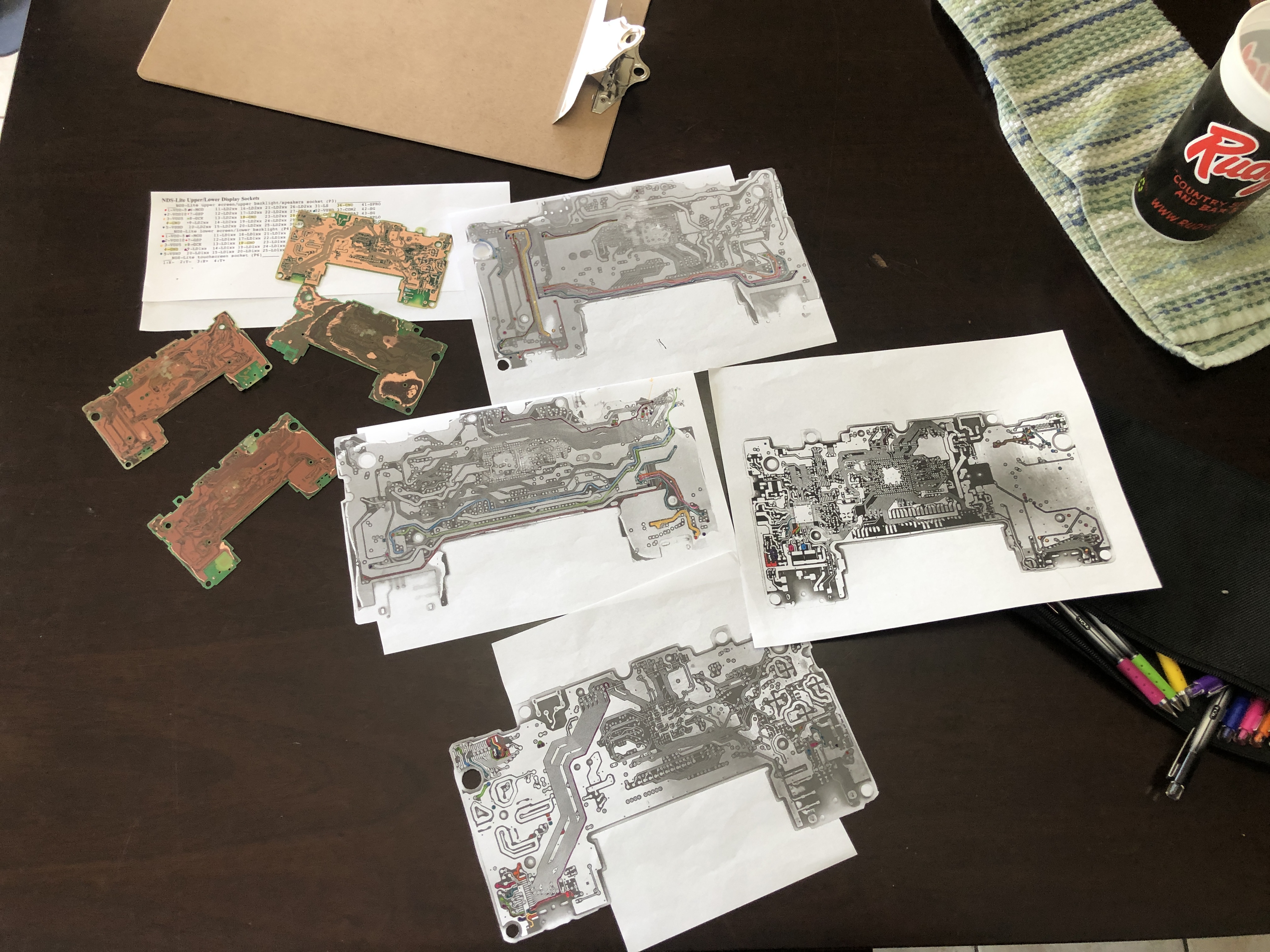

I had a few set backs not done yet. Ds lite is a 6 layer pcb one power plain one ground an then 4 layers for traces all I did was got 6 ds lites that where the same an slowly sanded each layer then scanned into my computer to make a compendium like the guys on the Wii trim did. Then I identified each SMD component and looked up its data sheet. A lot of work

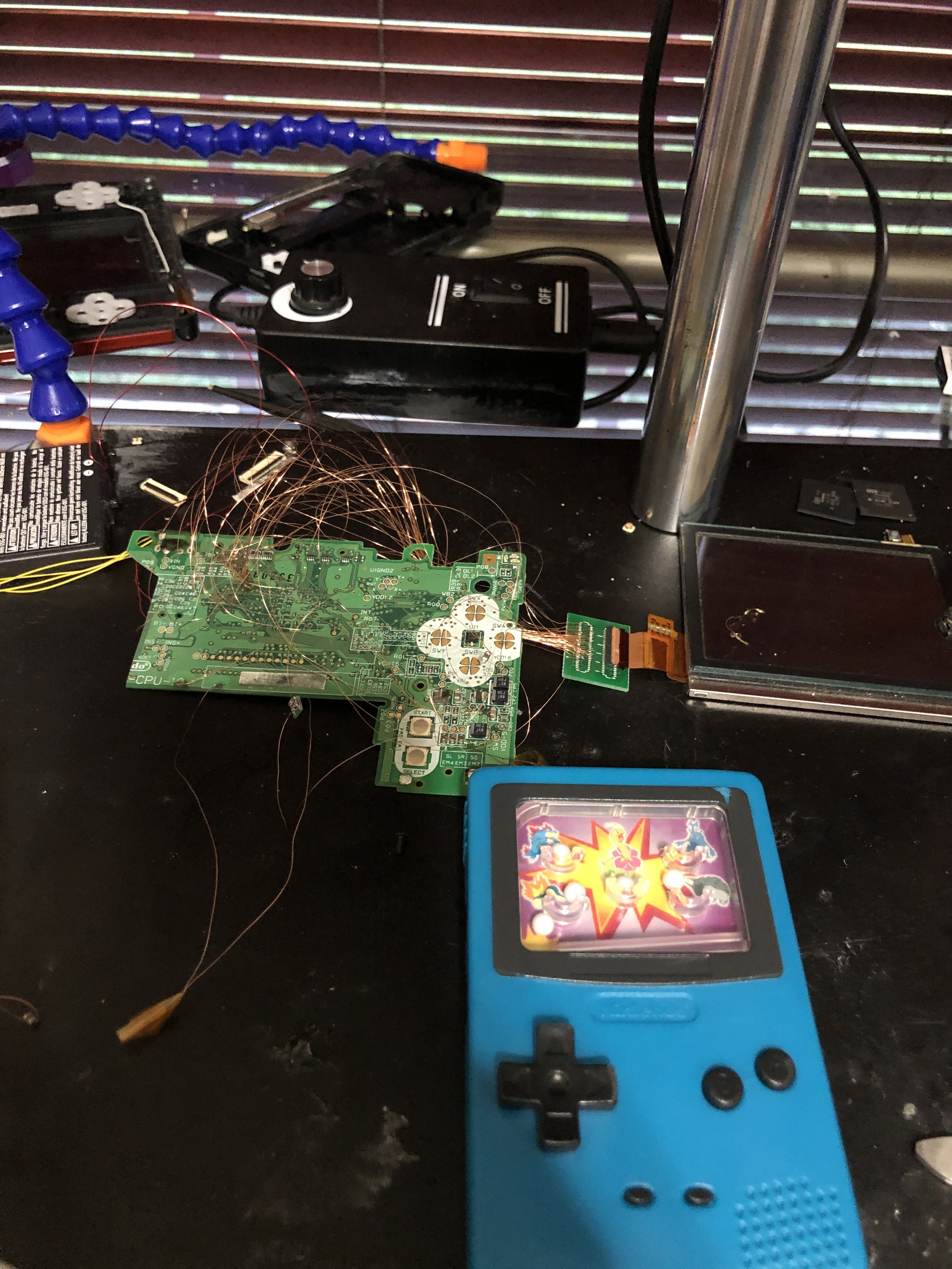

hey again, sorry to keep asking questions but, how did you plug in the touchscreen? as the touchscreen connects to the other half of the motherboard, thanks.
Soldered to ribbon cable with magnet wire to extend the cable 40 awg wire then soldered to the motherboard. I have a microscope so I can zoom in on to the pads an i use a jbc soldering station with the tiny soldering tip

You mentioned that you made a compendium of each layer. Thats awesome!
Could you please share it with us? It would help me a lot and I think other members would really appreciate it aswel.
btw: have you made any more progress since your last update? I'd really like to see more of your build :)
Yes I’ll start a new post an up load it later today. An as far as my project yes I have but when all this coved 19 started in the states work got crazy busy an I had to put it on the back burner for a lil bit.
