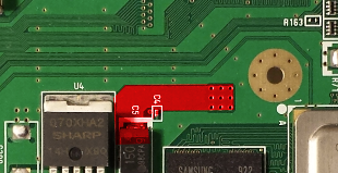

Hi, I watched some trimmed wii's and some left the LDO on and some removed it. My question is, can i remove it without any relocation and what are the side effects ?
i looked at the compendium Wii RVK-01 Compendium that shockslayer have released and found the 1.8v. i measured it at the 9 nine dots right above the ram. is that correct though? i really want it to get it right
Yes, anywhere in the red section you can put 1.8v:
